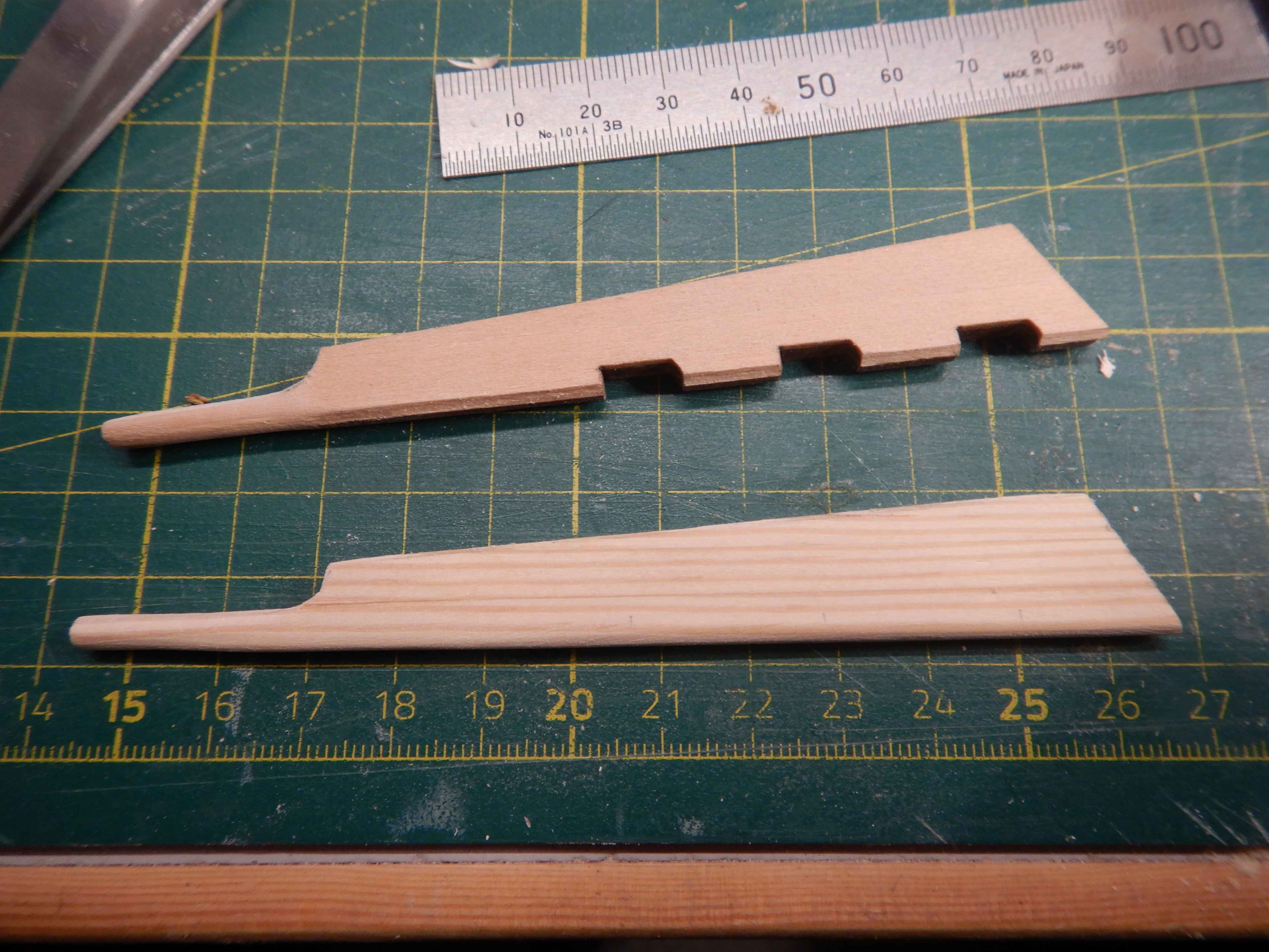

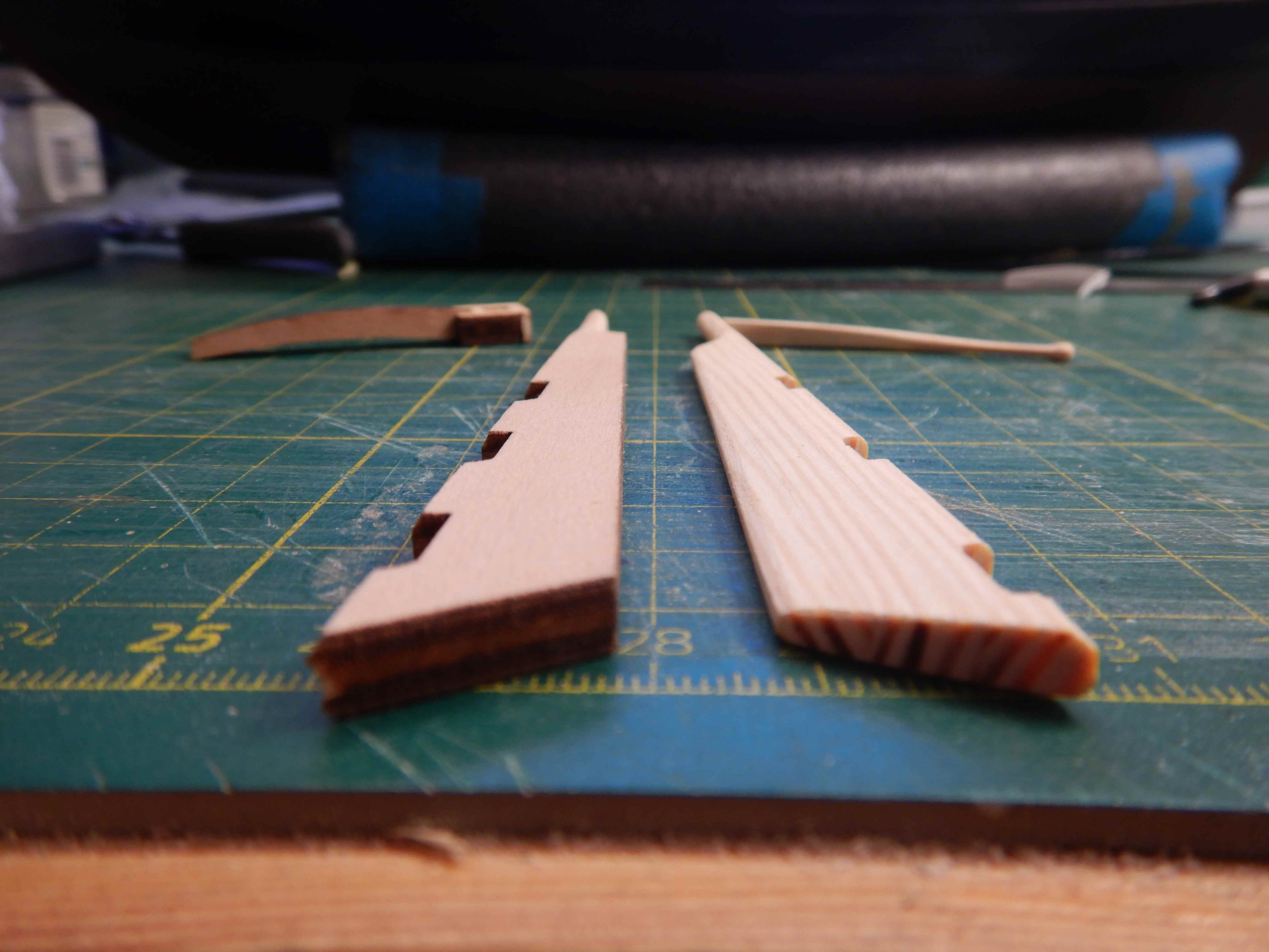

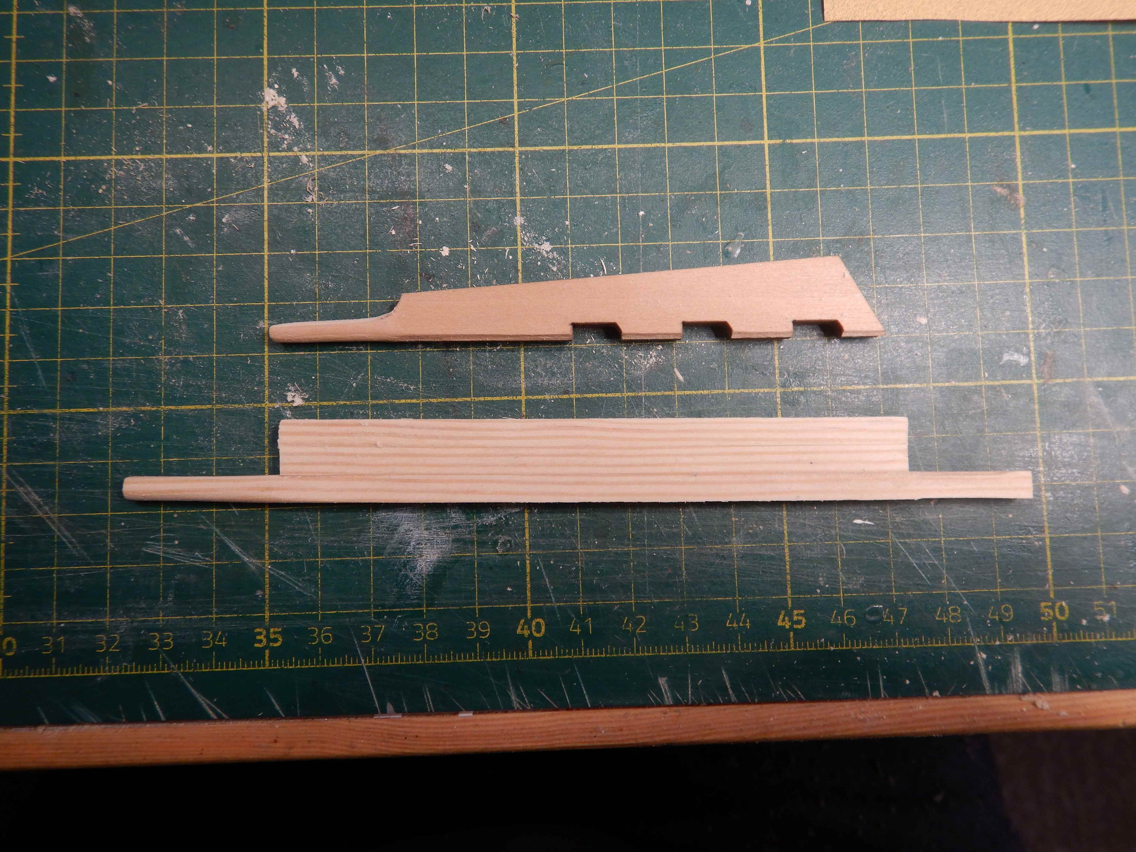

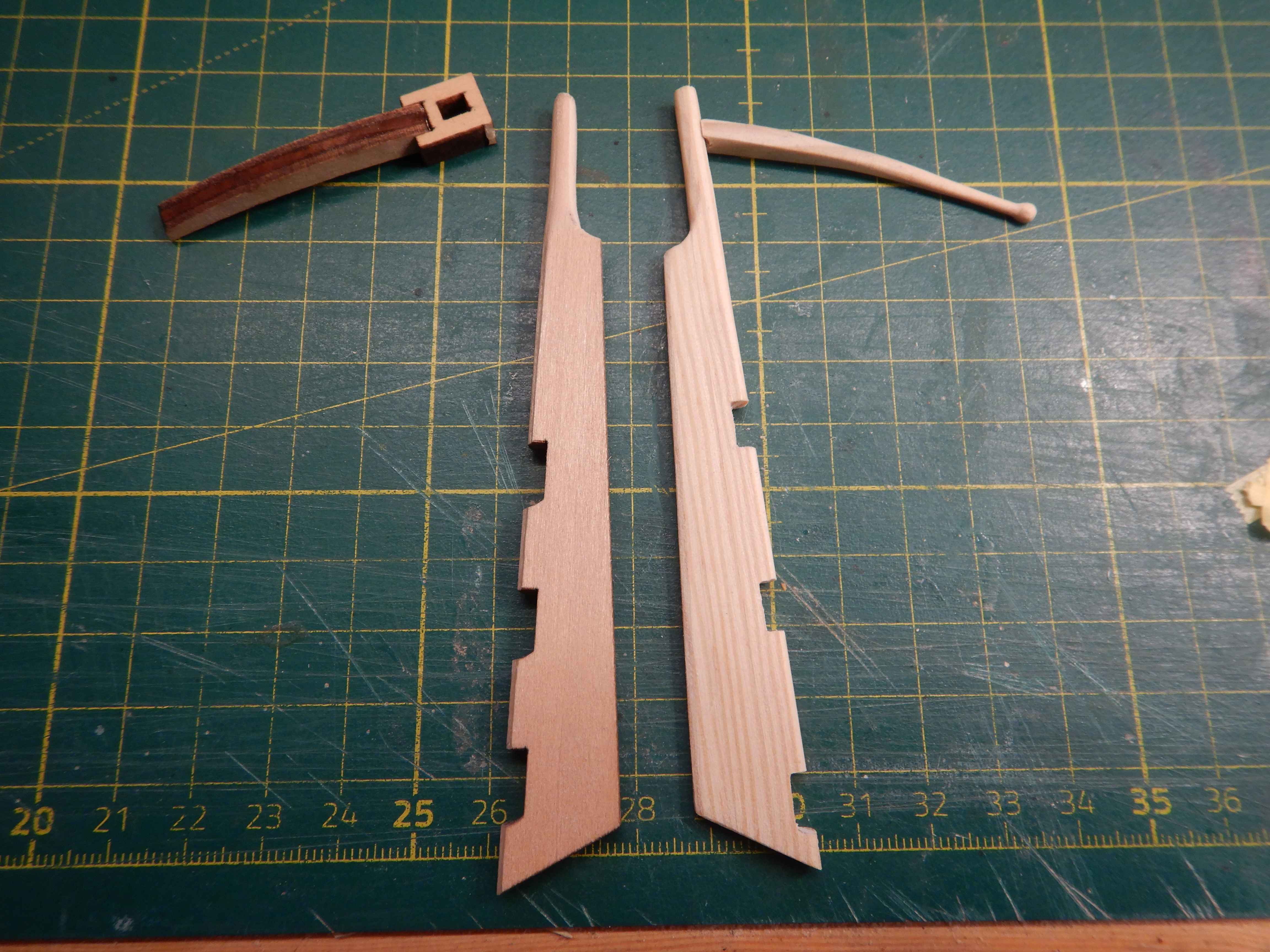

Hello!
Another little update on my Lynx build.

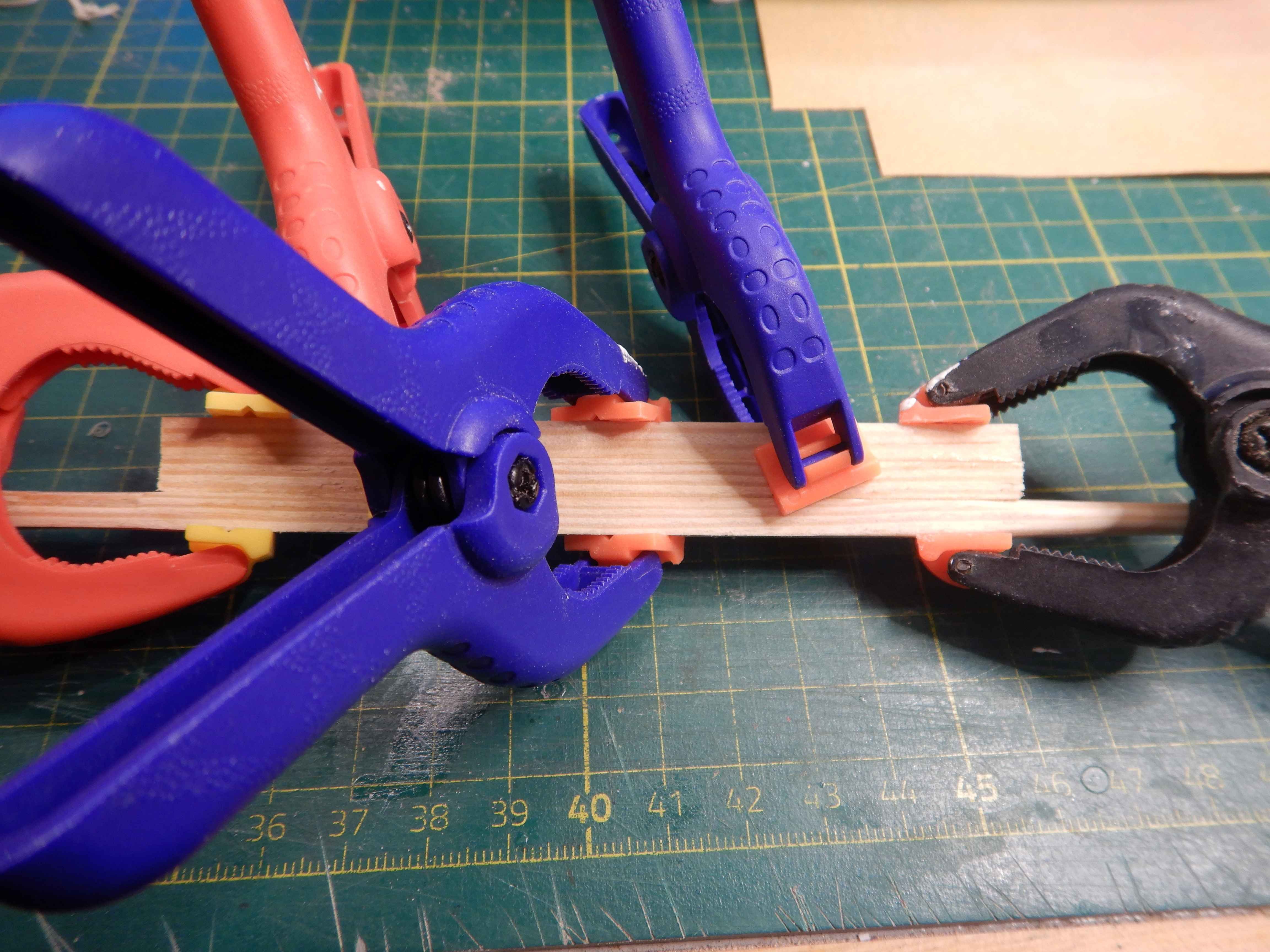

As mentioned in my previous post, I have made the rudder. I didn't like the plywood part, so I made it out of some square 5x5mm stock I had.
I put one piece in the drill and sanded the end that would be the rudder stock round before glueing three pieces together ti get the right width.
I ended up with this...
And after some shaping and sanding it looked like this..
I bent another piece to a slight curve, and made a tiller. Kit parts for comparison.
I also made the cutout for the hinges smaller.

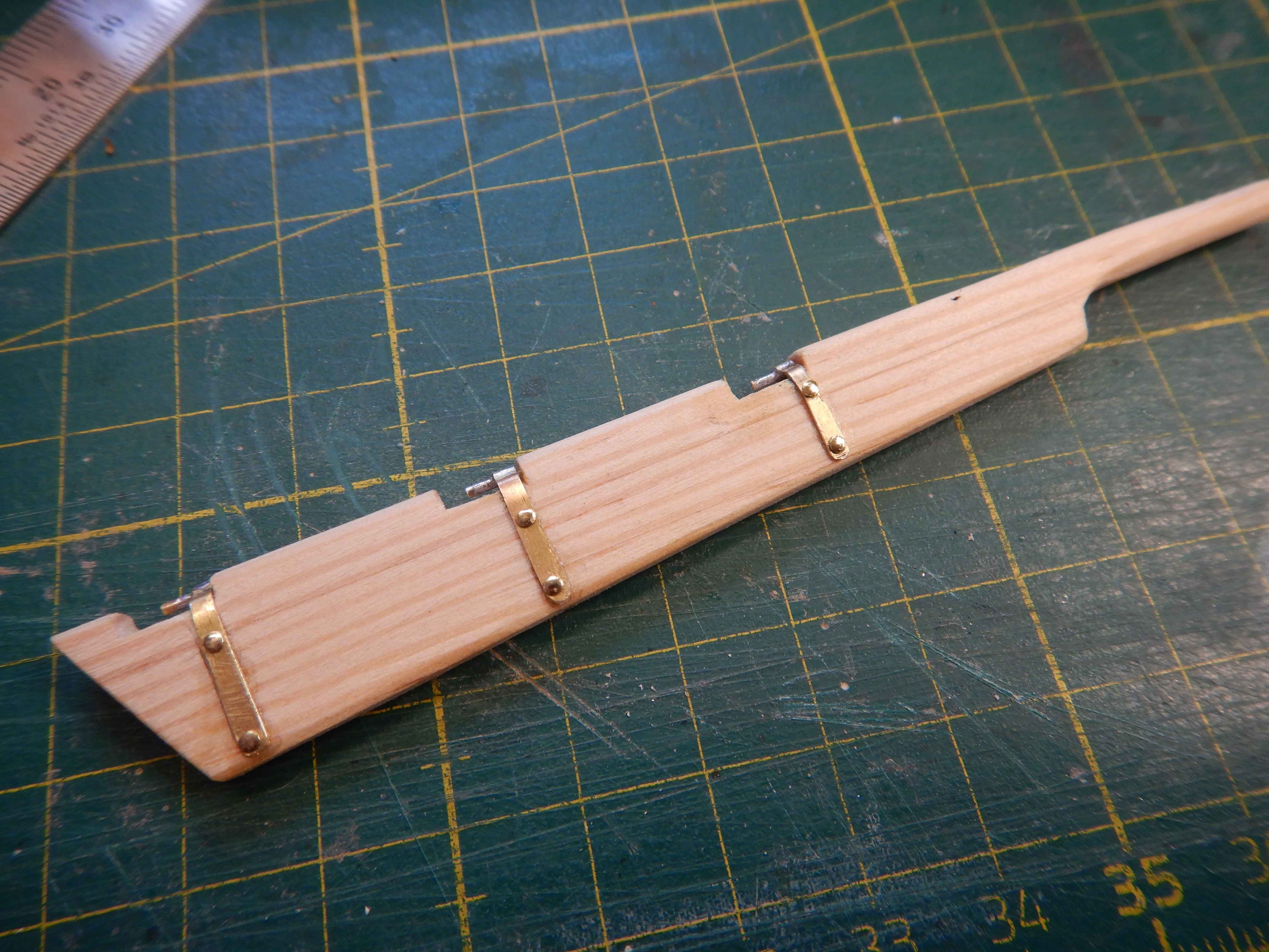

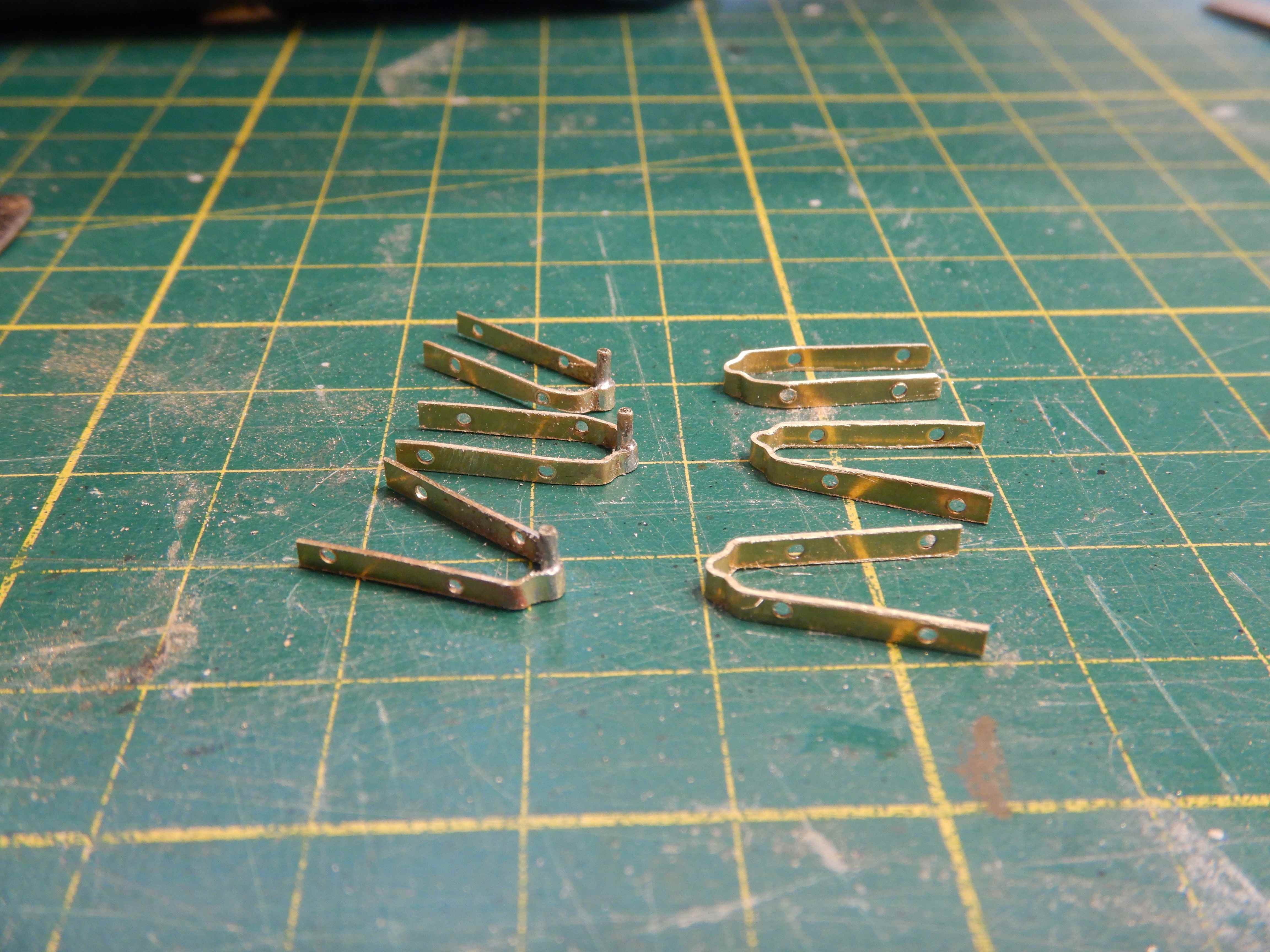

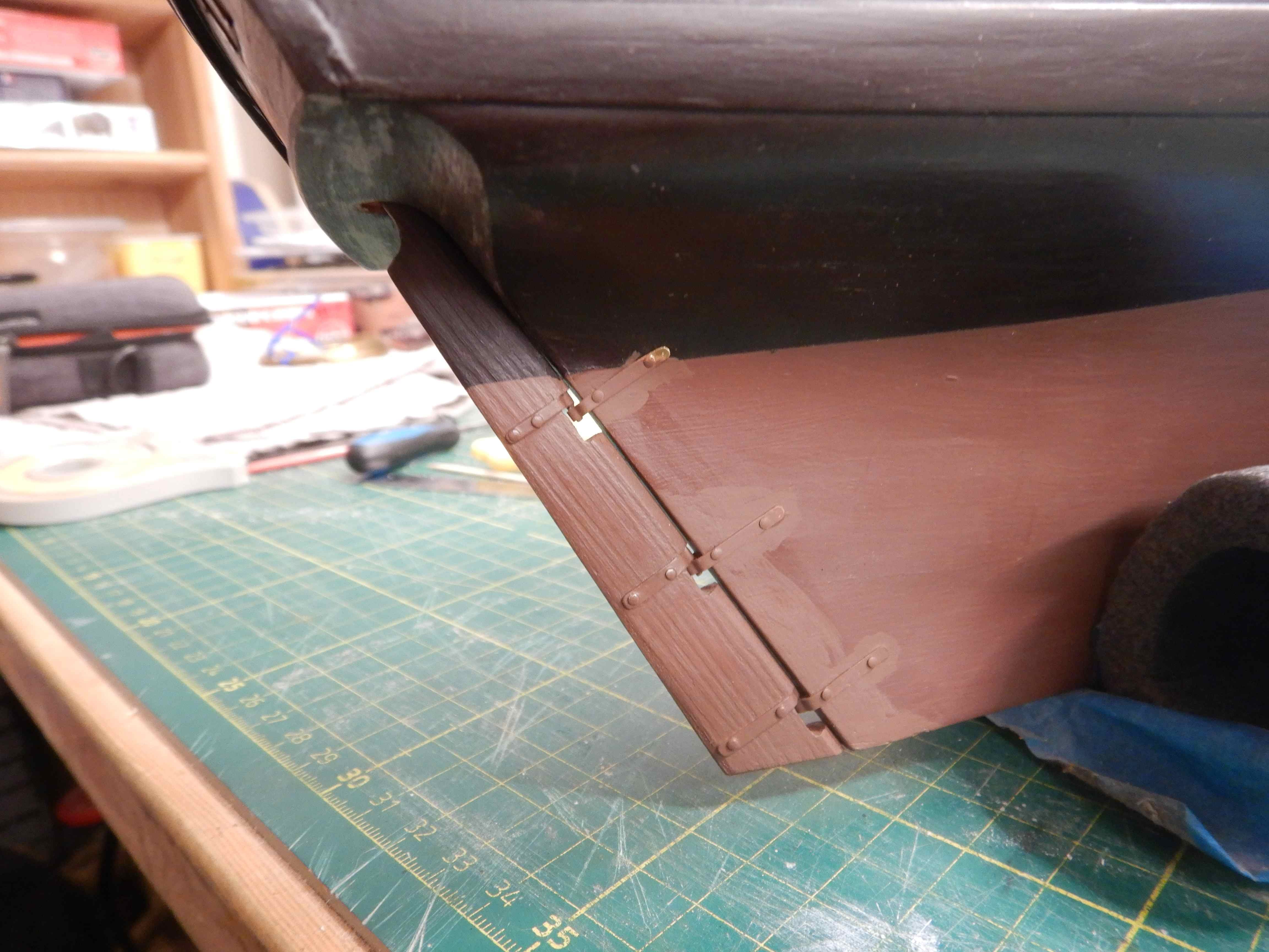

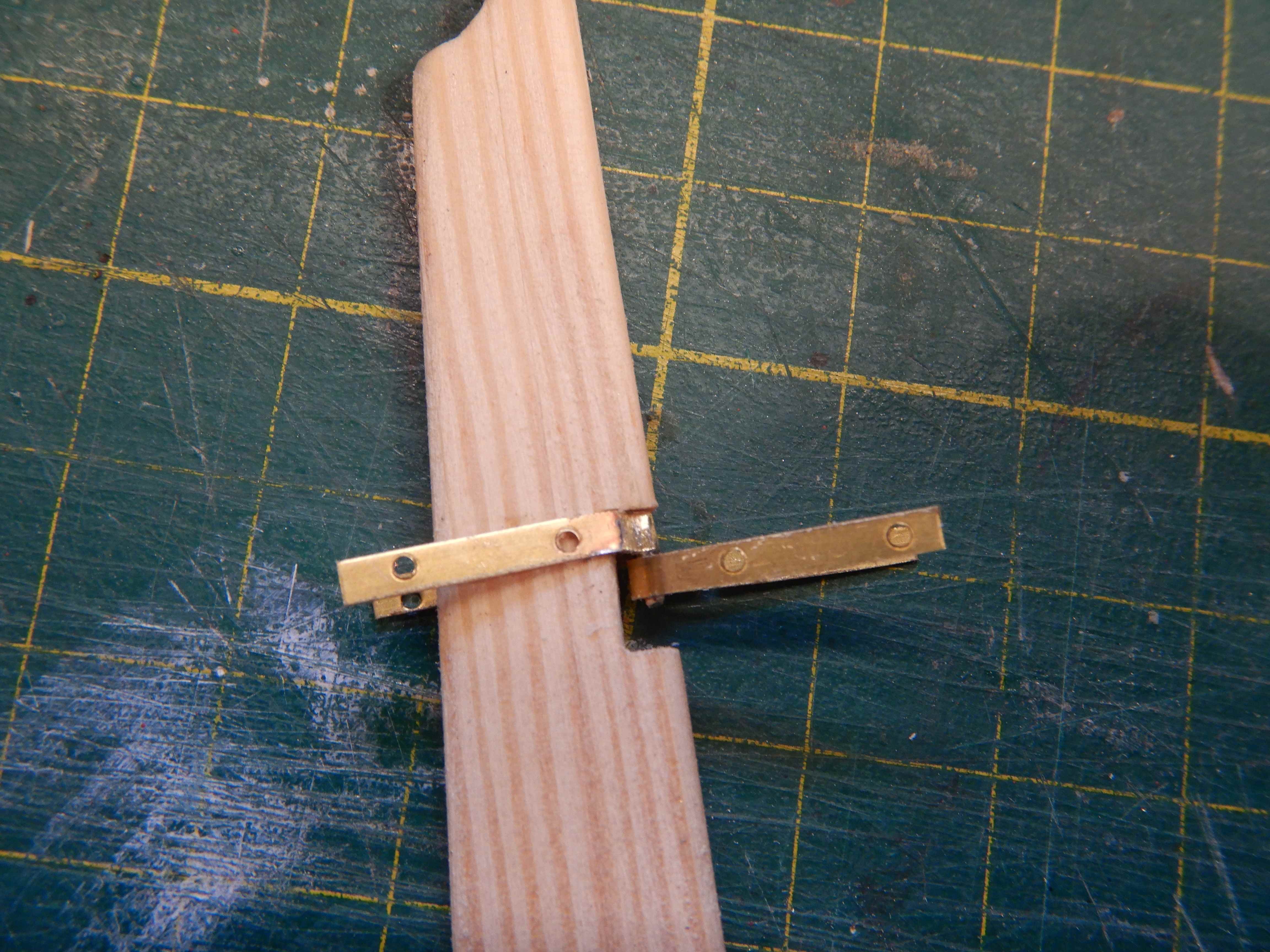

Then it was time to make the hinges. Here I used the kit supplied parts, but I filed the width down to 2 mm as I thougt they looked a little big.
I then soldered on a pin on the half that goes on the rudder.
DSCN3303.thumb.JPG.58a824e9bff0f0217fbfb18af0c53719.JPGDSCN3304.thumb.JPG.ab715526fd391b6361ec77da676b3114.JPG

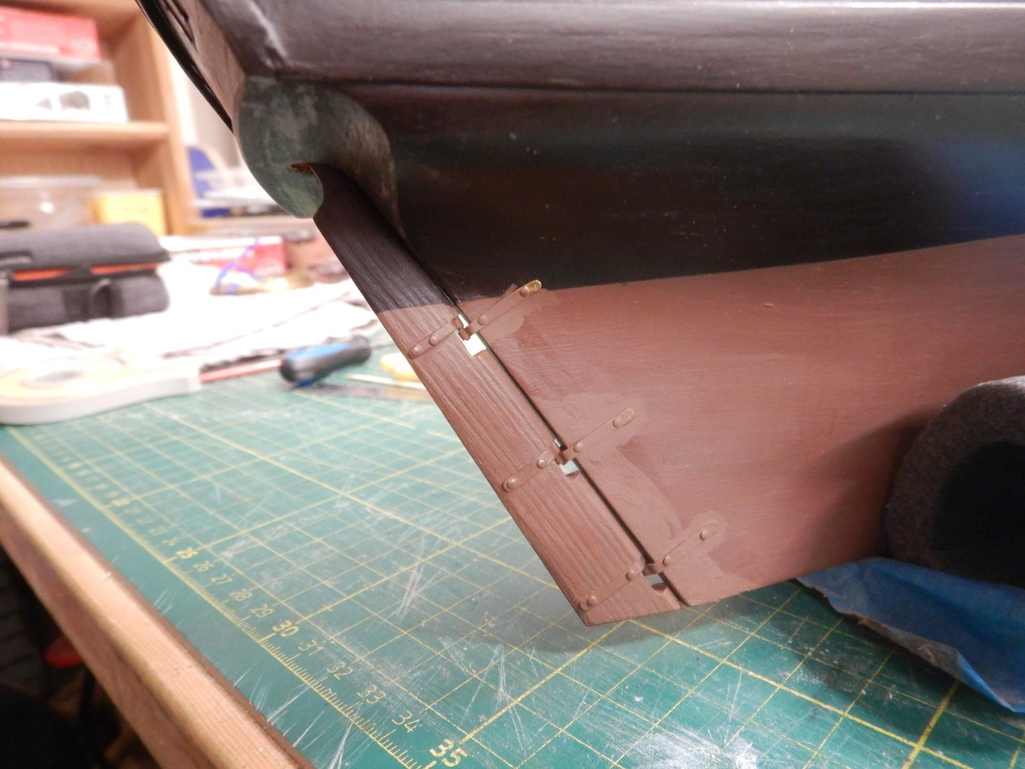

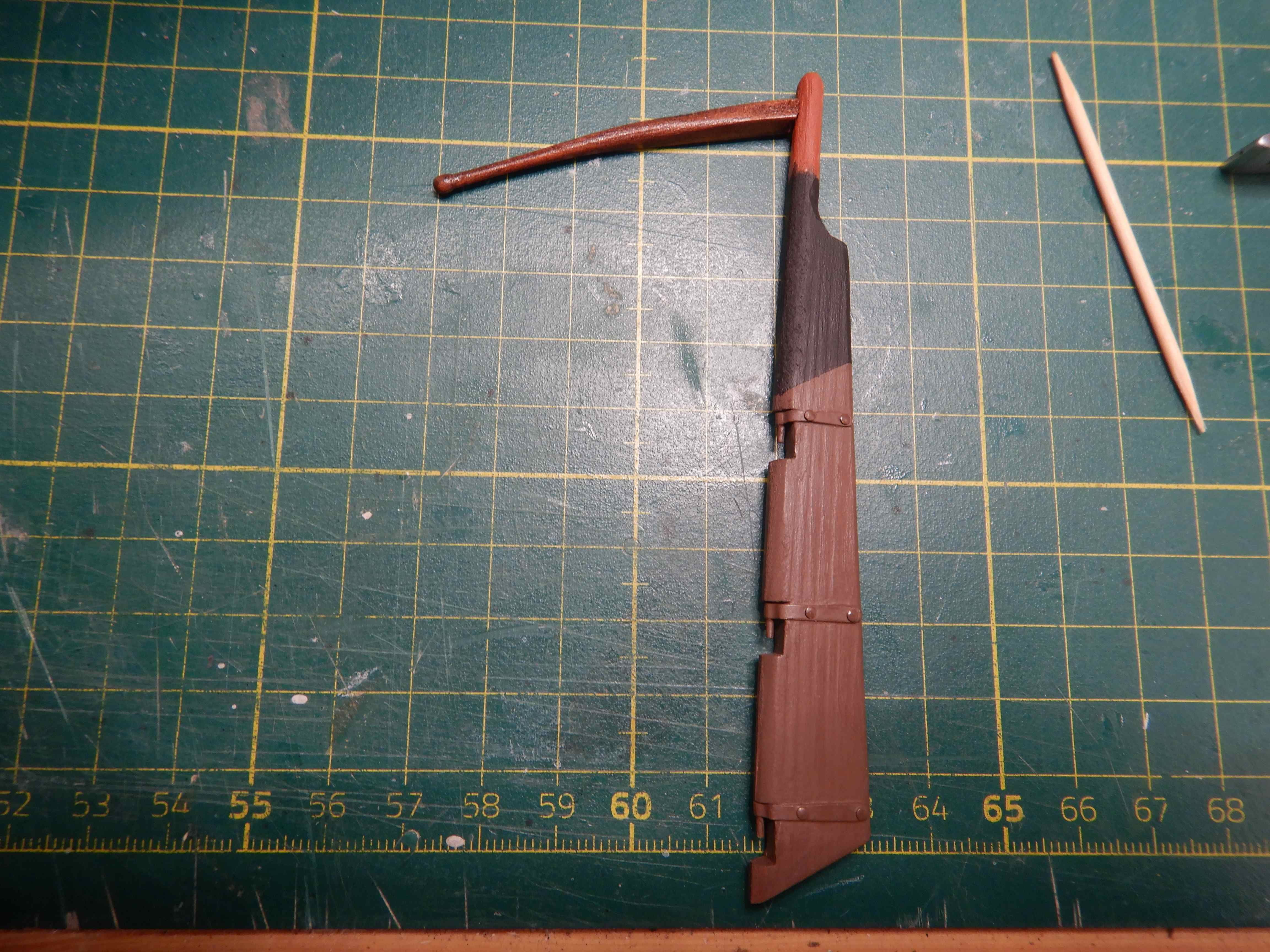

Then they were cut to length, and new holes were drilled. I fixed them to the rudder with CA glue and brass nails.
Then, some paint.. I gave the tiller a coat of mahogany stain and varnish. Not sure if I like it, might paint it..
The tiller will get a metal fitting that goes around the rudder stock, but this will be mounted later.
DSCN3315.thumb.JPG.418935f4768c93ae86a2373b949d525f.JPGDSCN3317.thumb.JPG.52f229a5cfe7dfb98f1514651c2e9289.JPG
I will also make stopper blocks to prevent the rudder unshipping, but I won't mount the rudder permanently just yet..

I love the idea of soldering those pins on! I am stealing that one for sure. It will save a LOT of fiddly work. Very nice.
