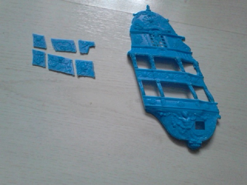

After a little absence, here's an update on the SR. I started working on the kit injection pins (there are a lot) at a meeting of the modelism club I'm in and tonight I started cutting the panels of one of the quarter galleries using a xacto knife (didn't cut myself yet). I think I can use that for the 3rd battery gunport to correct their angle without having to use another part.
This weekend, I worked essentially on the quarter gallery (part 17), opening it. It wasn't so hard and I didn't cut myself yet.

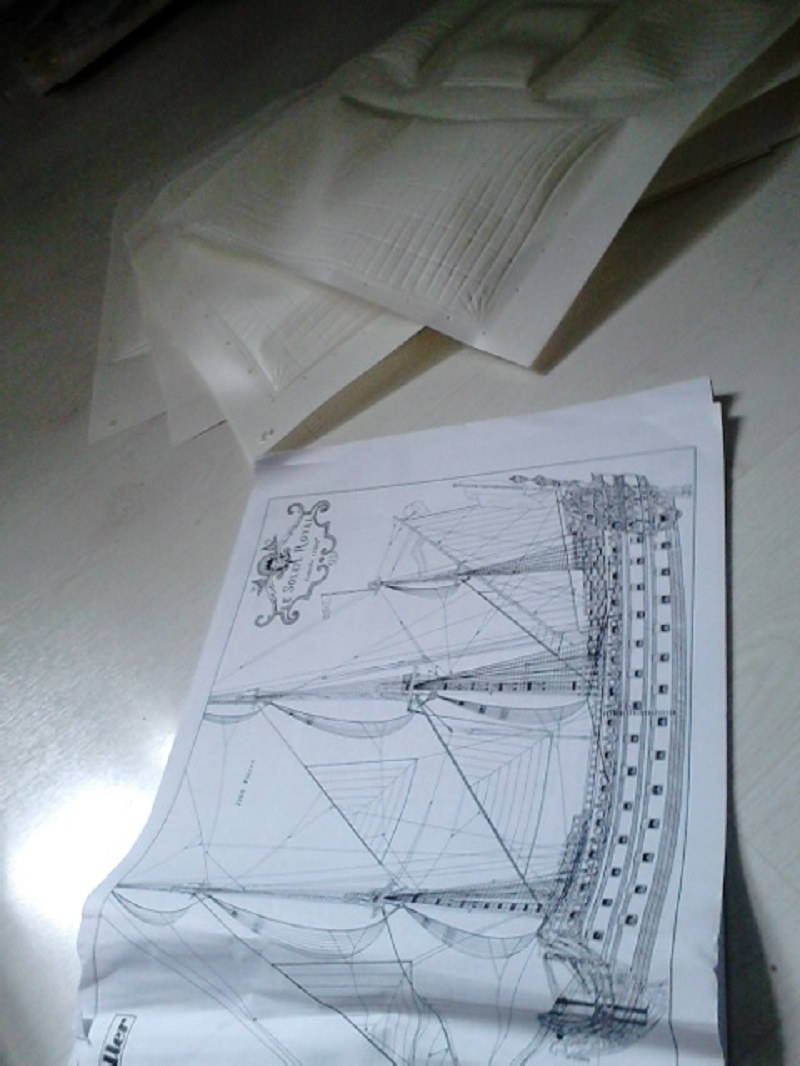

Yesterday, I started making plans o the stern façade. Both will be rough schemes. One showing the original heller part, the other the modifyed part. I started opening the 2nd quarter gallery too while watching the french show "c'est pas sorcier" on the belem

I did the rough scheme of the heller stern façade yesterday and opened all the panels of the second quarter gallery while watching "c'est pas sorcier" on the french ship of the line. This episode showed the hermione under construction(slight audio issue on sabine parts for some reason, but not jamy)

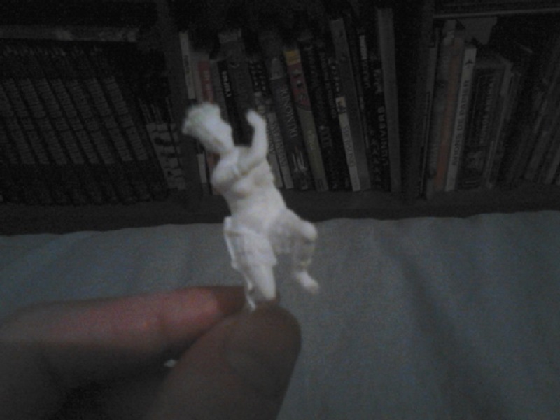

A bit of news, I'll go back to the gun cariages tomerow. I started working on the america/africa figures provided by heller. I had to remove the molding lines using a knife and sand paper and I glued both figures arms. Had to use pics from tanneron soleil royal and a soleil royal someone from my modelist club did.
