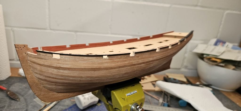

The second planking is now finished. It took rather long due to being a bit fiddly (and my sometimes lacking motivation).
The outcome is unfortunately to my liking. Unfortunately, because I intended to paint the lower hull with an off-white paint. Now with the quite acceptable planking I’m having second thoughts about covering my woodwork…
Next the wales and different wooden strips will be placed ‘from inside to outside’. The height of the bulwark was set somewhat by eyeballing and is now too high. I will install the deck, mark the height of the bulwark on the inside, sand it down and measure the position of wales and decorative strips on the outside from the top down. Nex time I build this kit I will take care to correct the upper edge of the first planking to the correct height above deck BEFORE starting the second layer!

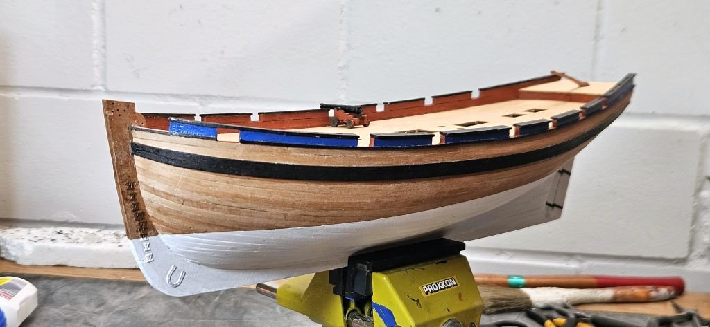

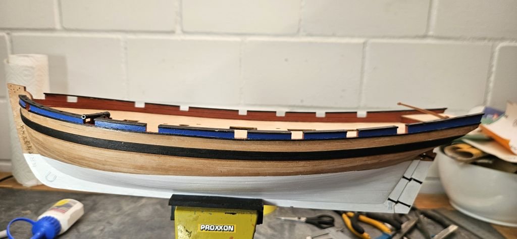

Now the strips marking the sheer rails and finally the main wales were glued on in the appropriate height.
For better definition of the colour, I tried to paint all parts as far as possible before glueing on. This is helpful when installing the inner bulwark planking but worked as well on the wales.

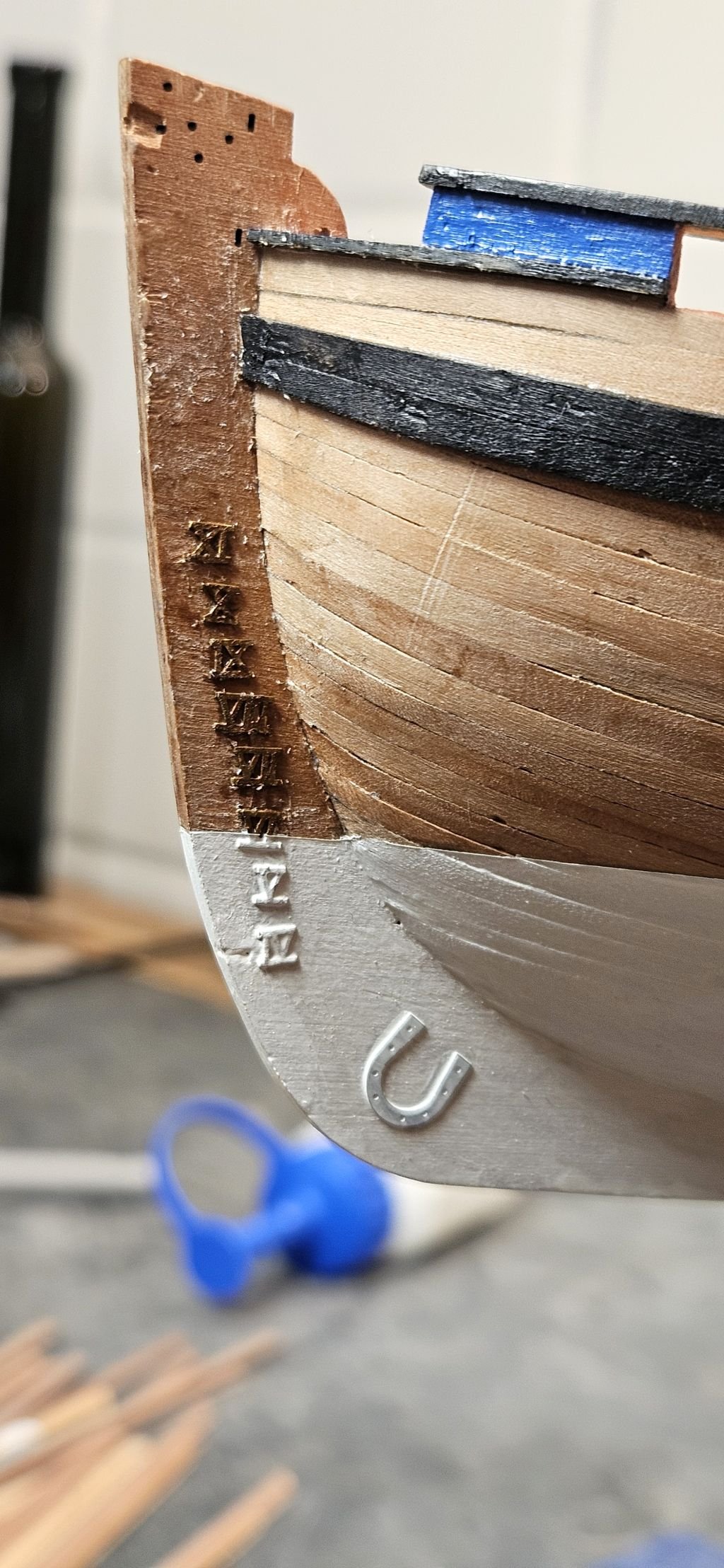

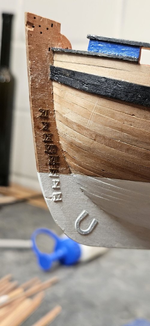

Now I did place the draught marks and  horseshoe and fish plates on the keel.

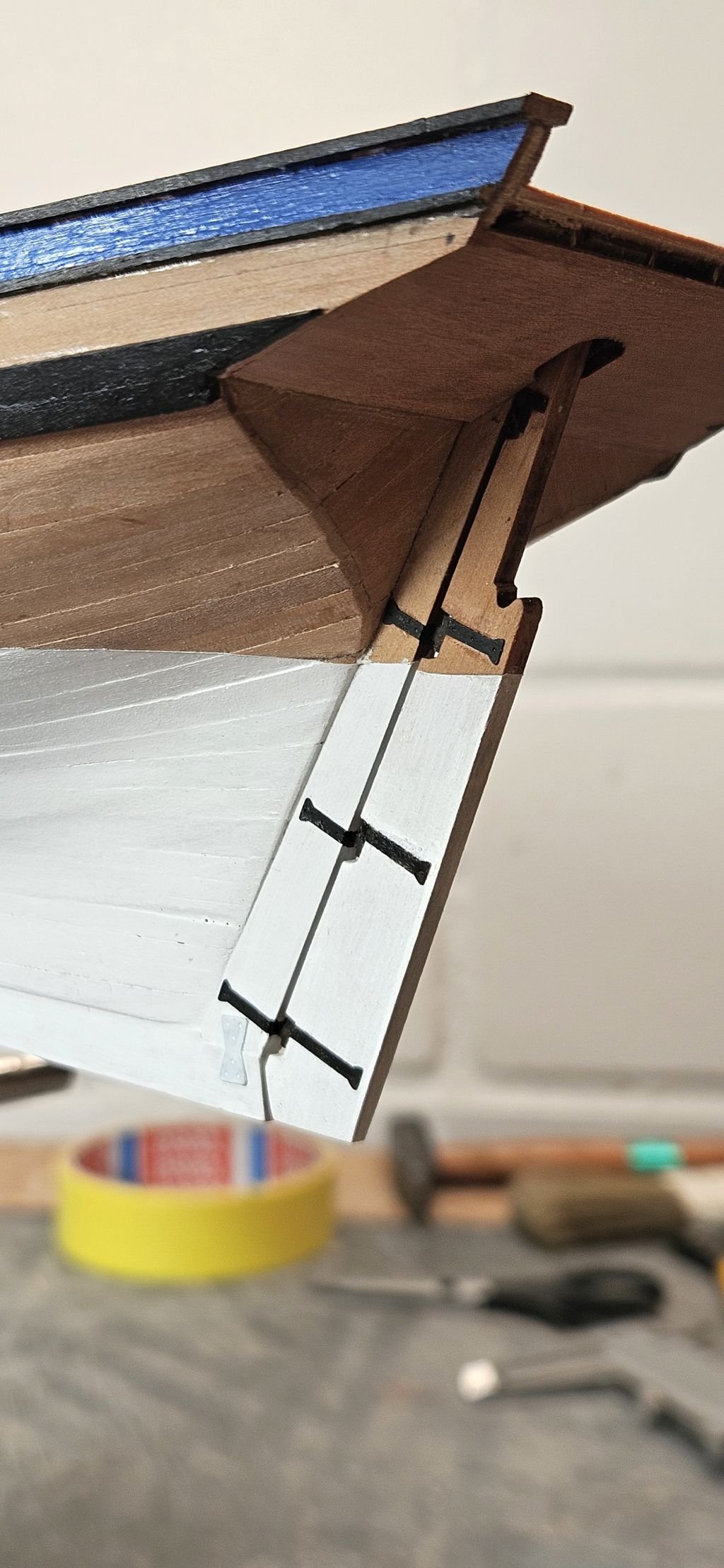

With a mixture of whitewash, dull white and about 5% dull black I painted the lower hull and the lower part of the rudder. The rudder fittings were blackened and glued onto rudder and hull. The rudder is only provisionally fixed.
I deliberately painted over the keel plates and the lower drought marks as I consider them part of the construction and they may benefit from the protective cover with white lead paint. On the other hand, I left the rudder gear blank as it is part of a mechanical device which should move freely and may need to be occasionally checked for wear and tear.

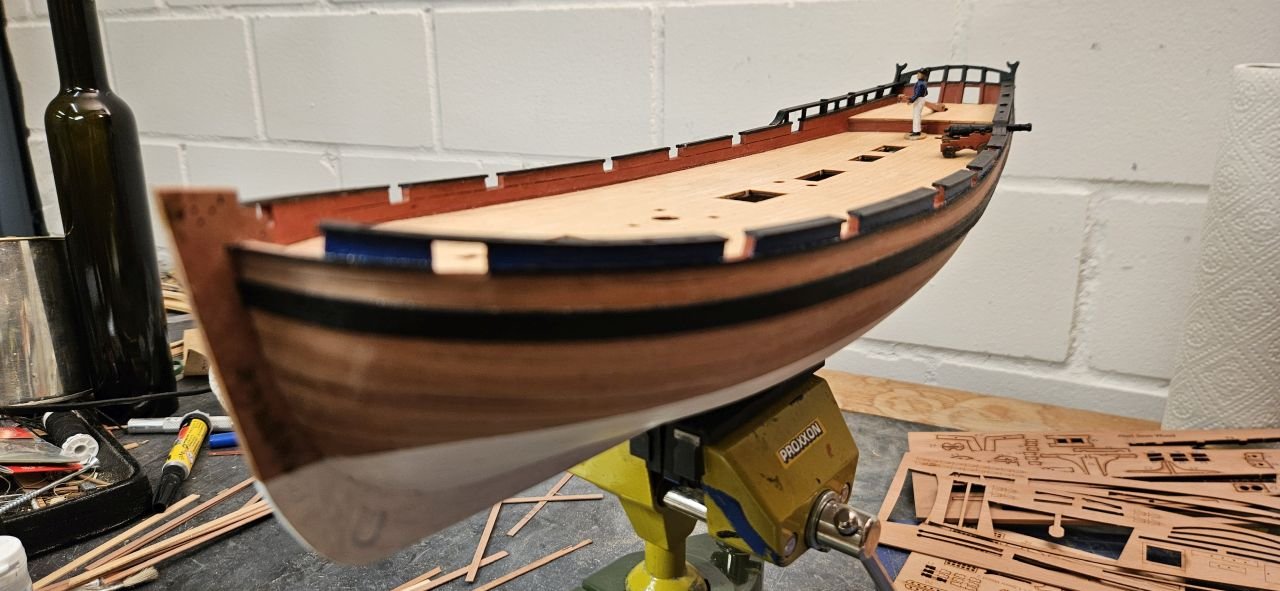

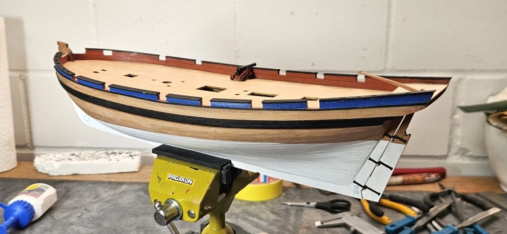

Trimming the rails
20250617_212744.jpg.d1720cd81c66e4cb8c6570dc237f1225.jpg20250617_224821.jpg.0f72ec4b196c40077b211287125e5717.jpg

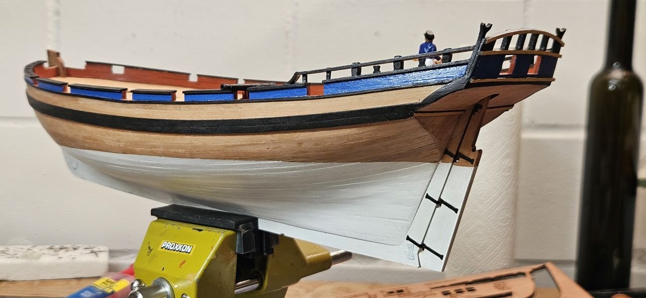

Hull almost finished
rudder
Seems one of the carpenters was a bit careless with his axe

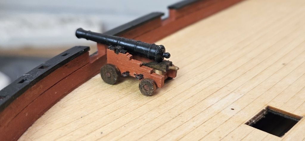

6 pounder gun
looking elegant

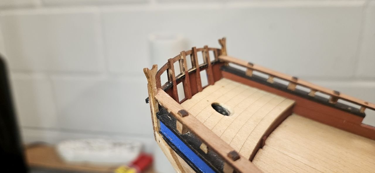

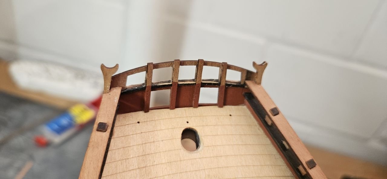

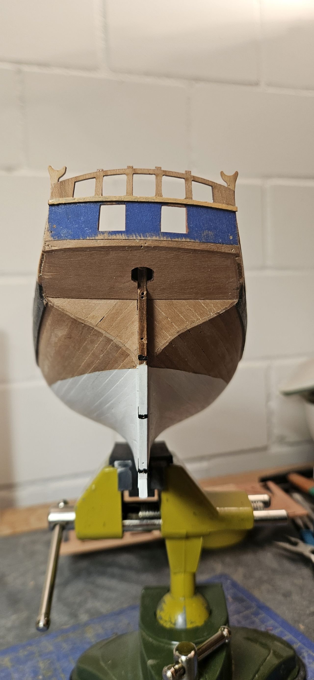

Building the stern really was a puzzle. More than once, I was properly puzzled how to make the parts fit while trying to adhere to the kit’s manual and Peter Goodwin’s book.
The kit’s upper transom part leaves an open space at the lower end when properly brought to the height of the platform deck. Others had the same problem before – so it seems that not only unprecise building on my part is the problem here. A sidewise bent 1 x 3mm strip was glued on below the lower end of part 49 and adjusted.
Next problem was the side counter timber which is one massive timber on the prototype, including the boom cradles on top, but here consist of several parts (part 76 and the outer edges of part 49 and somehow the parts 75). After due consideration I didn’t fix the cradles on the side of the transom but glued it onto its forward side, trying to create the impression of one continuous counter timber.
Above the stern chase ports should be a rail, the upper counter rail. To simulate it I added a 1mm x 1mm strip on the inside on the same height as part 52 on the outside to create the impression of a 3mm wide rail.
Building up the rough tree rails needed a lot of adjustments but was more or less straightforward.
One still open question is the painting of the counter. Goodwin shows it in black while the kit’s manual leaves it open. To leave it in wood and varnish would still be an option, especially as I don’t intend to add the decorations. They would certainly look nice but also a little bit pretentious for a mere cutter. The blue colour band in itself is probably already rather more than an ordinary cutter would get from the admiralty.
Additional strip below the transom

Building up the upper counter rail
Approximation of the side counter timber

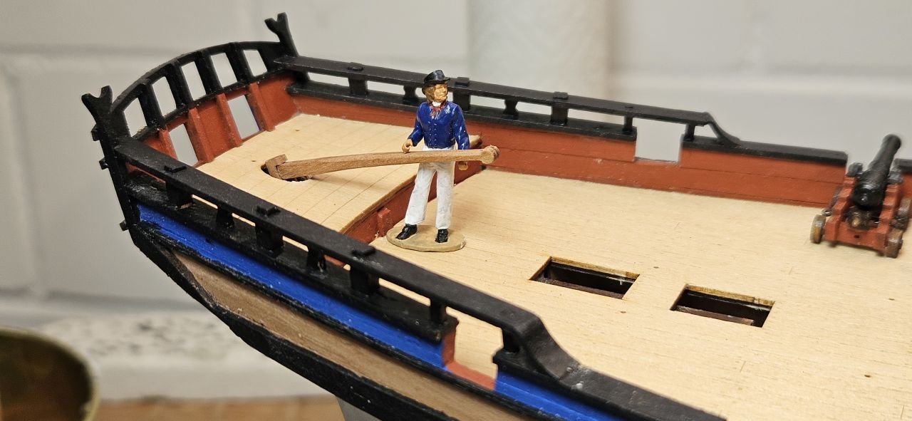

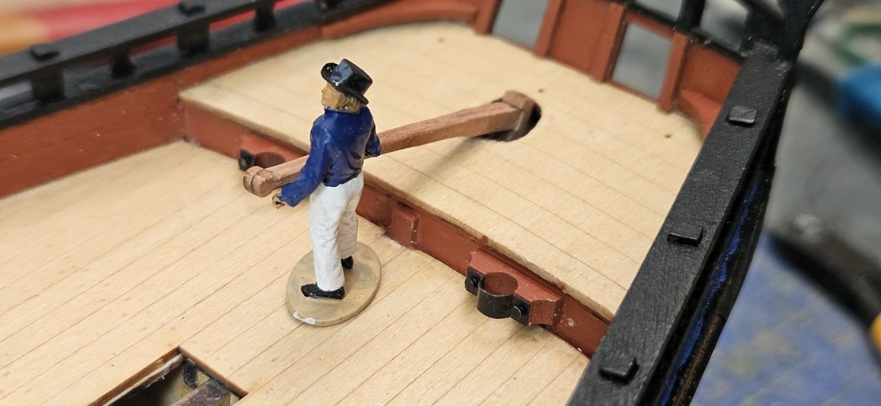

All painted and testing the tiller – so far, so good

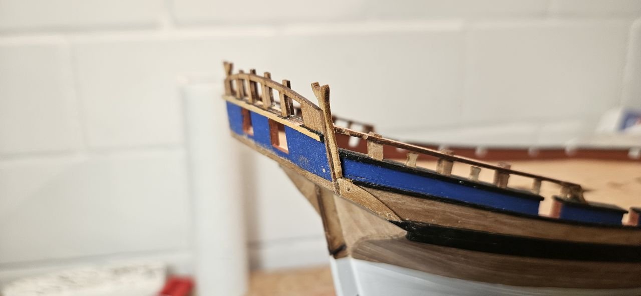

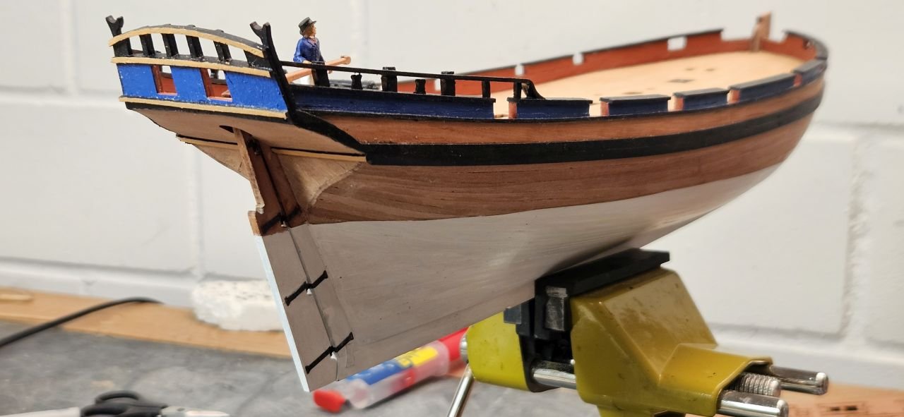

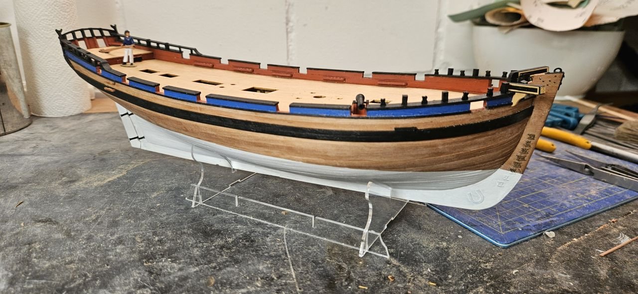

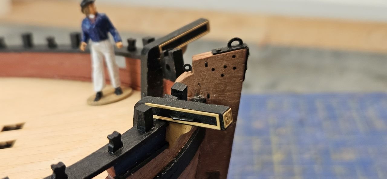

The next bit was finishing the bow. Sometime during that process, I decided to leave the stem in natural wood instead of painting it black. It is simpler and with the equally natural stern post it looks symmetrical and pleases me.
The rest was pretty straightforward according to the instructions.

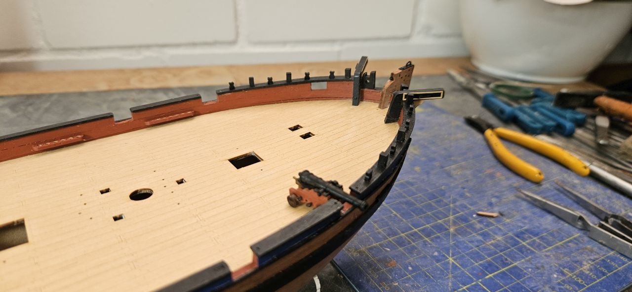

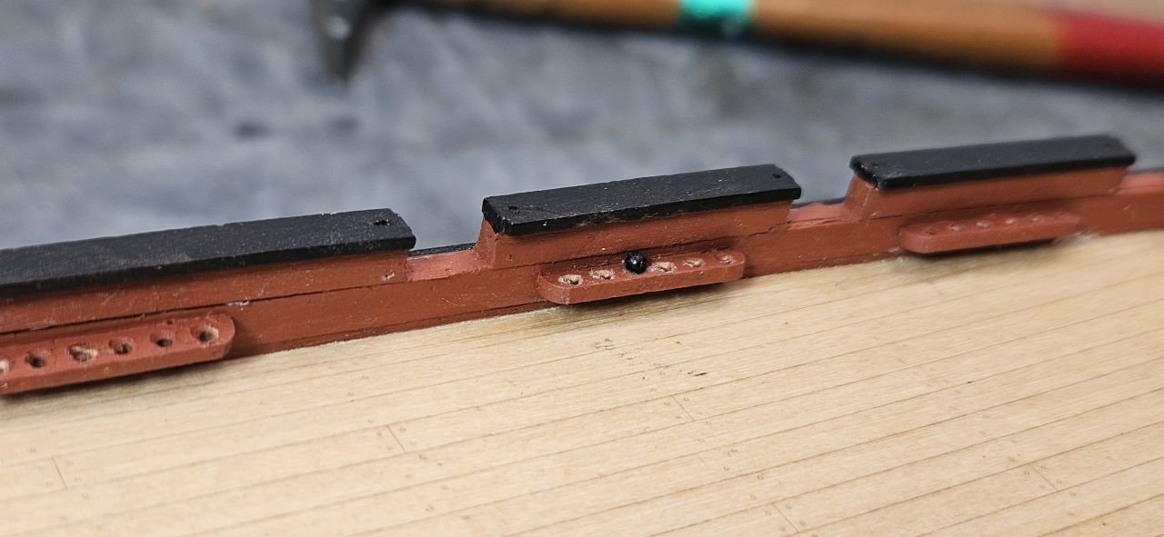

The shot racks are installed as well, as are the entry steps. The openings in the shot racks were opened up a bit on top to give a better support to the shots in rough sea.
the mizzen mast steps are in place as well

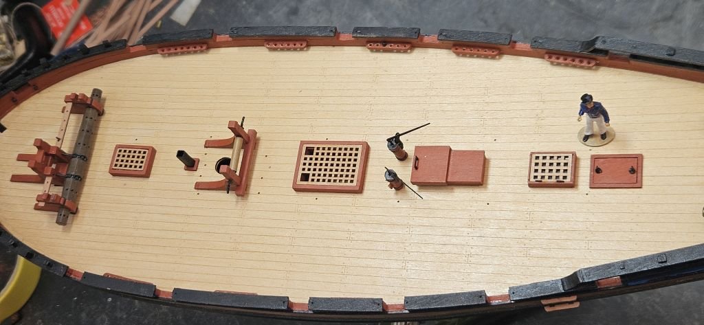

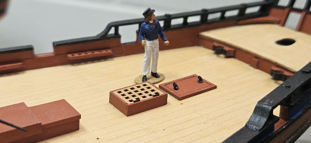

The next step was installing the various deck fittings.

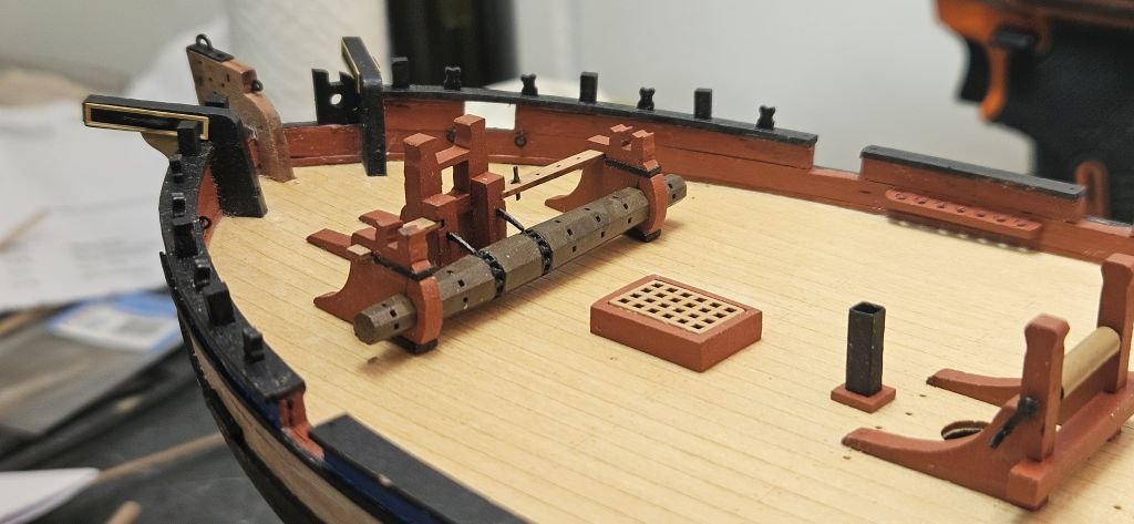

First was the main winch and bitt assembly which worked well
Then came the forward companionway which presented the first problem. The parts of the coaming didn’t fit the grating and had to be shortened/adapted. Speaking of the grating: those wooden, laser cut gratings which come with the second edition of the kit are superb.
The jeer bitts assembly went like a dream while the main hatch did ask for minor adjustments.

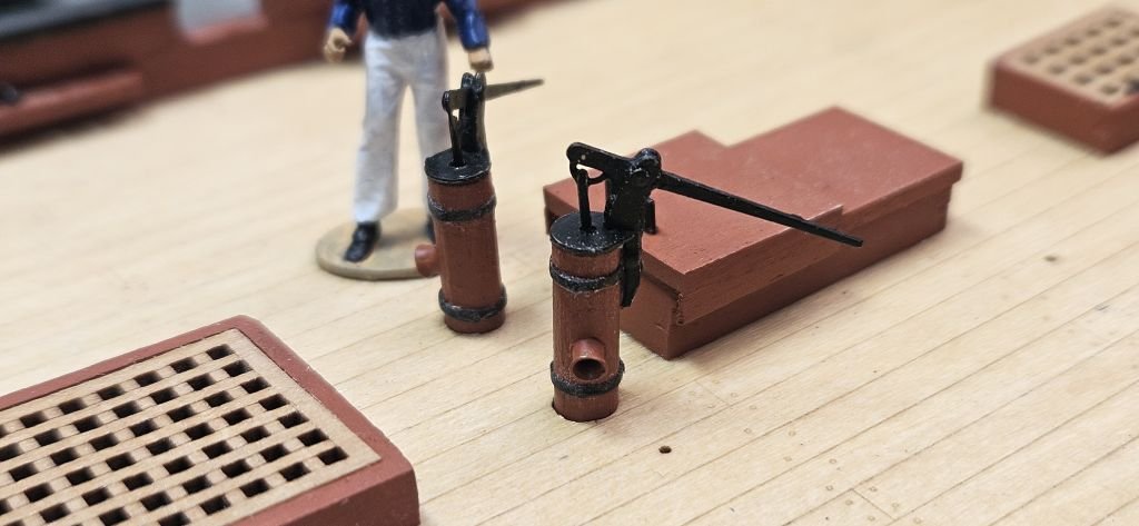

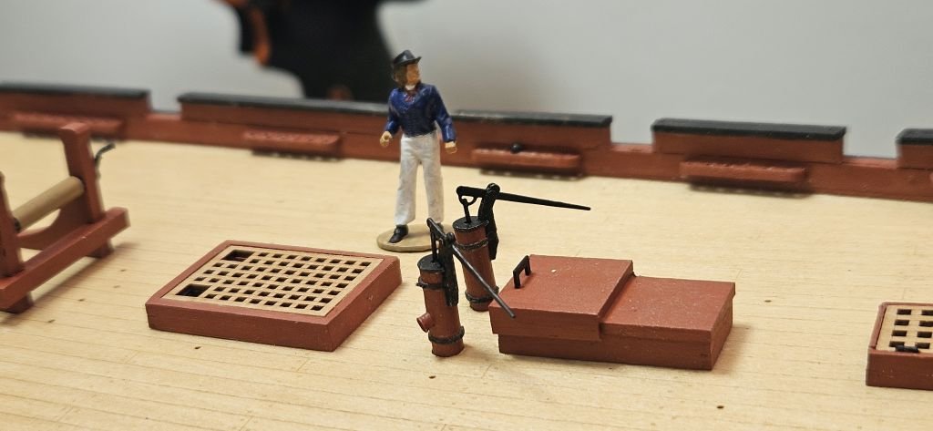

The pumps got a small upgrade with iron hoops made of cartridge paper and discharge ports made of reworked cable-end sleeves.
The aft companionway was a bit changed to imitate the sliding runners.

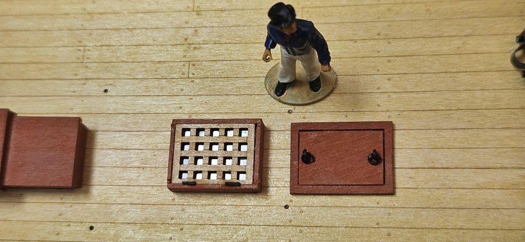

The coaming of the skylight was completely changed to let the grating into the coaming. That grating was also filed thinner to make room for a ‘glass’ pane underneath. Two short pieces of wire imitate the hinges.
The bread hatch assembly was then straightforward again.

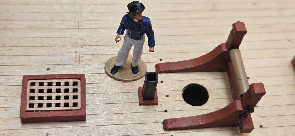

Finally, the stove flue was taken in hand. Fortunately, I was initially unable to locate the flue (part 108 - found it later). With some stripes of cartridge paper, I folded and glued a square tube (or to be precise, about 5 of them until I had an acceptable result), painted it black and glued it into its base.

main winch
forward hatch, stove flue and jeer bitts
pumps and aft companionway

skylight and bread hatch
