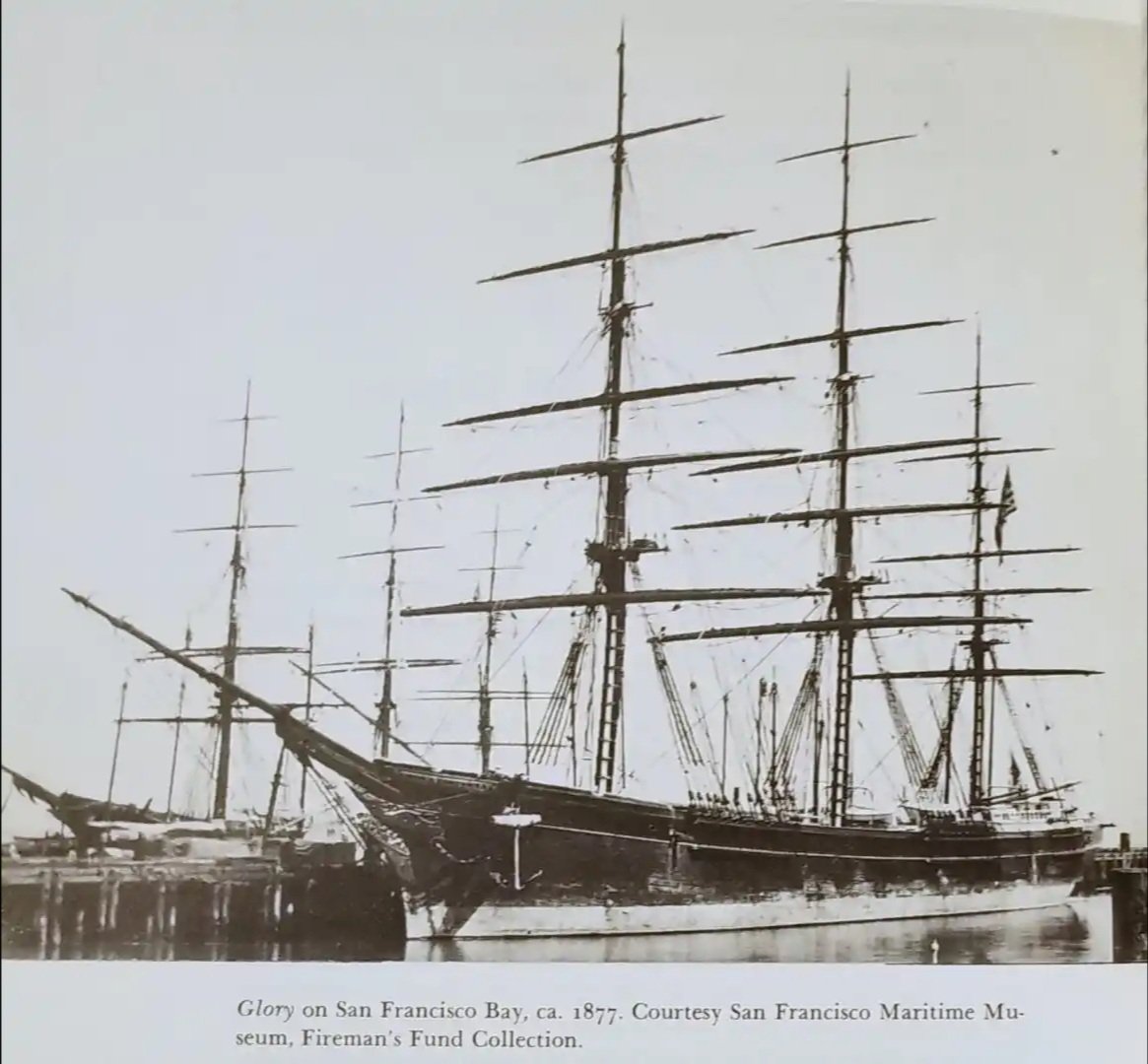

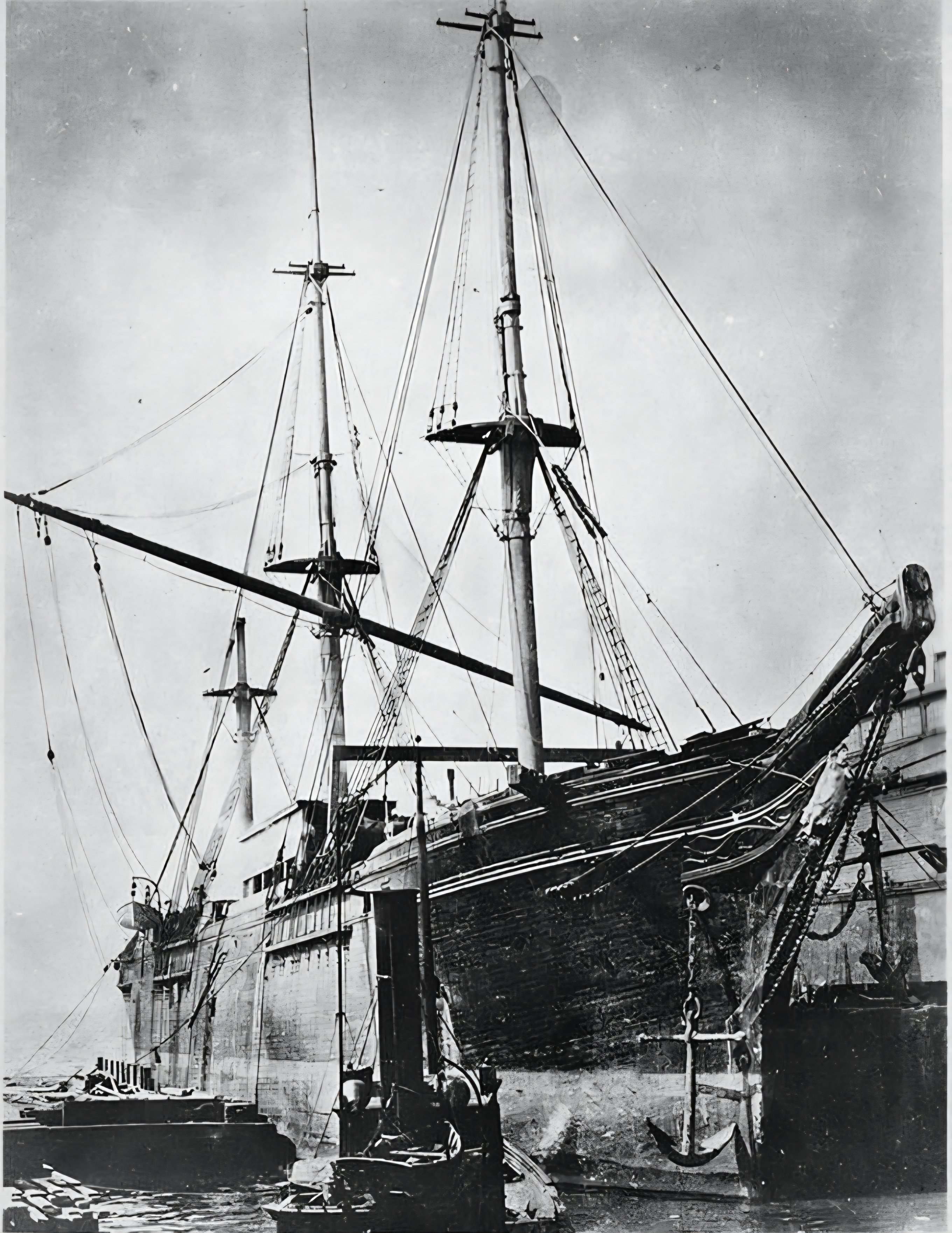

@Kenchington probably the best evidence we have been able to reliably evaluate is a treasure trove of Glory of the Seas historic images. Author Michael Mjelde quite generously shared many rare and in some cases never seen before images of her. Included were multiple views of her complex bow structure. Elements Rob and I interpret to be navel (not naval) hoods are very tight configured devices which are literally an extension of the upper hull. They gracefully twist from a "V" configuration to gradually arrive at a vertical curving point. Contrary to more decorative moldings on other clipper bowed ships and barques, these are three times as big and offer a substantial perch for the large bowsprit-jibboom spars installed just above. Both @rwiederrich and @Vladimir_Wairoa build logs feature many of these crystal clear images. In fact, true to Duncan McLean's evaluation of the unique toughness of these structures, clipper Glory of the Seas survived a collision when a steam ship accidentally backed into her bow. The only damage she sustained was a cracked upper starboard rail and loss of some cutwater carvings. In his description of the bow construct on Flying Cloud McLean stated that the ship would remain seaworthy even with loss of her cutwater.
Personally, I find it quite disheartening to find such opposition to our discovery.  Modelers who profess to seek the highest level of accuracy...shy away from clear evidence.  I'm amazed, I was expecting more enthusiasm.  I've been researching and building scratch clippers for over 50 years and nothing so evident and clear would ever be dismissed because of, *I Just couldn't see it*.  If you've studied Mckay's practices and his attentions...it is clear he was onto something, no other builder partook of.
As far as I'm concerned, my Staghound, (as it has been replicated on Glory of the Seas), representation will include this *navel Hood*, as we have discovered.  And I will continue to gracefully point out this omission/error misrepresented on, so many models.   I'm that passionate about it.  Smooth sailing friends.
Rob
  New discoveries are often resisted when presented.  Examples: Sea fossil evidence found in the 19th century on mountain tops indicated that the Earth is vastly older than the approximately 4,000 years suggested by the Bible;  Darwin & Wallace described Natural Selection as the mechanism of Speciation (still stubbornly rejected by some even today - there is a 'full size' Noah's Ark in Kentucky where humans cohabitate with dinosaurs);  Hubble's discovery in the 1920s that there were other distant galaxies - and not 'spiral nebulae' close to us in a 'small' universe;  Continental drift due to plate tectonics;  that a meteor triggered a mass extinction 60 million years ago that finished-off the dinosaurs ...   So it has been throughout history (ever read Carl Sagan's 'The Demon Haunted World'?).  Don't be surprised or disheartened, mate - for your research is appreciated by more than a few among us.

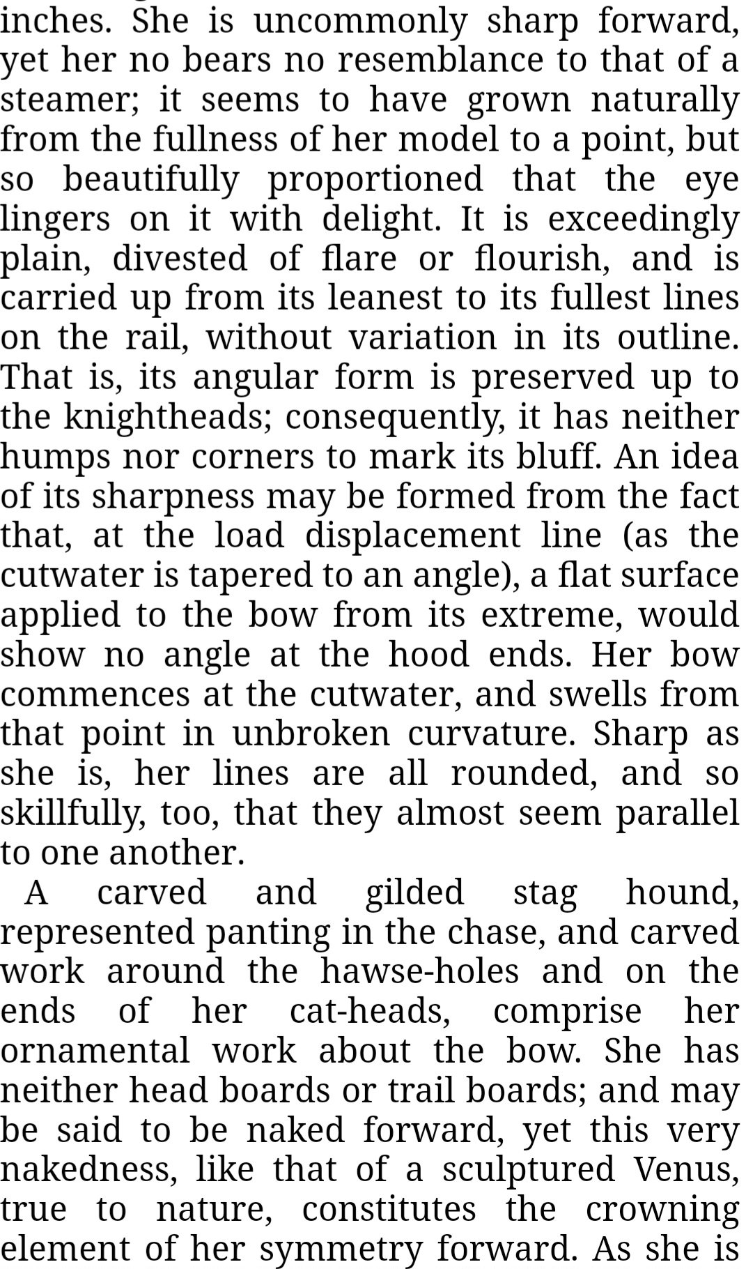

@sob Scott, that particular quote is mine, as I attempted to help others envision the complex nature of those nautical devices which can be clearly seen in Glory of the Seas photos. Instead what I'll do is share excerpts from the two ships where McLean described the bow arrangement. I apologize in advance if this is material you've already read but I'm also sharing it for others who may not be as familiar with these passages. I'll start with Stag Hound and then proceed to Flying Cloud. After these two, McLean doesn't repeat a description of this bow again. However, based on his sailor's observation of how durable this new design was, we see no reason why McKay would just abandon it. One trait I've noticed in McLean's works, typical I suspect of a fellow Scottsman, is his no nonsense approach to describing these vessels. He doesn't waste much time on carvings or embellishments. So when he describes Stag Hound as a model which may be said to be the original of a new idea in naval architecture, that's saying something. He repeats this assertion near the end of his evaluation. In his description of the McKay bow, he briefly mentions hood ends. Blink and you'll miss it. If you're familiar with the Cornelius McKay hull model you'll see that Stag Hound had a near vertical bow. Yet McLean describes a gracefully curving cutwater which projects beyond the bow. McLean refers to this structure not just as cutwater but her bow too. This is where the genius of the navel hood design joins both stem and cutwater into a powerful prow capable of smashing into the toughest seas on earth. A singular cutwater would be too vulnerable alone. McLean's greater description occurs with Flying Cloud. Here's where he first uses the term navel hood to describe these nautical constructs. However one wants to interpret these navel hoods, they were large enough to accommodate carved work which precludes a simple molded piece like we see on Great Admiral. McLean also states that these vessels had neither head nor trail boards, ruling them out. Further on he makes his most insightful evaluation of the clever ruggedness of this unique bow when he observes that even loss of her cutwater wouldn't affect her seaworthiness. That is saying something. Screenshot_20250430_182030_Chrome.thumb.jpg.3dd777dde3a3934dbbad56c320cecb29.jpgScreenshot_20250430_183404_Chrome.thumb.jpg.0b63539b24bcf3567f8acf2de38efce9.jpg

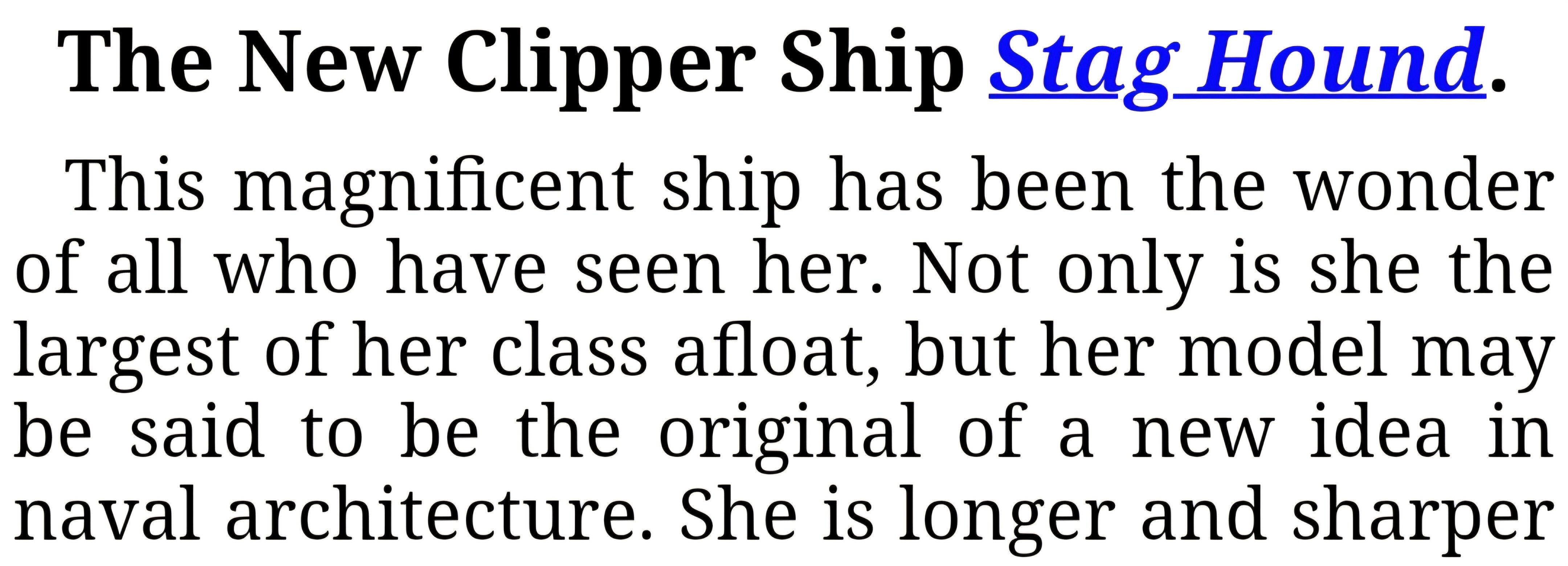

yup - I had seen the language in McLeean's descriptions of there Stag Hound & Flying Cloud - I had not seen the specific language "the complex curving navel hoods

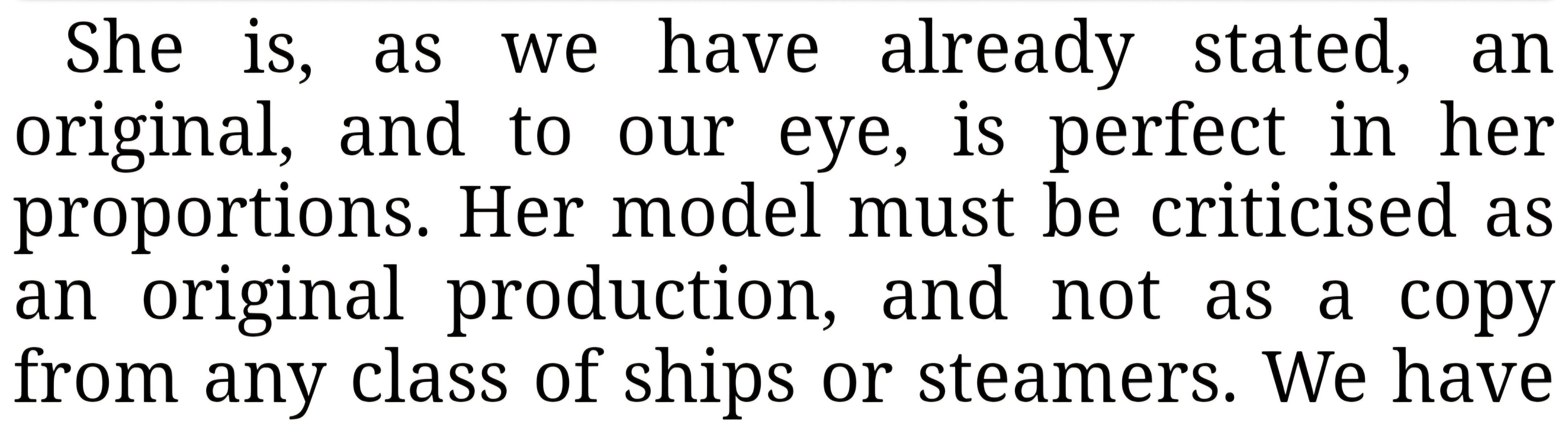

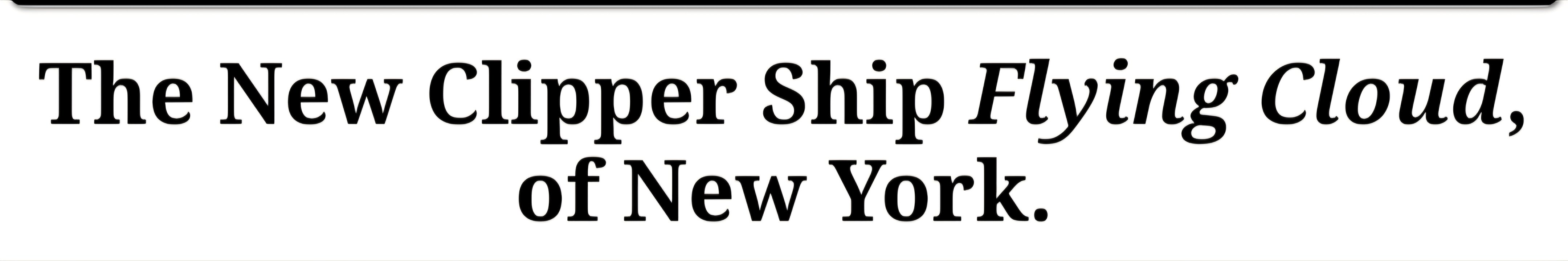

@sob my apologies for mixing up my description of navel hood with McLean's historic articles from the 1850s. To clarify what I mean by these devices twisting to adhere to the hull here's a series of Glory of the Seas scenes. They're in chronological order from her shortly before launch in 1869 to approximately 1911. In comparison, I've also included the 1854 Champion of the Seas daguerrotype. Rob and I clearly see the gold-leaf embellished devices behind her sailor figurehead as the same navel hood, cutwater combination as seen 15 years later on Glory of the Seas. This proves that McKay was consistent in application of this unique bow structure. When examining traditional naval hoods, what I have seen is that they're structural pieces but unlike McKay's navel hoods, they're usually not adhering so closely to the ship's hull. It's the main reason why we consider McKay's structures as integral bow extensions.
200390735_GloryofTheSeas-02_jpg_1e3ea586a74b8c0a0aa8a4438686e3ec.jpg.f6f2d2d5b7beeb87ff8b85c613a0468b.jpg.2423acf5f35106d86eb3c66b9a04d148.jpg
thanks
Scott

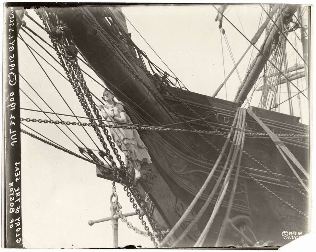

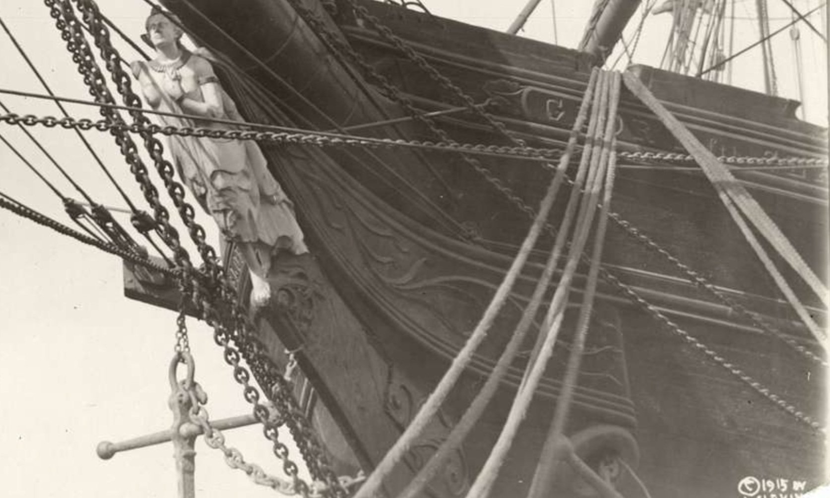

"the complex curving navel hoods  are Clipperfan's own words....used to describe the special symmetry required of the structure to transform from the hull shape of the bow, to straighten out and meet securely to the vertical aspects of the cutwater/stem.  It requires a *twist* to be made, in the structure.
Scott....it completely escapes me, as to your hard rejection of this structure, that is clearly evident on Glory of the Seas.  A structure no other builder employed.  I might remind you, if I may, that in the light of new conclusive evidence that Flying Cloud, as Staghound before her, did in fact have a spacious, Well lit, recessed forecastle that housed a patented windless below......with WC's internal to this topgallant forecastle.  You have not (as of late), included these changes on your plans, but retain the highly inaccurate external wood windless under a very short(inaccessible) forecastle deck, that, in no way could house a full watch of crew.  I tore out my initial errored forecastle on Glory of the Seas...long after it was installed and hardware was being applied...(When new evidence came forward), so I could create the most accurate model of Glory of the Seas.  Regardless of the pain and hard work that it took....being accurate was more important.  I would encourage you to do the same.  So what's it gonna be......Hold your opinion on one, or willingly overlook the other? The ramifications are far reaching.

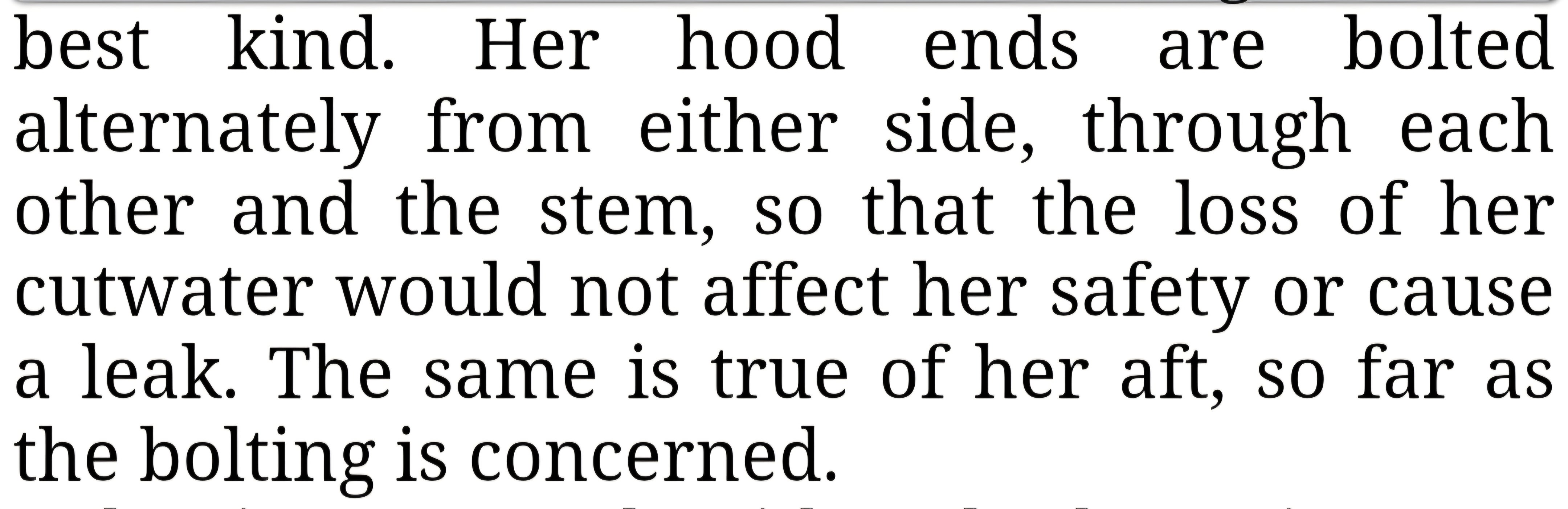

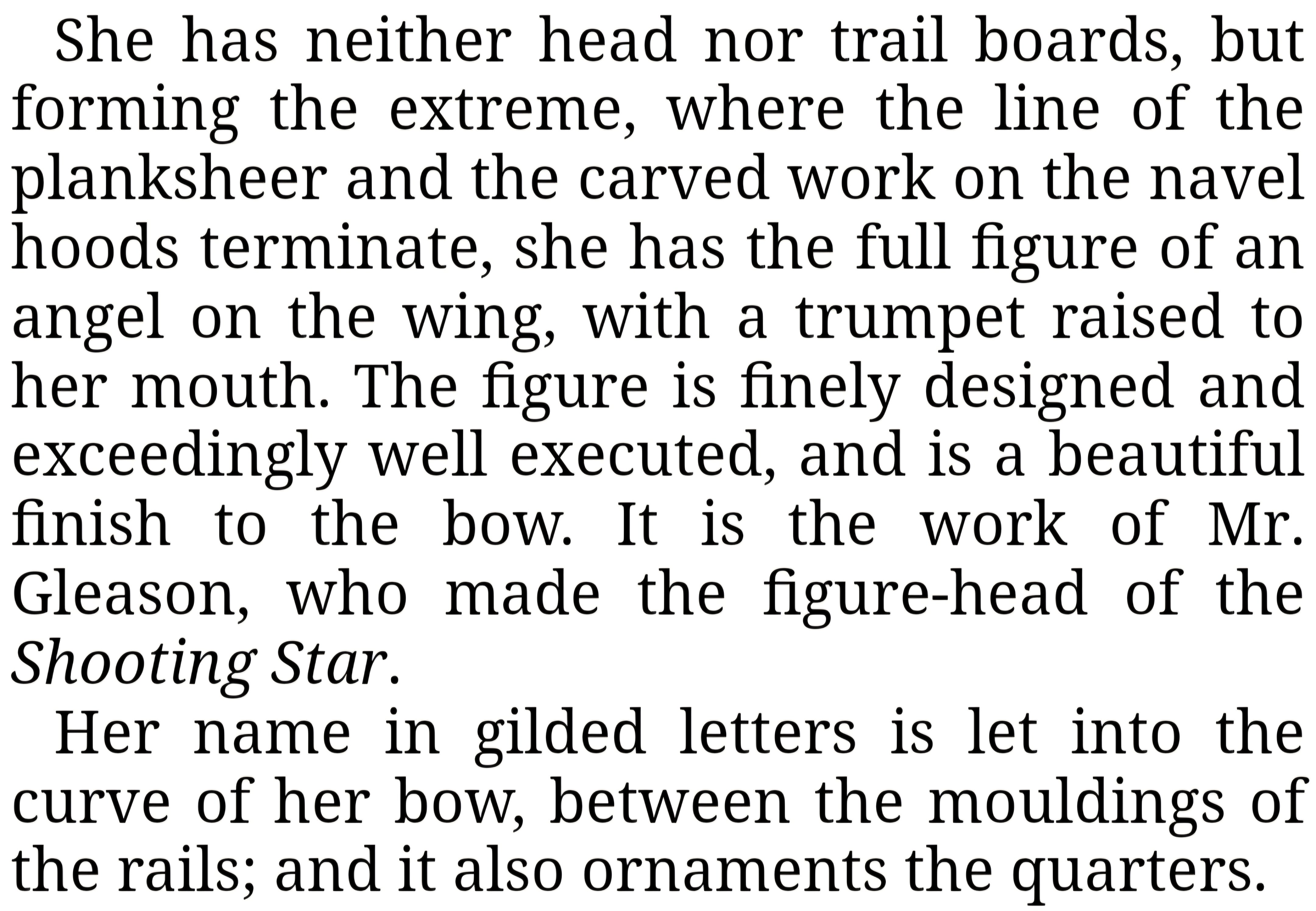

McLean refers to this structure that extends *PAST* the owes hole as, "Her hood ends are bolted alternately from either side, through each other and the stem, so that the loss of her cutwater would not affect her safety or cause a leak".  The Howes holes are nowhere near the cutwater.....but looking at Glory, you can easily identify this McLean description for FC.  Earlier in his description he says, "where the line of the planksheer and the carved work on the navel hoods terminate, she has the full figure of an angel".  Again, the planksheer is roughly at the level of the deck (nowhere near the howes holes).  Following Glory again, you can see this structures termination point is no where hear the howes hole.  Its out by the figurehead.  IF the Navel hood was specific to the howes holes and structurally tied to it, for cable alignment purposes.  How then does McLean on several occasions state the Hood has carvings upon it and it terminates at the figurehead, and is structurally supportive of the cutwater and stem?
Rob

in Glory the structure extends past the base of the figurehead and extends on top of the figurehead

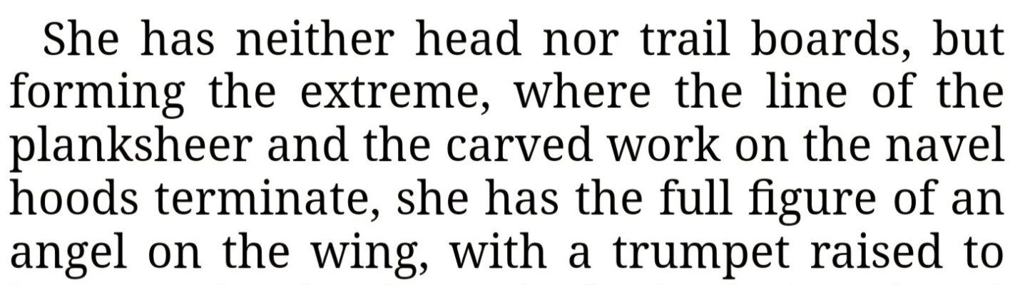

the McLean note on the naval hoods on the FC says ""where the line of the planksheer and the carved work on the navel hoods terminate, she has the full figure of an angel"."
that, to me, indicates that the navel hoods do not extend past the base of the figurehead
Scott

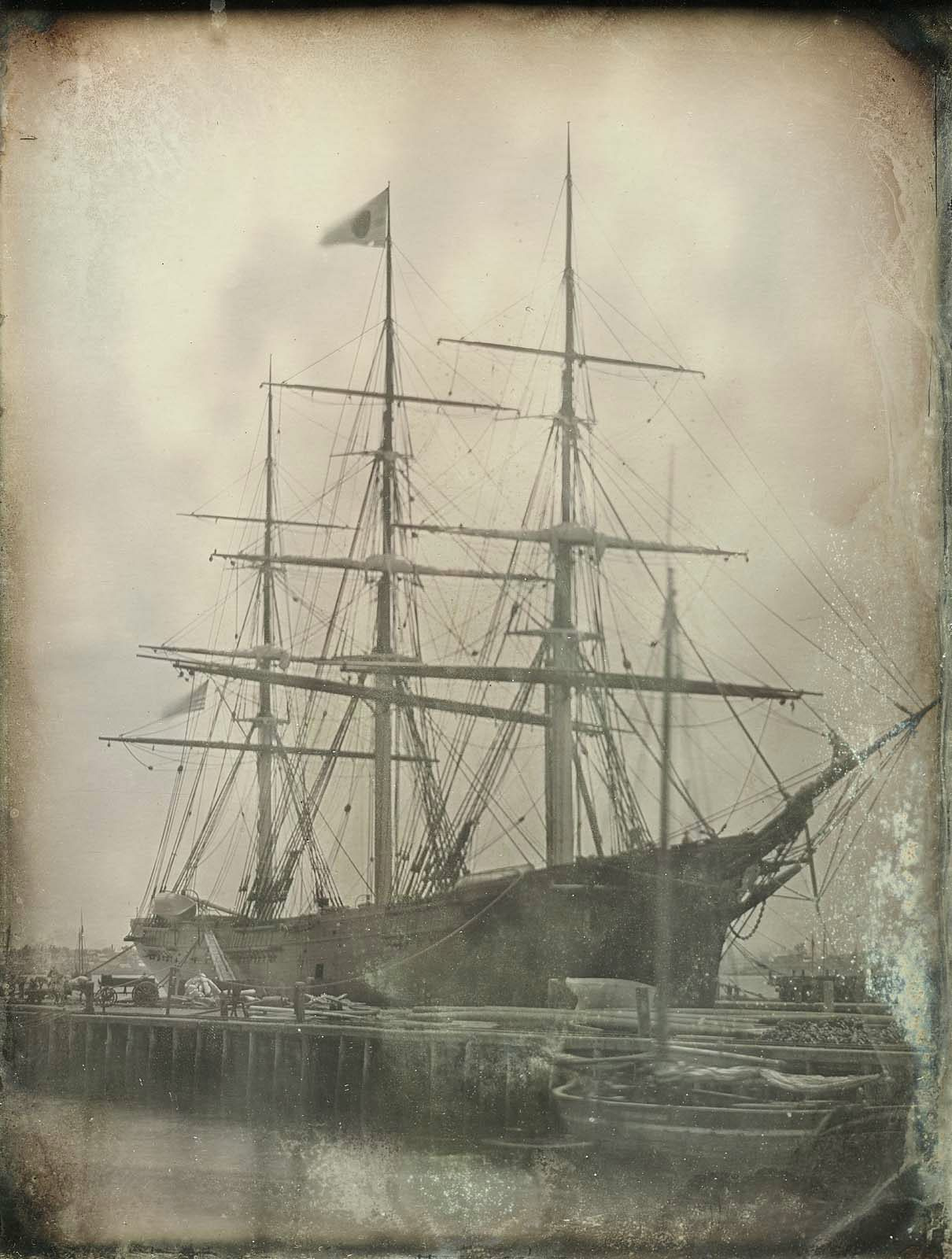

Then you are forced to explain why the figurehead is not back by the howes holes.....  On Glory the termination of this structure is above the figureheads shoulders.  Close enough to meat the description.  Since McLean is not very exact on many of his trim descriptions, and he uses terms such as, *Somewhat, about and some*.  He even fails to give the aft portico dimensions on FC.  A structure that had to be calculated from other known dimensions.
All this being said.  Apart from the exact depictions made by McLean....it can be reasonably devised, as I and Rich have done.....a Hood of some kind existed on Staghound, FC SS, and most likely all of McKay's clippers, and they were similar to that on  Glory of the Seas.
As I have pointed out before, that is a reference to the hood ends of the planks and nothing whatever to do with the navel hoods, either in the original meaning of that term or the unique McKay structure.
Yes. But that is the upper, forward end of the structure in question. My point concerned the lower, after end. From the quoted text, that seems to have surrounded the hawse holes in Flying Cloud but, as seen in photographs, it clearly did not in Glory.

Well...you and Scott both have claimed the hood end terminates with the feet of the angel.  But McLean's description says nothing about the Angels feet...... " work on the navel hoods terminate, she has the full figure of an angel".  It simply states a full figure of an angel is present.  Using McLean's own lack of clarity on describing many carving and structural details.....It could easily be determined that at the termination of the hood...or in (proximity)...cuz no other place is possible......the figurehead is mounted.  If we were to follow his description literally.  The unreinforced stem would have to protrude at least 7ft (the length of the figurehead) beyond the cutwater to accommodate and support it.  The angel could not be fully supported by its feet alone.  It had to be supported by its back.  Which makes the understanding of the hood coming up forward and over the figurehead more plausible.  Such as we see in Glory.
Rob
True enough. And he also says nothing of where the navel hoods terminate, only where the carved work on them terminates.
Like Scott, I read where the carved work terminates to mean that there was no navel-hood carving beyond the aftermost part of the angel (i.e. the feet), though I don't deny that there is some ambiguity. But you are right that the structural timber of the navel hoods could have continued up to the angel's shoulders, as in Glory. Certainly, there was some sort of heavy timber there. As you say, the figure could not have been supported by its feet alone. (And I see to justification to suggest some sort of supporting ironwork, though that would have been technically possible.)
