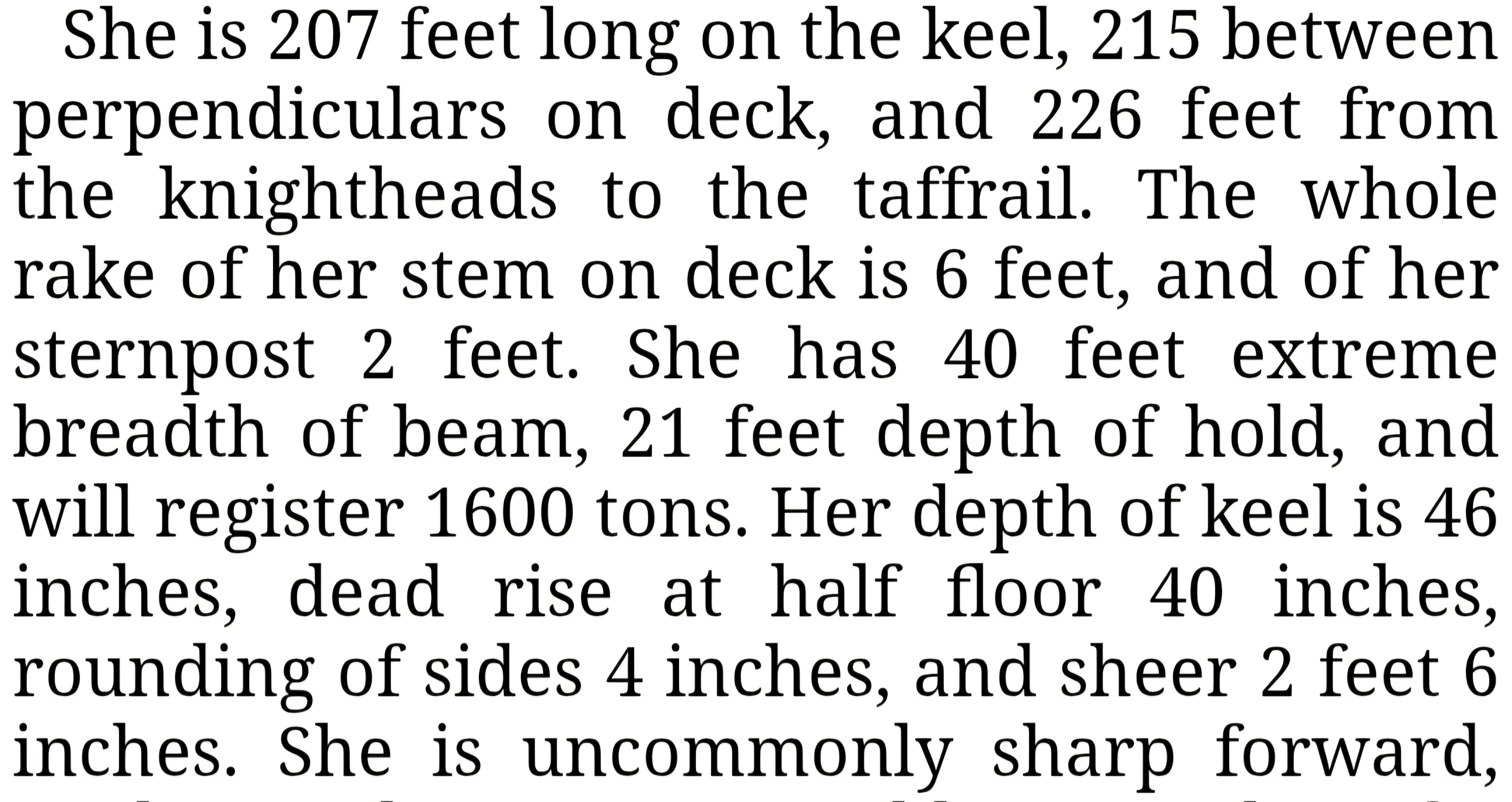

37 minutes ago, Kenchington said:
I'd have to see the original wording to be sure, but the rake of the after face of the post was a matter of hull design (influencing the run of the planking) whereas the gradient of the inner face was only of structural concern. Even then, the post was only one part of a complex structure involving deadwood, possibly keelson, likely a large standing knee, maybe an inner post and so on. It would make much more sense to quote a single value for the rake if that referred to the after, outer face.
Rudders could (and did) function perfectly well on raked posts. Indeed, even a post erected perpendicular to the keel was likely to be raked once the vessel was trimmed for sailing, with the heel slightly deeper than the forefoot.
Trevor

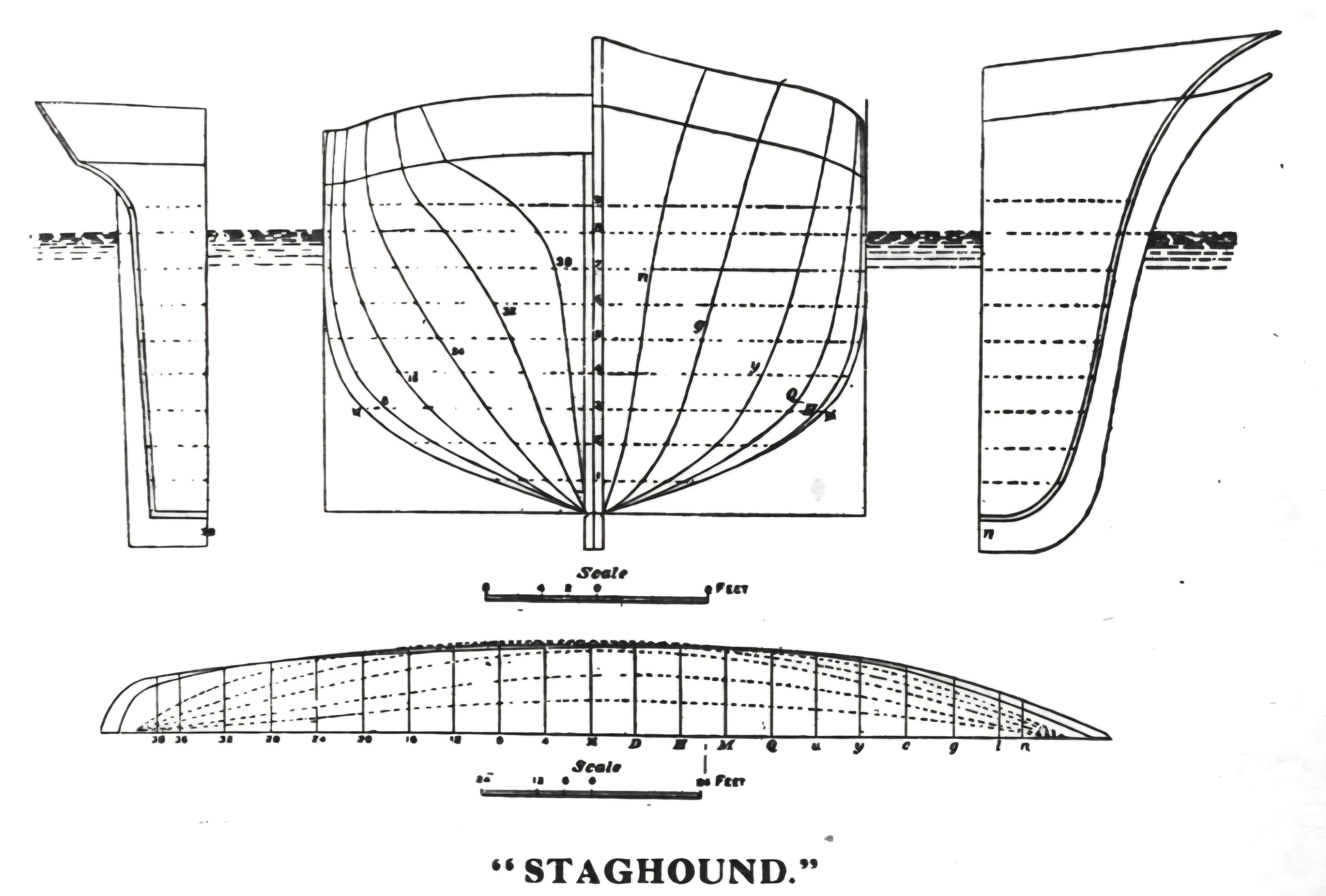

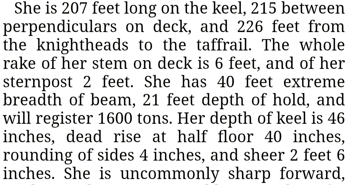

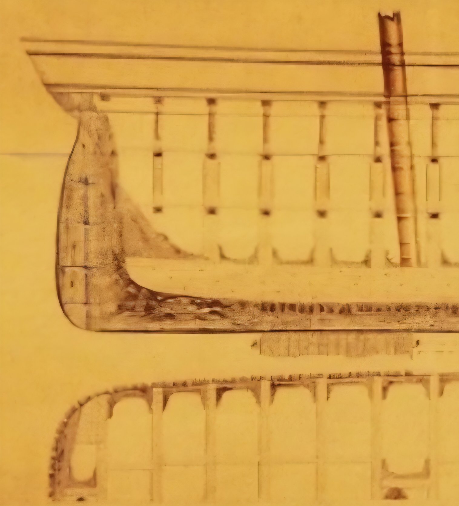

@Kenchington,Trevor here's the exact section of the Staghound article which includes the exact specs supplied to Duncan McLean by McKay's Shipyard. I've also included a close up detail of the stern on McKay's twin packets sketch which shows how the aft stern is thicker below than above.

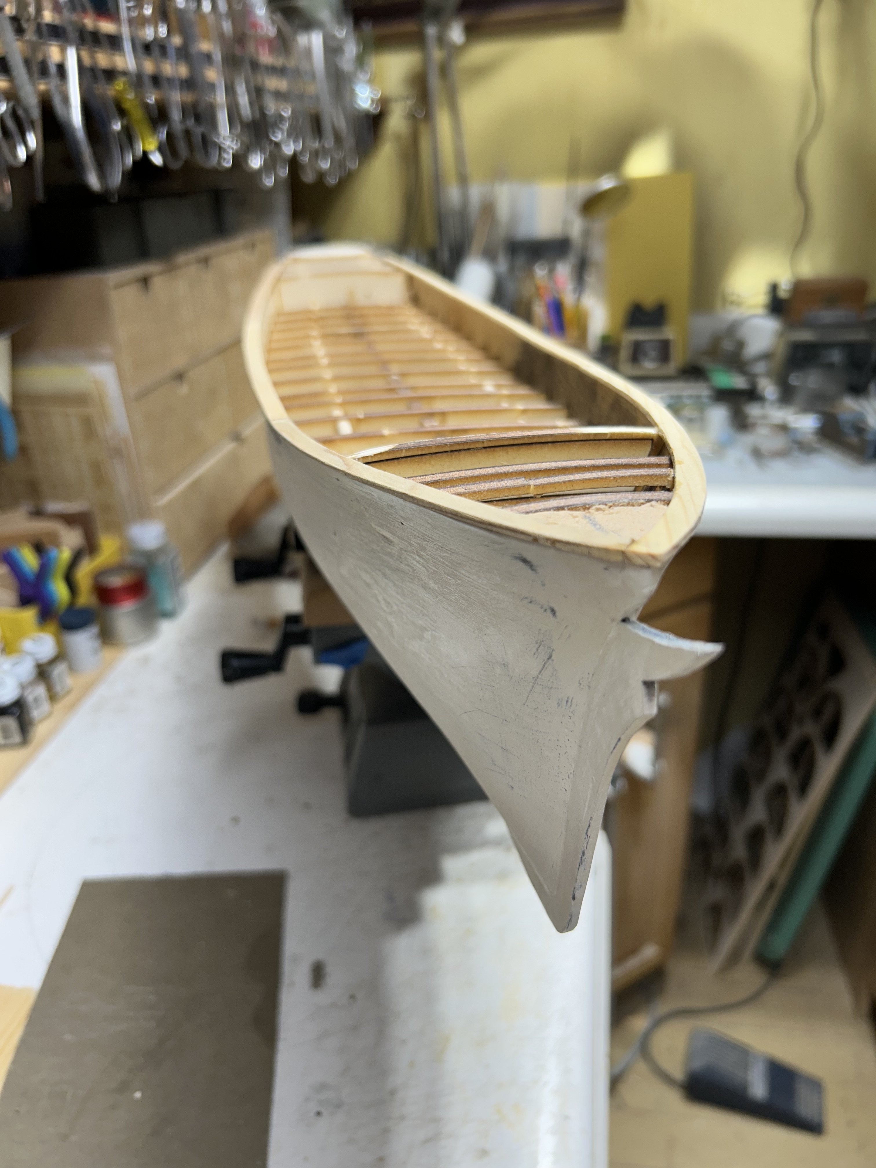

Working out the contours.

Contouring.

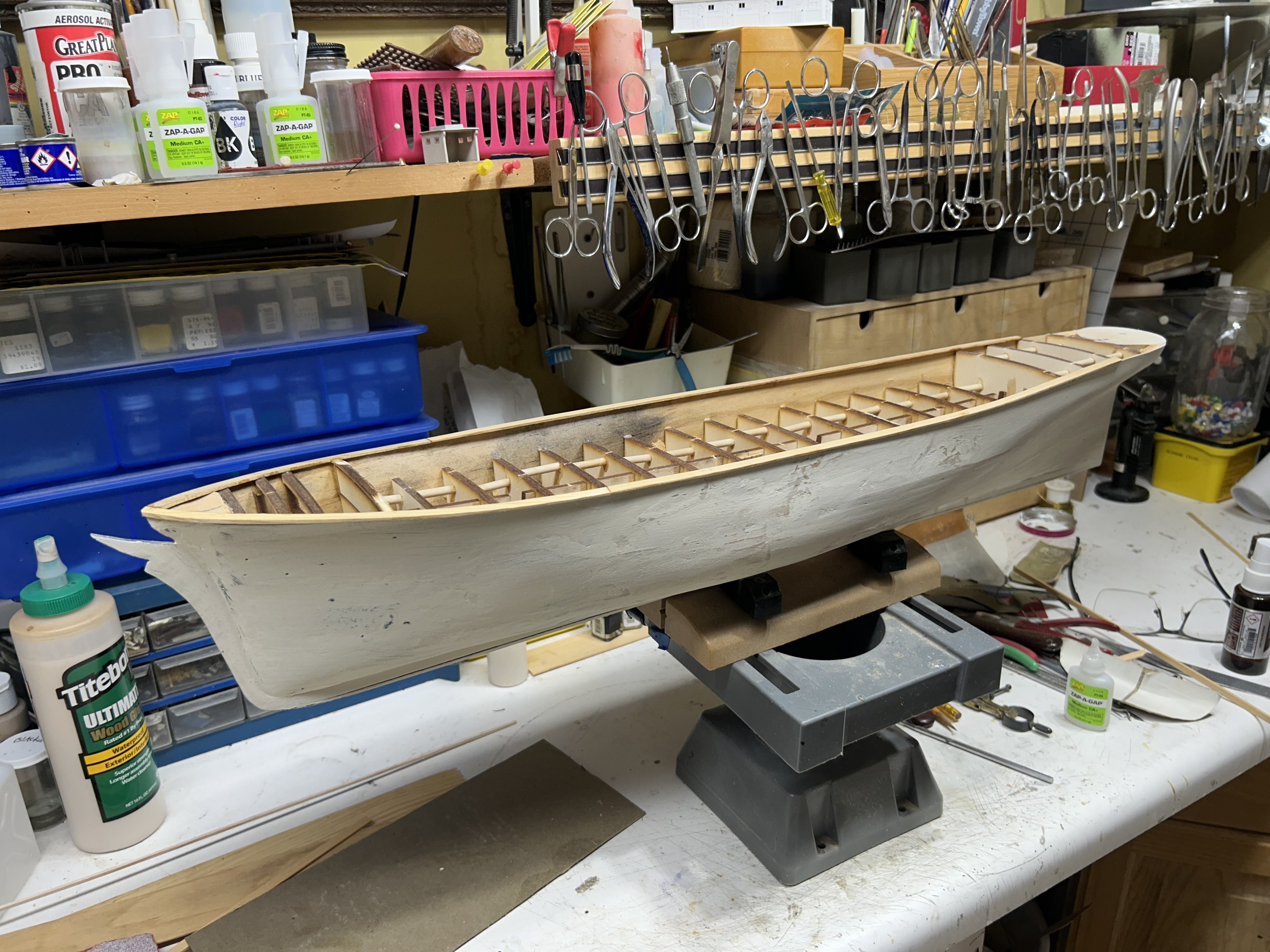

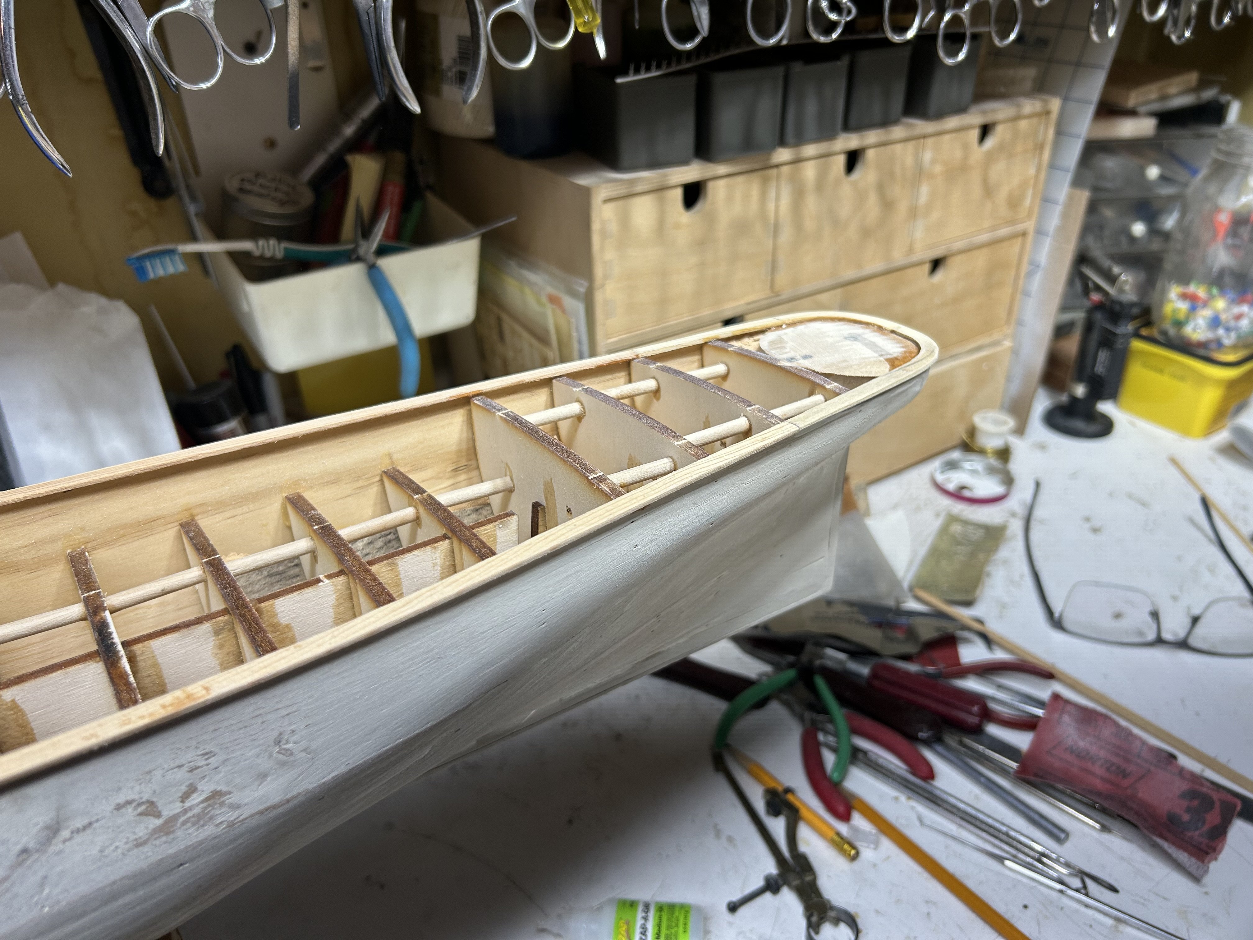

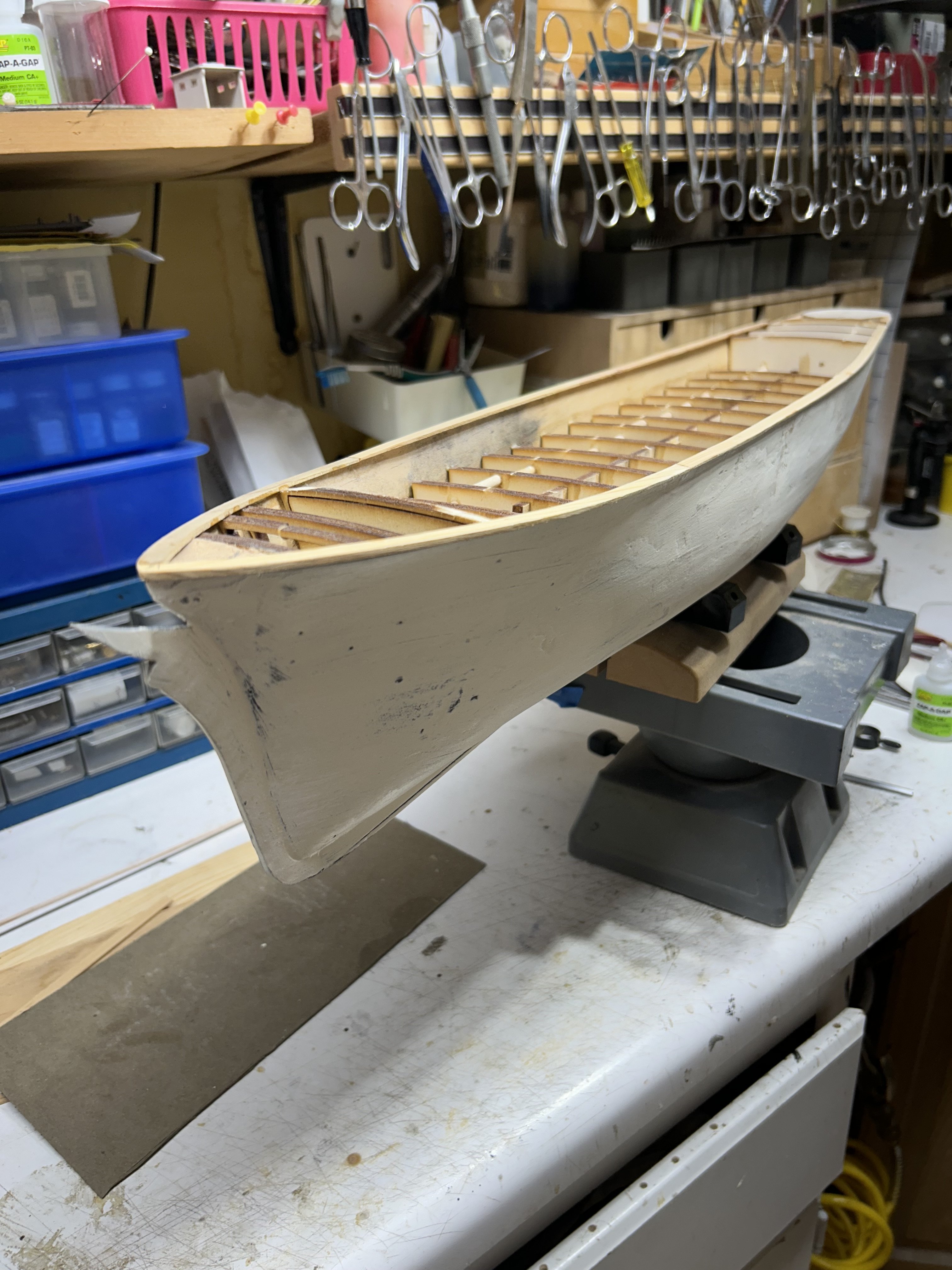

Did some corrections to the cutwater and the keel.  Here is a close up of the stem.

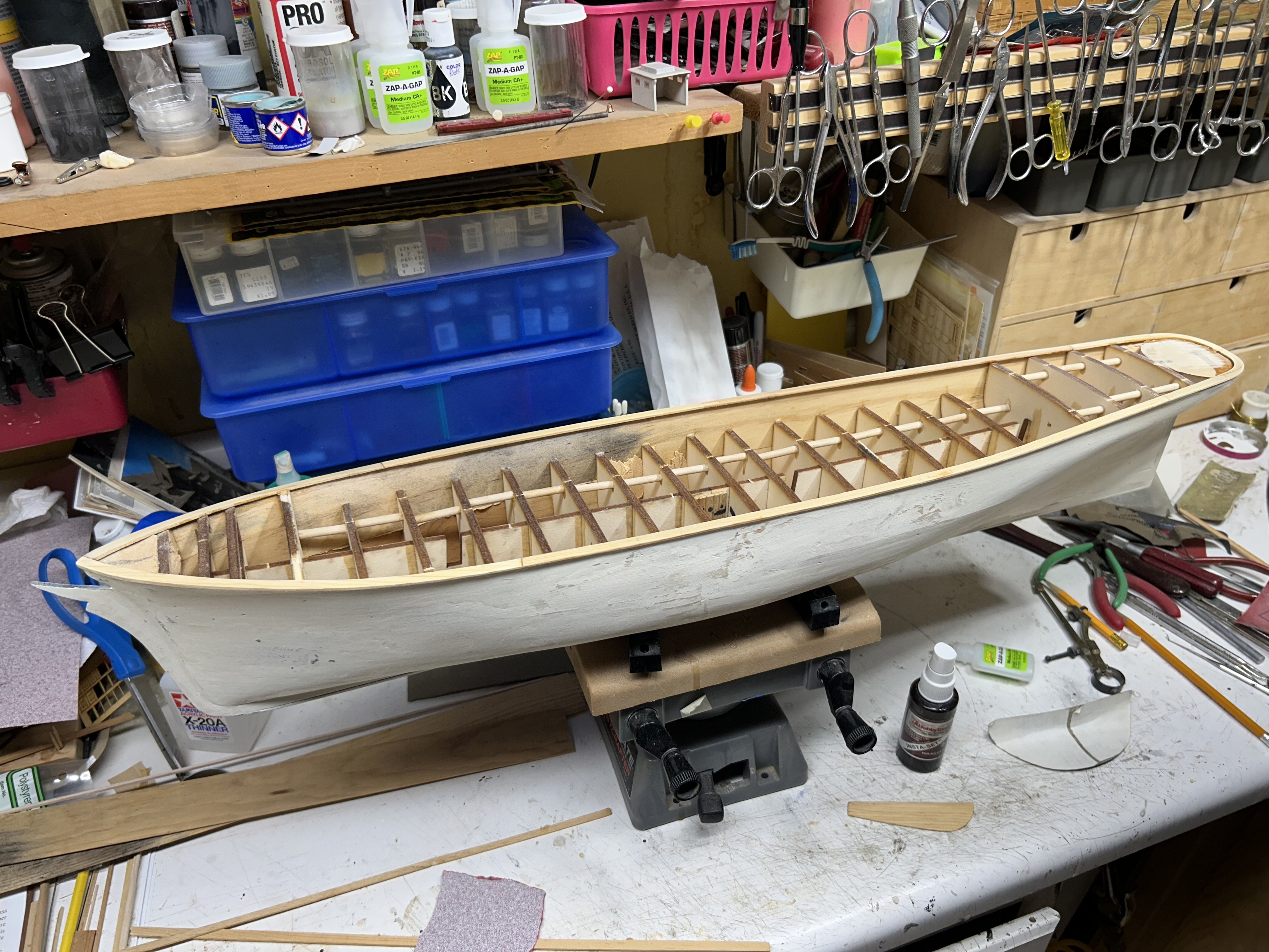

Now a couple overall’s.

Sprayed on a primer to aid in contouring, and sanding.

Thanks a lot Rick.  Since we have no photos to aid me……the McKay model and McLean’s description is all I have to work with……. Oh and a little artistic license.
Rob

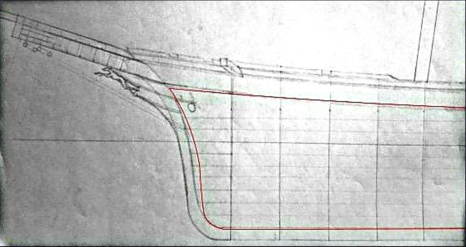

Rob,
At this scale, your staghound's starting to look more like a chihuahua 😉 Either your navel hoods are too large or figurehead's too tiny. I'm resharing my sketch to aid in your scale evaluation. The staghound figurehead is 90" (7 & 1/2' like the Athene figurehead. Like her, the naval hoods terminate around the dog's front shoulders. The sketch is done to 1:96th scale with 8' verticle lines. I traced the Alexander Hall plans, which besides her bow profile was just about spot on. You can use the scale on that print as a guideline, as my trace was exactly the same.

Rob, my bad. I misunderstood your picture, which made the figurehead look ridiculously small. The svelte hull of your Staghound is really beautiful and demonstrates Donald McKay's extreme California clipper true to form. It's so exciting to see you back at work on her.

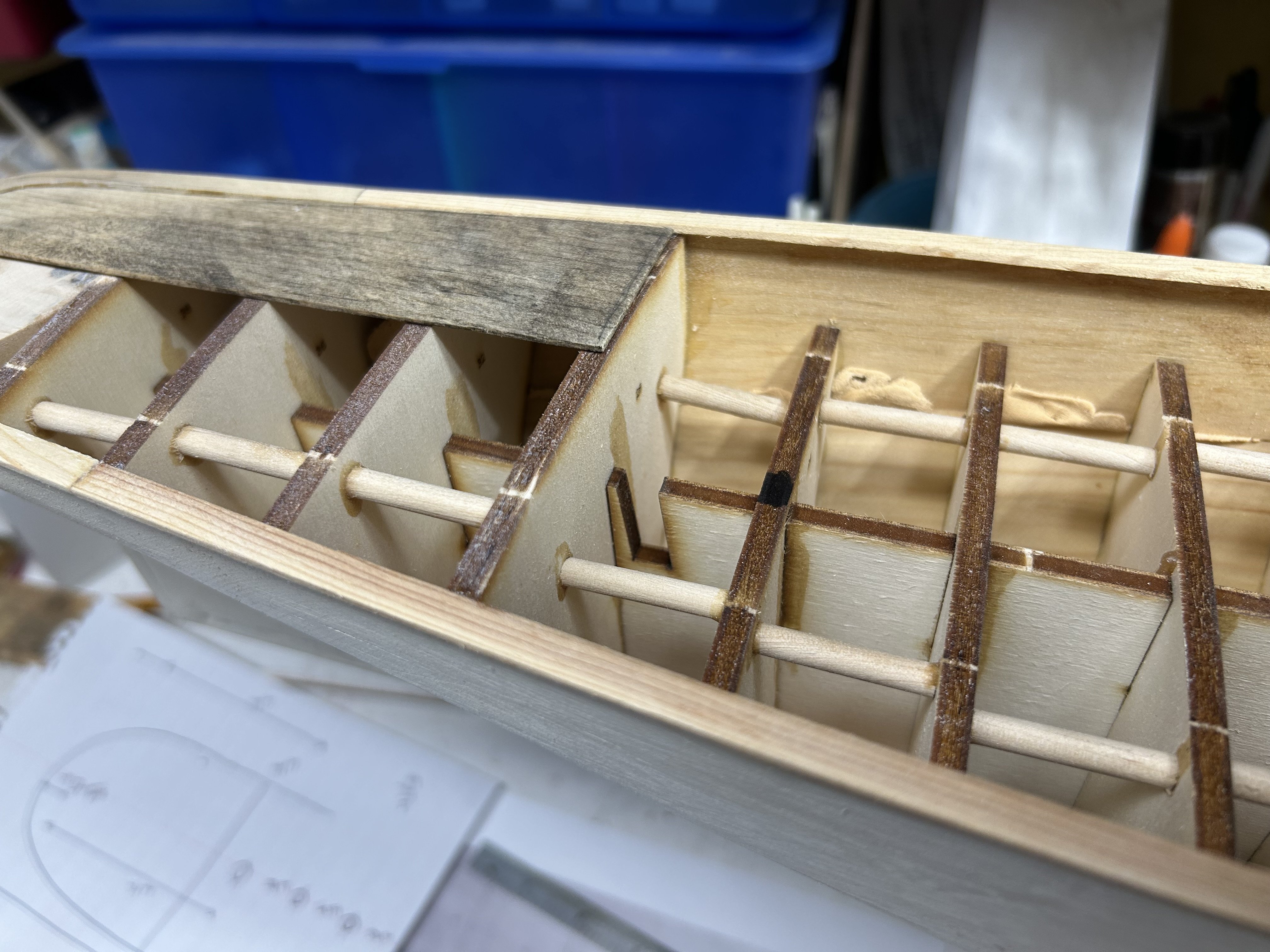

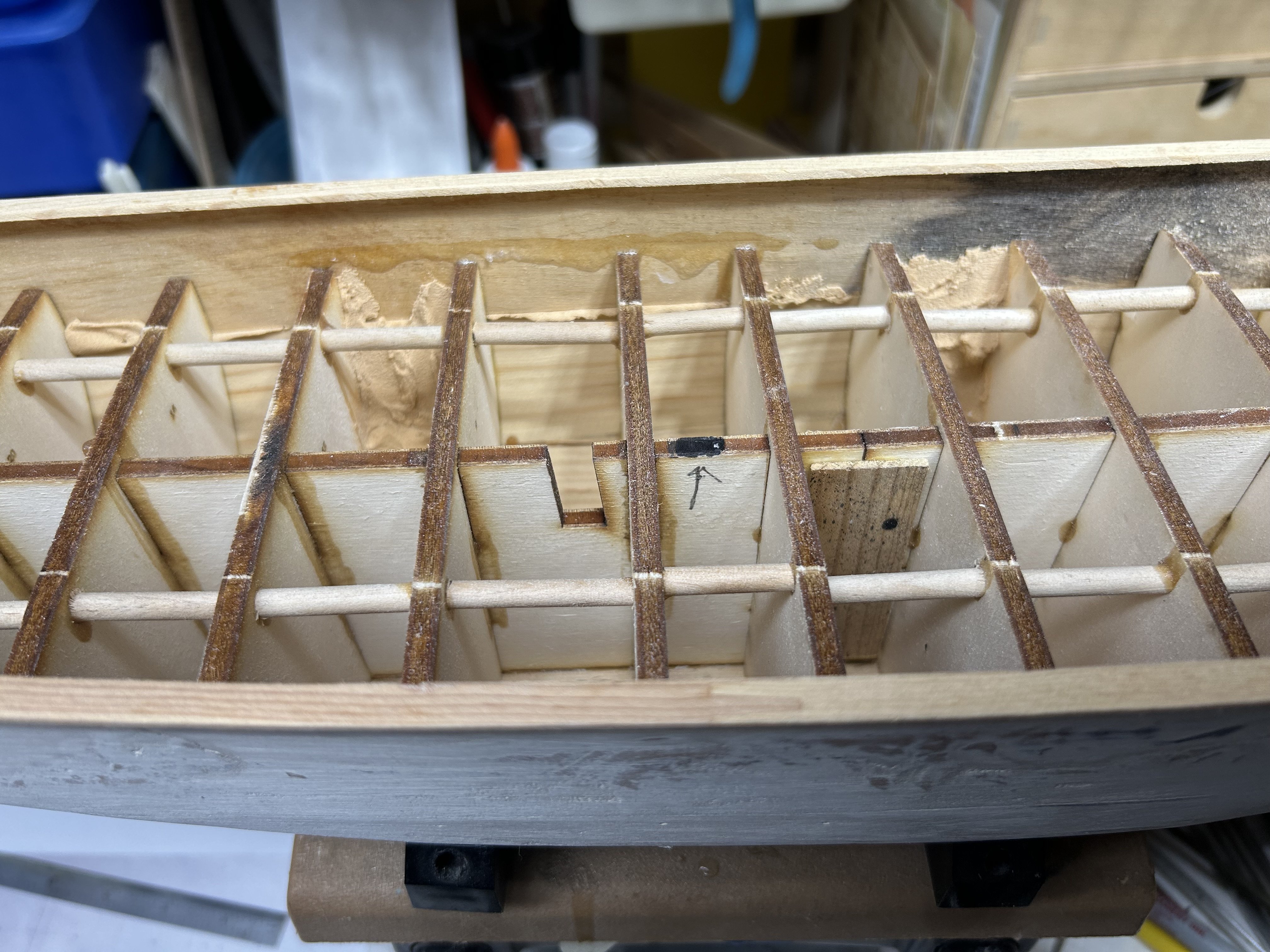

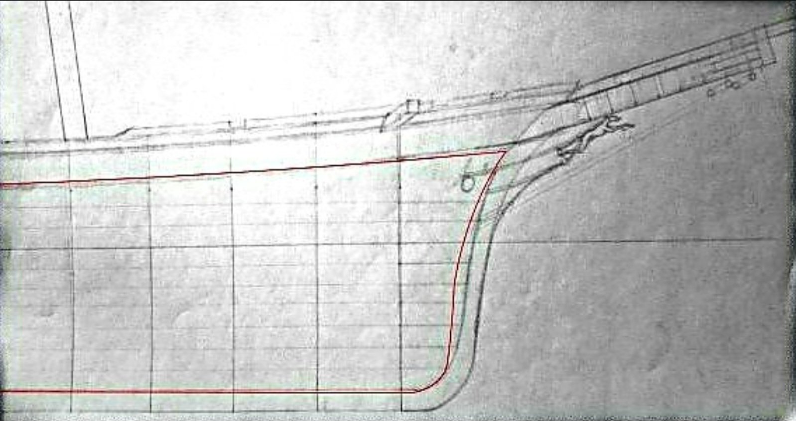

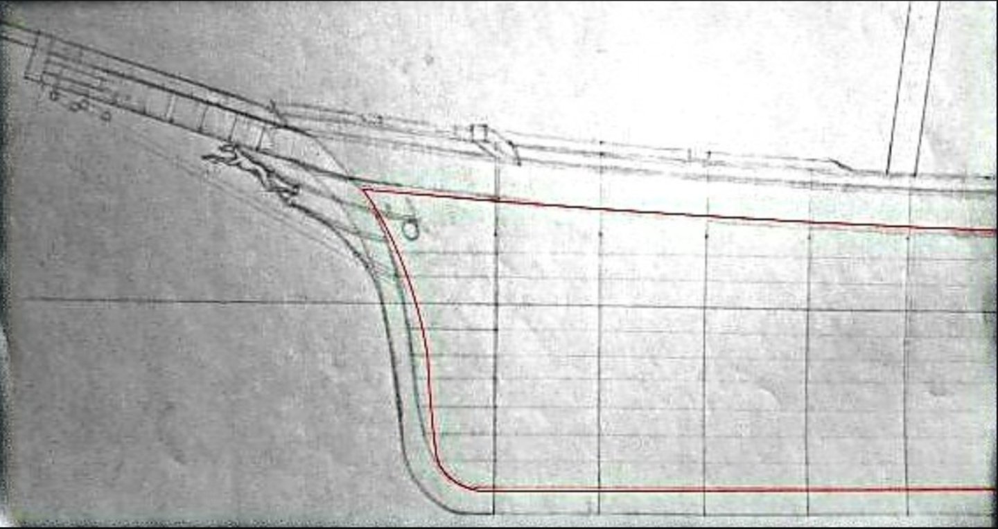

Recalculating it looks like Vlad placed the masts in the incorrect location.  I noticed it when placing the portico.  It was off by 8 scale ft.  The foremast began too far back from the stem.  Everything was off by 8ft.
Some images to show. The black dot is the correct location.
Rob

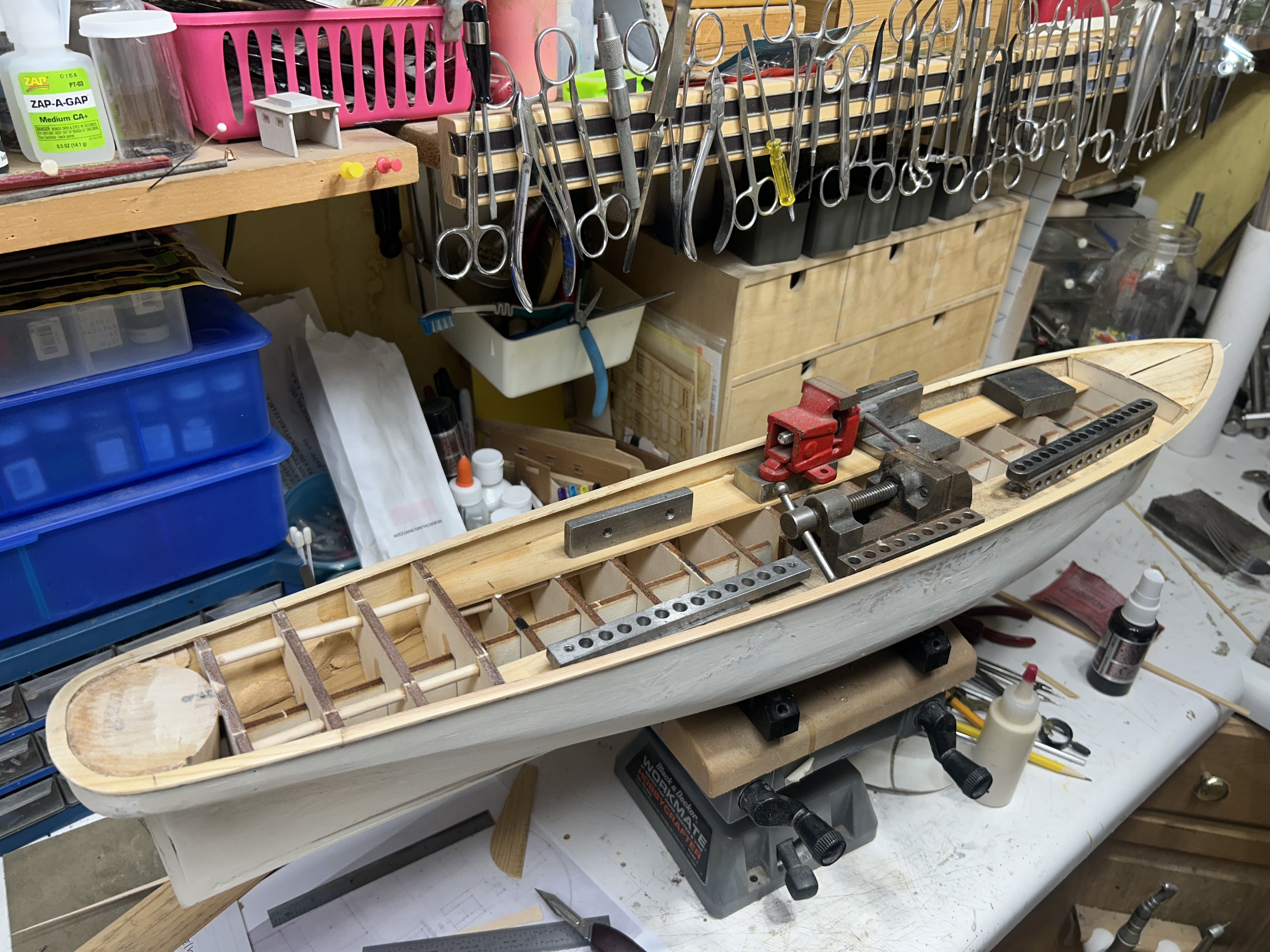

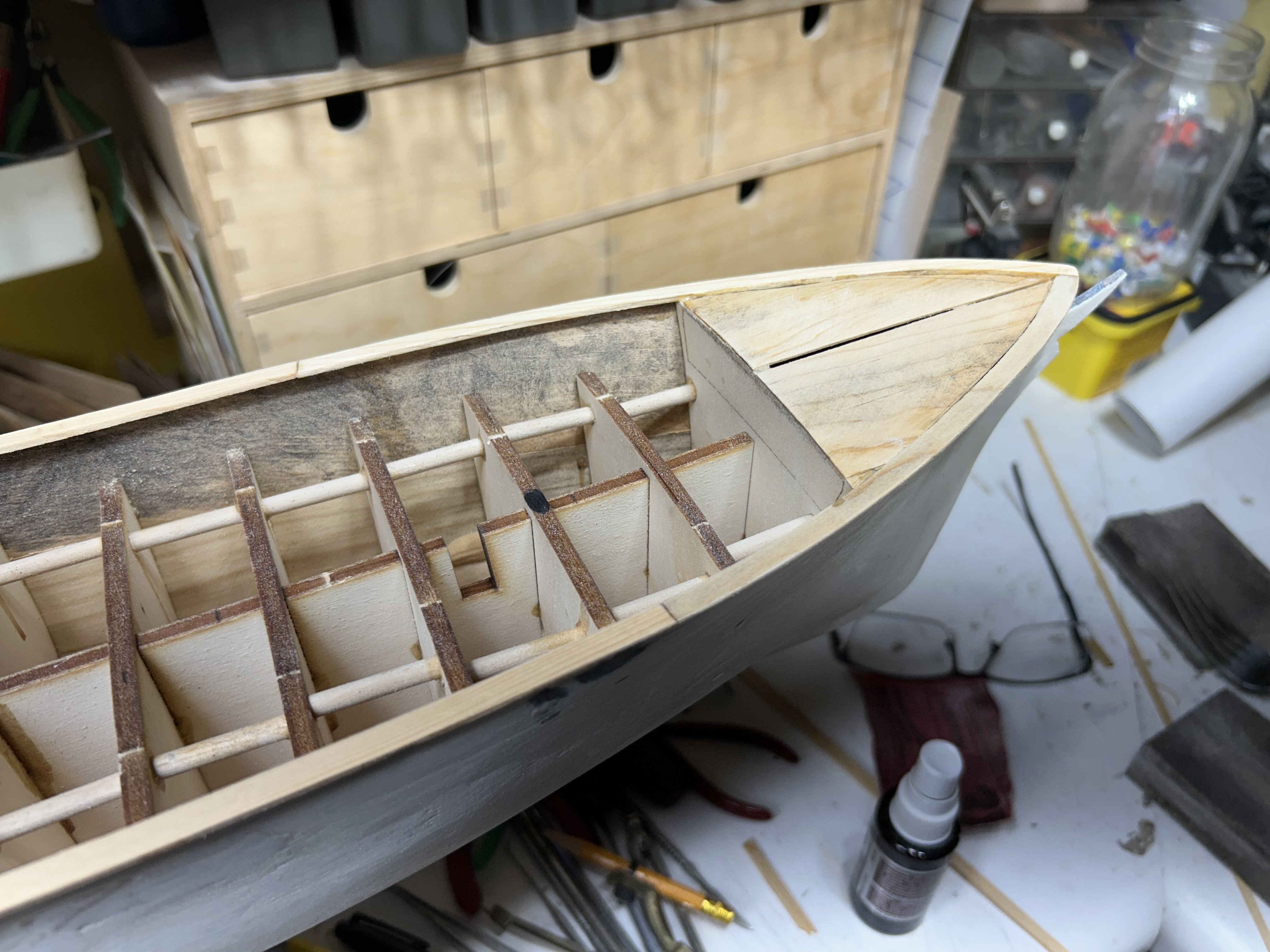

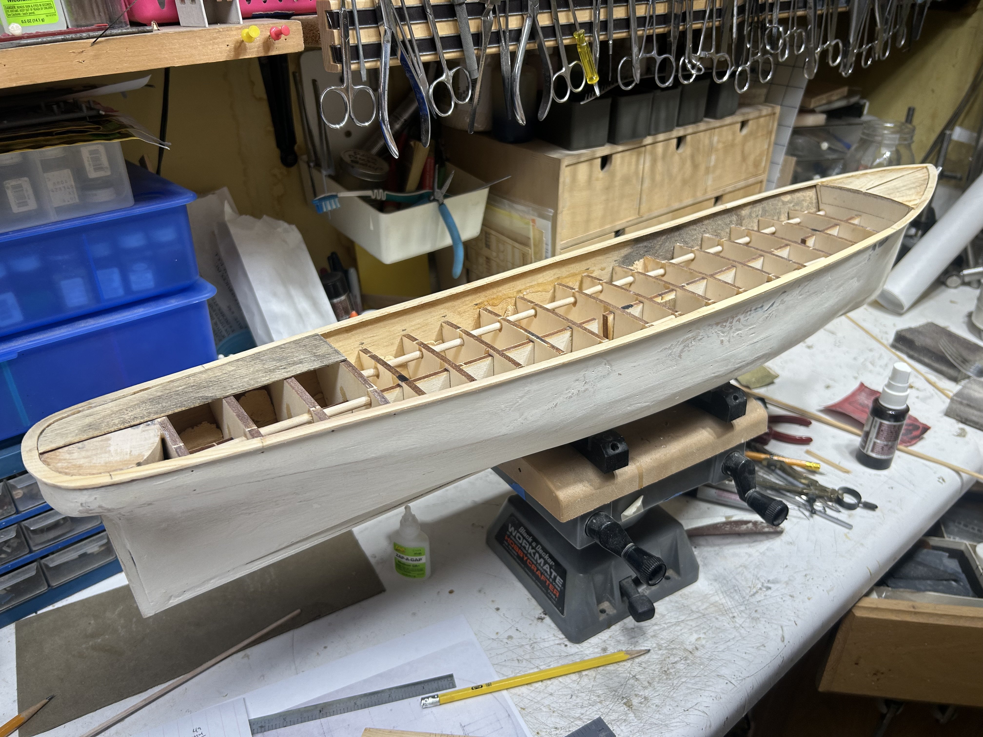

Began to install the sub deck.
Rob
Current build:
Finished build:
Current build(On hold):
Rob
Rob, your step by step updates really drives home what a complicated process scratch building a clipper replica really is. Staghound is shaping up to be a strikingly beautiful vessel.
    I'd might prepare the correct mast locations before decking everything in, by adding extra material on either side of the mainmast location (& the 4 corners of the new fore and mizzen locations, since they are at an intersection of frame members).  Then after decking, a drill press with the hull held in a jig (allowing for rear mast rake) and a forstner or other wood bit would make decent holes.
