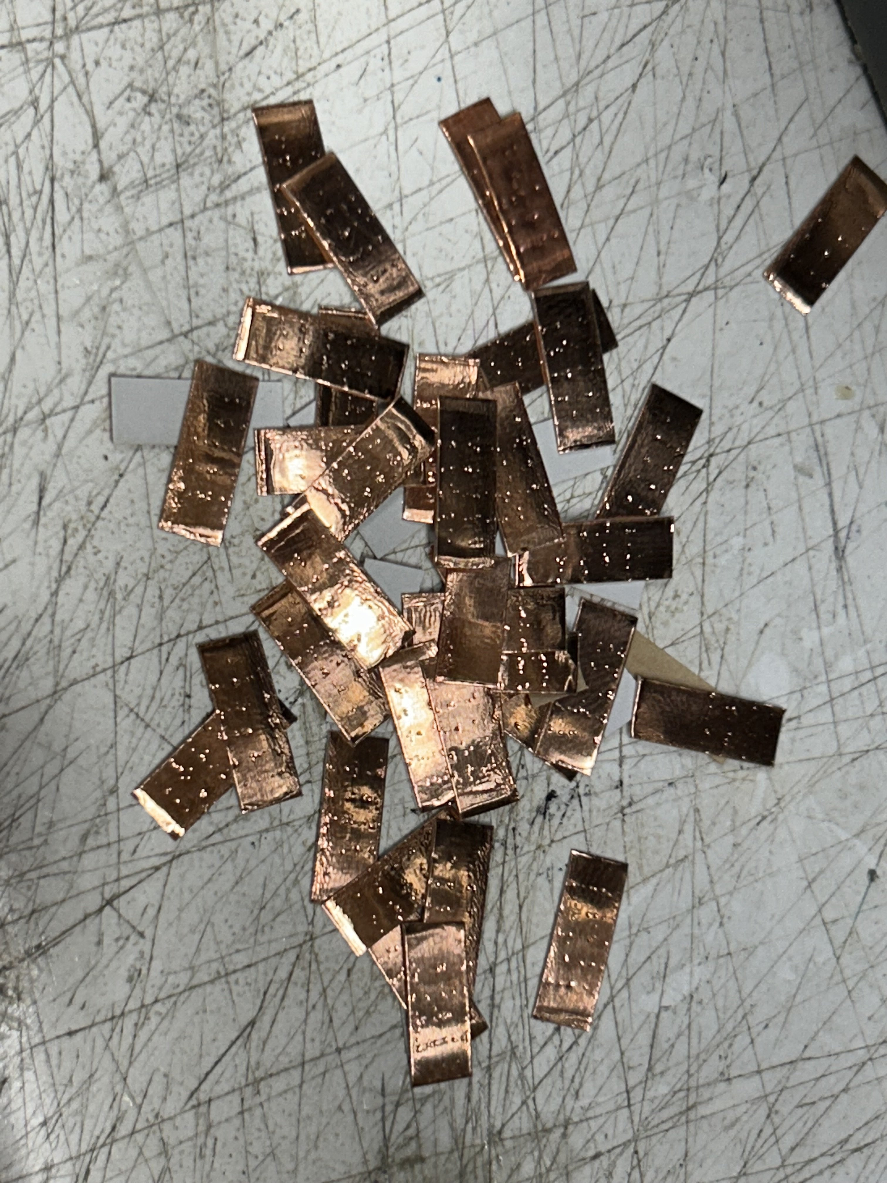

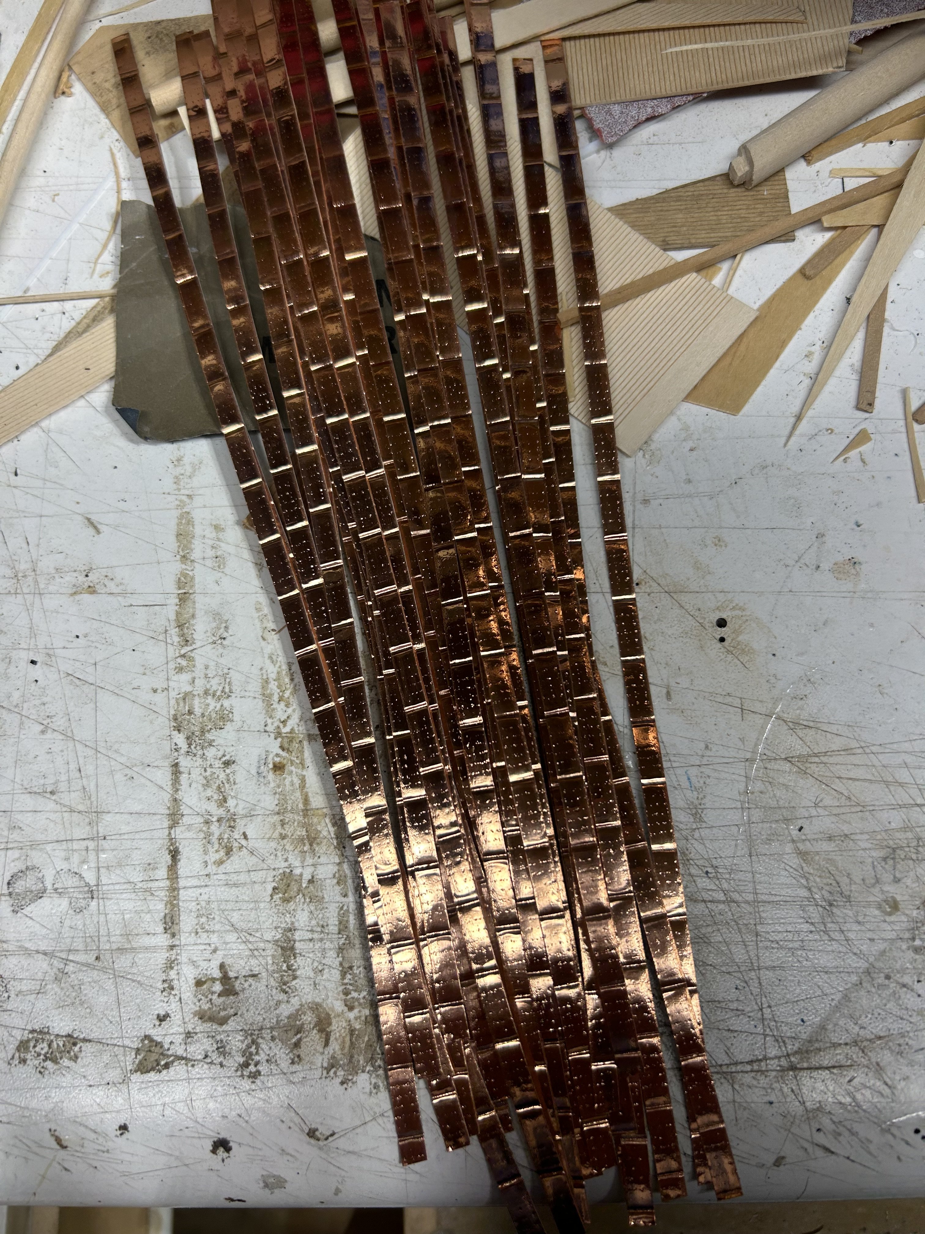

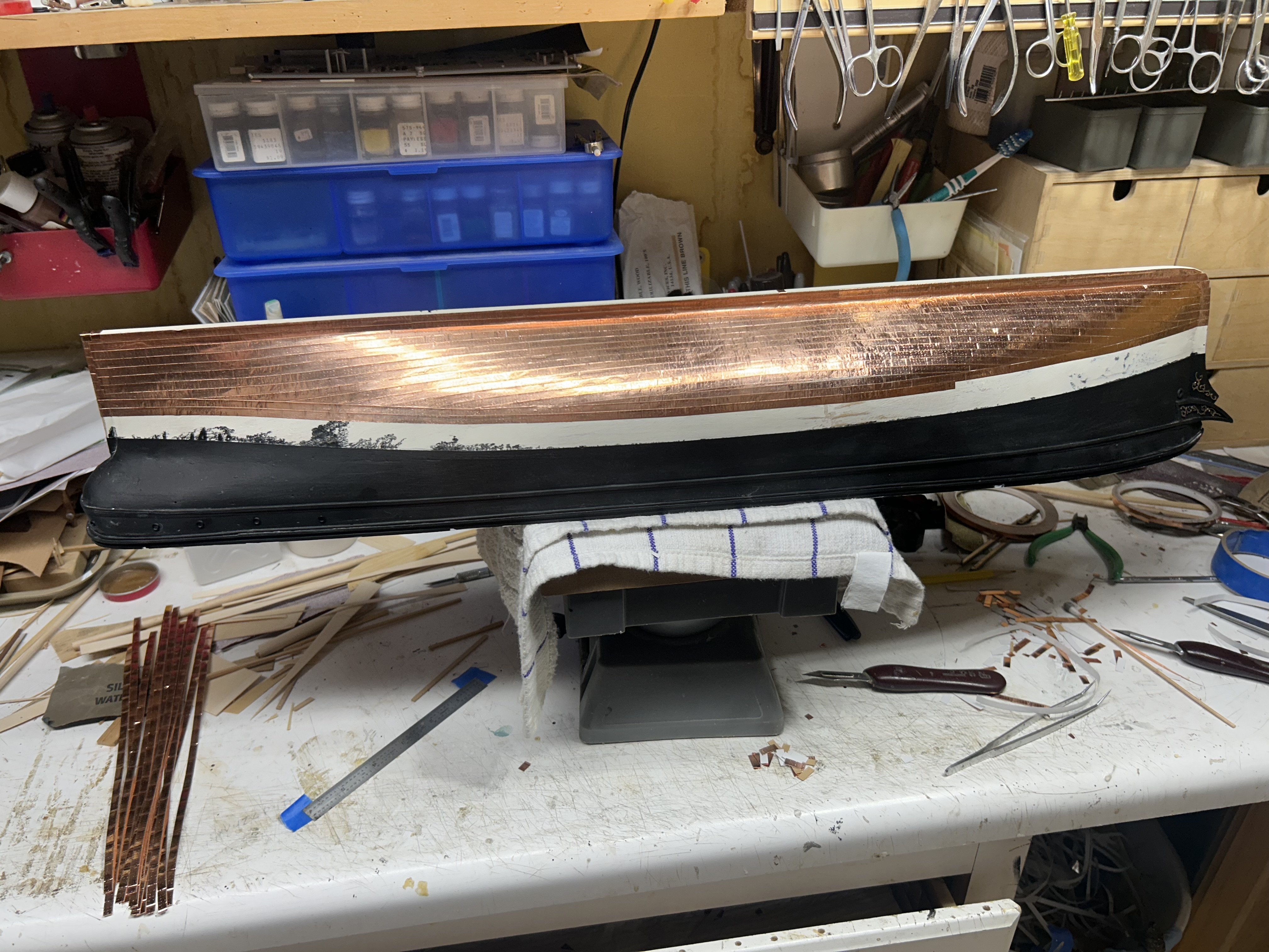

I gather it will require around 31 more embossed strips to complete the job.  Not forgetting to add the single plates needed to cover the keel foot.
As is my habit, I want to create a unique mounting for Staghound.  Like all my McKay clippers....she will be mounted with something that ties into her name.  My first thought is to use deer antlers as the pedistals and then mount them to the base (whatever I decide)
Rob.

Made the remainder embossed strips tomorrow
Rob

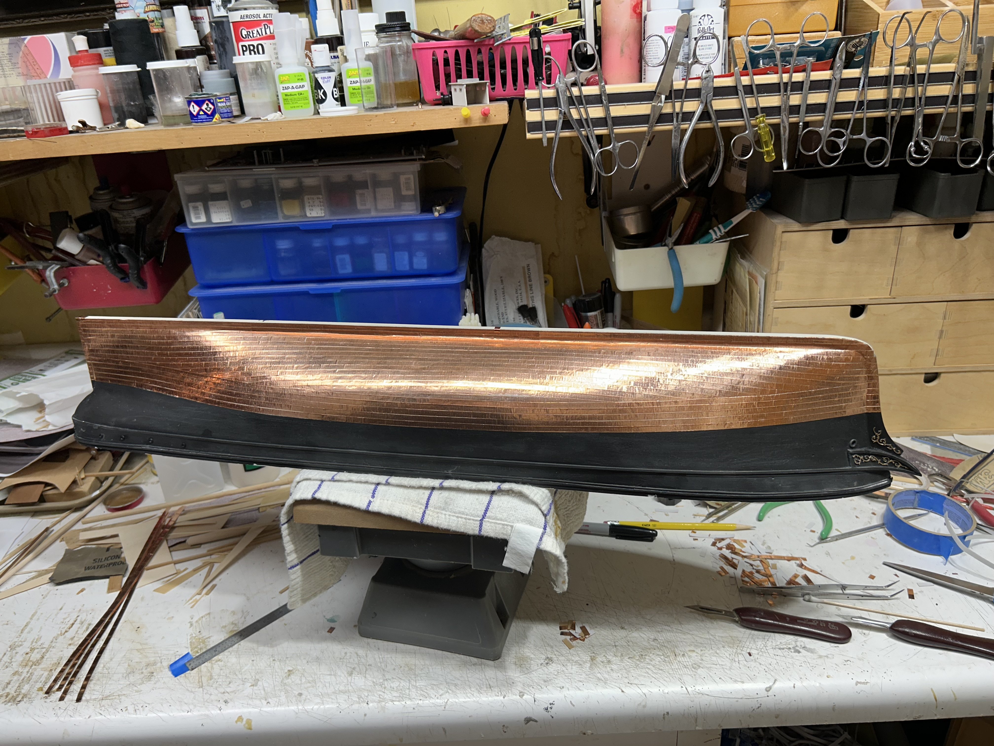

Finished the port side.   Now to finish off the keel foot.
Rob
Current build:
Finished build:
Current build(On hold):
Prepping the single plates for the keel foot.
Rob
Current build:
Finished build:

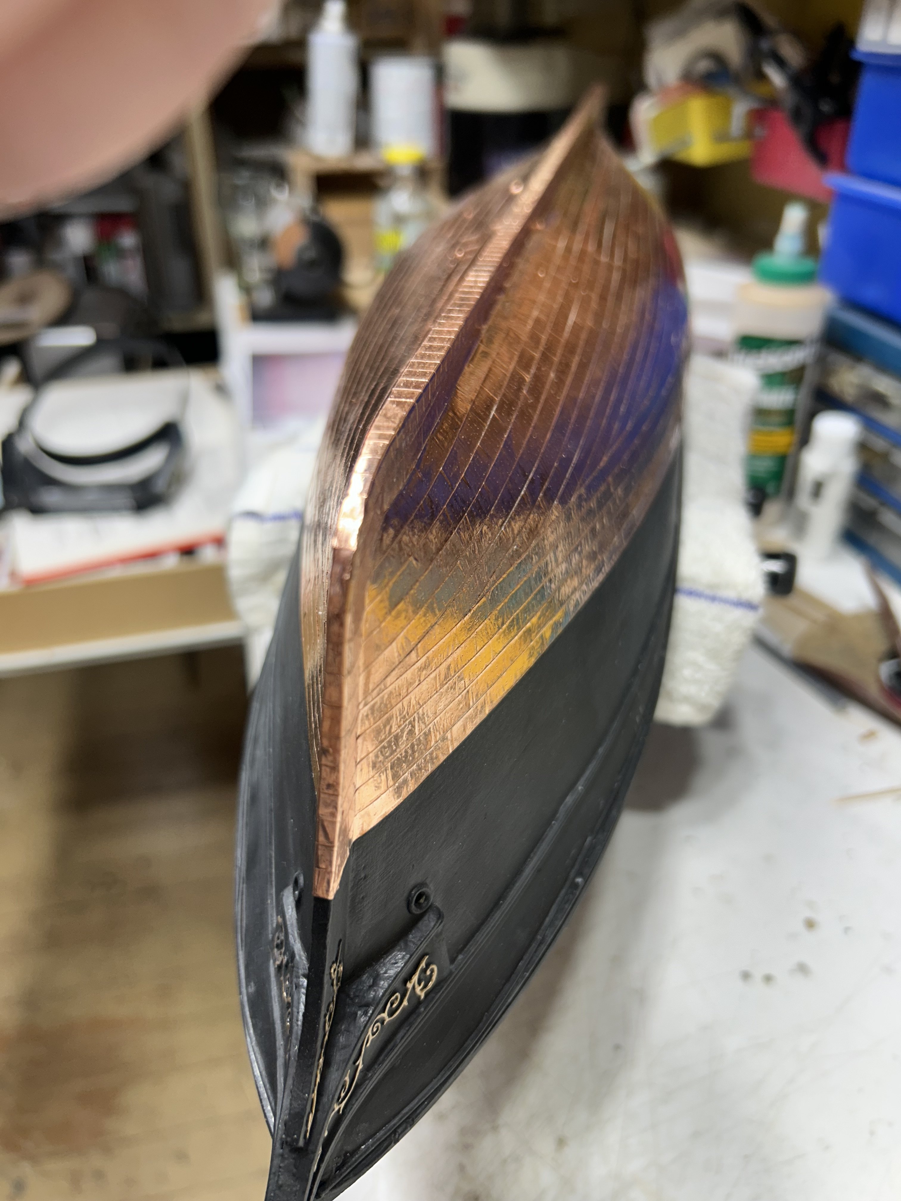

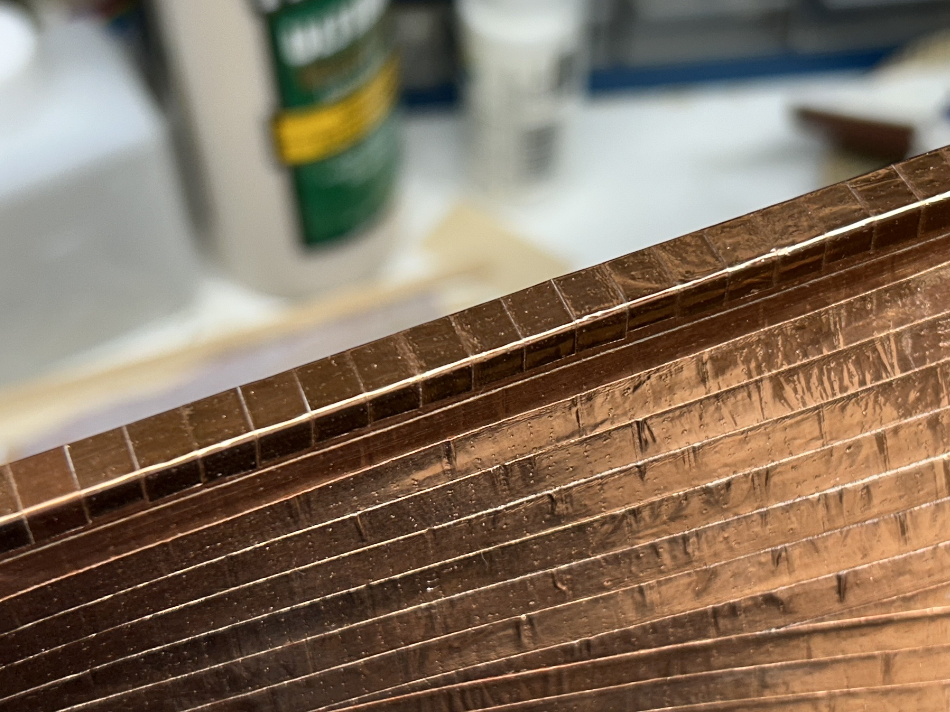

A little keel foot coppering.
Rob

She’s looking smart.    When the keel is done…….paint.
Rob

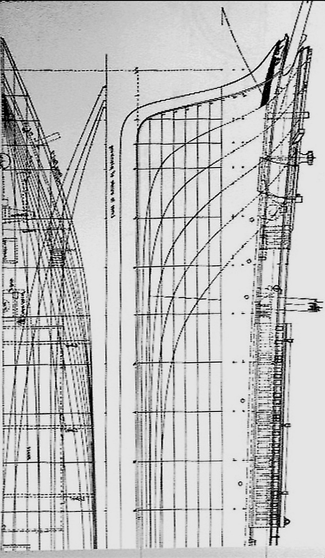

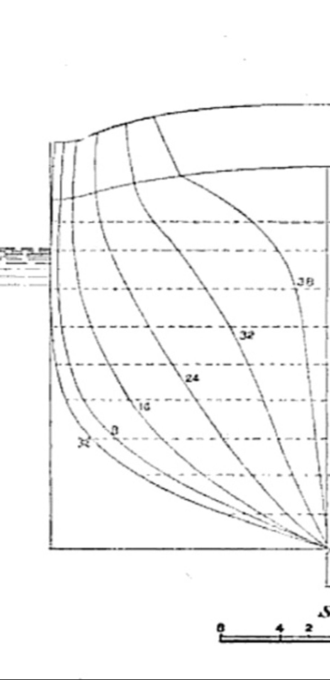

Rob, there's just something so beautiful about a black hull with muntz metal below. It's amazing how closely your Stag Hound resembles the Cornelius McKay model crafted nearly 175 years ago. It's a tribute to your modeling skills, Vlad's cgi work and my serendipity in getting many more images of the McKay hull.
When you add to the McKay half model the missing stem/cut water , and the main bulwark , she does look pretty good.  5ft higher forward then aft, and drawing 10ft aft then forward……. She takes on the description as outlined by McLean.
Rob
Rob
Rob,
Once again we're proving the incomparable value of decent research. Your 50 years of model building prowess shines with this exciting Stag Hound build.

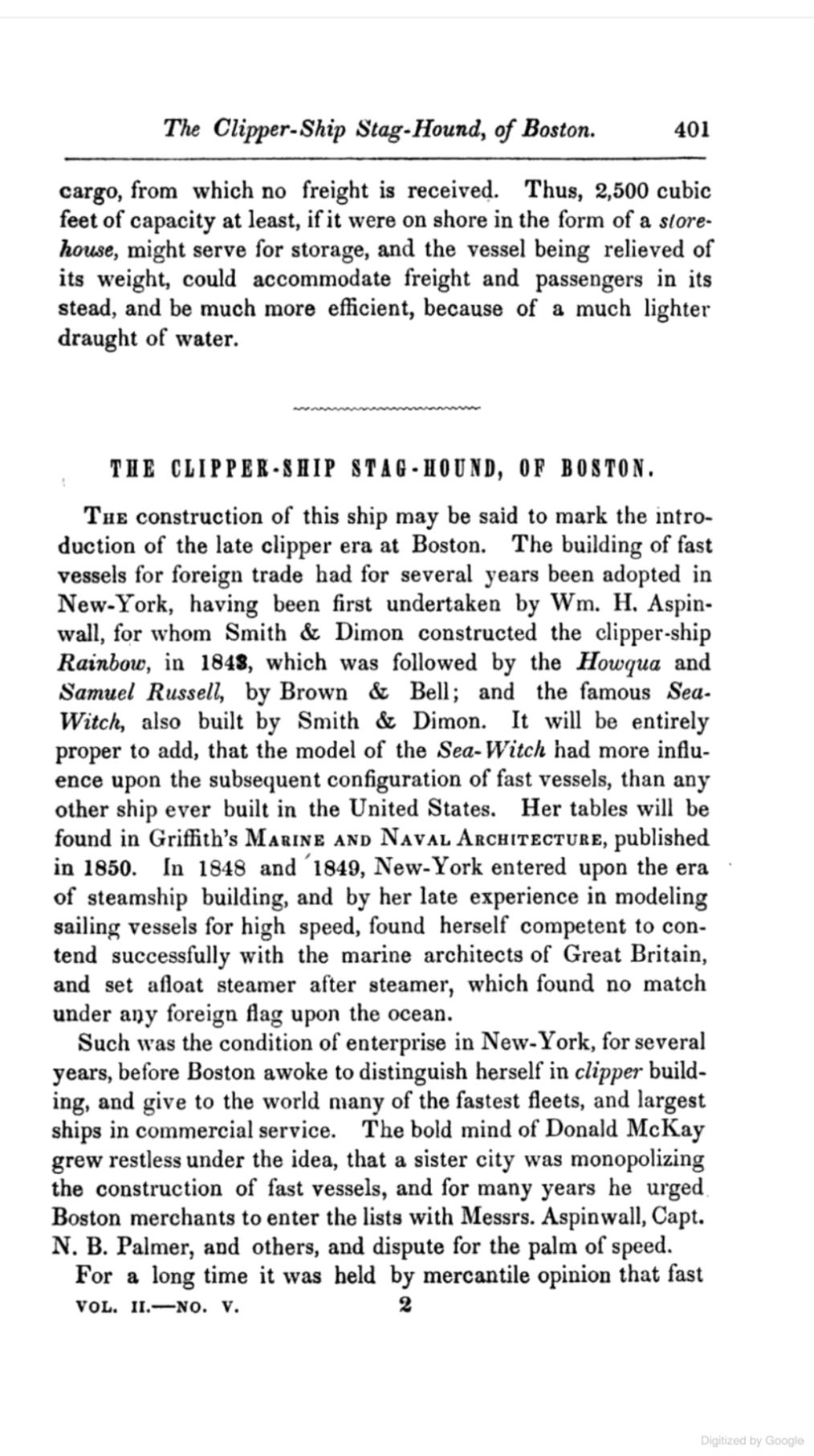

@rwiederrich Rob,

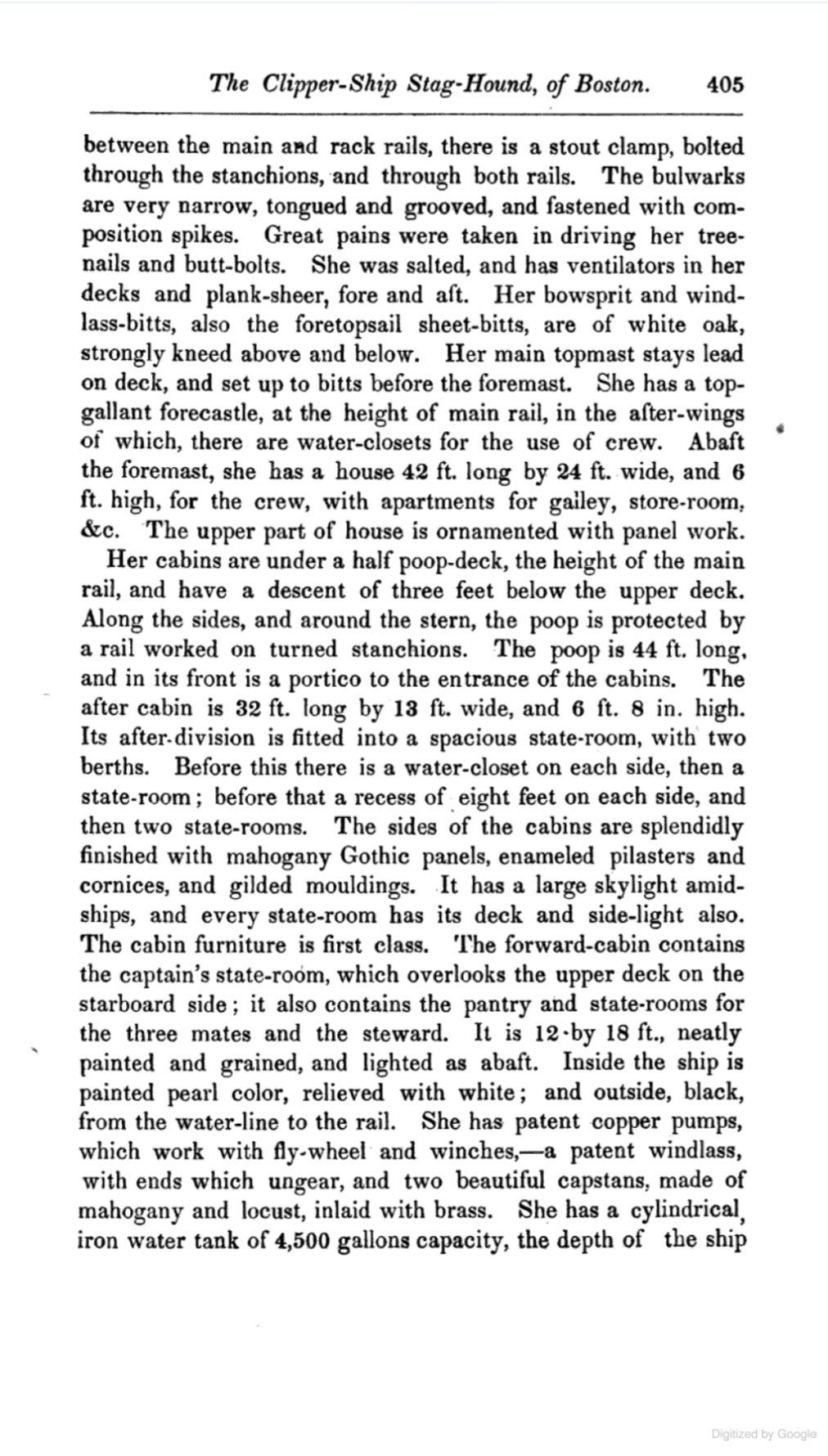

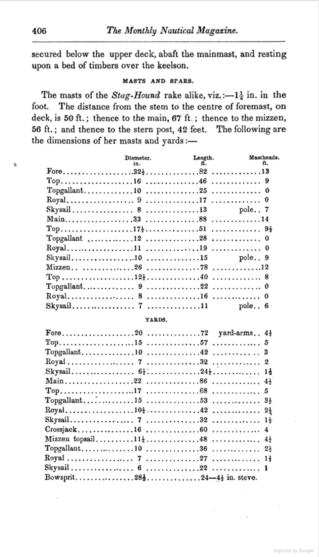

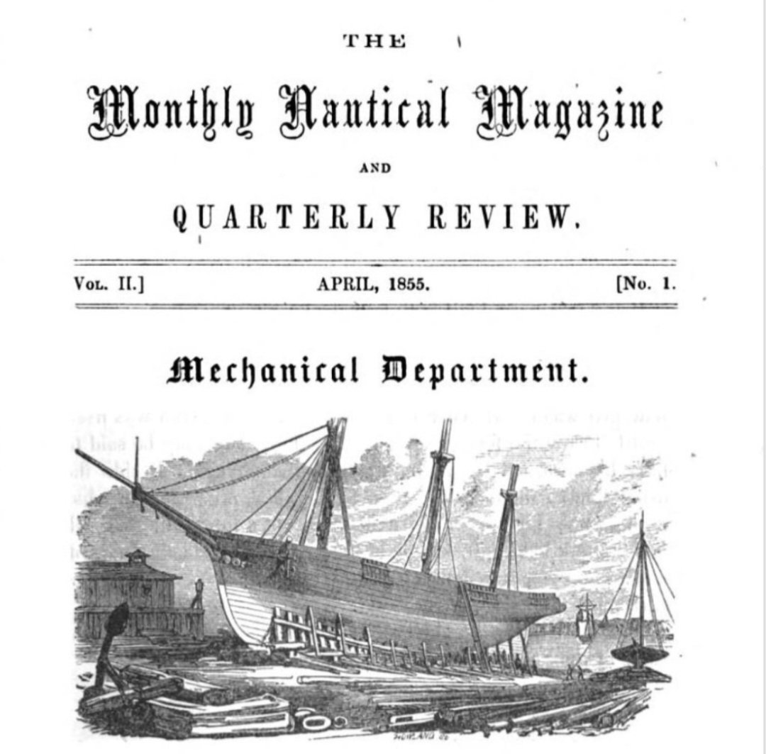

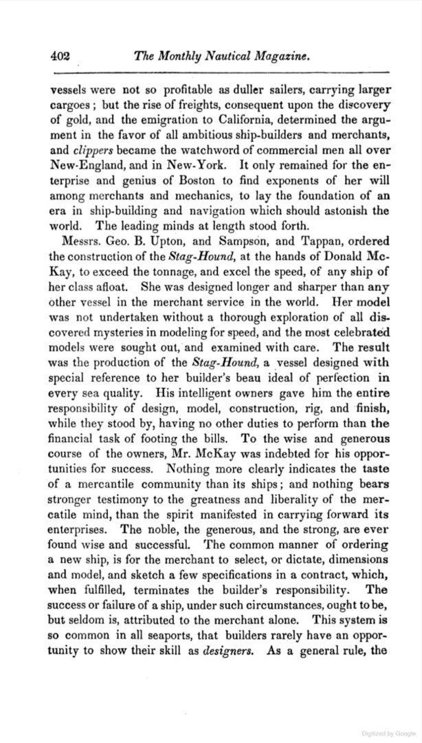

A Father’s Day gift of a sort for you. From Monthtly Nautical Magazine Quarterly Review, April 1855 there's an article on the 5 year old McKay California Fleet clipper Stag-Hound. While she had the fastest times among other clippers for the seasons she sailed in. I found a confirming spec that her masts raked 1 & 1/4" each instead of the erroneous 1 & 1/2" printed in the Boston Daily Atlas. There are 2 errata in this article: it's inconceivable that her keel clear of the garboards was 39" as that would leave an impossibly thin 7" for her inner keel. The specs in the Hall lists her outer keel as 30" leaving a more sensible 16" inner keel. In Cornelius McKay's handwritten specs lists her bowsprit steeve as 4.2" (19.34° inclination) not the more aggressive 4 & 1/2" (20.56° inclination) of this article. As we've discussed, using multiple historic sources results in greater accuracy.
@rwiederrich @Vladimir_Wairoa did terrific yeoman's work creating a Stag Hound bulkhead kit in the similar fashion he did so excellently for our completed Glory of the Seas project. Still, based on recent comparisons of Rob's model to statistical dimensions it appears like her deck profile is just a bit slim. So, I'm reapproaching this subject by reexamining plans we have available. The Hall fore and aft body and deck profile is easy to interpret as it's simply matching two halves. By flipping images it was easy to do. However, the Chappelle scan has proven to be a lot more problematic. Since it's taken from a two page book it is skewed in more than one way. Longitudinal lines have a slight "v" to them due to the curvature of the book. Vertical lines are also slightly raked at an angle as are the transverse lines in the hull and deck. These distortions could be the basis for an incorrect deck profile. Using a cell phone app, I've realigned all parallel lines to be true and almost all vertical lines as well, as accurately as possible. Now it remains to combine both fore and aft halves into a whole and create one full plan. At 1:96th scale a 266' long ship is 28 & 1/4th" between perpendiculars, knightheads (vertical line just behind prow) and stern taffrail. Her 40' beam at 1:96th scale is 5". Working with a revised set of prints properly aligned, I plan to create plans the ye olde fashioned way with precise measurements and referring closely to the Cornelius McKay model for her accurate sheer profile. I'm sharing my work here so if anyone wants to pursue this too, they're welcome to do so.

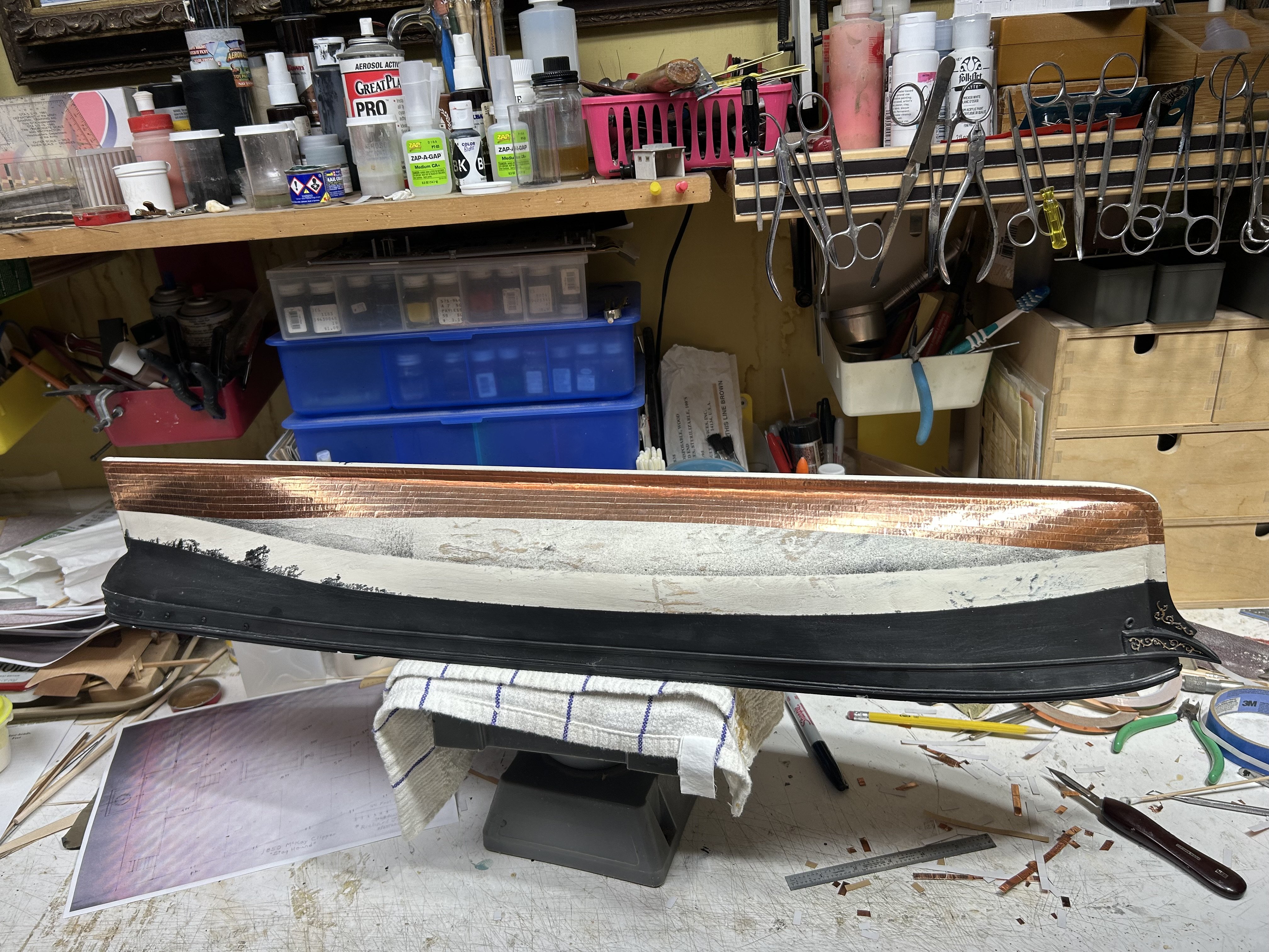

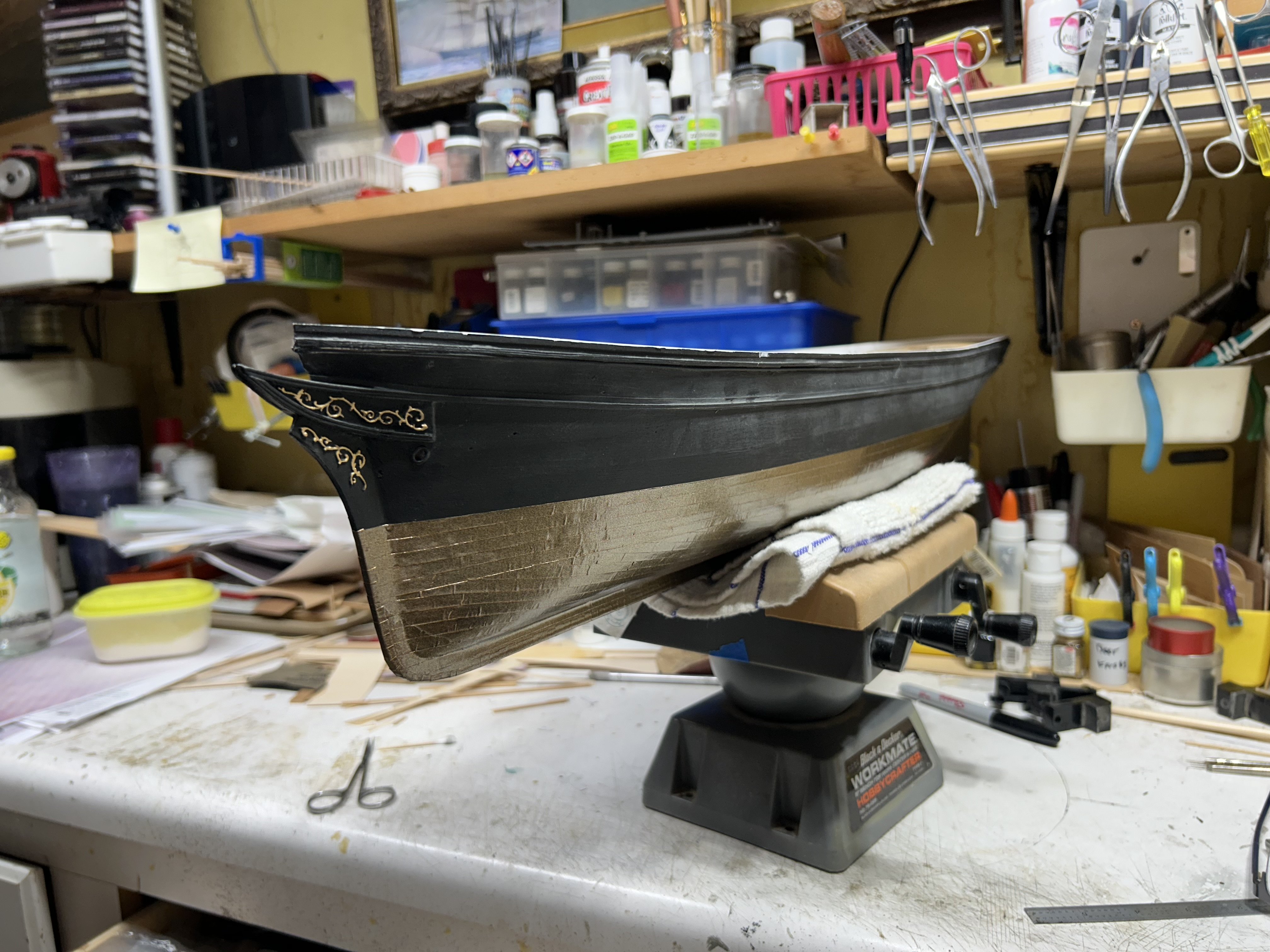

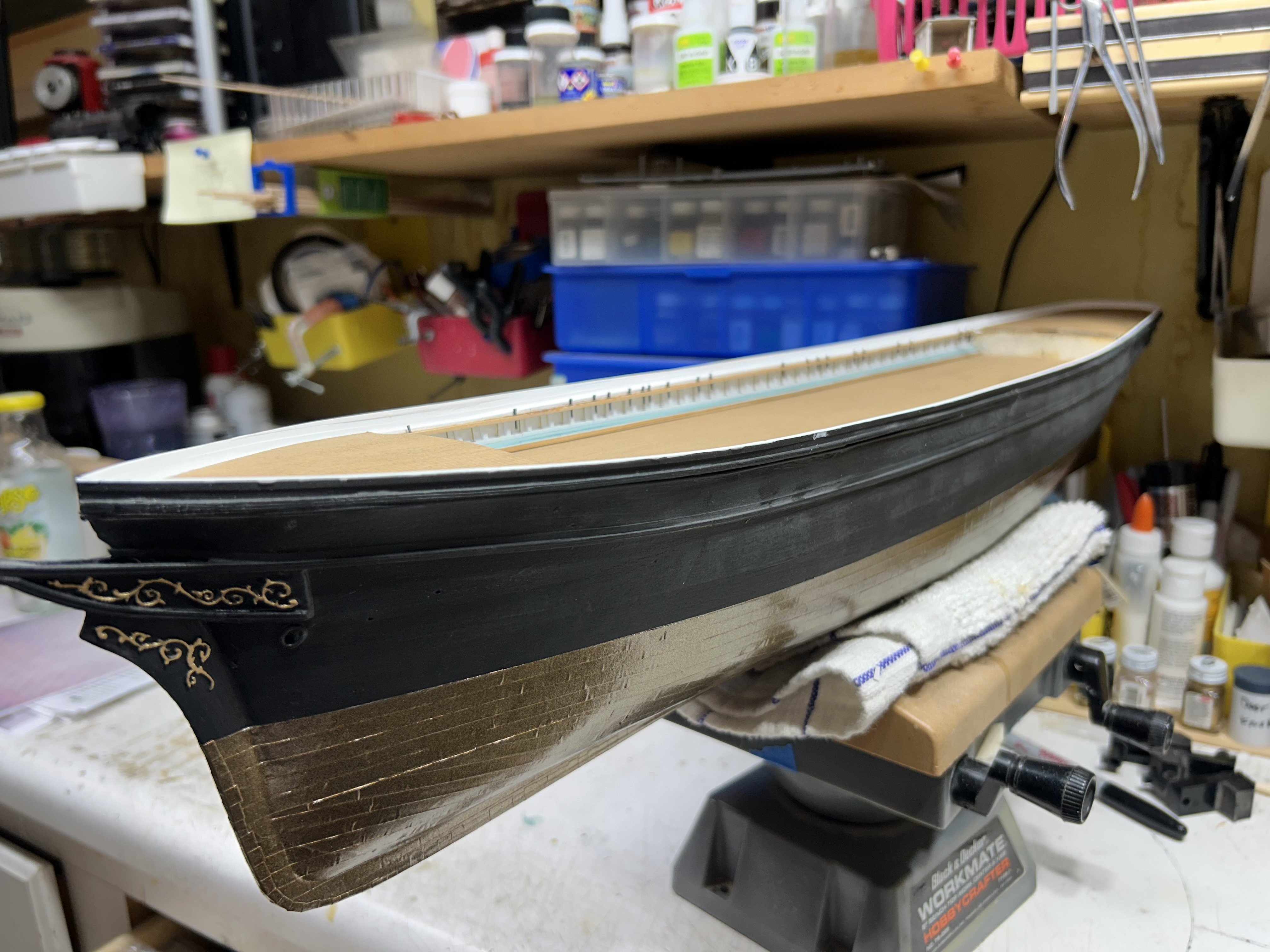

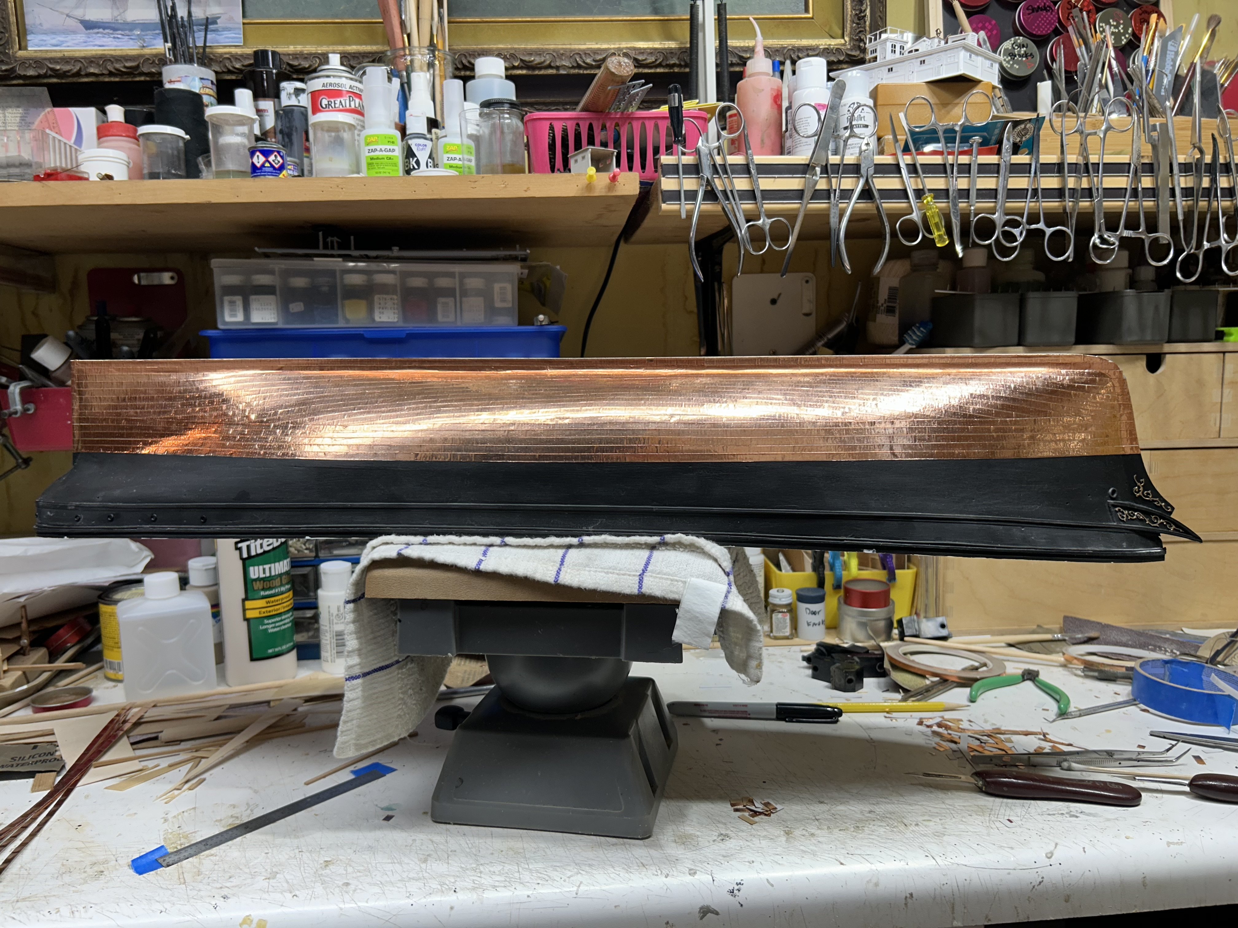

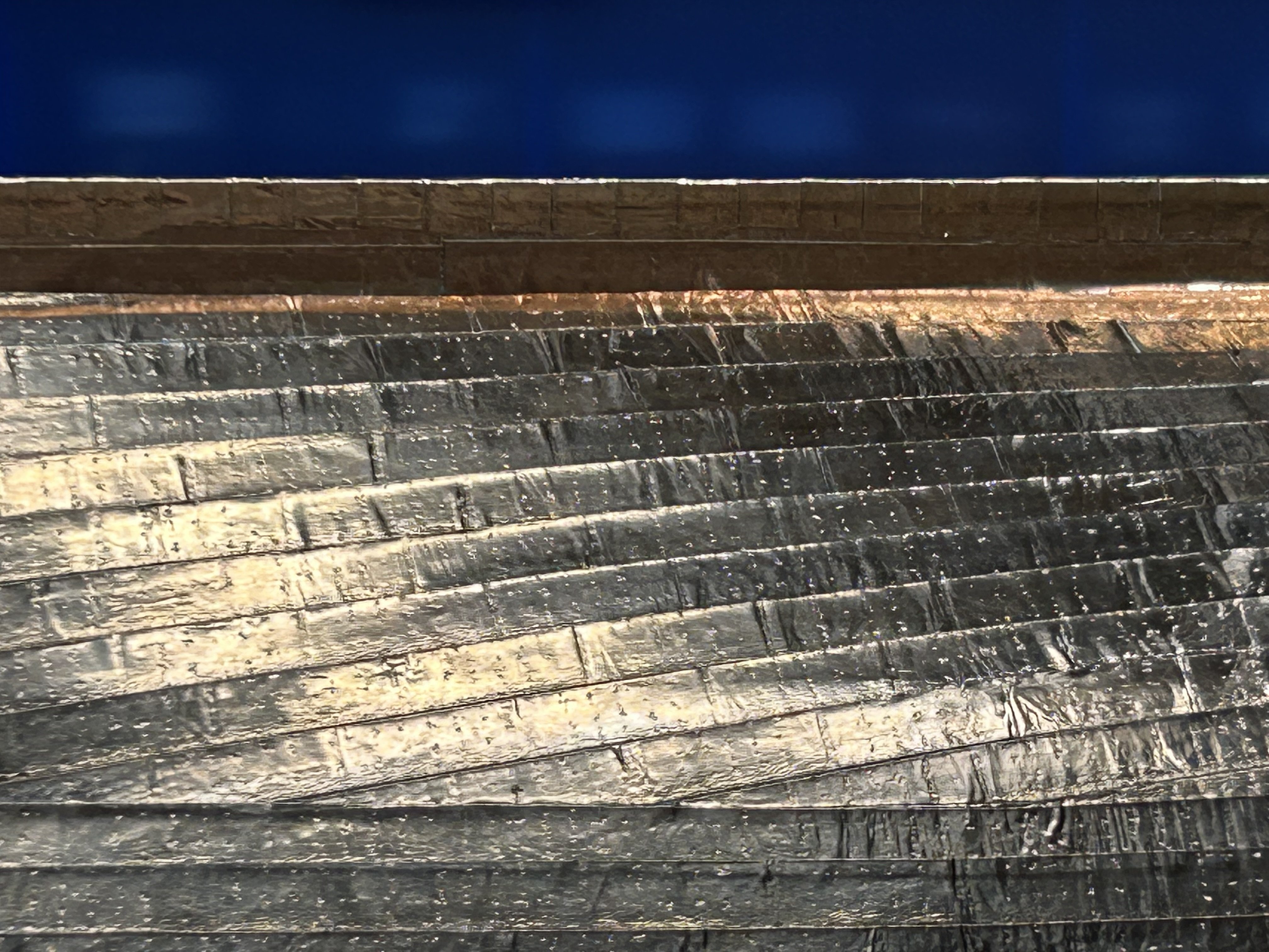

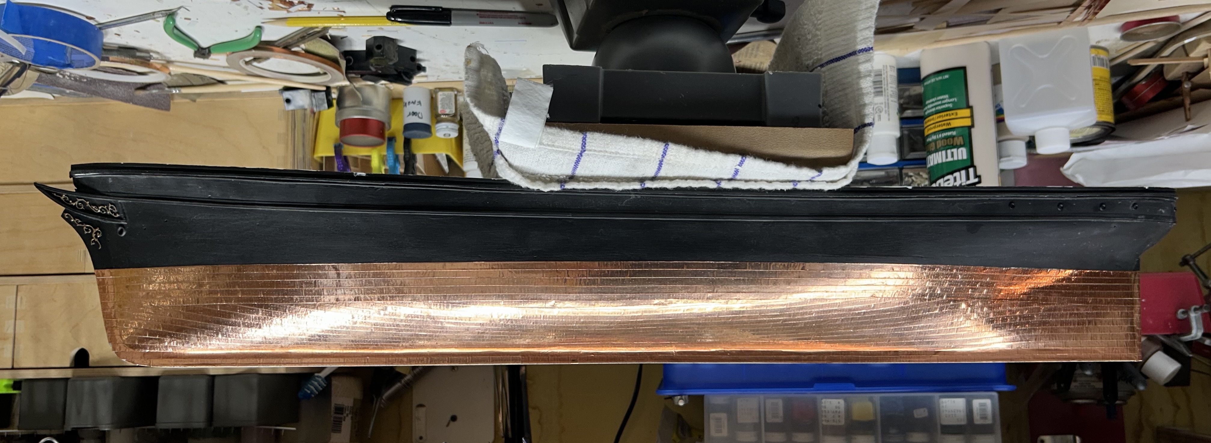

Finished up the coppering.
Rob
Current build:
Finished build:

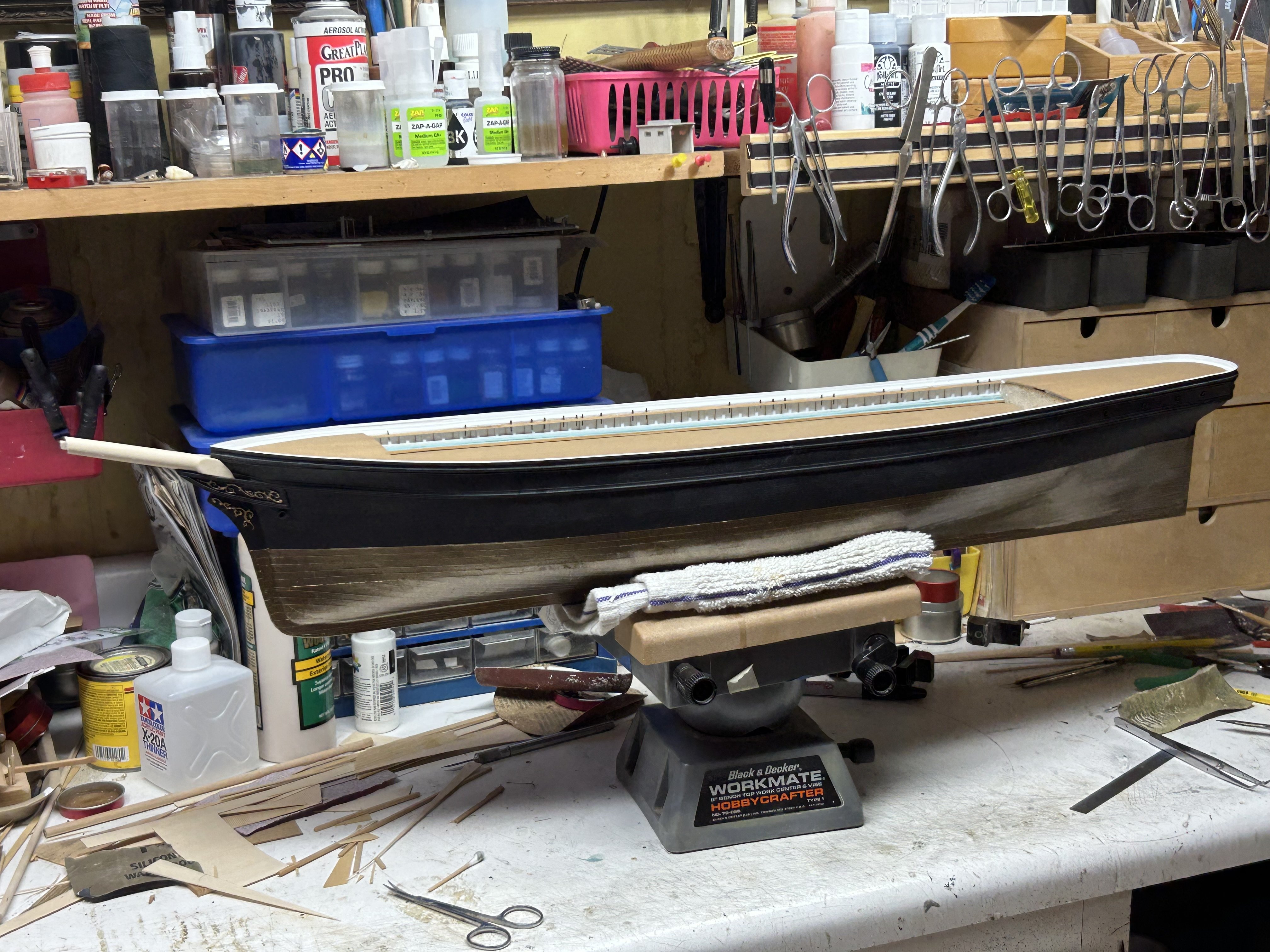

Masked and painted.
Rob
Current build:
Finished build:

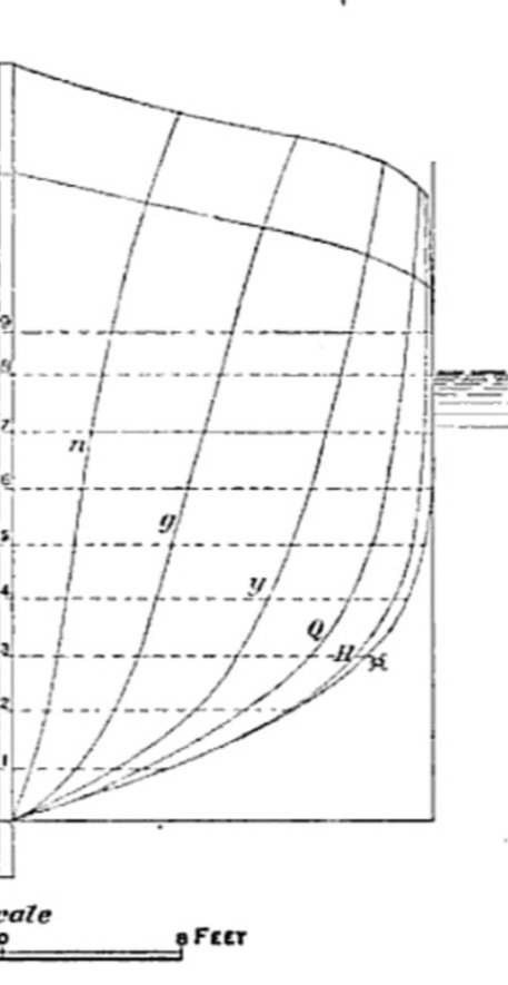

9 hours ago, ClipperFan said:
Rob, to quote a term from my favorite SciFi media... you're proceeding at "warp speed." Beautiful progress. When both hulls are compared, it's clear why 1869 Glory of the Seas is referred to as a medium clipper while 1850 Stag Hound has always been called an extreme clipper. Stag Hound has such a lovely yacht like profile, yet Donald McKay never launched another extreme vessel with such a radically designed 40" half hull. In fact, beginning with Flying Cloud second extreme clipper of his California Fleet, he gradually flattened his floors until he finally arrived at the 8" half floor on Glory of the Seas.
She is a much sleeker shallower model for sure.  I appreciate your investigation into the more accurate hull contours....but I ain't going back and since we know the narrowest point was only 24.5ft...it is only within the bowing of her hull from there to her max breadth of 40ft that can be contested.  The images never show exactly what you want to show and they ALWAYS reveal what you don't want to show....flaws in detail and workmanship.

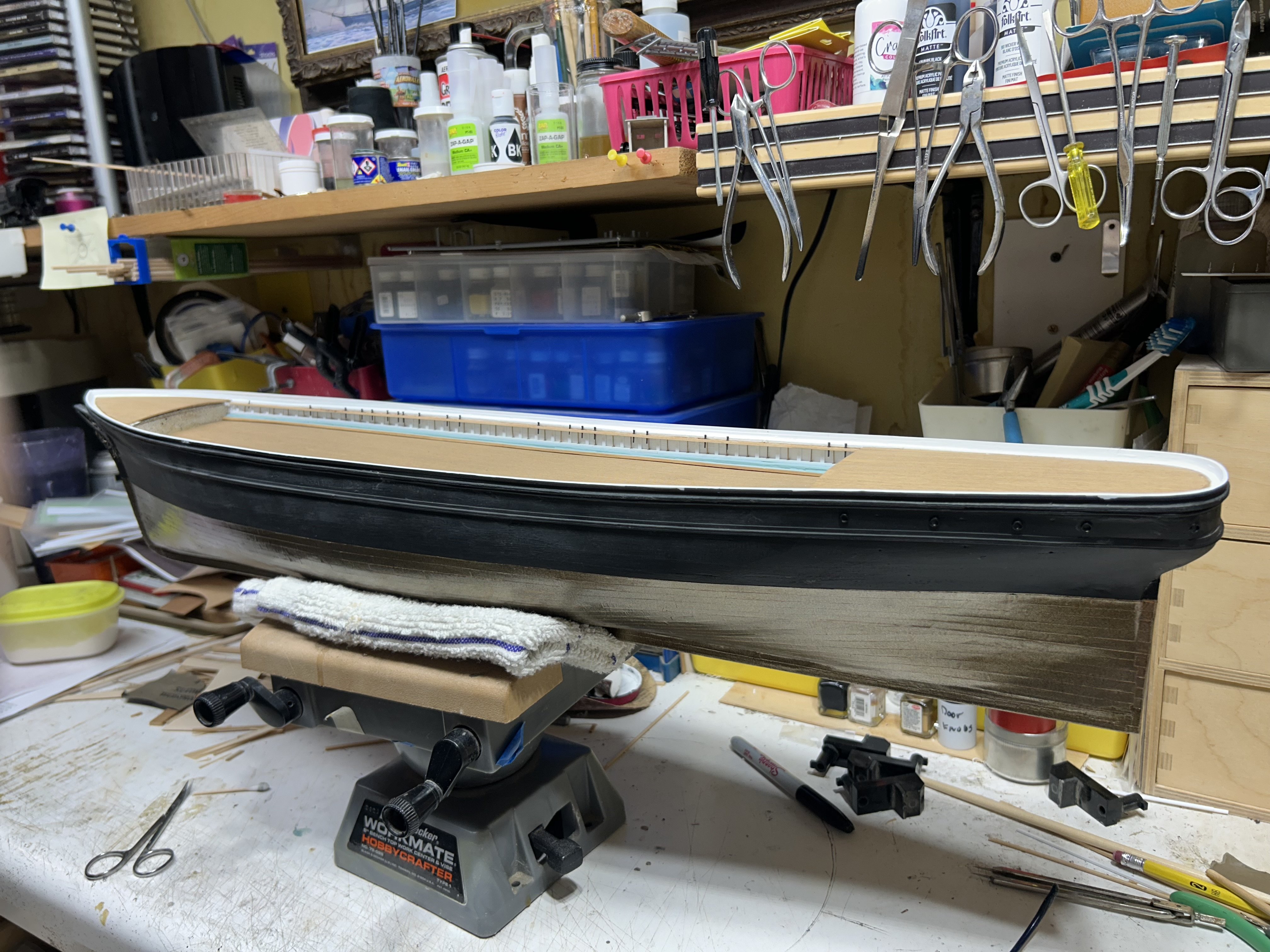

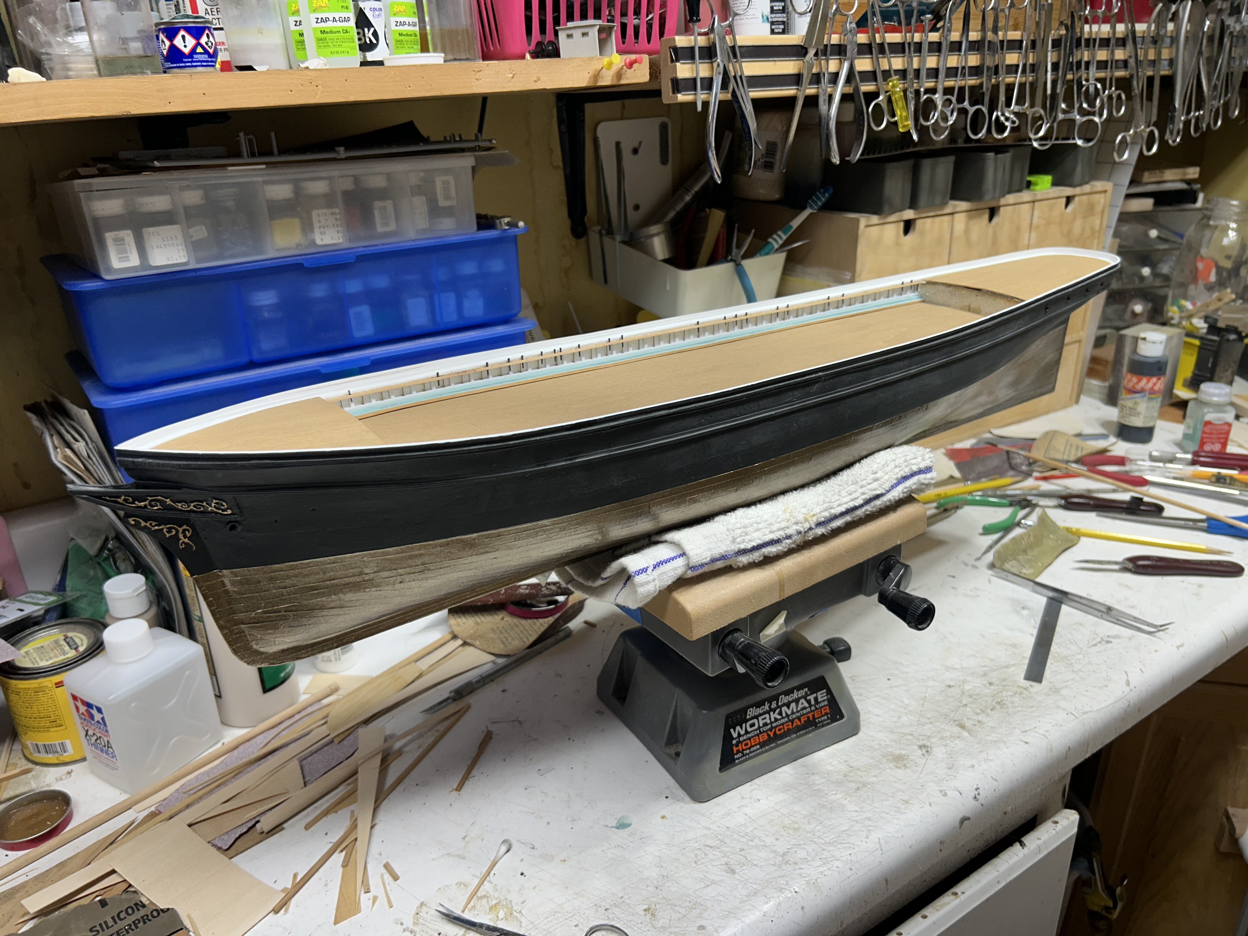

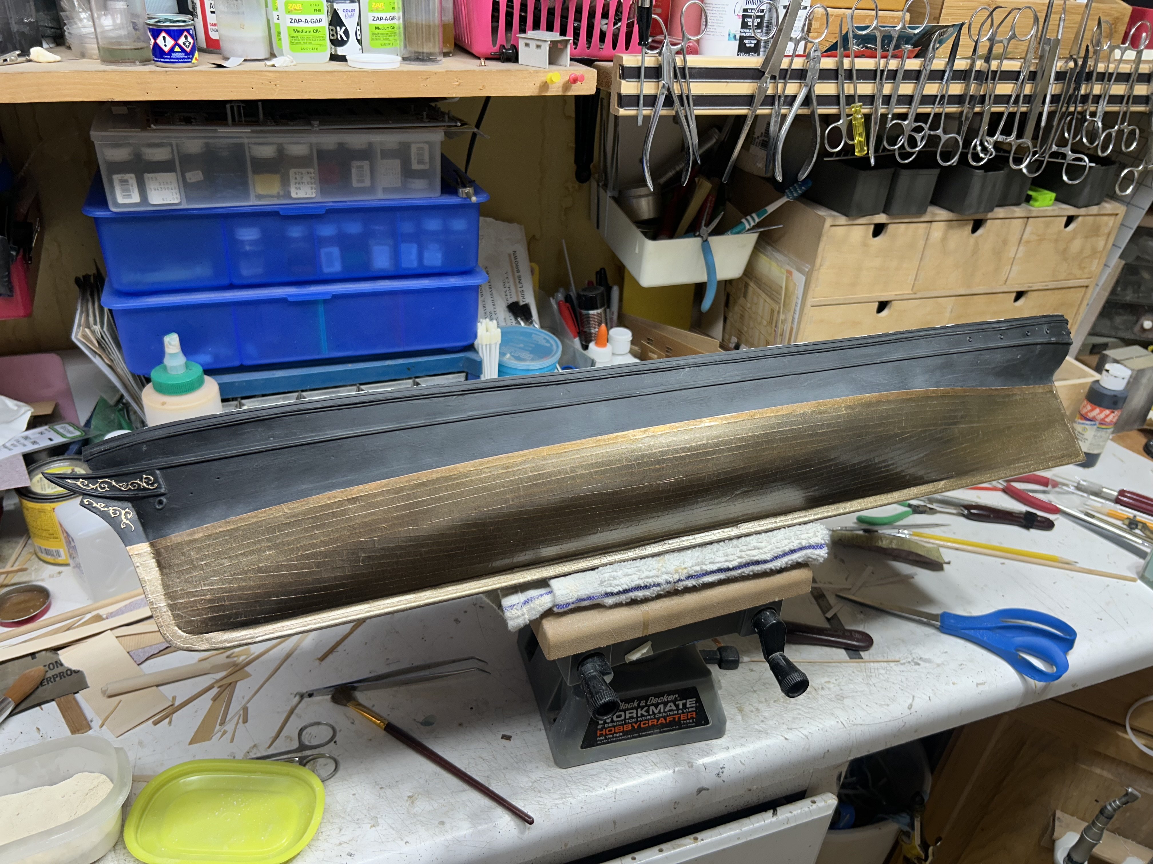

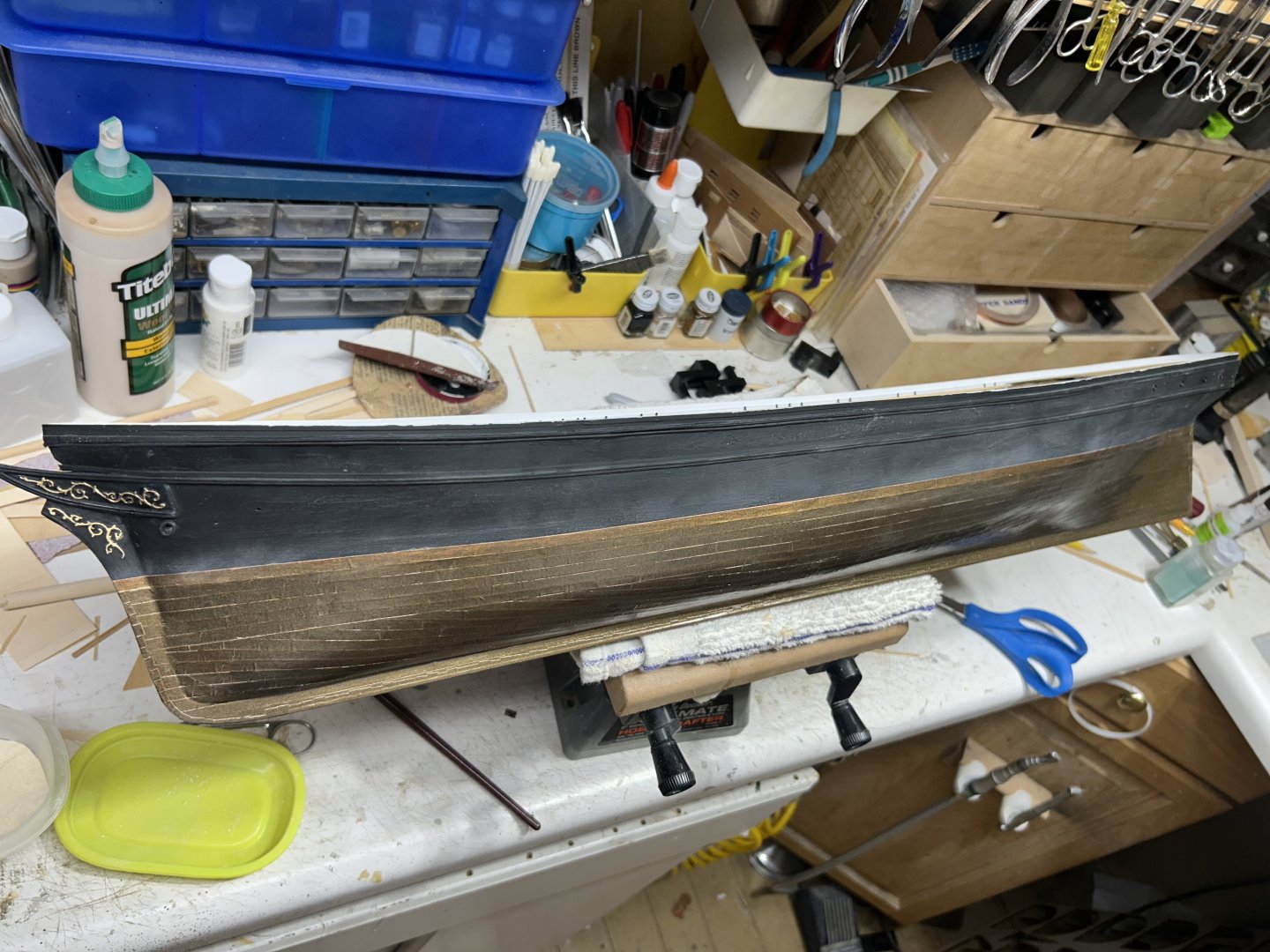

Added a little weathering along the waterline.
Rob
Current build:
Finished build:

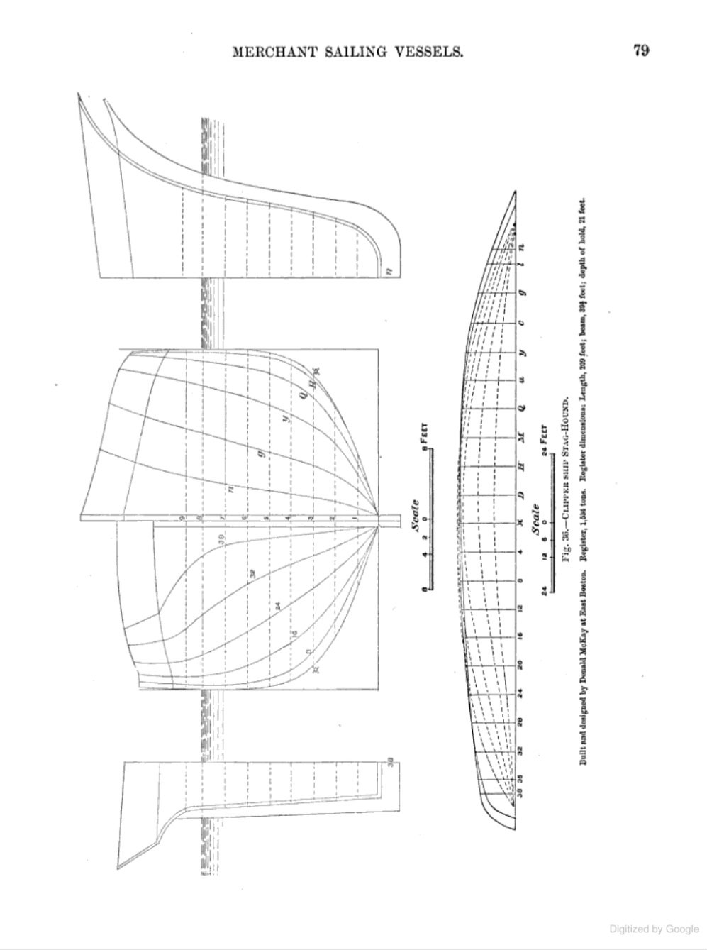

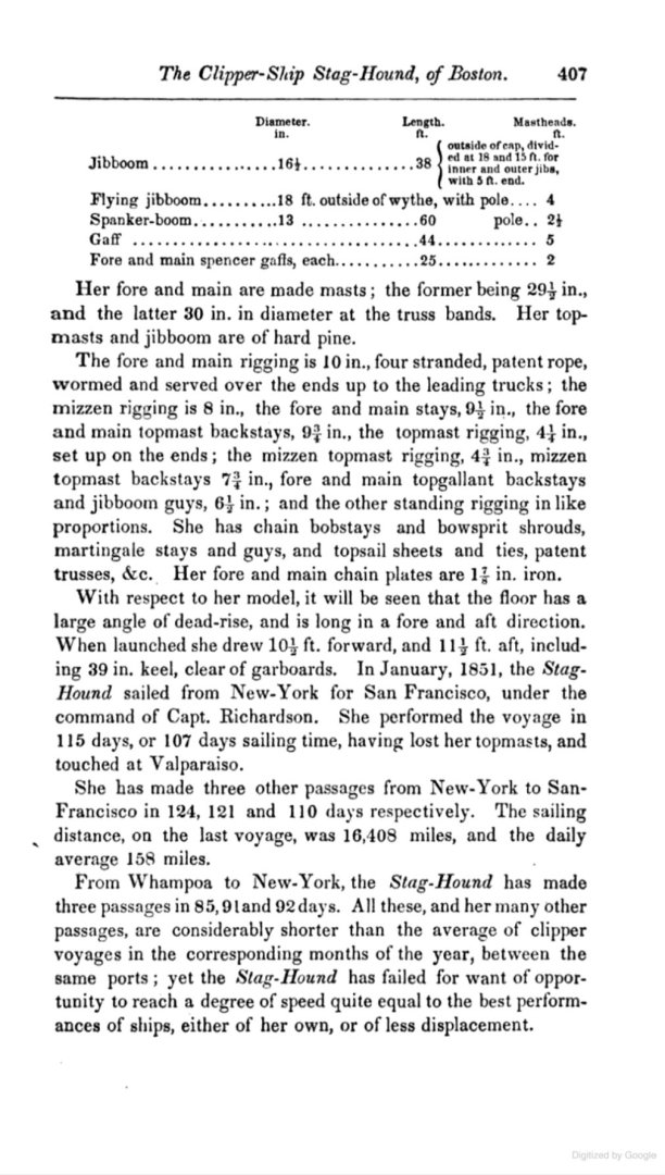

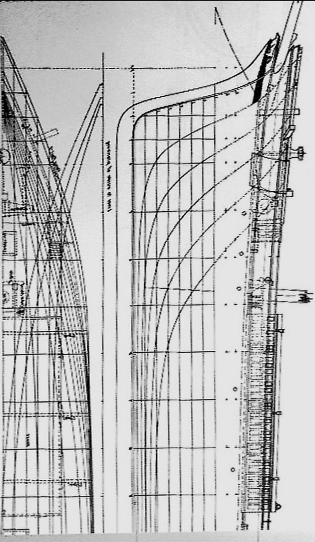

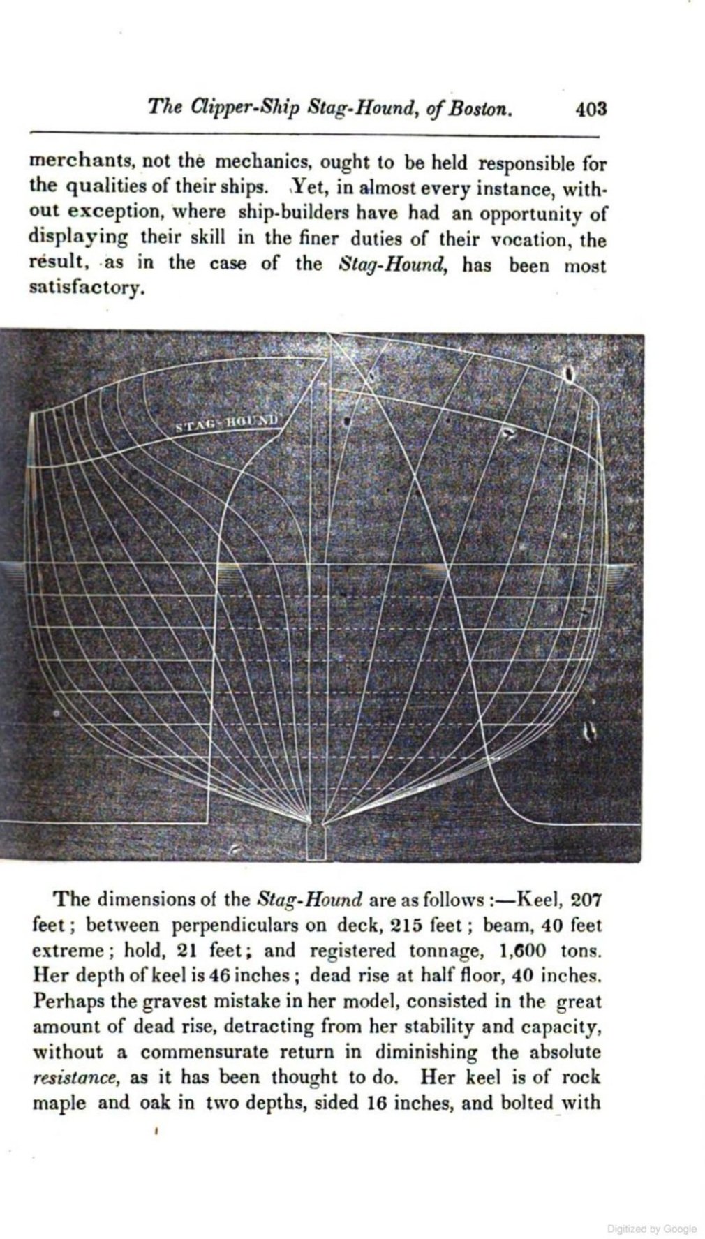

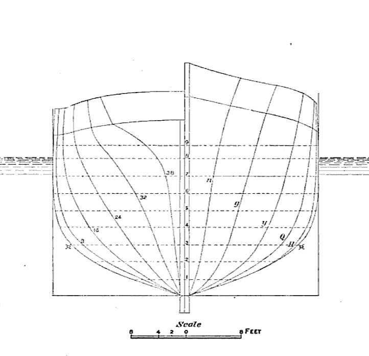

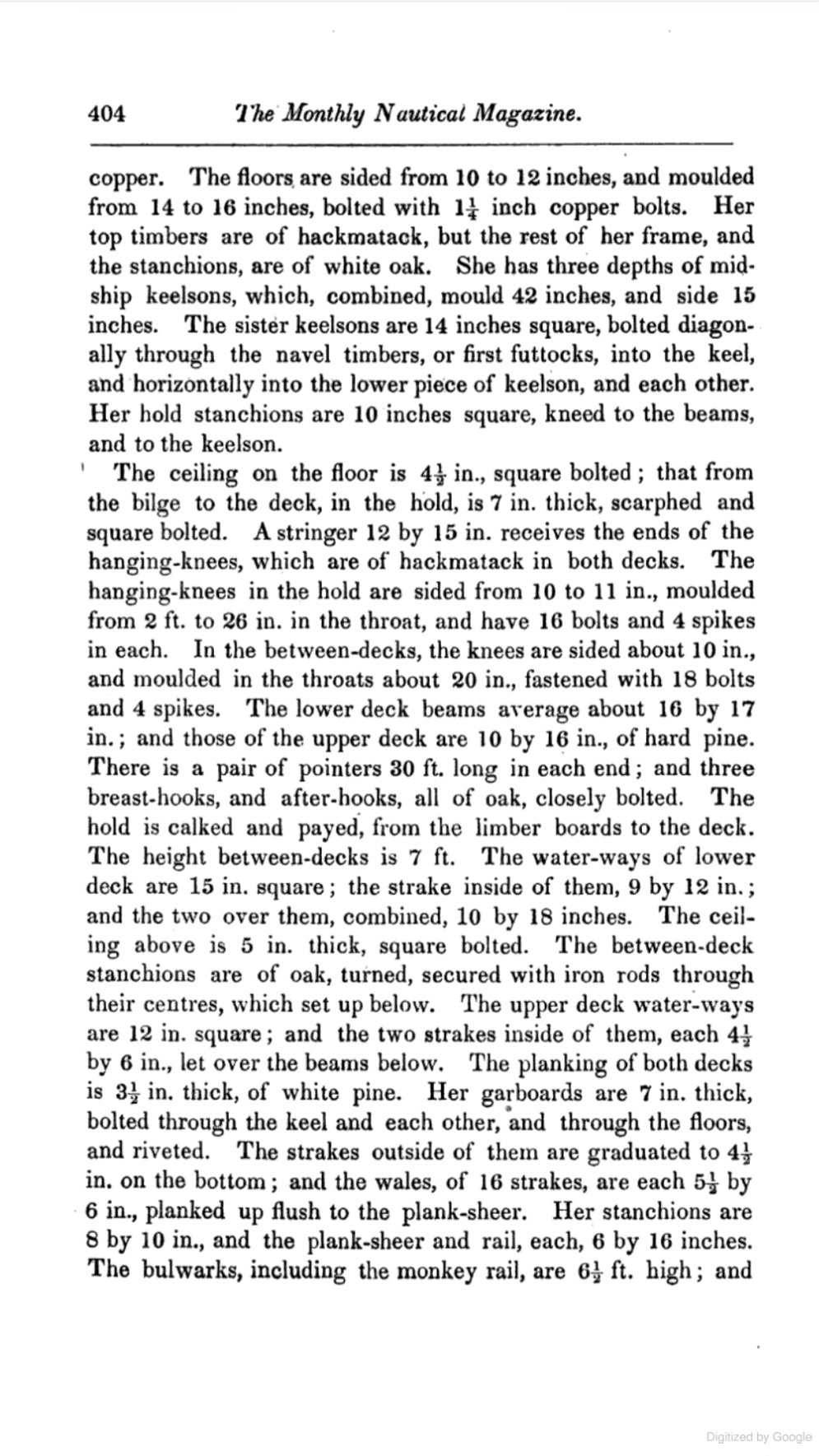

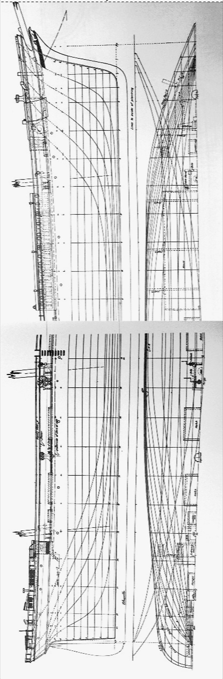

Sorry, ClipperFan, but I don't agree that the published dimensions are inconceivable. I'm not saying that they were correct, just that they could have been correct.
A 46-inch total depth of keel, with 7-inch thick garboards and 39 inches of the keel outside those garboards would mean that the floors sat flush across the top of the keel. That wasn't the universal way of building a wooden ship but it was one way. The other option was to notch the floors so that they hung over the sides of the keel as far as the inboard edge of the rabbet (either of which options could have the added complication of a deadwood between keel and floors). Notching the floors meant starting with a very deep, very expensive piece and then cutting away strength where it was most needed, so there was a major incentive to lay the floors flat on top of the keel, if that could be arranged without either critical weaknesses in the structure or extra costs elsewhere.
Note that the published report says that the garboards were through-bolted (each bolt passing through both garboards, edgewise, and the keel between). Thus, there was no need for solid timber to take fastenings driven from outboard, through the garboard and into the keel -- though I don't doubt that the garboards were trunnelled (from outboard) to the floors, which themselves were bolted to keel and keelson. Then again, all those copper bolts will have been expensive, not to mention the labour for boring the bolt holes and driving the bolts.
Trevor
13 hours ago, Rick310 said:
Looking really good Rob!!
Rick
Thanks Rick. I only had time to fiddle with some weathering......  I have to make all the chainplates first and that means some metal work.
Rob
Trevor
Great conversation....and if we can take anything away from this information...it would be,  *How did they do all of this drilling (accurately) in a timely manner, without a modern drill motor and spade bit*?😲
Wooden ships and IRON men.......
Rob
Last year, I got to drive 12-inch bronze carriage bolts lengthwise through 4-inch square teak sheet bits. The bits were glued from separate halves (4 by 4 teak being unobtainable here), so I started the bolt holes on the router table, making half-round grooves before gluing, then cleaned them up with an auger bit before trying to get the bolts through. It was still terrifying! What if the bolts stuck when half way through? There would be no way to get them out again. Fortunately, with the right lubricant and the capability to screw the bolts through, all went OK.
But compare that to the drift bolts (no screw threads) that MacKay's men drove! Worse, consider Great Western, the first of the big purpose-built Atlantic steamers. She had four rows of iron bolts driven fore-and-aft through her floors and futtocks, the bolts in each row overlapping one another. Each bolt was 1.5 inches in diameter and 24 feet long.
How on Earth did they bore the holes precisely enough to be sure that the bolts would not bind long before they were driven home? Come to that, how do you pound the end of a 24 ft bolt with a sledge hammer and drive it into its hole, without the exposed part of the bolt bending? And yet the job was done.
Trevor
Trevor
It's all a mystery.....or...where there's a will...there's a way.   Some long holes were pre-drilled,  then the rod was heated and was pushed through, burning the way through, trueing the hole.  However it was done it was done accurately and quickly.  Staghound was built in only a couple of months.
Rob
