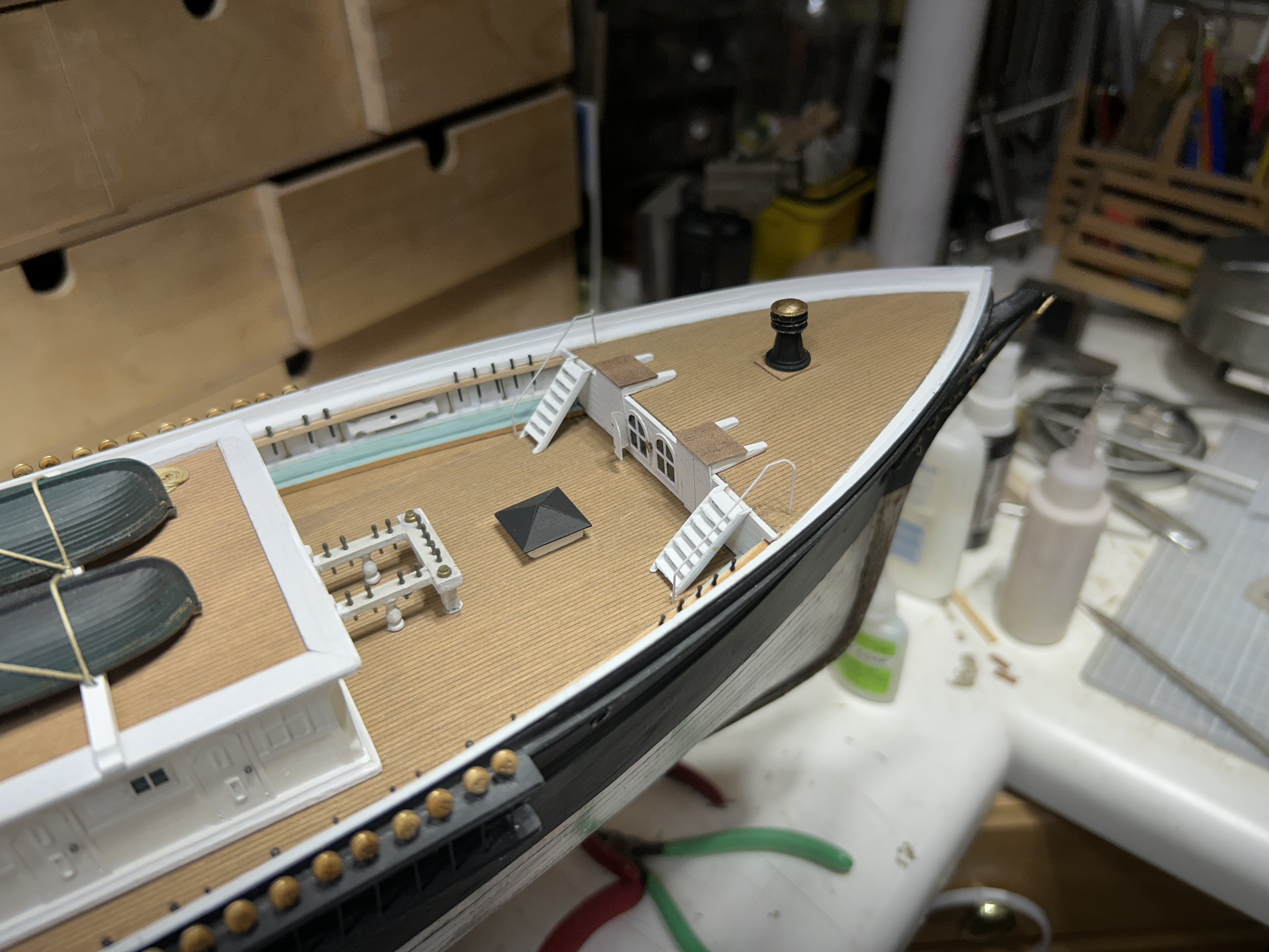

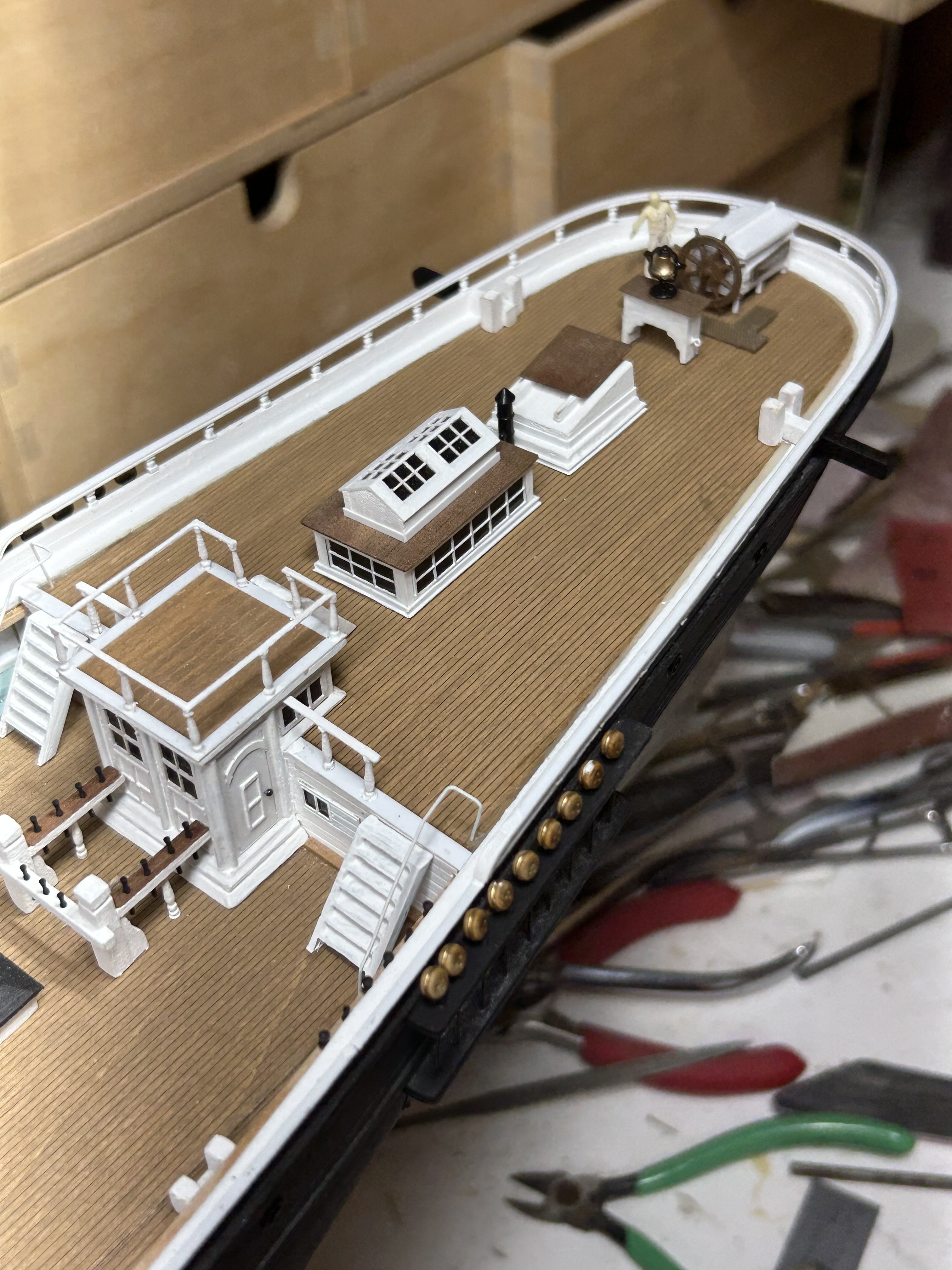

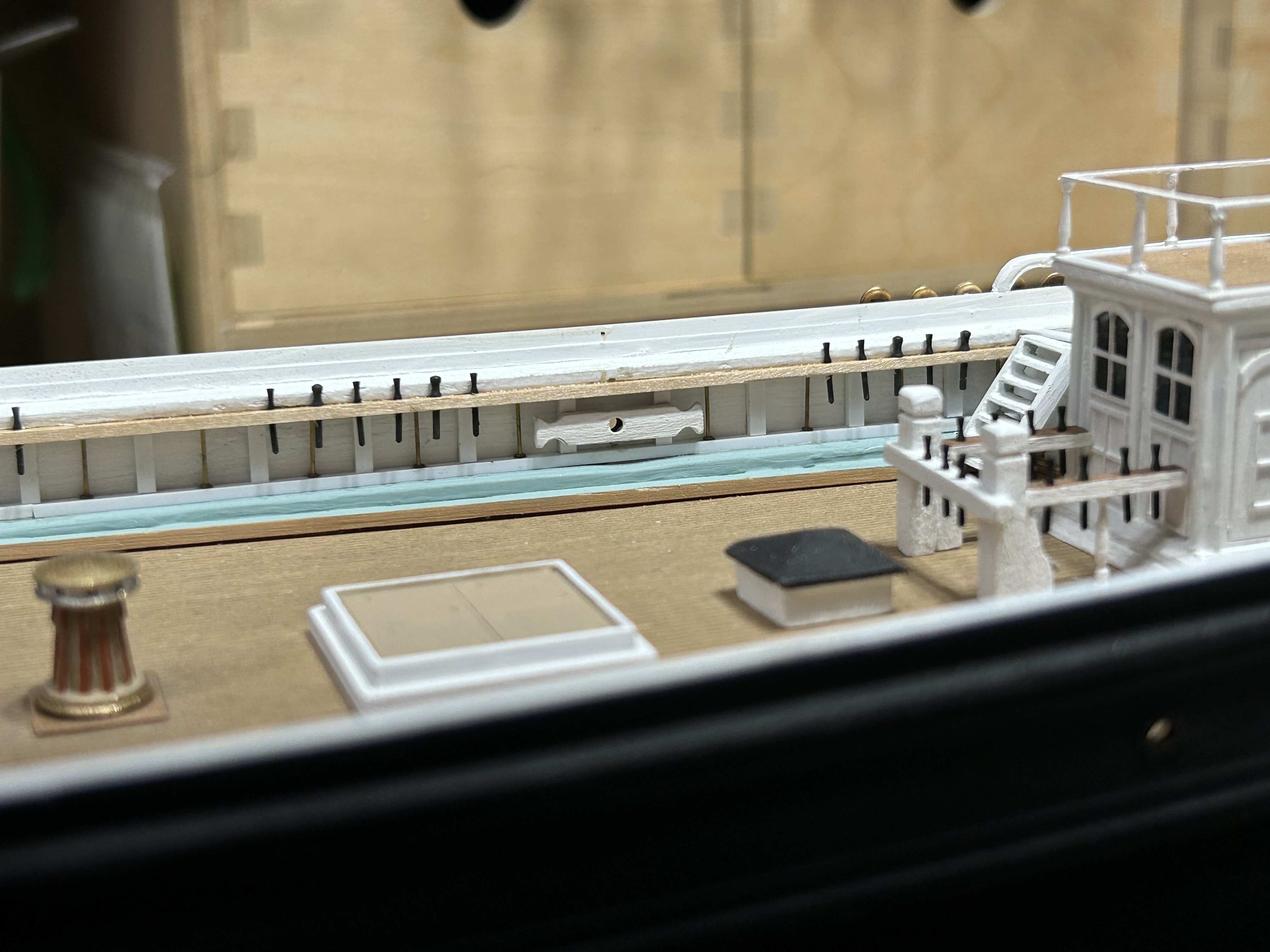

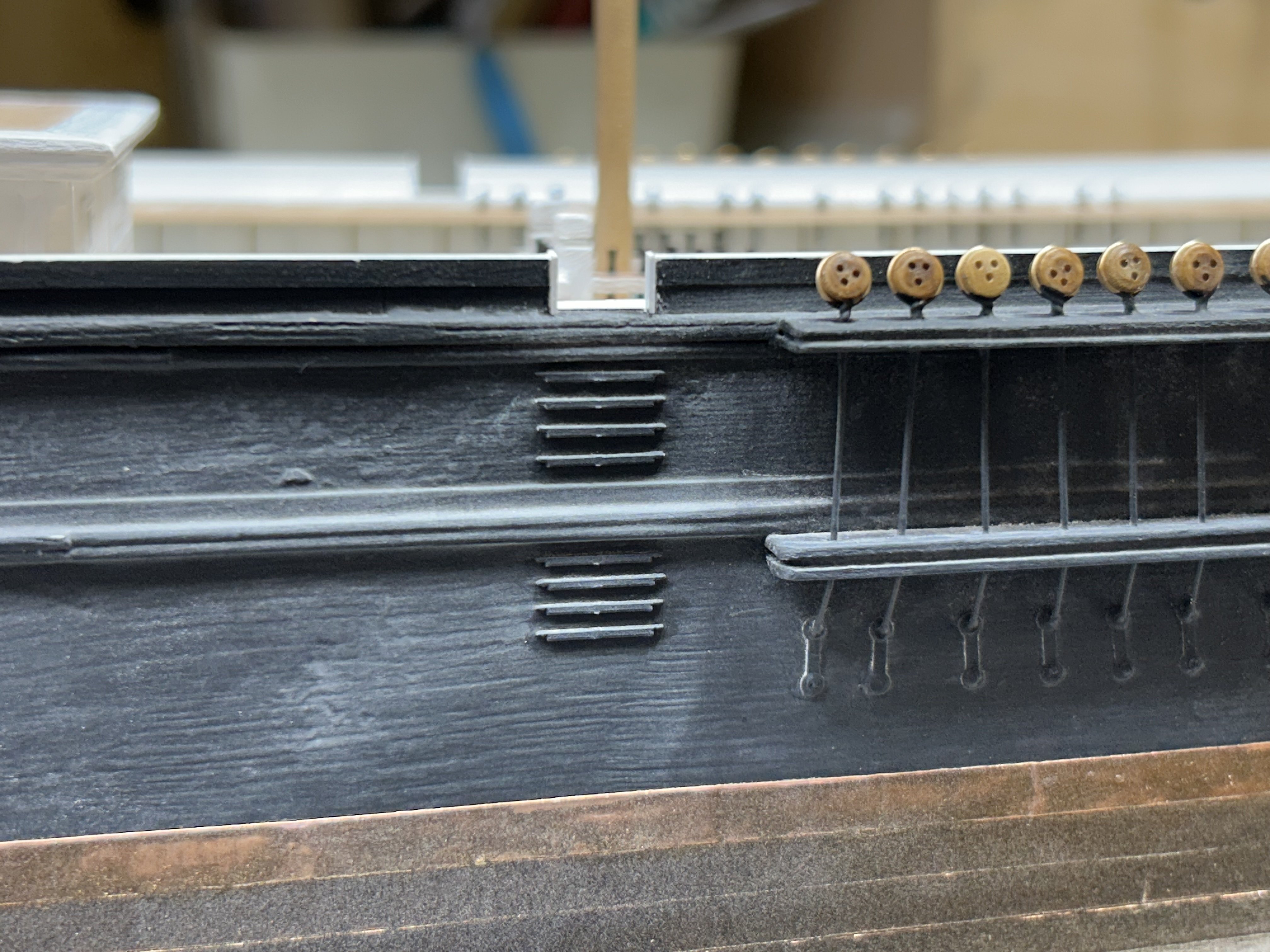

I did just a little today thus far.   Added the port access way and steps.   Not all of McKay ‘s ships had these access ways.
Rob

Thanks Rick.  Those steps are tiny little things.
Rob

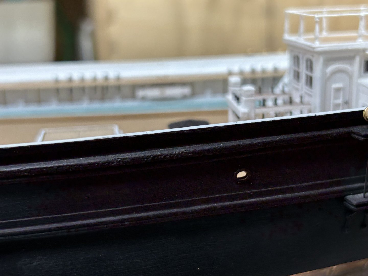

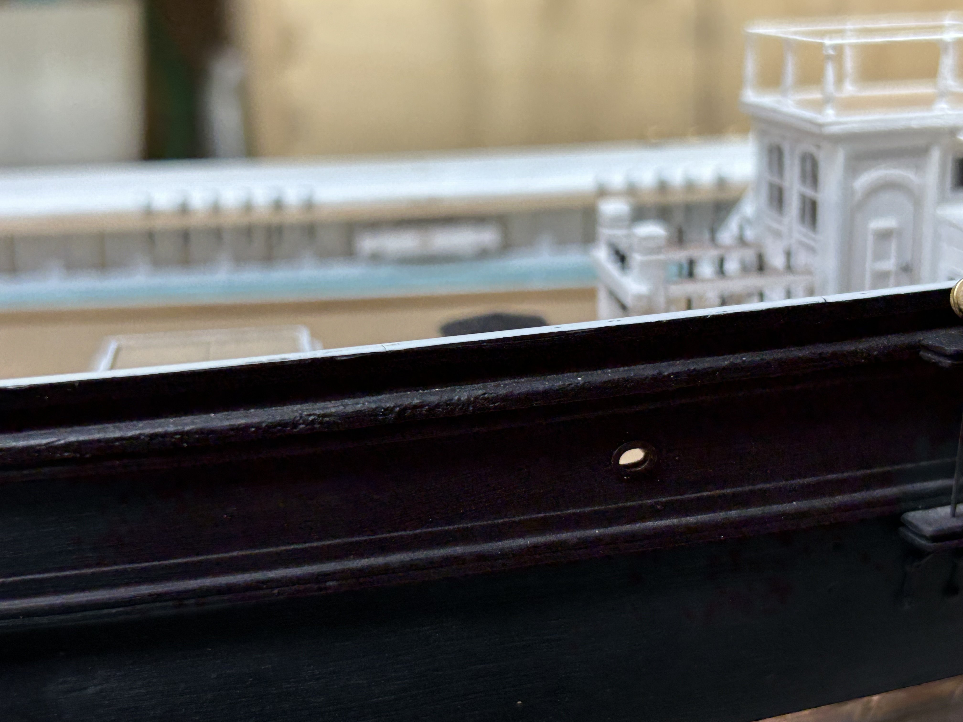

Thanks Rich.  Moving slowly along the hull...adding details, I just decided it was next.  Working from inside the hull I will drill the holes for the mooring fairleads...locating them, then finish up from the outside adding their sleaves.  I then can place the cavils and bitts.   Things have been a bit slow.  I'm prepping to remove the veranda off of our front porch, because it leaks. That will be an all day, Saturday job.  Repairing and reroofing the front porch, and rerailing the French doors.  Our master bedroom has  large French doors that go out onto the veranda.  I have also been helping my wife remodel the bedroom...prior to this.

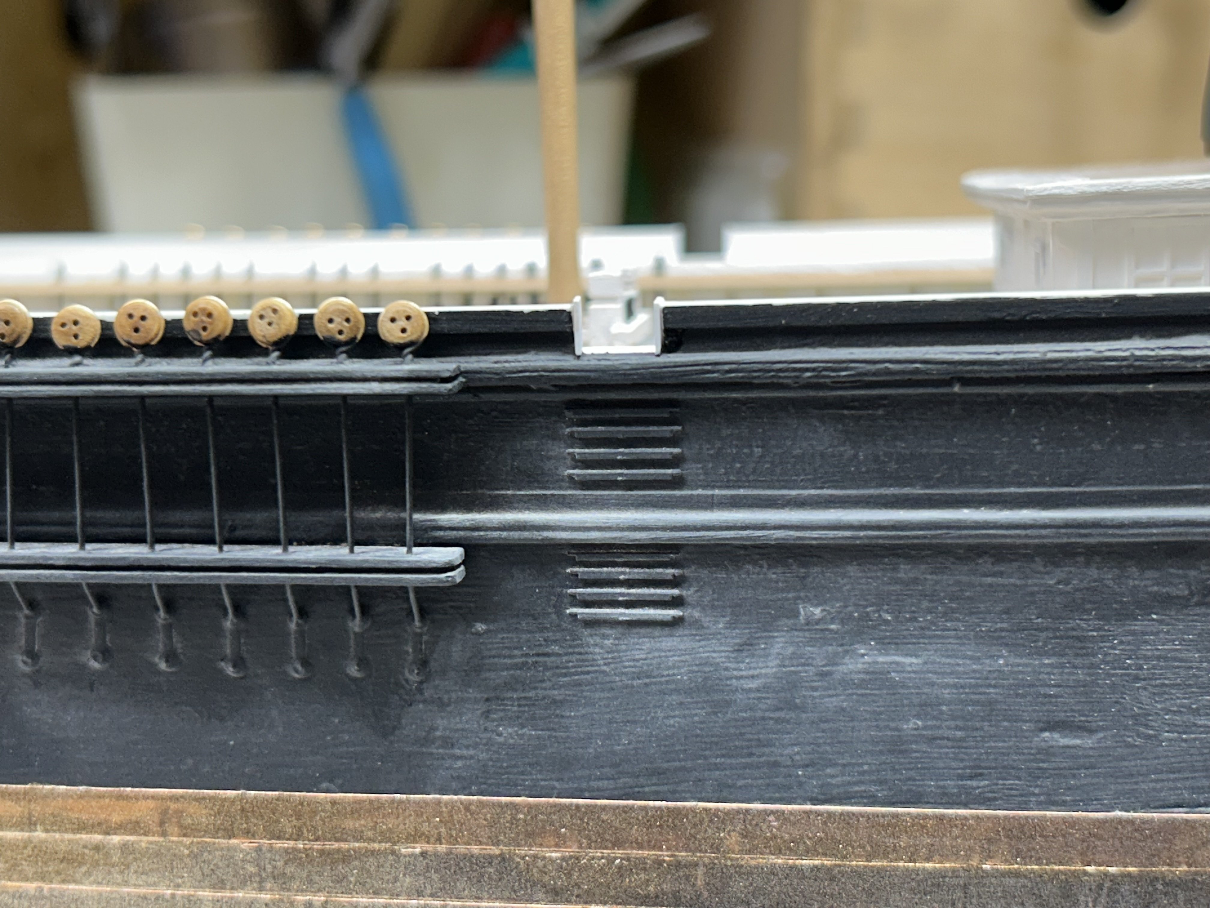

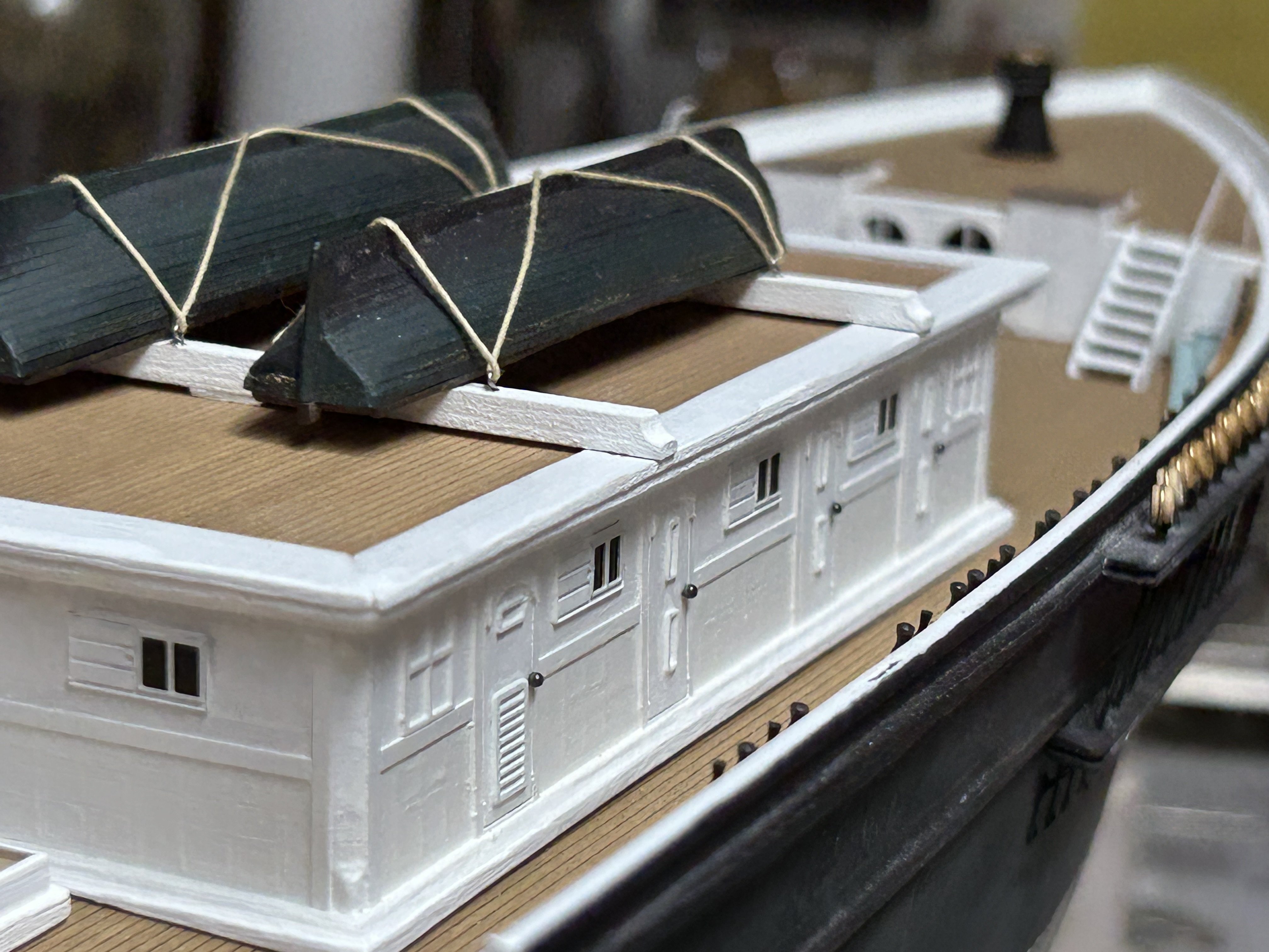

Finished adding the steps on the port side and finished the starboard side too.
Rob

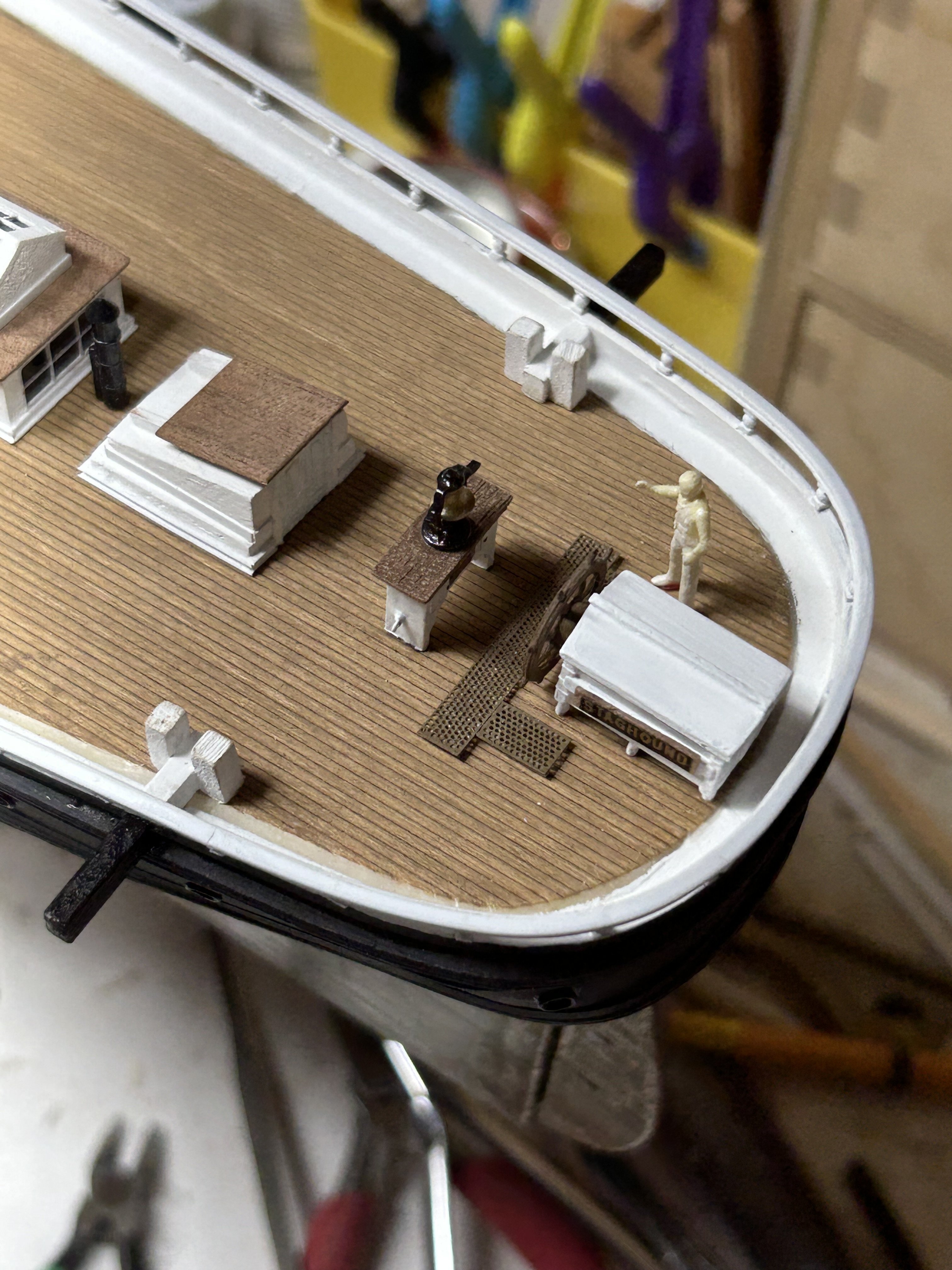

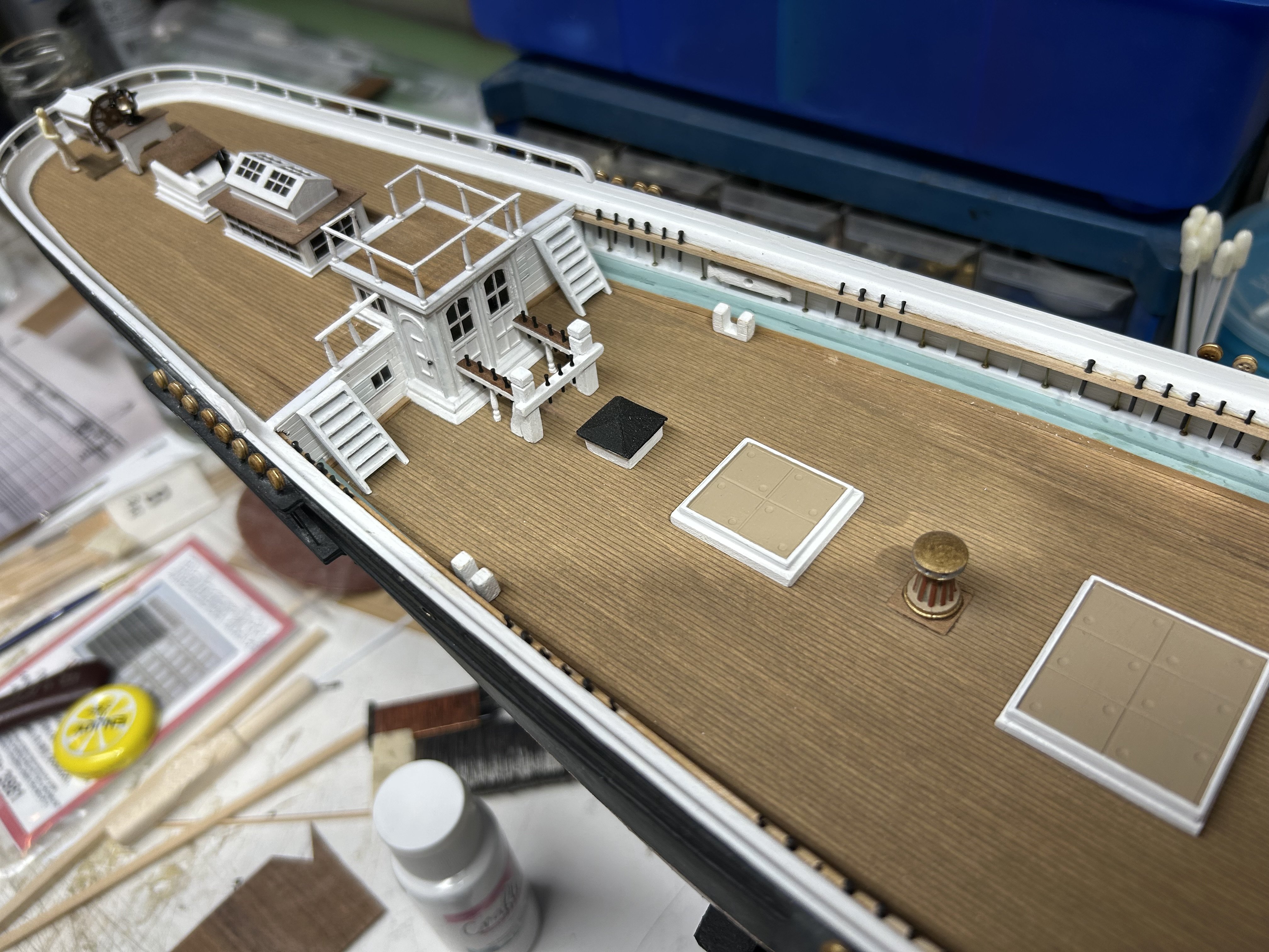

Added a few more details.
Rob

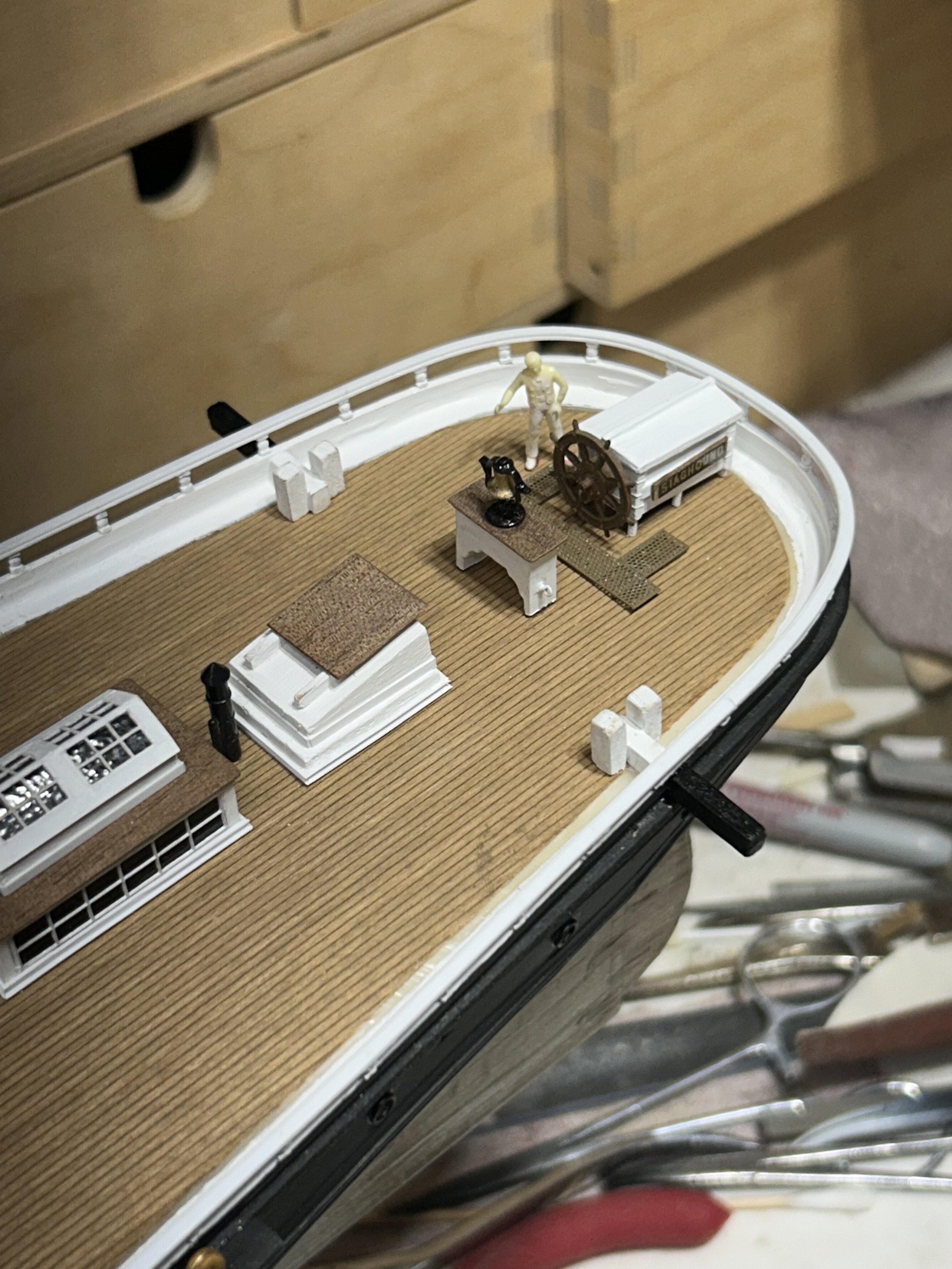

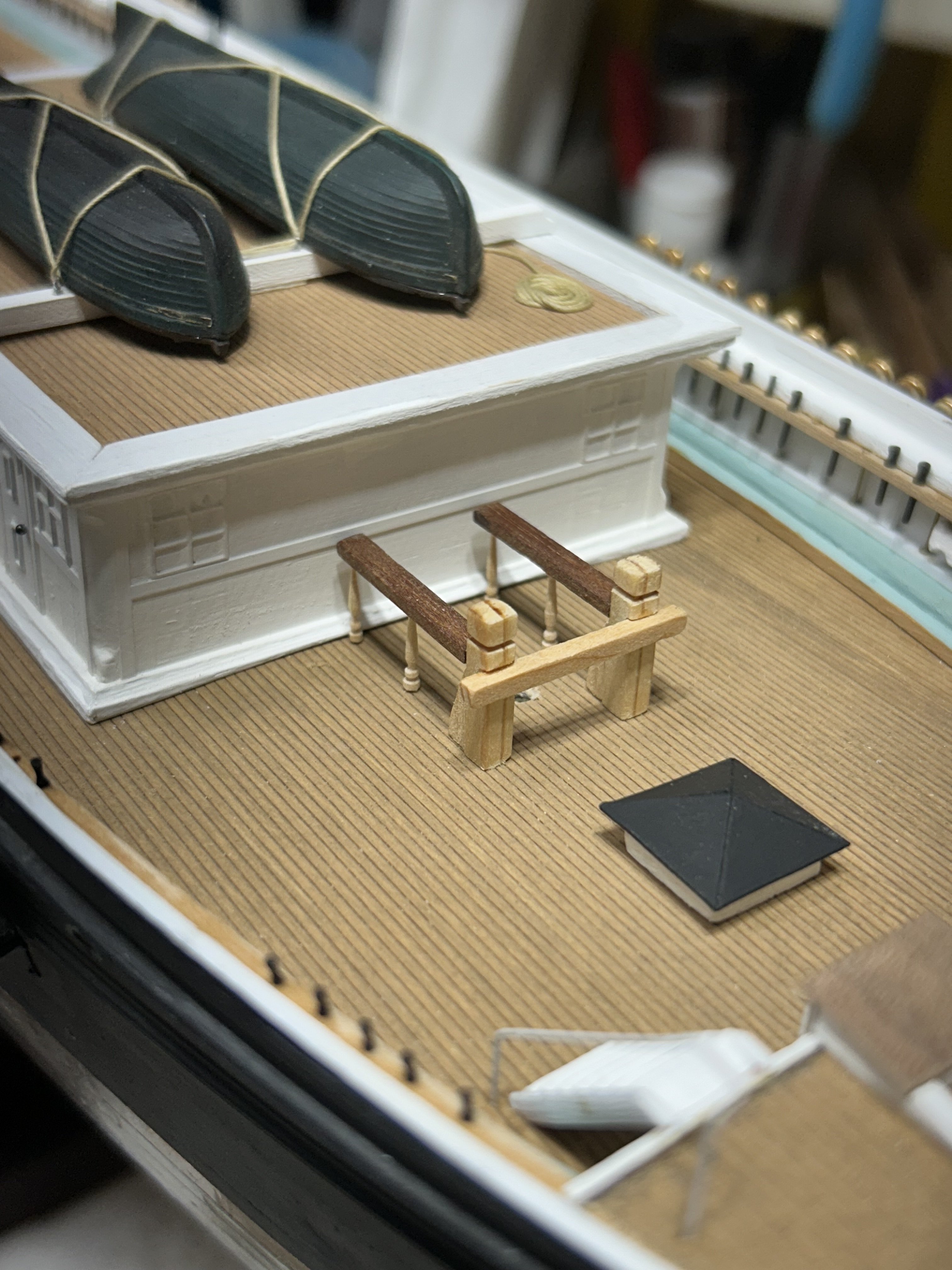

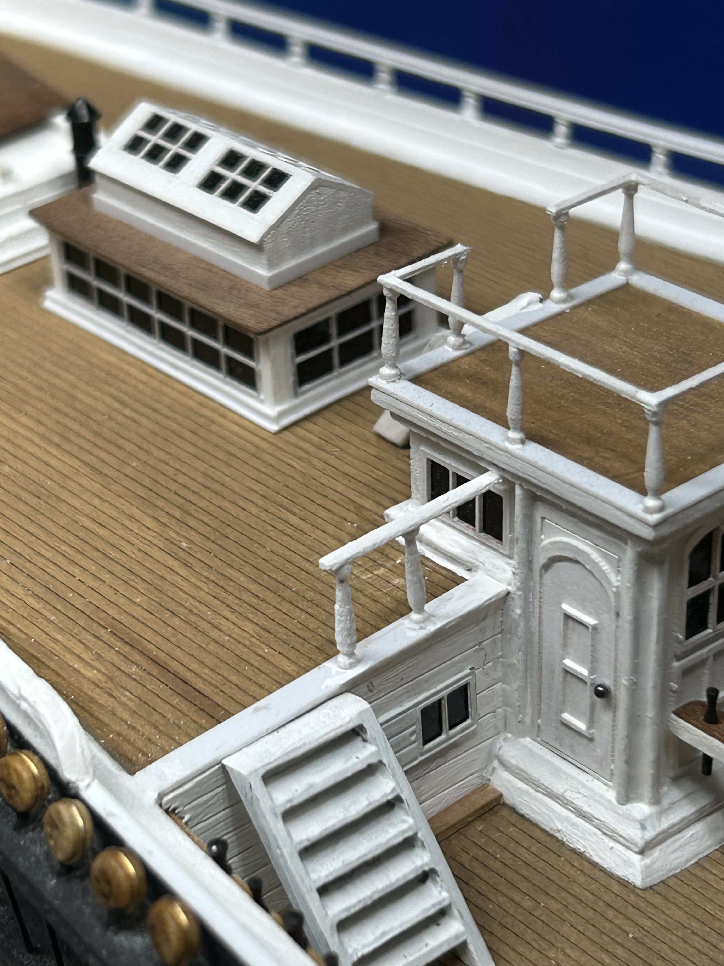

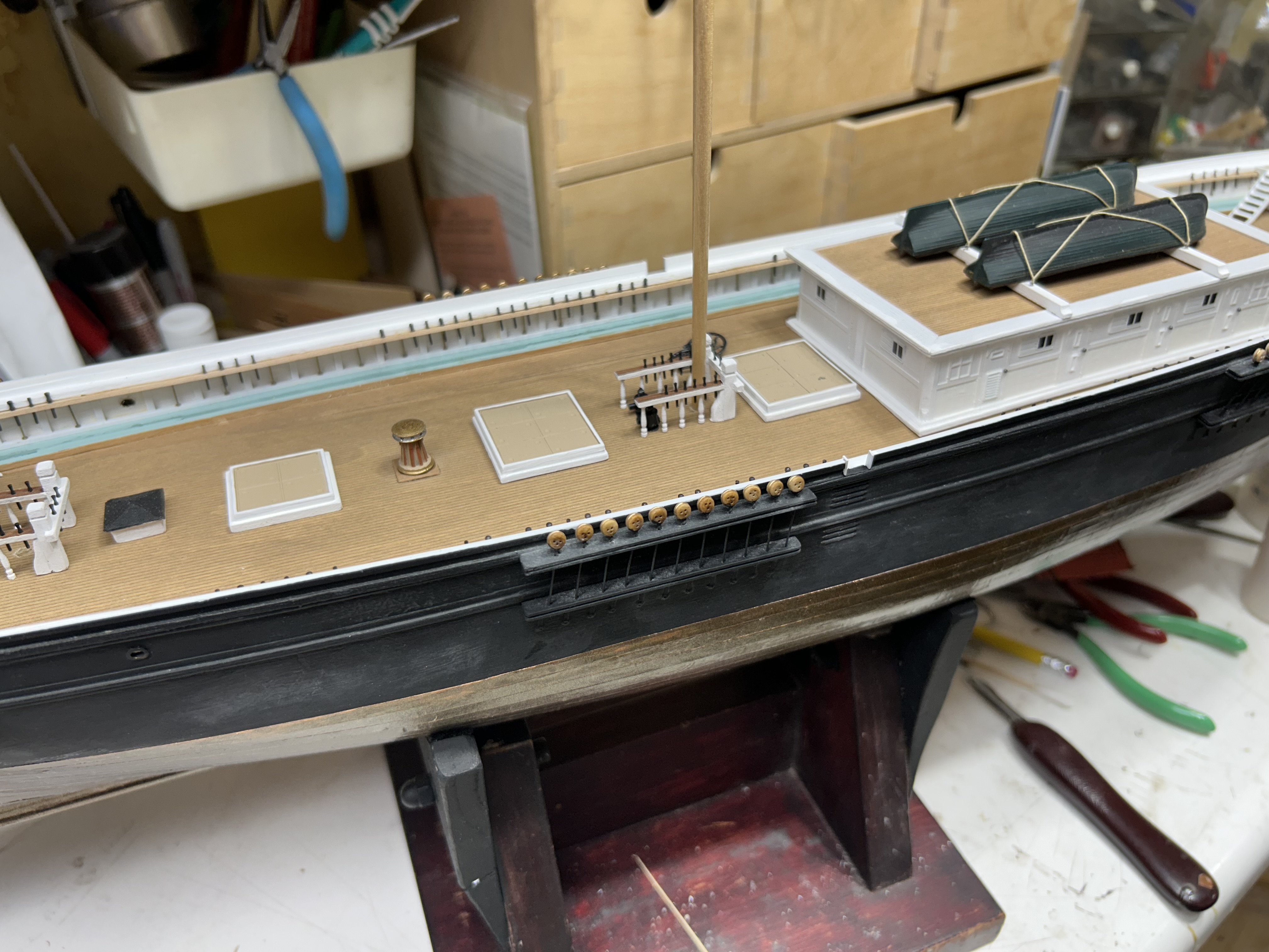

Did a bit of work on the small details.  Added forecastle step railing , the forward hold stair cover and began the fore fife rail.
Rob
Current build:
Finished build:
Current build(On hold):

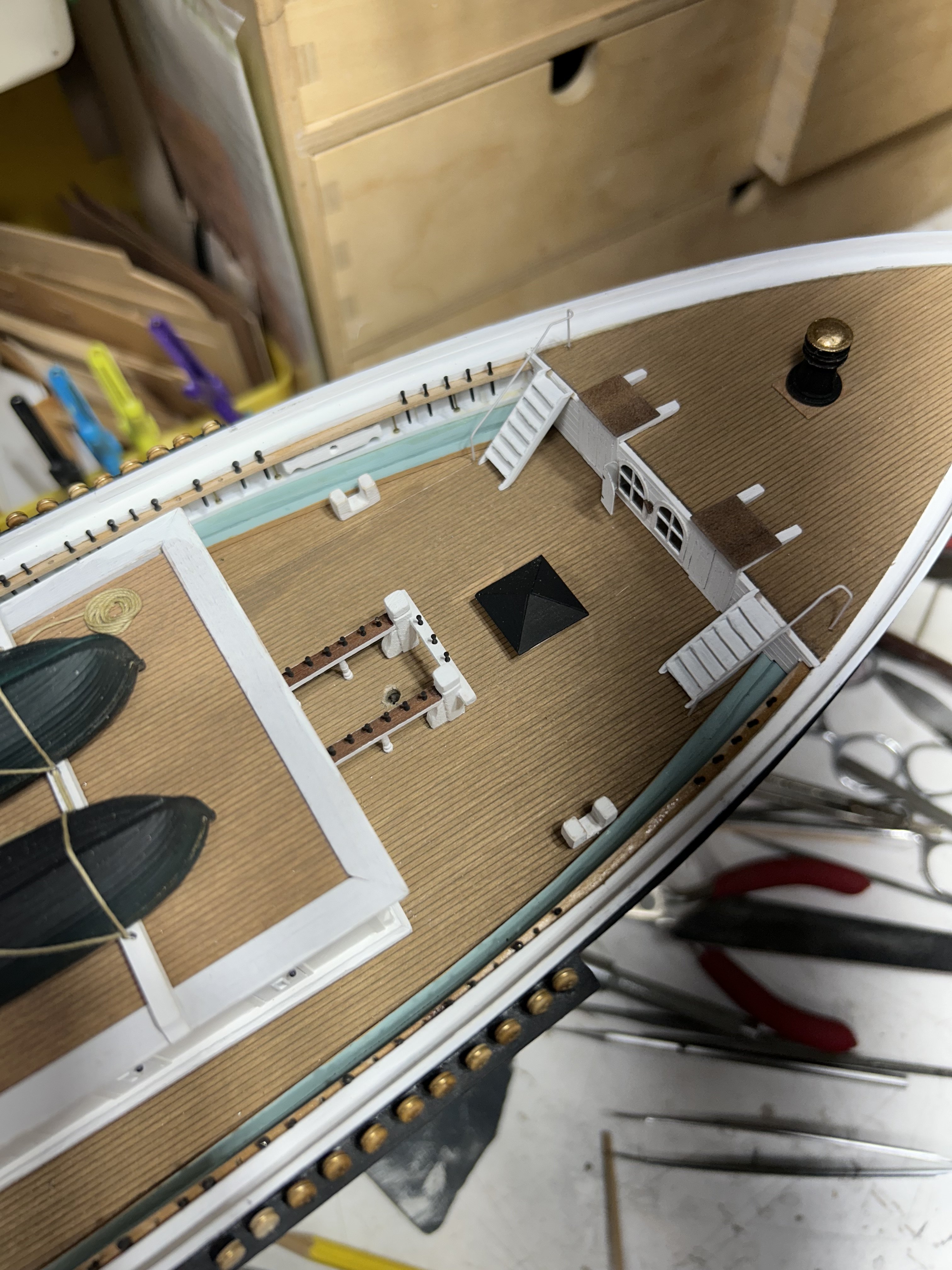

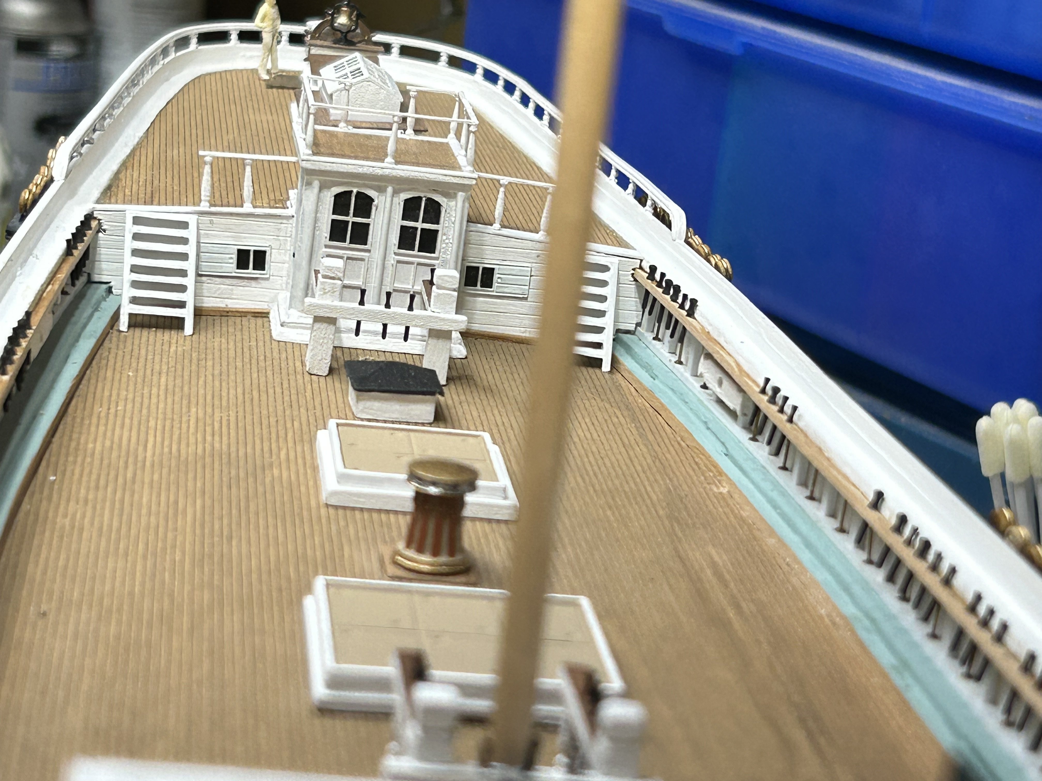

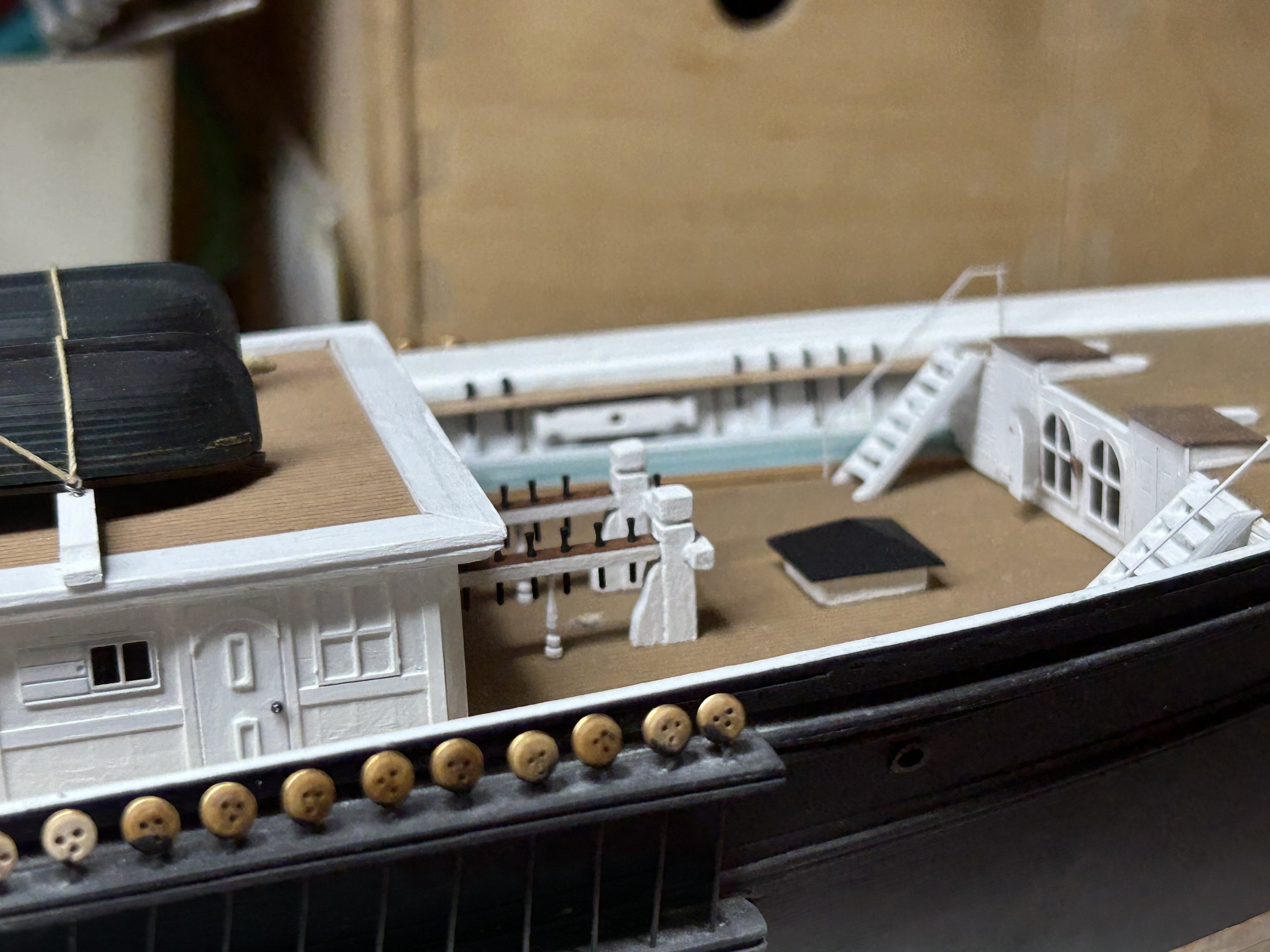

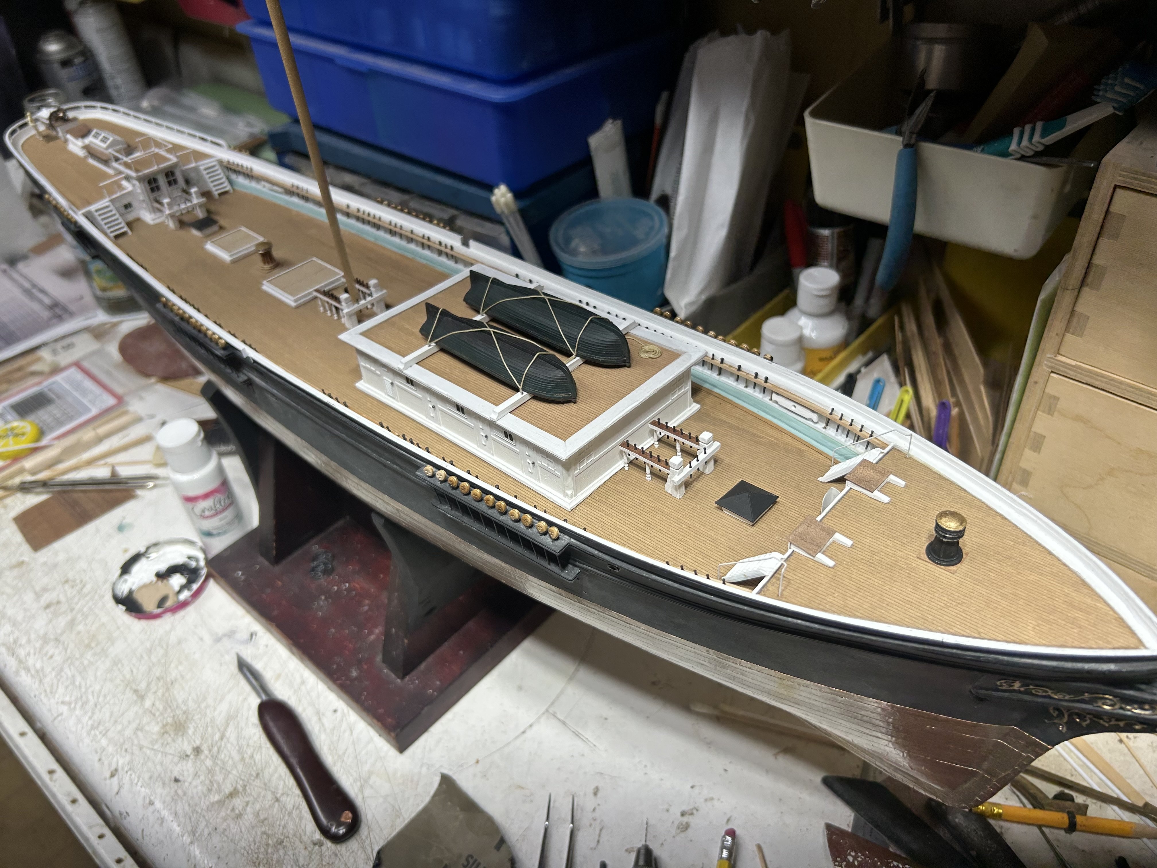

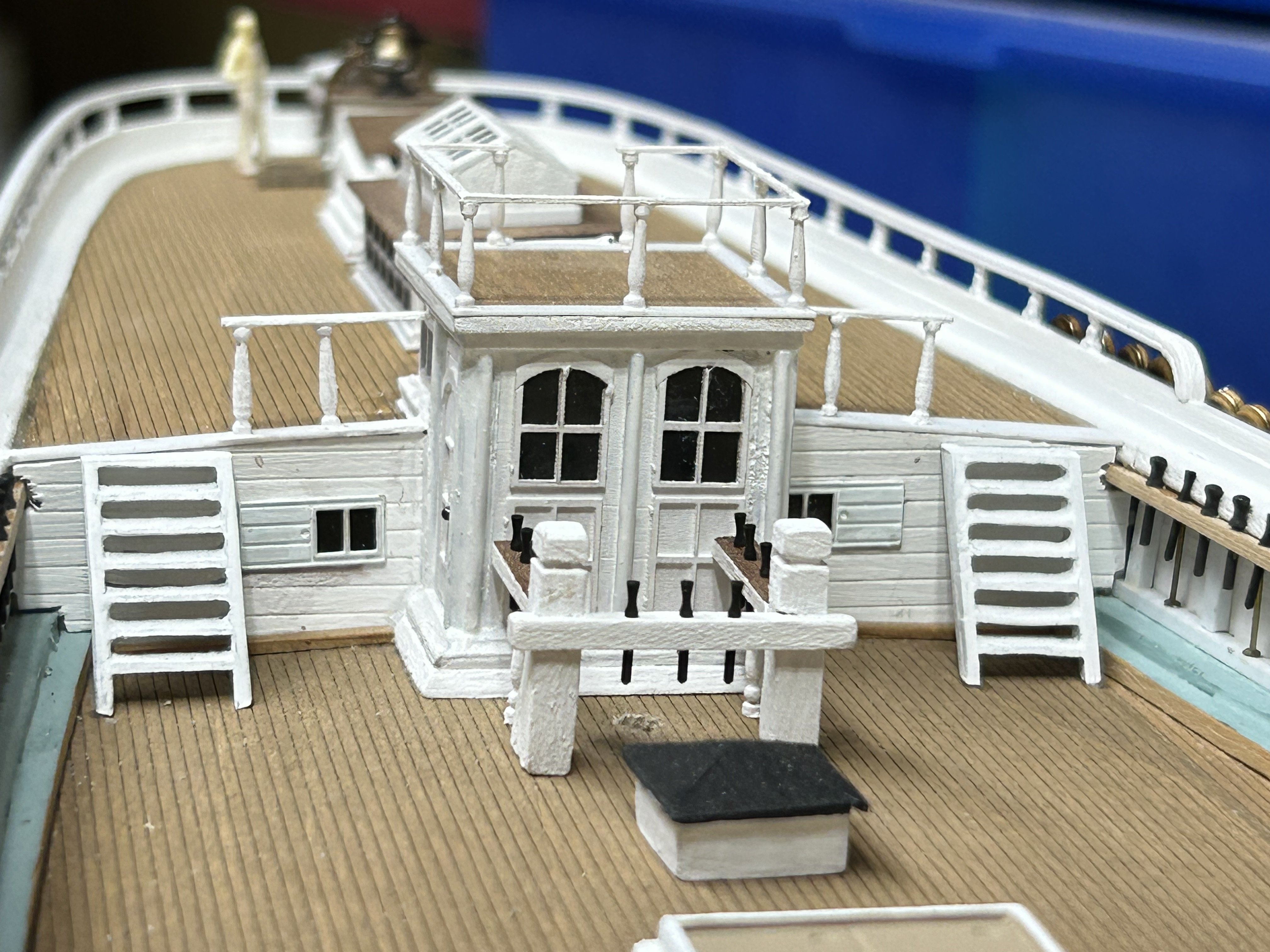

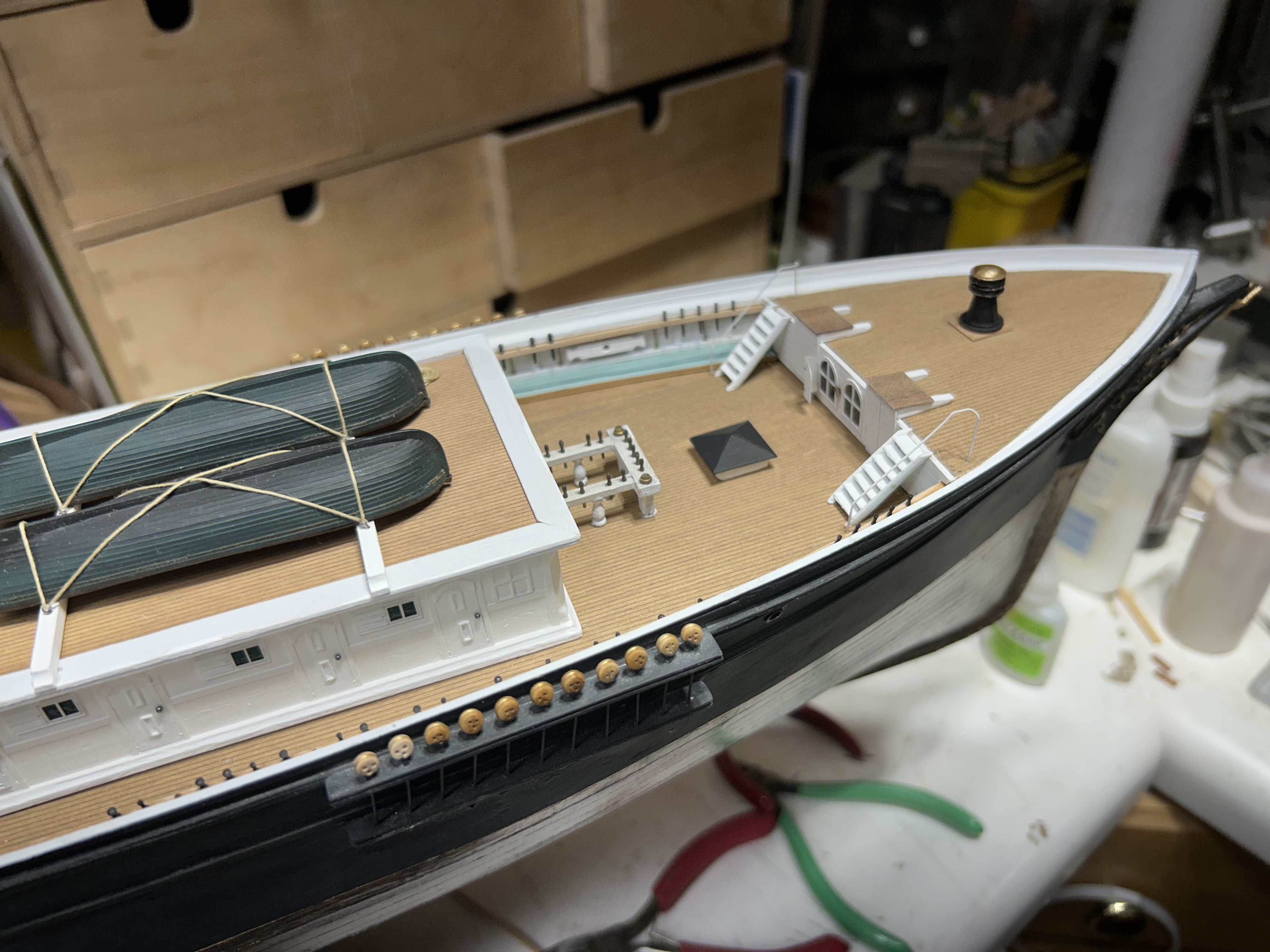

Took a few images around the model.
Rob

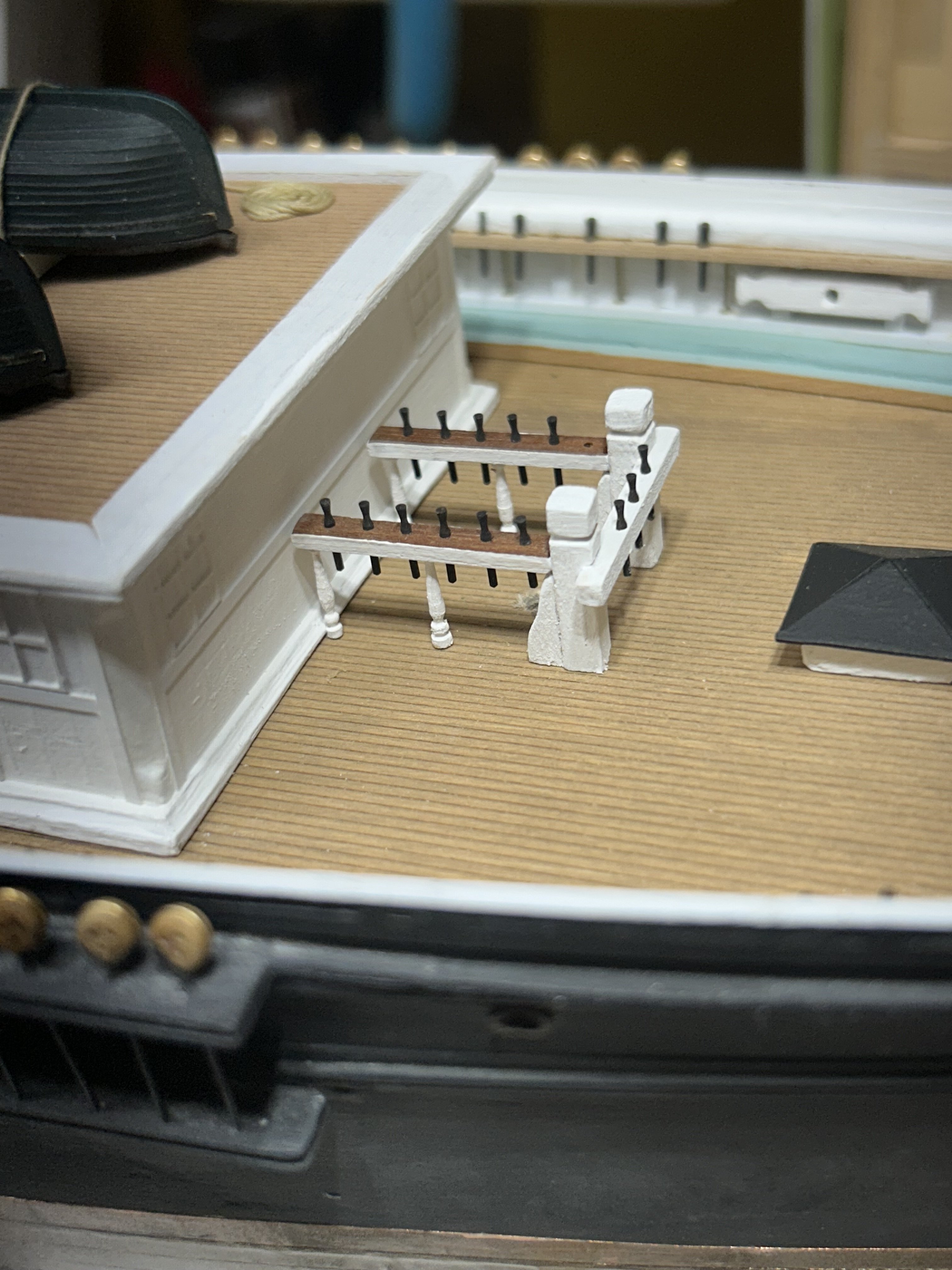

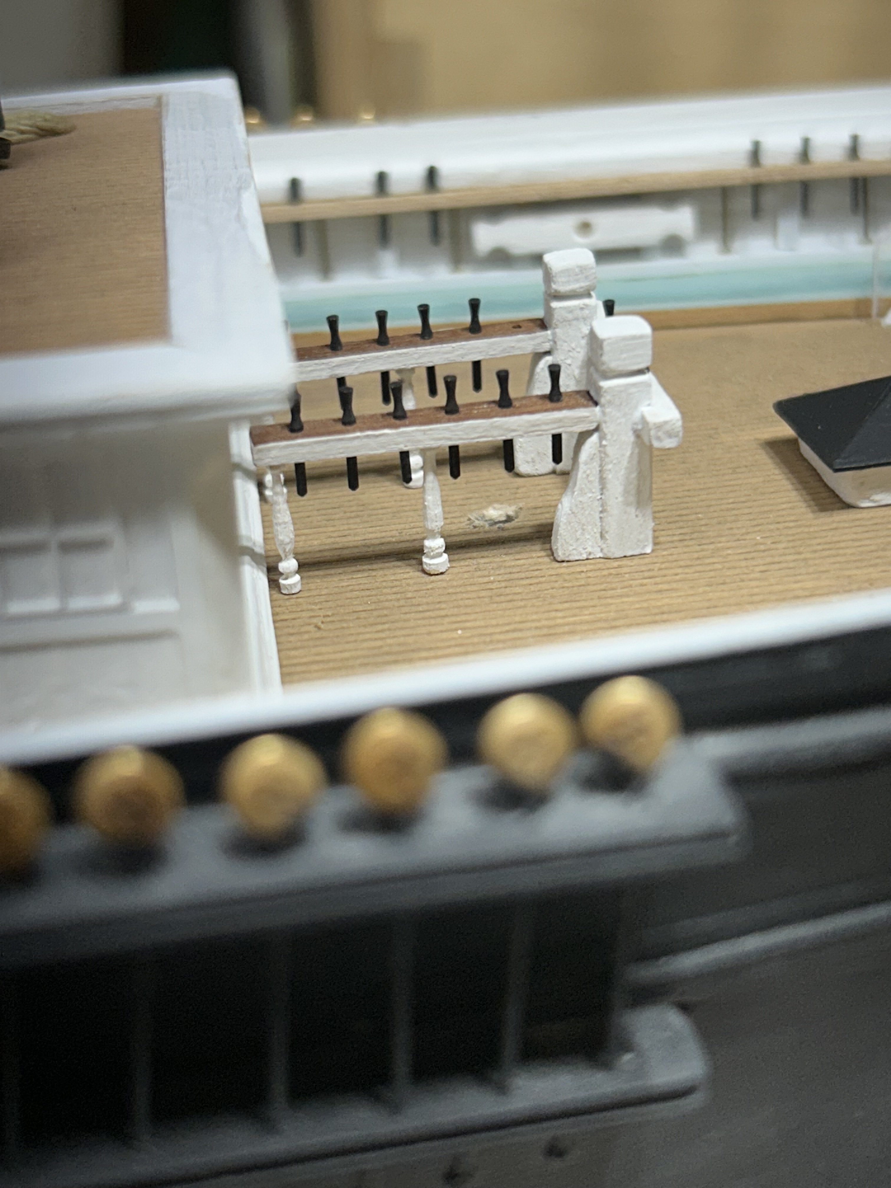

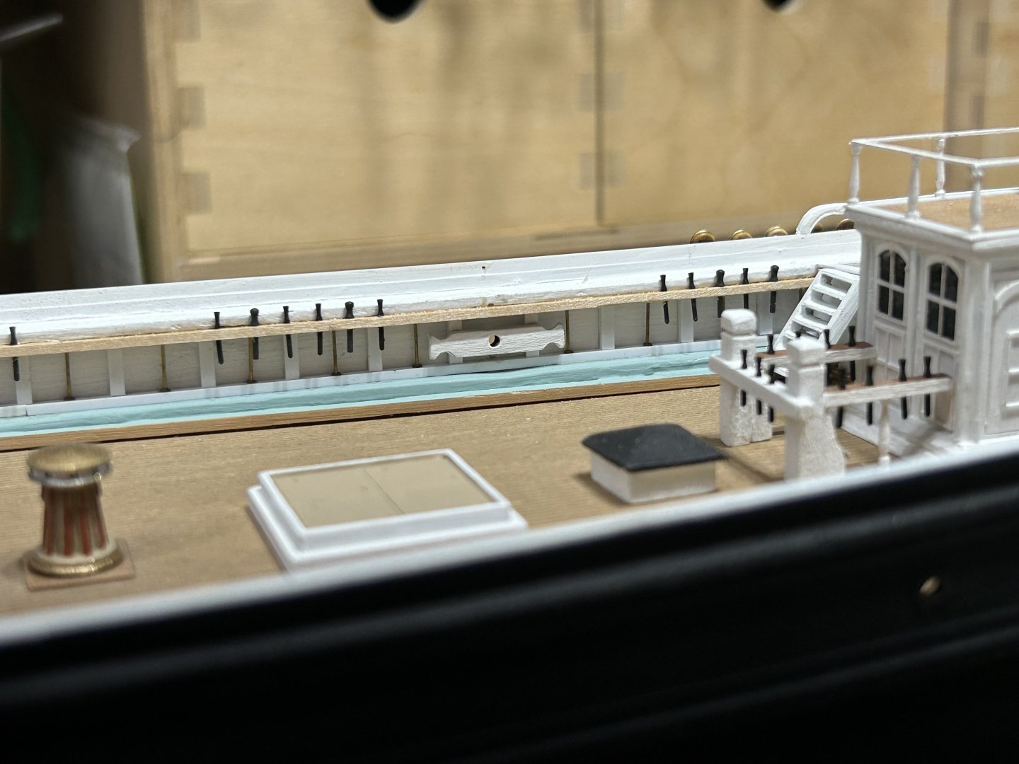

Finished the fore fife rail.
Rob

Mooring bits.
Rob

Thanks Rick.  Now to the bumpkins and their bits and poop step iron rails.  Then finally,
onto the forecastle details. Which will be an entire job in of itself.

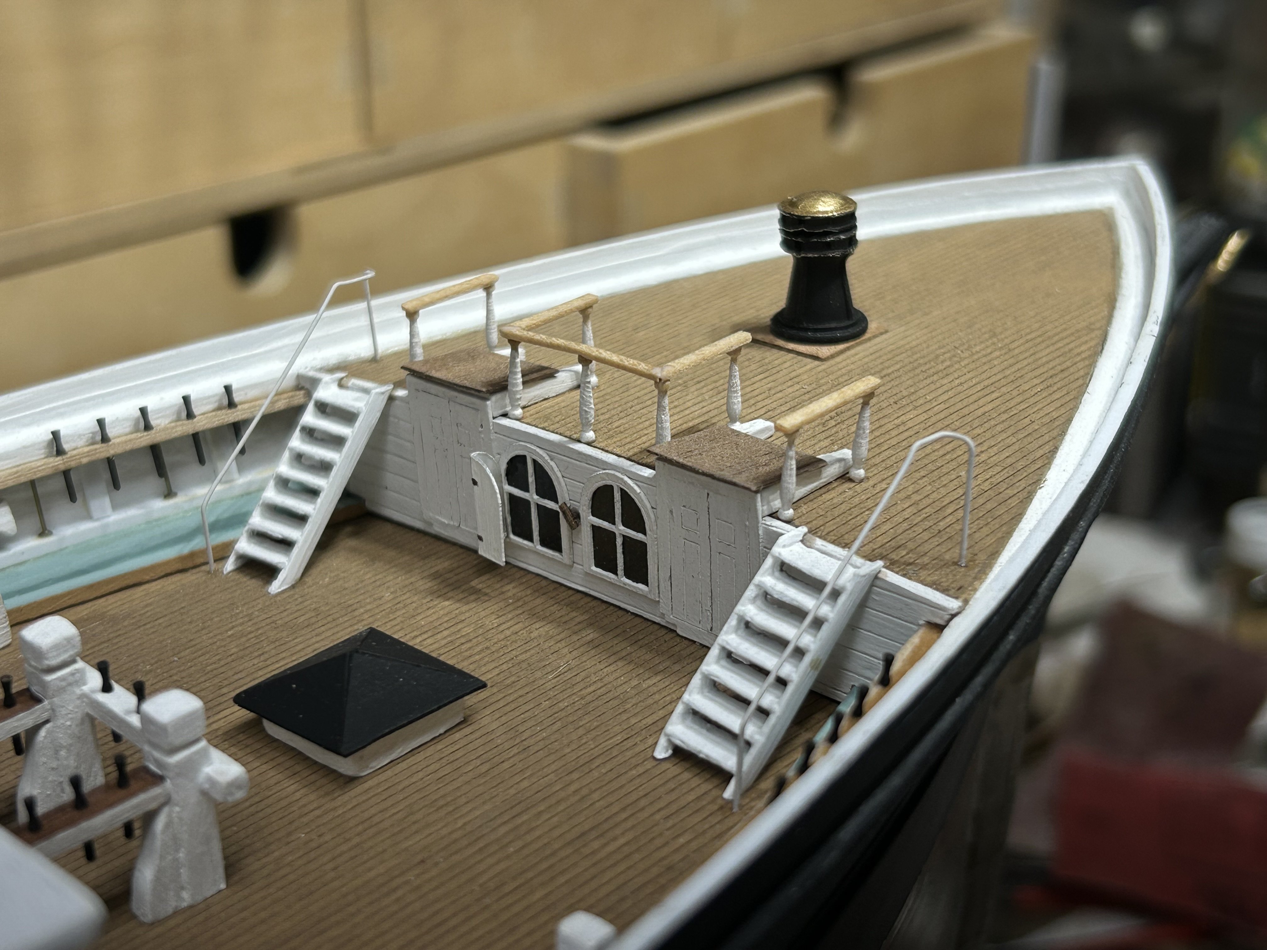

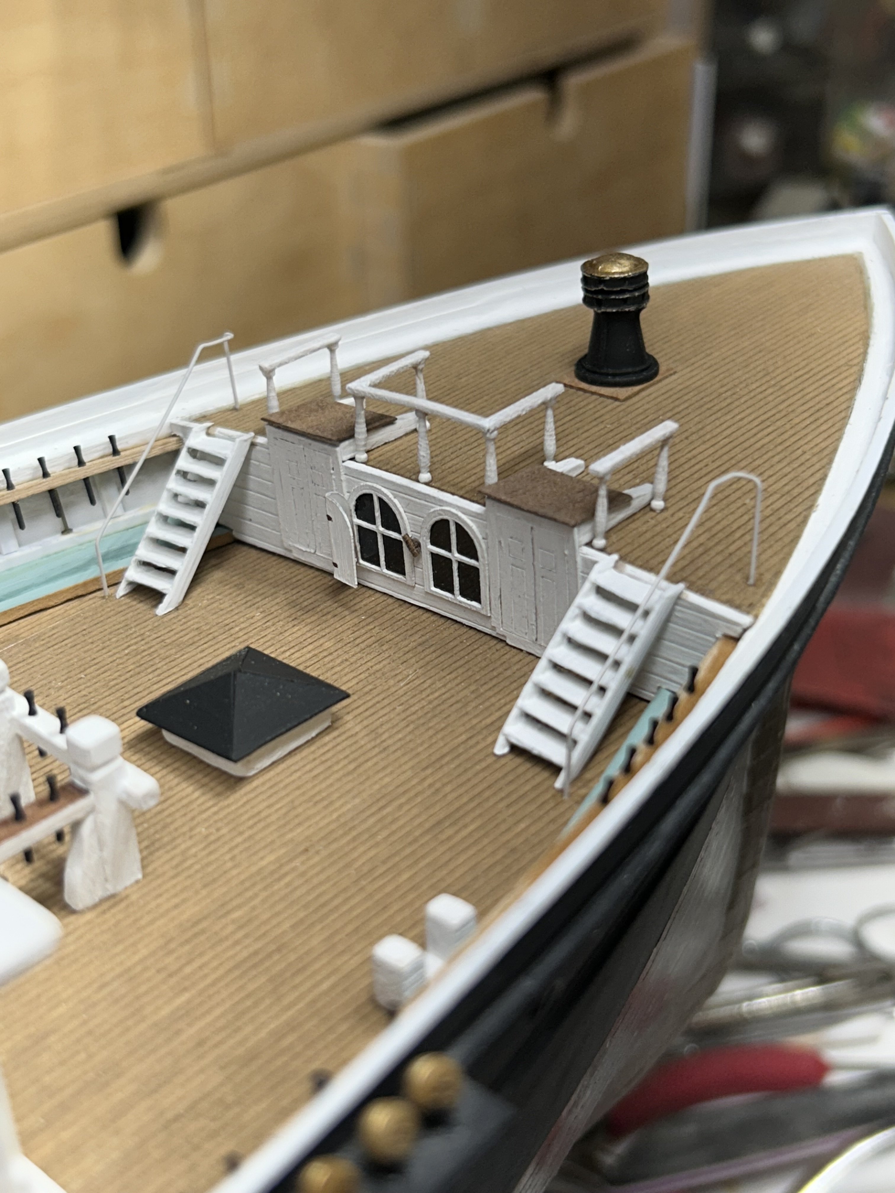

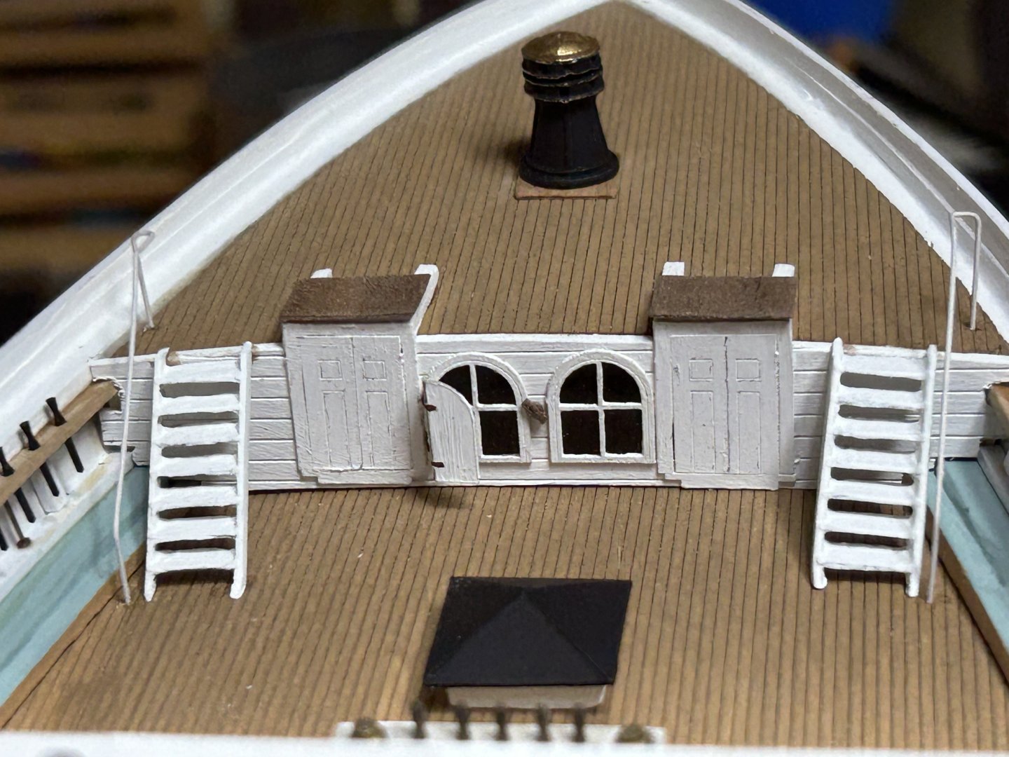

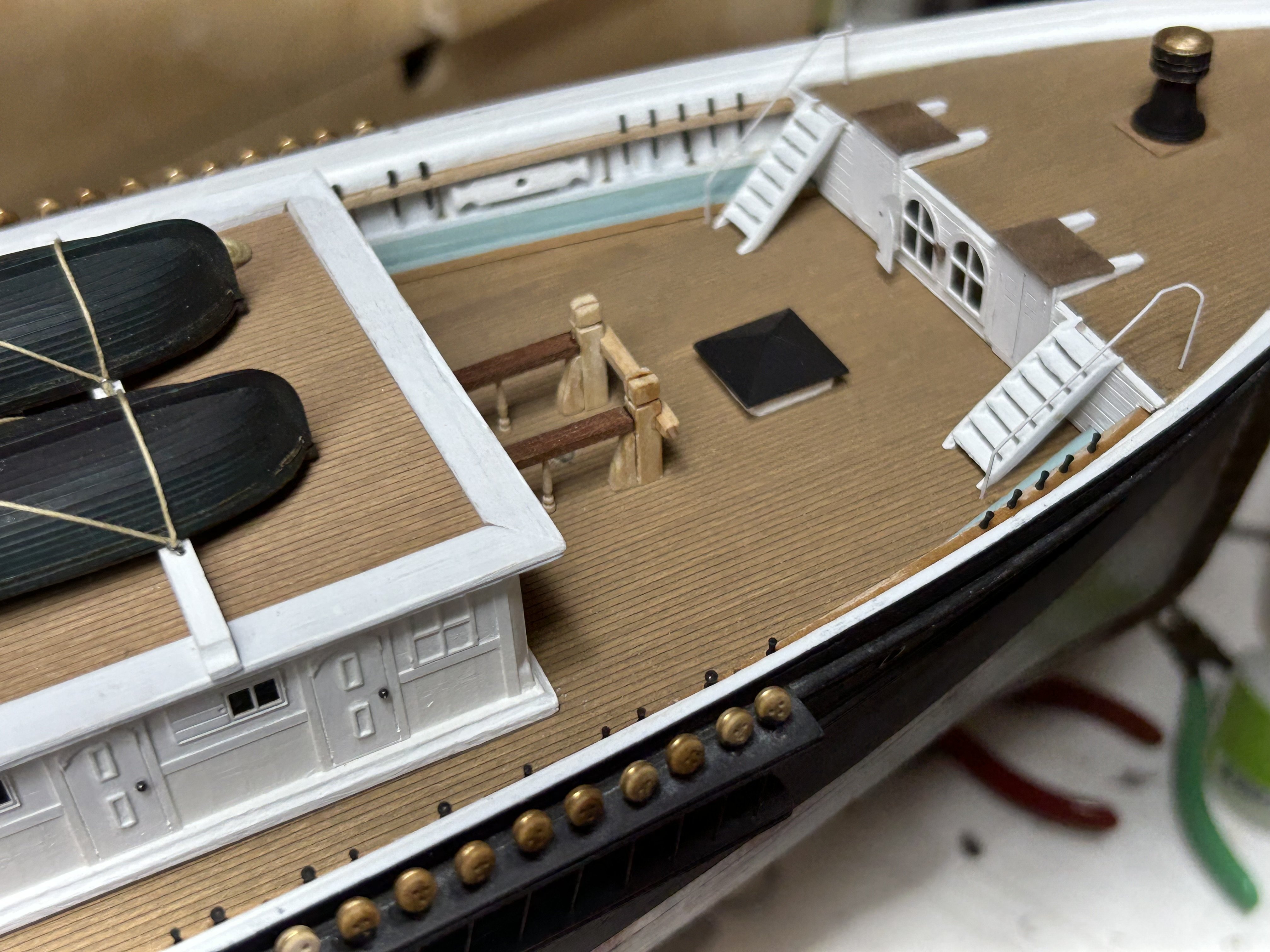

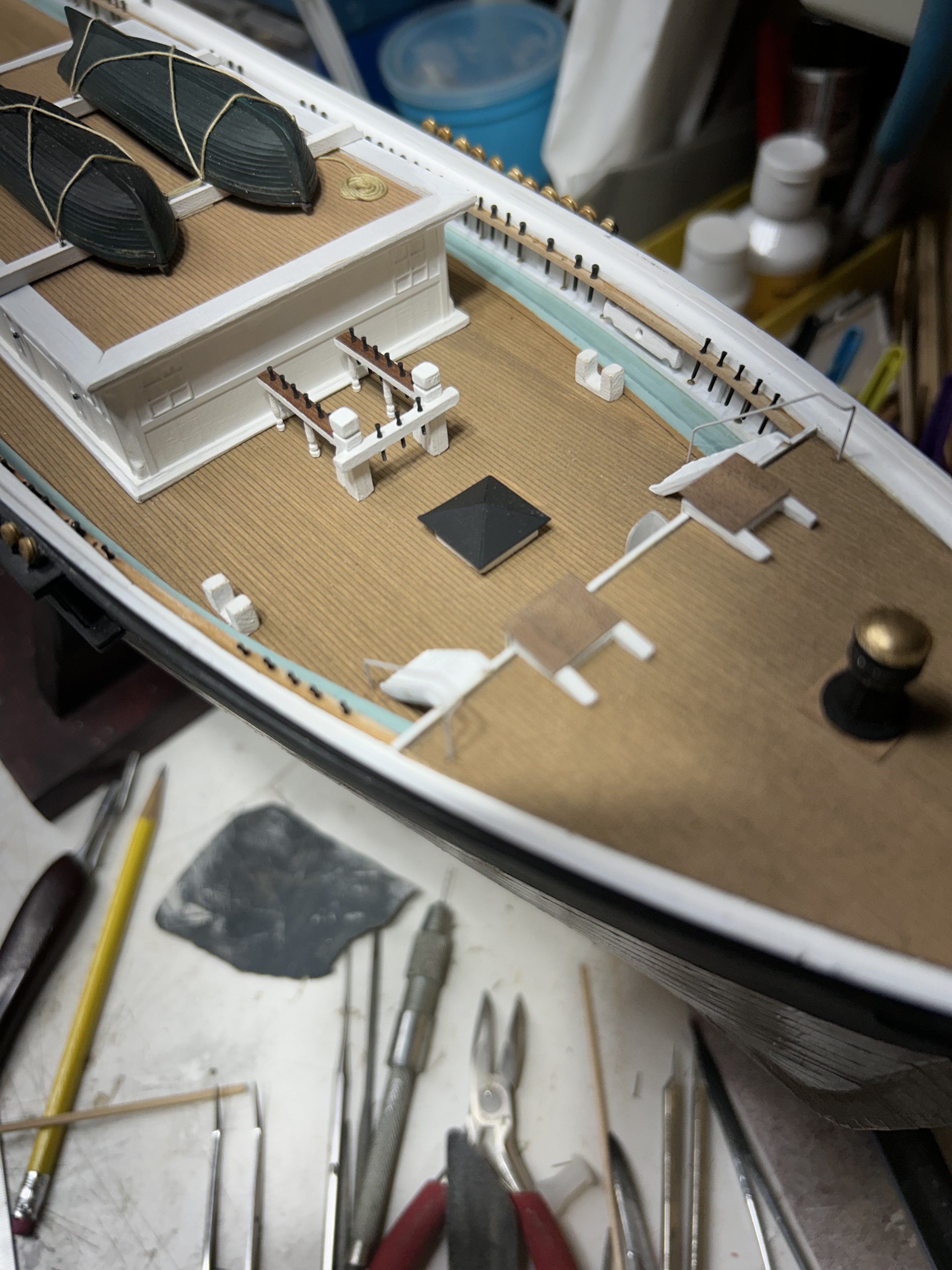

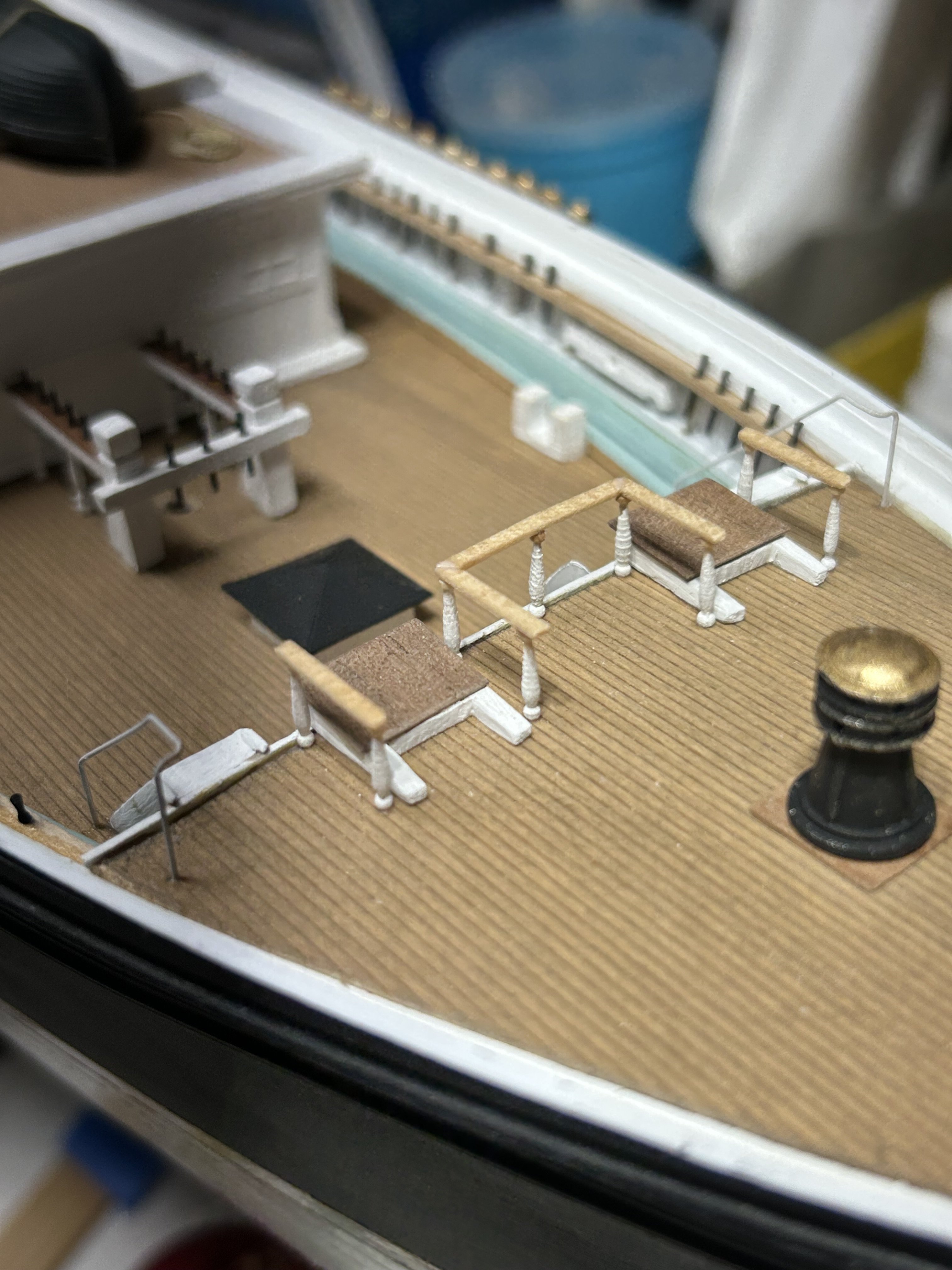

Worked on the forecastle railing a bit.   Lots to do.
Rob
Current build:
Finished build:
Chain barrier still need to be added in front of each companion way roof.
Rob

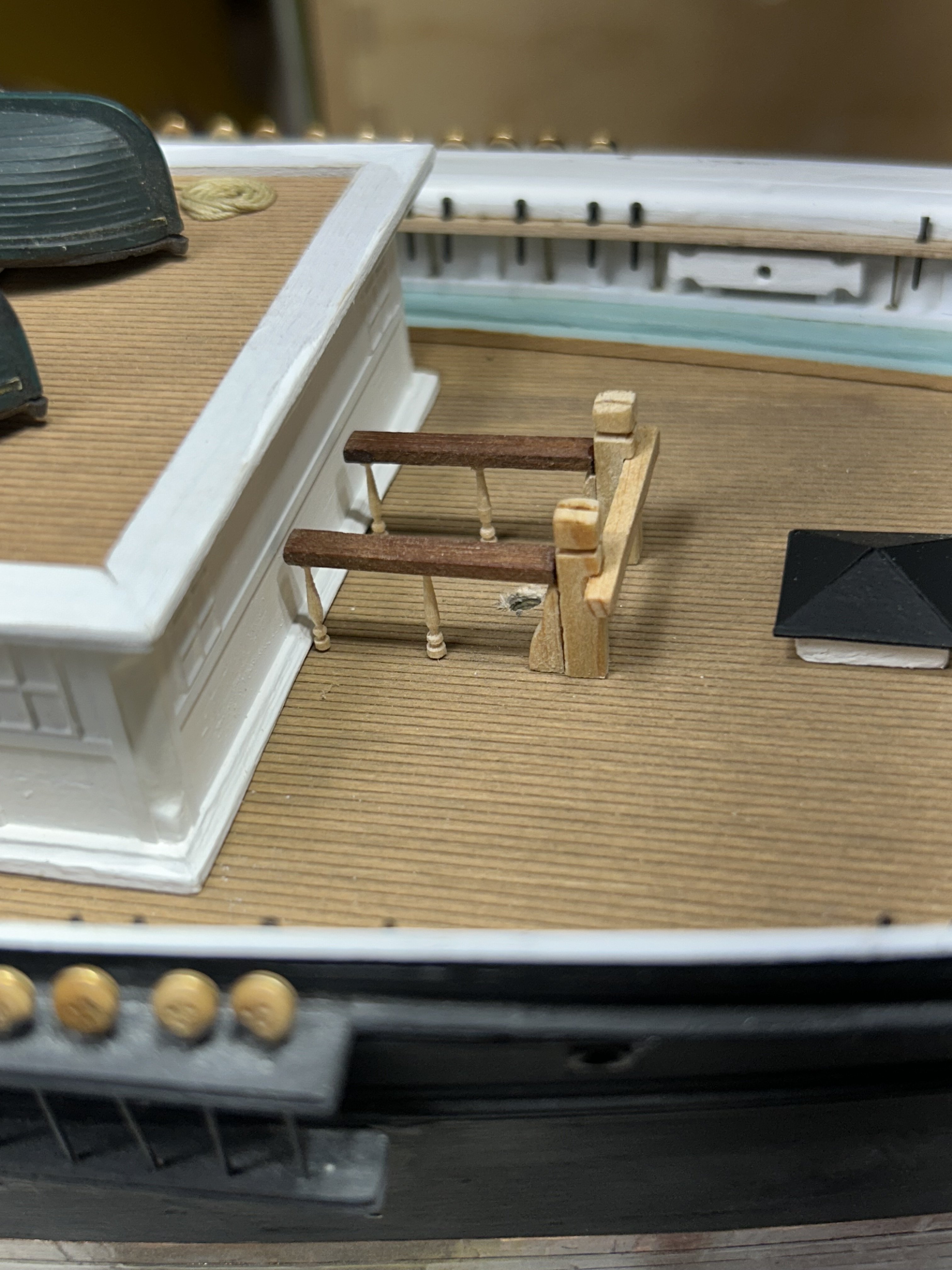

Finished up the bumpkins and their bits. Blocks and hardware will come later.
Rob

Finished up the safety chain around the forecastle companionway roofs.
Rob
