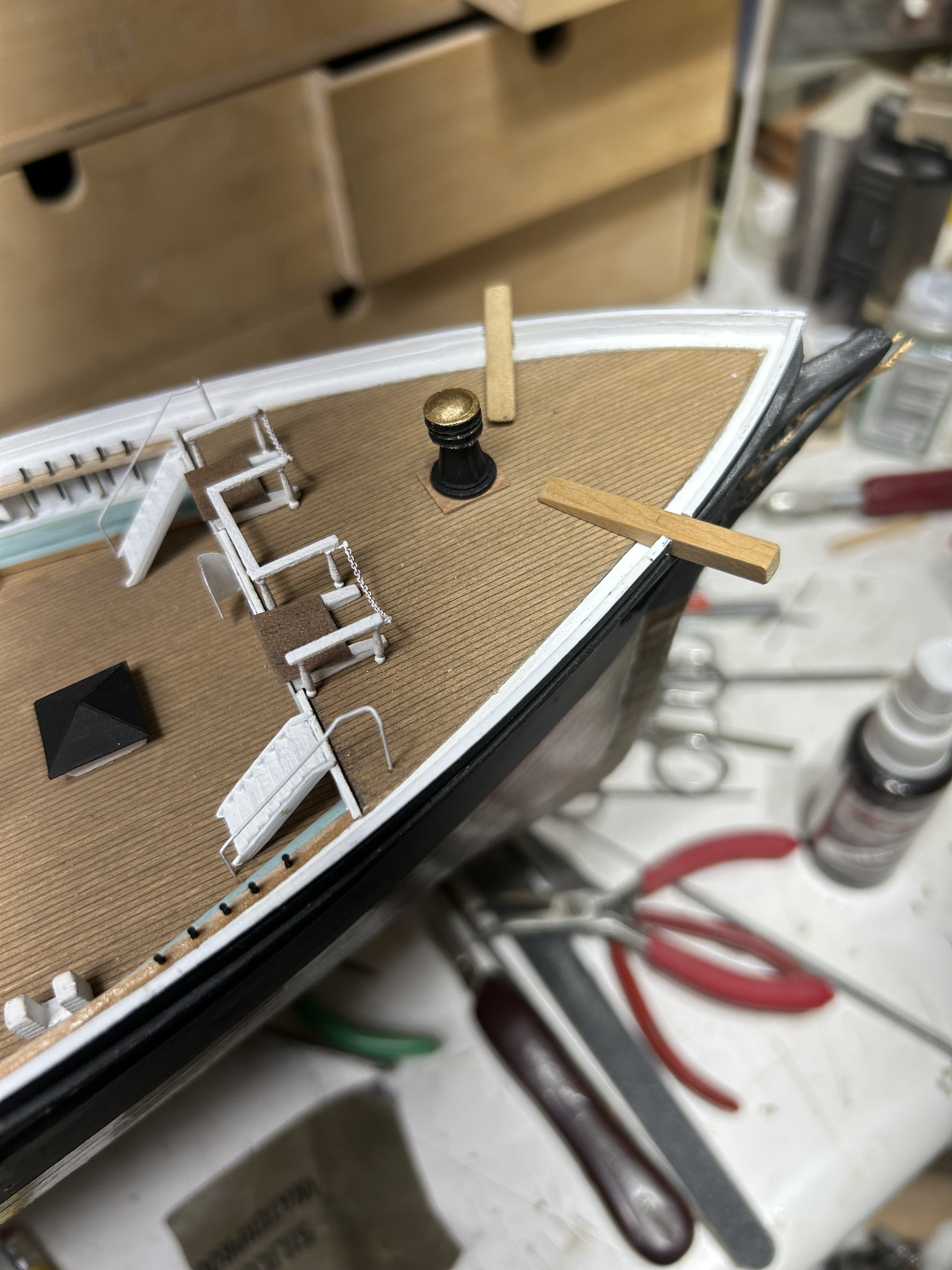

Cutting in the cat heads.
Rob

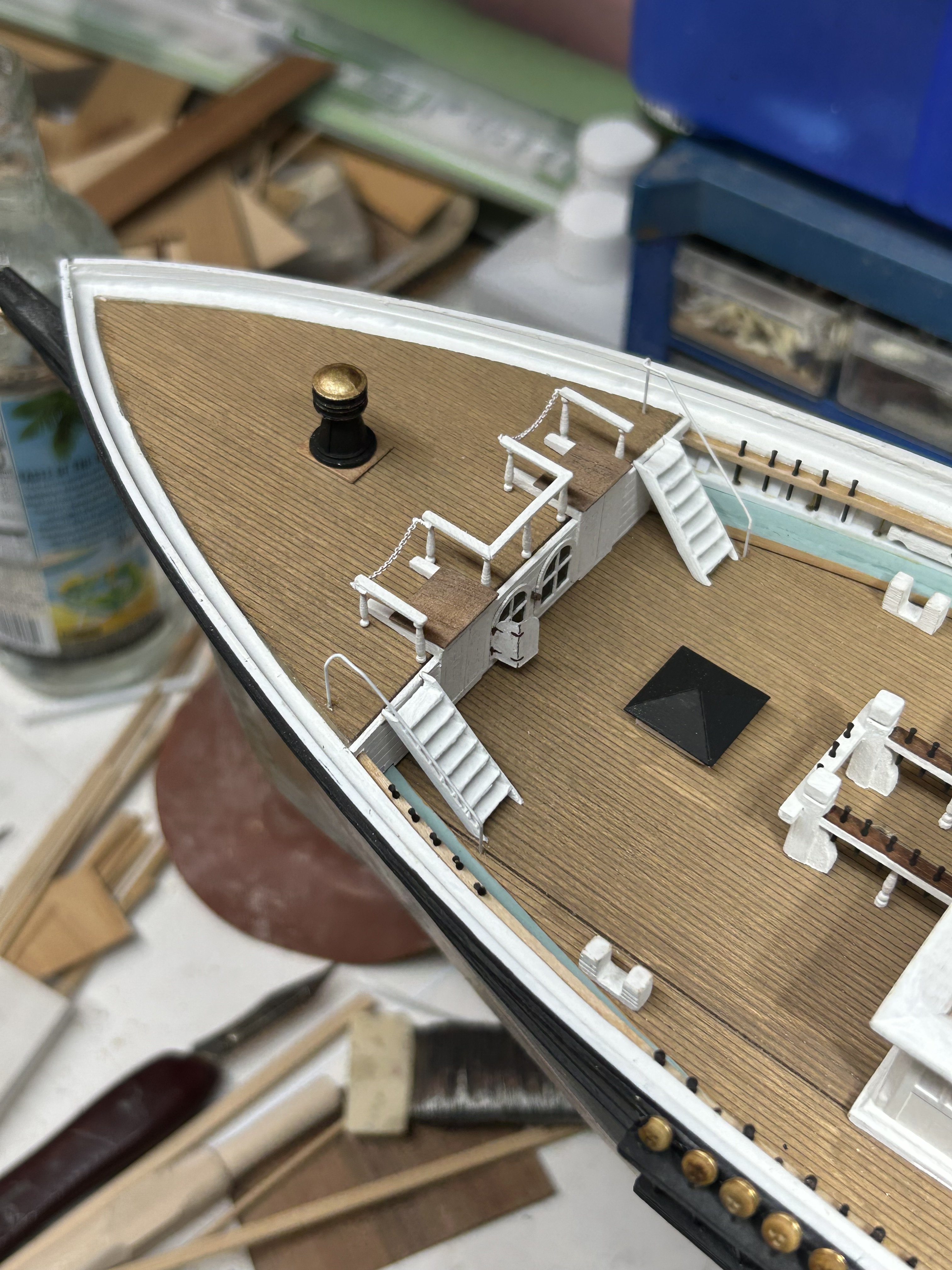

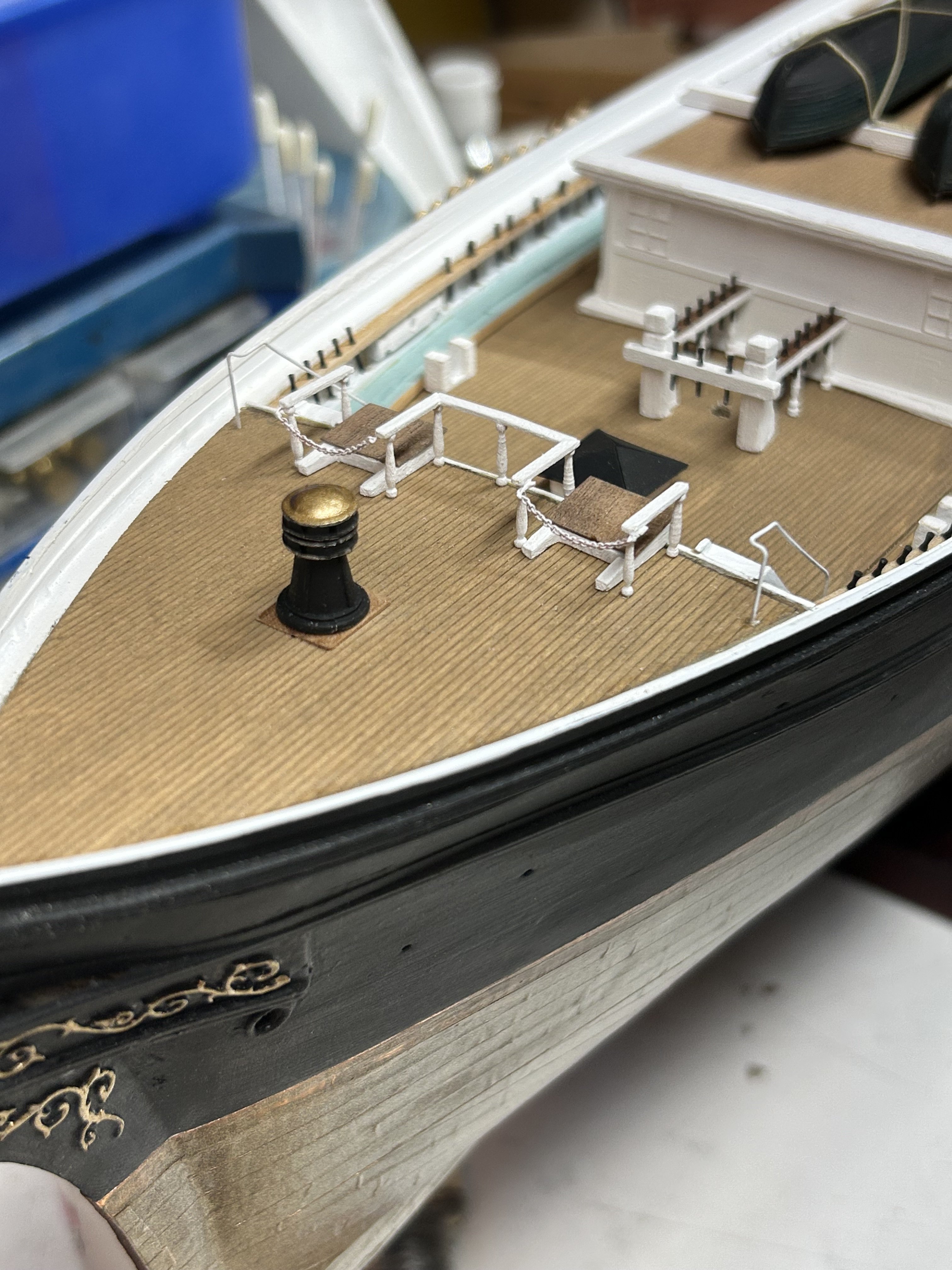

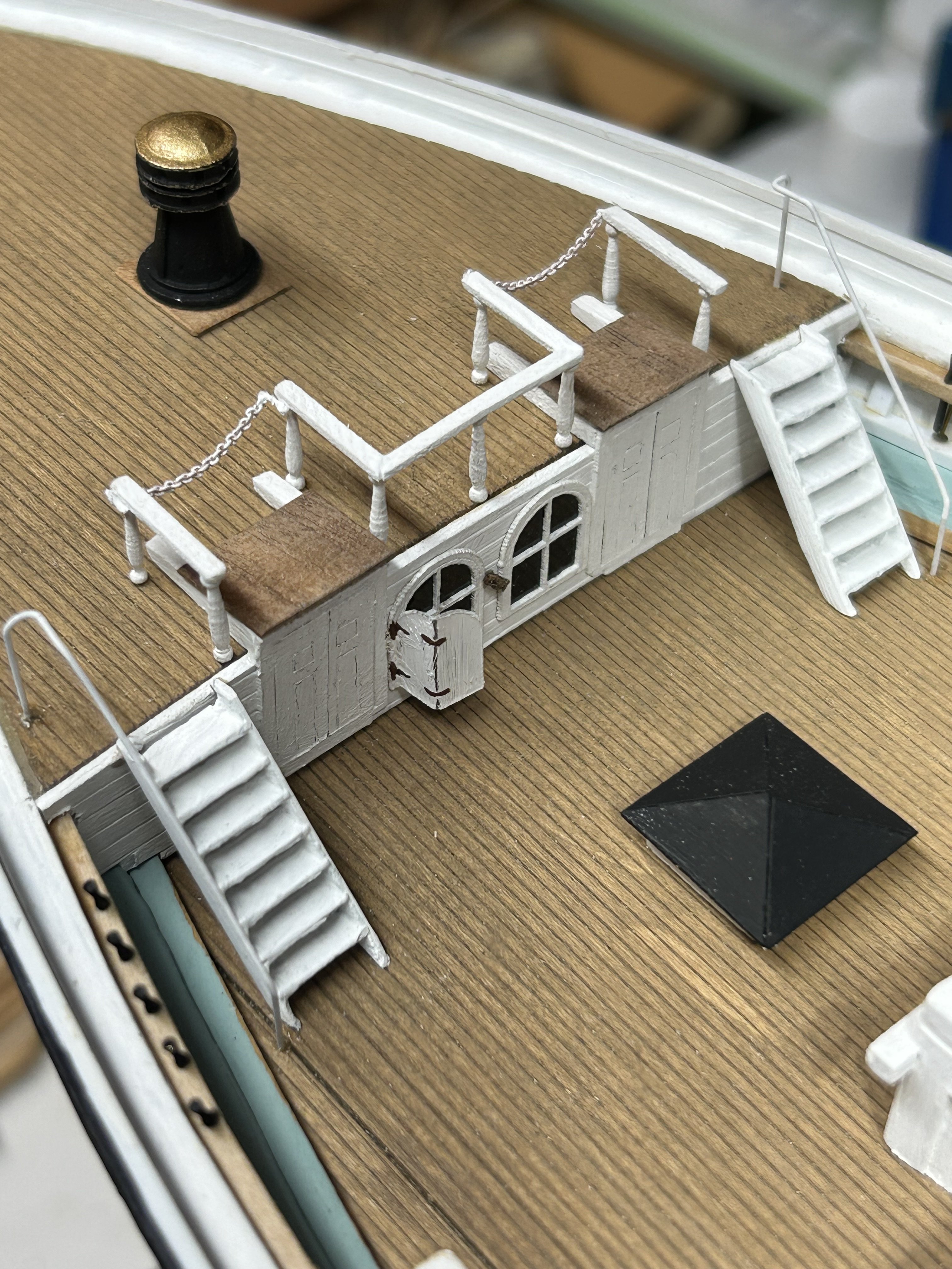

Finished up the bumpkins and their bits. Blocks and hardware will come later.
Rob
Rob, those safety chains are such a brilliant touch. They really drive home that this was a real vessel on a human level. Nicely done!
Thanks Rich.  Those little boogers were quite challenging to fix in place....without damaging the existing spindly wooden railing.
The splash rail will go atop the catheads in  the near future.  I will add the iron fairleads shortly after.
Noticing the Cheppelle drawing a bit closer.  I noticed he set the forecastle deck at nearly the monkey rail height.  NOT at the main rail height as McLean describes.   Probably trying to reconcile the limited height under the deck for real men to do work.  More evidence, the inner forecastle decking was 3ft below....providing that *AMPLE, well lit work space....we see described in McLean's first hand description.

39 minutes ago, uscharin said:
Some nice symmetrical wire bending on the step railings.  That isn't so easy to do as I recently found out.  Looking great.
Thanks.  Not only did it have to be cleanly executed ...it had to be mirrored.  Both fore and aft.  I'm humbled.

Rob,
No surprise that I agree with our prior assessment. Instead of trying to jam things in without thought as to how people would actually function in such cramped spaces, we're taking an opposite tack and using common sense to sort out how a space would have been laid out in a real world environment.

Thanks Rich.  I thought they would add some continuity to the practicalities we uncovered.

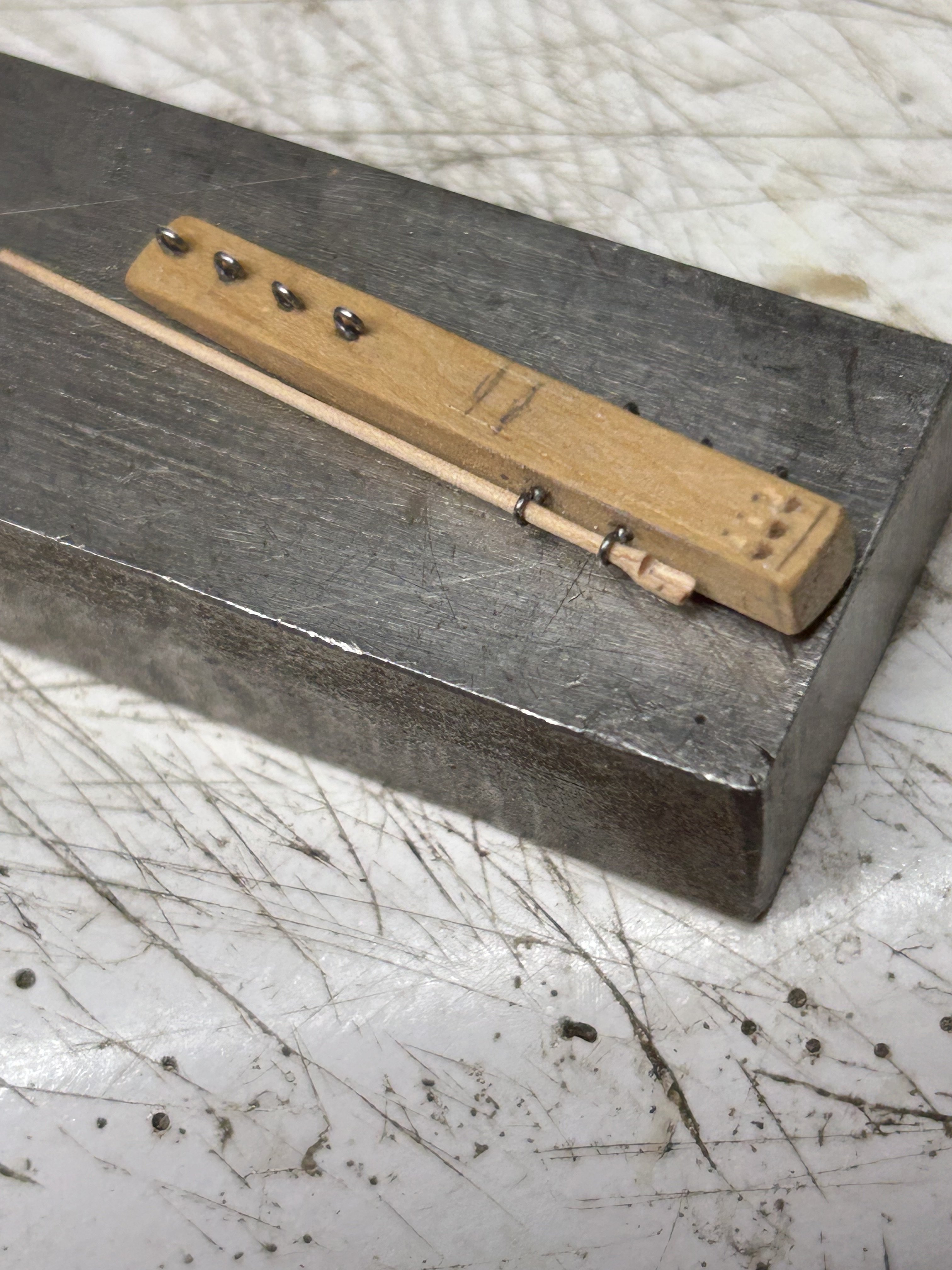

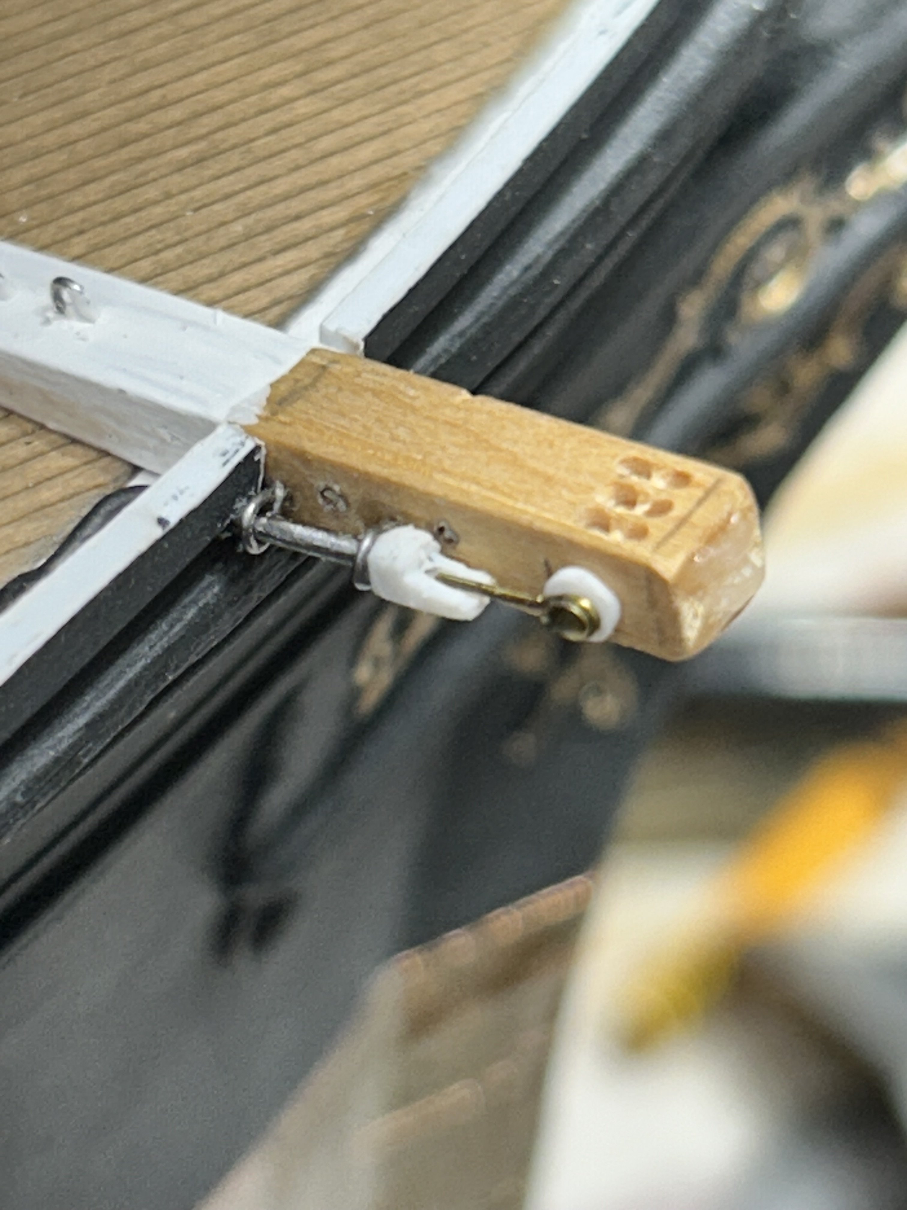

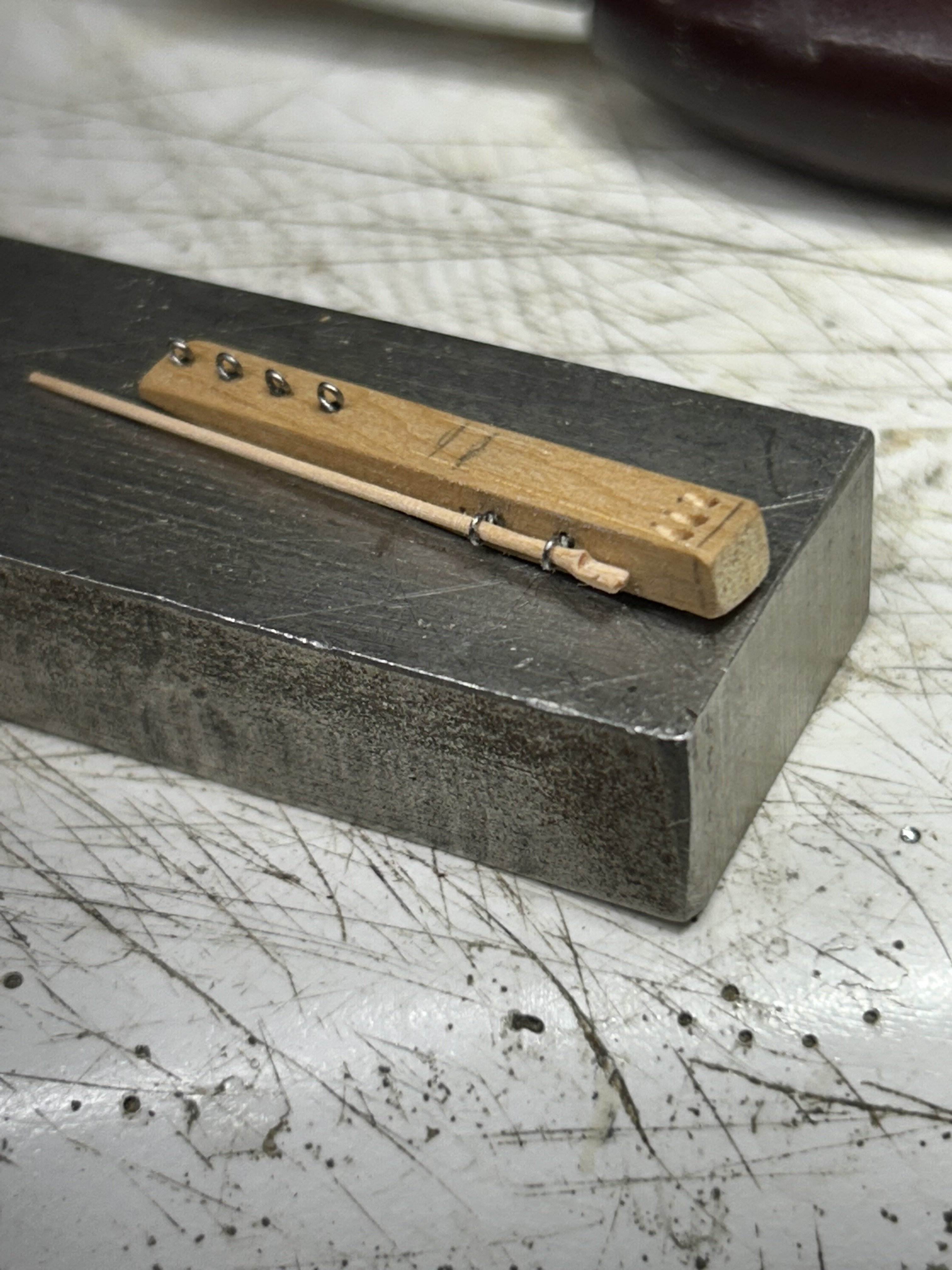

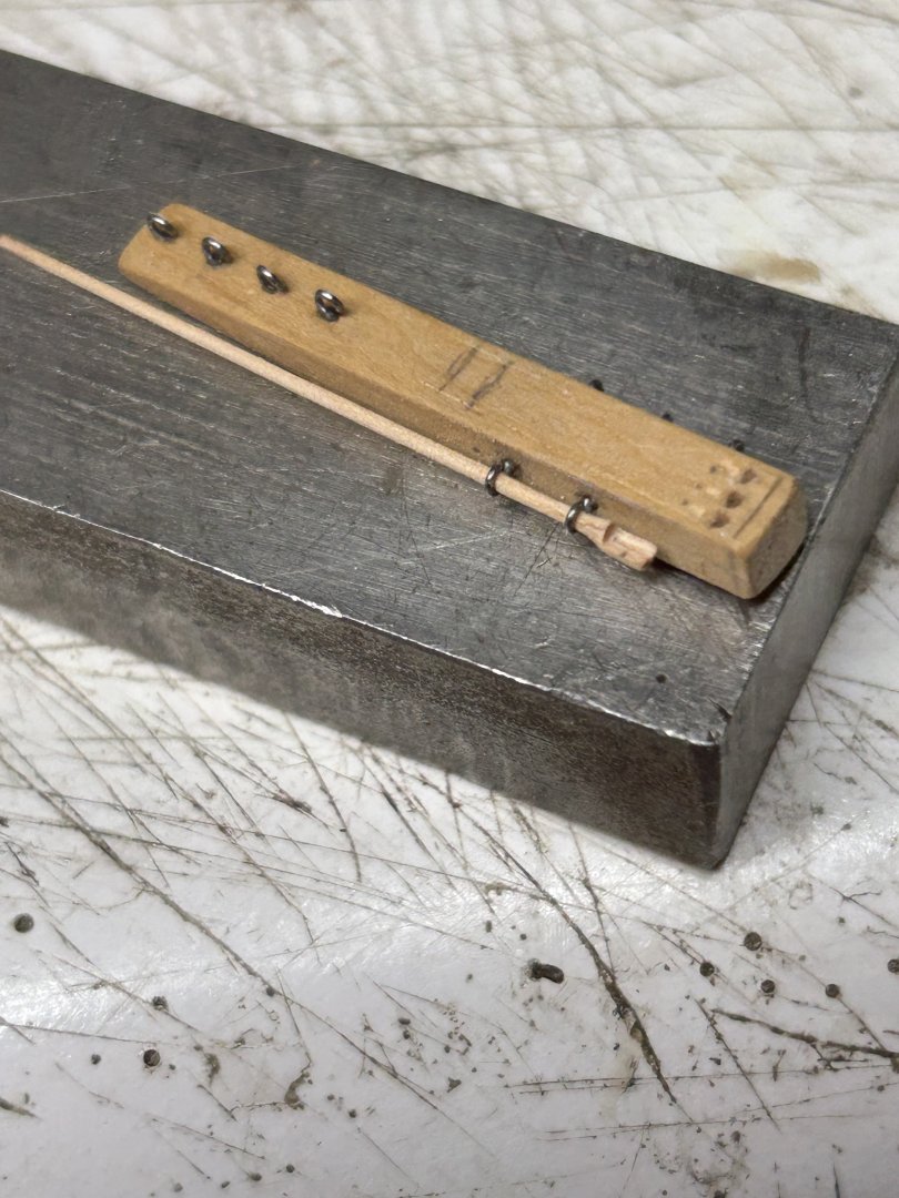

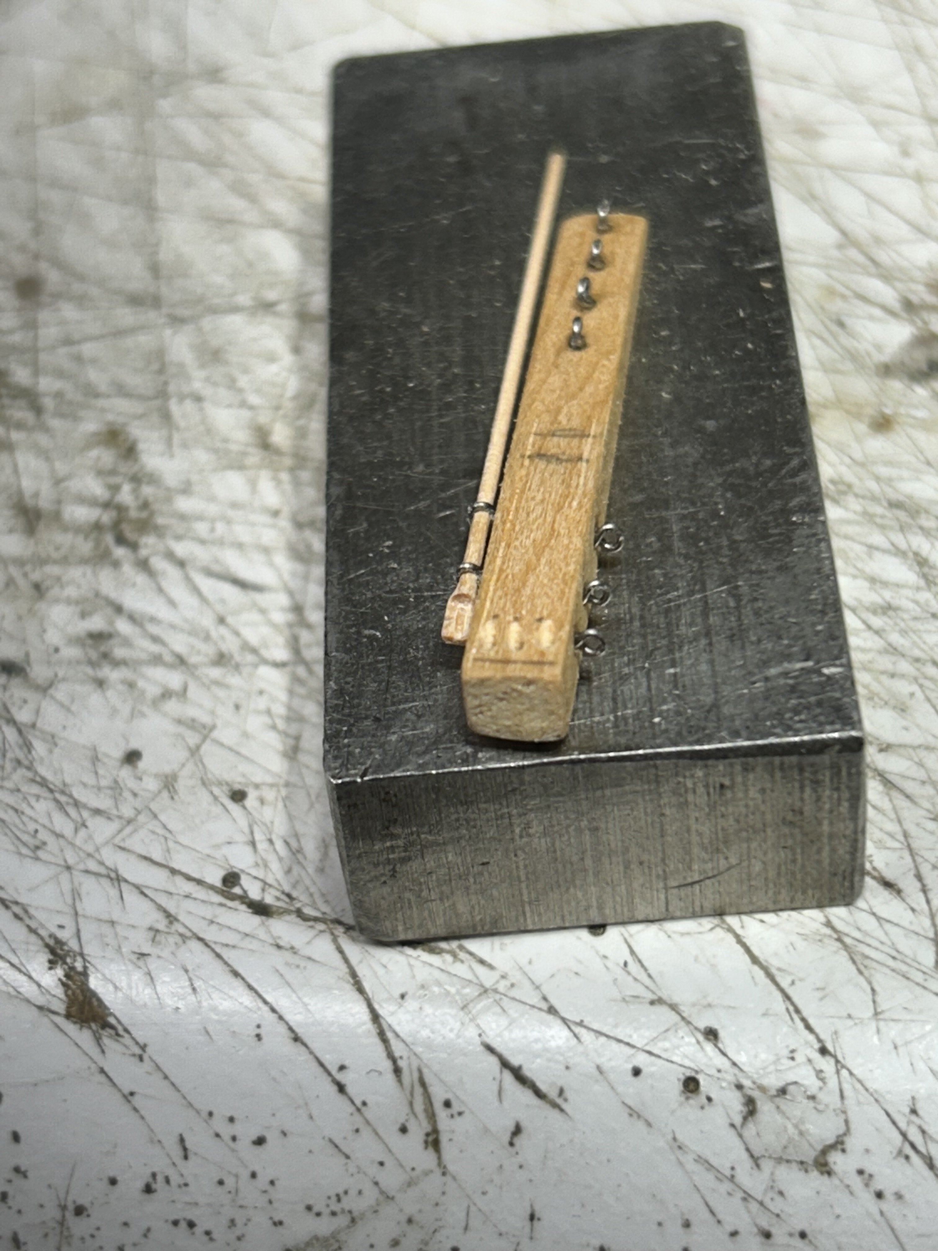

Worked a bit on the cat head structures.  Haven’t decided what release mechanism I want to use.  Here, I’m working out the twist and release design.    I haven’t added the release pin yet……just the long bar with the cupped head that holds the release pin and retaining chain.   The other design uses a rope and release clip that holds the release pin from falling away releasing the retaining chain.
Rob

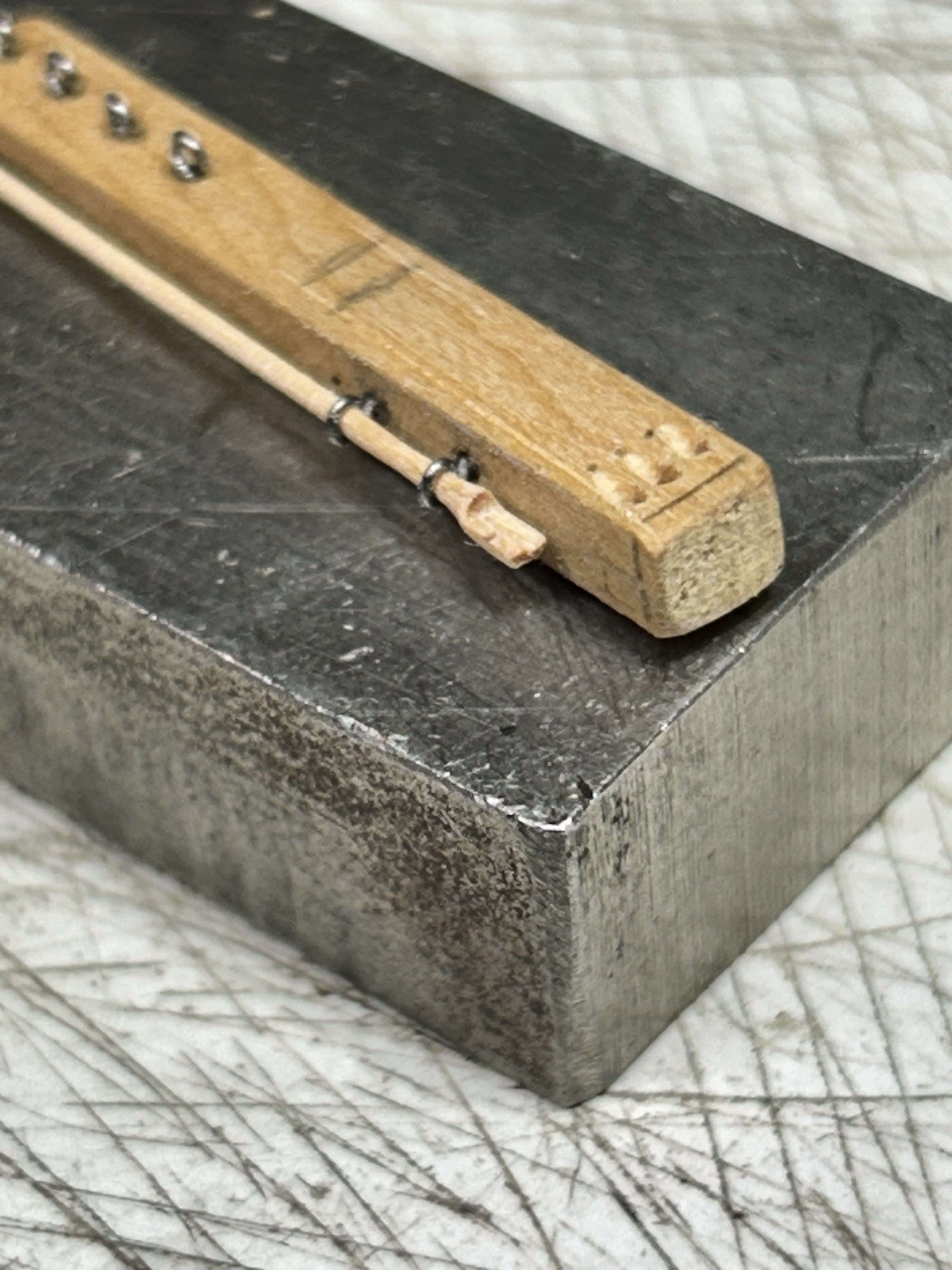

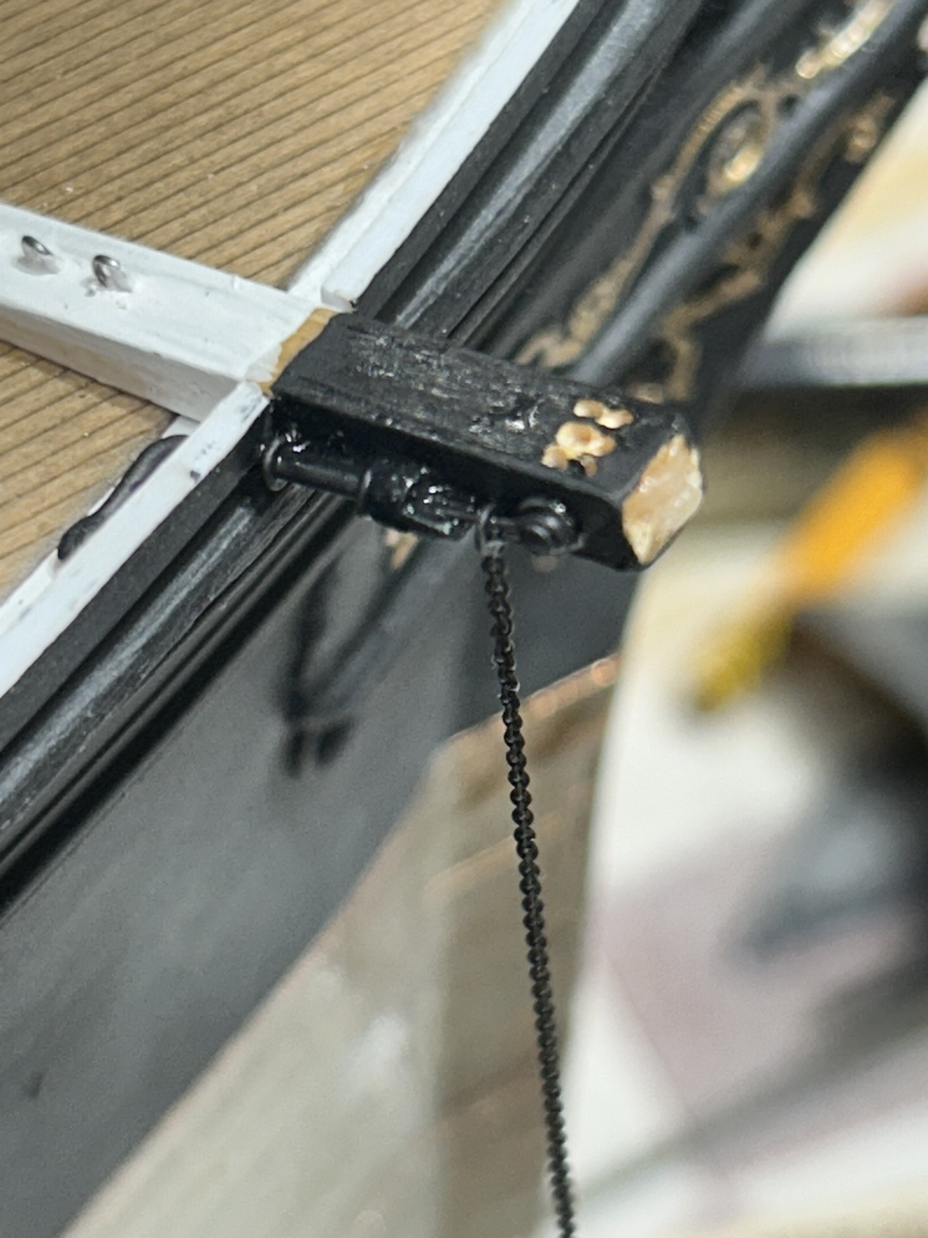

Worked on the anchor release mechanisms
Rob

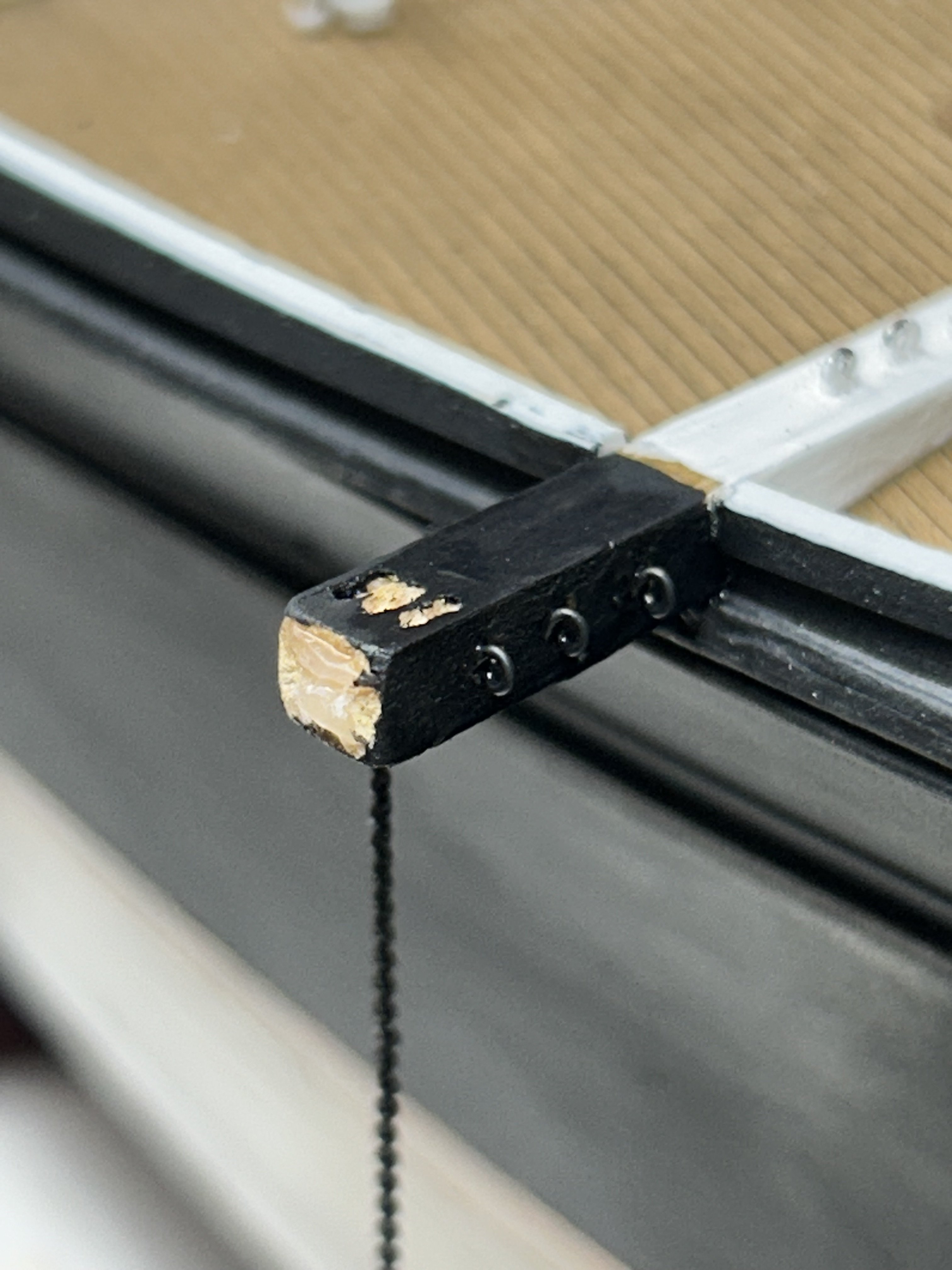

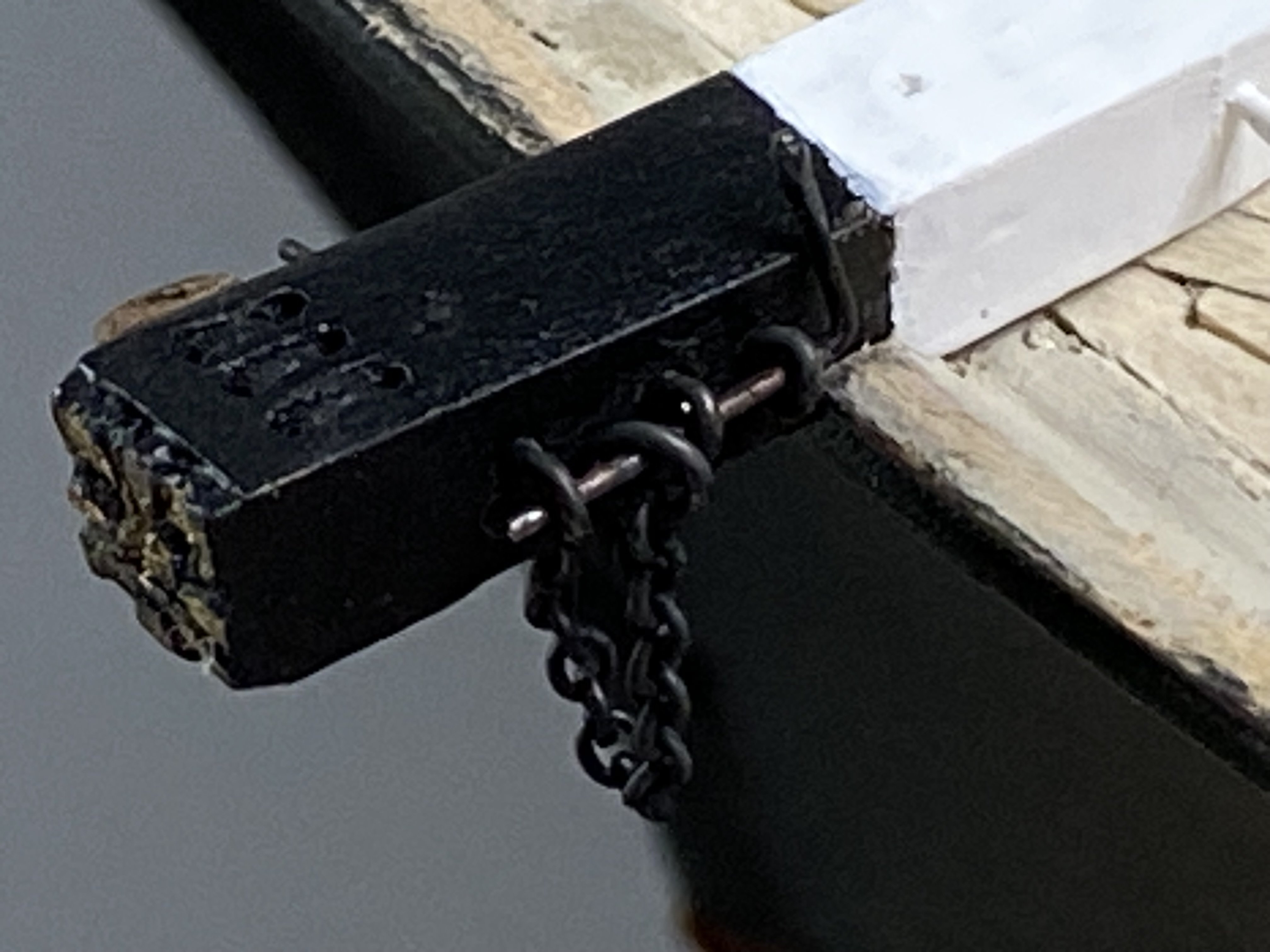

First coat of paint. I’ll add the painted cat facings a bit later.

Remember..that cathead is no longer then 9/16" and the release mechanism is very tiny.   I will finish off the gilded cat face on the end next.   I won't be adding the anchors until I have finished installing the splash rail
Rob

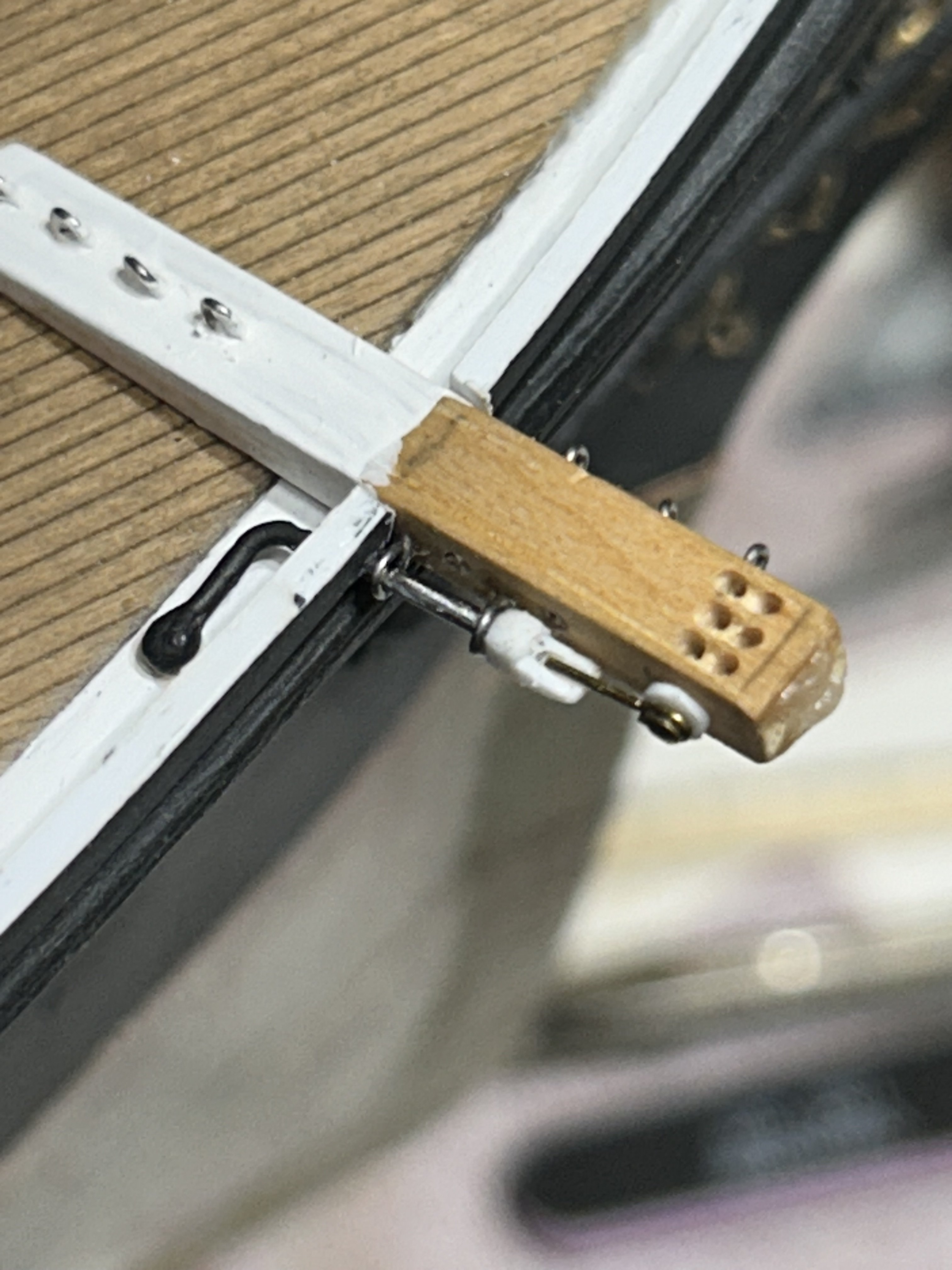

5 hours ago, Rick310 said:
Nice job on the anchor release mechanism!
I went with a more simple version, just a bar that could be pulled back to release the chainIMG_1840.thumb.jpeg.9ddefe8b9961fa313eeb7a9f2308059c.jpegRick
Rick, I wondered how you did your release.  I went back and forth....from the latch, like device on the Flying fish to EDT's Young America twist release.  I went with the latter.  It had to  drill an exact hole through the Rail, aligning exactly with the release bar.  It was a booger to install and then paint.
