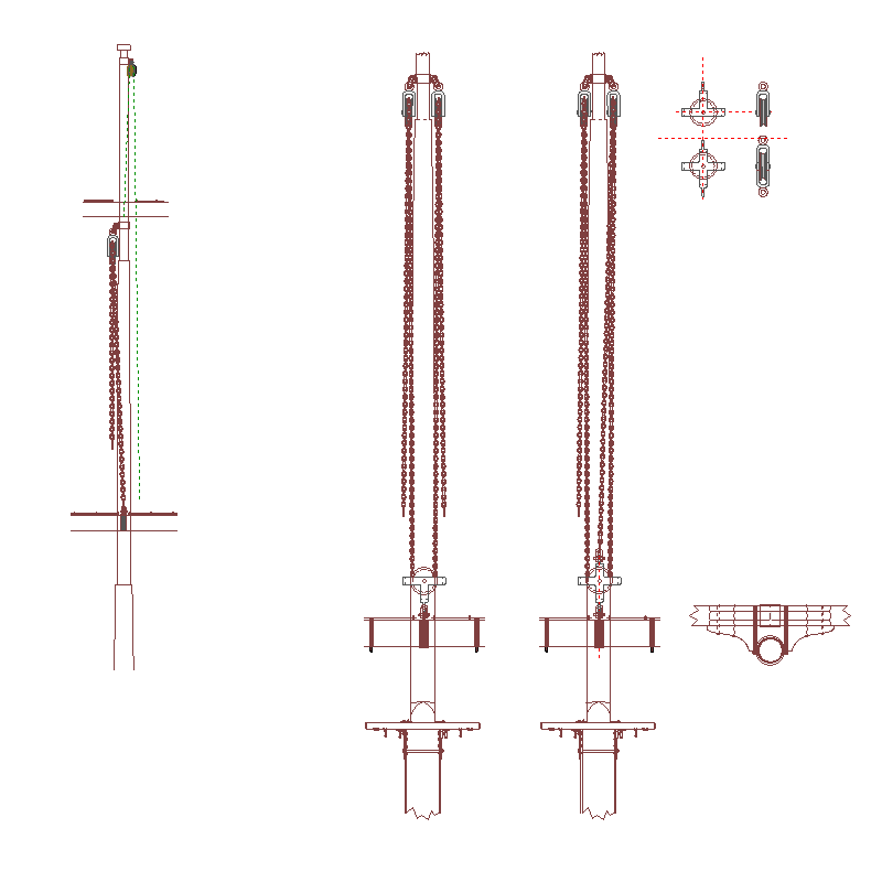

Hi Rob, the middle illustration illustration (97) and the last picture in the same post ere of great interest to me as I believe they show the way Victoria was rigged (using gins).  I also agree it is more likely the slings attached to the centre band of the yard (I believe that is the way Nares describes it from recall).
Could you please let me know the reference from which these were taken?
cheers
Pat
cheers
Pat
Pat...I believe I got illustration 97 from an online reference for the model plans for the clipper Flying Fish.  The last is of the Barque James Craig.

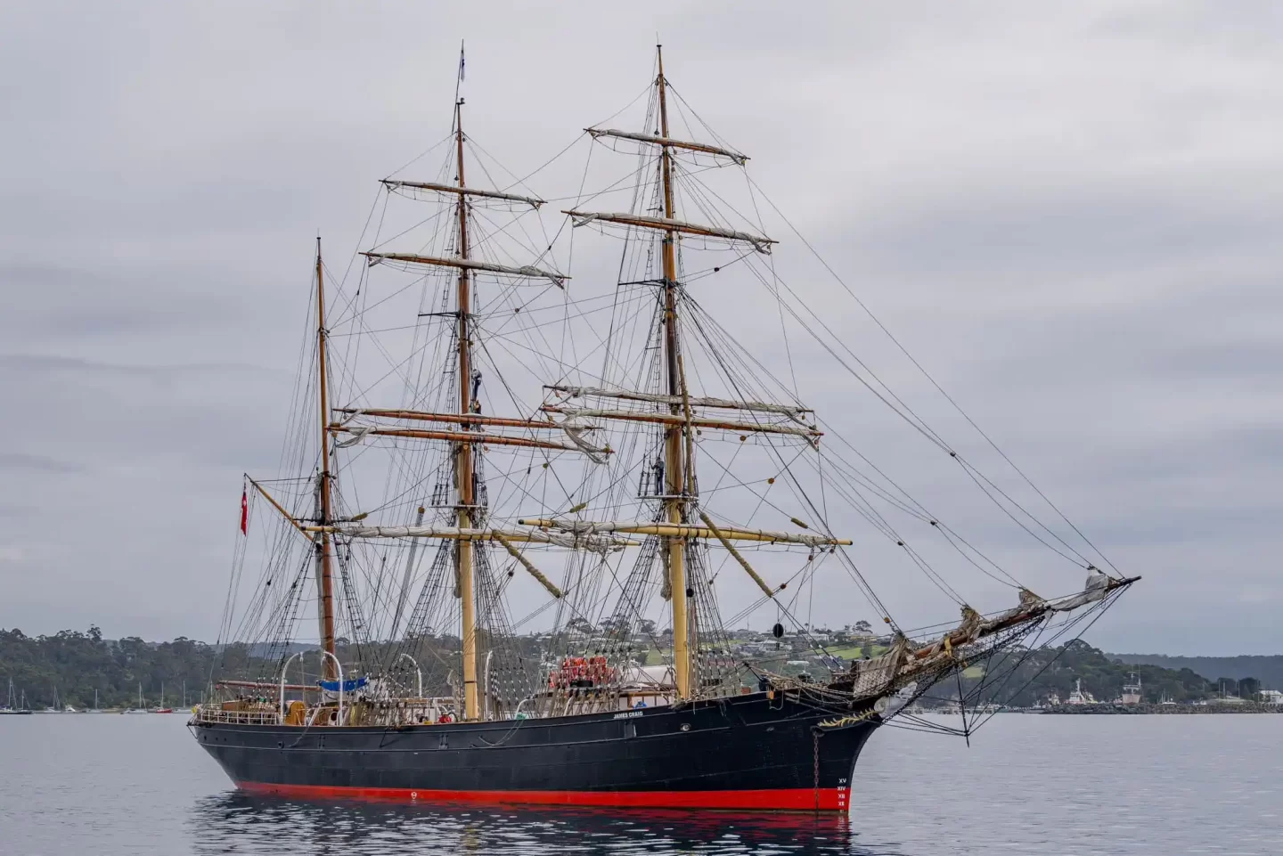

Rob, I noticed that lower and upper topsail yards on Barque James Baines have an octagonal center just afore her fore and main masts. Something I haven't seen on wooden masts before.
Possibly to retain the banding from possible rotation on the yard.   I’ve seen this octagon centers on other ships before.

Rob, D'oh! I meant James Craig and in a rush, since I was distracted picking up my wife from work, typed the wrong ship....

Pat ……I love both of your examples. But if you examine the action of the tie cable….. you will see. That the action will not permit a parral lift cable to be affixed that would not be in danger of following the rotation of the chain along its gin block travel.  Making it useable.
Under normal tie lift action,  the parral lift cable affixes to the central tie chain.  And both move in tandem. One lifting the yard, the other lifting the parral band.  Without this cable, the parral band will bind.
Rob

That's a good point Rob, and one I had not considered. While the Rigging Warrant is silent on this cable/rope, it makes practical sense to have one fitted/rigged, so I will probably add that.

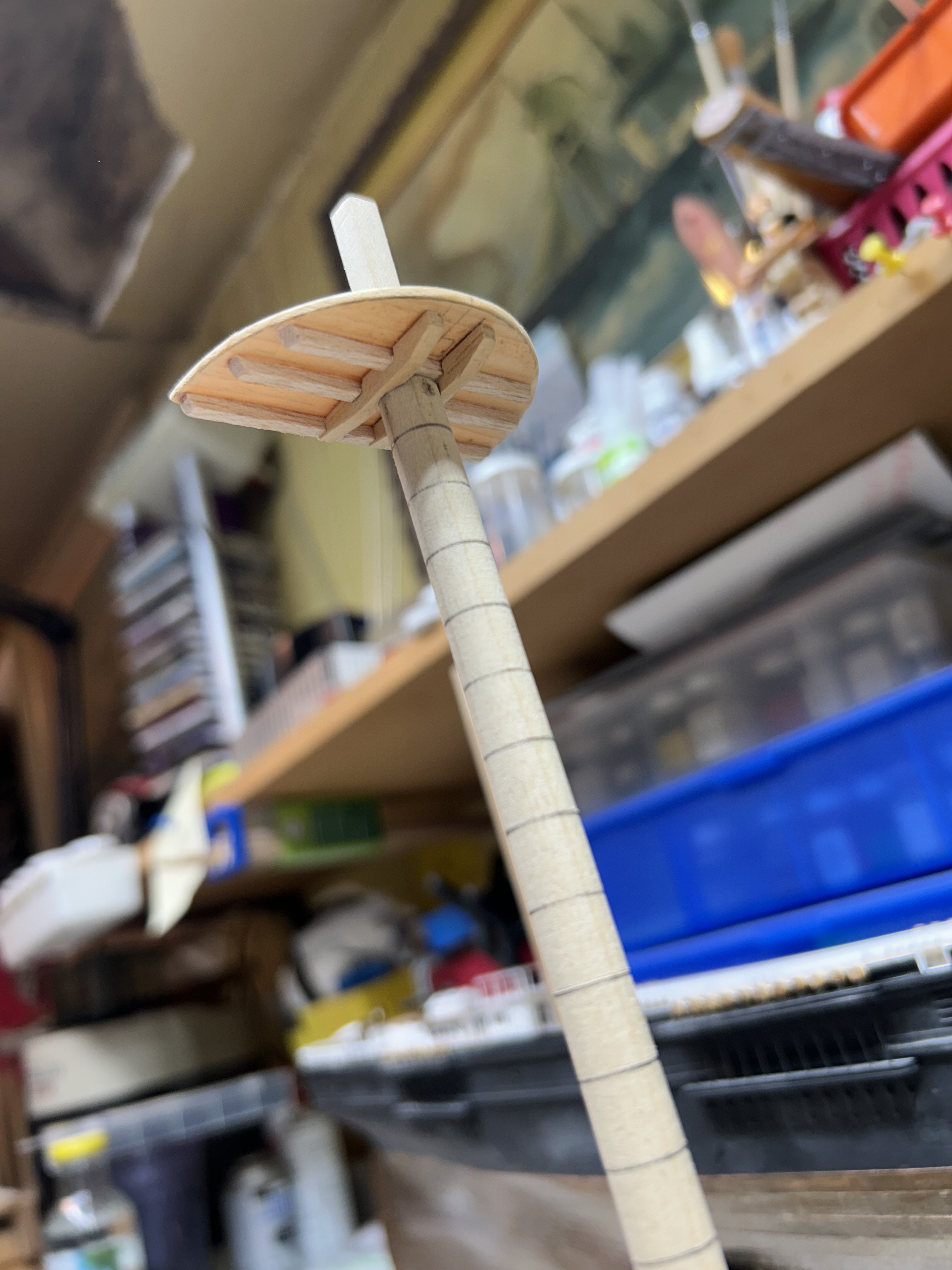

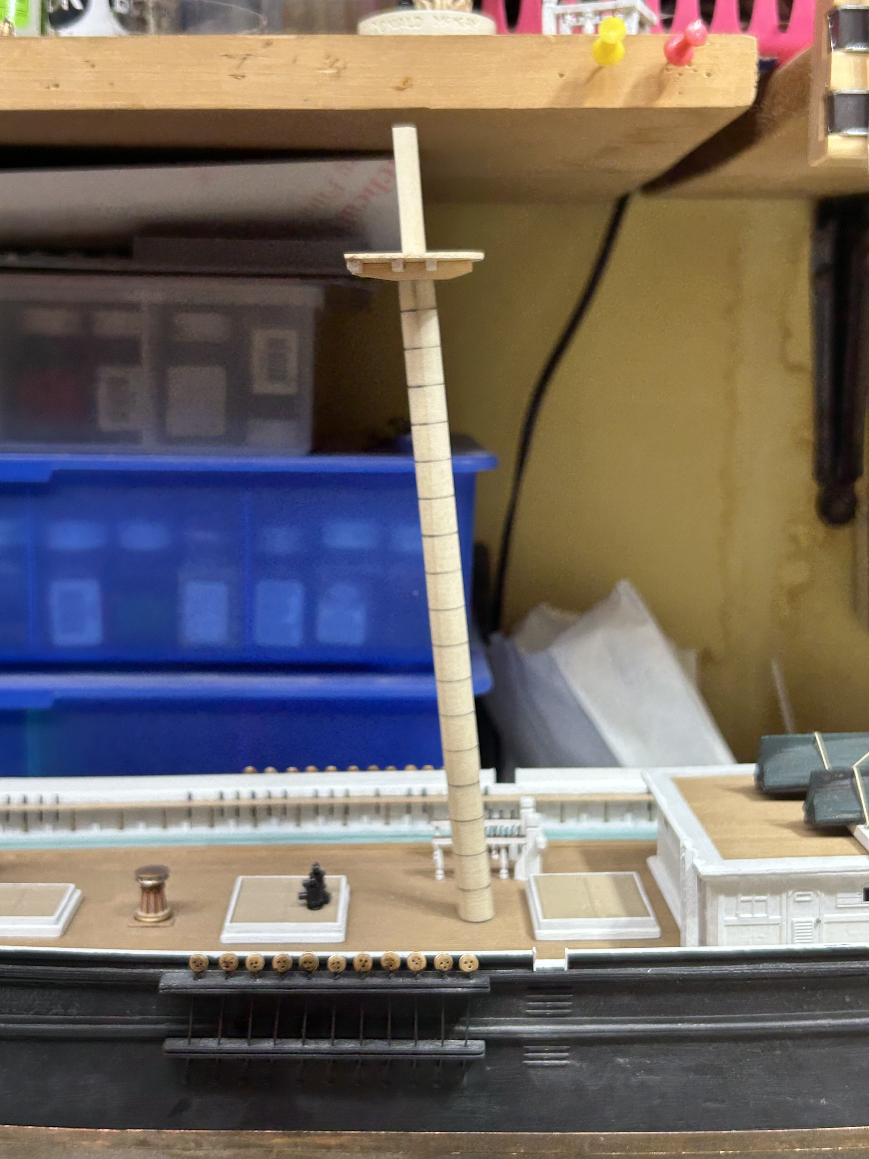

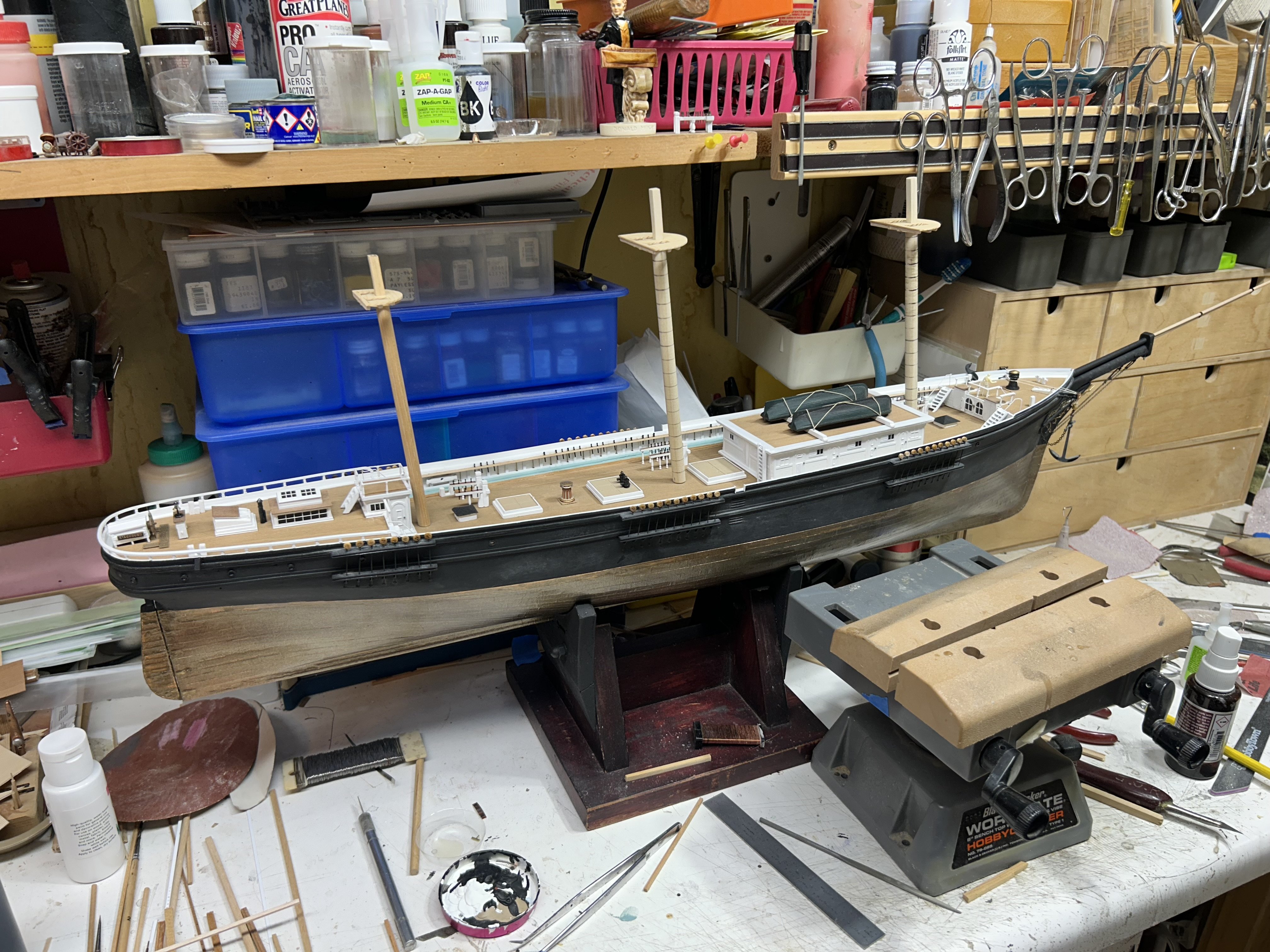

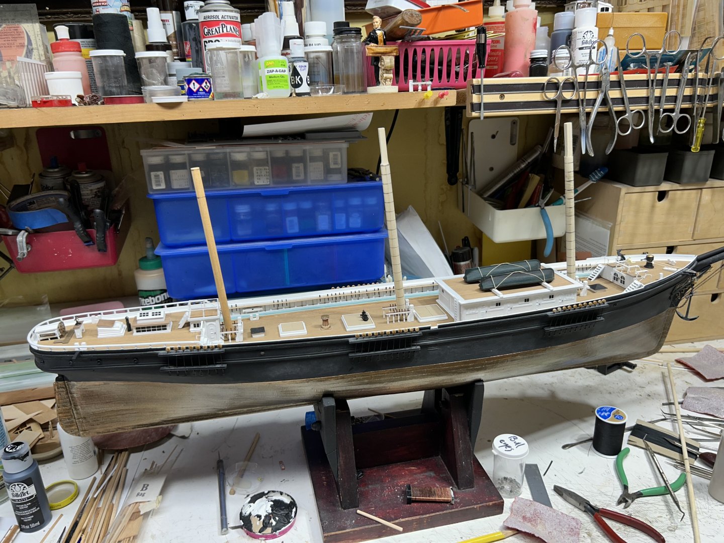

I began the construction of the 3 lower masts.
Turned , tapered and marked out banding locations.
Rob

Pat.  It came to me, so clearly.  You can still use the double gin blocks at the tops, as described in Duncan McLeans description of flying Fish(which so happens to match your Victoria schematic).
If you use the arrangement on the right...with the double gin blocks at the tops and a single gin block at the yard(which has an insertion eye) to affix the tie cable too)  You can still add a parral band lift cable to the center chain just above its insertion point on the block.  This portion of the tie does not rotate around a block....but simply moves up and down, in tandem with the yard and parral.
I feel satisfied and comfortable with this arrangement for my Staghound.
Your thoughts?
Rob

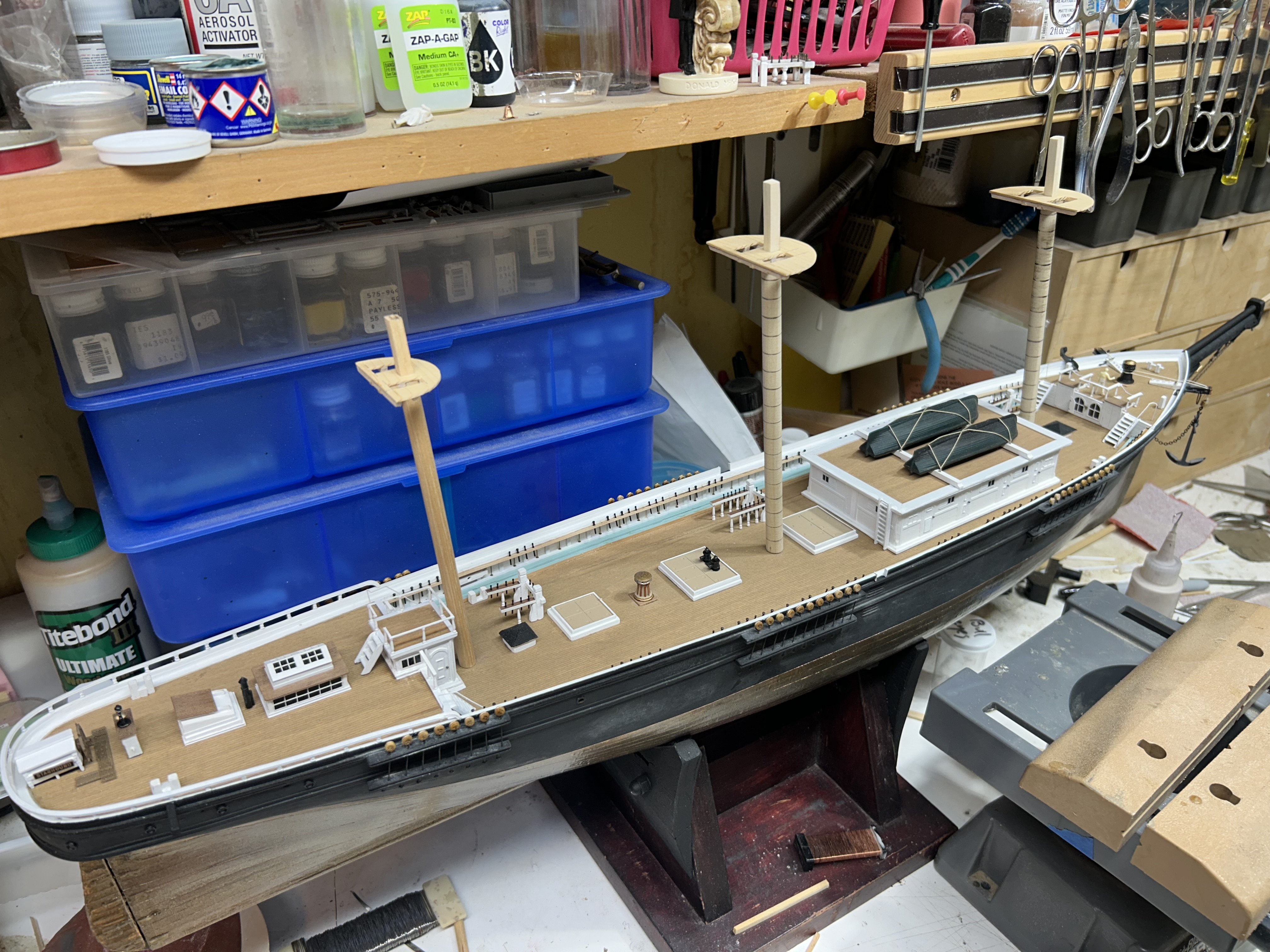

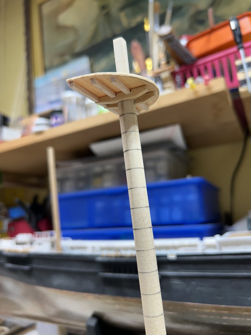

Spent a little time working on the 3 tops.  Still have details to add, but the base construction is done.
Rob

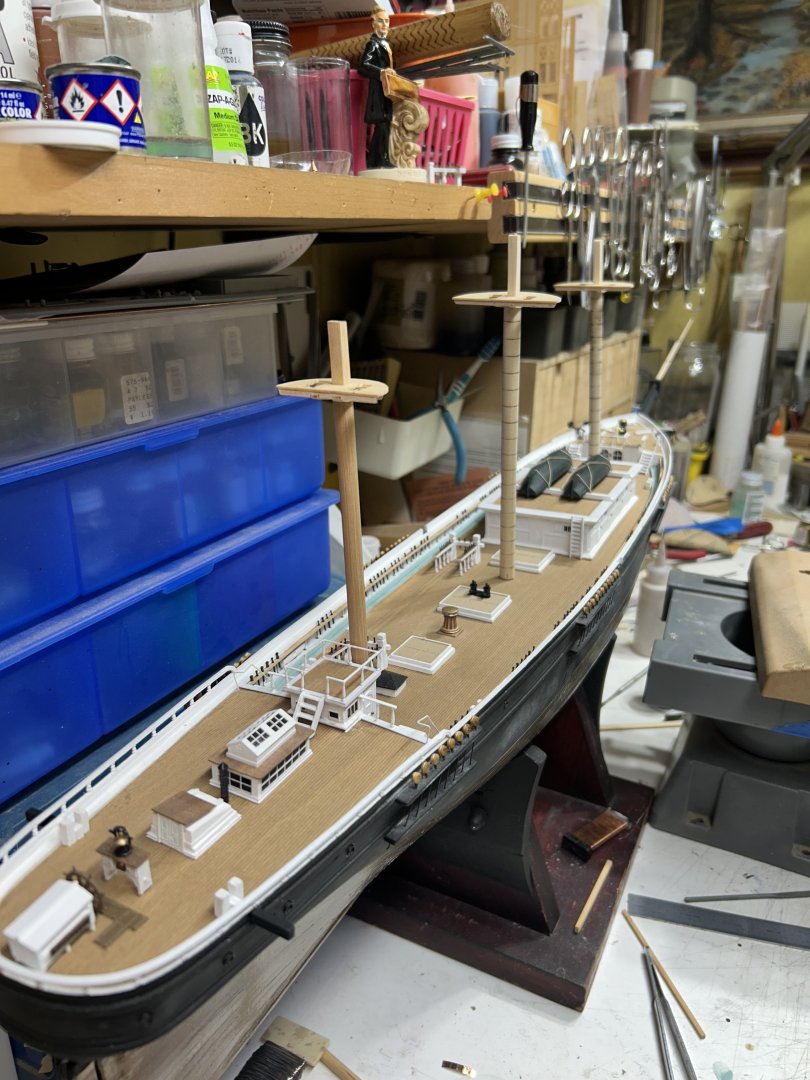

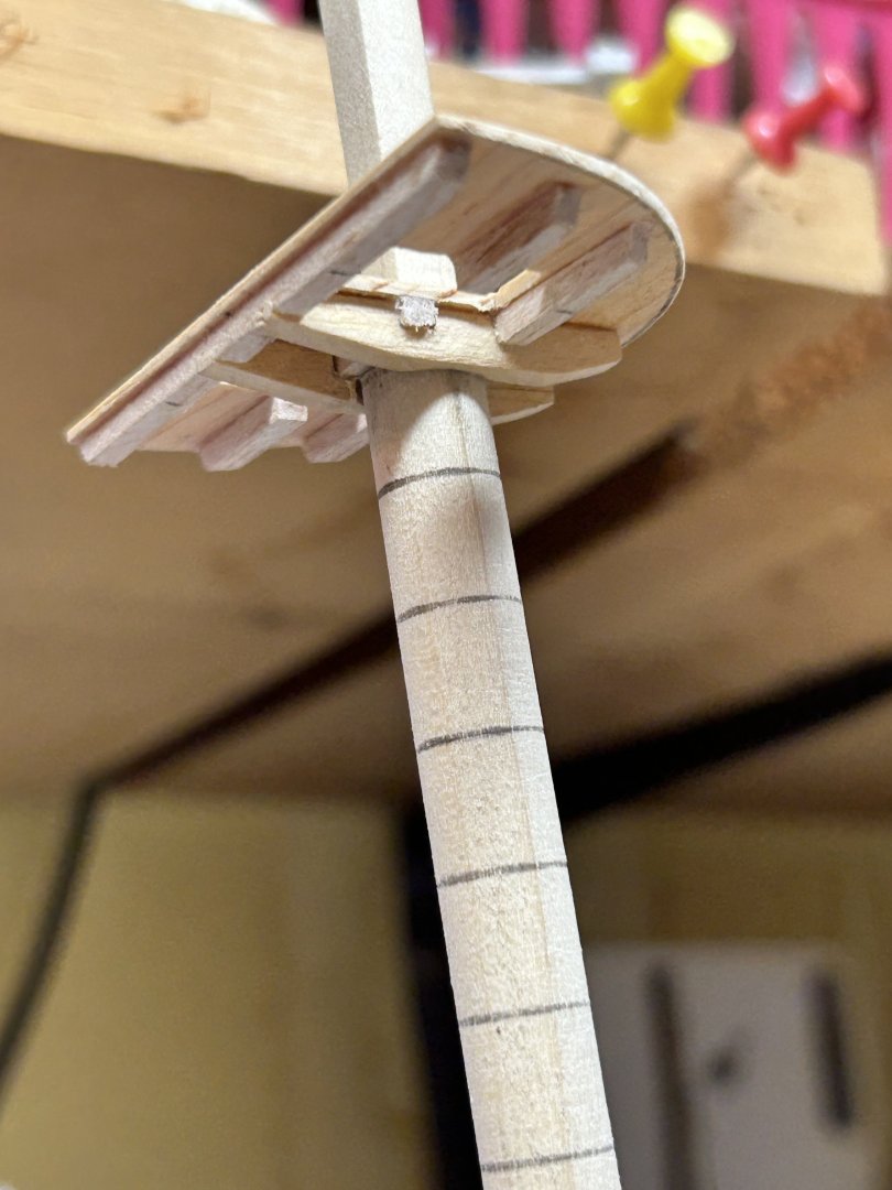

As I mentioned.  I will begin adding detailing and adding trim.  The cheeks won’t be added till I finished banding the main and fore masts.  Once done, I’ll glue and paint the lower masts.
I’ll then move onto the top masts, which will be varnished wood.  And so forth, till the mast is built.  No real detail will be added at this time , that will happen when each mast is treated as a single project.  Till then…….simple mast construction.
Rob

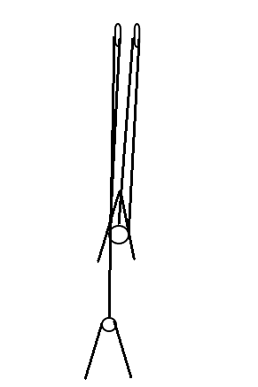

With the suggestion I made...it is easily applicable to 2 purchases.  One port the other starboard.  Simply end the tie chain heading back down to the deck with another gin block.  Then run chain down to each purchase point and end in the block purchases.   In essence the tie gin block would be the same for any double topsail arrangement.  The tie leaves the yard, goes up through the mast fairlead pulley, just under the top tree....back down to a gin block that separates the two port and starboard purchase lines.
That is how I plan on rigging the heavy topsail yard.
Here is rudimentary drawing depicting what I'm describing.  Note the gin blocks....the path of the tie.....the addition of the P/SB purchases......and the parral band wire lifts.
Rob(Thanks)

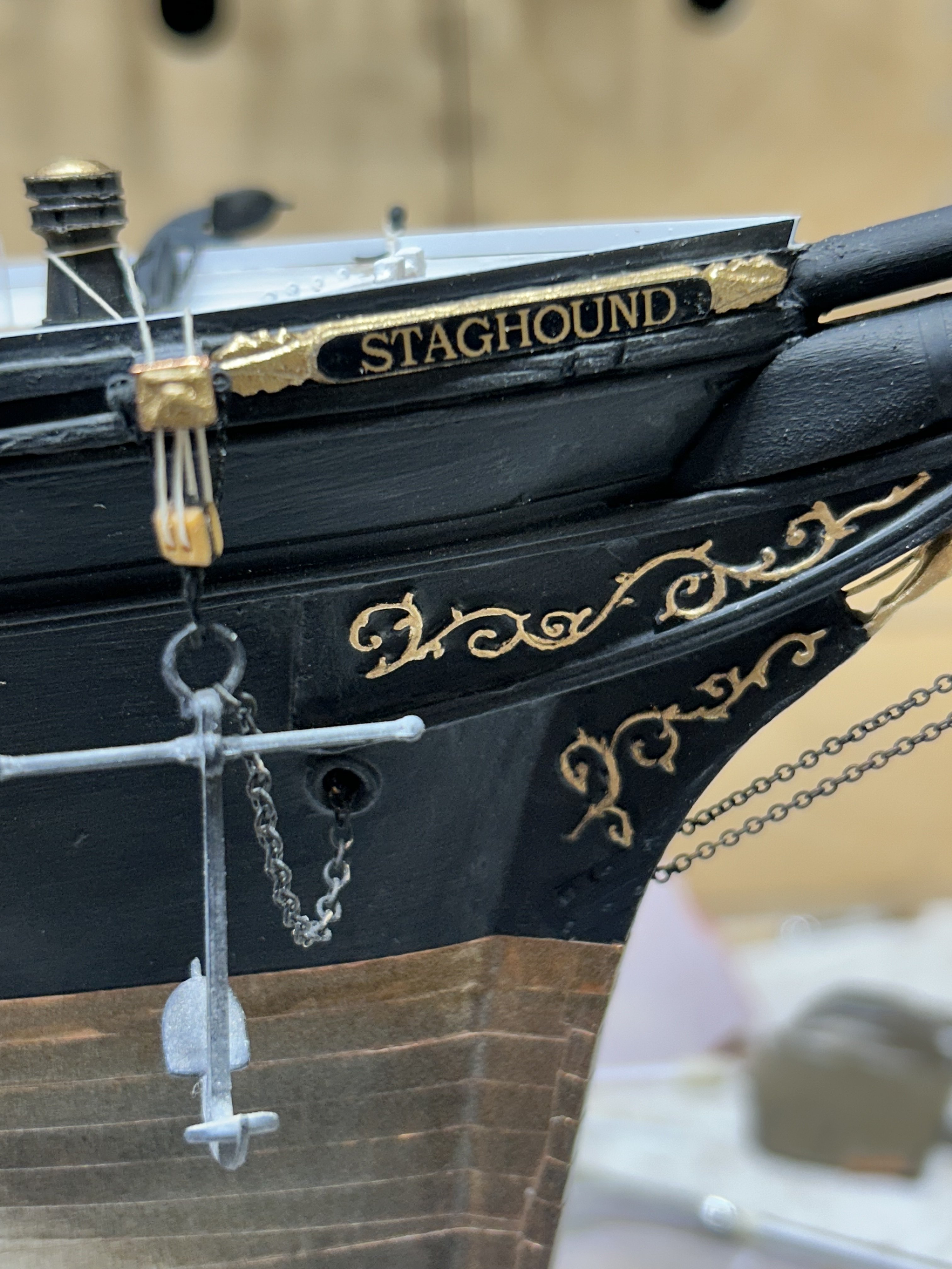

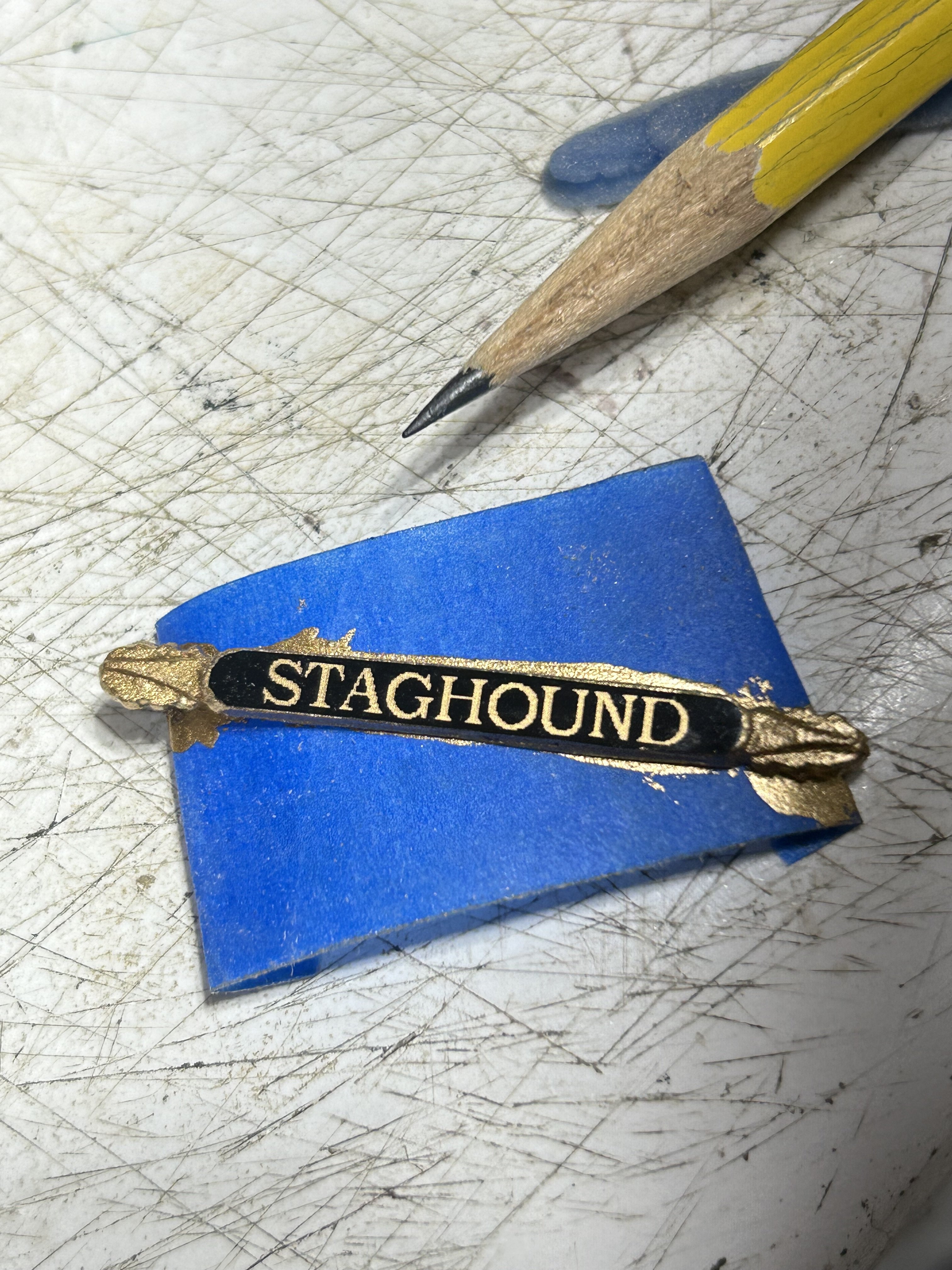

Spent just a little time making the name boards.
Rob
