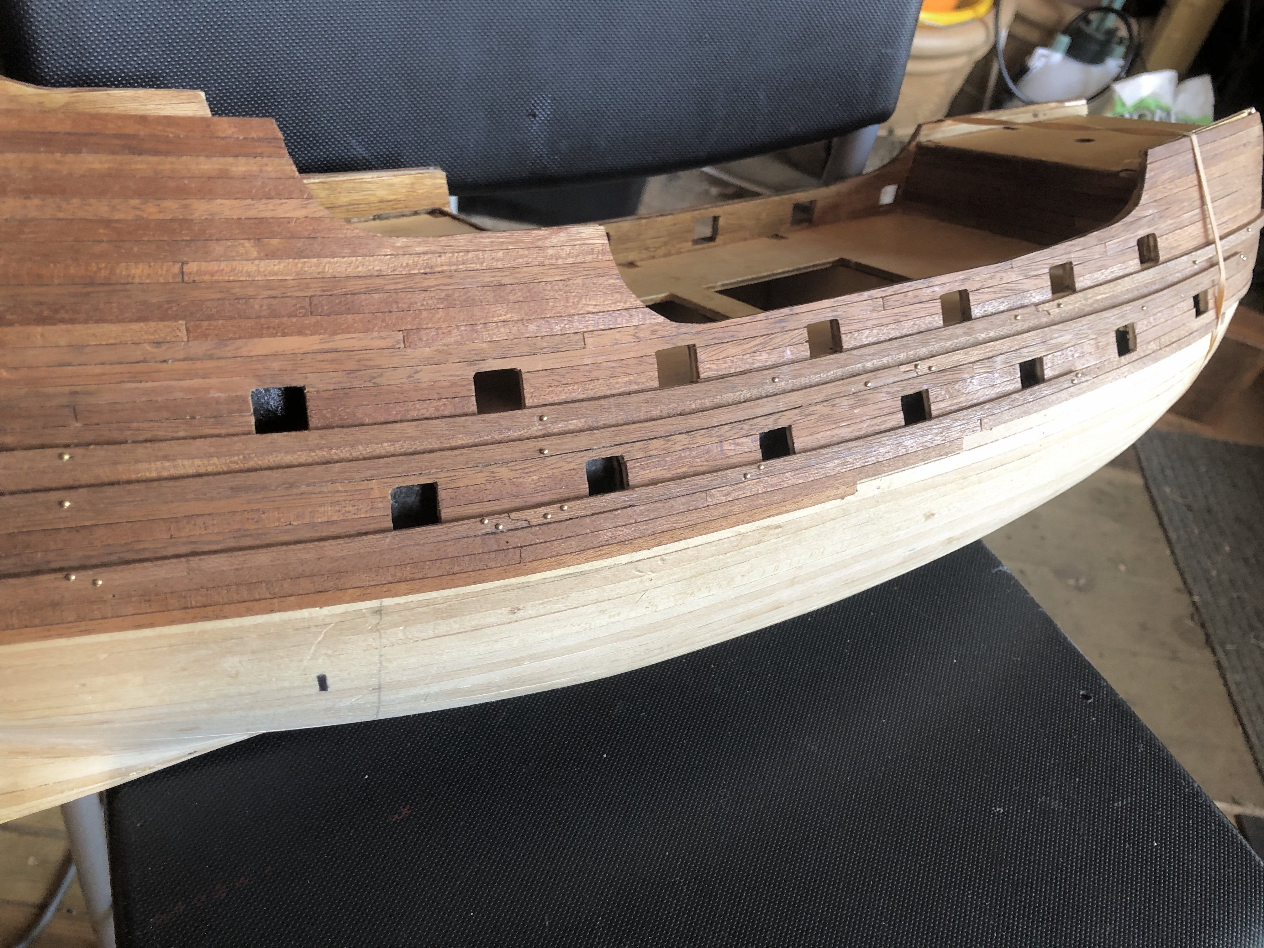

Finished the planking above the wales, but looked too light, I had tested samples of African walnut with a coloured Danish Oil and it looked perfect just about dark enough. Coating the ship with this oil and what a disappointment every blemish, wood glue stain was revealed. Lightly sanded down and reapplying no better, tried staining with medium oak no better. Everything had to come off, continuing without being happy with the hull would be a killer. Looking at my San Martin, covering with mahogany and finishing with diluted poly u varnish has aged well so that’s what I did. Going for the chunky finish using the grain and the texture of the planking to give an old galleon look. Looking on the bright side I can remove planking on hulls and decks quite easily and redo.

Very nice. Shows off your clean planking work.

Looks like you are just a little ahead of my on the apostol.  I just finished first layer and am now working on second.  I like bseing that you are running your second plank as individual planks rather than single planks the whole length.  Are you doing the same below the wales too?
I'm on my third build and for the first to, I used wood glue for second planks.  Got real lucky and no glue bleed but what you are facing has been my fear with such thin planks.  I'm trying contact cement this time but that comes with it's own challenges!
I like the quality and detail you are putting in so I'll follow along.

thanks for nice comments, yes I am not going to do one long plank. I am not rigorously doing a regular  butt shift but I am going to put vertical strakes which will hide the lack of pattern. I like lights on yours.

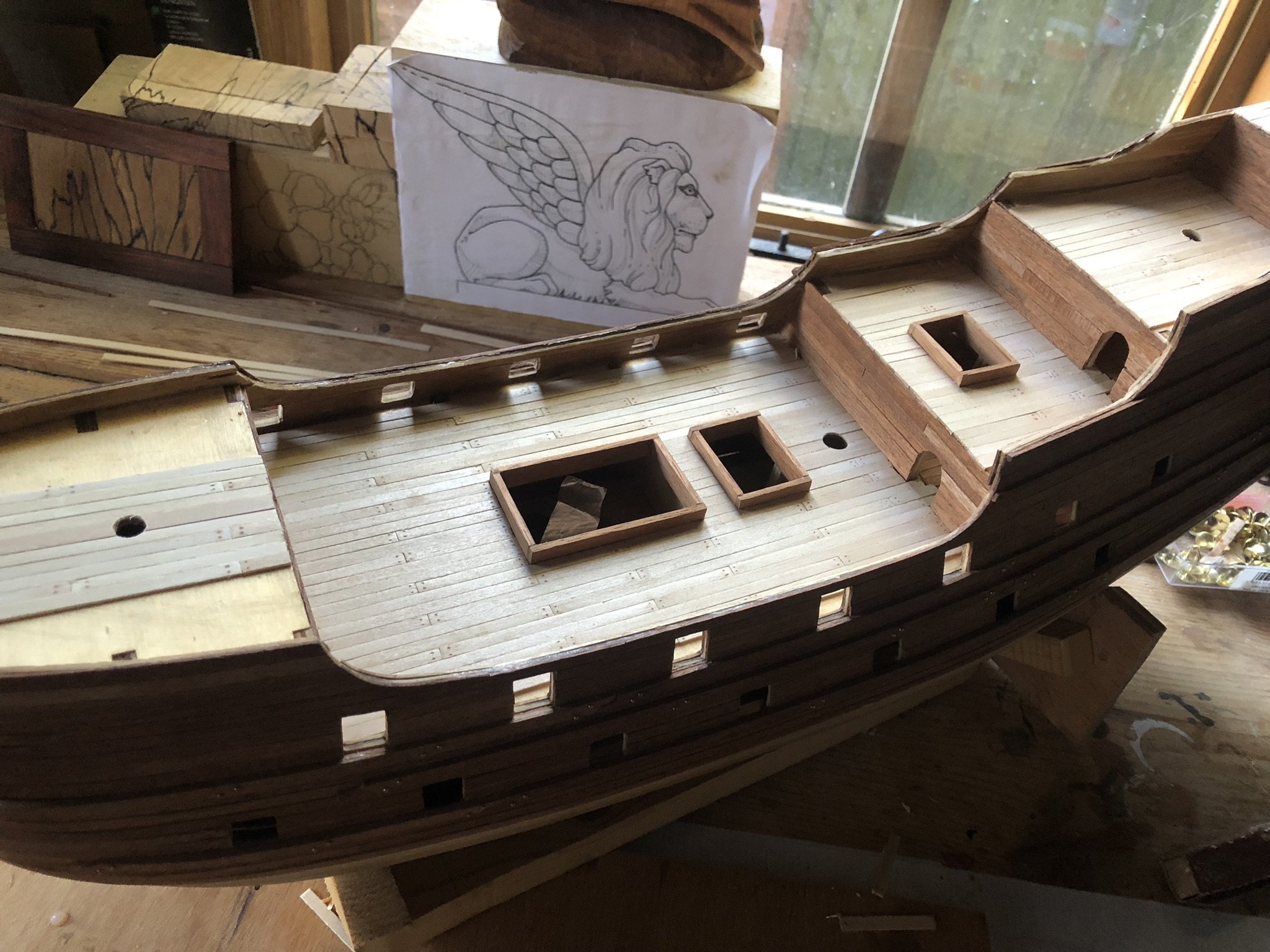

More planking, now the main deck

Decks nearly planked. Trying to use slightly different tones of lime to make it more interesting, but only strips I’ve remaining are very pale and the same so will order a few more in hope
for more variation.

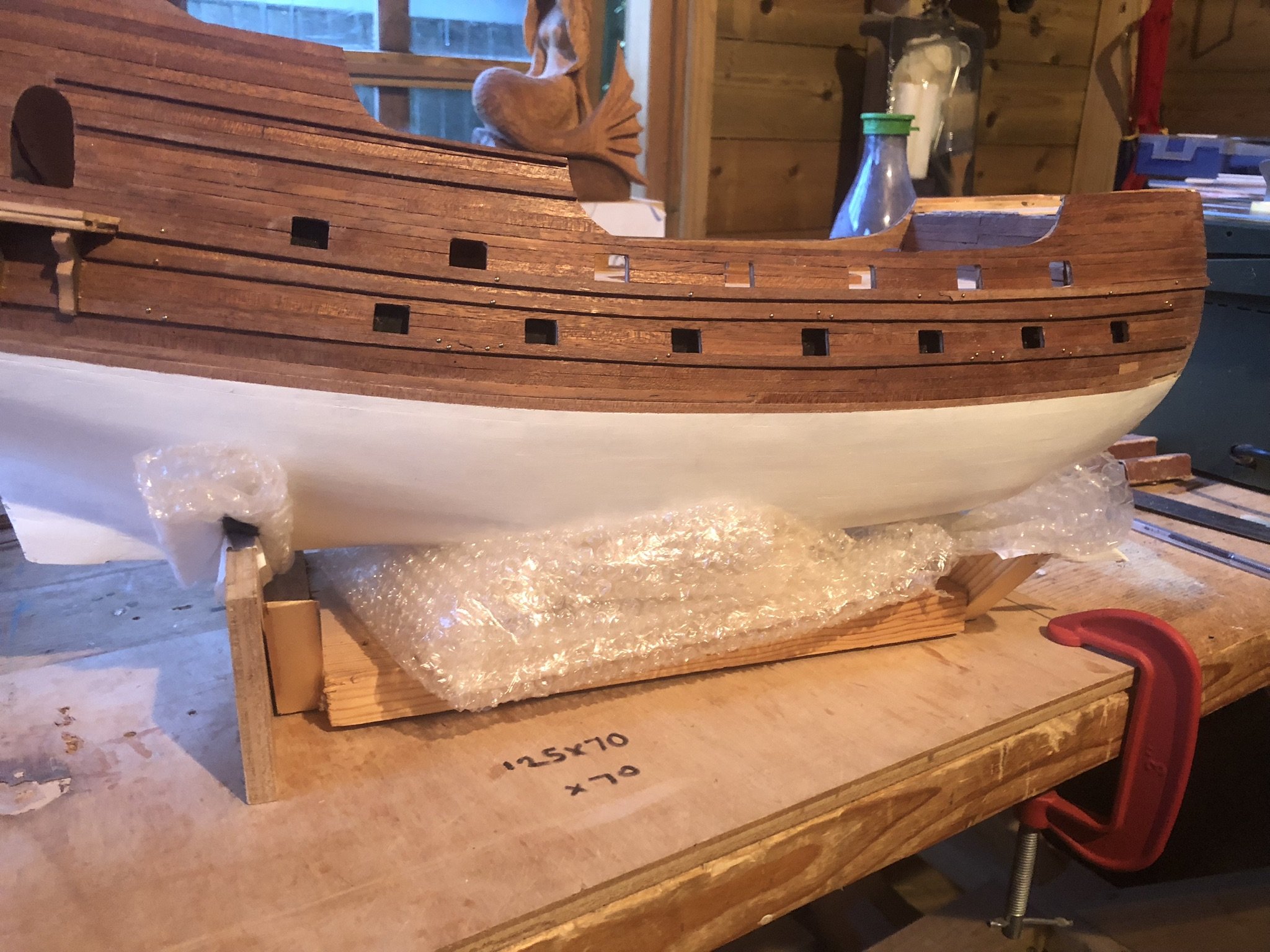

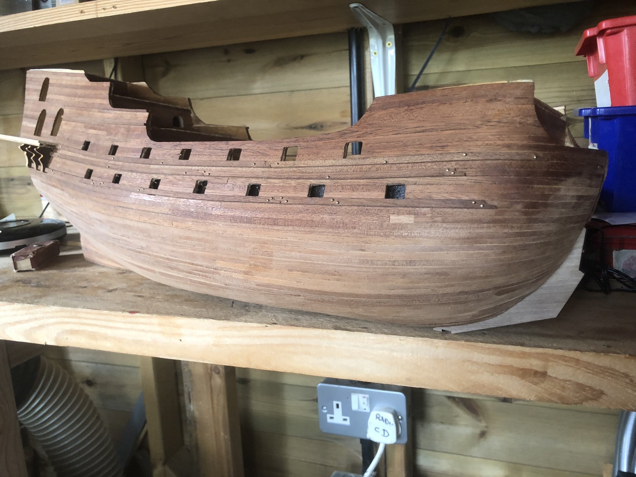

Finished planking lower hull, more planks used than expected and second batch of pseudo mahogany ordered was markedly different to what I had in stock, bit of a sickly orange but decided to use since if I reordered would new be any better? Anyway planking was acceptable not my best work mind. Bearing this in mind decided to paint bottom to represent white stuff. I have seen images of Spanish galleons painted with it. After much filling, sanding, painting, re-sanding quite pleased. Sure it will need redoing later after working on ship, but anyway shows hull is ok.

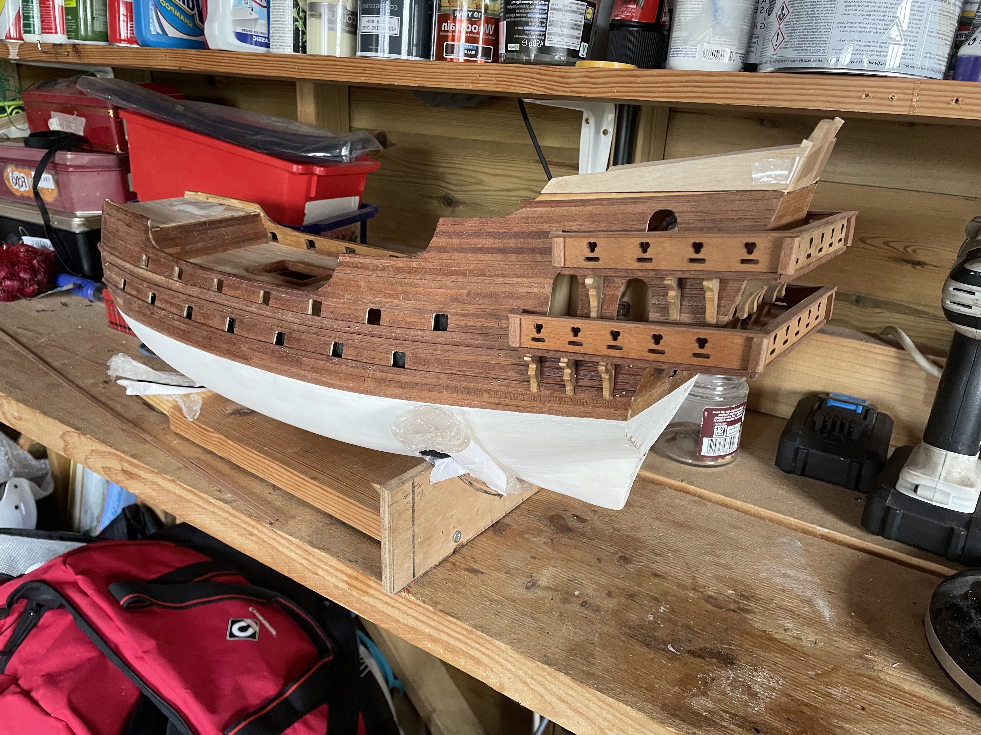

Slow progress I’am having to glue a plank wait for it to dry before doing the next one. Light oak stain on the supplied balcony pieces is quite a good match. There’s a few of us doing the Apostle Felipe and all going to look different.. Anyway glad I didn’t install the windows I’d made as there was a bit of sanding involved with balconies.

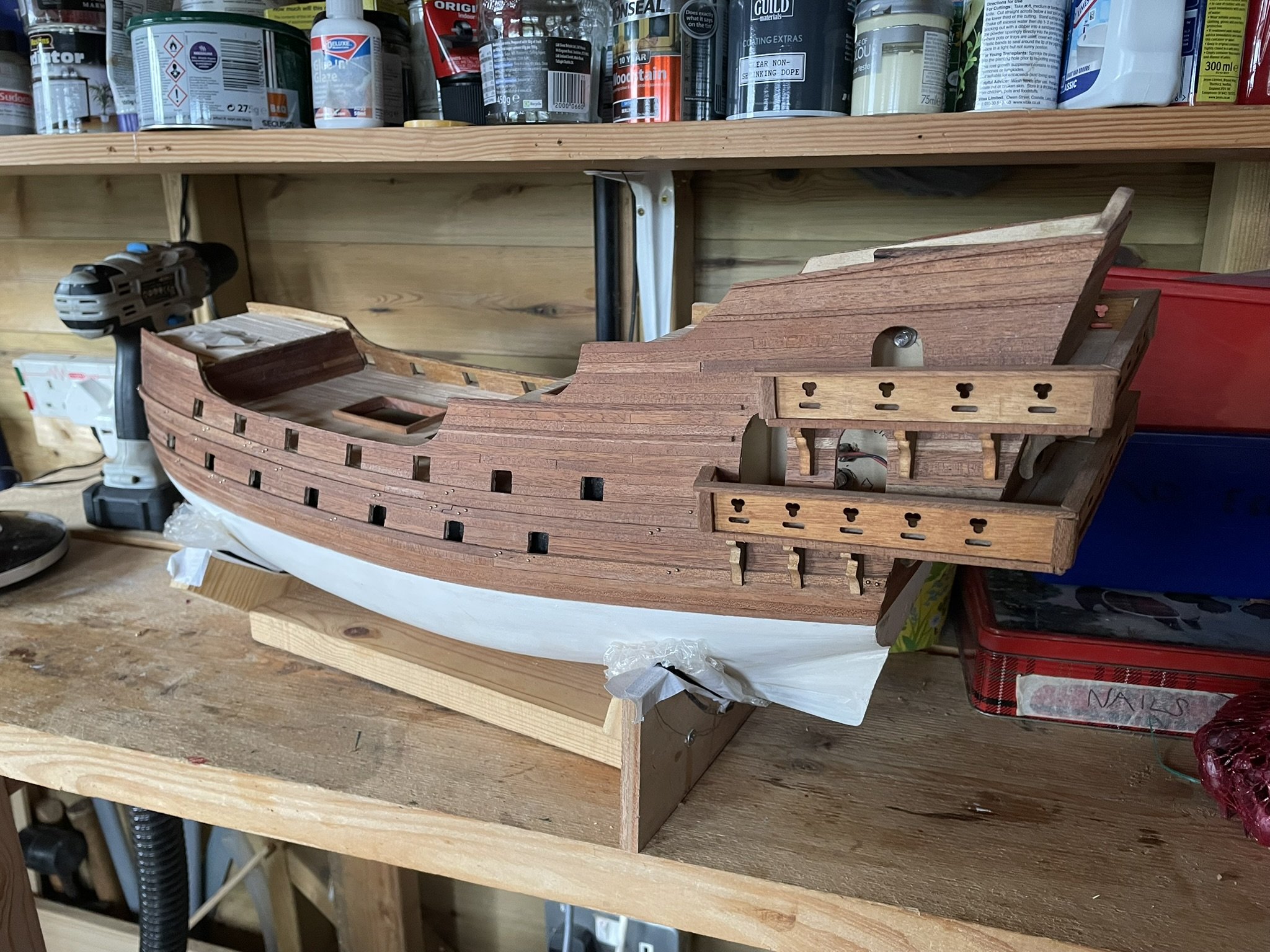

Comparing my model with a painting of similar period galleons, mine didn’t give the appearance I was hoping for. Poop deck too low, my fault as the balconies were slightly too high and in effort to get window shape right they ended too high up.
Decided to add a bit on top. Quite pleased with result. This is the sort of thing Baker does so well, mind his are the result of meticulous research. Mine a gut feeling.
