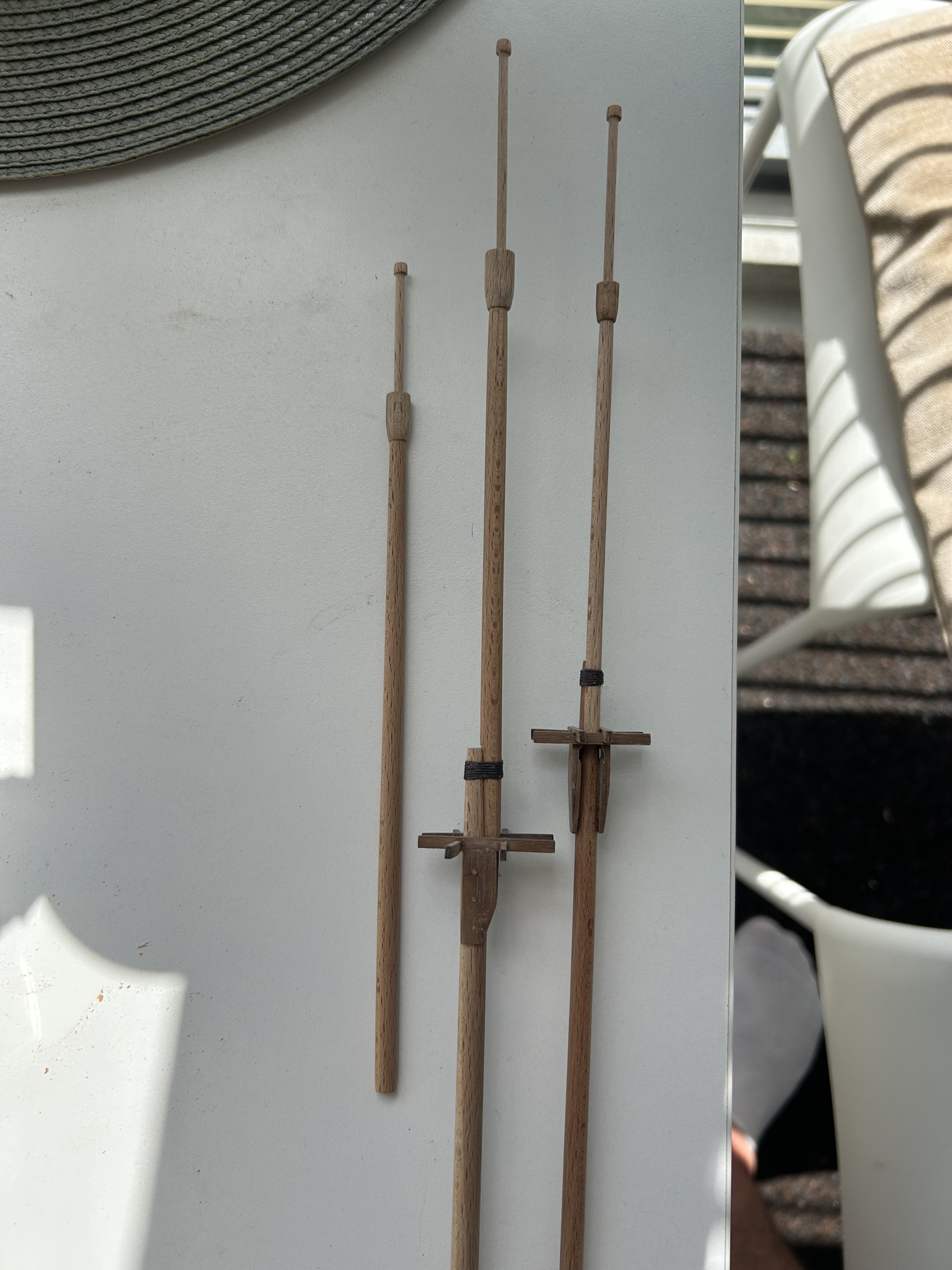

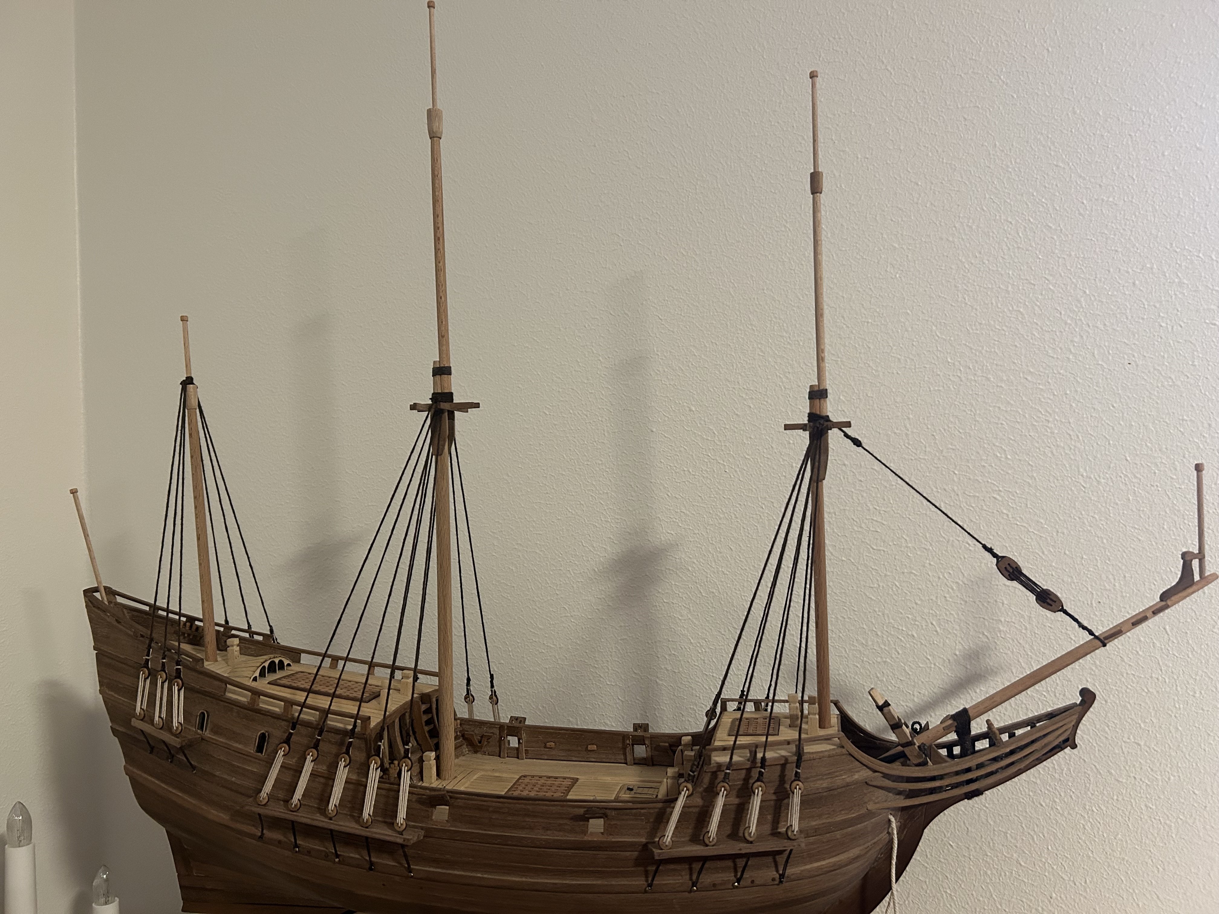

The masts are ready. I have to say, what adds a certain edge to the experience is that they were crafted in true Amish style — entirely by hand. The thing is, when I went to the store for a power drill, not a single one leapt into my arms or whispered that it had been waiting for me all along, insisting I had no right to leave without it. Perhaps that’s just how power drills are. In any case, I never bought one. The only upside is that making each mast has turned into an exciting, slightly masochistic adventure.

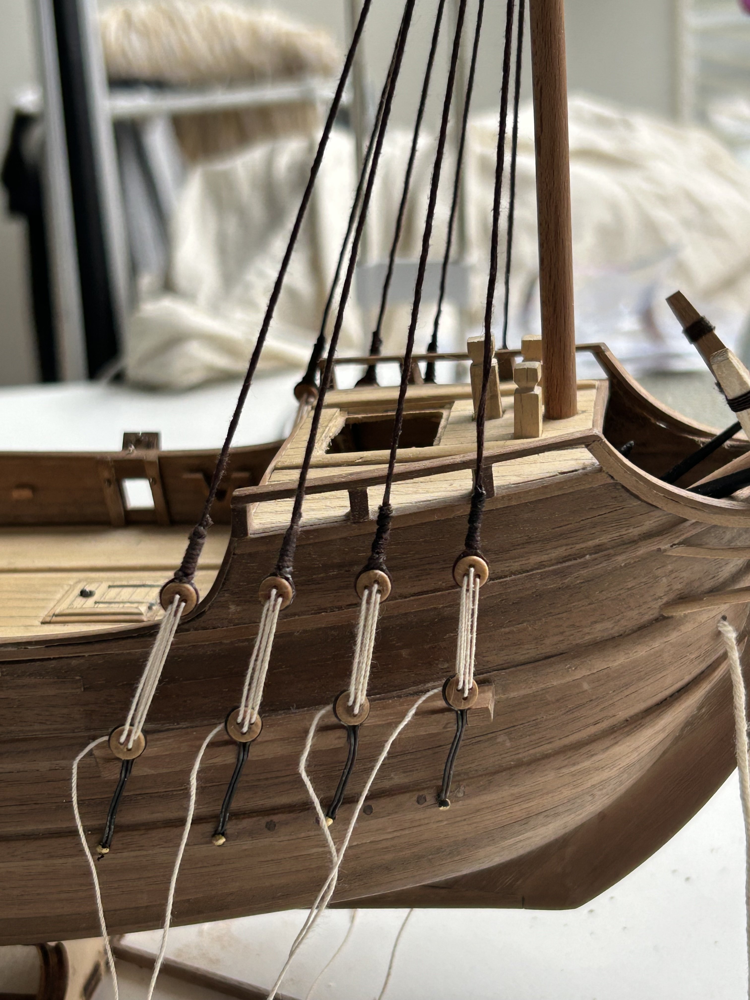

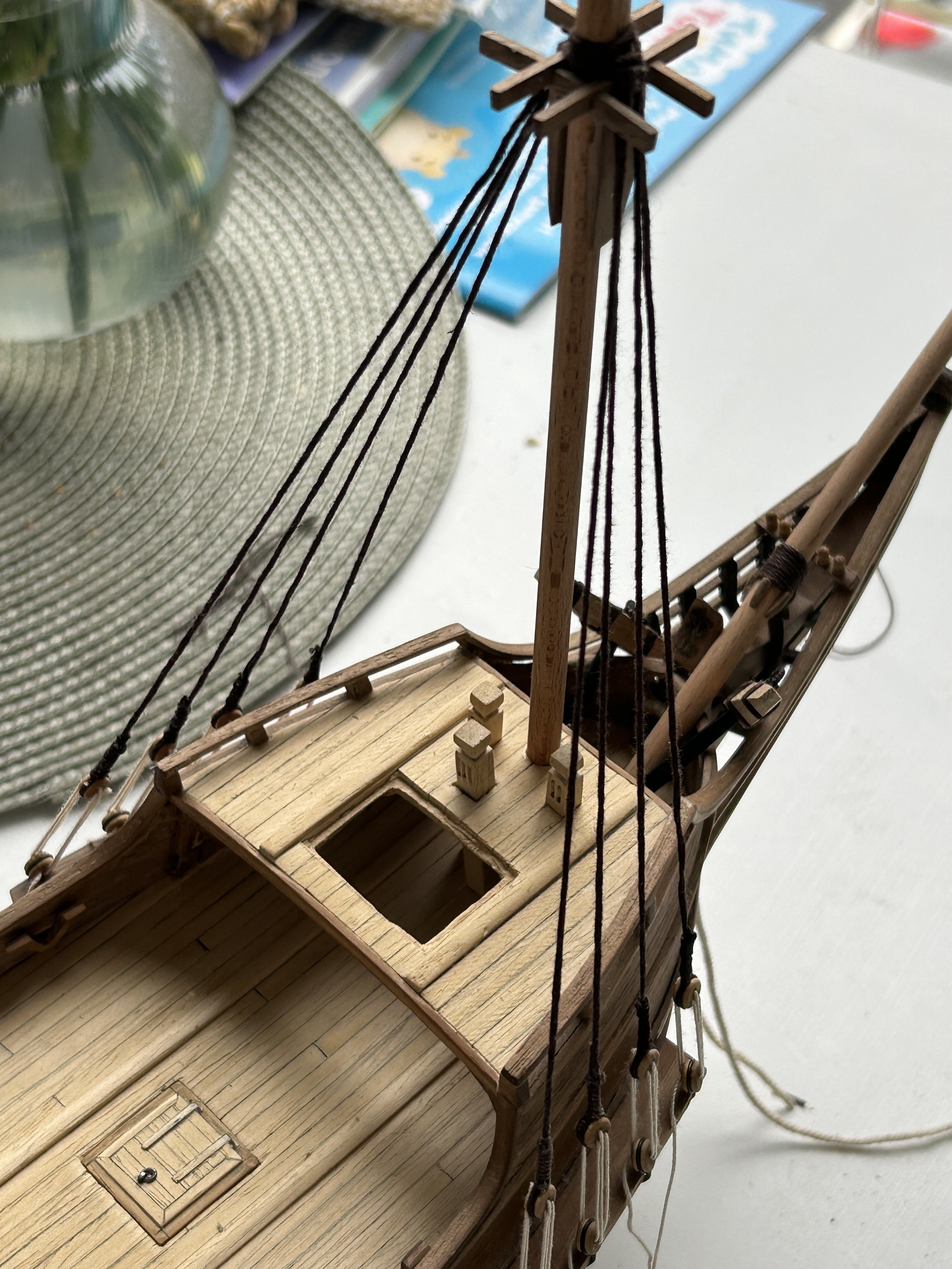

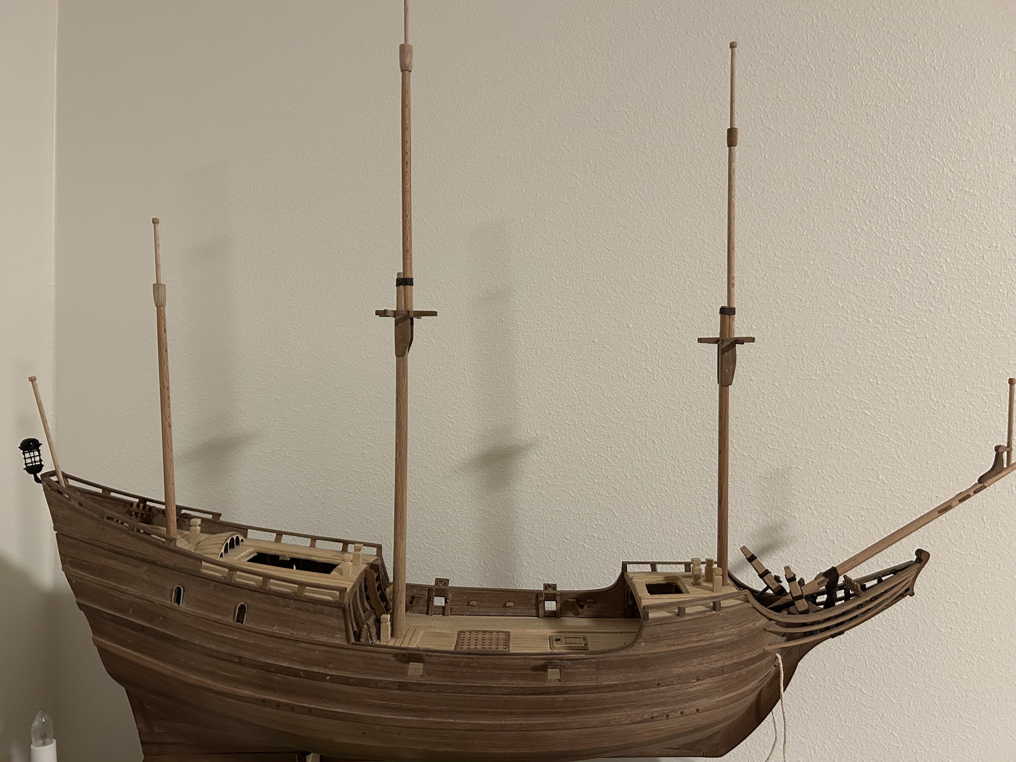

8 hours ago, Olli Sukunimisson said:
Rigging in progress. Heh, Mr. Hans created such a beautiful kit.
The next kit I buy will be a Kolderstok.  I have been enjoying watching the fantastic job you have been doing on this and your previous build.
  - Eric
