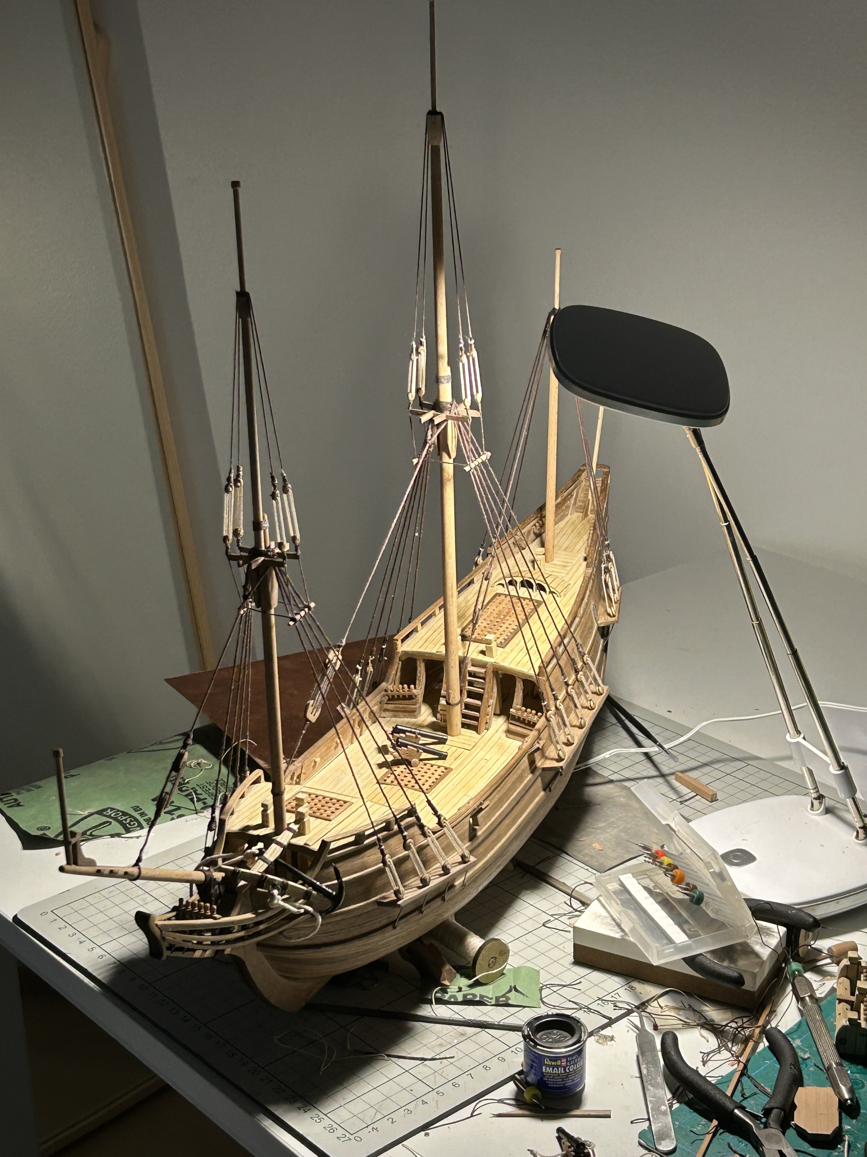

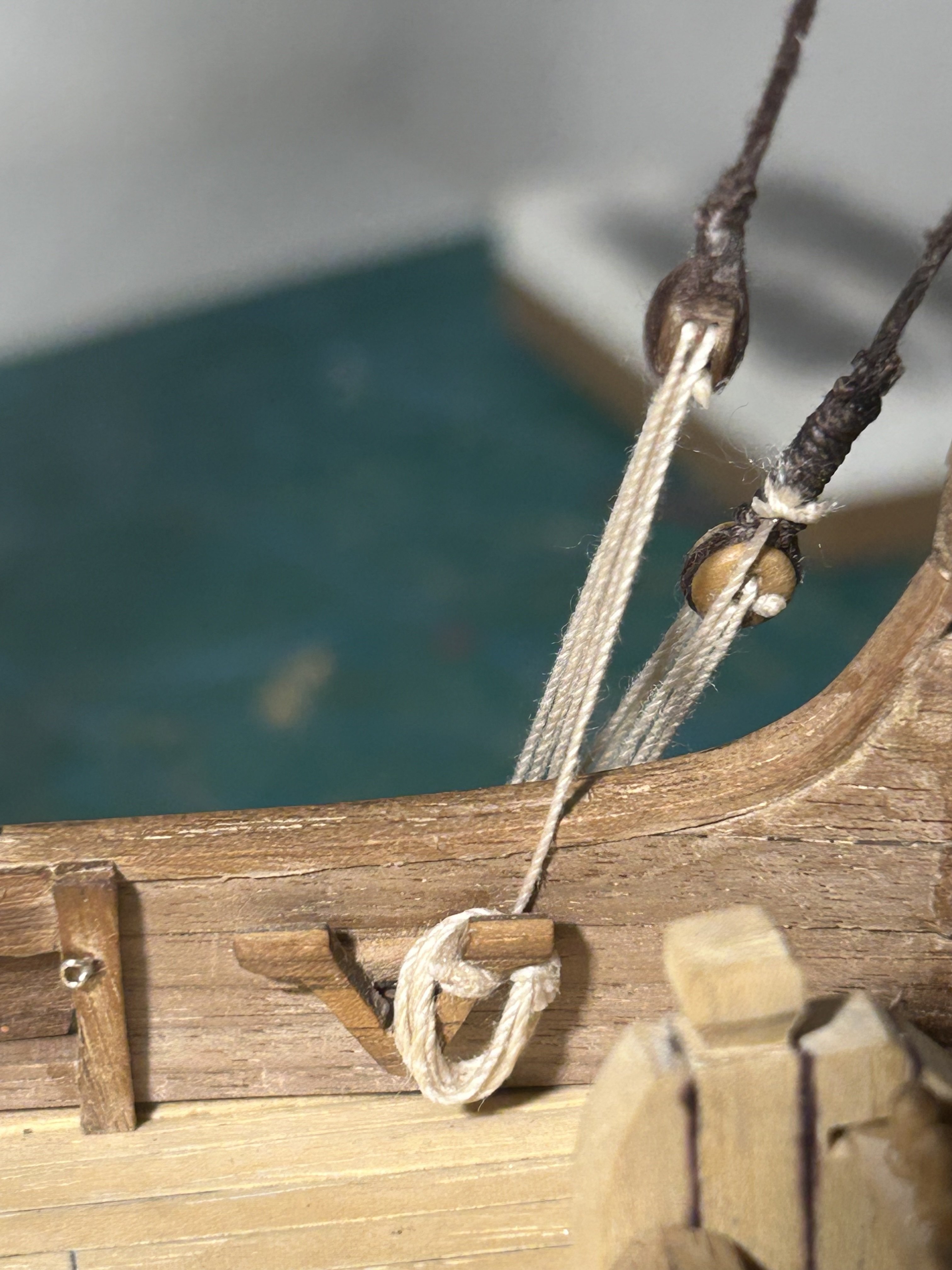

I think your blocks are positioned wrong.
Rotate 180°.
Otherwise, nice work.
Good
Edited by Baker

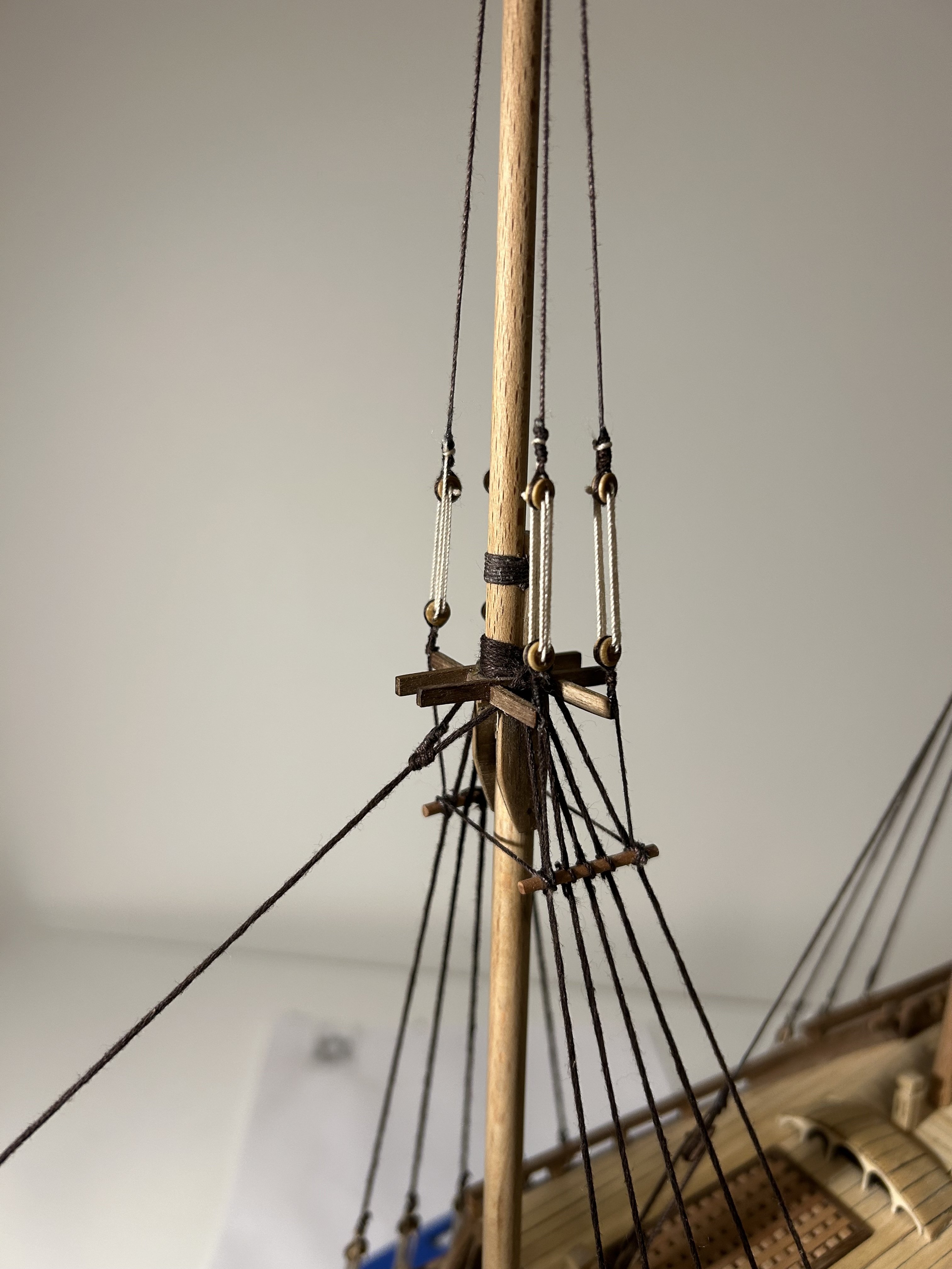

Thanks, Ronald! Yeah, I tried, stopped, tried again, looked in different directions — and decided to continue with these strips. It looks funny, almost transparent. I hope it will benefit this ship. There’s so much rigging on it that making it thinner and more airy might actually be a good idea. Let’s see. :)
Yeah too bulky looks also not good, so I understand your reasoning 👍

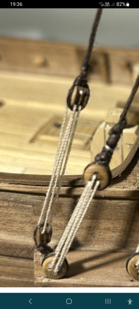

There are regulations for the thickness of ropes on Dutch ships from this period. But I haven't found any records of these ropes. I was in Amsterdam last Saturday at the Maritime Museum and took this photo there. Too thin is better than too thick, I think.
Edited by Baker
Baker – thanks! Ehhhh… slightly, slightly, slightly thicker, but still noticeable. Okay, I’ll keep it in mind for the next incarnation of Duyfken  - if Hans ever provides a full-frame version of it… :)
Edited by Olli Sukunimisson
In his 17th century book Aloude en hedendaagsche scheepsbouw en bestier (ancient and current ship-building and
sailing) , Nicolaes Witsen gives an overview of the thickness of various ropes and rigging for ships. These
thicknesses are related to mast diameters or circumferences. An indication of the thickness of the ratlines
that can be obtained from his tables gives a value of about 1/4 to 1/3 of the thickness of the shrouds. So,
with a shroud thickness of 0.8 mm for this model, a ratline of about 0.2 to 0.27 mm thickness can be used.
And yes - this is quite thin 🙂
Hans
Owner of Kolderstok Models - 17th century Dutch ships.
Please visit www.kolderstok.com for an overview of the model kits available
Thanks, Hans! Yeah… you’re breaking my heart :) It’s marked as 0.2, but seems slightly thinner. Thanks again, I’ll try to listen to my feelings — if I want her to be correct or lighter and brighter than her sister ships :)
The easiest way to messure the thickness of a thread is by winding it 10 or 20 times around a dowel, windings close to each other, and then measure the total width. Divide it through the number of windings - et voila!
Edited by *Hans*
