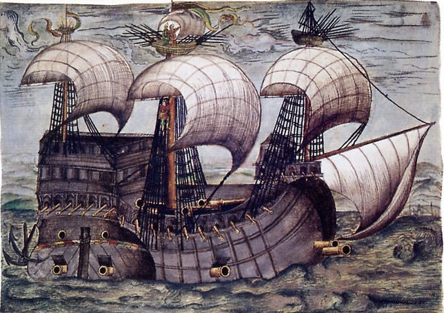

But more seriously, in addition to dozens, perhaps hundreds, of different plans from the period, quite clear (written) indications on this matter can be found, for example, in the shipbuilding manuscript from around 1610 by Lavanha or the so-called Newton manuscript from the first or second quarter of the 17th century. But perhaps this is most spectacularly and instructively demonstrated by Robert Dudley in his work (manuscript) from around 1636. The descriptions of the individual levels in the diagrams below (transcribed in red) practically speak for themselves and probably don't even need any further commentary. Perhaps except that this specific material has almost certainly never been used or maybe even noticed by anyone before.
