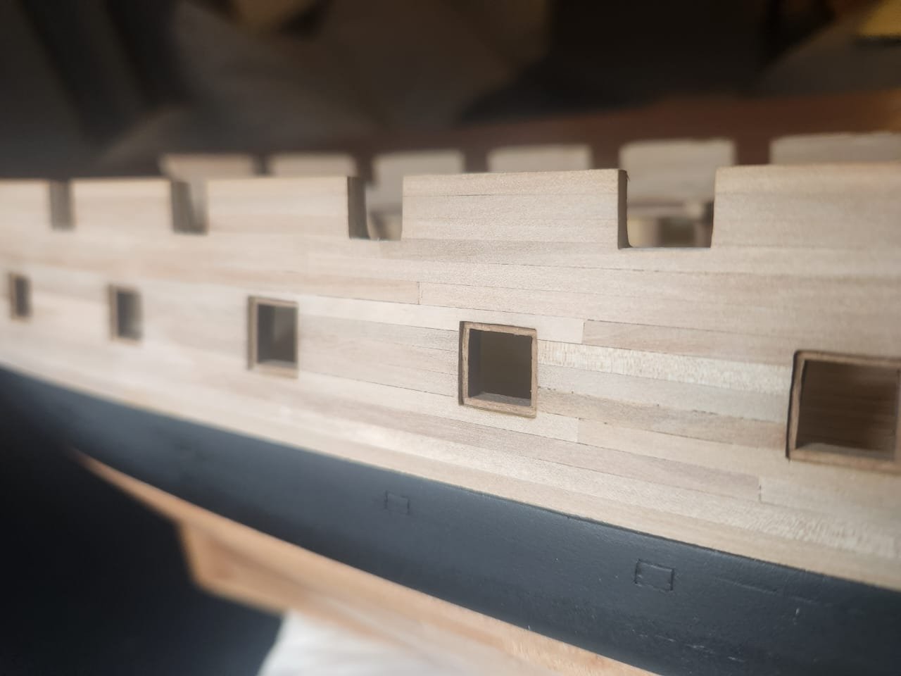

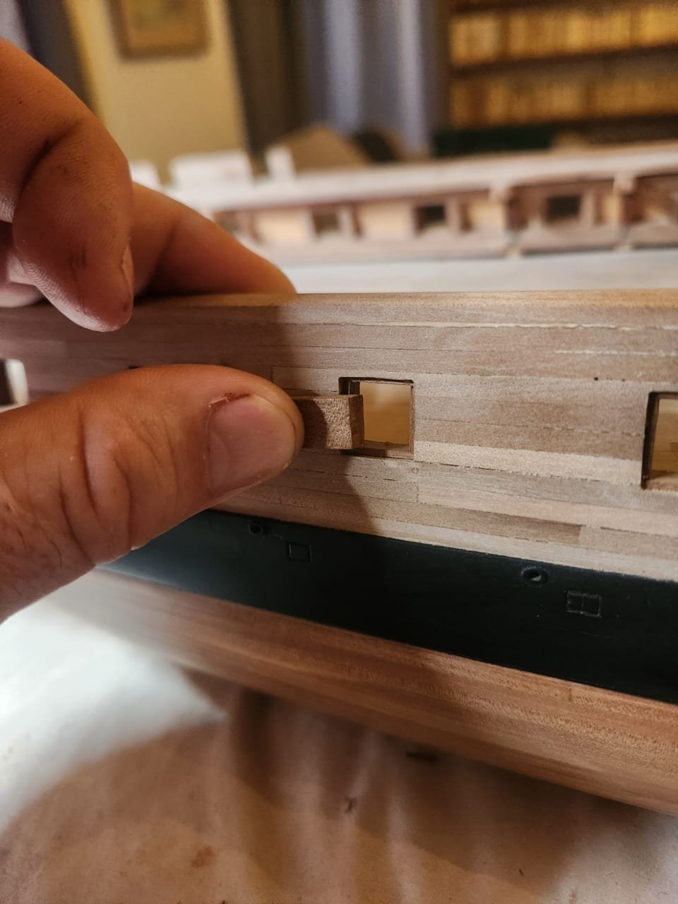

Gun Port Linings

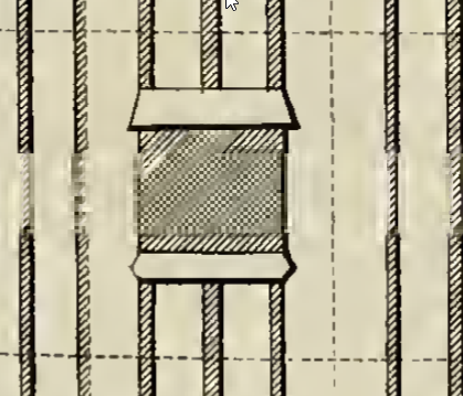

Gun port linings next, It would appear that the constitution didn not have fixed(Hinged) gun port lids at the time of launch but rather removable split lids. There is no indication of port lids at this point on any of the paintings or drawings of her or her sister ships in the early years of their existence. There may well have been port lids on the forward most ports and possibly coverings on the aft most ports but I will get into that detail at a later stage. For now our only concern is gun port linings.
The only place where we can see these linings to any real degree is from the 1812 Isaac Hull model and Perhaps the Corne 1803 painting. In these two sources the ratio of lining to openings seems fairly consistent. If we assume an outer port opening of 3ft 3 inches as indicated in the 1794 body plan by Joshua Humphreys then we can deduct that the inner lining of the port is 4inches wide(1.3mm at scale).
image.png.b2c563bd6d1580103ea87195138a019c.pngThe only other piece of Evidence that was vaguely relevant is the orientation of the joints. This detail is purely academic as the ports will be painted but it is worth mentioning that David Steel shows the port linings to be the exposed frame section with 2 horizontal upper and lower sills mortoised into them. This means what would be visible to the viewer is 2 horizontal joints at the upper edge of the gun port and 2 miter joints at the lower edge of the gun port once planking has been installed.

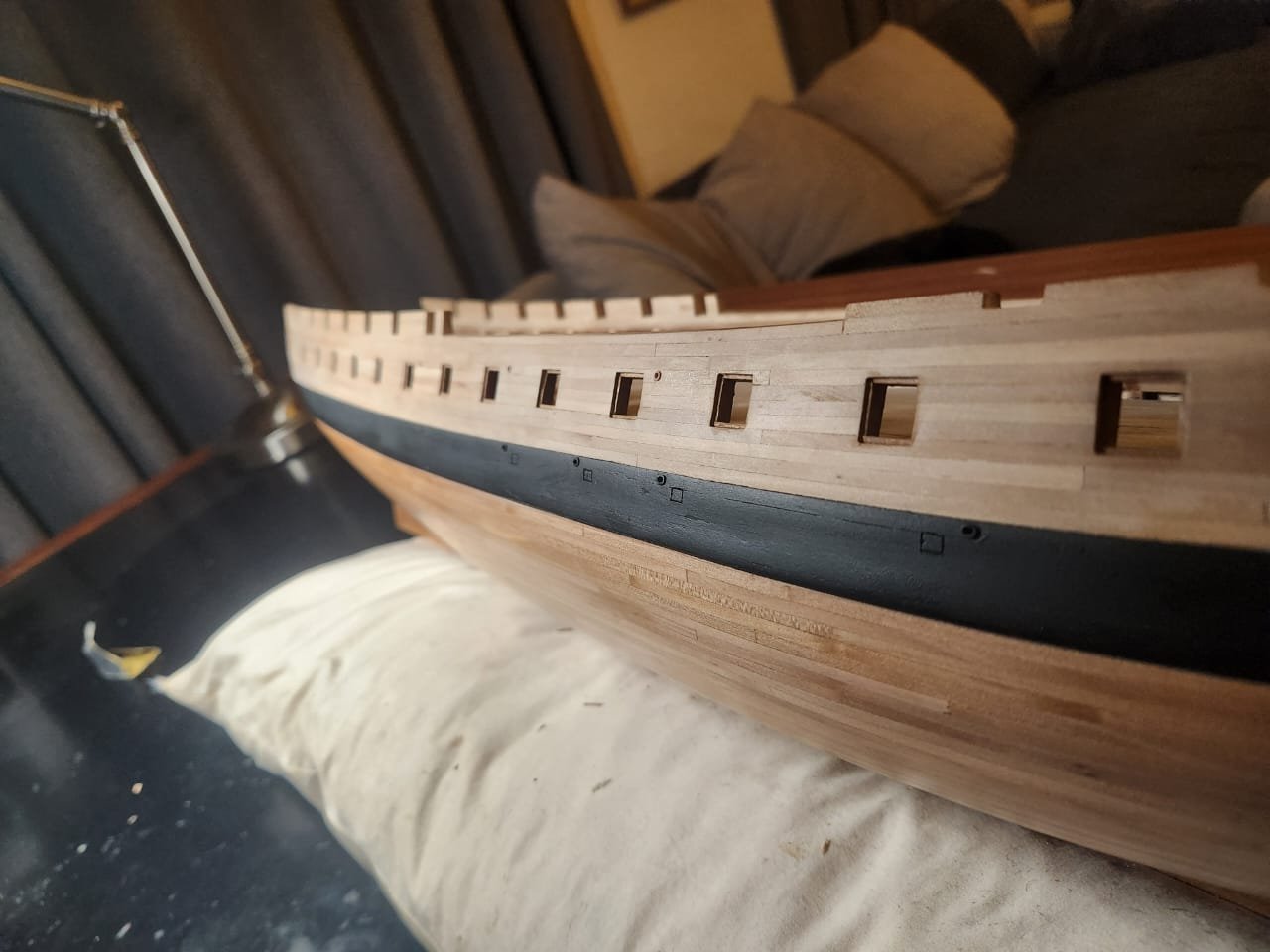

I bulk cut the 120 side to just slightly longer than their correct length, then bulk squared off one side of each plank and marked their correct length with pencil. I first installed the upper and lower sills and then squeezed the side sills in to seat them more tightly. I made sure that the edges were slightly too close to the outer planking and then tapped them to the correct depth using this little jig.
Once all the sills were in i gave them a good buff with some steel wool and dragged a sausage of steel wool through each port to clean up the edges. I then made up a mix of wood glue and wood filler to make a gooey filler and used this to tidy up any little gaps between the outer and inner framing. This was applied with a small silicon sculpting tool.
This is the almost final result, These ports will be painted in red ochre but that is a task for another day.

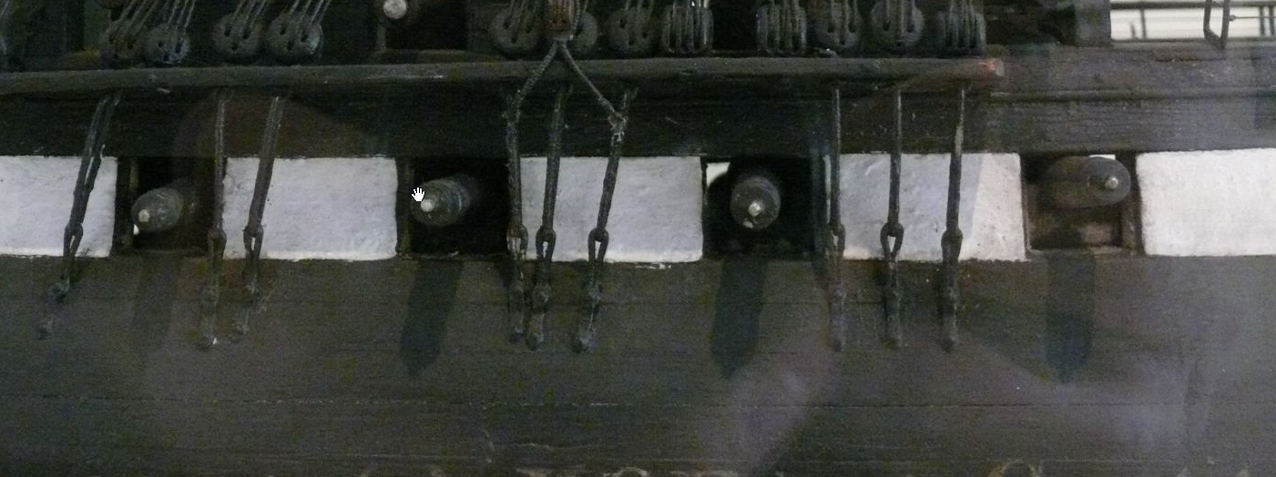

Very interesting @Marcus.K., I appreciate the amount of work you are putting into this research. As @The Bitter End said I also find the research process to uncover obscure details as much fund as building models themselves.
One thing that stands out to me with the vents is how many of them there are. I have found air vents on plans for HMS Camilla of 1776 (https://www.rmg.co.uk/collections/objects/rmgc-object-83800) and also Daphne 1776 (https://www.rmg.co.uk/collections/objects/rmgc-object-83787), but there are only 6 of them on each side. One for each cabin and then one near the bow. They are drawn in black pencil at about the line of the deck.
Edited by Thukydides
Thanks for your kind comment, Thukydides. Are you sure we see air vents here? They seem to be higher than the deck? Is it possible that these are ports for oars? The ships seem to be smaller and may have been moved by the help of oars? For them these positions would fit - except: why not having more then ...

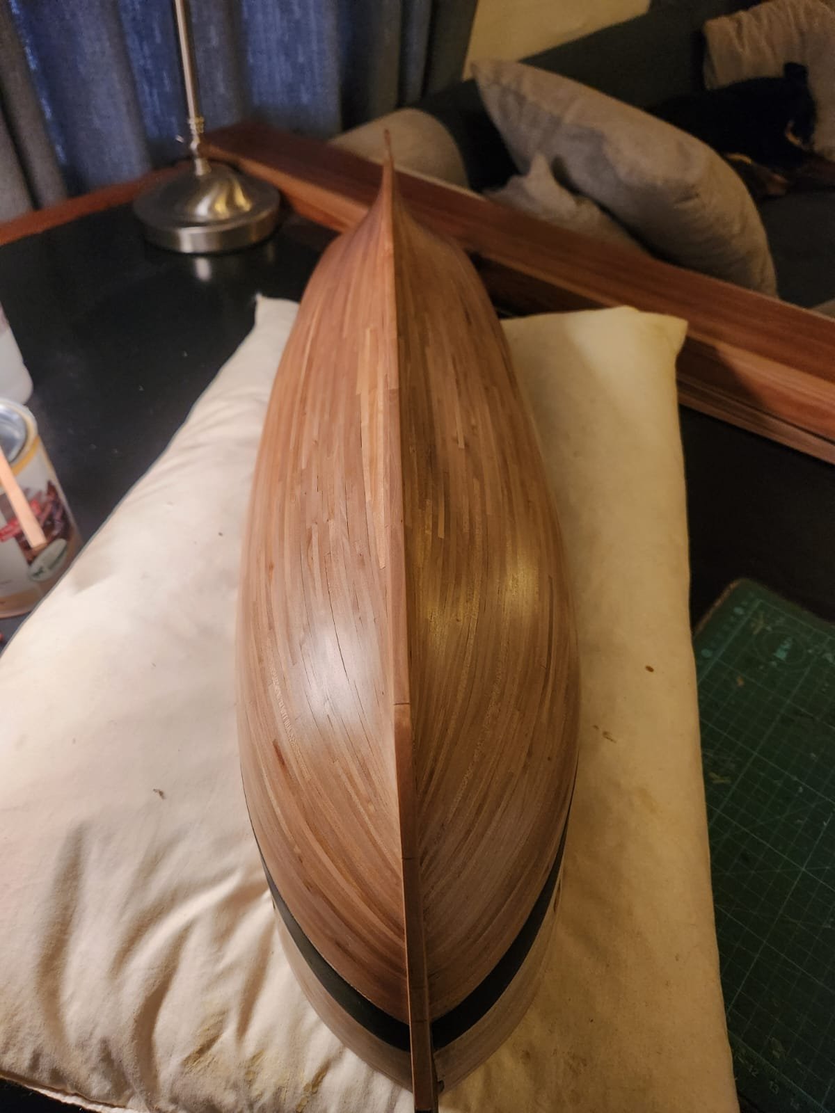

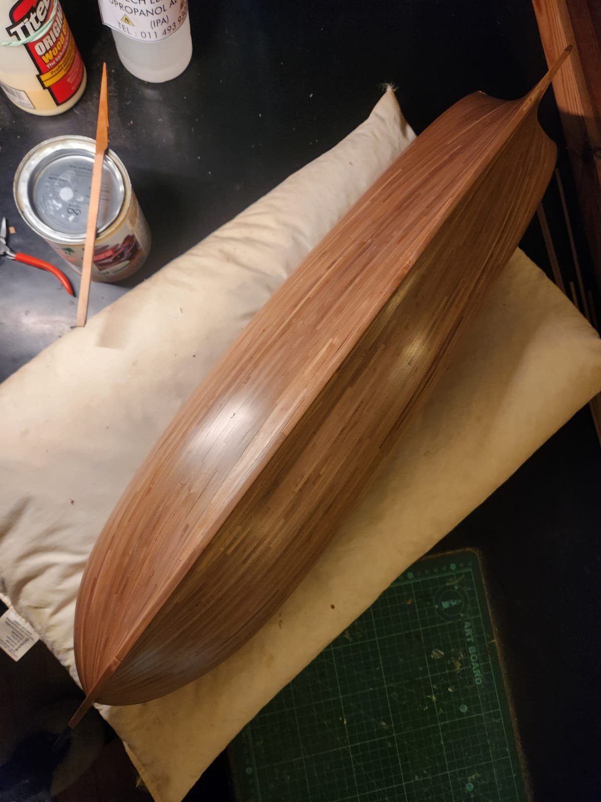

Oiling The hull - I realised that I failed to mention a pretty significant mistake from my initial application of Osmo Poly X and I felt that this warranted a repost incase someone made the same mistake as me.
When they say mix the the product prior to application, what they mean is MIX THE PRODUCT PRIOR TO APPLICATION!
I failed to do this with my first coat and the product came from a tin which had been standing in my workshop for some months. This resulted in a very unsatisfactory finish which i had to try to remove with Mineral spirits, I think I got most of it taken off and the final result was still ok but the mess to get this resolved was less than ideal.
all that being said ..... back to the original post

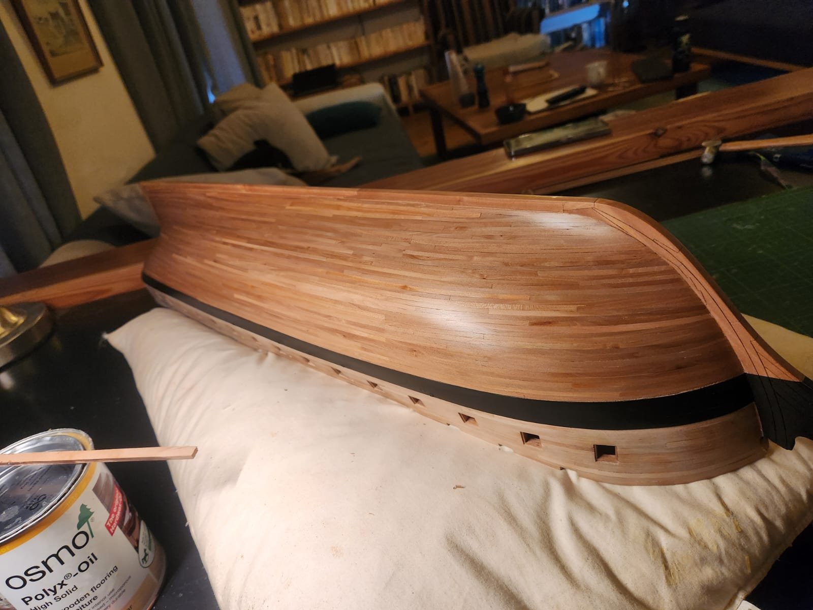

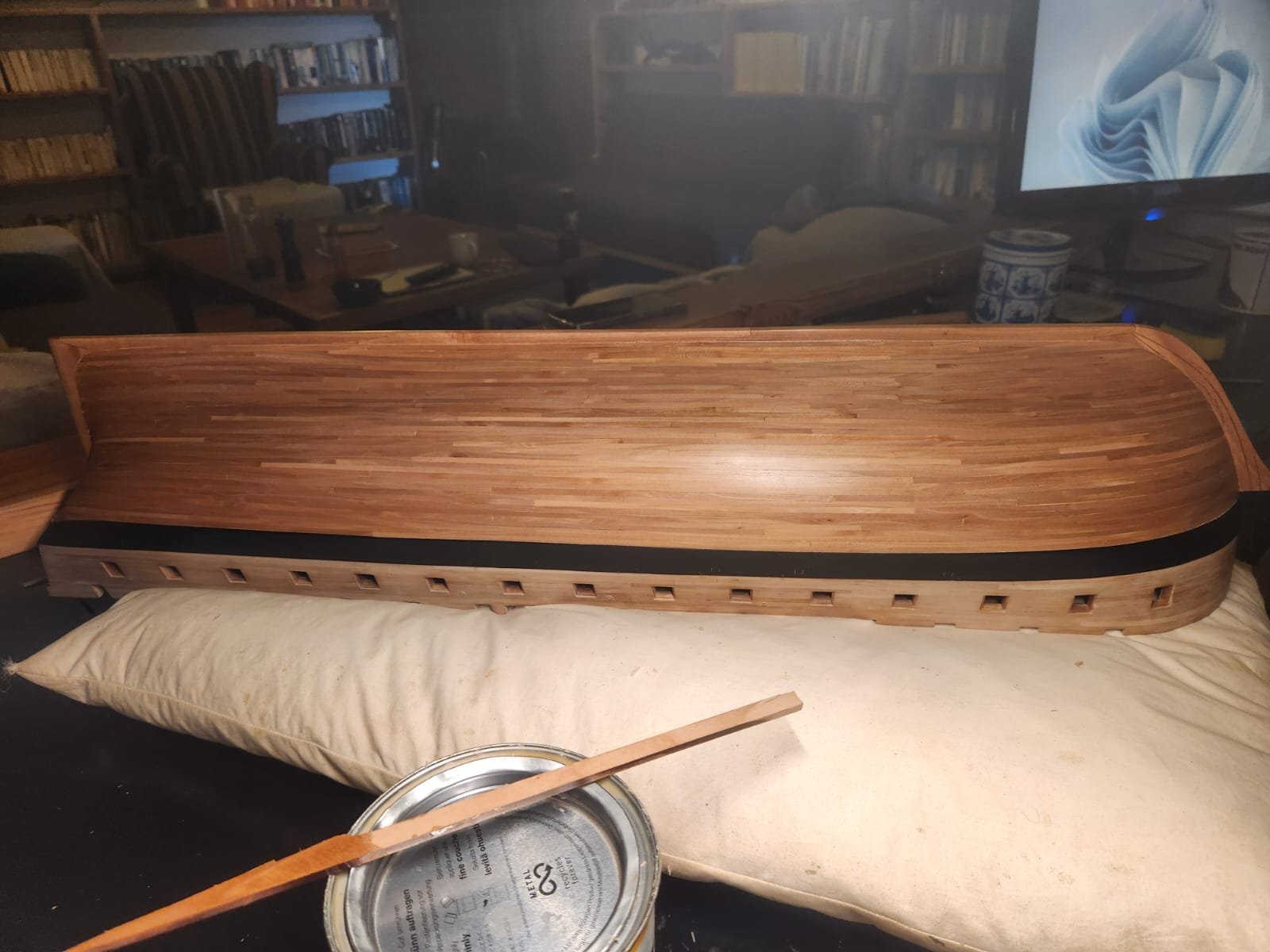

One of the best parts of the build. Oiling the hull.
The hull was sanded back to 400 grit until all scratches were removed(kind of) and then given 2 very thin coats of Osmo Polyx Oil 3062 Clear Matt , this is a beautiful product. My only tips are to apply it with a soft scouring pad, to work in circular motions and to be very conservative with quantity.
I also applied this over the paint which dried well and gave a lovely satin finish.
I know I should really copper or paint this hull but the wood is special to me and I quite like this very unique effect, I hope you all do too and your feedback in welcomed.

Yes this is the challenge of this, lots of confusing and sometimes contradictory views. If they are vents I suspect they must angle down (similar to the the example you showed), but they appear to largely be around the beams, just below the deck planking. One thought I had was maybe they run through the room and space between the frames.
The second example is from 1727 so I suspect given the number (and regular spacing) of them that those are meant to be sweeps. Many of the earlier smaller vessels had them.

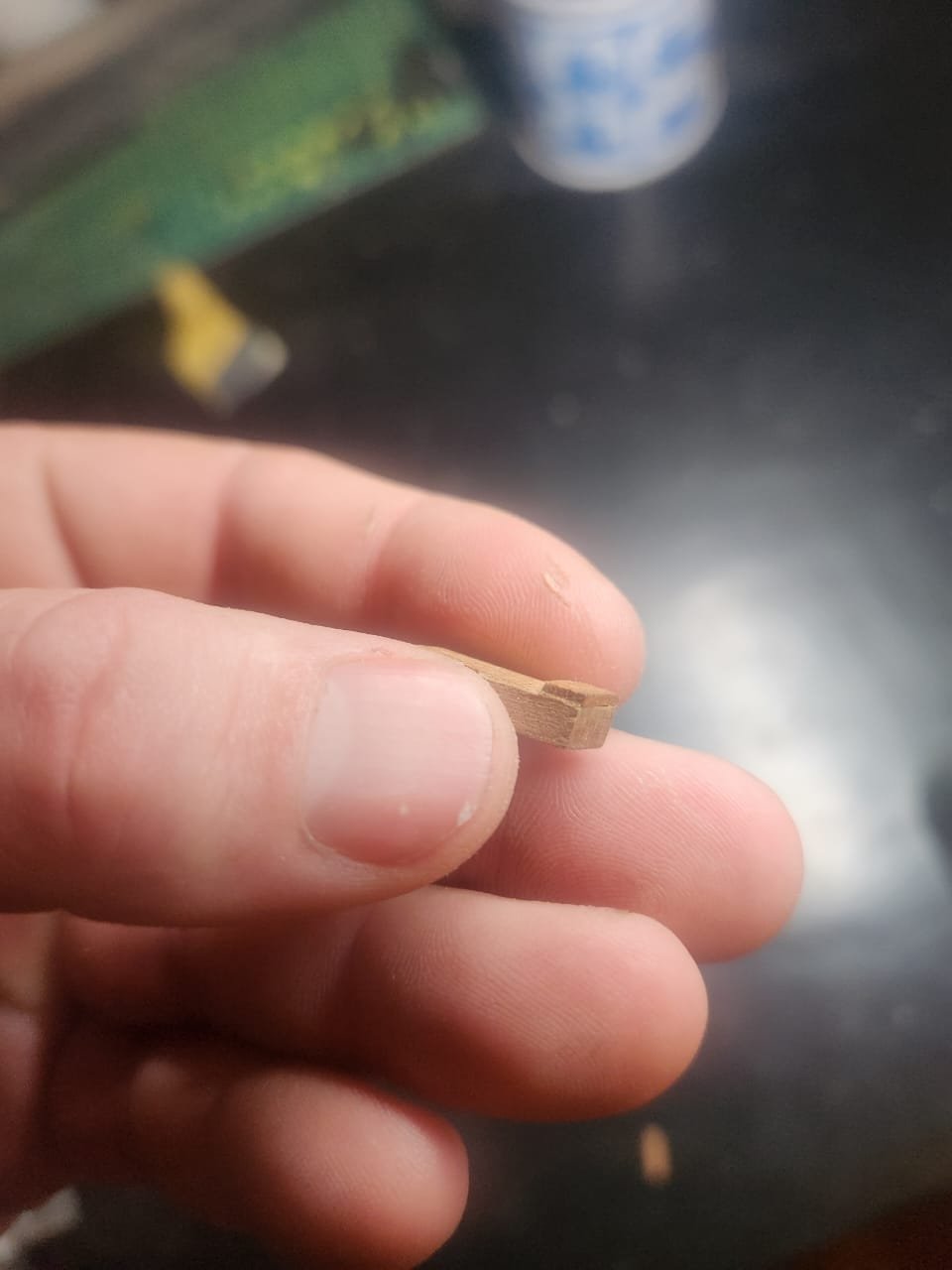

To get this result I filed a profile into a sacrificial box cutter blade:
After a trial or two to determine a suitable profile I cut this into the transom and went over it with some steel wool to smooth things out
And painted it black as well as touching up the ochre.(The notches are to allow a tight fit under the bulkheads when pressed into place)

Roux-President1.png.1b512f90c49102a3e91ea55ce66ca41b.pngRoux-President2.png.15be5636de027d5faa2f31434442c281.pngCorne-1803.png.ab7ca2290016e51150352dd3a4aa207d.pngCorne-Tripoli.png.71b4f83bca6070582e45b01e9584ccd2.png
After some discussion with good old Marcus we agreed that the colour shown on the painting may be wrong for 2 reasons. Firstly, the artist wished for the viewer to experience a certain colour, depending on lighting etc that may require use of a brown to show a reddish colour. In addition and arguably more importantly we don't know how paint colours deteriorated over the 200 odd years since these were painted. That then led me to the next step of the investigation: to pull the colour from the American flags which would all have been a fairly standardised bright red colour as can be seen in this example which flew on the Constitution around 1816
This resulted in surprisingly brown colour samples for something which is known to be red:
Roux-President0Flag.png.c5d31da7ef66b7327df8eed8bf1a25a2.pngCorne-1803Flag.png.fa7dc54da2be7510f31b10d9feebec3b.pngCorne-TripoliFlag.png.997bfd128ba8e16ddf6b596e8dae50f6.png
This colour deterioration clearly showed that the colour of the gun port lining was meant to be closer to red than brown. The next logical step was to feed AI all the data I had from all the paintings and tell ChatGPT to do a colour correction for the gun ports based on the known colour deterioration of the flag. The result was surprisingly pleasing. Without any other prompting it gave me one value, HEX #A3050F:
This seemed like the perfect balance between a modern and historical red.
The application of this chosen colour was achieved as follows:
1. masked off the hull completely and applied a spray-painted layer of rustoleum matt black primer
2. Applied a thin coat of Vallejo "Red"(70.926) with a tiny tiny amount of Vallejo "Black"(70.950 and a drop of Vallejo "Cavalry brown"(70.982) with a single drop of paint retarder. Exact ratios are hard to describe but it's mostly red, a smidgen of black and a drop of brown)
3. I then applied another thin coat over this of "Red" with a small drop of Vallejo "Carmine Red"(70.908)
4. I finally finished this with a drybrushing of pure "carmine red to highlight the edges and to give the ports a bit more of a natural look.
This recipe is by no means perfect but it worked for me.
Now unless anyone has a warning of some sort for me I believe my next step is to begin the Quarter Galleries.
Have a great evening
Cheers
Haiko
