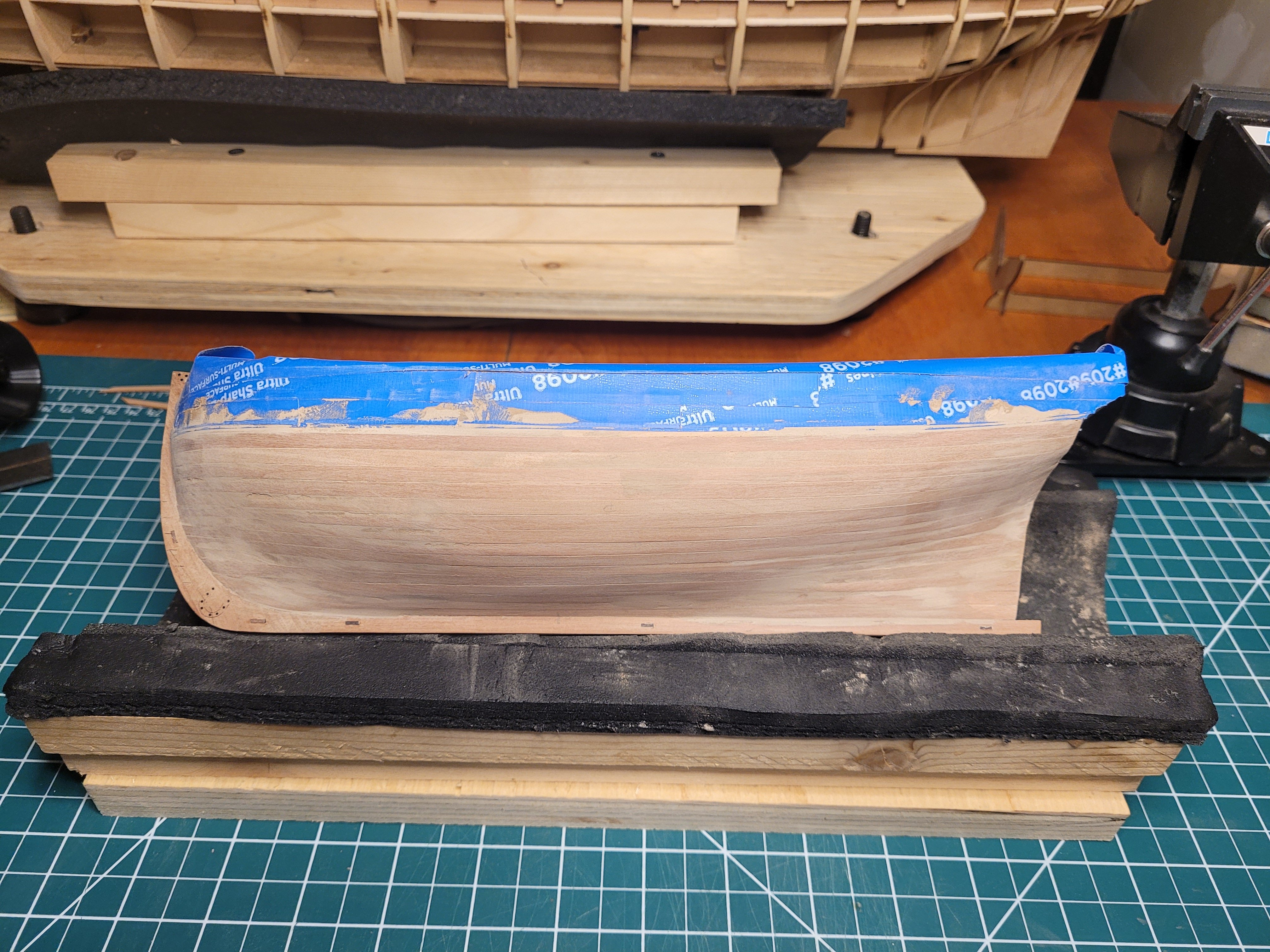

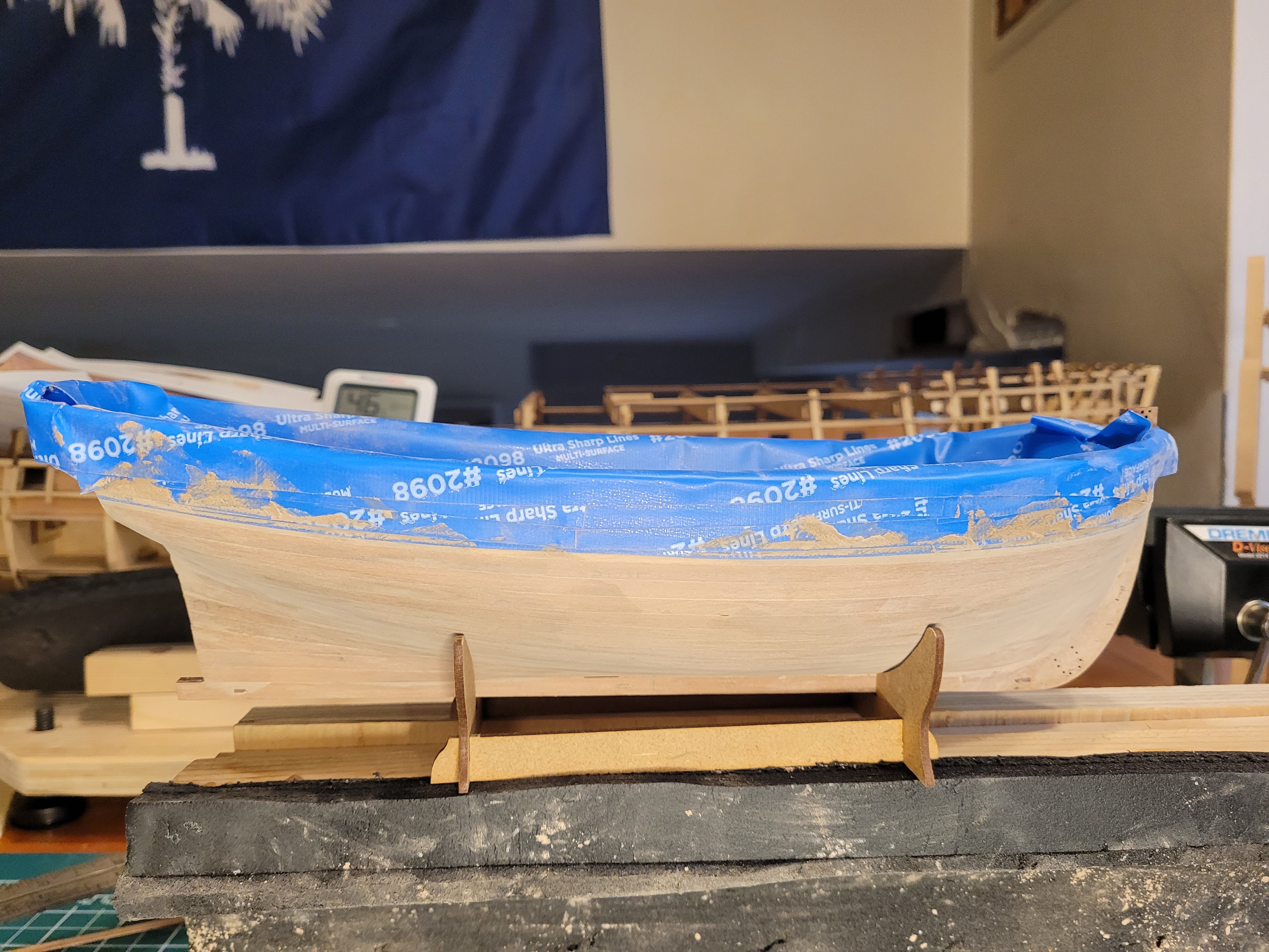

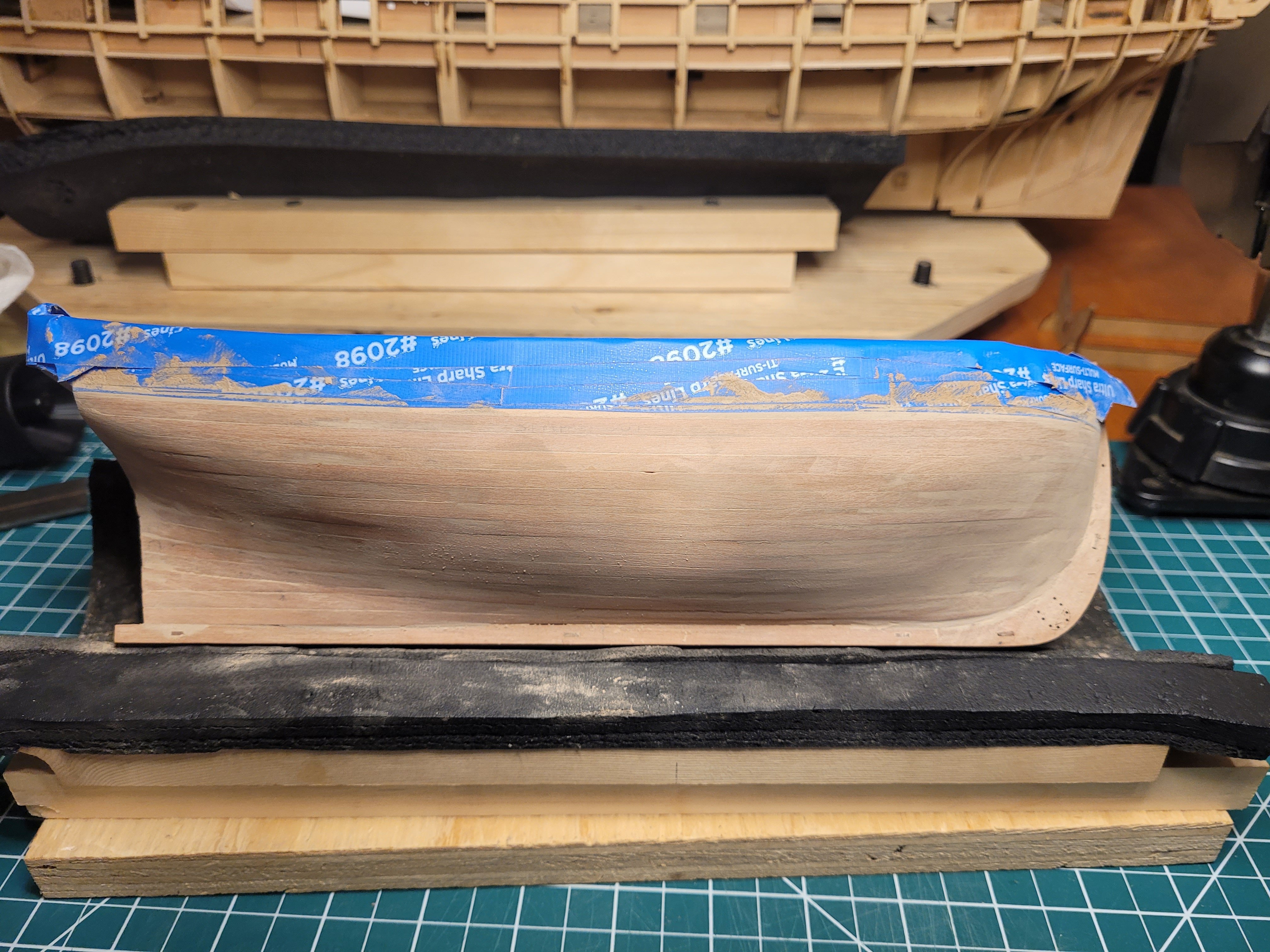

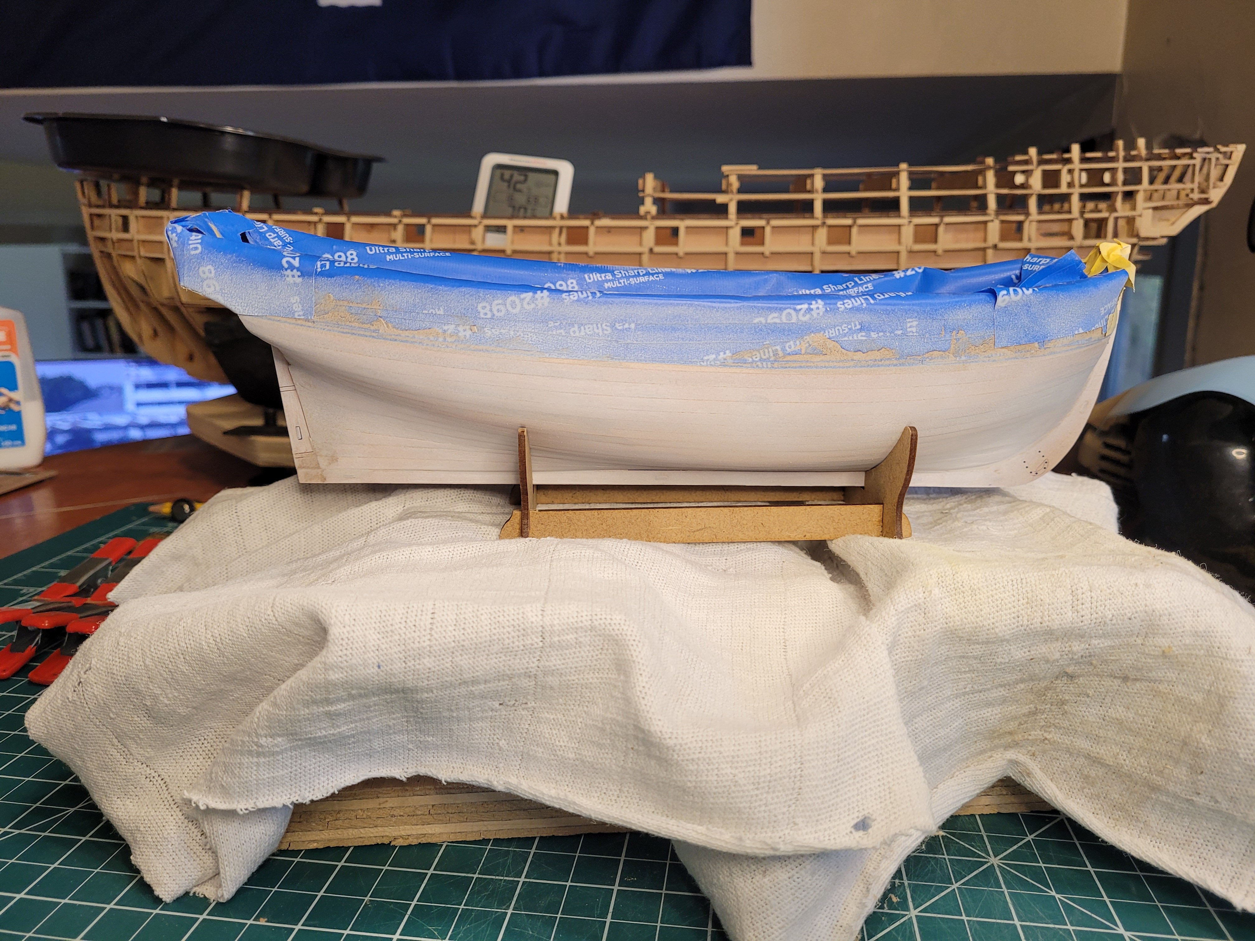

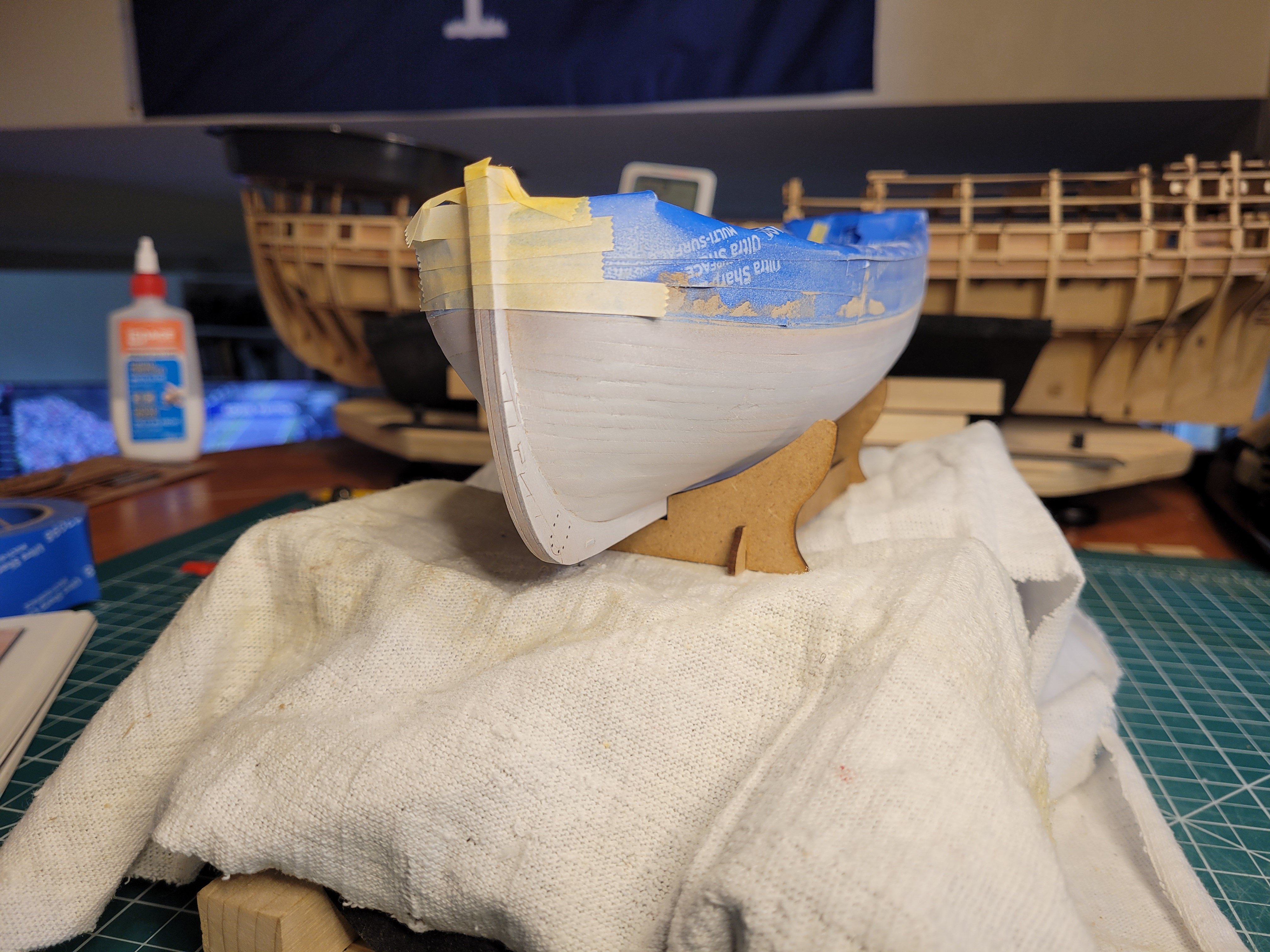

I opted for wood filler.  The sanding is easy, and it's no fuss if I fill a spot/area with too much filler.
This is after round 2;  I want to get it as smooth/finished as possible before I do the first primer coat.  Just about all of the gaps are now filled and there's more filler to come off what shows in the pics.  But there will be spots/areas that will pop as needing attention when I put the primer coat on.  I may get to a primer coat by tomorrow afternoon.  Looking forward to that.
I'm using gloves now.
BTW I'm toying with the idea of using stain instead of paint so that I get some show-through of planks.  I was thinking I might try an out-of-way test patch.  Is there any reason I shouldn't use stain?
Cheers/Nick
Edited by Nick 843
added text

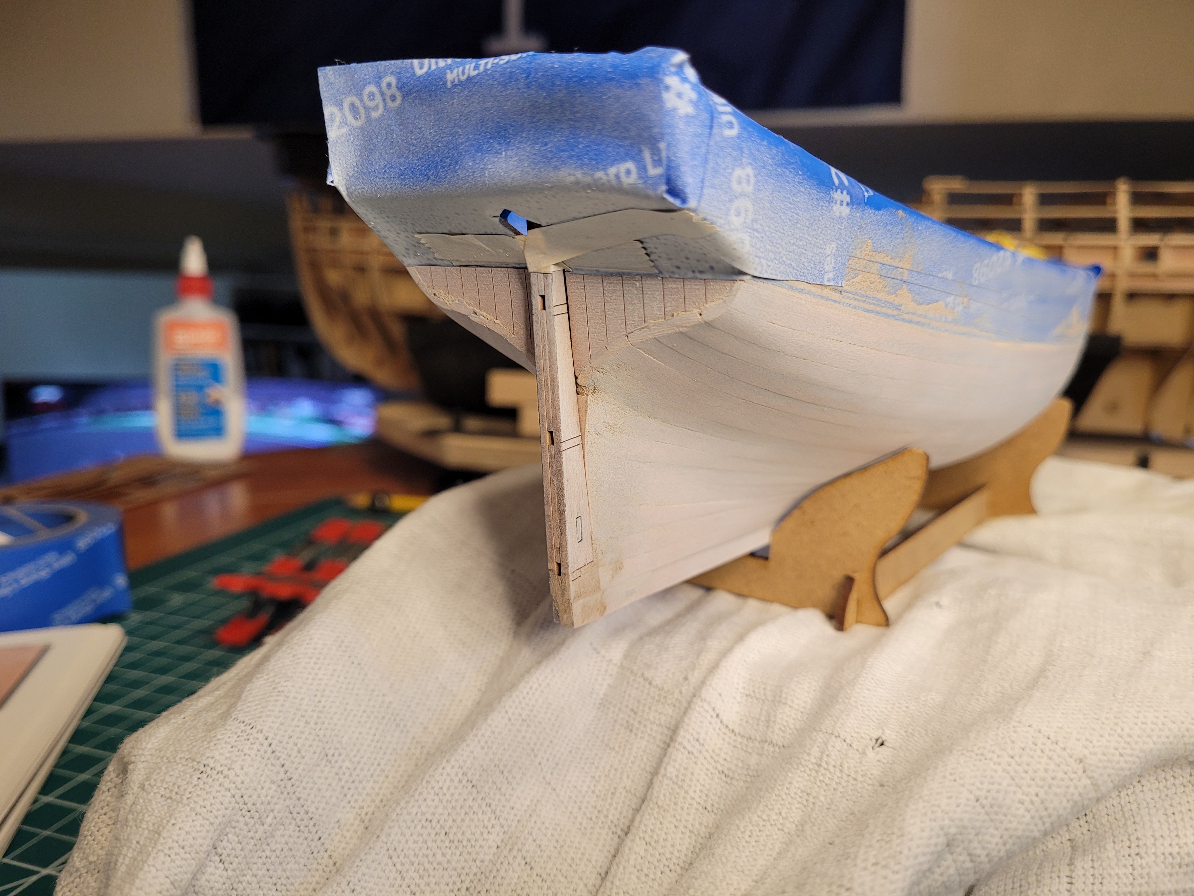

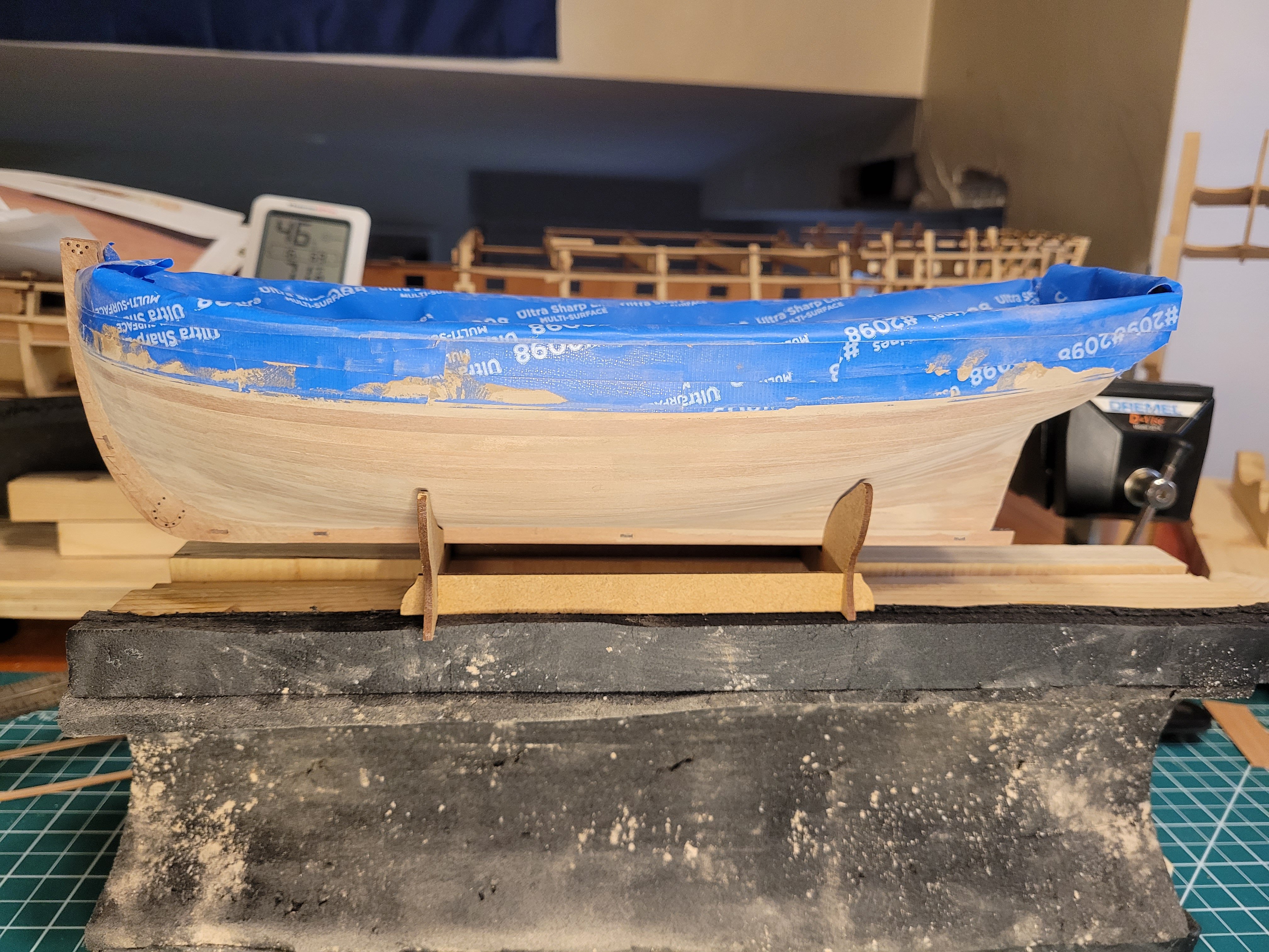

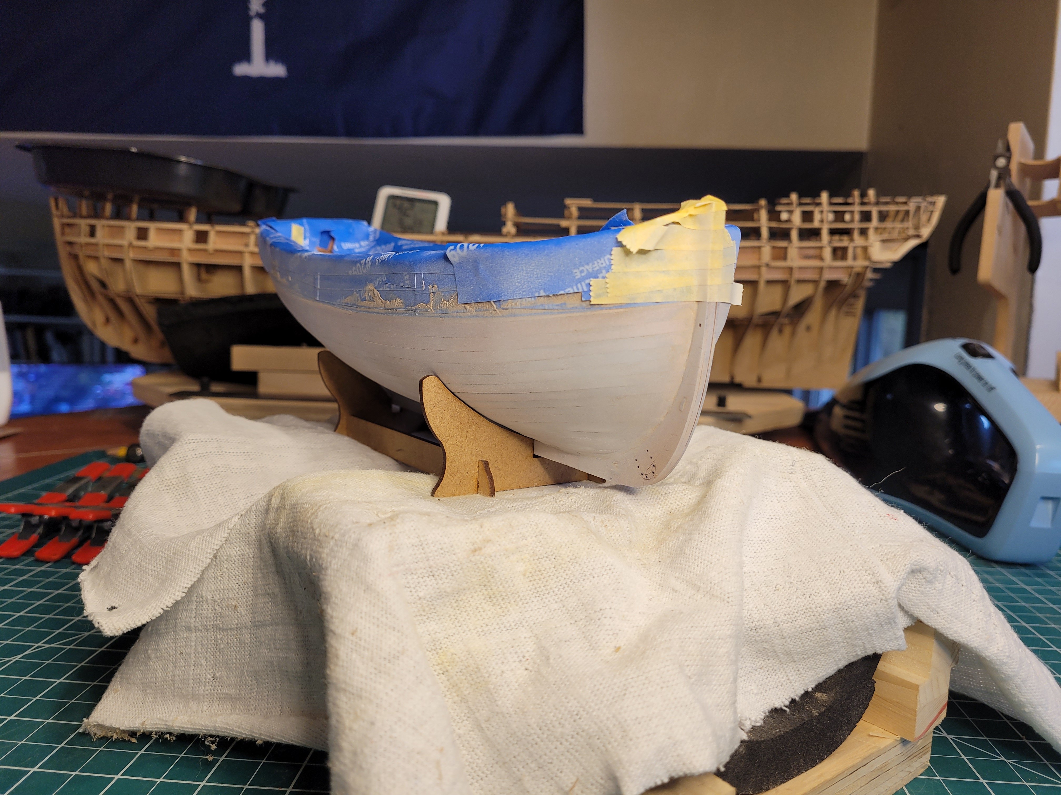

Thanks both.  But I've just realized that those pics show it way better than it is in reality because of the light I put on it.  I'd aimed a light directly at it from model-level; amazing what light will do; I think it's the first time I've paid attention to the quality of any photograph LOL.
I realized it this morning when I shifted the light to a different position and it shadowed some of the remaining gaps/unevenness etc.
These show it more accurately I think.
Nick
Thanks Chris.
I'm hoping I can lay down the paint thinly enough that at least some of that detail will show through.

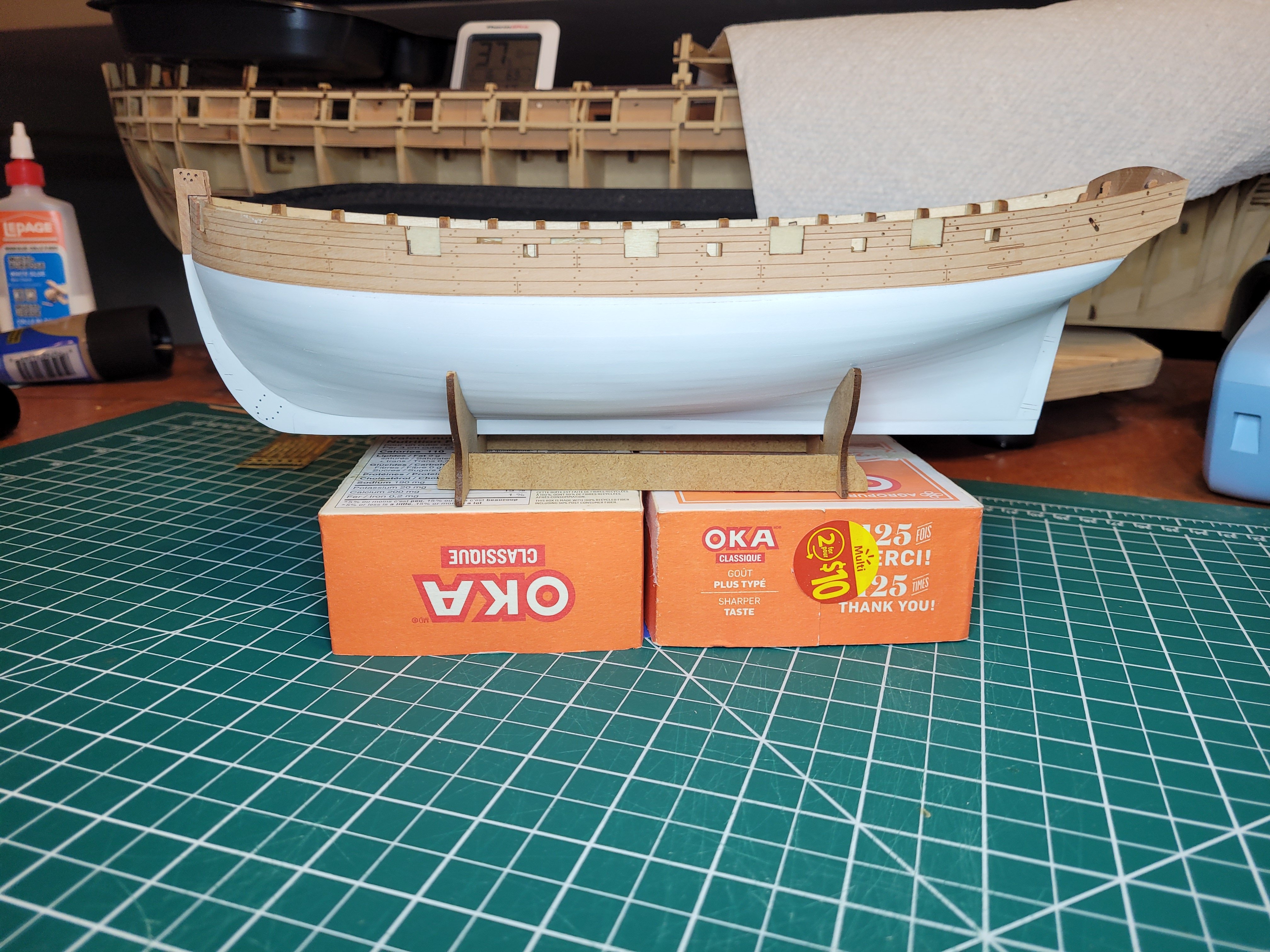

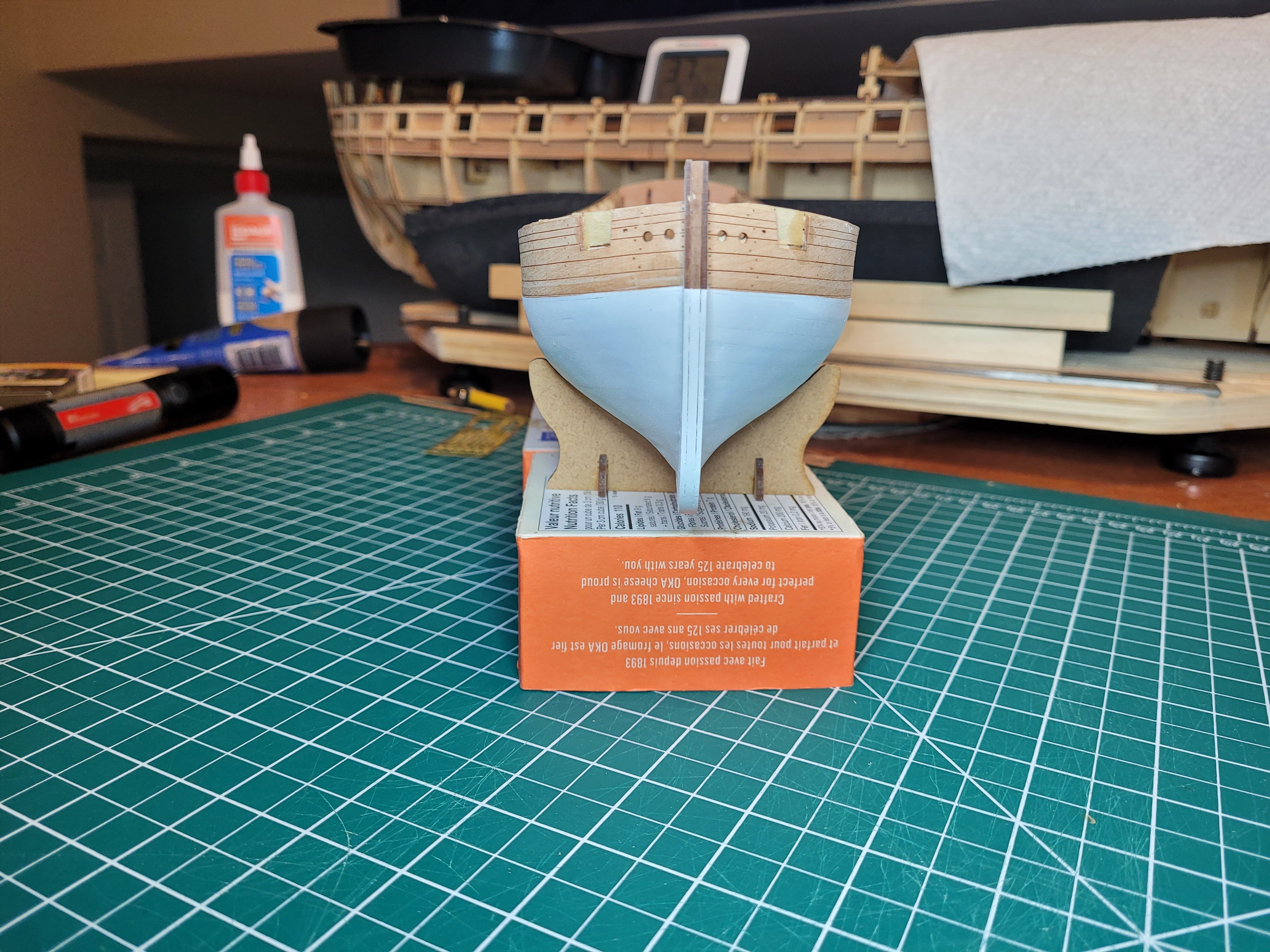

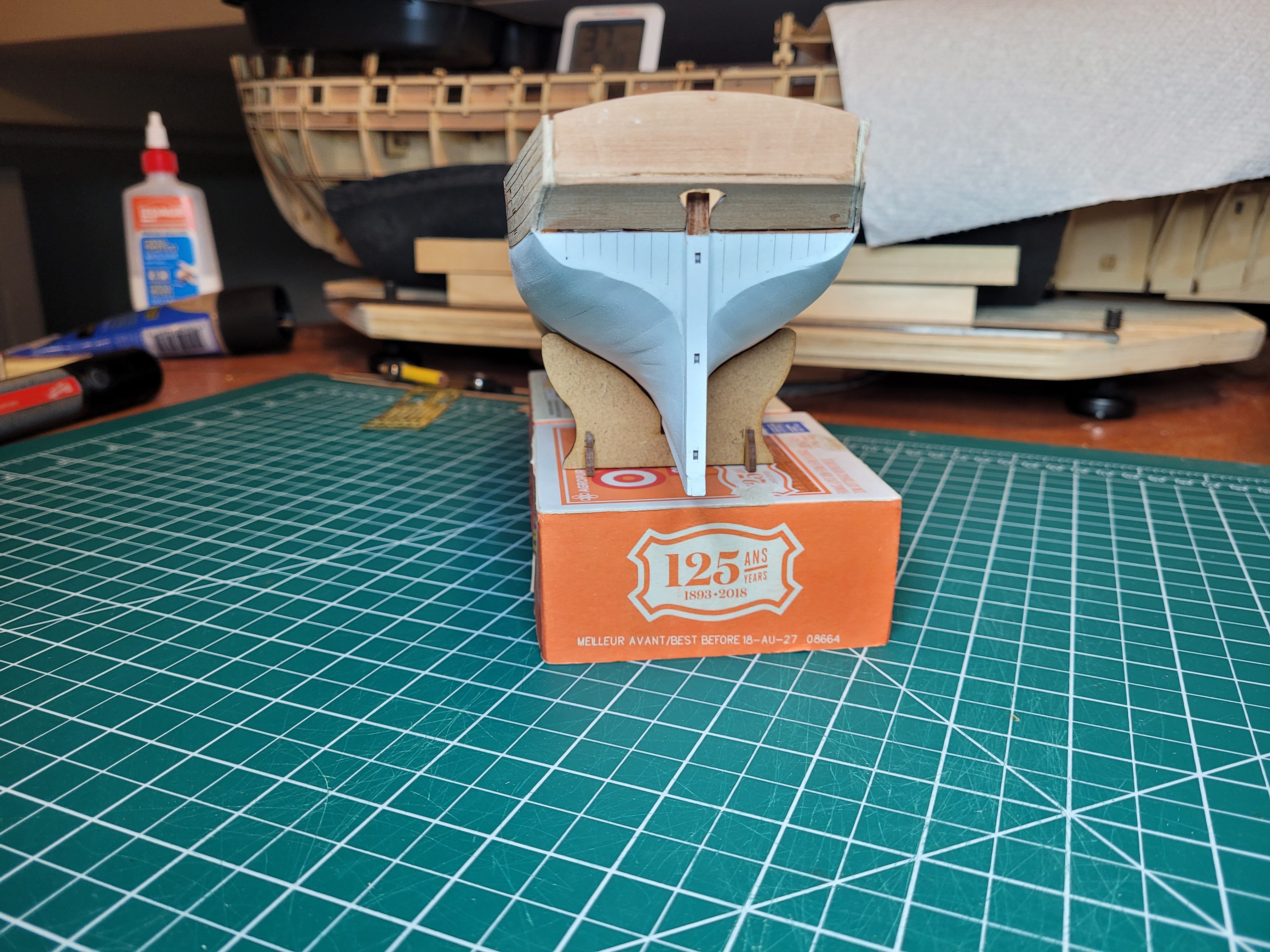

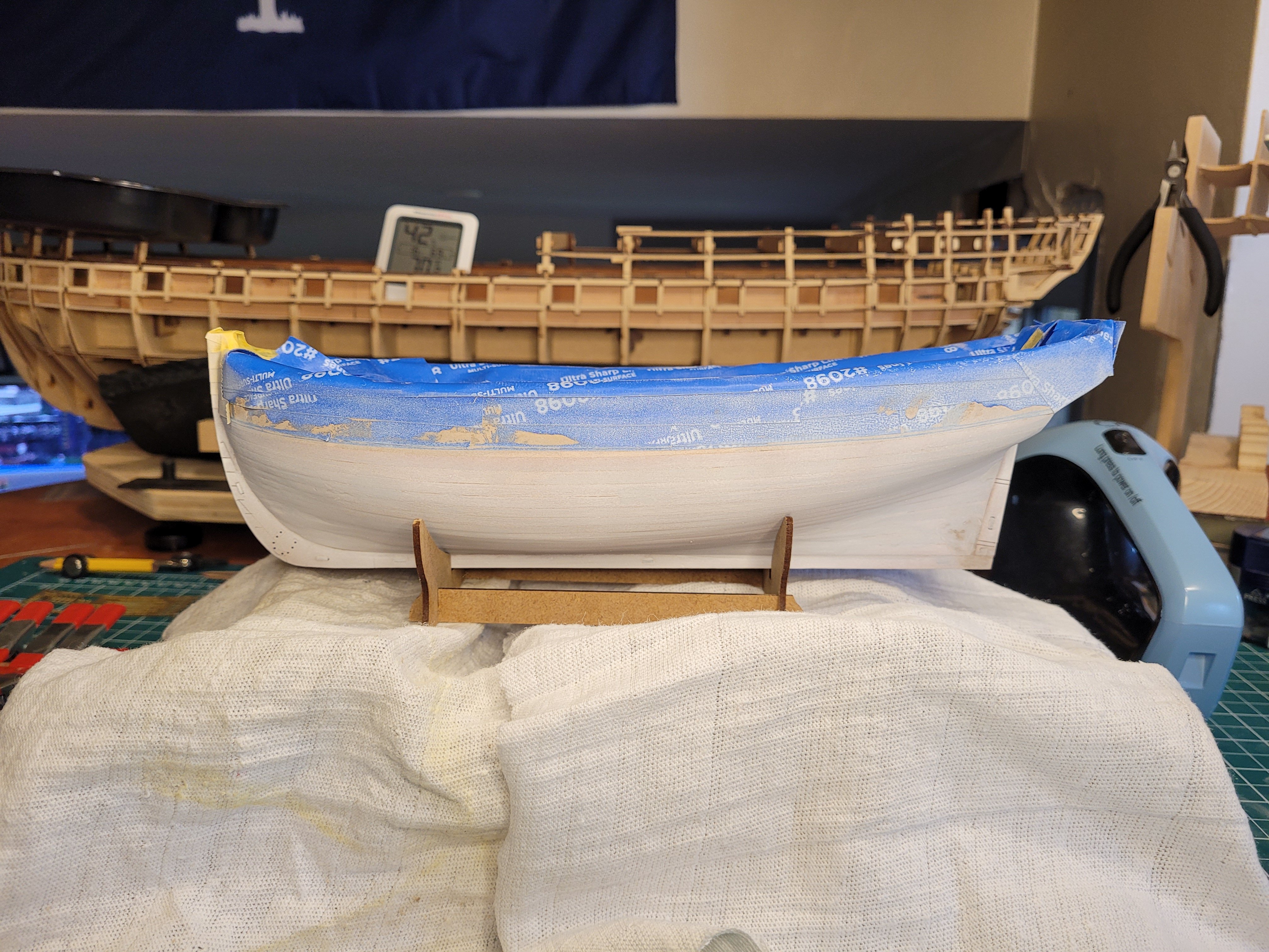

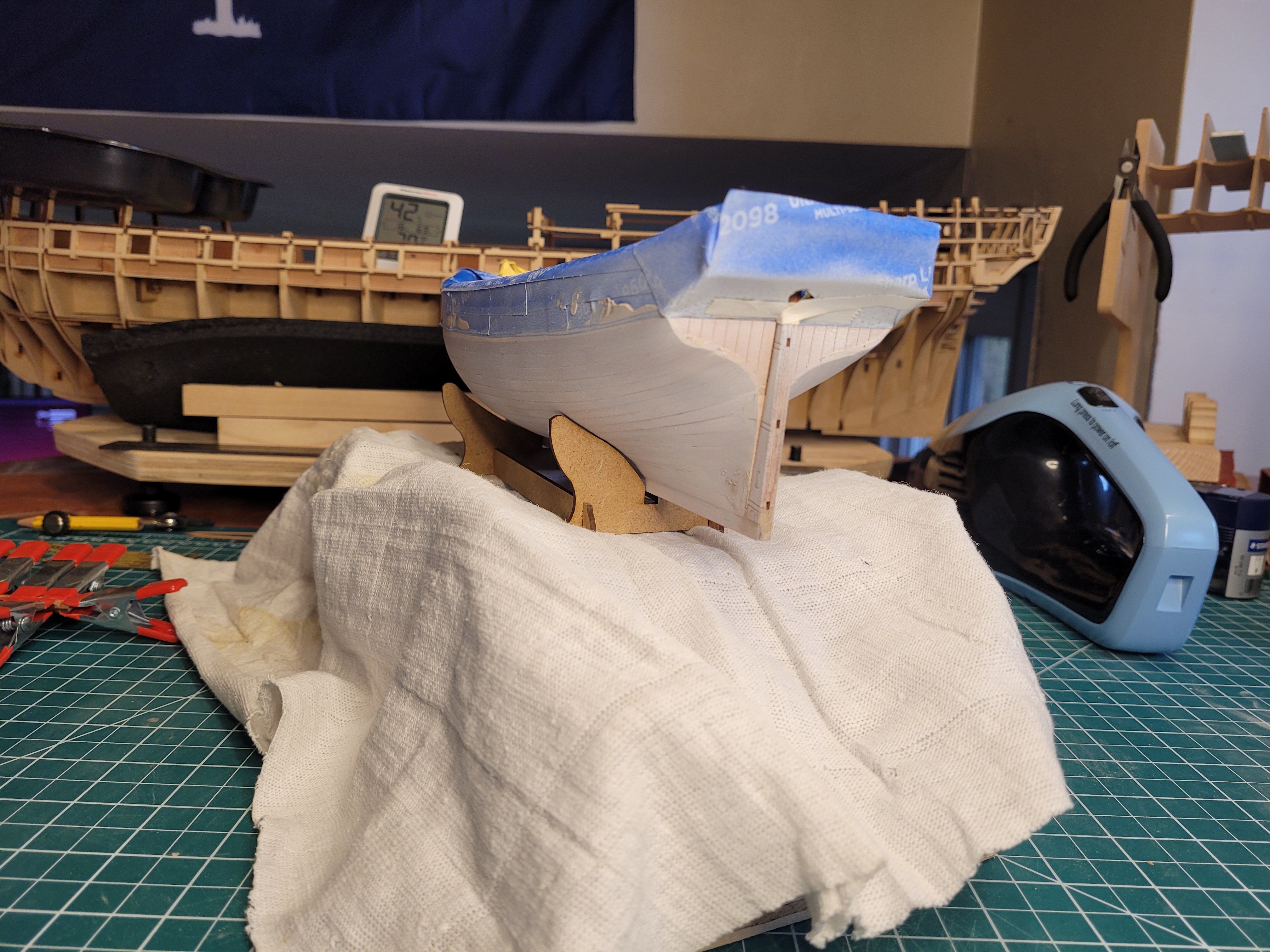

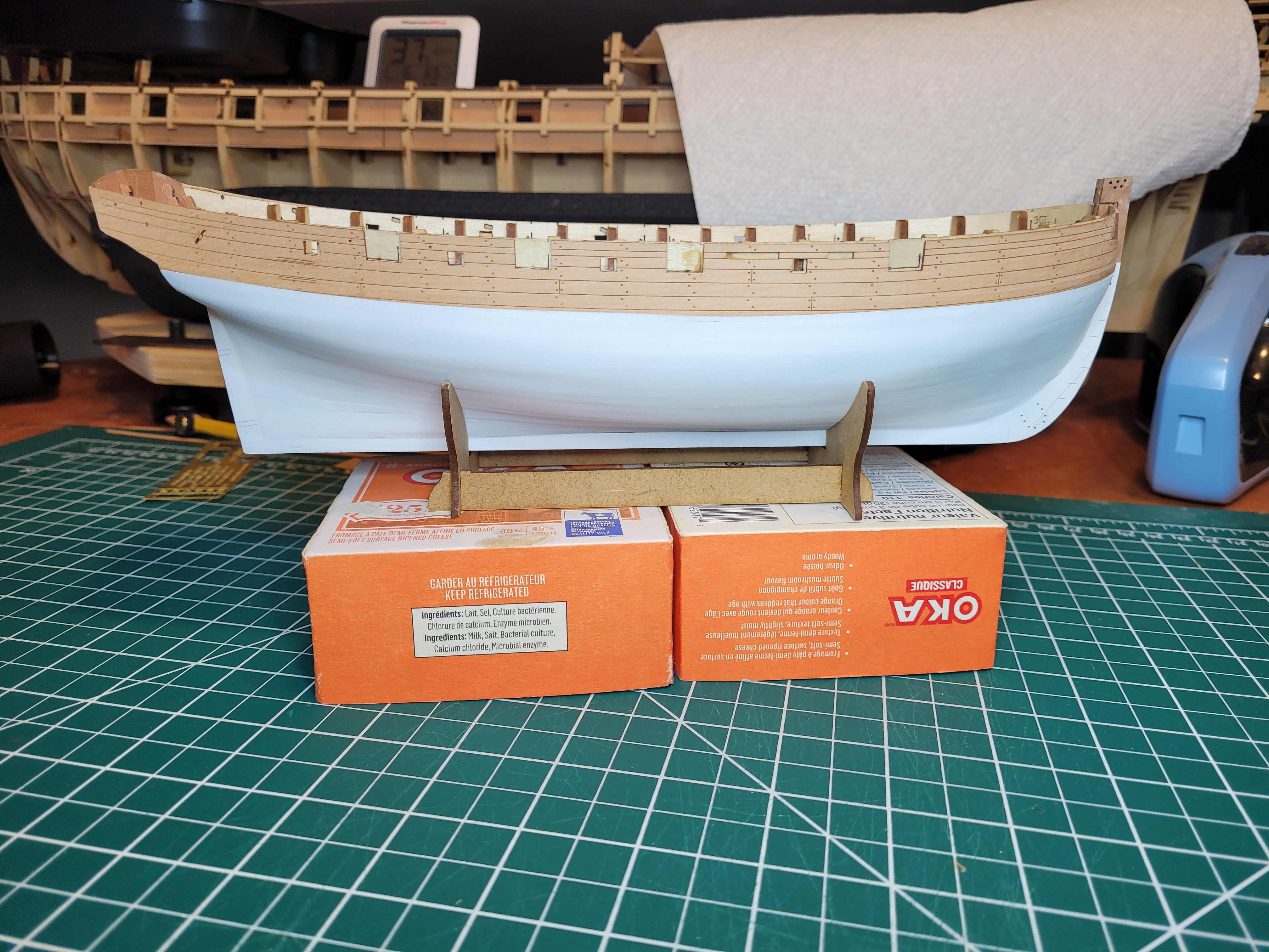

Painted.  Some own questioning going on as to whether or not I should rework any of it, but it's growing on me as probably done.
There's some variance in the coverage, and I'll appreciate any comments as I mull it over for the next day or so, but I'm tending to the idea that it's not worth remedial work.  And overall hafta say I like it.  One thing that worked out well was the masking which gave me a clean line.
I am going to re-do the stem; I guess I overlooked filling those gap lines.
Nick

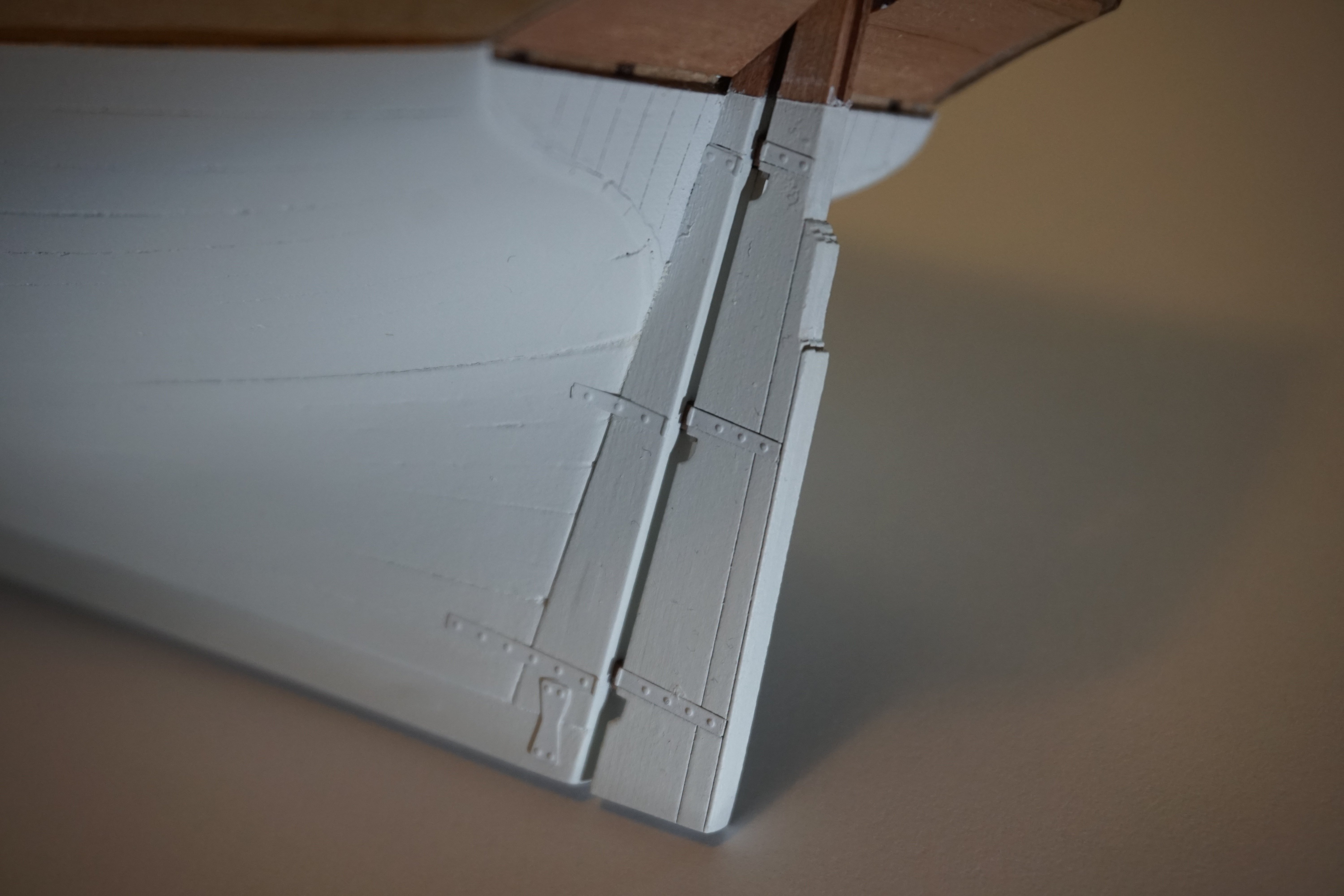

It took me an embarrassingly long time to figure it out myself. I too scoured other build logs, but since there was no mention of it, I assumed my PE sheet had a printing error that others didn’t. Should have mentioned about it in my log though.
This is how I did it, not sure if 100% correct:
Sternpost: PE-26, PE-24, PE-22
Rudder: PE-25, PE-23, PE-21
Edited by Nightdive
Many thanks both of you.  I'll follow Nightdive's parts list; looks good on his photo.
