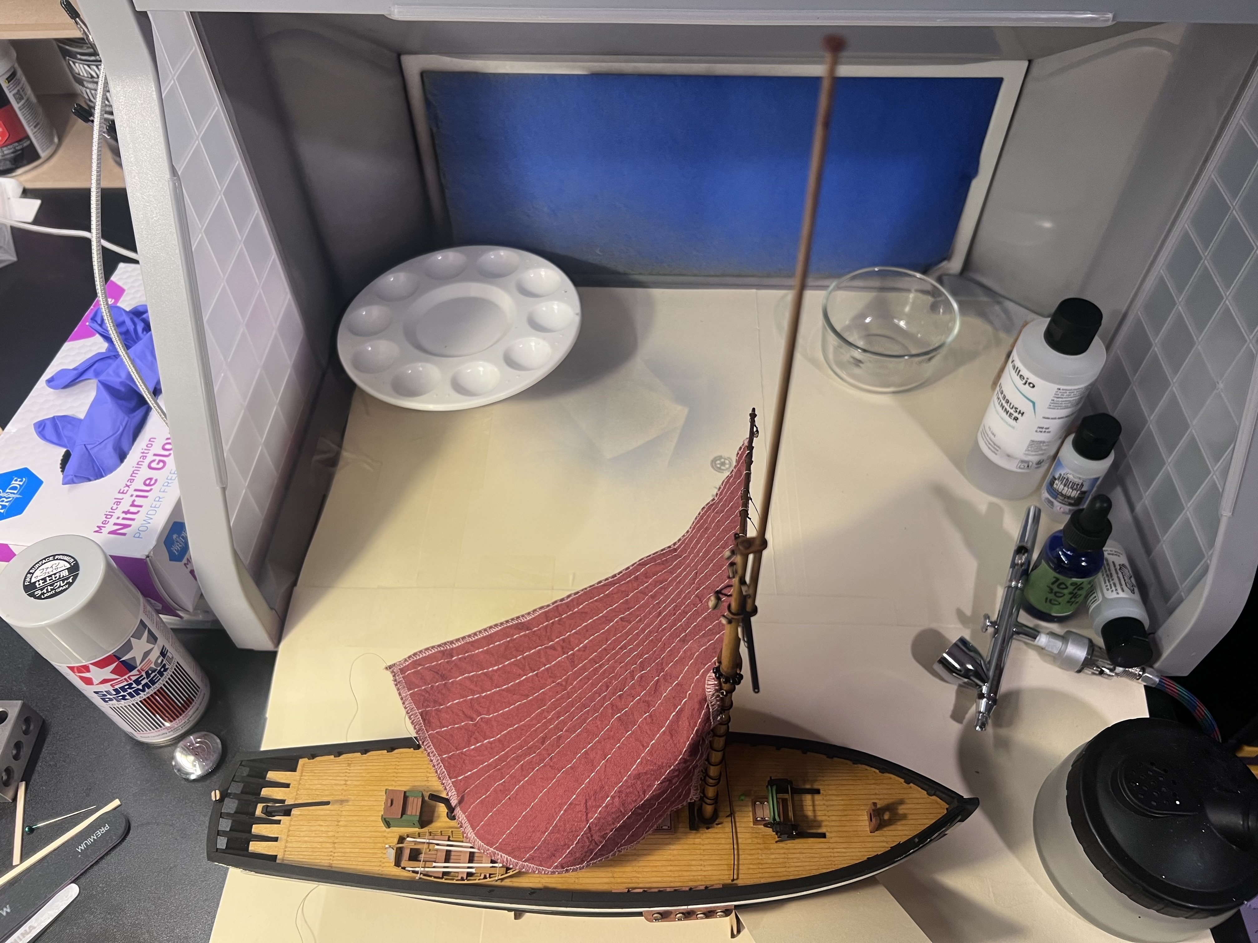

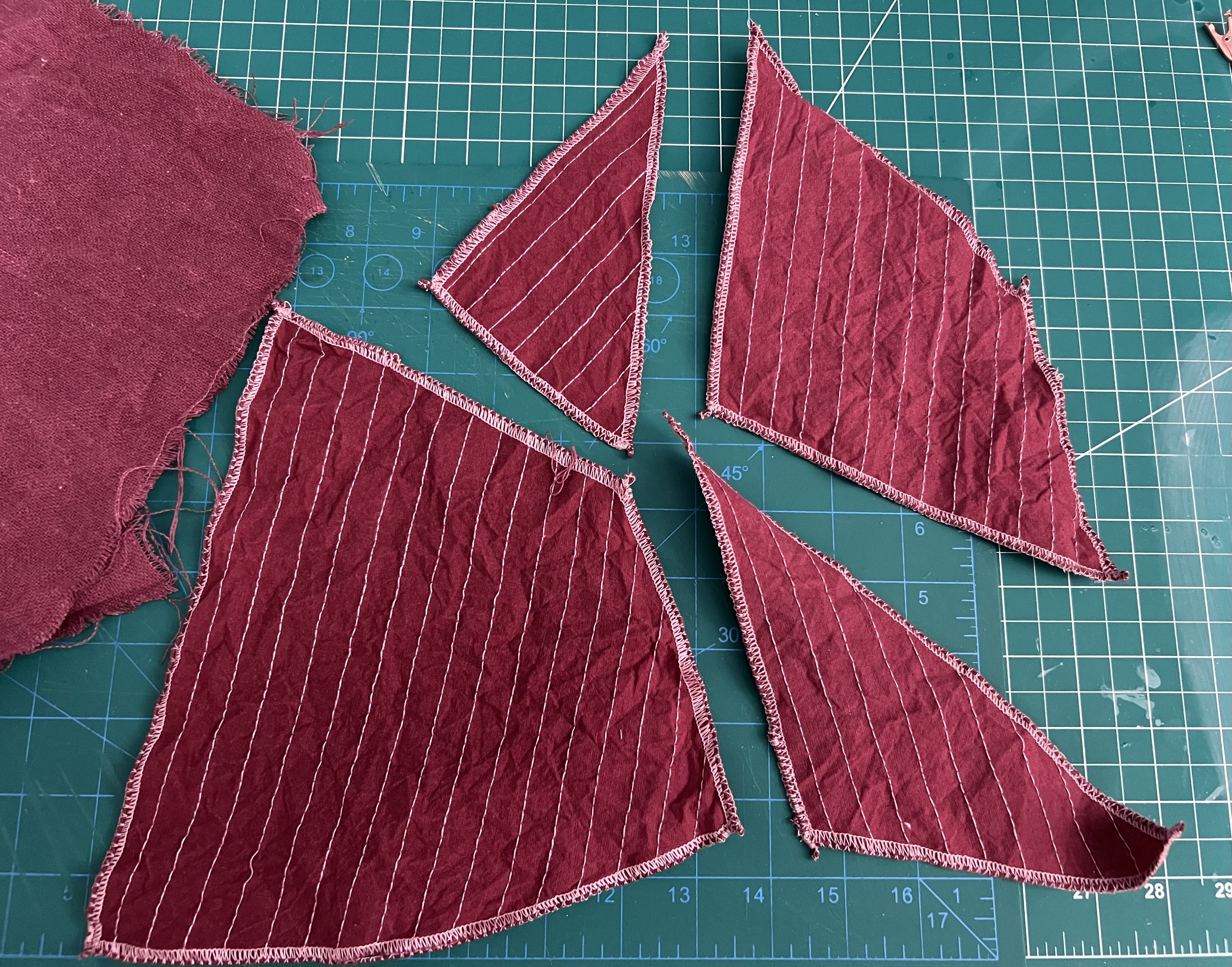

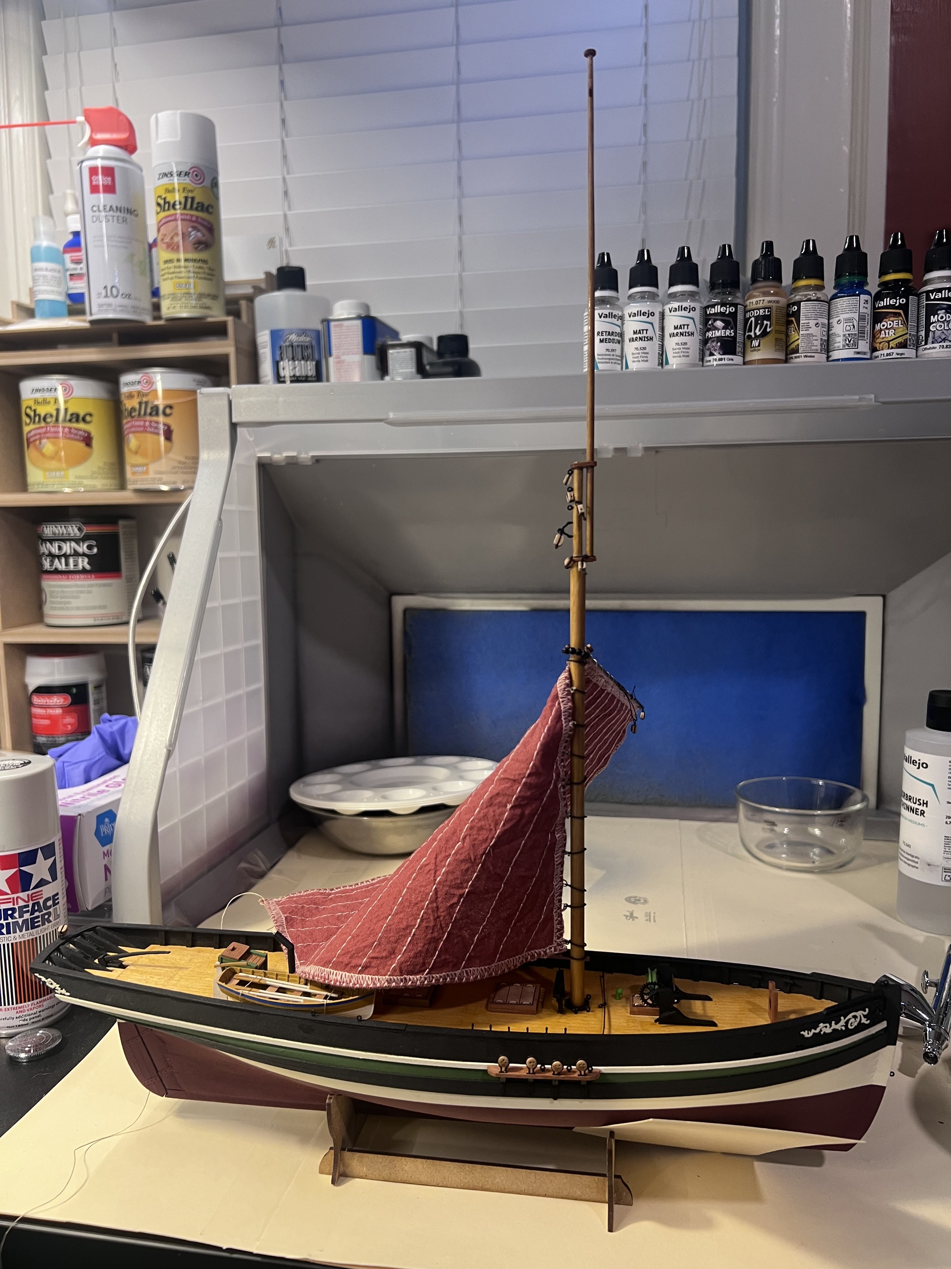

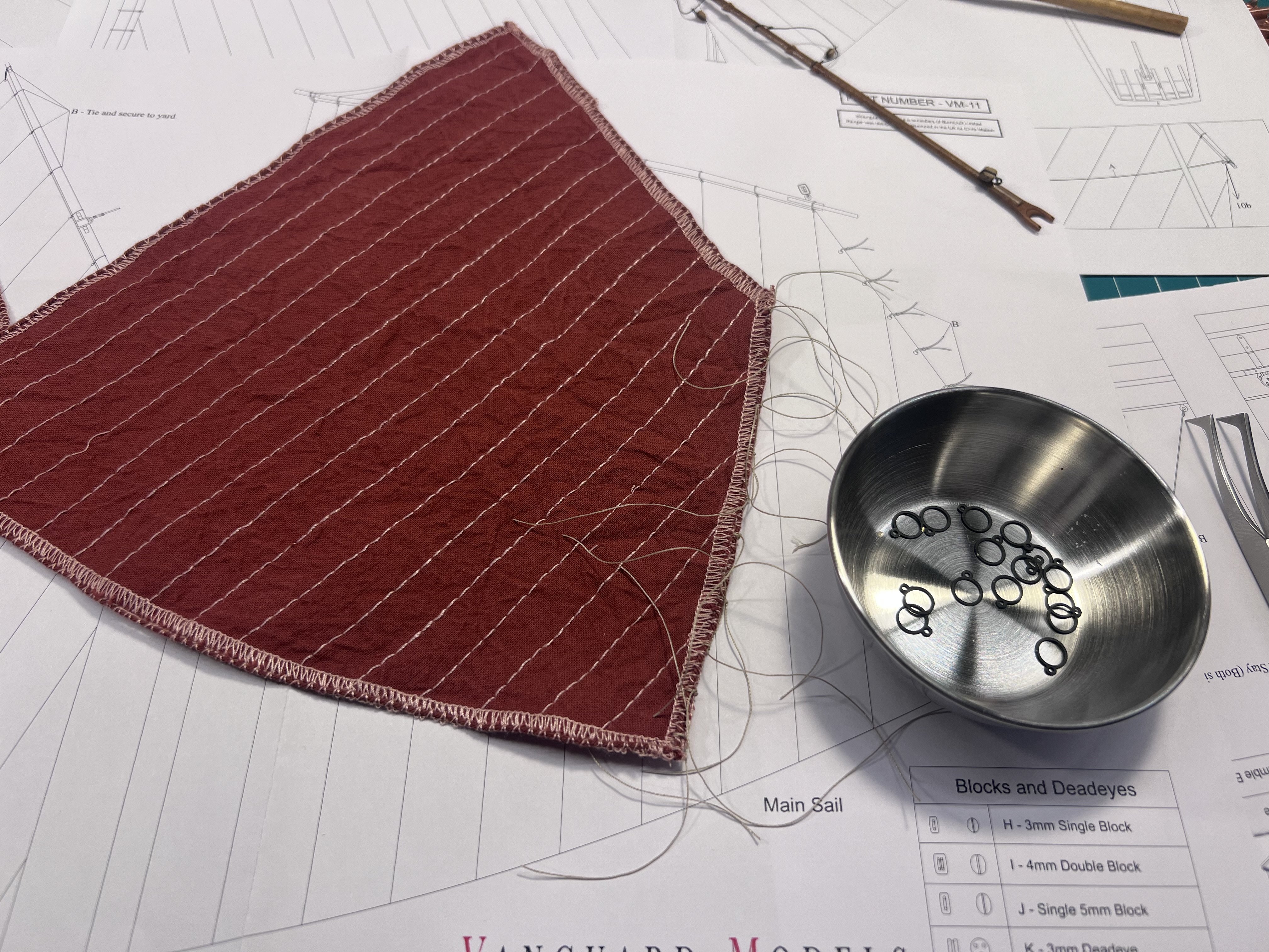

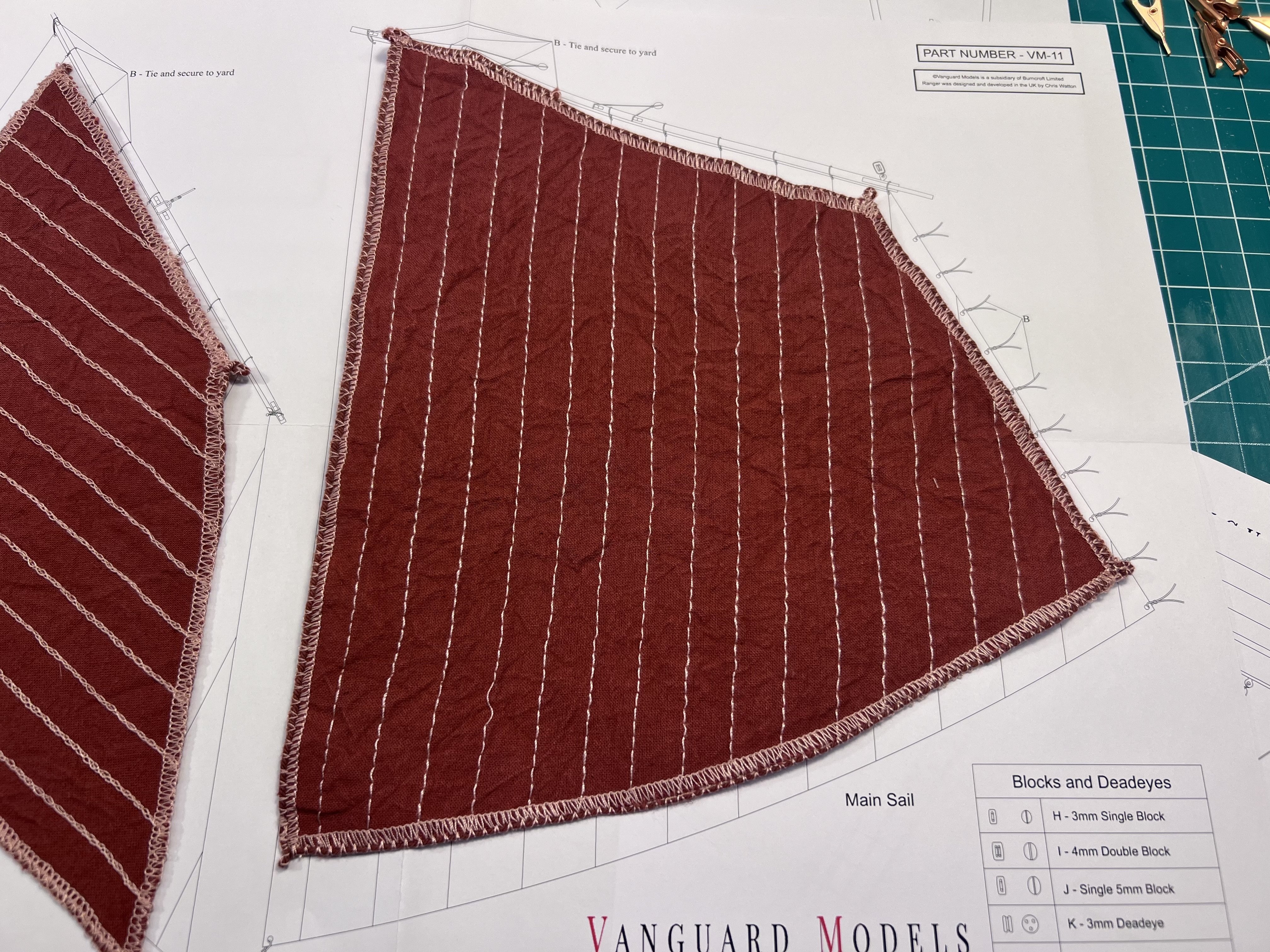

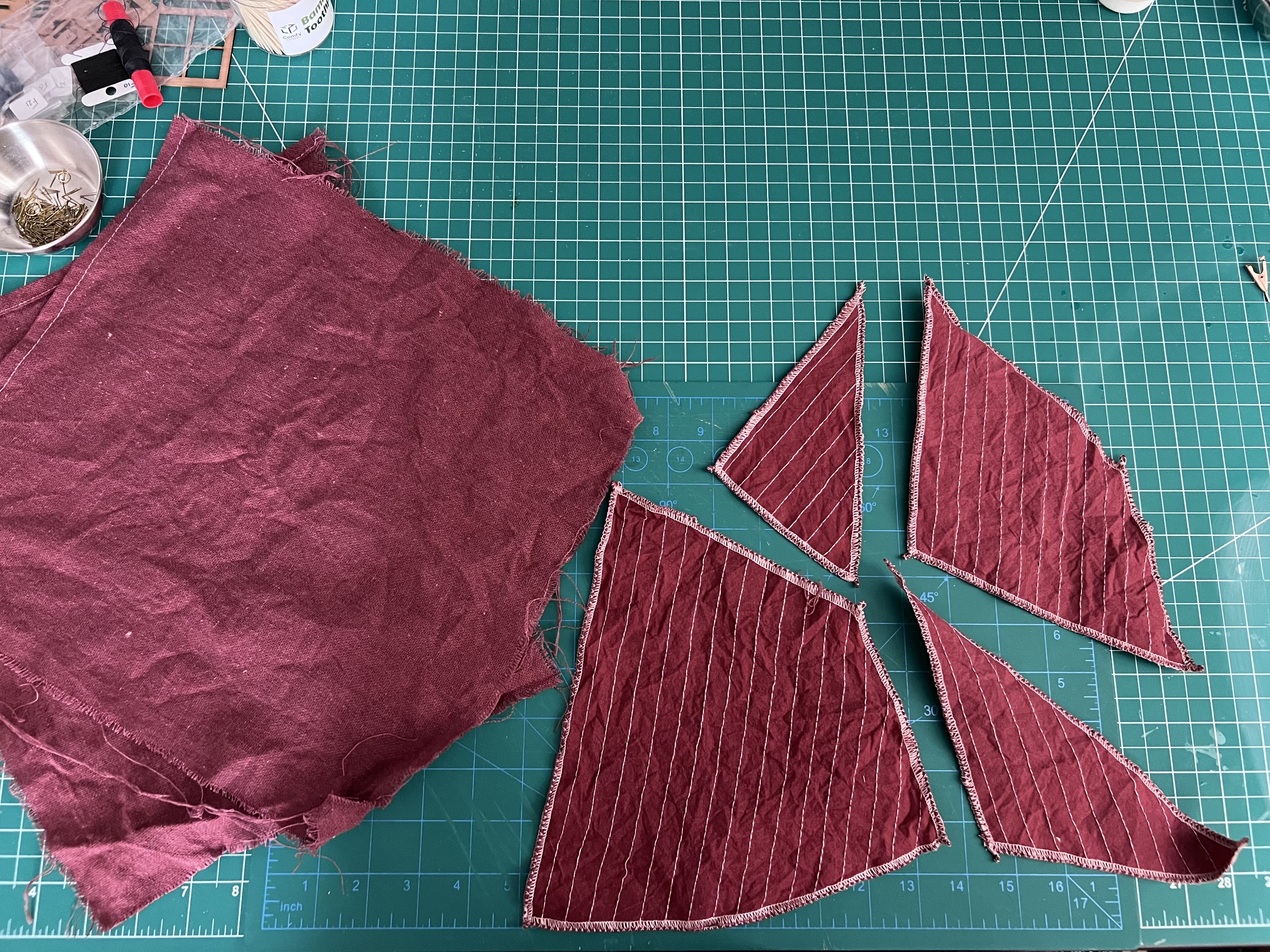

Dyed the sails. Playing around I ended up using a 2:2:1 ratio of RIT Tan : Scarlet : Cocoa Brown. Started with a 1:1 of Tan : Scarlet but that seemed too red. The end result is redder than the others, but I like it, and from what I’ve seen online for ships of this sort there seems to be some variability.
I’m also showing some linen fabric I dyed in the same batch. While probably closer than I had used an old t-shirt the shade is a good bit different.

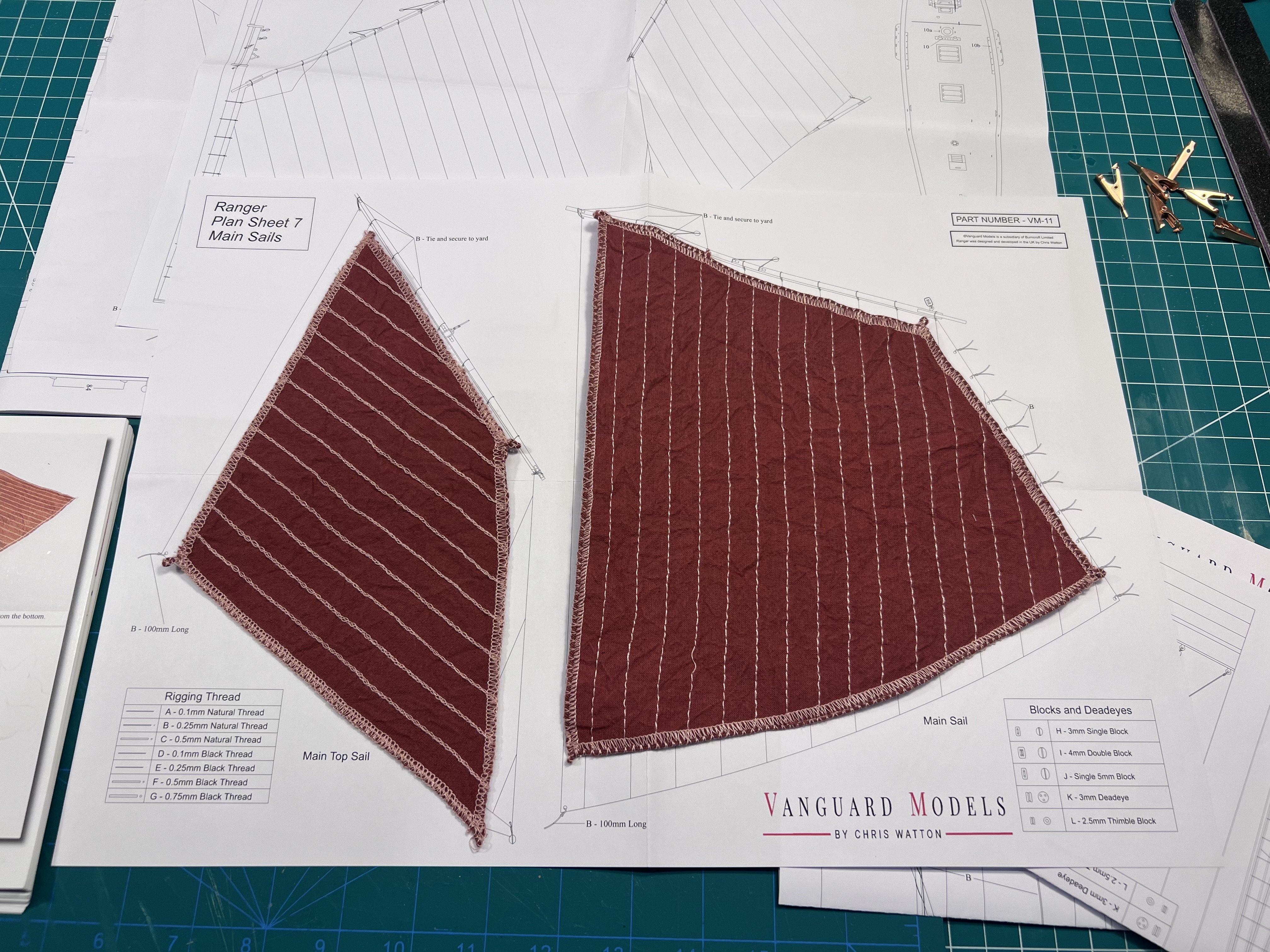

Oddly, the sail size isn’t 1:1 with the plans. I was hoping to use it to determine where to tie on main sail rings.
The boom is 1:1.
I think Chris Watton said he didn’t use sails from where he got them originally. This was from agesofsail so it could have been an old model from their inventory.

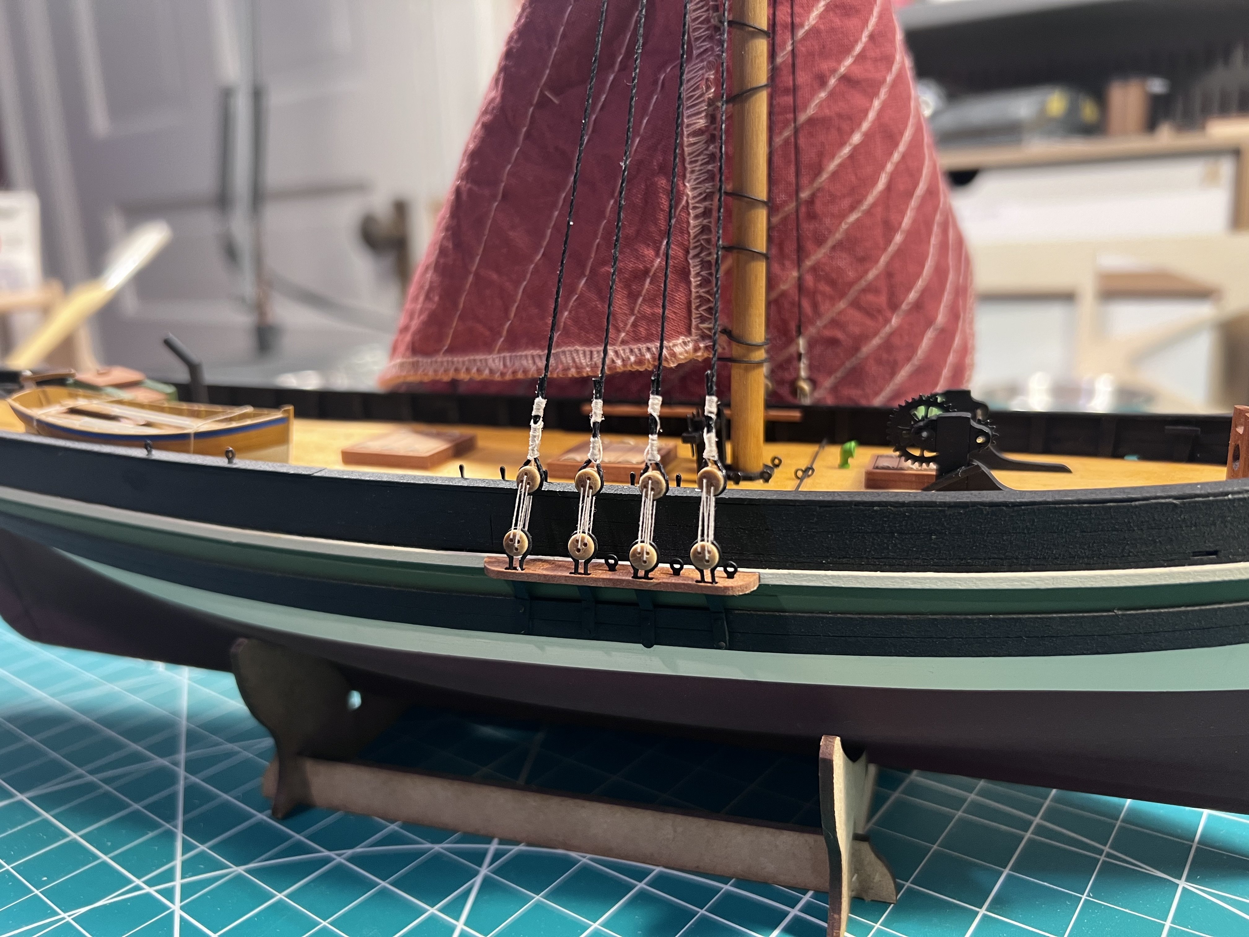

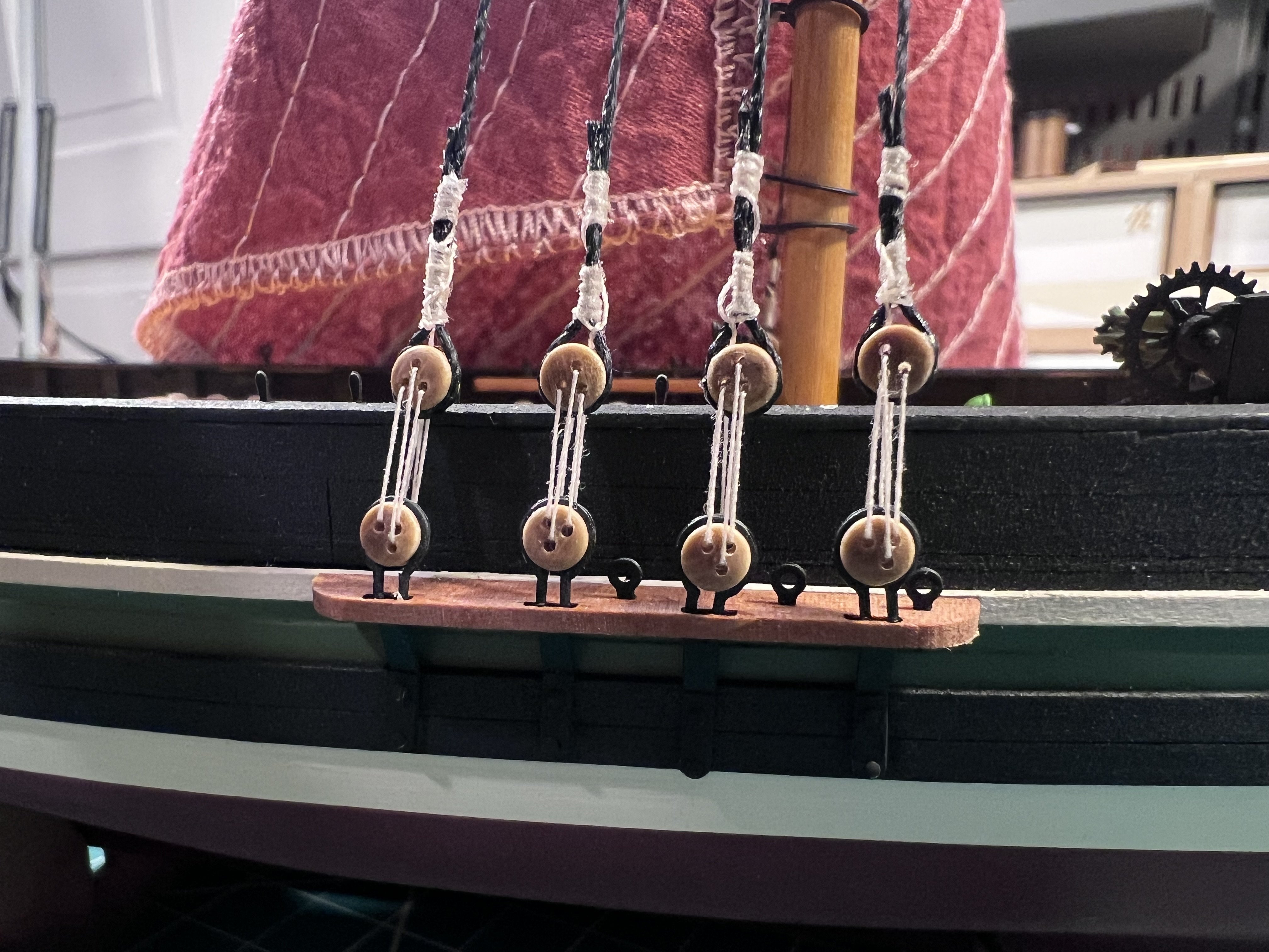

I’m done with the Vanguard Ranger. It’s my second Vanguard model after the Sherbourne. The first couple of photos are in progress shots, but the rest are of the completed model. I still have a few clips holding some rigging while it dries (the tied off rope has a coat of diluted white PVA), but I’m done. I’m going to try to take some nicer photos with my Nikon - maybe next weekend - still need to do the same for my Sherbourne that I finished a while back.
