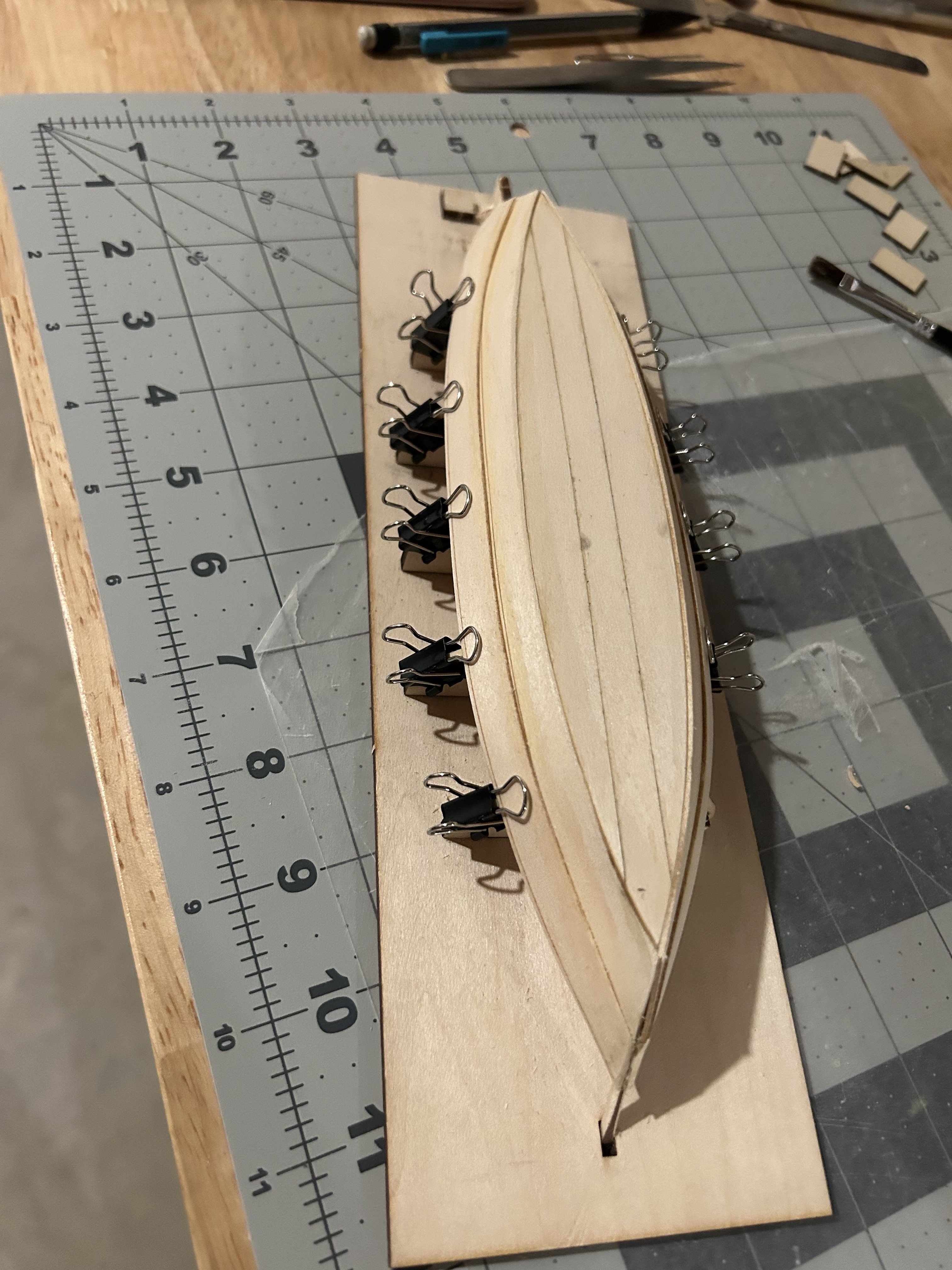

I didn’t have much of a chance to work on this much over the last two weeks but I’m back at it now. My repair job on the broken frame seems to be holding up and after a lot of careful sanding the last couple days I felt ready to move onto the garboard planks. Beveling the upper edges went fairly smoothly. While I had them soaking in hot water I managed to rig up some binder clips (first photo) to help hold the planks to the frame and almost act as a ledger board while I made fine adjustments and maneuvered rubber bands in place. I vaguely remember seeing that technique in a video somewhere along the line and I’m happy with how they worked out for this step. I think it will be very helpful when the planks dry out and I glue them—hopefully this weekend.

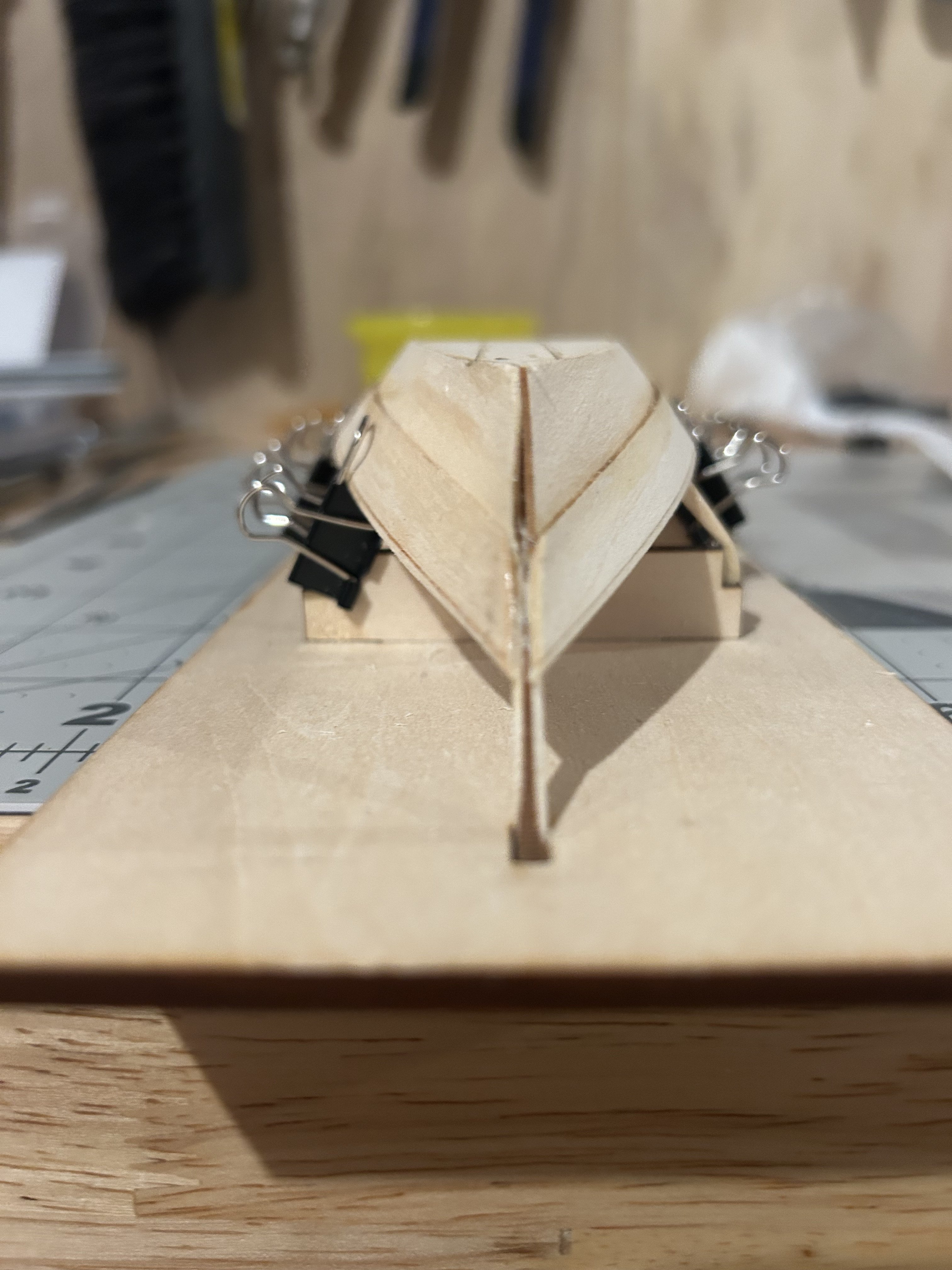

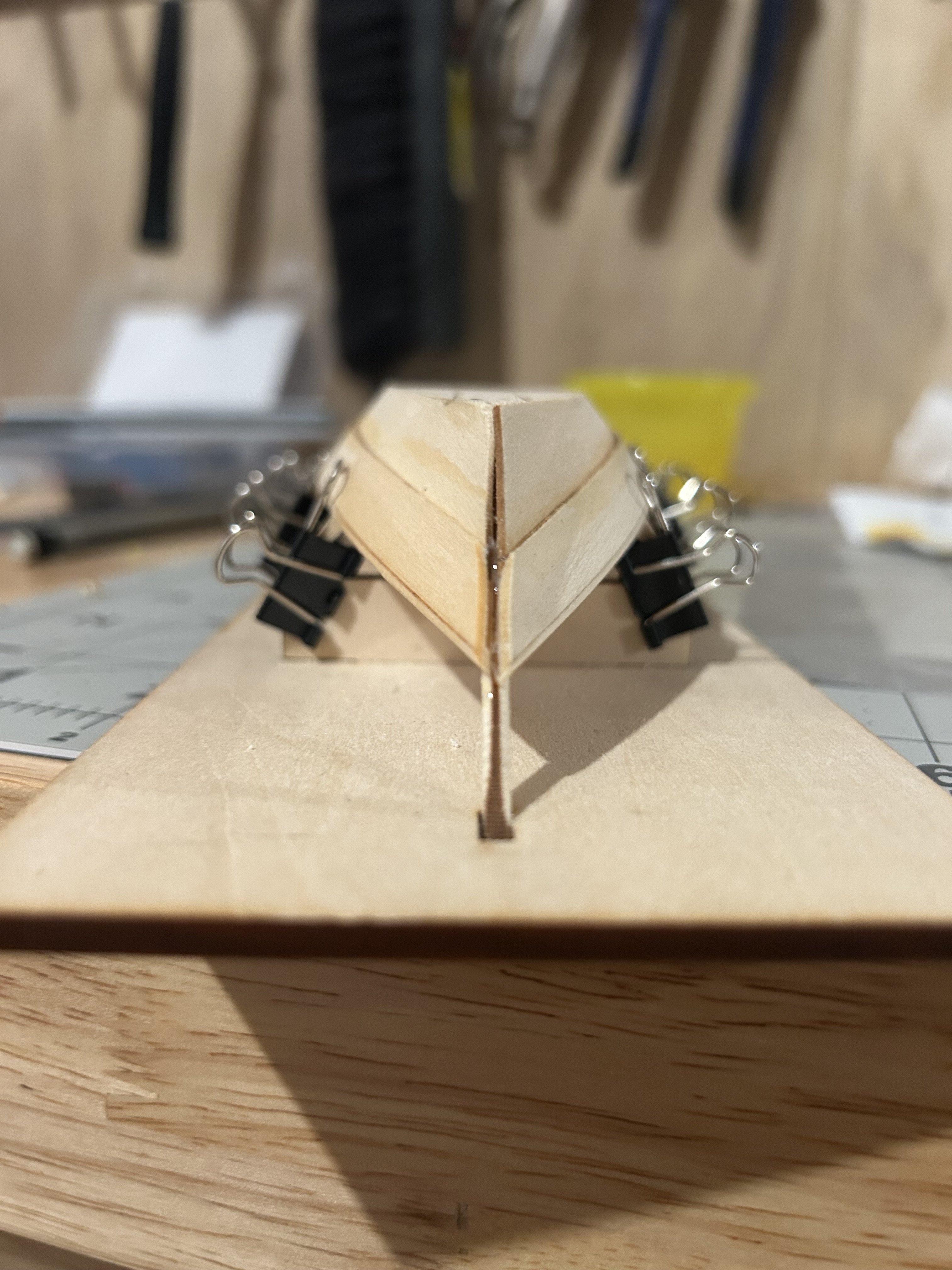

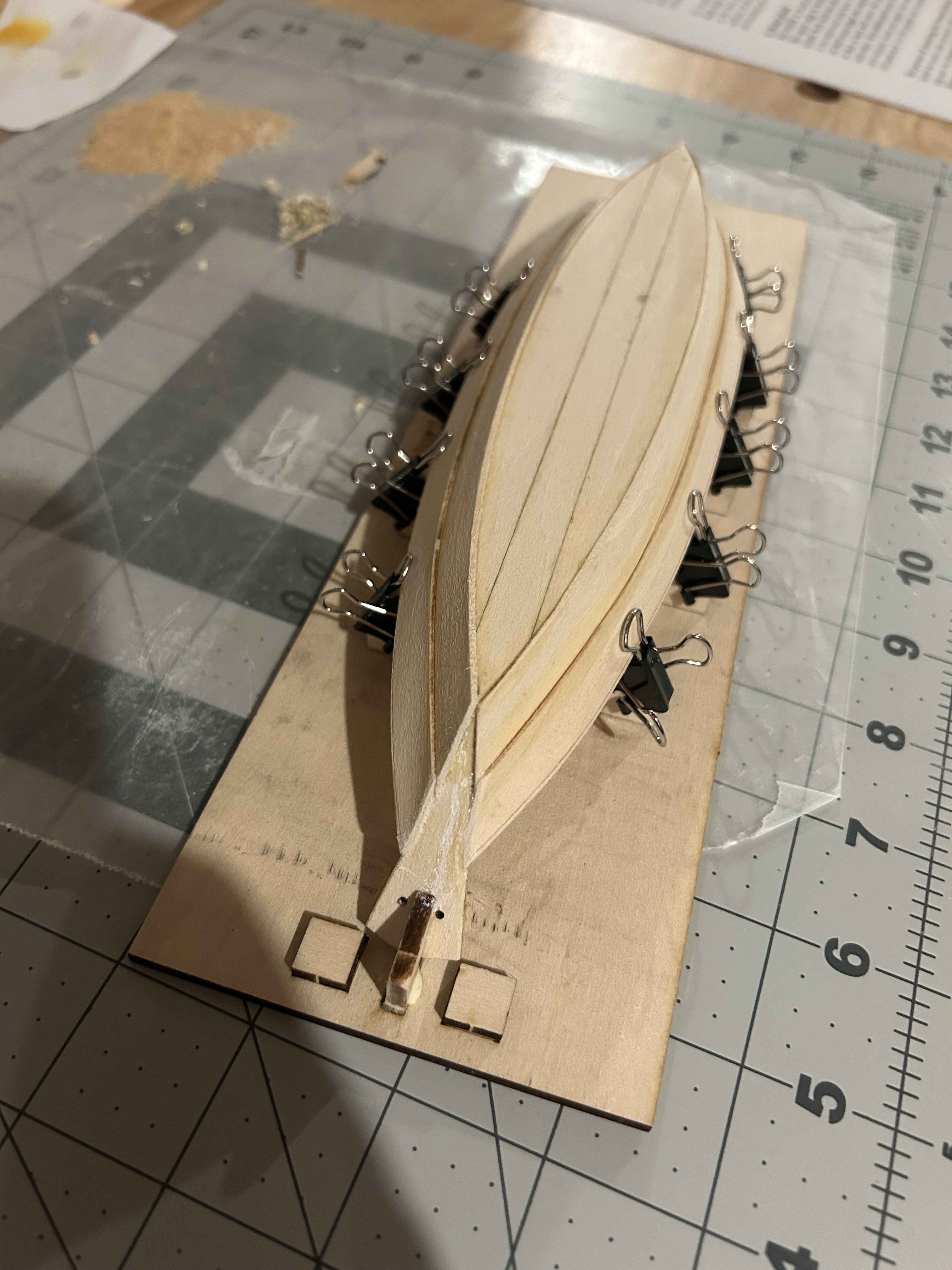

The broad planks gave me a much harder time. Looking back, I think it's probably because there are more variables at play, especially for a novice. I didn't realize until after the glue dried that on the port side, the two planks overlapped each other much more than starboard (first photo). I managed to to scrape the glue back to the first frame on that side and reattach it in a slightly better position. There's quite a bit more excess glue now, but I think the alignment looks much better (second photo). There is a similar issue at the stern, but it's not as bad and I had some CA glue mixed into those joints so I'm going to leave it. All part of the journey I suppose and hopefully I can take what I learned here and apply it to the final planks.
