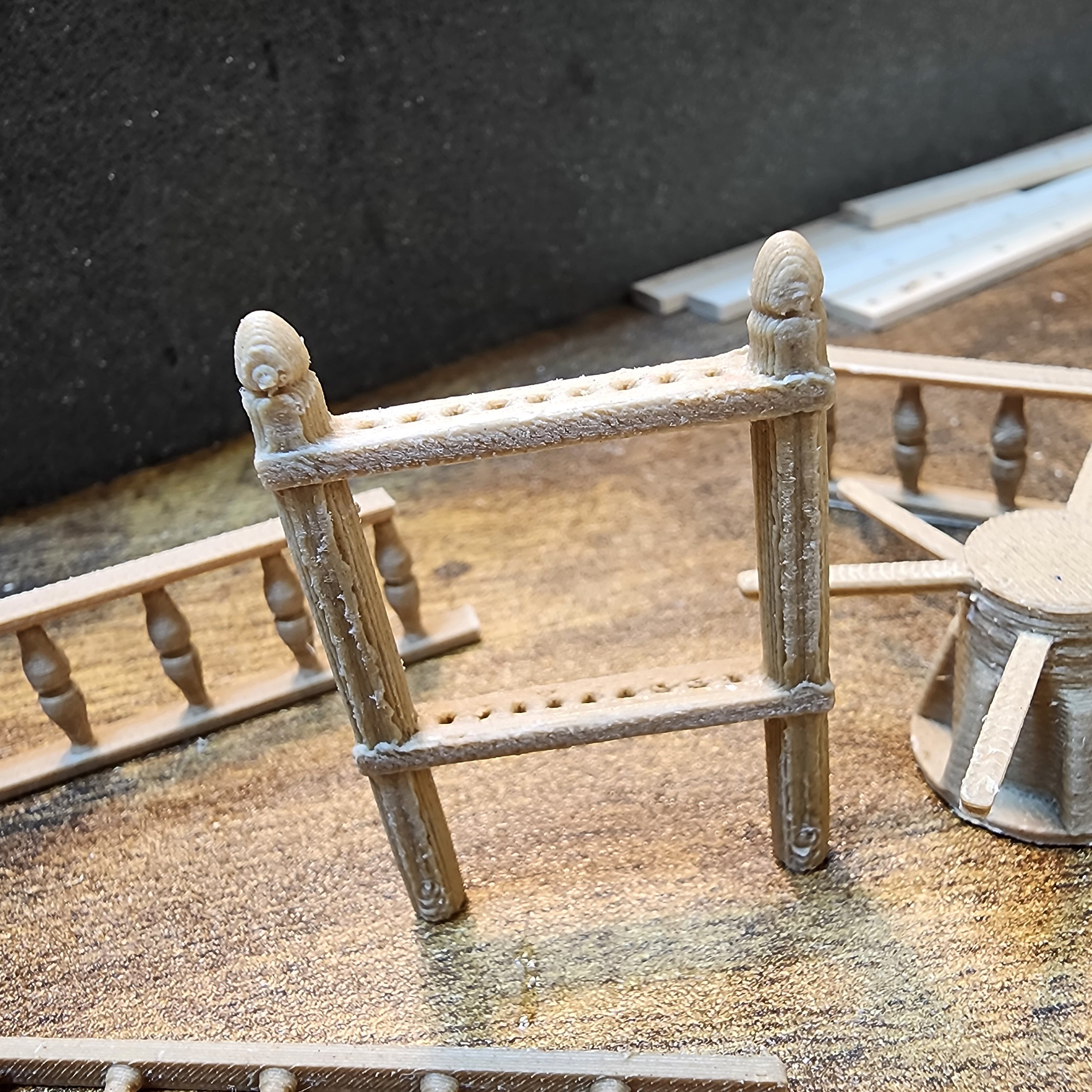

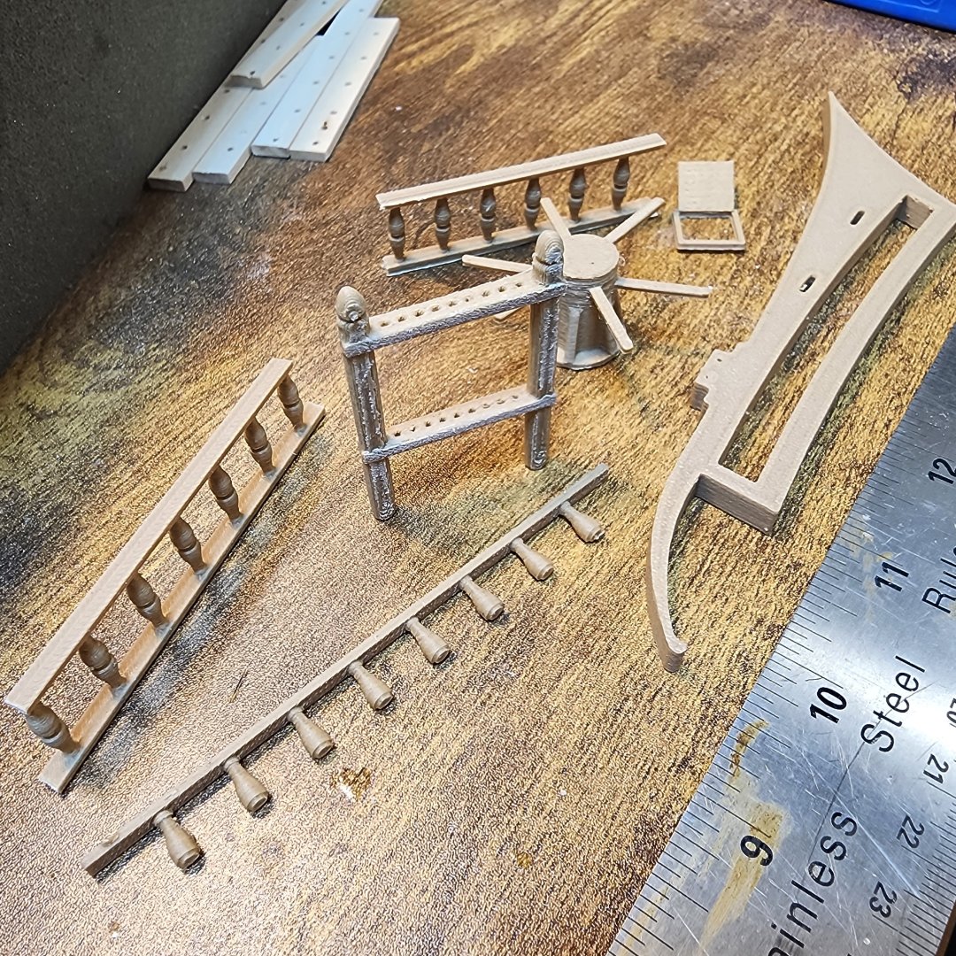

Not sure if it is right for your application but
I build 16 and 17 century tall ships so almost everything is wood.
I use Creality Wood filament PLA 1.75 because it is 30% wood.
All the parts were printed on a very inexpensive Creality K1 printer.
This is off the printer with no cleanup, sanding or touchup.
The second picture is right off the printer so need to be cleaned up
but I will leave the vertical lines in because has the look of sawed rough wood.
20250905_103931.thumb.jpg.d2c2d6b33e04b590a4ace9ed378d1e56.jpg20250905_104148.thumb.jpg.b25ecfea34050f092324a263c7cf91b0.jpg

FDM printing is ideal for those who enjoy sanding and aren't interested in small, detailed parts.  Using wood-like material is irrelevant since it's going to be painted over anyway and usually requires a larger nozzle diameter, reducing details further.  I cut my teeth on commercial FDM printers that cost thousands, and bought a $350 Phrozen resin printer just to see what it could do.  I was immediately blown away by the intricate details it could produce.  Minimal sanding was the icing on the cake.  My time is the most important commodity I have control over.
Cons: Resin printing requires a dedicated, well-ventilated space and parts cleaning can be messy, despite the vortex cleaning stations available.  91 IPA is one consumable along with resin, but I've learned how to minimize how much IPA I need, using a discarded Windex sprayer, foam brush, and compressed air (60 psi from my air brush) to blow the excess resin from the .1 to .4 mm details.  A half quart bottle of IPA lasts weeks instead of submerging the entire part in a plastic bin and contaminating a larger volume of IPA which becomes less and less effective over time and then has to be disposed of.
For test fixtures and jigs, I still like FDM prints and farm those out to friends to produce my designs.
Learning how to properly orient parts in a slicer takes time to acquire -usually through multiple failures (part of the learning process.)  Resin printing is not plug-and-play as advertised despite new advances in printing technology.
Being able to create parts with injection-molded precision at home is pretty darn cool though, and worth a look if that's what you need.

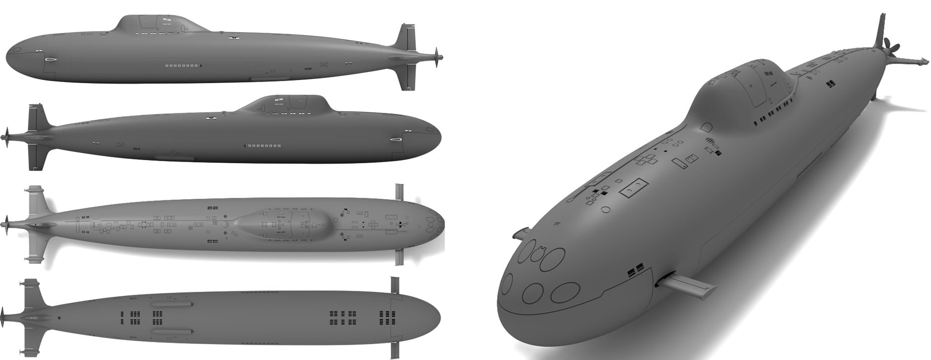

My first resin model renders (for an RC submarine project) and the printed results were virtually identical.
