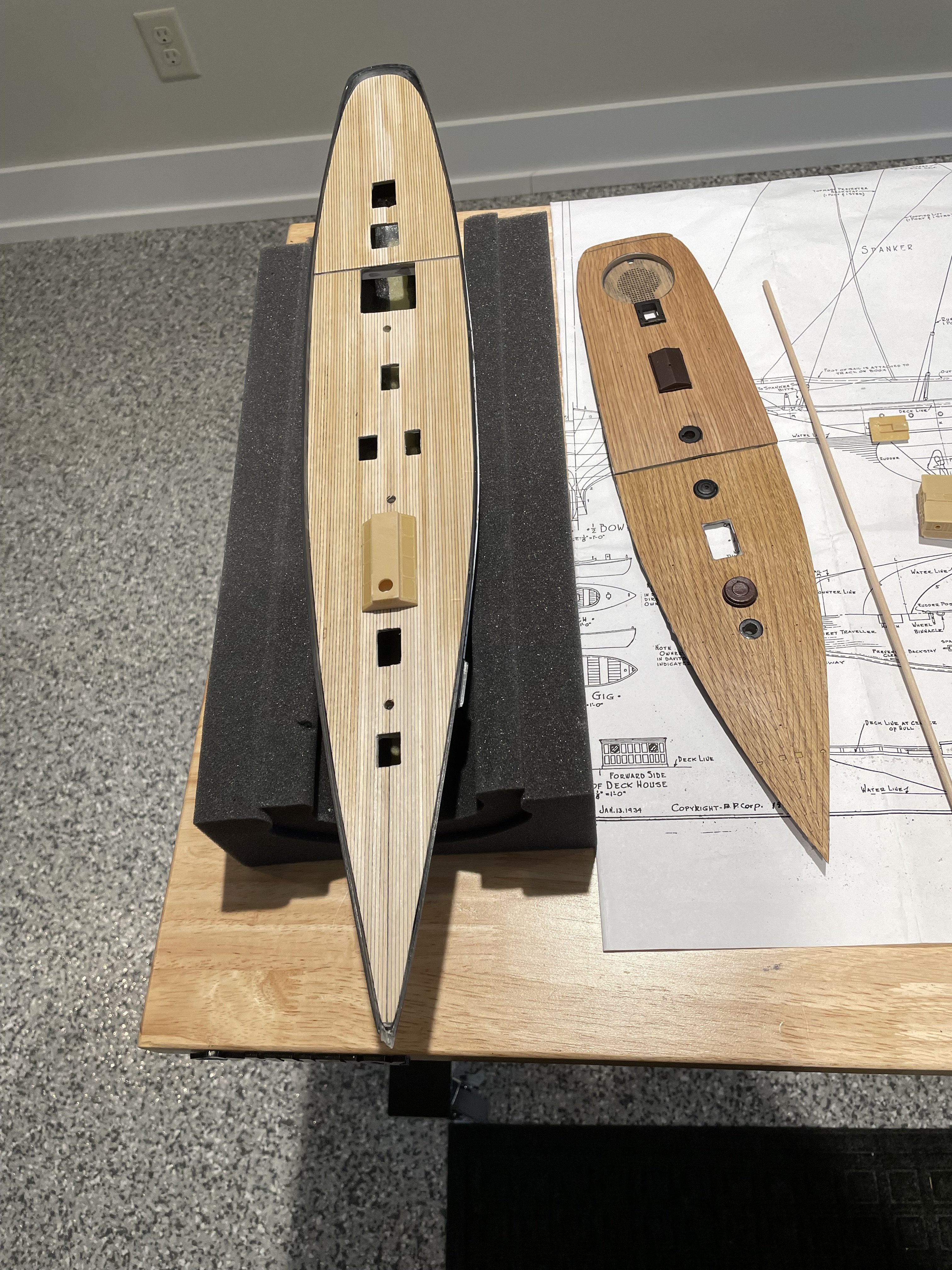

Moving-on to the deck installation, all deck detail was removed. I also opened up the locations of the various deck houses. Then the glued up deck sheeting was marked and cut to fit the deck. Because the width of the deck was too wide, I made a pattern and split  the wood deck along the center line. The makes for a seam along the centerline. The wood deck material also had ro be thinned before use in this build.  The wood decking was laminated to the plastic deck with epoxy.
 More on this to come!

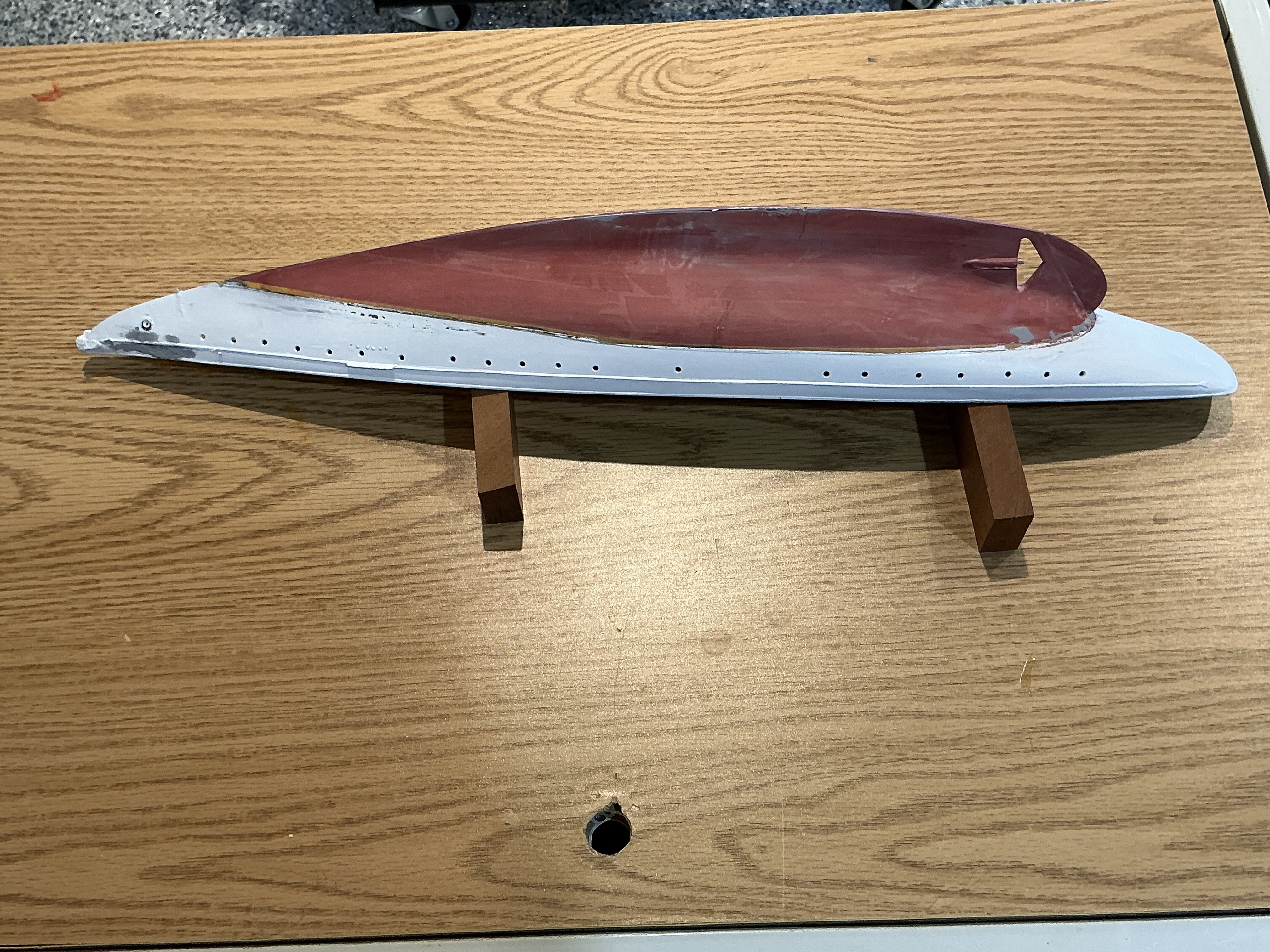

Now is the time to talk about the paint debacle. When I saw Bluejacket’s  Atlantic, I really liked the hull color scheme- black over scarlet red. They were using Model Master paints back in the day. Rustoleum put and to all to the Testor’s lines some three years back. When it came time, I ordered the paint for the Atlantic. I received an assortment of True North paints.
True North paints are based on mineral spirits. I is odd stuff to work with. The hull color sent was a WWII anti fouling paint color in salmon pink. This paint dries slowly. Second coats blend nicely. It takes a lot of thinning for an air brush to cope with the mixture. I really wanted the deep red color on the hull. I decided to paint the upper hull to see if I could live with. The flat black was full of sediment and very to mix. When I thinned this paint ; it required more tan 60 percent thinner and much higher pressure. The paint dried dead flat and it was very grainy. I put the gold paint on the trim by hand brushed and masked and sprayed the arrows above the portholes..it required some touch of the black . I noticed the detail was getting muddier and muddier. When I stood back and looked it was just a mess. I stripped all of the hull uppers off with Testor paint remover. The paint remover was not very productive- it took three passes to remove it. I left the lower hull covered, put  this project on the shelf last summer. I just this week removed the tape. Not the best idea leaving the masking tape on for so long.
The picture below is the hull looks like after cleanup. It looks the pink color looks like it paint over well, but I pine it for paint barrier, just in case. I will be using Tamiya hull red for the lower hull. The True North paints went the garbage a  long time ago. The next  time you a photo it will be a much happier sight!
