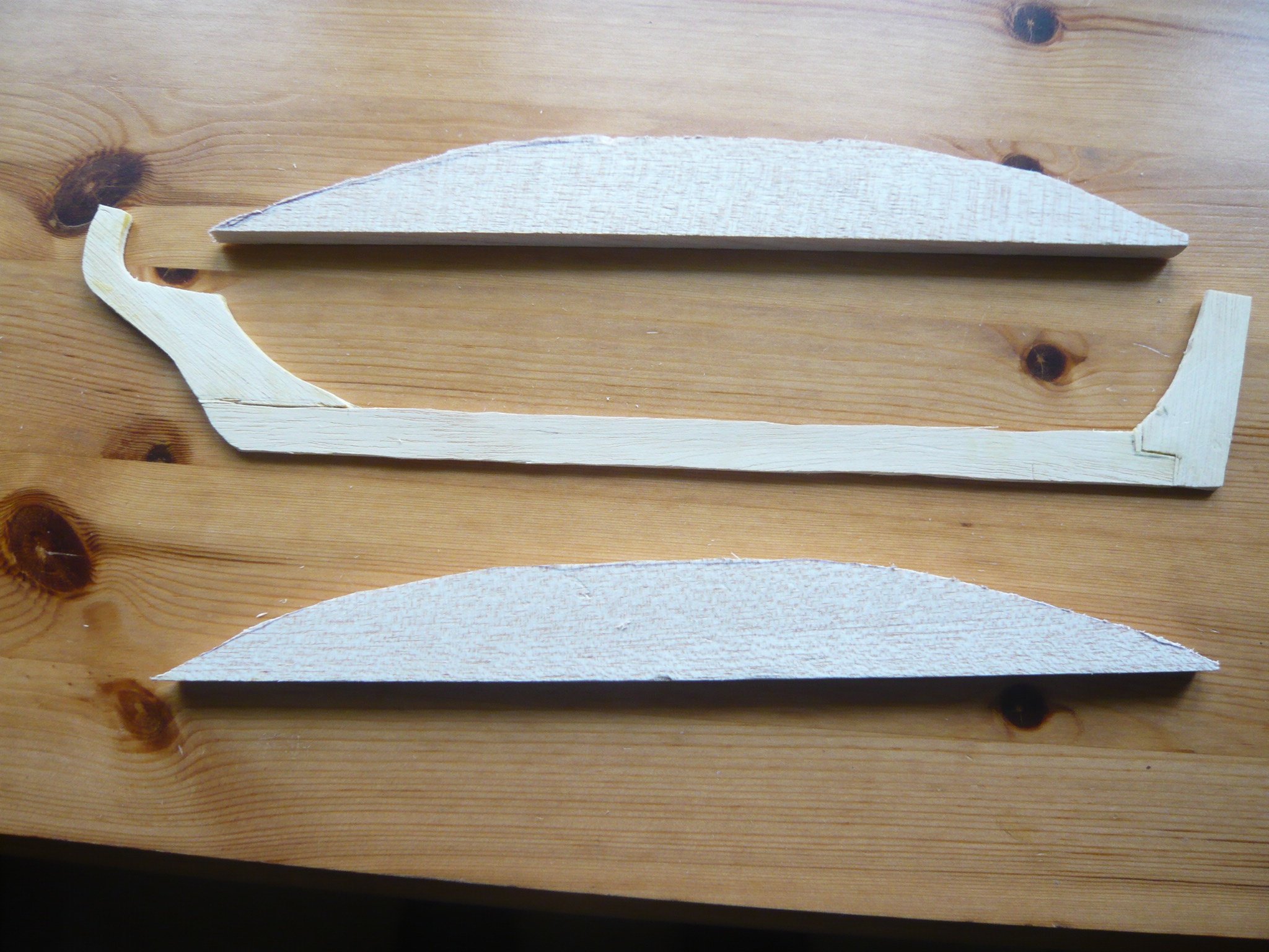

So, here’s the start. Note that the scale is 1:160, so the model will be about a foot in length. It all looks very primitive in the early stages, but there seemed little point in trying to fabricate the keel as one would have to do with, say, a scale of 1:48 as used by the craftsmen who built such splendid models in the 18th century. The wood for the bread-and-butter slices is balsa, and I dare say that choice will not meet with much approval. But it is easy to work, and does not warp, twist, expand or contract, at least to judge by the way the models I made in the late 1950s have lasted.P1070031.thumb.JPG.1799e3eb6db7edd3d4946d7cc1ba3be8.JPG

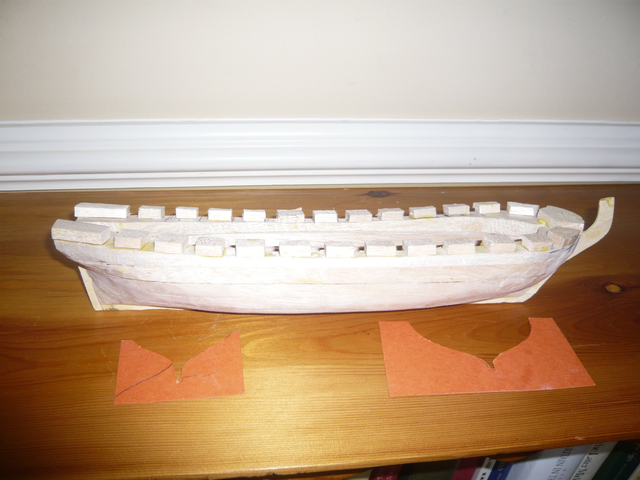

The next photo shows initial progress, with just a couple of templates I’ve used to check that the model follows the plan reasonably closely. I’ve tried something new for me, Barrot de Gaillard’s method of making gunports. It does ensure that they are all lined up correctly. He was a little concerned that the sheer meant that the rectangular blocks were not quite vertical at the bow and stern, but that’s easily remedied by making the blocks less than absolutely square. I’ve not decided whether to have the gunports, at least the lower ones, open or closed, but that decision can wait. I think that these gunports are too small for it to be worth lining them, though it would make them neater.P1070040.thumb.JPG.3dcff00ca4c467ac54ae237ec885d77d.JPG

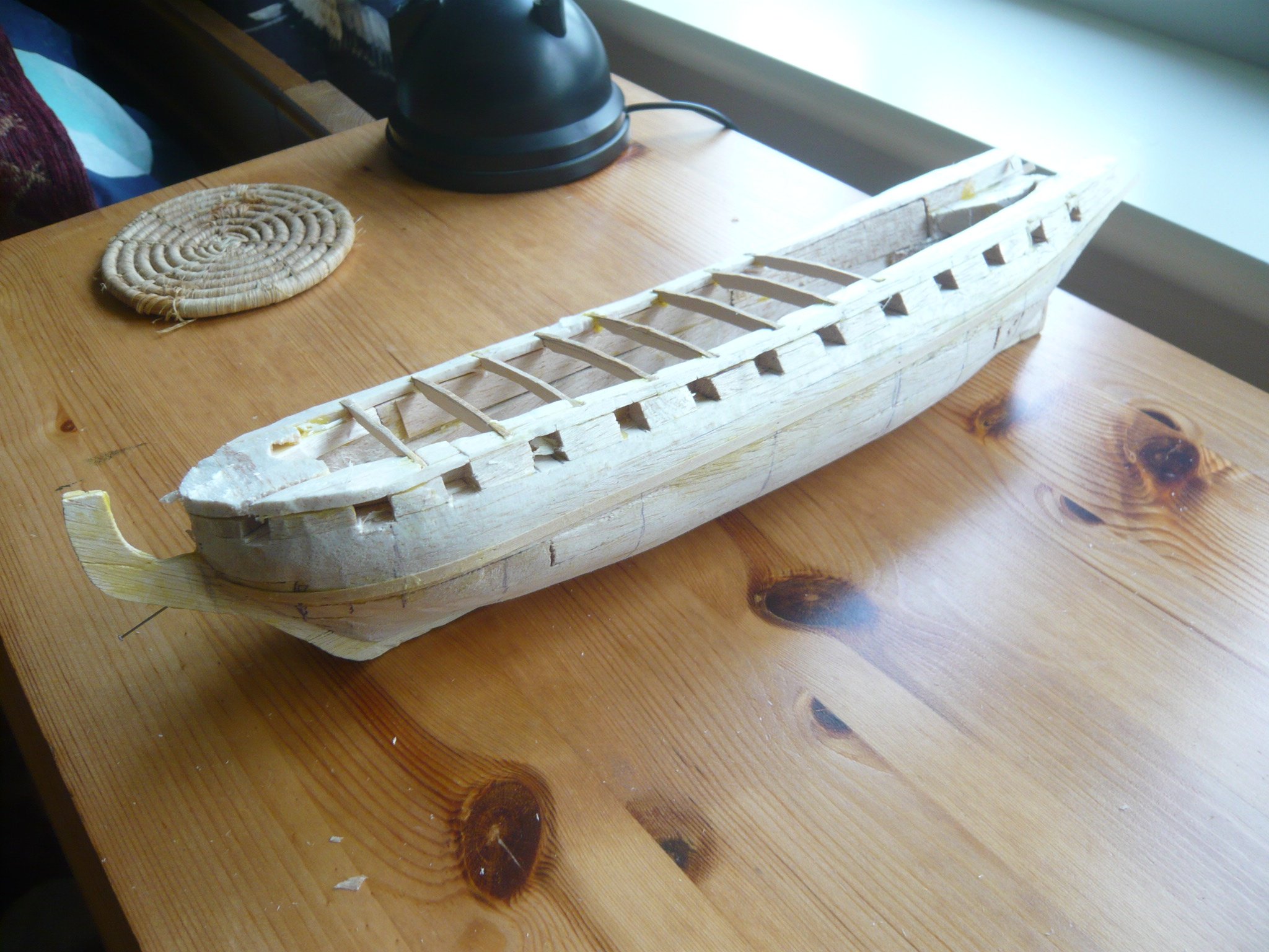

Next is another view, showing deck beams installed. There is a long way to go.

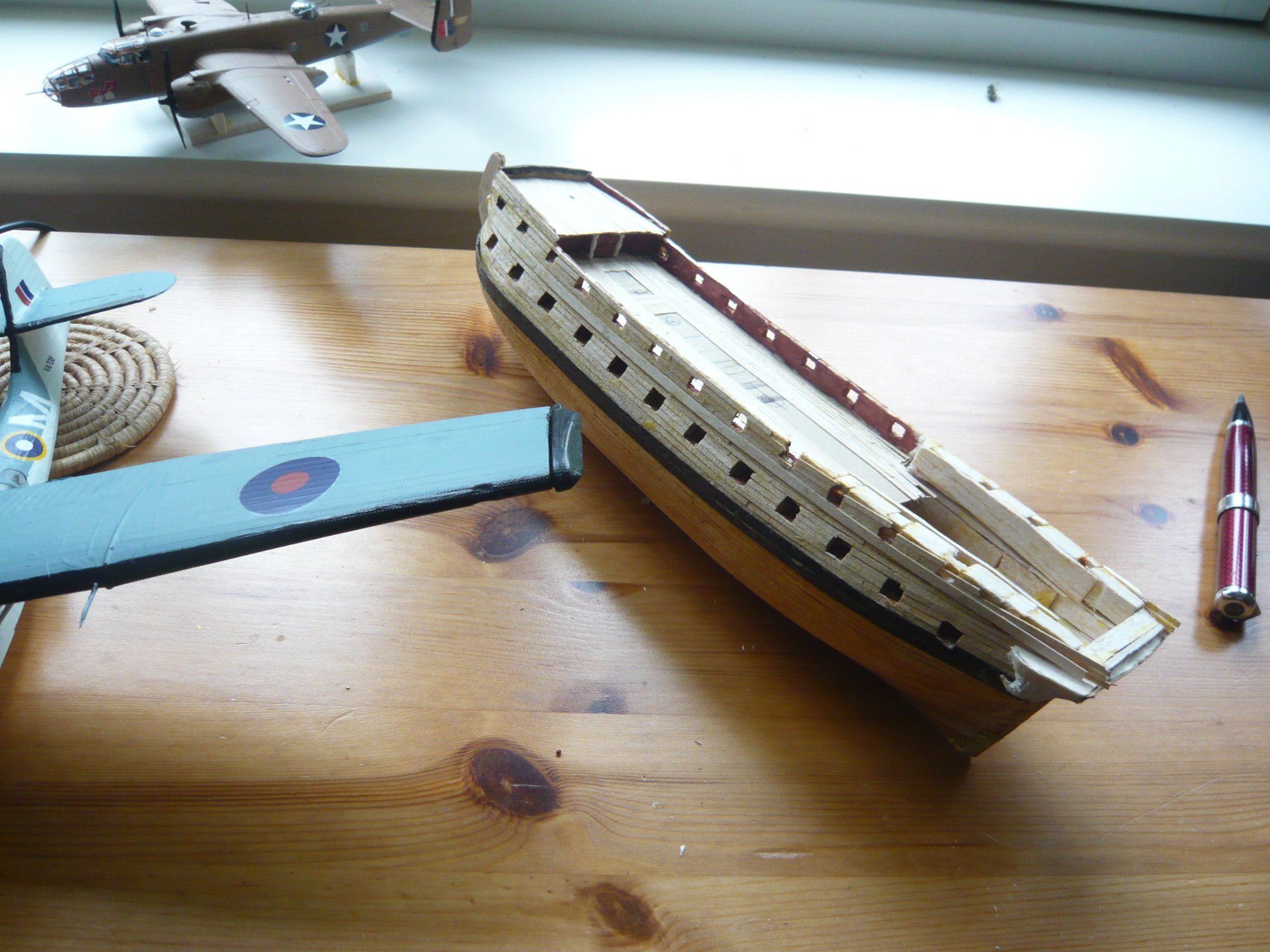

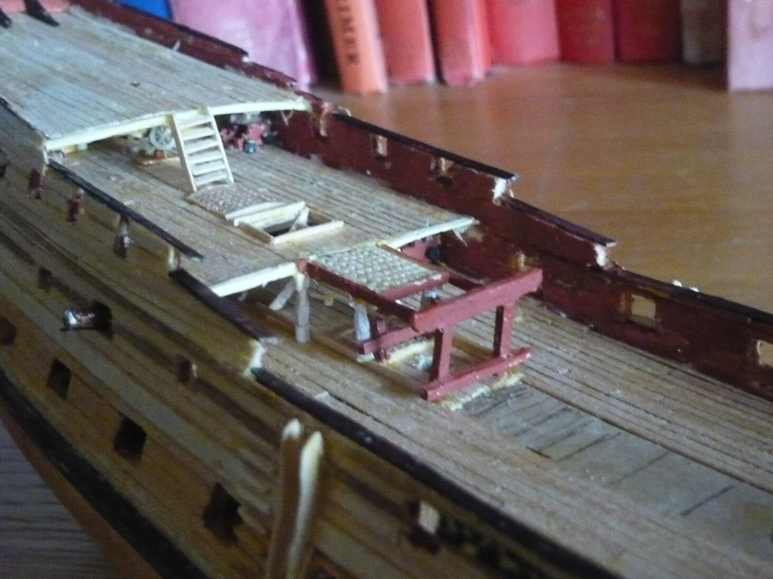

Once again, it’s been too long since my last posting. The model proceeds slowly, Wimbledon on the TV having been the latest distraction. As the photo shows, some of the decks are now in place - the upper deck and the forecastle deck . They present some interesting issues. As I have not installed a large number of deck beams, I have fitted a thin card deck first of all; the planks are then be glued to this.  Of the various ways of showing the caulking between the planks, the simplest at this sort of scale is just to use a fairly soft pencil to darken the edges. The focs’l bulkhead is also fitted. I was a little worried that the height of the focs’l deck seemed too low, but it gives, scaled up, a headroom of about 5’ 8”. As the average height of an adult eighteenth century sailor was about 5’ 5” that’s not a problem.  The crew of the galleon captured by Anson, Nuestra Senora de Covadonga, were startled to discover that many of their captors were boys, and calculations suggest that on average an eighteen-year old would not have reached five feet in height. So they would not have banged their heads on the deck beams.
So, here's a picture of the latest state of play. The plastic aeroplanes, incidentally, are the work of a 12 year old grandson, who is especially proud of the Catalina on the left of the photo.

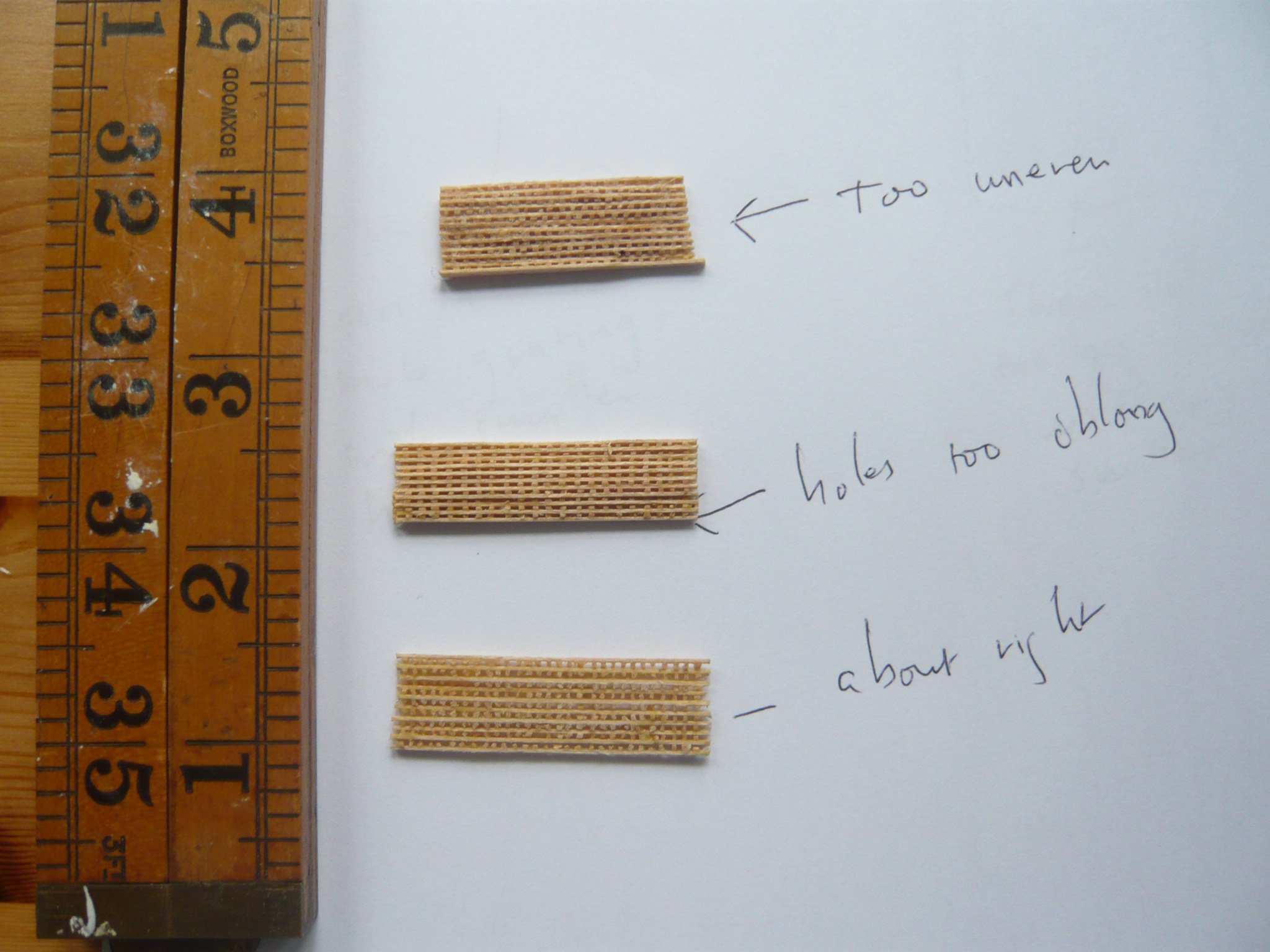

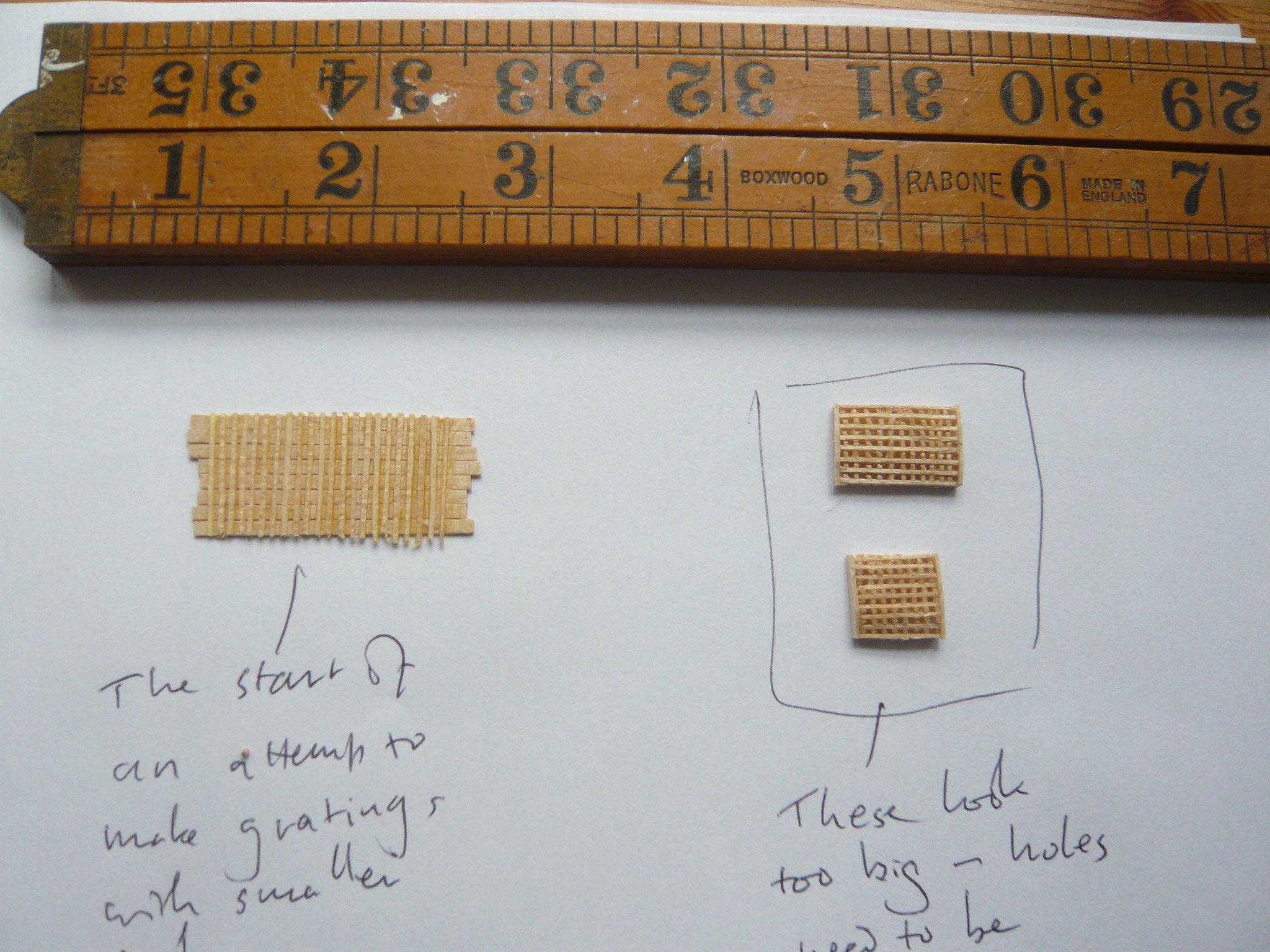

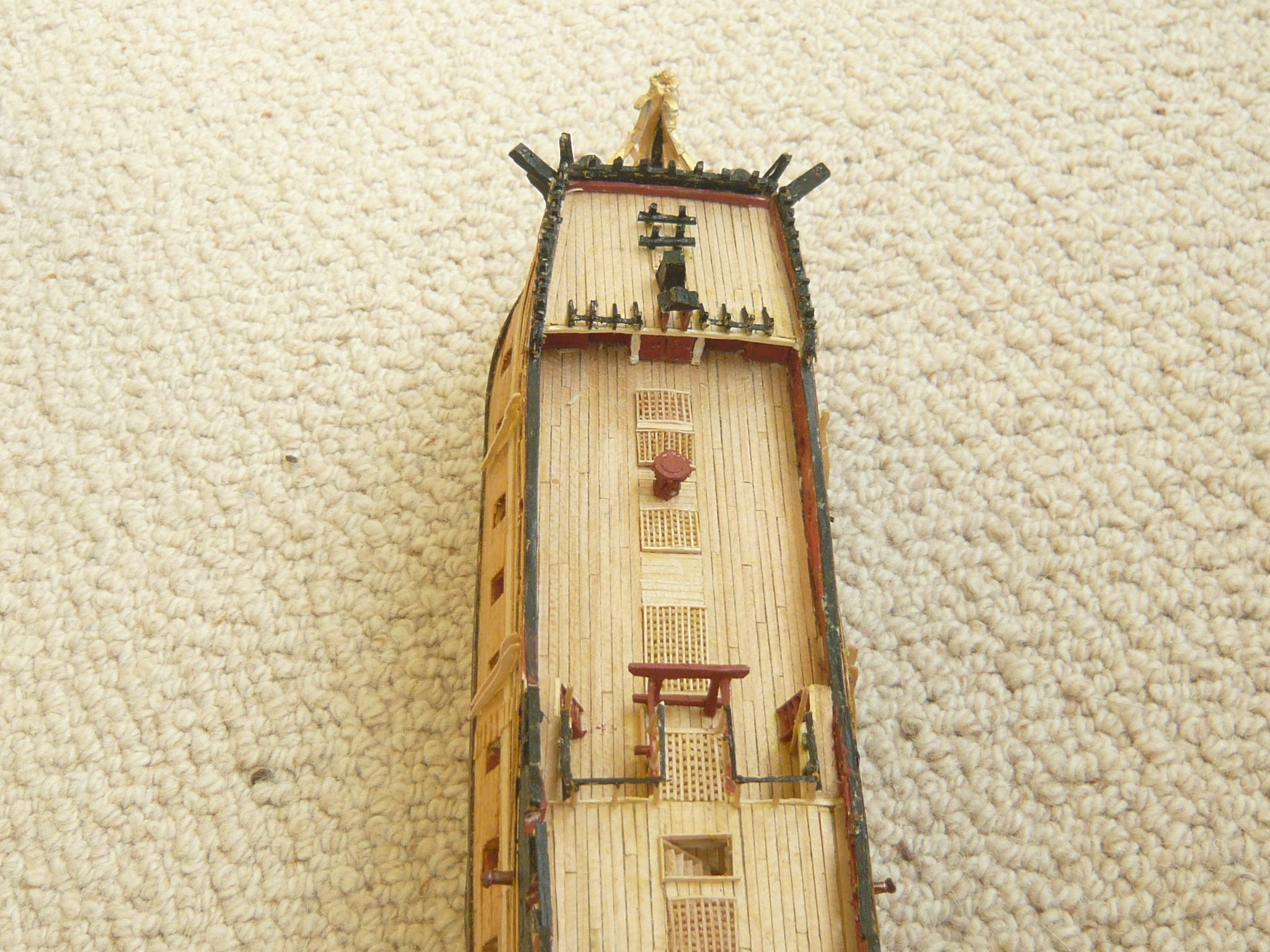

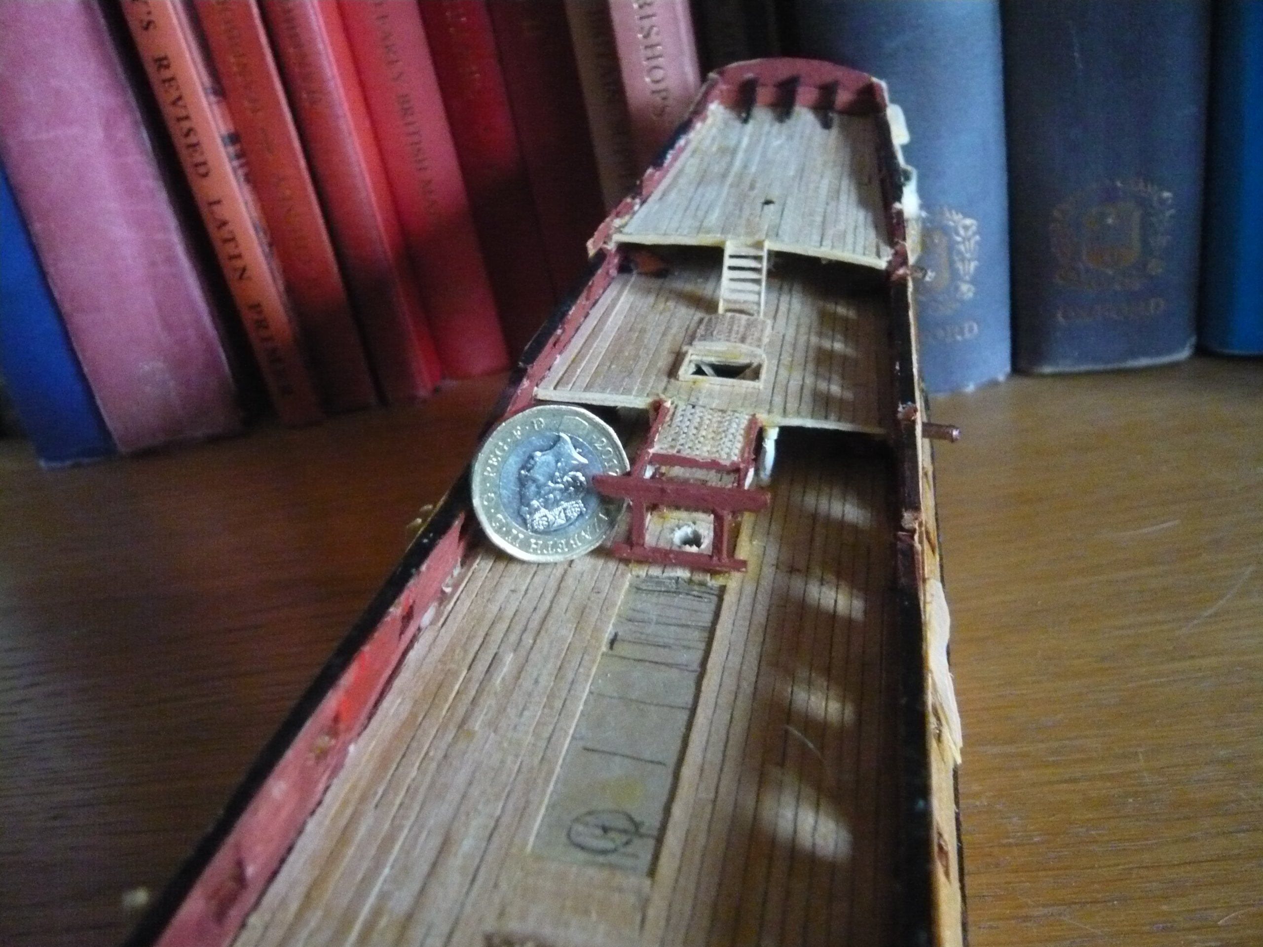

One big issue issue is the gratings, which I’ve not fitted yet. I have seen too many photographs of models where the gratings are just not right. Some have holes which are so big that sailors could put their legs through them. Others are flat, not curved as they should be.  I have looked at ways in which others have made gratings, often using complicated saws and other machines to cut the notches, but I don’t have anything that could do that. Anyway, what I need is gratings with holes roughly 1 mm square, which I guess is a bit small for most machinery.  So, it’s back to familiar techniques for me - old dogs and new tricks? Here’s a photo of a model I made in, I guess, 1959 or so. The grating is flat, which is incorrect, and the holes too large, but the method is what I still use.P1070085-modified.thumb.JPG.d5a3d54226317bbab2214c5d3e521c2d.JPG
Firstly, millimetre square strips need to be cut. Then they are glued onto pieces of a wider strip (I did not have sufficiently thin sheet). Individual notched pieces are cut from this. I tried gluing square strips into the notches, but the results were awful. The problem was that it’s so hard to cut the notched cross pieces just 1 mm thin.  So, after unsuccessful experiments, I went back to what I have always done, and stuck each strip to the next. The problem is to make sure that everything is properly aligned. It means that the grain of the crosspieces is wrong, but at this scale that hardly matters. it’s possible to bend the grating slightly, to give it the requisite curve. It’s not ideal, but it’s the best I can do. Sorry - some of the writing is missing from the photo, but I hope it's clear enough.
Here's the best effort so far

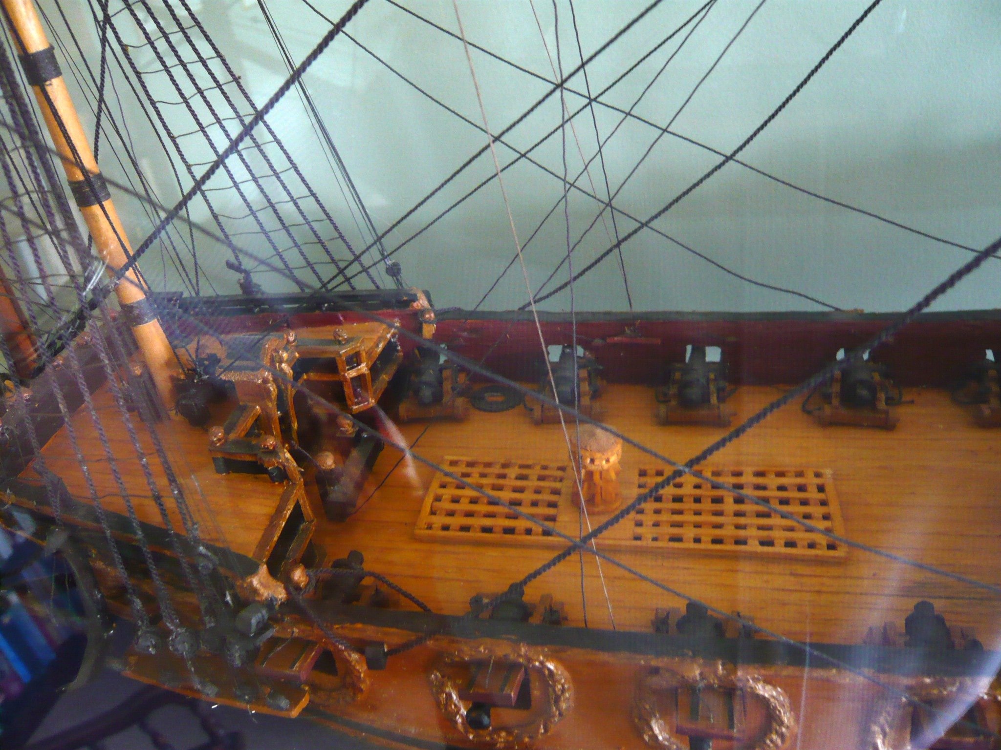

One problem is that there is no deck plan for Centurion, nor have I found a photograph of the model in the National Maritime Museum that shows how the gratings were arranged. There is, however, a useful photo taken from above of a modern model of Centurion based on the one in the National Maritime Museum. This sold at auction by Eldreds  in 2020 for an impressive $7,500, for which the lucky bidder did not even get painted decorations or masts, let alone rigging (https://www.eldreds.com/auction-lot/exhibition-standard-admiralty-board-style-model-o_F934F9EBC2), which is useful.  Also there are some later eighteenth century plans on the NMM site, and they are helpful.

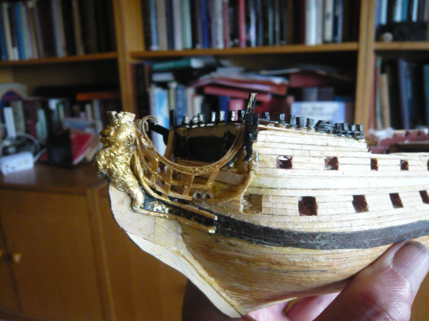

Once again t’s a fair time since I updated this blog - apologies. The bow was a problem, and my initial efforts were a predictable failure. I tried using card, but it just did not look right, even though, unlike  wood, there is no problem in bending it. So I have used stripwood, soaking it in hot tap water (provided the boiler is working, which was a bit of a problem until a new one arrived recently). The bent strips are then glued together to achieve a plausible thickness. As for the figurehead, I have used Milliput, as I can’t carve anything that small. The figure is no more than about an inch in height. One grandson said helpfully that it looks more like a seal than a lion, but I think it will have to do. I’ve gilded it rather than attempting polychrome - it’s not clear how the original would have been finished, but this seems best.  There’s a good deal of tidying up to be done, and photos always seem to bring out the faults, but I hope this gives some impression of progress on the this part of the model. Meanwhile I’ve also been working on the stern, which is taking ages. Incidentally, I have belatedly found an excellent video of the model in the National Maritime Museum at https://www.youtube.com/watch?v=RAM-K193fYk. As well as the ship, it features ‘relaxing classical music’. I’m not clear who made it, but it’s not the work of the museum.P1070121.thumb.JPG.3e4af9779d395543e0d2211402f1923e.JPG

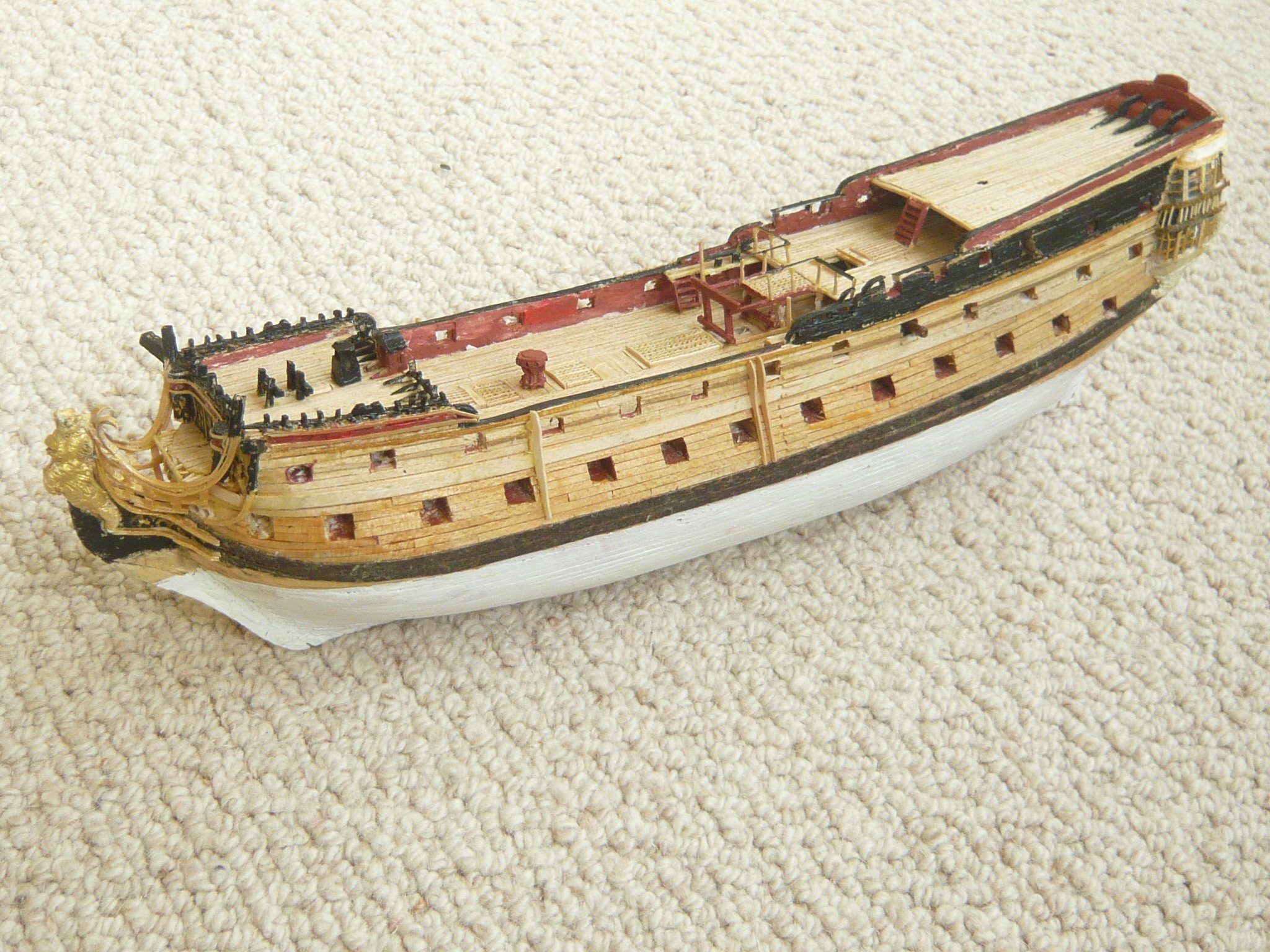

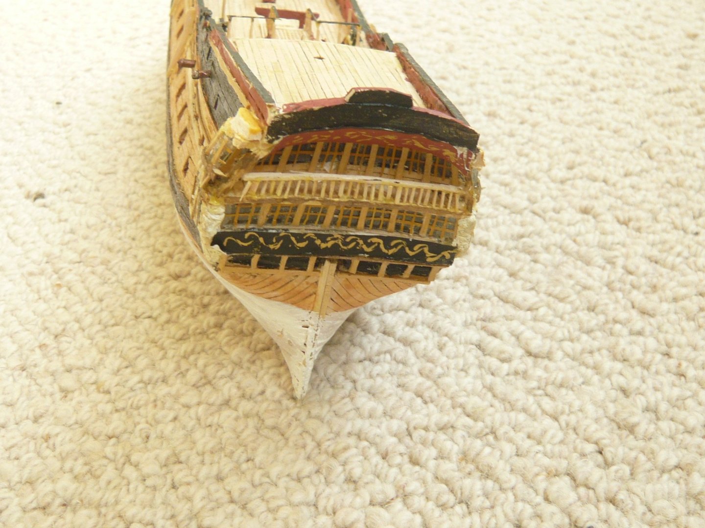

You must all have thought I’d given up on this model. Far from it, but progress has been slow. This is really just a follow-up on the last post. The bow looks better now, though there will be more to do. It has meant tackling what is for me the most difficult element of the ship - the decoration. There is no way that even if this was to a 1:48 scale I could begin to match the painting of those eighteenth-century model makers. At this size, with the model about a foot long, all I can do is provide some indication of the way the ship may have been painted. I say ‘may have been’ deliberately, for I wonder whether the full-size ship would really have been decorated as beautifully as the model in the National Maritime Museum. Anyway, what I have done is to try to give some impression, nothing more. I’ve found it easiest to do the painting on paper, with the results then glued into place. A brush proved impossible, so I used a pin for the gold. I suspect that it might have been possible to do something more convincing with a computer and colour printer, but that’s beyond me (and I don’t have a colour printer). It all looks a good deal more rough in the photo than I think it does in reality, but I’ll do my best to clear up the bits that look problematic. Work also proceeds on the stern, but goodness, it's complicated, and certainly not ready to be photographed. P1070136.thumb.JPG.0ca870e212b7b294b84fdc9a668e8810.JPG
