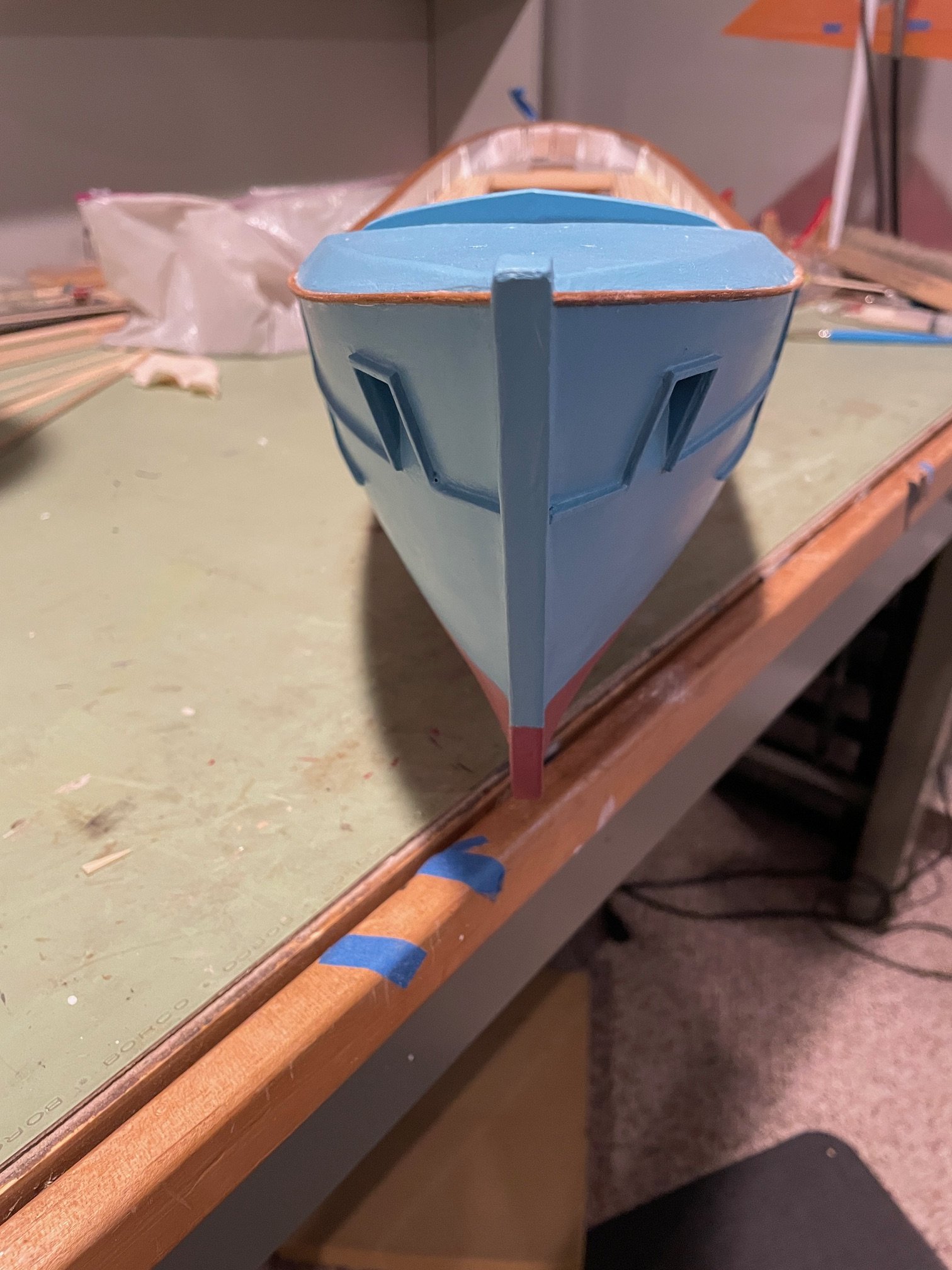

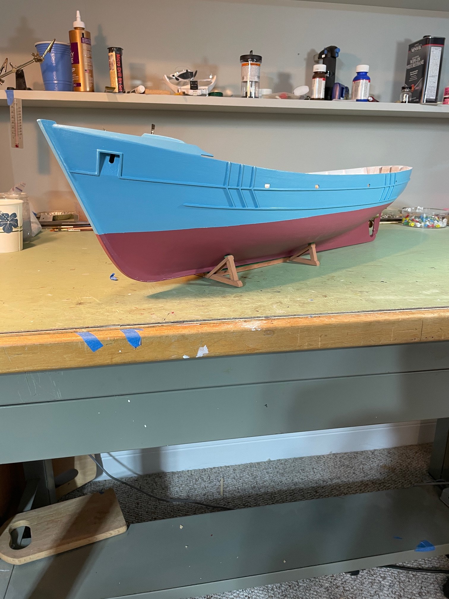

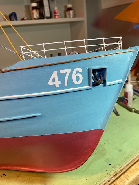

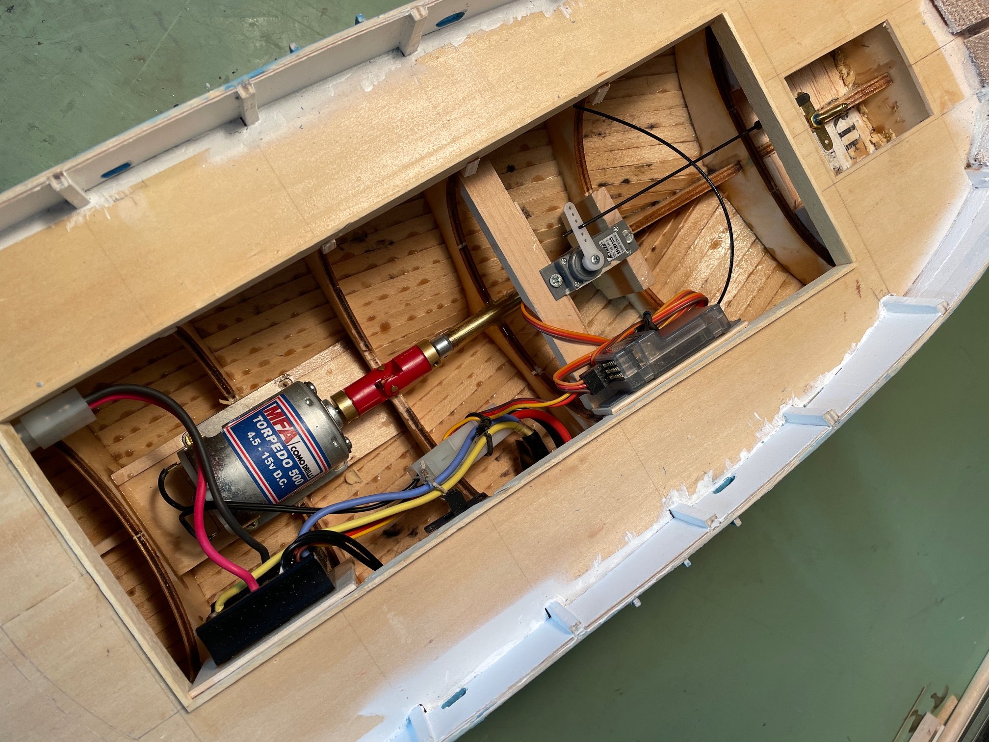

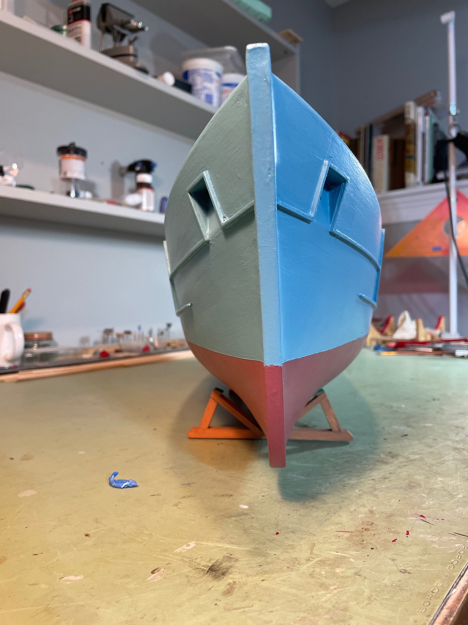

I finished painting the hull, applying the blue paint above the waterline.
Once the paint had dried, I proceeded to install all the electronics along with the propeller.  The only thing I'm still unsure about is what to do with the antenna and how to support it.

Nordkap's looking wonderful. The paint looks just right to me.

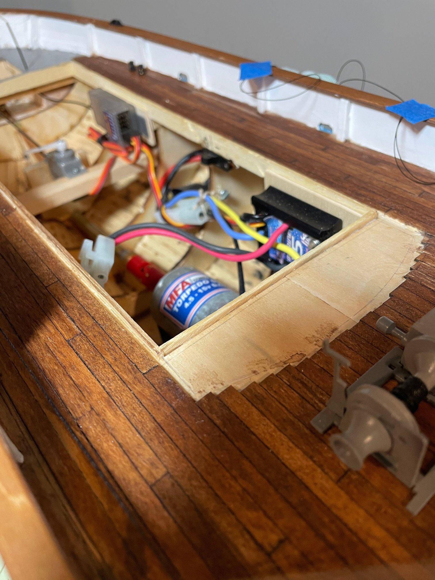

I think the idea with the antenna is to keep it above the waterline, and away from things that are electronically noisy (I.e. the motor)... Since the boat is not carbon fibre it shouldn't make a Faraday cage, so you should be okay having the antenna inside the model, and unless you have to I would advise not changing the antenna wire unless  you have to. I believe they are matched by length to the frequency.
I have always just had the receiver in a tray up towards the deck away from the motor and rudder servo. Having said that I have more experience with 27Mhz and 40MHz... my tests with 2.4GHz seem okay though.
A distance test is always a good idea... plug everything in, connect transmitter to receiver, and then get someone to watch the bost while you walk away from it using the transmitter. See how far you get before it stops responding. It'll give you some idea what to expect on the water.
Also, doing a first sail (or indeed sailing in general) somewhere where you can wade out and retrieve the model is a great comfort.
Hope that's helpful, and apologies if I'm repeating things you already know.
Rob
Thanks for the advice, Rob — and no need to apologize. I can use all the help I can get when it comes to electronics! As for changing out the antenna, that's definitely way above my pay grade.
So, you think I can keep the antenna inside the cabin? I was under the impression I needed to run it up through the cabin roof and keep it vertical, kind of like a car radio antenna (not that cars really have those anymore).
Good advice, I will definitely do that before putting it in the water.
When I (briefly) sailed a One Metre class yacht, the 2.4GHz receiver was just sat in a plastic pot along with the battery just beneath the deck, and it worked fine. That was a fibreglass hull and deck (albeit with patches). The orientation shouldn't make any difference unless you're pushing the signal to its limits, as I guess it changes relatively anyway as you move the transmitter around, and as the boat sails in different directions.
The one article I found about this (again from a radio sailing perspective) talks about having problems at a distance of 180 metres because of a carbon fibre hull and rain reducing the signal strength.... so that gives you some idea of the capabilities of modern radio control transmitters and receivers. (Here, if you want to go down the rabbit hole...  https://www.onemetre.net/Build/2.4GHz/24GHz.htm )

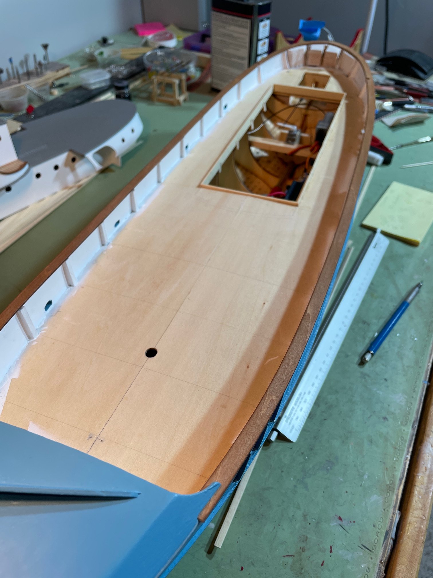

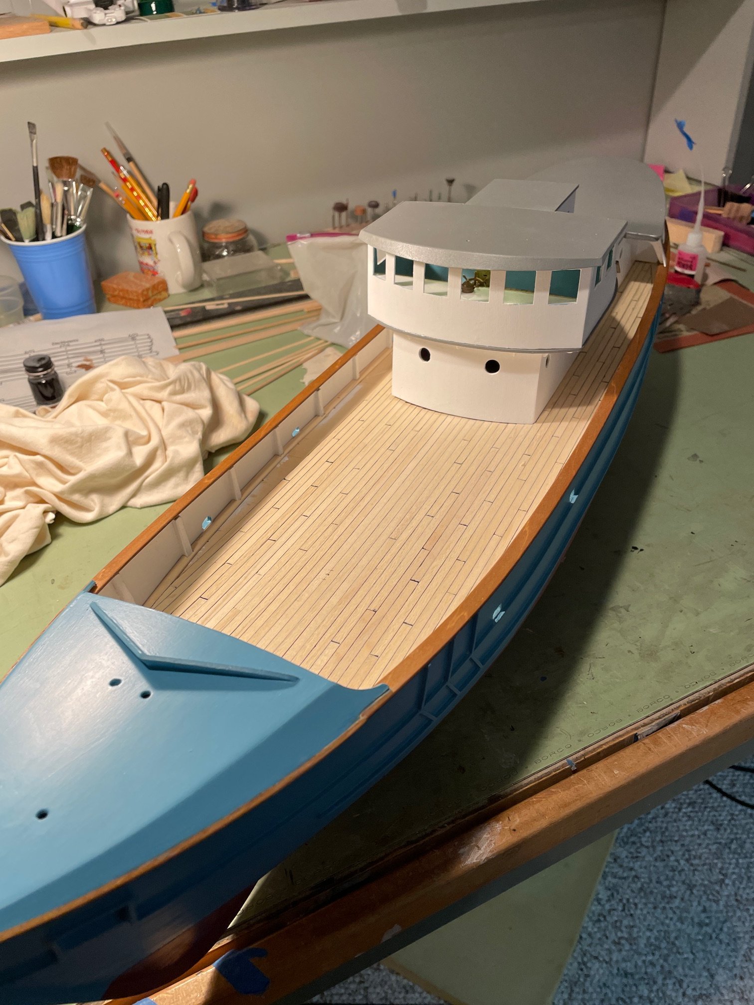

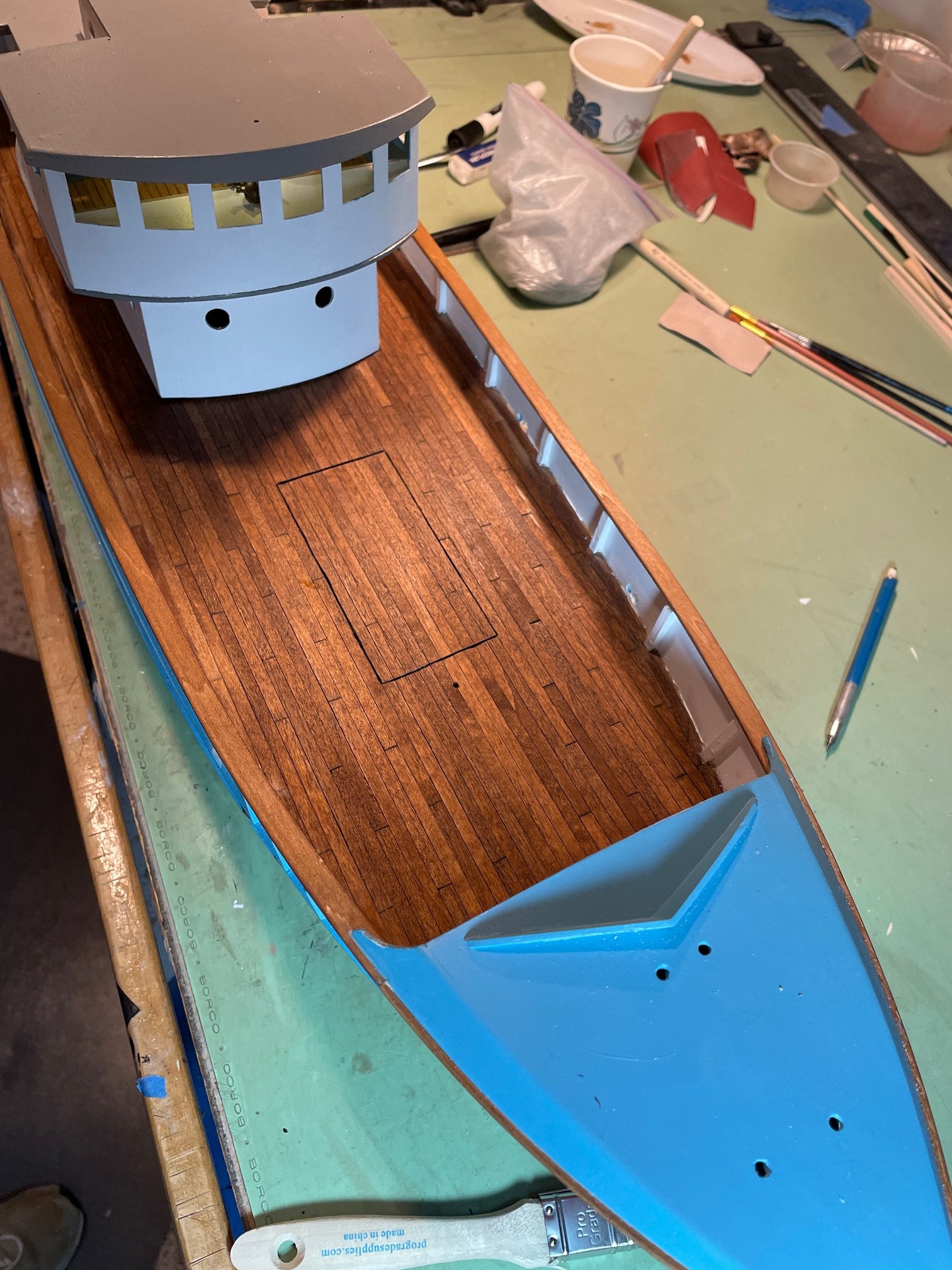

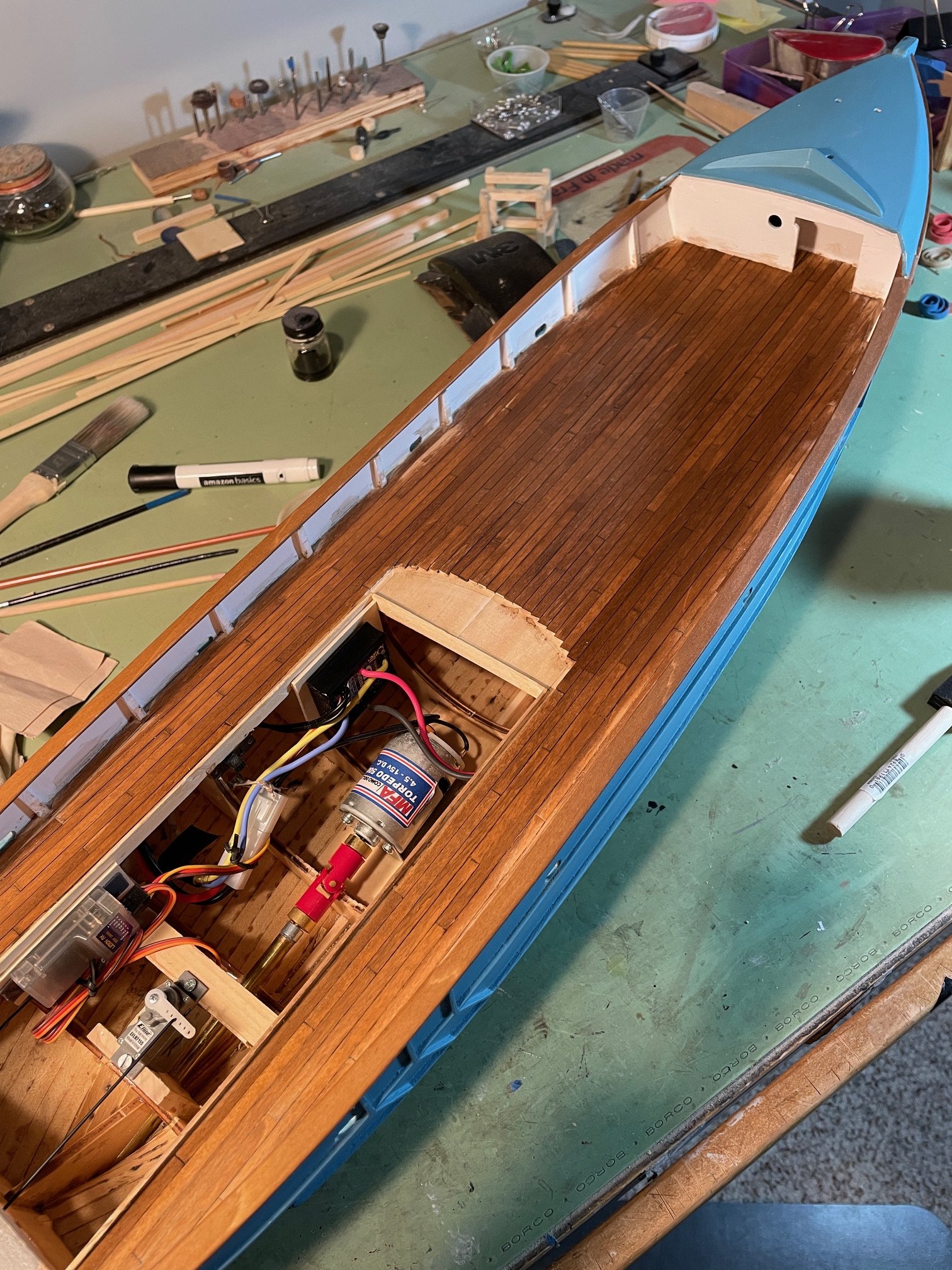

Cap Rail and Main Deck Planking

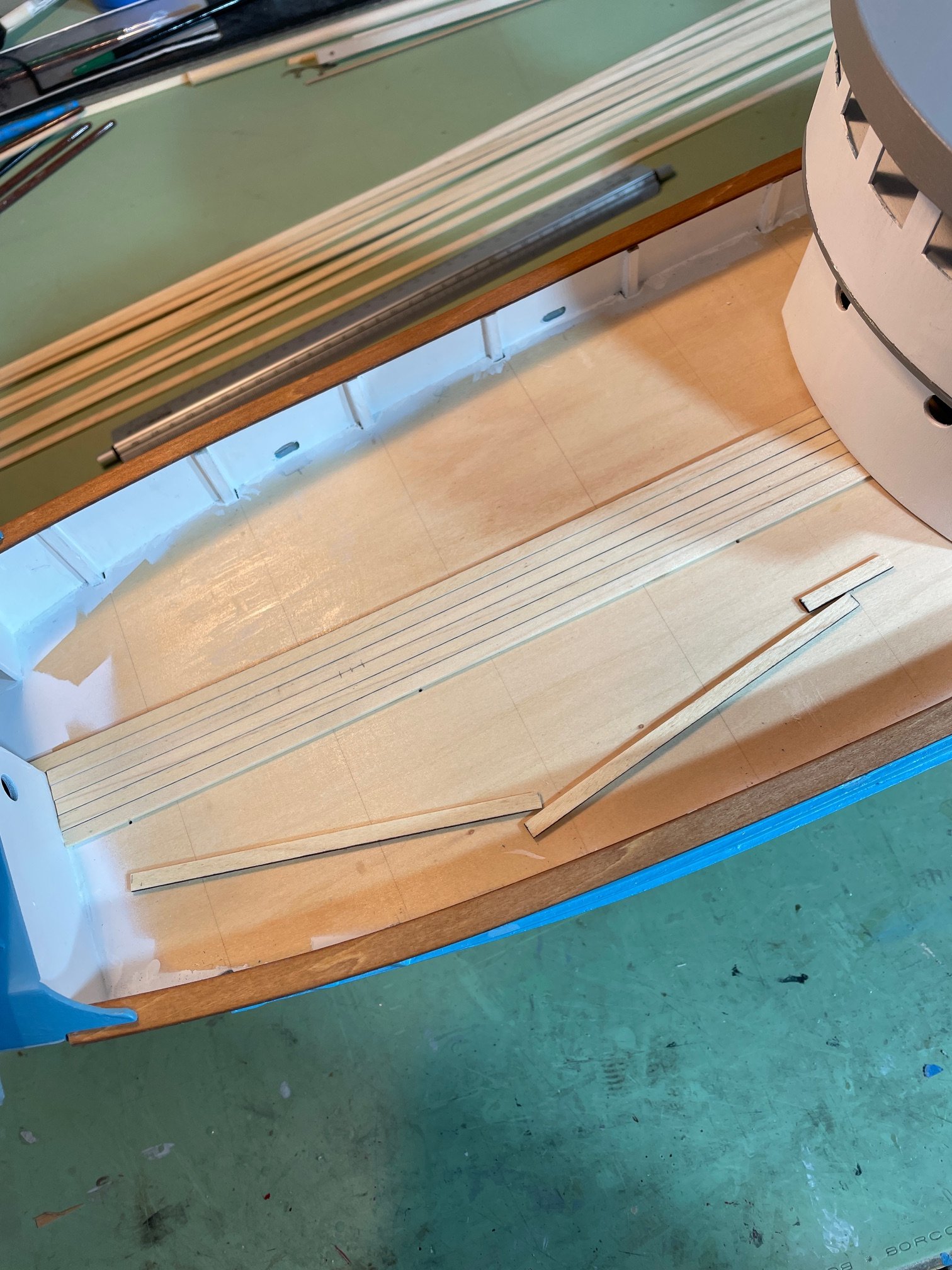

With the hull painting completed, it was time to move on to the main deck. The first step was installing the cap rail above the bulwarks. Before gluing the rails in place, I sanded the edges to round them off. Then I stained them, and once dry, applied three coats of wipe-on polyurethane.
 For the deck planking, I used leftover material from a previous build. Since the deck features three hatches and a winch along the centerline, I decided to install the first six planks—three on each side of the centerline—as single, full-length pieces running from the cabin to the bow structure. The remainder of the deck was planked using a three-butt shift layout.

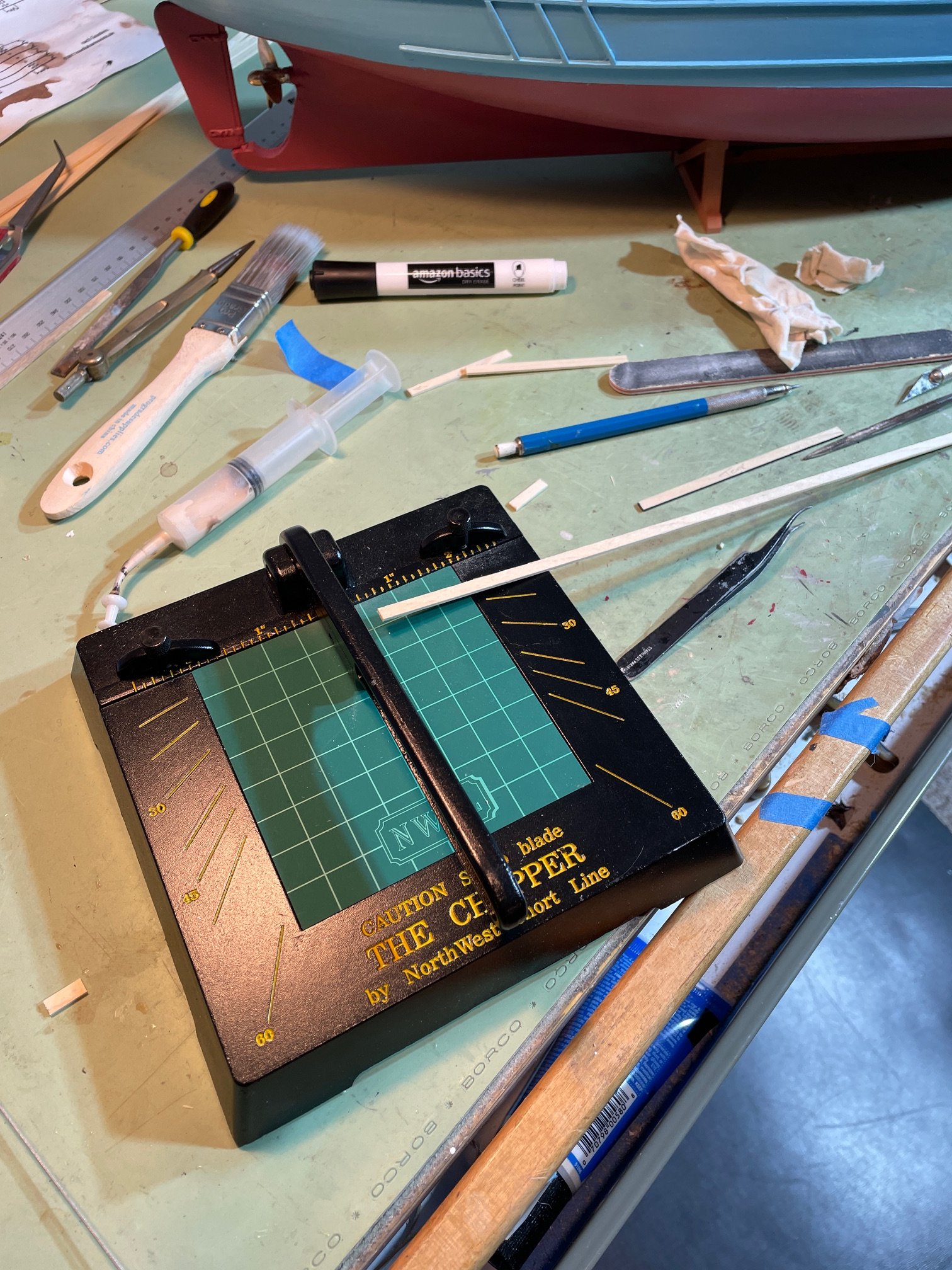

To make the job easier, I treated myself to a razor cutter. Honestly, I should have bought one ten years ago—it made a huge difference when cutting all those planks.
Deck Completed.
I also installed the bow trim pieces at this time.
I was slightly disappointed by how dark the stained deck turned out. I had tested a strip beforehand, which looked considerably lighter. Still, I do like how the darker tone complements the blue of the hull, so I can live with it. After the stain dried, I applied three coats of wipe-on poly to the finished deck.

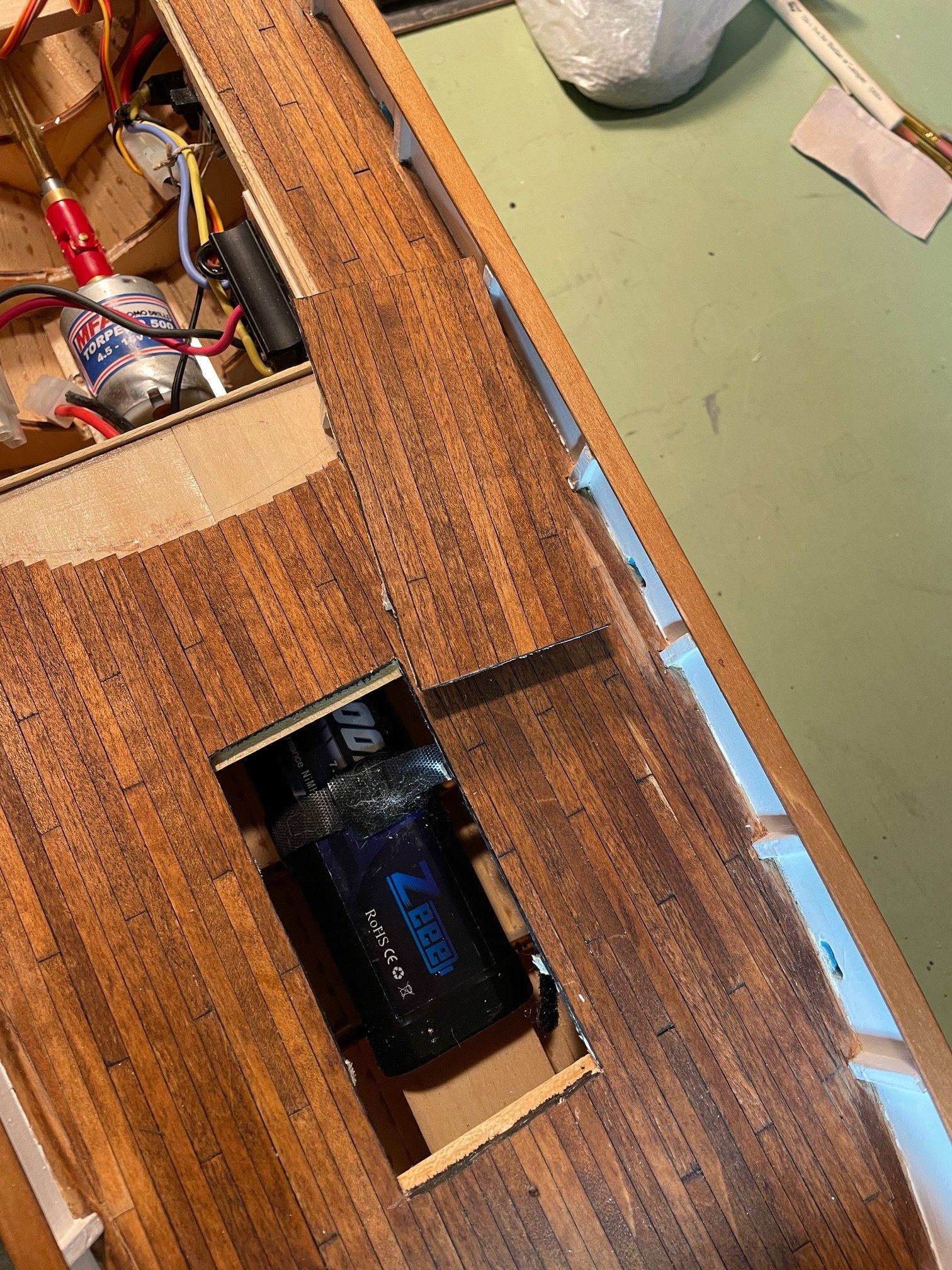

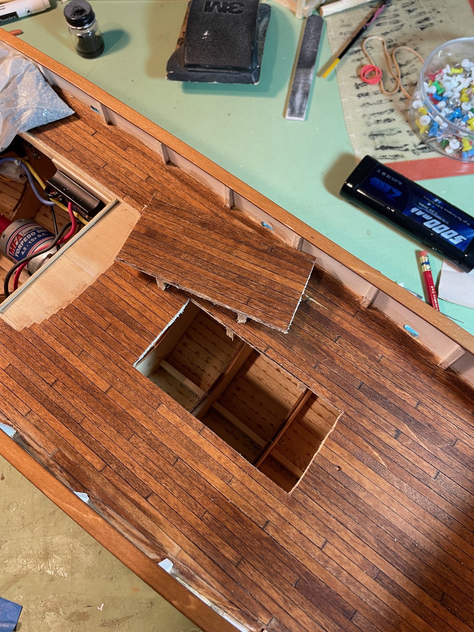

Battery Access Hatch
 The next step was a bit nerve-racking. I needed a way to install and remove the battery, so I decided to cut an access hatch into the deck. Using an X-Acto knife, I carefully cut through the deck in the area where the two deck hatches will go. I also used an X-Acto saw to cut through the bulkhead frames.
Battery Installed.
Hatch in Place.
Thanks for looking in and for the likes.

The deck looks great
Thanks, Alan. Like I mentioned, I was a little disappointed at first with how dark the deck turned out—but it’s definitely growing on me. I think using lighter colors for all the attachments will help balance it out.

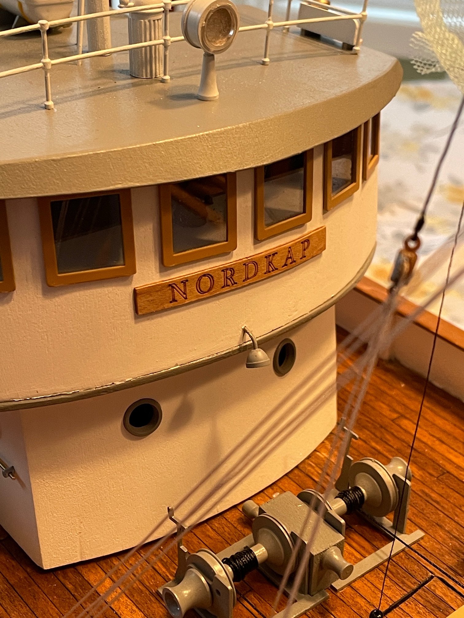

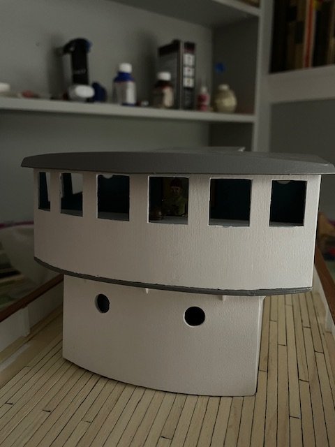

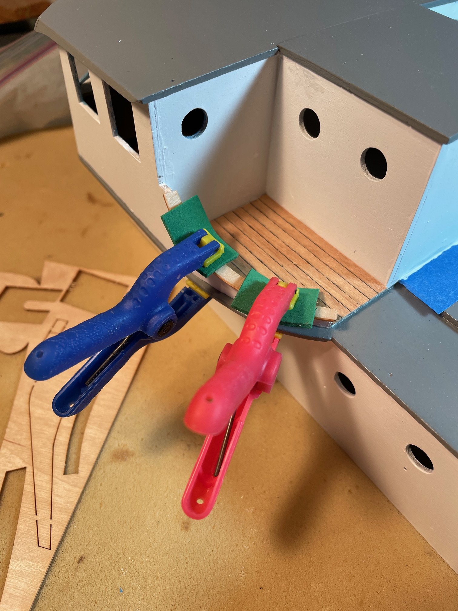

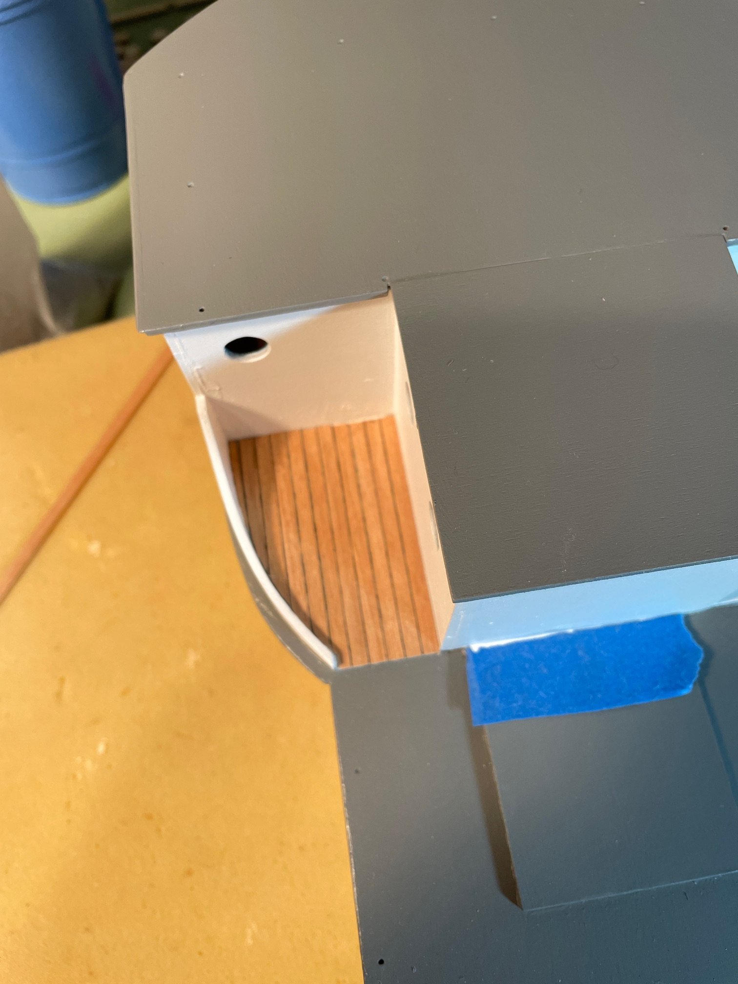

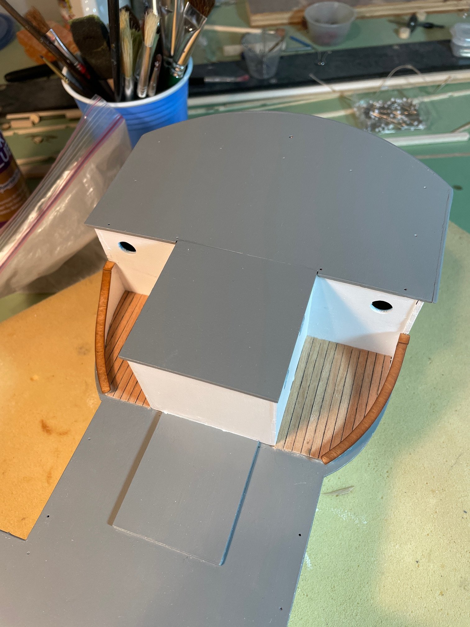

Now that the hull is nearly complete, I decided to begin work on the upper cabin. I started by installing the exterior deck planking using the kit-supplied material.
Next, I added the cap railing and applied a stain. Once everything had dried, I finished the rail and deck off with three coats of wipe-on polyurethane.

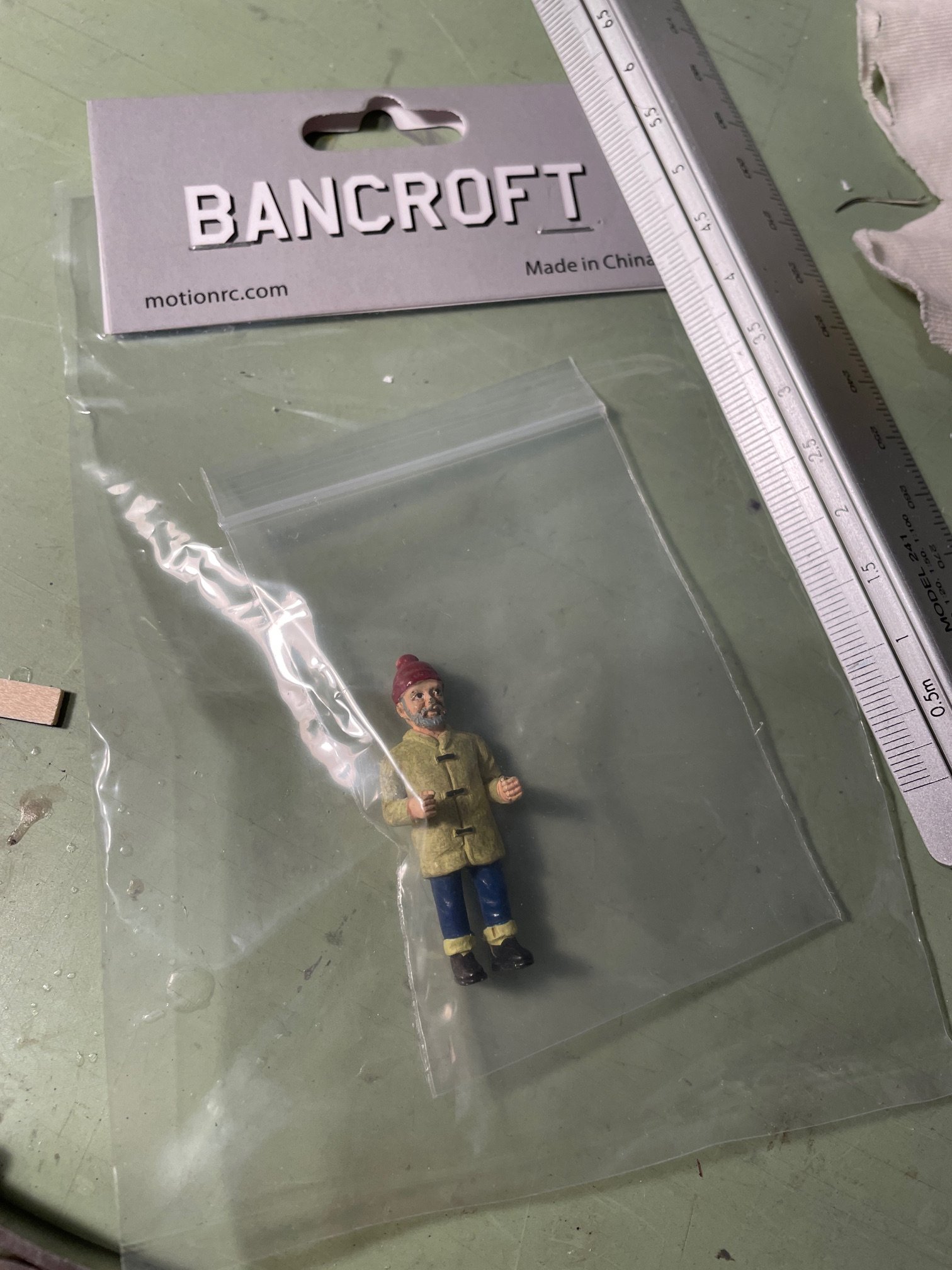

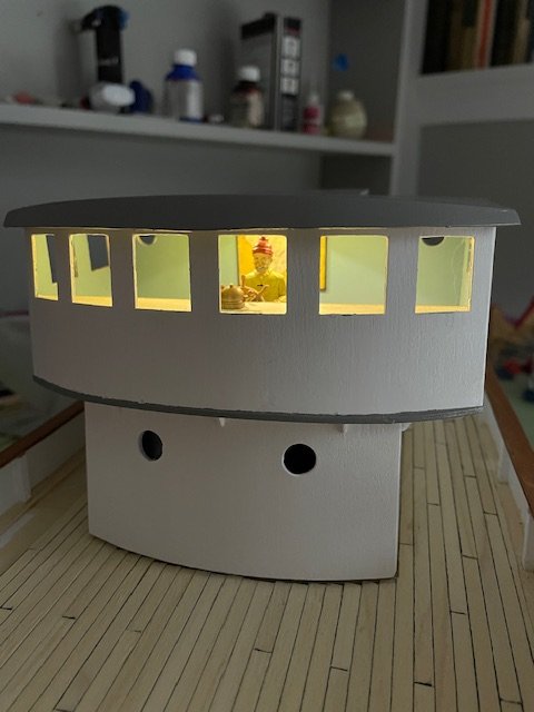

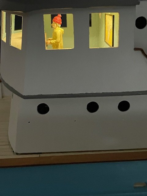

Next I decided that since this ship will be operational, it needed a captain at the helm. I found one I liked from Motion RC — the Bancroft 1/50 Scale Civilian Mariner figure.

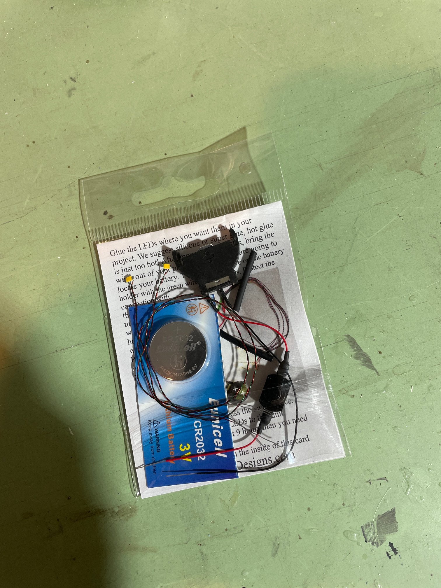

After placing him at the wheel, it quickly became clear that a little lighting was in order.
I picked up a Chip Light Kit from Evans Designs and installed the mini LEDs
— and now, we have light!
That said, I really need to plan a little better next time. I had already installed the cabin roof, so I ended up having to fit both the captain and the lights through the cabin windows — not exactly ideal, but it worked!

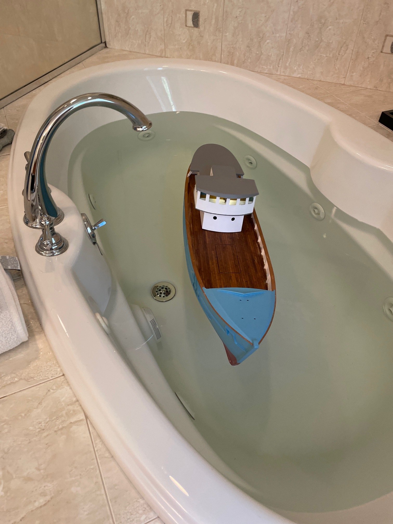

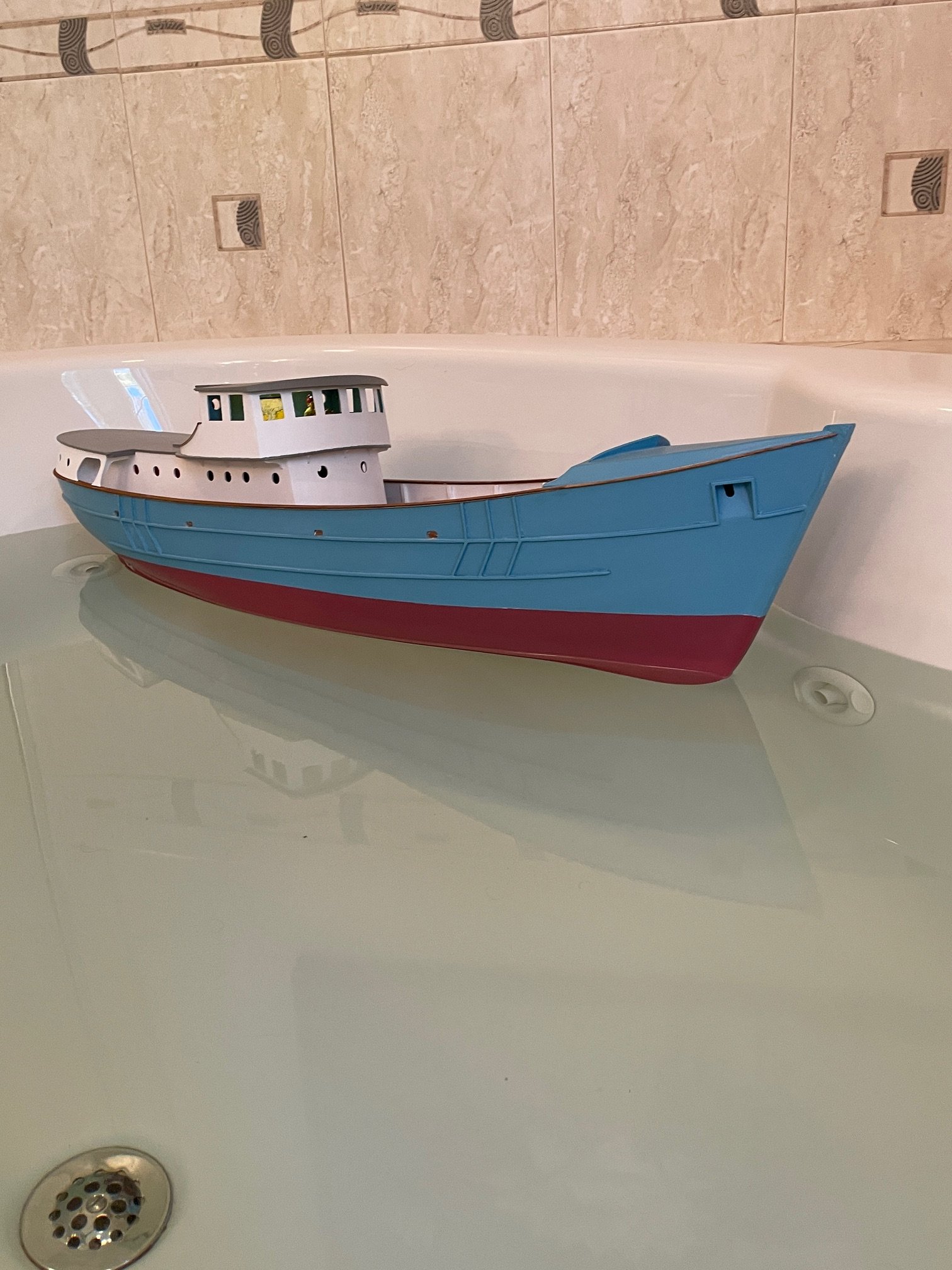

Float Test
With all the electronics installed, I thought it would be a good time to give the ship another float test.
As you can see, there’s a slight list to the port side, and the bow sits a bit high. To correct this, I plan to use lead shot salvaged from an old diving weight belt as adjustable ballast.  After draining the tub, I realized that the list may have been influenced by the battery placement, as it’s relatively heavy and it might have been positioned off-center. I’ll verify this next time by temporarily relocating the battery to confirm whether it’s the primary cause of the imbalance.  Oh, and still no leaks.

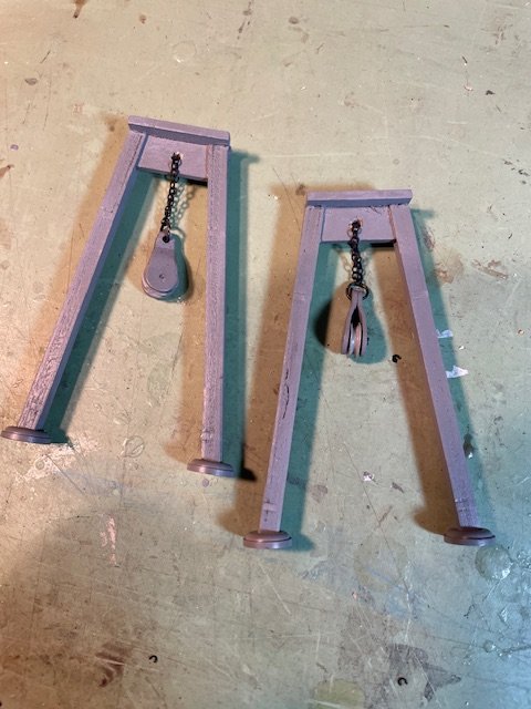

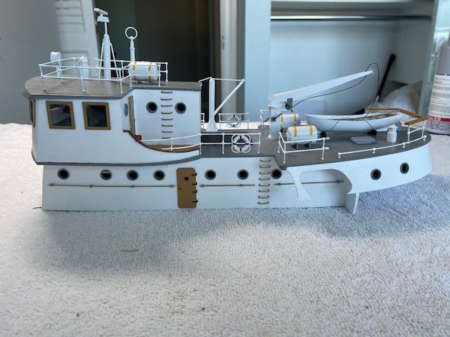

I decided to change things up a bit and start working on the miscellaneous deck items. Once I figured out which pieces to use, assembly was pretty straightforward.
Deck Crane
That came together nicely.
Antenna (I think?)
I’m assuming this is some kind of antenna. I added a small post to the bottom of the brass top to attach it more securely to the wooden dowel.
Radar Tower
That went together smoothly as well.
Painting Details
I also painted the door and window frames.

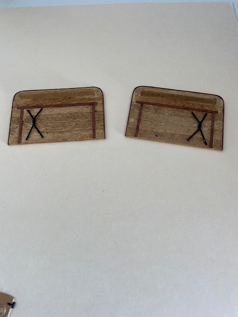

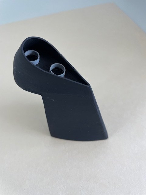

Then I came to this piece.
I put it together, but for the life of me I can’t figure out what it is or what it’s supposed to be used for. I’ve checked other builds and searched various trawler websites, but I haven’t been able to identify it.  Anyone have any ideas?
Thanks again for the likes.

Thanks to a new member of MSW, buntzi, I was informed through an email that the items pictured below are trawl doors. Their function is to keep the mouth of the net open as it is dragged along the bottom. Thank you, buntzi.

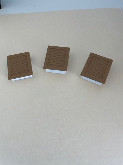

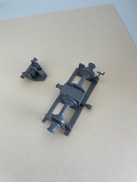

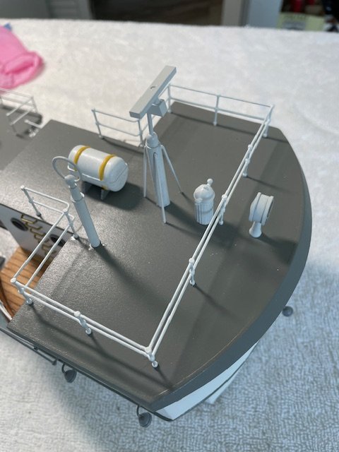

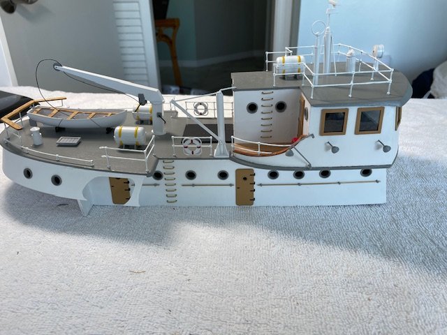

Continuing with the miscellaneous deck items:
Assembled and painted the windlasses
Smokestack
Deck hatches
Two deck cranes
Next, I began populating the superstructure with the assembled components:
Superstructure upper deck
Superstructure lower deck

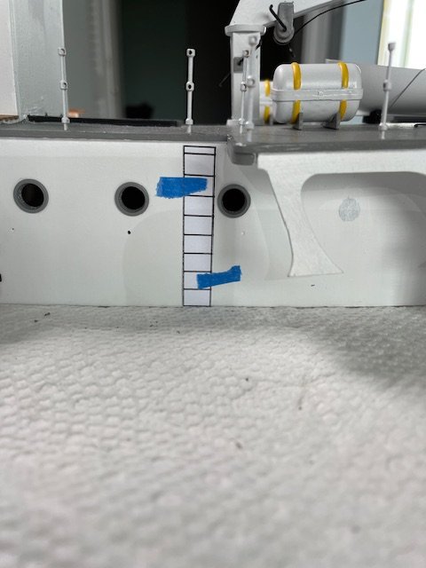

For the ladder rungs located on the sides, I drew up a template so I could accurately locate the holes for each rung.
I also installed the handrails and lighting fixtures.
Just a note: I had to order more 1 mm diameter brass rods for the handrailings because the kit didn’t include enough. Ordered it from Amazon.

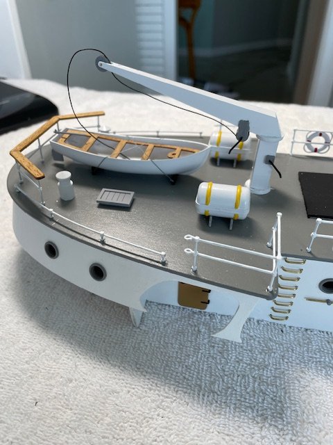

I was a little slow posting this update because I’m just getting over my first case of COVID. It took five years to finally catch it, and when I did, it did a pretty good job on me—but I’m all better now.

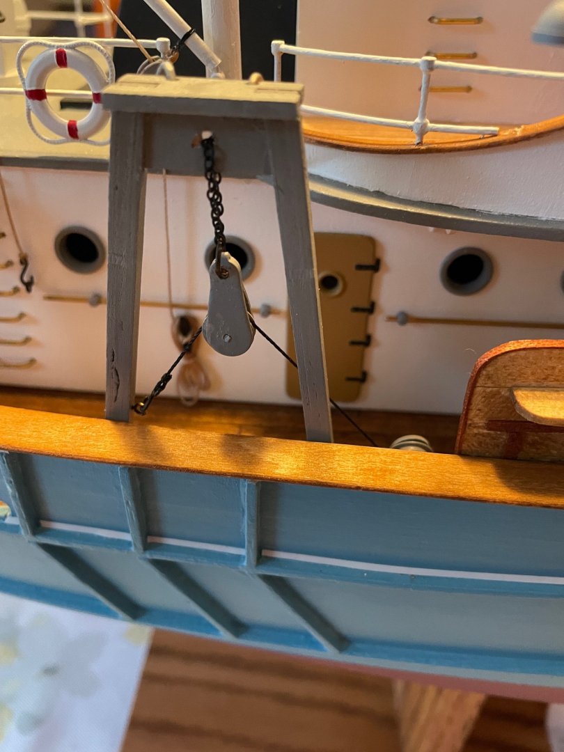

I started at the bow, installing the handrail and windlass. To accurately locate the handrail posts, I made a photocopy of the bow section from the plans and taped it in place as a guide. I used a compass point to mark all the locations.  I also marked the bollard locations on the deck.
Next, I installed the ladder, deck hatches, and the larger windlass on the main deck.  The two higher hatches are mounted on the removable deck portion to access the battery.
After that, I jumped over to the hull pin striping. I had some 1/16” white pinstripe tape left over from another project, and it worked out very nicely.

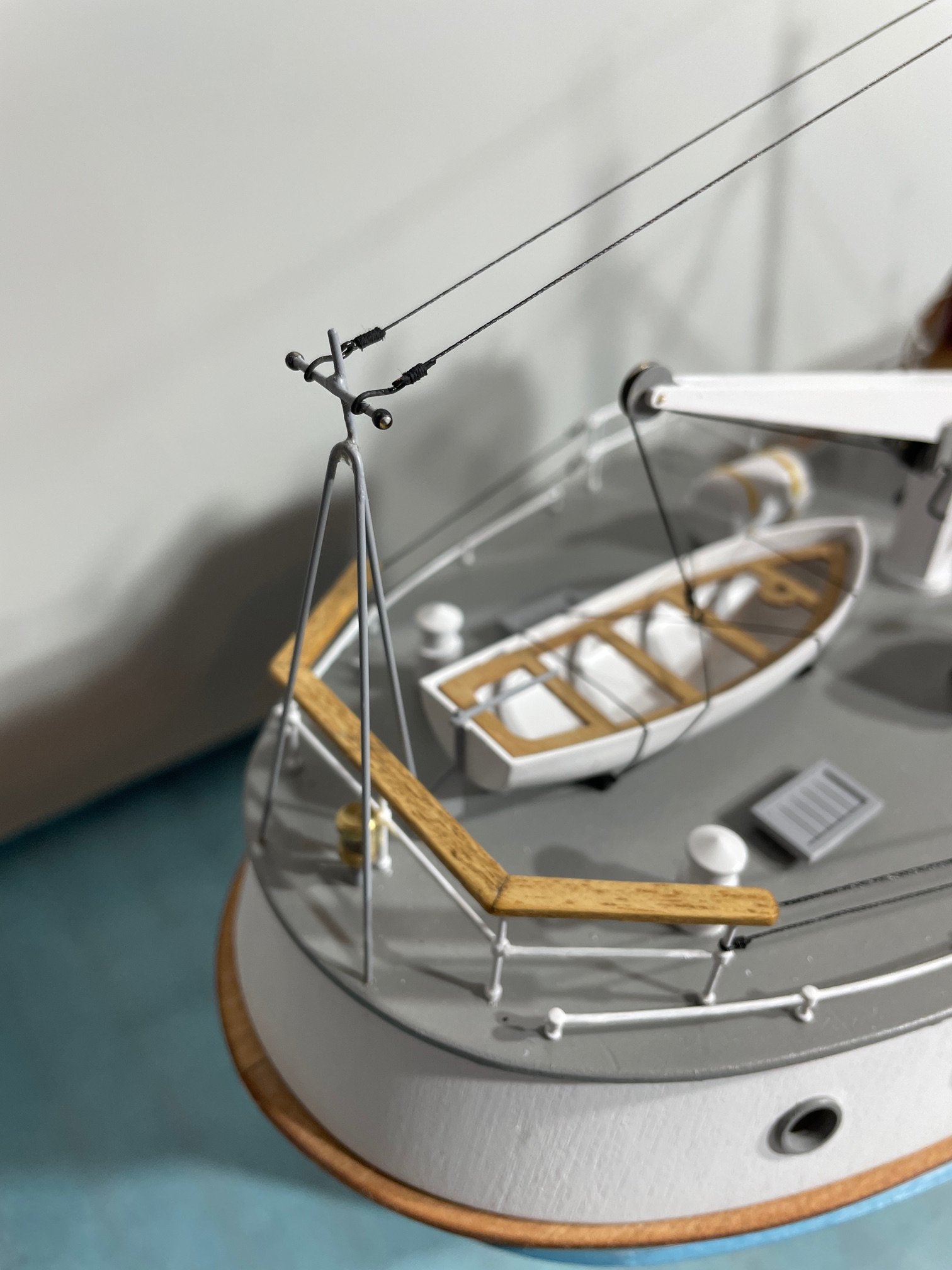

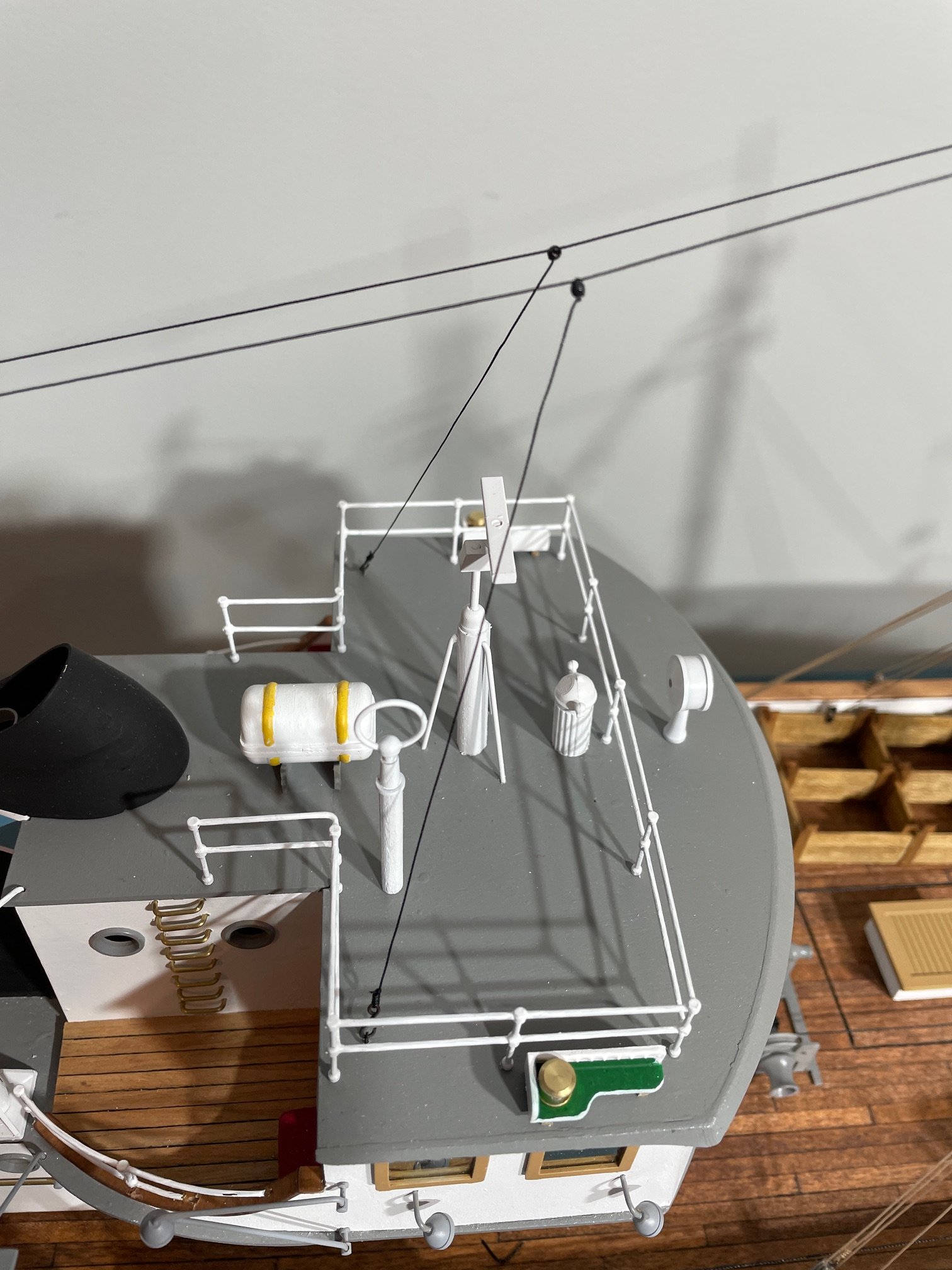

Then it was back to the superstructure. I installed the rear antenna support and the cable handrail, finished painting the stack and the anchors, and added pins to the anchors to help secure them to the hull.

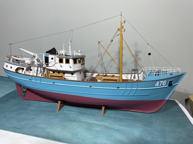

Stepping the Mast:
The mast and boom were pre-assembled with all their attachments and painted before being installed on the ship.
My standard method for stepping the mast involves using a 45-degree right triangle. I use the triangle to help ensure the mast is plumb athwartships. First, I scribe a line in the plastic triangle, bisecting the 90-degree angle and making it perpendicular to the hypotenuse. Then, I measure the overall distance athwartships from the outboard edges of each cap rail, where the triangle will be placed. Dividing this distance in half, I mark the same measurement on either side of the scribed line along the hypotenuse of the triangle.
Next, I position the triangle upright against the mast, ensuring that the two marks line up with the edges of the cap rail. With the apex of the bisected 90-degree angle centered on the ship, it will be perfectly perpendicular to the deck. The position of the mast fore and aft sometimes needs to be braced into position, this mast I did not have to do that.  I use white glue for this step, as it allows me time to adjust the mast into its final position.
The main advantage of this method is that it doesn't require the ship to be perfectly leveled. As long as the ship has a reasonable degree of symmetry, and the triangle is correctly positioned across the cap rails, the apex of the triangle will always be centered on the ship and 90 degrees to the deck.
While I’m not certain whether these types of masts would traditionally have a mast coat, I did apply one to provide additional support for the mast.
Mast and Boom Installation:

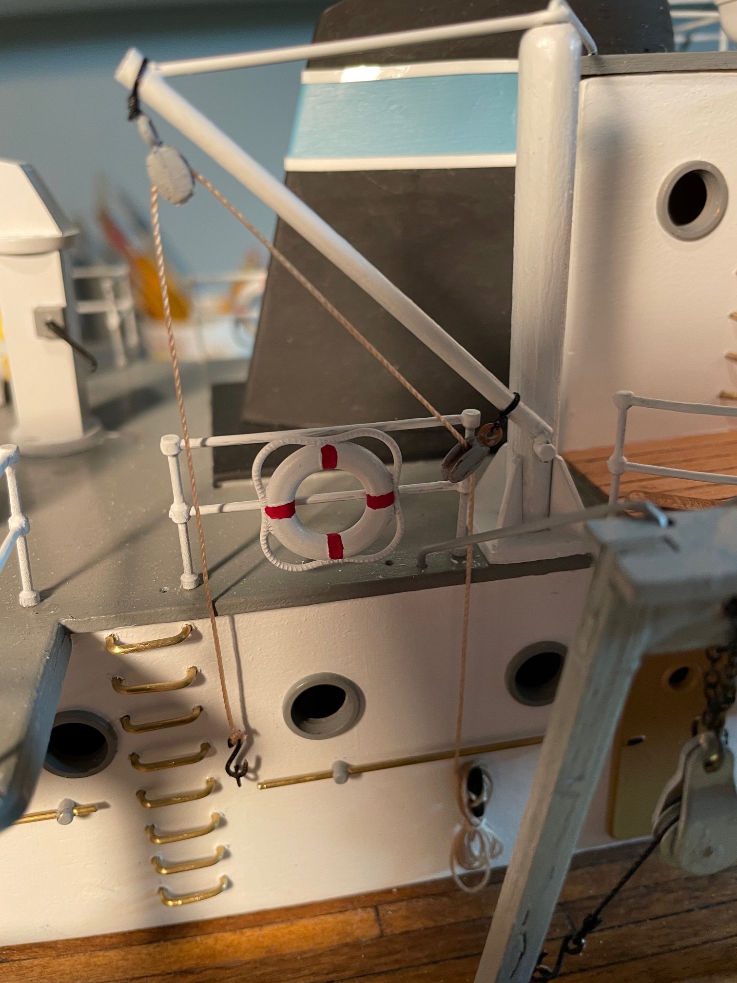

With the mast and boom in place, I moved on to rigging the block and tackles.
This part was fairly straightforward, though I did make one mistake: I should have waited to glue the fish storage bin in place until after completing the rigging.
First, the wire bracing for both the mast and the forward deck crane were then installed.
Next, the rigging for the boom
Then the mast rigging

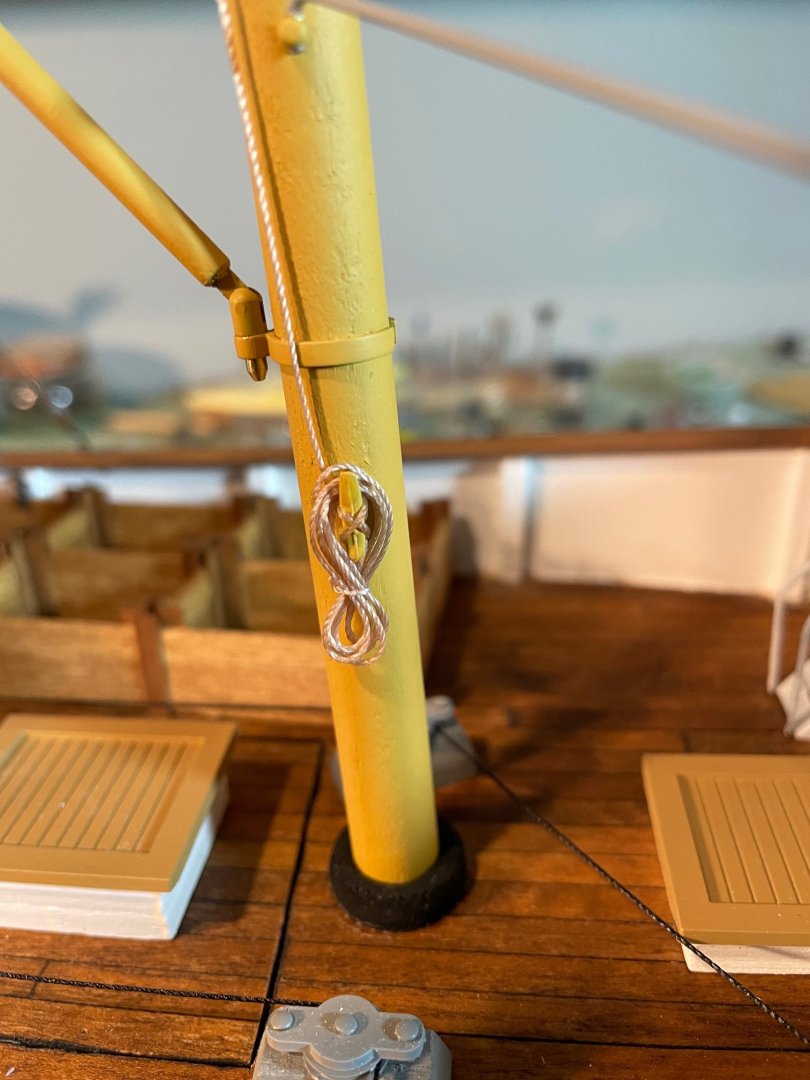

Additionally, I added the wire bracing for the aft deck crane. Since this bracing runs from the crane to the superstructure (which must be removed in order to install the battery and turn the motor on), I didn’t glue this bracing in place. This will allow me to remove it easily when needed.

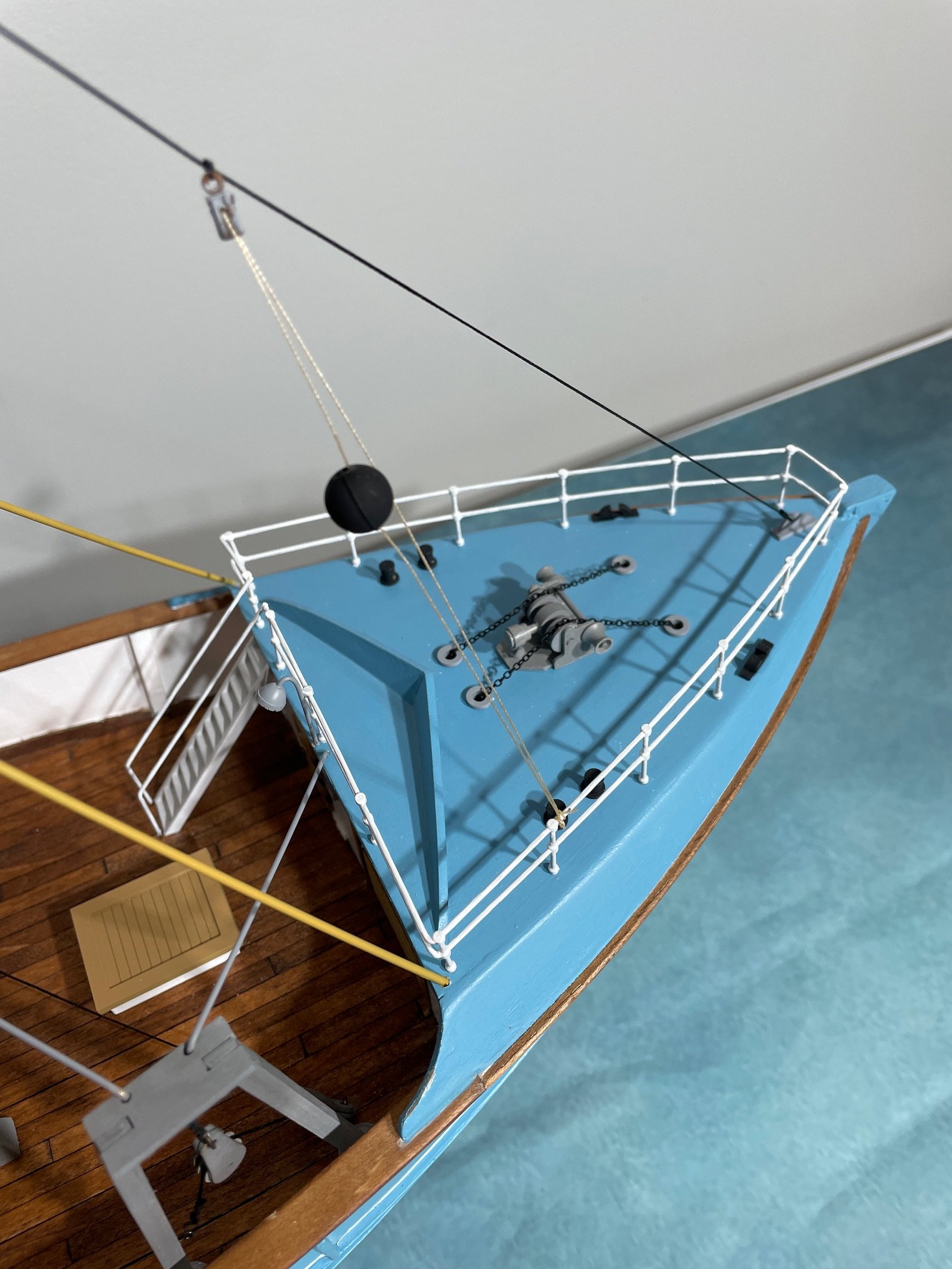

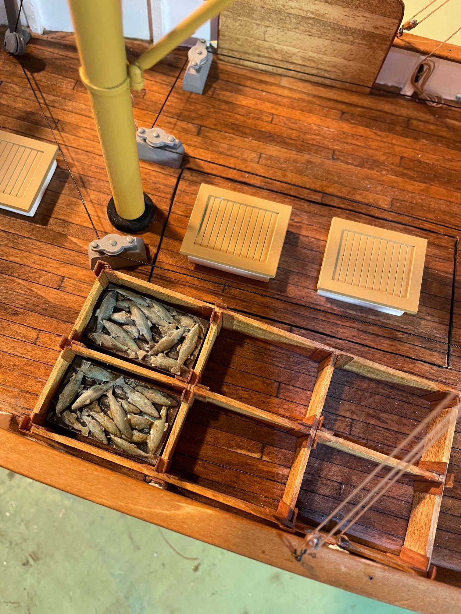

Getting close to the end now, just  a few more odds and ends to complete.  Then I think another water test is called for.  Thanks for looking and for the likes.

Very late to this party........beautiful model, should look great on the water!
My only comment is that it is useful to have a "coaming" around the inner edges of the walls of a removable cabin i.e.close-fitting strips of wood extending up a ways from deck level to keep any water that reaches the cabin walls from dripping down into the electric innards.
Did you try the motor/speed controller in your last water test?
Good work! Welcome to RC.
18 hours ago, king derelict said:
Looking very good. The neat rigging and excellent deck details really make the model stand out.
alan
Thanks, Alan. I forgot to mention in my post that I didn’t use the white rigging thread provided with the kit. Instead, I substituted some rigging I had left over from a previous model—black for the standing rigging and tan for the running rigging.
Thanks for the kind words, Ian. There is an edge plank (coaming) around the perimeter of the opening where the cabin is located. It’s not very high (about 1/8"). I could probably add an extension to make it a little higher if you think it should be.  You made me think however about the battery hatch I cut into the main deck. I'll need to come up with something to waterproof it.

Thank you for your input. I believe I performed that calibration when I first installed all the electronics. The propeller RPM does vary with throttle position, so I think it’s working correctly.
In the tub, since I’m not yet used to the controls, I pushed the throttle a little too far forward and didn’t have much room to work with. I think once I get it into a larger body of water, I’ll be able to get used to them more easily.
The cables running from the deck cranes to the windlass were run along the deck and through the deck pulleys.
Next I installed what might be a forestay running from the masthead down to a gusset plate at the bow.  From this stay, a halyard was rigged down to a handrail post located on the bow deck.  On this halyard I installed a wooden ball that was shown on the plans, though initially I had no idea what it’s called or its purpose. After showing a photo of it to my brother-in-law— an experienced sailor—I learned it’s an anchor signal ball. Further research confirmed that an anchor ball (or "day shape") is a black spherical marker used by vessels to indicate they are at anchor during daylight hours. Learned something new!
Next, what I assume are antenna wires were installed running from the masthead aft to the wire support tower at the stern.
These wires need to be easily removable so the cabin could be lifted off the model. To achieve this, I incorporated small hooks at the ends of the lines that attach to the wire support tower at the stern, allowing for simple detachment and reattachment.
I also attached small hooks to the wires that run from the antenna wires down to the cabin roof deck for easy removal and reattachment.
The ship’s number decals were added,
The plastic fish were painted and placed into the fish storage bins. (they don't look to fresh 🫢)
I also added several rope coils
Nameplate installed
Overall to date.
Sal
