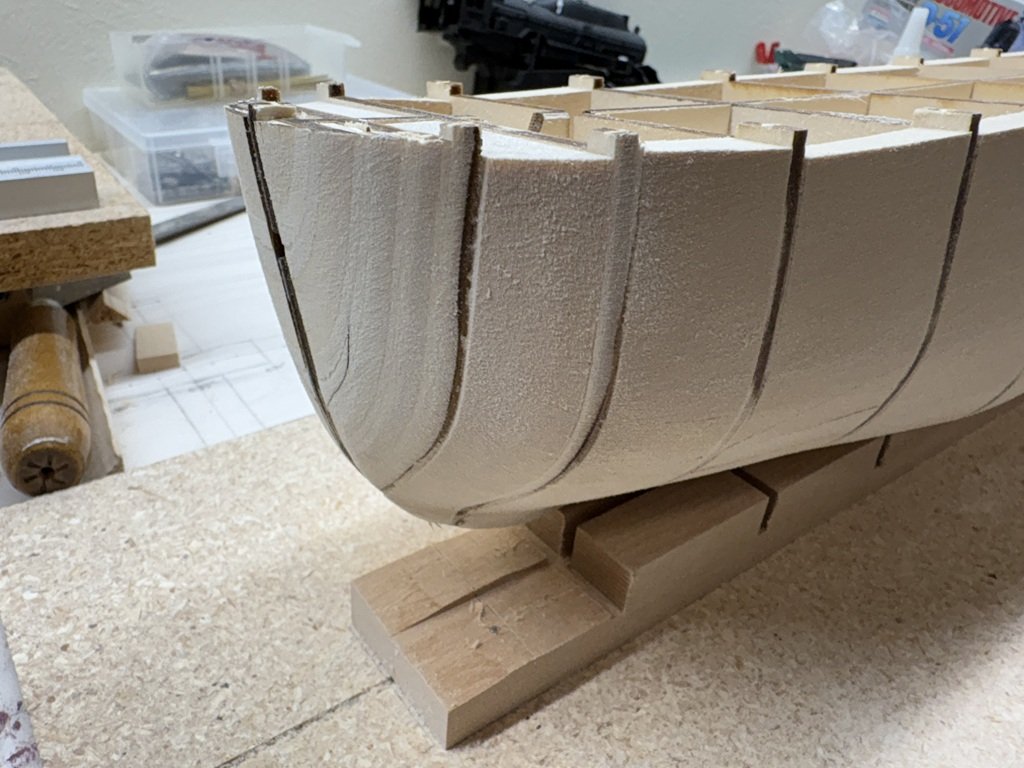

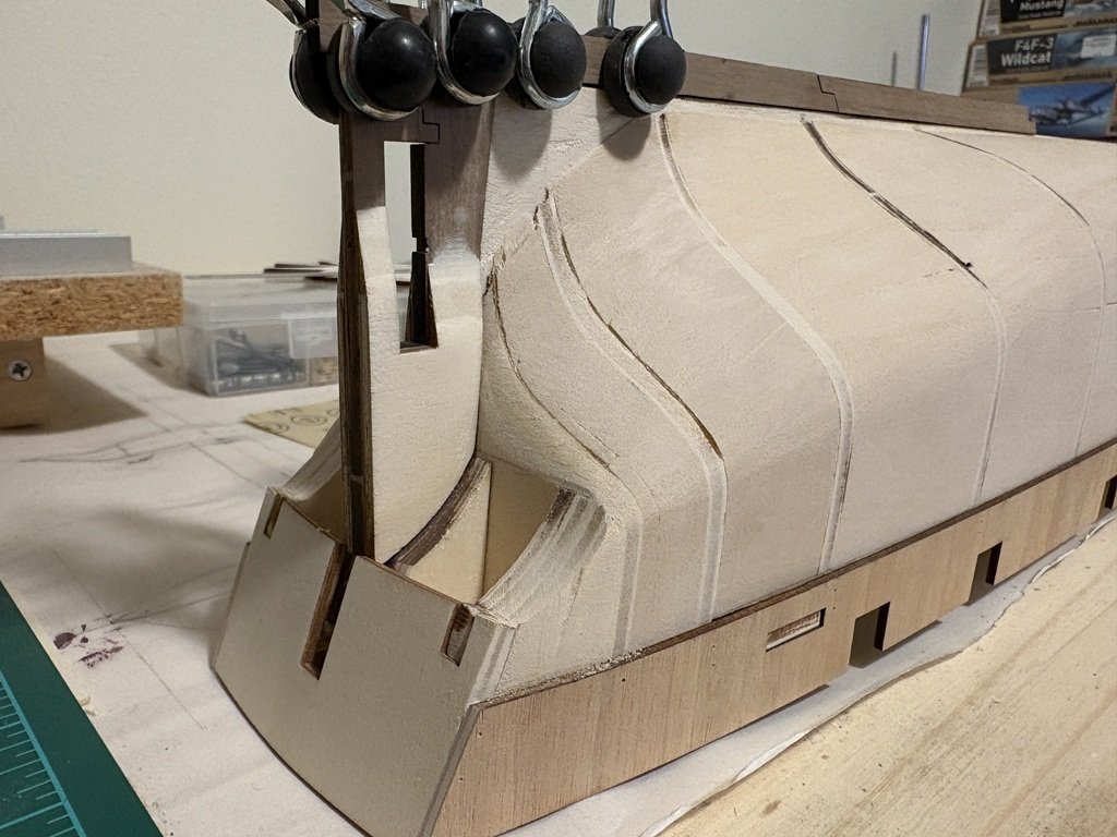

I decided to add the bow filler blocks so that I could make a nicer transition from the sides to front of the hull. In particular, I don't think I could have come close to forming the concave dip that forms on the first bulkhead. Of course this means I've taken the tack that requires this buff bow to be planked!

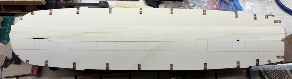

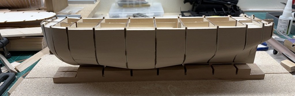

More shaping, especially on the port side, and now very close to the profile dictated by the kit's bulkheads as I'm starting to sand off laser char most everywhere. Besides the midship bulge, there is a rough transition that needs attention near the third bulkhead from the back.

I found planking on the bow of my Terror wasn't that bad- that weird little bulge Occre created midships was a bit of fun though! I wish i had done like my Erebus and scratched new frames forward and aft of the midship section.
Keith
Yep that’s an issue, looks like Occre cut in too fast! Am I right that the whole hull seems short compared to Betts’ model?

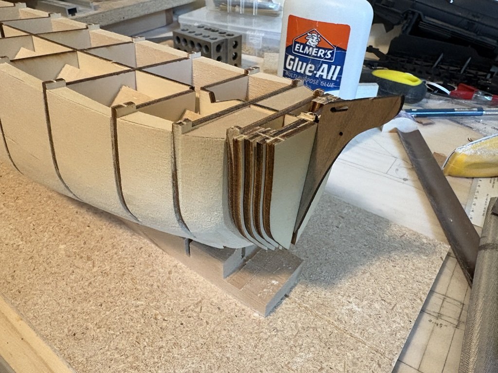

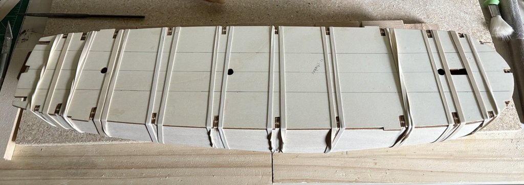

Shaping, shaping, shaping ...
But progress is being made and I am now going to change from 120 grit to 180 grit in order to finish the shaping. (I started with 80 grit sandpaper.) Here are some pictures I took to help me see where there are symmetry 'issues'.

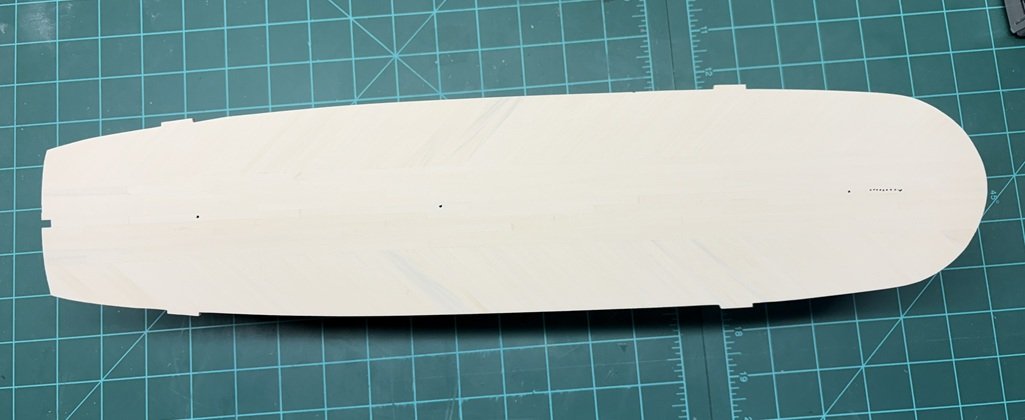

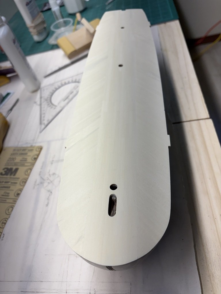

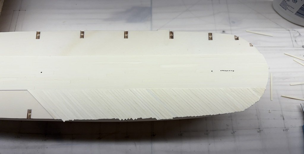

Unexpectedly workers showed up at the dockyard to begin laying the deck planking!
Space for 11 strakes are being laid in a four butt shift using 8cm planks made from Holly.

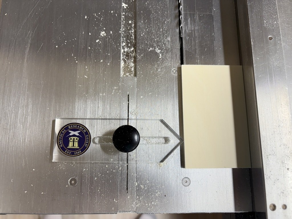

I'm using the NRG Thin Strip Saw Jig to cut the planks 0.7mm thick. The kit supplied planks are quoted at 0.5mm. Once the deck is sanded, the thickness should be just fine. First I tried to cut the strips using a slitting blade, but the Holly was not cutting clean (it was burning a bit) so I changed to the standard carbide blade and the work is now going well - even though I lose more wood to the blade than is in an individual plank!

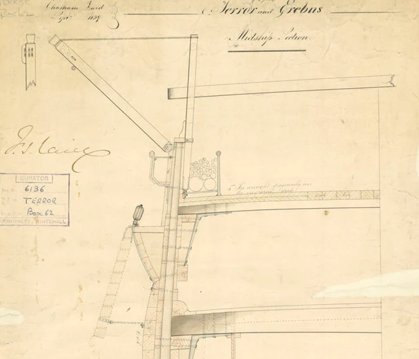

Very nice work! The diagonal planking is interesting, did it somehow help strengthen the hull against ice?
Thanks!
Yes, from a physics perspective the angled planks would help distribute / reduce crushing forces from along the sides of the hull. From this cross-sectional plan it can be seen that the outer portion of the deck was planked in two layers, the top layer being set at a diagonal; the lower front to back as normal.

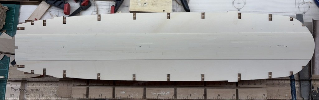

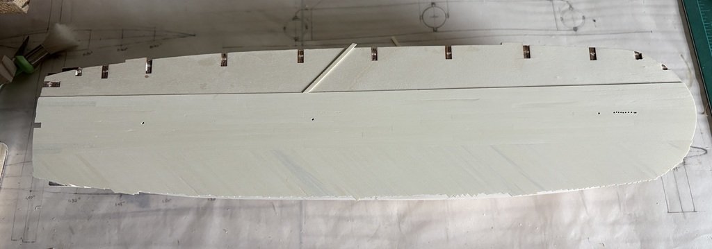

I'm going to say the deck planking is done. Sanding with 220 grit sandpaper was followed by opening the mast and bowsprit holes in the deck. A last go over with the 220 grit and a good cleaning / dusting off prior to a thin coat of clear matte varnish. It will get another coat once the deck furniture is all in place.
Bulwarks up next.

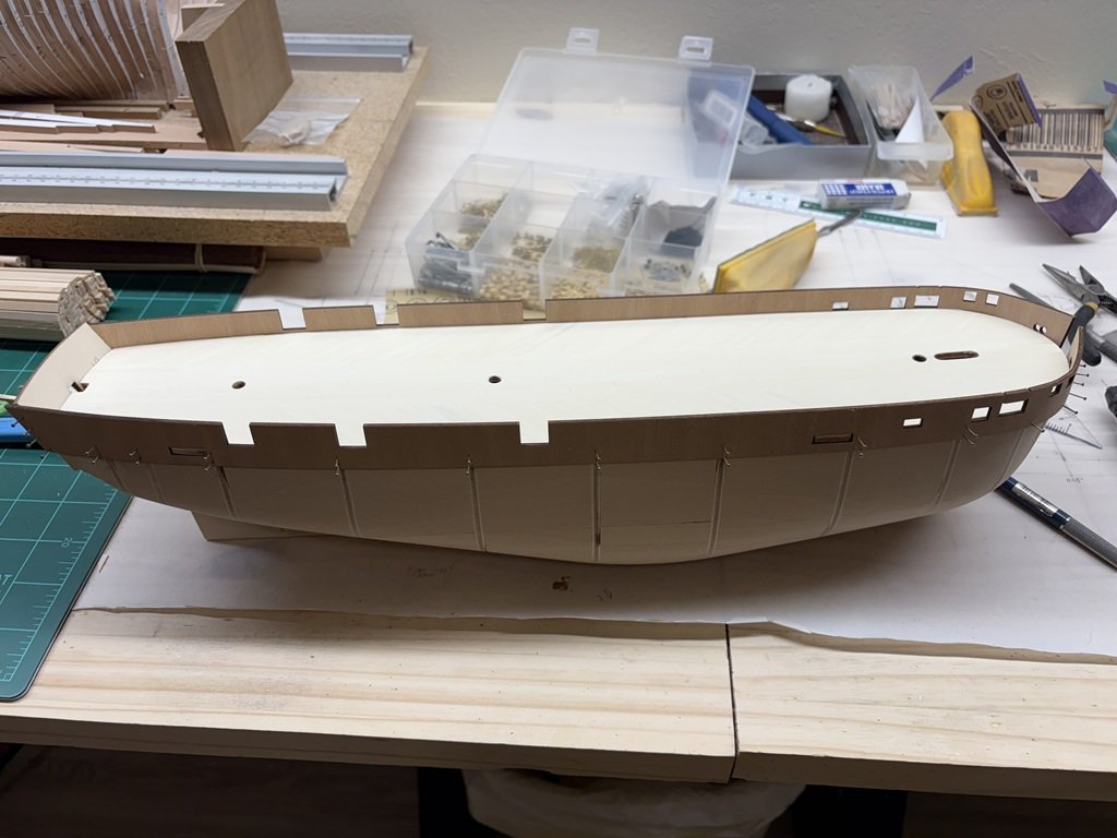

Started to attach the bulwarks today.
I guess I'm going to be a slacker here - from other forums, I knew that the kit bulwarks are not as high as those drawn in Betts' plans. I applaud those that have taken the time to raise them up and make other related adjustments! So this model is going to have bulwarks about 6 scale inches too short and the larger ports, within the bulwarks, are not being enlarged (which only works if the bulwarks are raised). If I change my mind later, the bulwarks could be extended during the planking process ...
