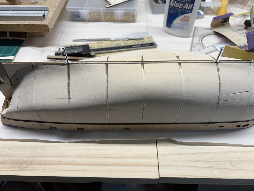

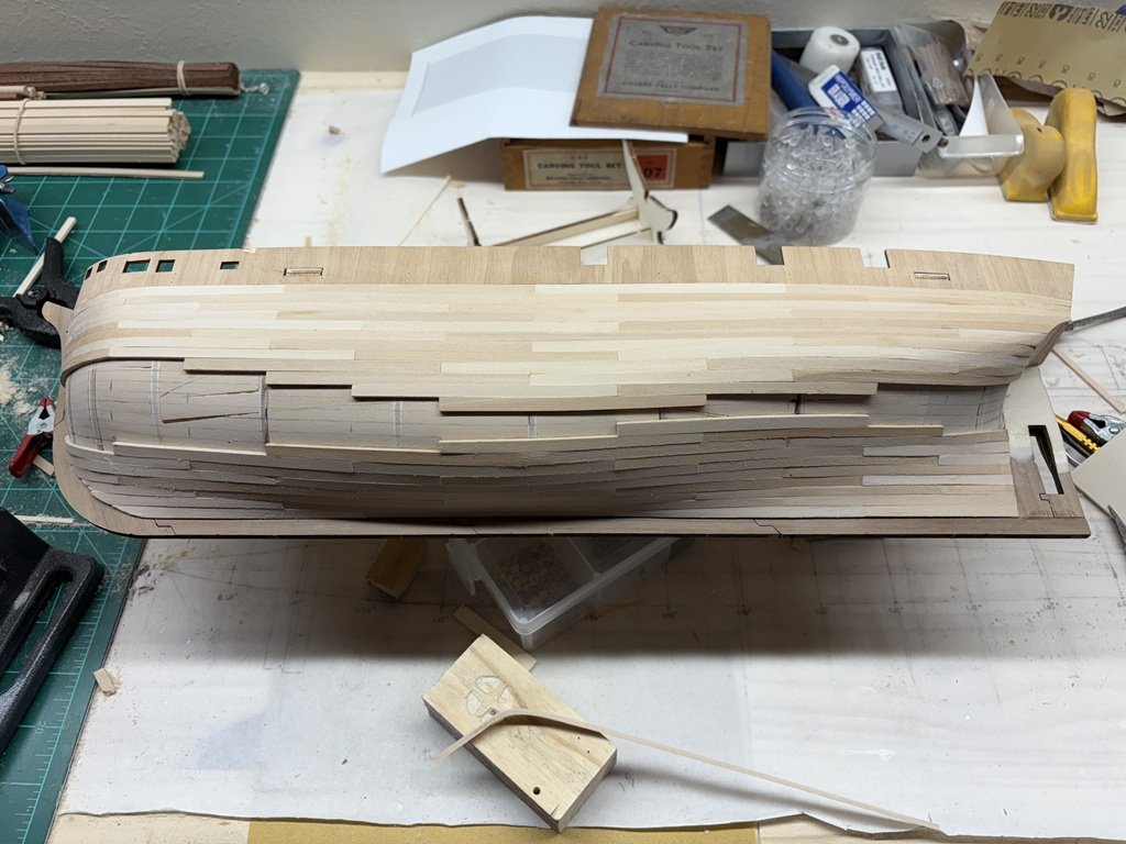

The planking shift has been marked and hull planking has begun! First plank, part of the garboard has been attached.
Using the provided planking material, I think there will be about 75 planks needed on each side of the hull. Some of the pieces will be hard to form near the bow and stern. Primarily due to the thickness of the material, I don't know if I will be able to get the kit wood to conform to the needed bends or if some supplemental material will be recruited - time will tell. Sometimes I find it a 'fun' challenge to see what can be done with the provided materials :)

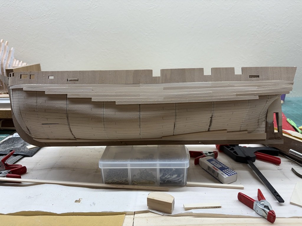

I got 9 planks shaped and installed today - so if things go well / at about this pace, i should be able to plank the hull in about 3 weeks.
I'll most likely plank the complete port side and then go do the starboard planking. I will be working from bottom up and top down simultaneously with the final planks going in near the turn of the bilge. The six planks on top were easy to work, but the lower garboard strake is only partially done due to the twists in those planks. There is one more plank on the garboard strake that is being worked on currently - the one that ends at the stern. It is challenging because it twists 90 degrees in less than 4 inches.
The planks that need a great deal of bending are being wetted and clamped in place to dry / take their shape. I remember rushing this process in one of my first models. In that one, planks were wetted and bent, but I failed to wait for them to be totally dry before attaching to the hull. Once they dried, I had a good number of gaps due to the wood shrinking back to its nominal dimensions; lesson learned and hopefully never repeated again!

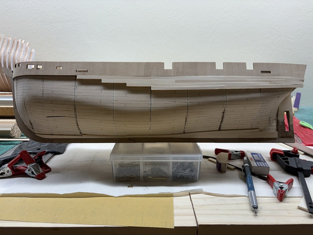

After 3 days, 30 planks are now in place. About 85 more to go on this side. My count of planks was way off a couple of days ago - there are closer to 115 planks on each side rather than 75!
Soon the work will get more challenging coming down from above as for the next diagonal from the front will have me planking right up to the stem, thus a reasonably sharp bend will need to be put into the plank. Probably as, or more, challenging work coming up aft as in two stakes I will be into the 'tuck'.
Not sure if the work coming up from the bottom will be significantly harder than now. In the front strakes will need to conform to the stem. In the back everything needs to be worked up to the stern post. Some of the planks need a great deal of twist as they make there way to the back.

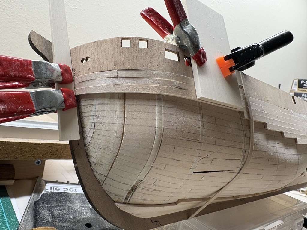

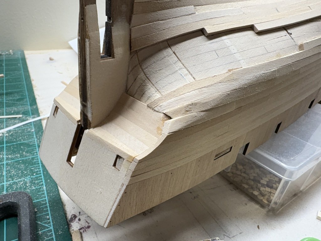

So far only 3 planks today ☹️. But they were hard ones that butt up against the stem. I needed to partially form each, then wet to bend, and do some more shaping before they could be attached. Once the now clamped plank dries I will be able to add quite a few planks with less difficulty going front to back and downward.
Yesterday I got about 10 planks attached and cleaned up the back edge of the top 6 stakes. In the back, it is time to work on the tuck. There is quite a bit of bend in that area and I am debating the wisdom of creating a mold to bend the planks in that area.

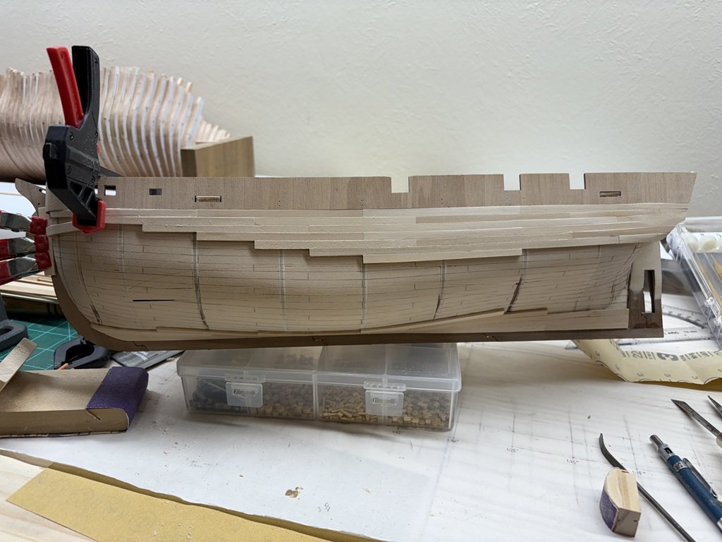

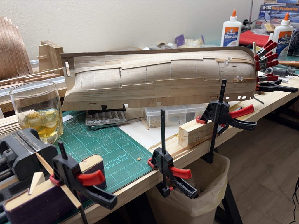

Four planks are being pre-bent to take up positions near the stem and stern (top and bottom). Not too long before the top and bottom work come together! But still a lot of planks that need sharp bends. The Jameson is helping the process!

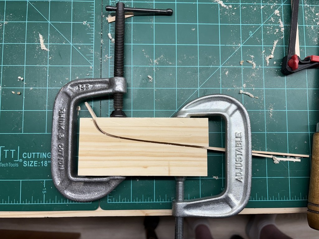

Progress - slow, but sure! One more plank and the top-to-down will meet bottom-to-top work. The plank sitting below the model has been bent in a jig to help facilitate the stern tuck planking.
The jig is pretty simple; but, depending on the piece of wood, my take more than one wetting and overnight clamping iteration. The jig is very much like the one Chapelle uses to bend wales in his Ships of the American Revolution book.
Here's the beginning of the tuck planking being installed:

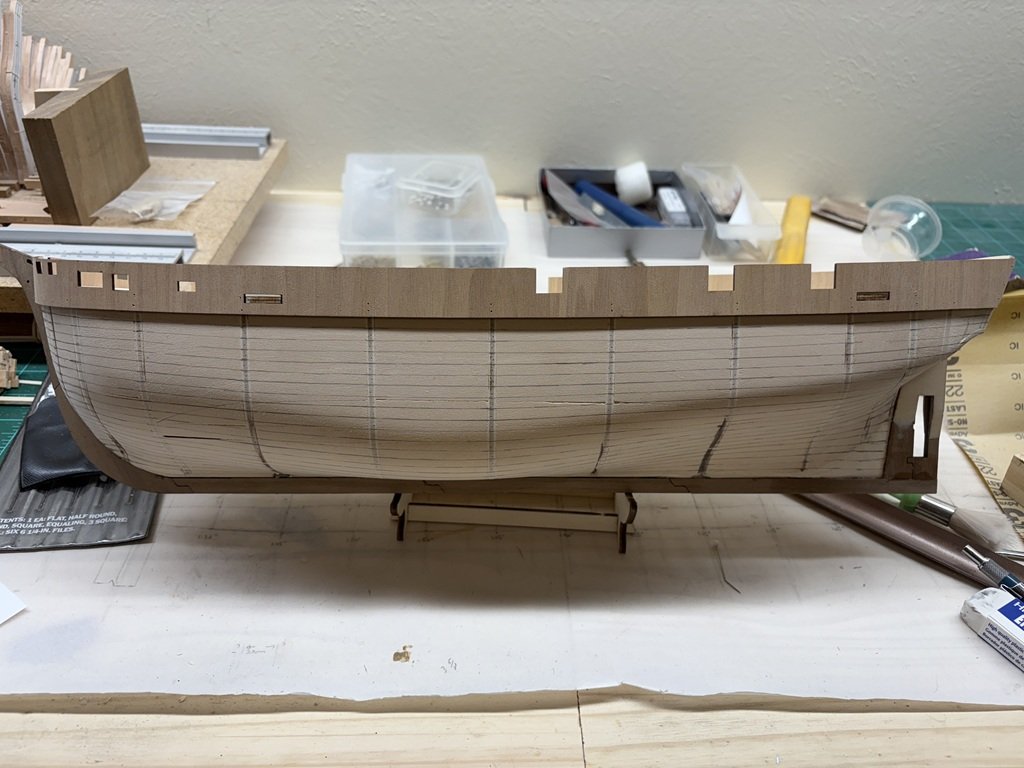

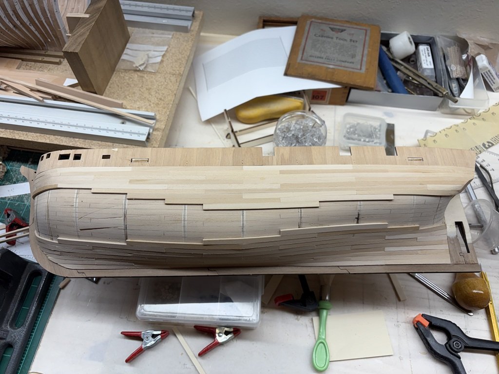

The port side planking is finally complete. It also got 15 min of smoothing before I decided it was too cold to sit outside any longer. But enough was done to get a look at what the hull is looking like now. Difficult (for me) to plank using the kit-supplied wood. A number of the planks would have been easier to fashion out of sheet wood / wider strips. There are a few 'gaps' that will need to be attended too, but all should be fine since the hull will be painted. Nevertheless, it has been a 'fun' experiment. Hopefully the starboard side will go quicker - or at least more easily! After the whole hull is planked, I'll do the rest of the sanding and get on to the ice channels. I don't foresee the need to do a second planking.
