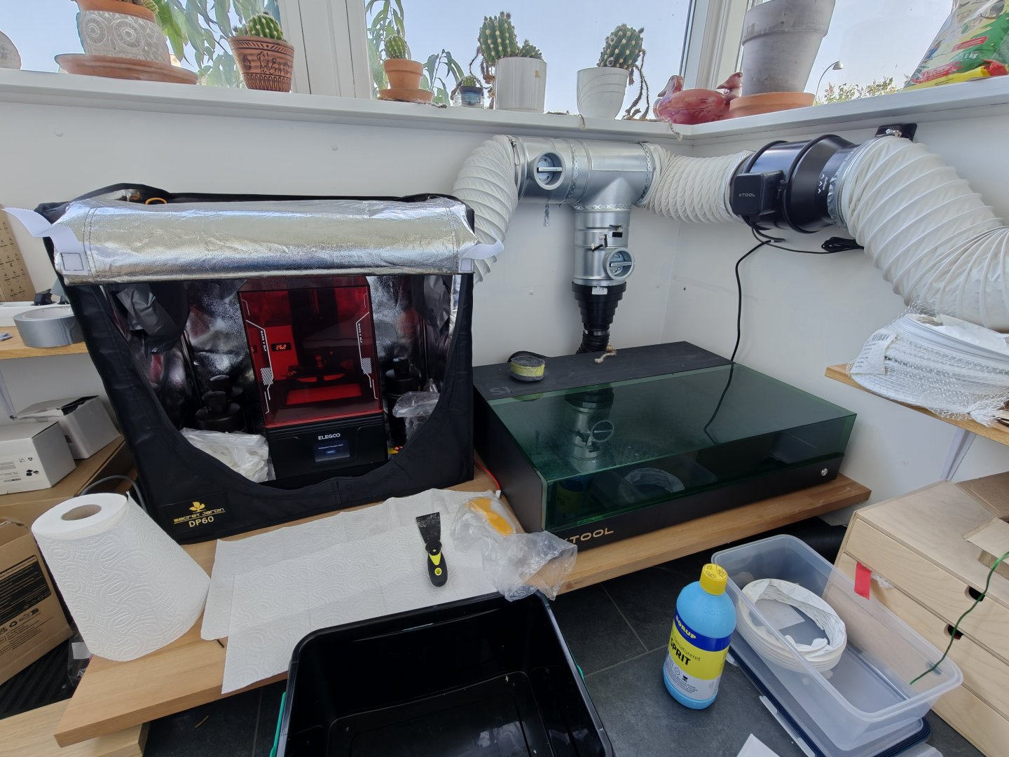

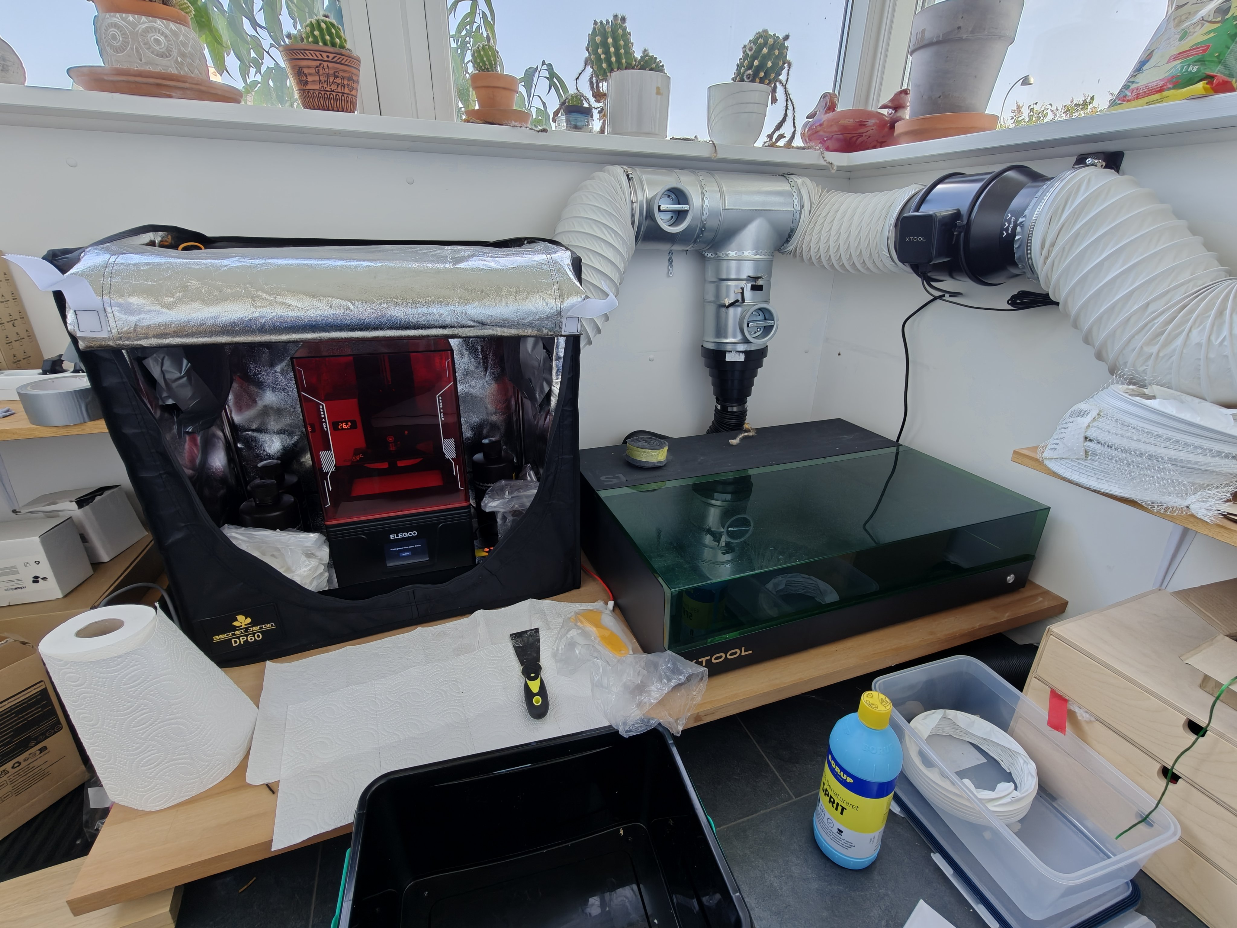

2. Yes, it does. You will find opinions that it is totally harmless and those that say it is extremely toxic. The truth is probably somewhere in between. You need very good ventilation to the outside and a space that you can close off to the rest of the house when you have resin in the open. You should also avoid touching the resin - it is not super toxic, but it will cause allergic reactions. Either right away or over time. And I really dislike the smell which is quite strong when handling it in the open.
I have the printer and the laser cutter hooked up to a small manifold with a big 200 mm fan. The printer is placed in a small growth tent - perfect for the purpose as I can ventilate it and keep stray light out. I keep the resin in the vat between runs and have a bathroom ventilator turned on when I am not printing to ensure no vapors seep into the adjacent living area.
This is my setup:
When I handle open or uncured resin I wear a half mask with organic vapor filters and I wear nitrile gloves - I use a lot of gloves and change them when I have touched uncured resin before I spread it around. I collect gloves and tissues in clear bags and uv cure them before disposal. I use water washable resin but still do a final rinse in IPA and collect water and IPA in clear plastic bottles that I can cure before I dispose of the content (or re-use the IPA). I am a chemist and this is what I have found to suitable for safe handling based on the safety data sheets and handling of similar chemicals in the lab.
I wash twice with water and twice with IPA and reuse the wash medias many times before changing them. I do the wash in IKEA tupperware with silicone seals, very easy to use and keep. And I can cure them from time to time.
It is a bit of hassle, but no step is difficult on its own and once you get the hang of it, it is not difficult and it does not take a lot of time. But I think you need a small dedicated space to make it hassle-free.
