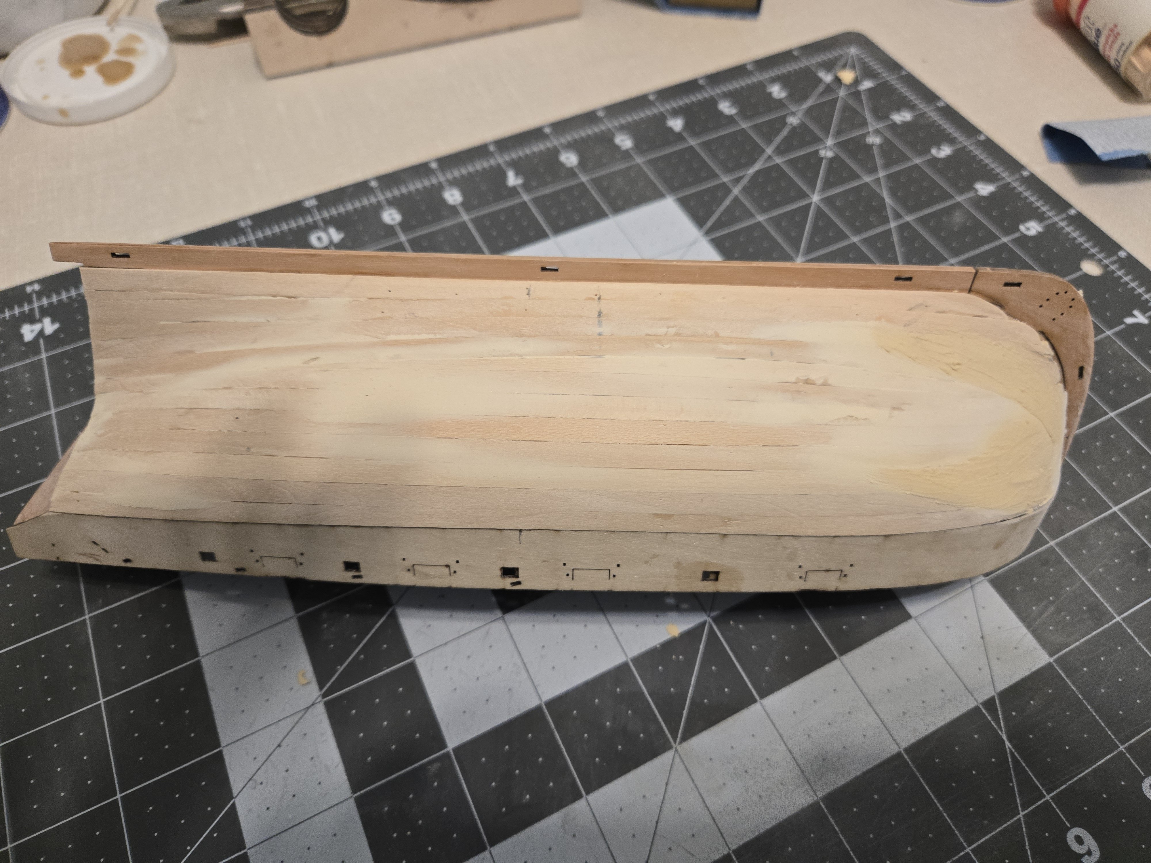

This evening is definitely time to begin the first planking.

Got a start on first planking as well today. The benefits of being on vacation for the week, plenty of time to build!

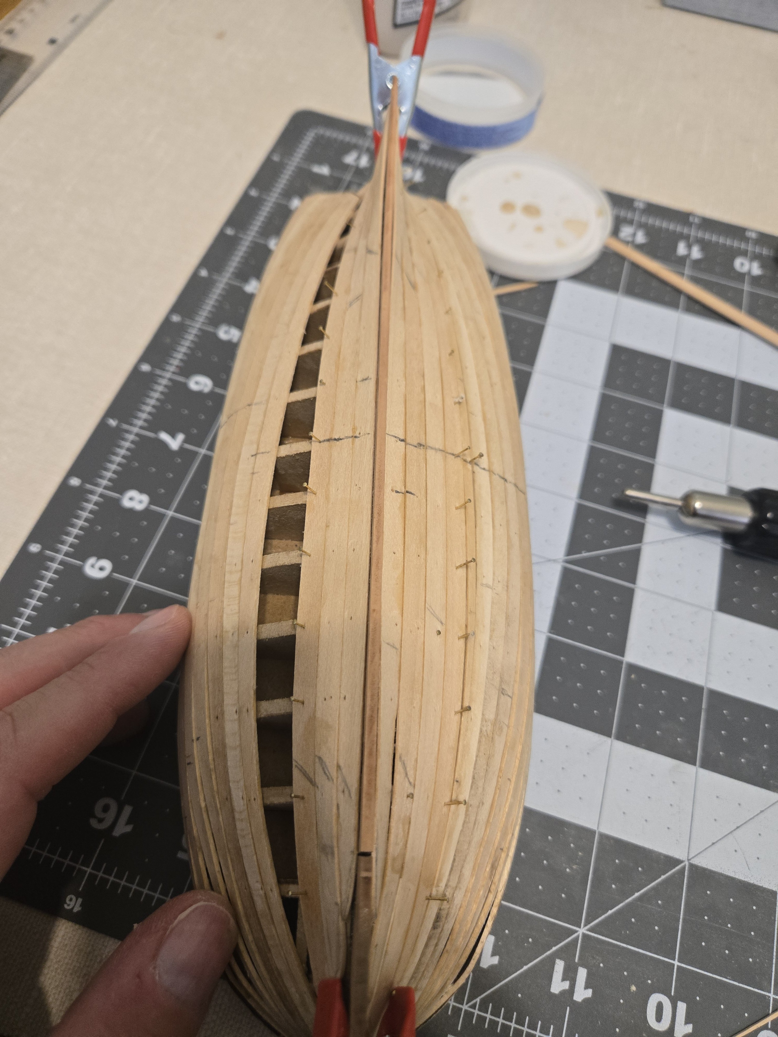

Fitting up the first plank here, and some things I am discovering; Smooth operation of a pin pusher is absolutely 100% a skill that must be learned. I dropped about 4:1 on this first plank. Also it did not sit dead on perfect, a fact I didn't realize until I got the next plank on.
Another thing that I was not 'getting' was the steel ruler and craft knife tapering. I found the planks were moving around under the ruler no matter how hard I pressed down on the ruler. In the end I decided to just sand them. Honestly I think I prefer sanding them to a taper anyways. Gives me nice fine control of the process the whole way through.

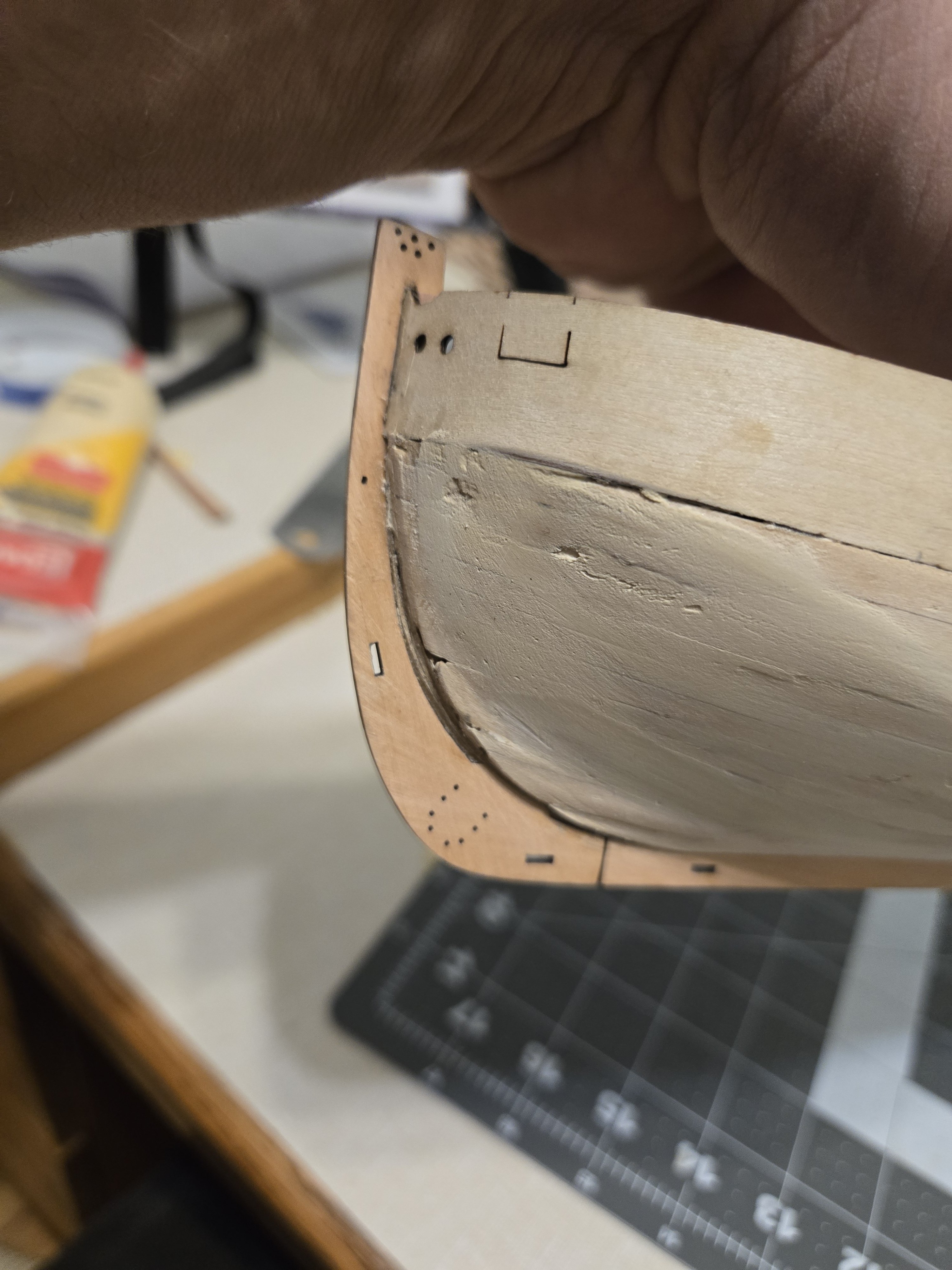

You can see in that final picture the first plank has a weird notch/kink to it by the bow. It looks super bad here, but isn't quite that nasty looking in real life. I think it's within the realm of sand & fill before second planking. Other than that I am pretty pleased with results so far. Some odds and ends and things I will change next time, but for a first ever model I think it's going quite nicely so far!
Just a small suggestion. Take a look at the planking tutorial under modeling techniques at the top of the page. It looks to me like you are not edge bending the bow enough. They shouldn't twist off the hull like that, but should lay flat.
I also describe the process in my alert log.
I like the Modelkit Stuff series on the Sherbourne but he is intentionally keeping things basic and not doing anything different from the manual. He’s not doing edge bending by choice. Without edge bending you’ll get some clinkering of the planks. Thankfully the planks are thick enough that sanding and filler can fix it. The pear for the second planking is thinner. My planking of Sherbourne was absolute garbage. Check out my log to see what it should not look like. Thankfully it’s painted since most of what’s directly under the paint is wood filler.
Try to do some edge bending and things will lay nicely (at least nicer), it’ll make things easier later, and be good practice for a later model that demands edge bending.

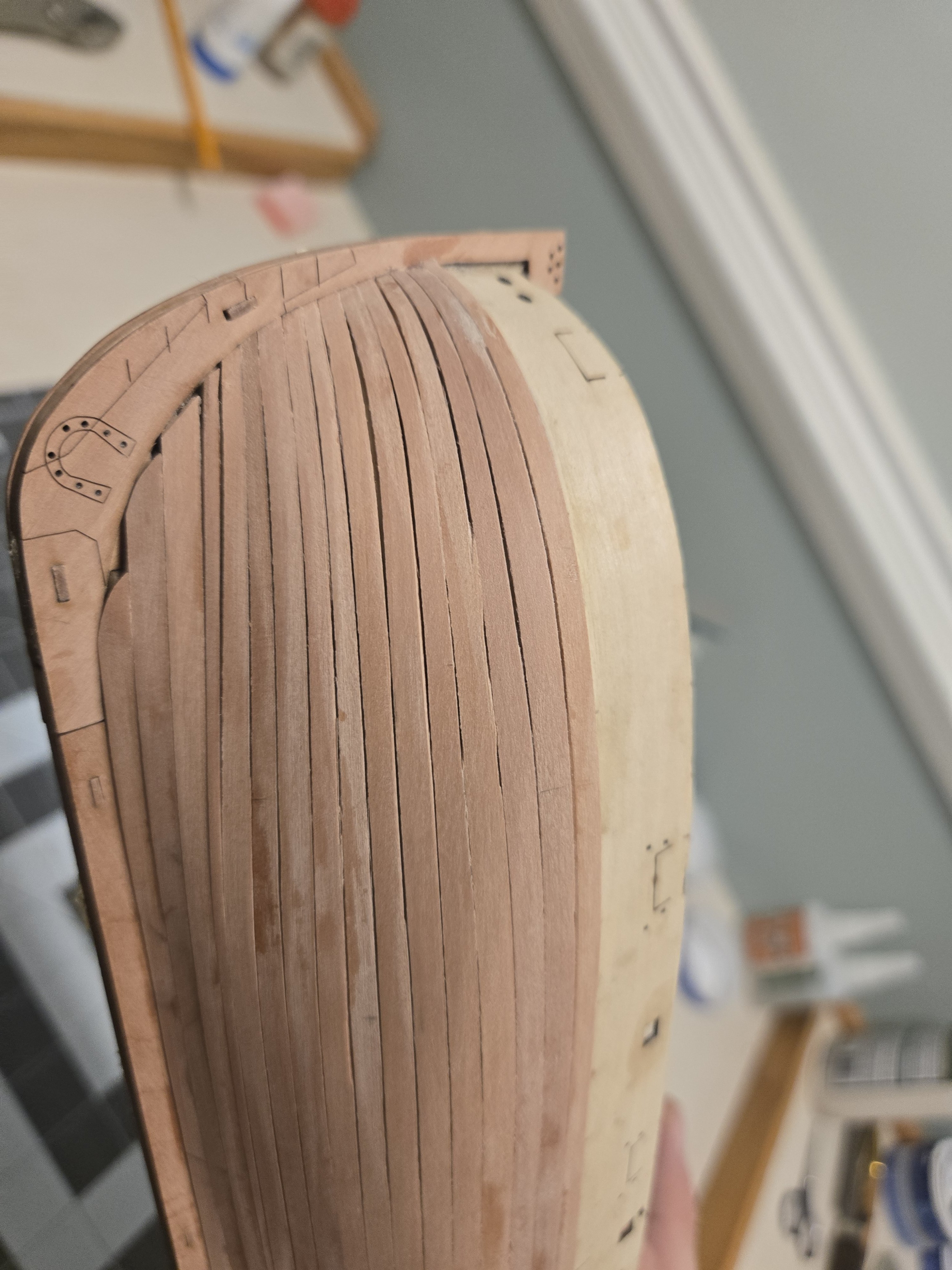

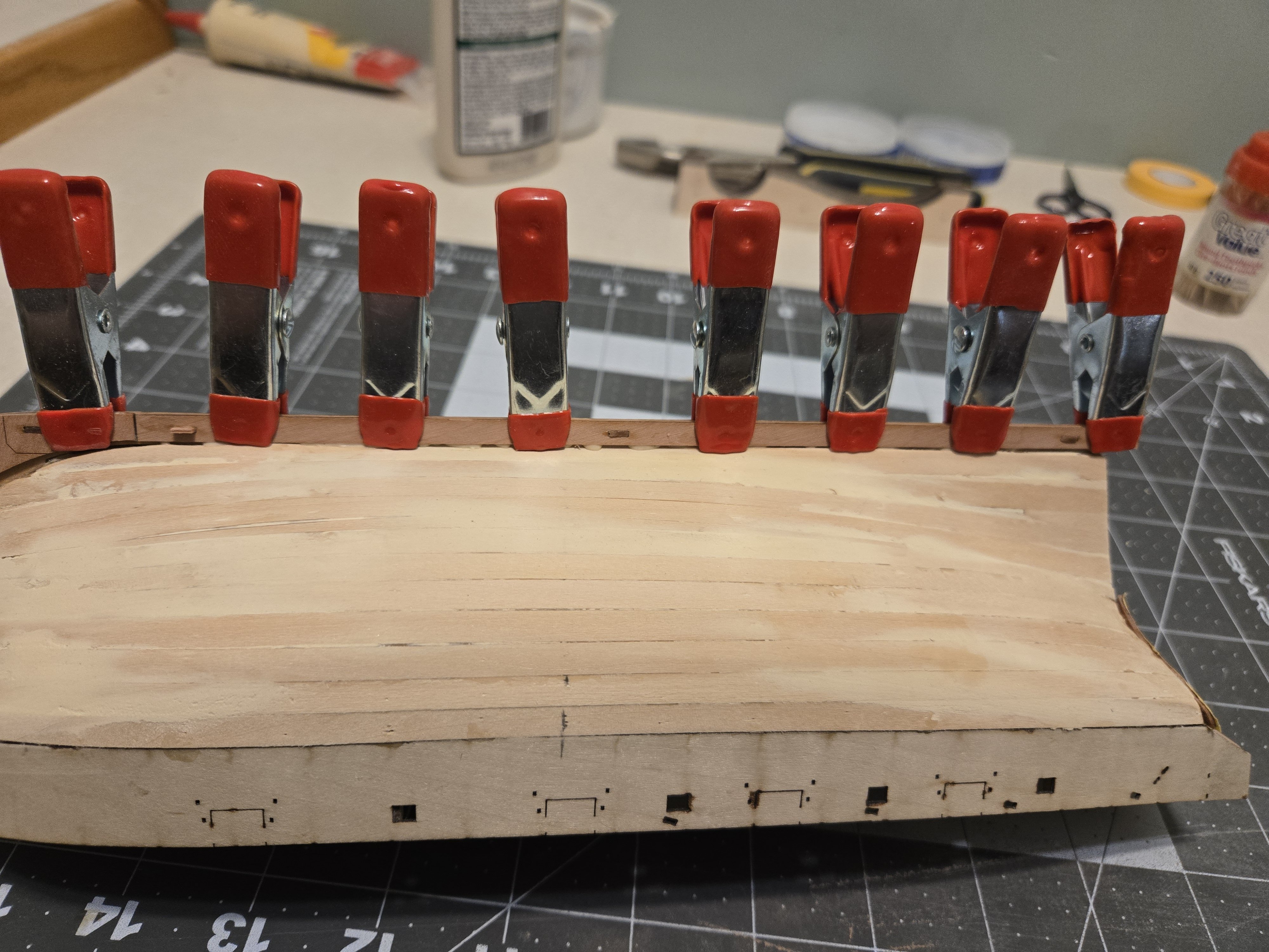

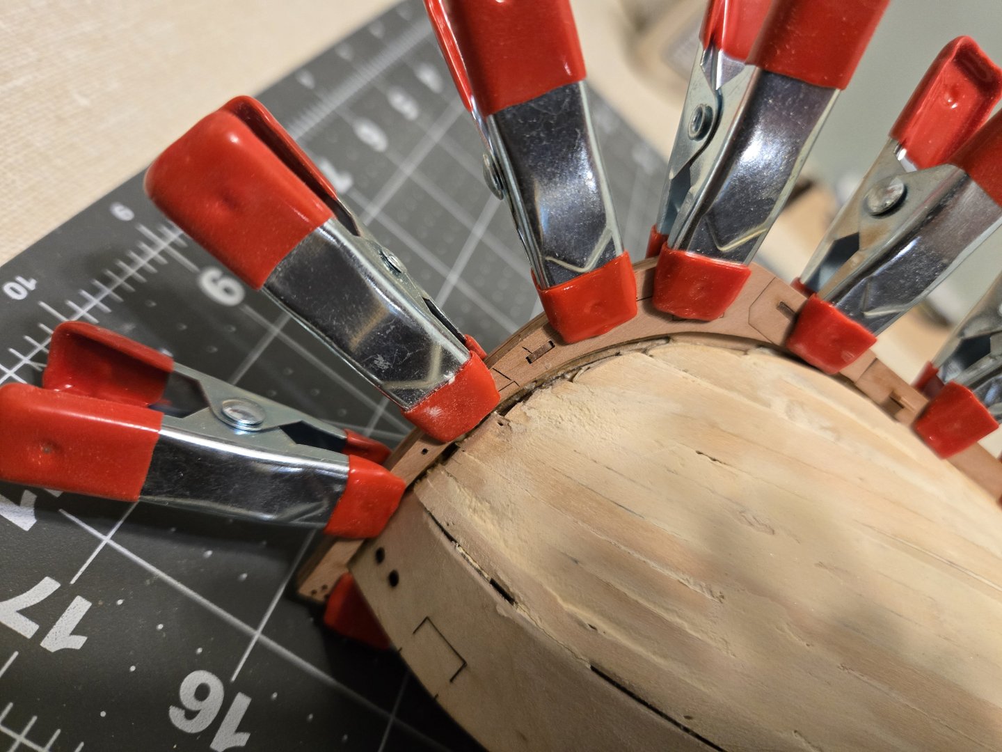

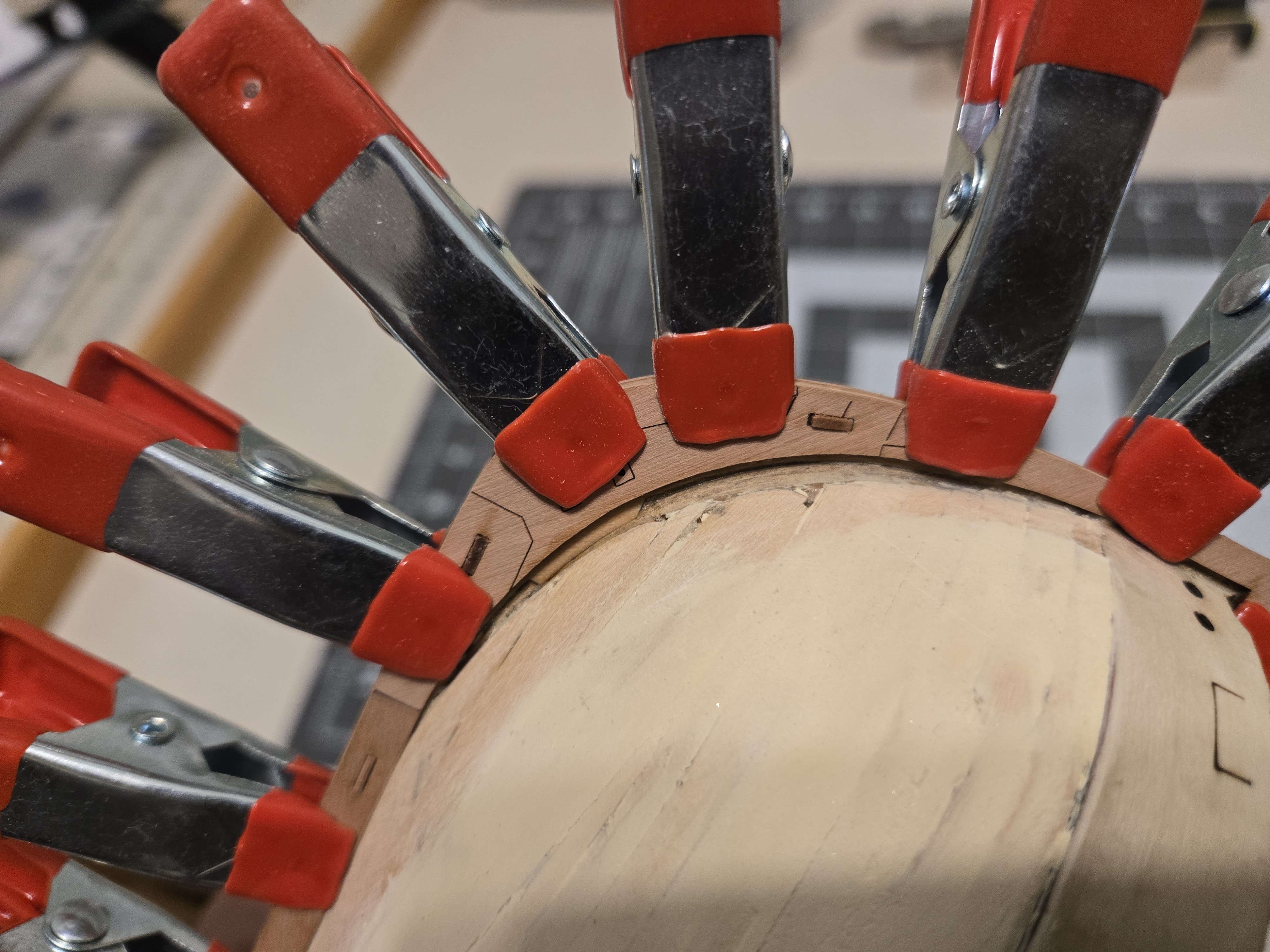

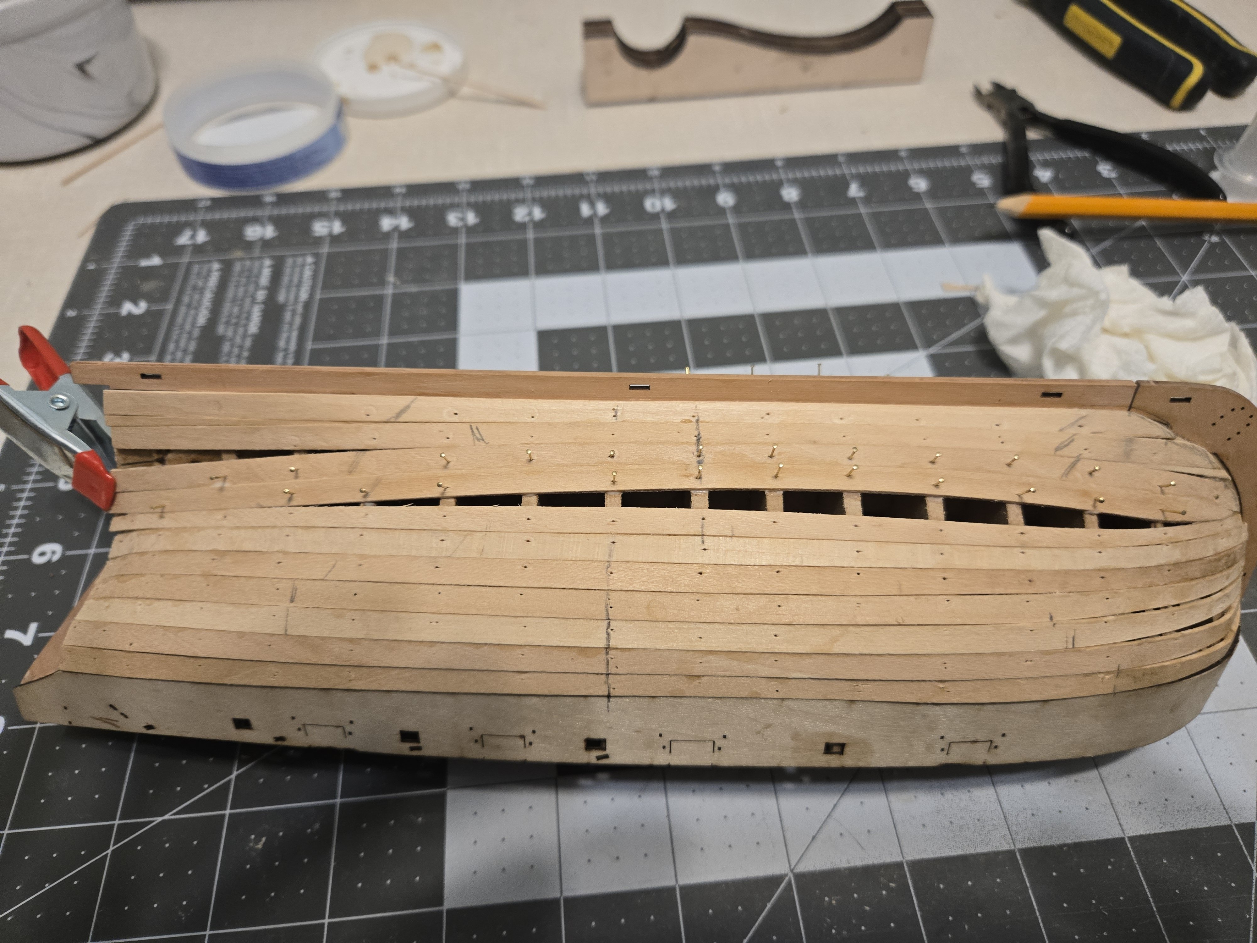

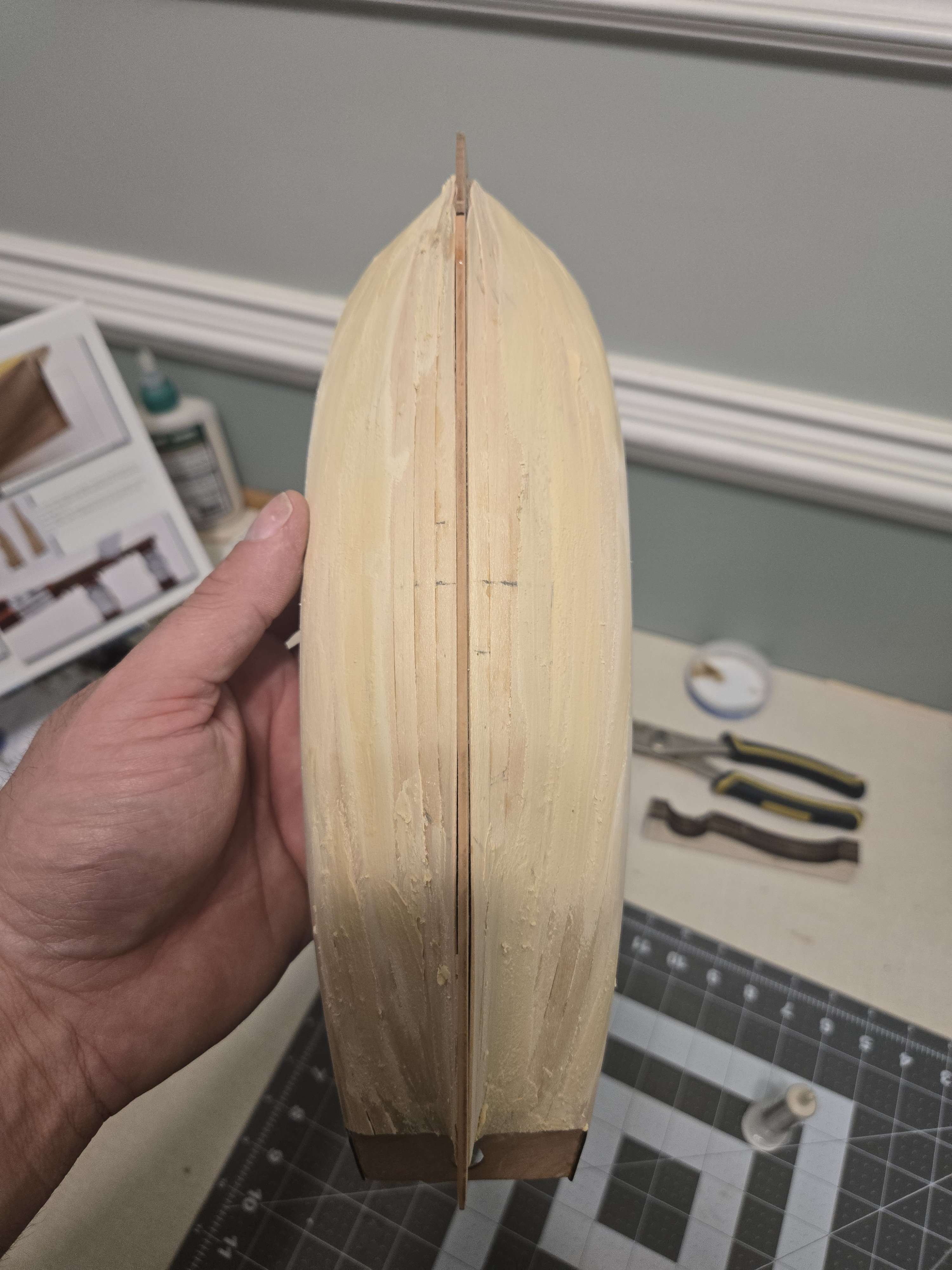

Alright so, I watched some videos suggested by some very helpful folks here, checked some suggested build logs, and modified my techniques a bit. Started soaking the planks, putting a bit of a bend on the edge, and the results I think speak volumes! The first four planks below were just me putting a little bend in with the steam from the kettle, the 5th and 6th planks were soaked, shaped, and edge bent before being installed. They aren't 100% perfect, but I think they are sitting light years better than the other 4. Even just clicking them into place was much, much easier. They just sat where I wanted them without needing to really put any tension on them. This is definitely the way! Thank you all and keep any more advice rolling it's a huge help!
Edit: Also a LOT easier to cut the planks with a knife and rule after they were soaked. Huge thanks for the tips on cutting the taper!
Edited by Pinenuts
I think you’re really there when a piece of planking fits in place almost like it was a piece in a Lego kit. I remember one person respond to a question about using clamps to hold a piece of planking in place near the bow by saying that you don’t even need a clamp if the plank has been shaped correctly. I’m certainly not there by any means yet.
