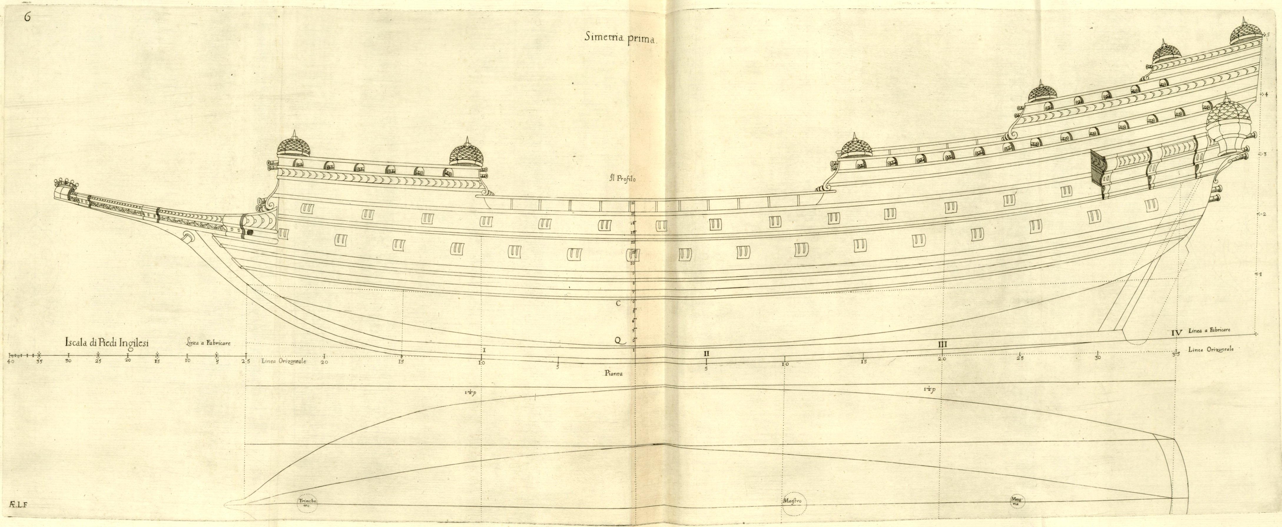

The first design is shown and described in the figures in Chapter VIII below, of an improved galleon long four breadths along the first line, or wale, which sports two and a half decks, with the gunroom, and will carry eighty pieces, in the manner described in Chapter VII. The author had a 300-ton version of the same design built for himself, carrying 30 pieces, in which he sailed as a general to the Indies in 1594 with other vessels, at his own expense (for comparison, according to the calculation method provided by Dudley, the capacity of his published design is 1000 ton).
The second design is of ‘rambargi’, presented in Chapter IX, long five breadths along the first line, or wale; one of which will carry 90 pieces, with the restrictions described in Chapter VII, and they are faster than galleons; and these resemble the longest ships of the Royal Navy of England.
The author had one of this type built for the Most Serene Grand Duke Ferdinand I, of about 600 tons, named S. Giovanni Battista. In any case, it carried 60 large, reinforced pieces and proved its worth against the Turks.
The third design, described in Chapter X, is of a ‘galezabra’ long six breadths along first line, or wale, which carries two decks and a third, with the gunroom; and this is a vessel even faster than the ‘rambargi’, and is very formidable in fighting from windward with the force of its artillery, and will carry 90 pieces, those described in Chapter VII, with others reinforced [guns].
Of these ‘galezabres’, the author had one built for the Most Serene Grand Duke Cosimo II, not exceeding 300 tons; although it carried 40 good pieces, it was a very fast and very stable vessel.
The fourth design is a square-rigged vessel, named a frigate by the author, seven breadths long, with the entire stern, and its proportions can be observed in Chapter XI, and carrying 50 pieces [described] in Chapter VII. And the author built as a test a small vessel, like a ‘pinaccio’, of this design for himself in Livorno in around 1608, and it proved to be very fast and handled well at sea. He had another vessel of the same design, of about 140 tons, built when he went to the Indies, named the Little Bear, commanded by Captain Monck, an Englishman, a relative of the author and his vice-admiral.
The fifth design is of rowing vessel, being an improved ‘Galeazza’, called by the author ‘Galerone’ or ‘Galeratone’; which is much more manoeuvrable than the galeazze, and can be dismasted and propelled [by rowing] very well, which the large galeazze cannot do. The Galerone has length of eight breadths along its line (wale), as [shown] in Chapter XII, and can carry 50 carriage cannons and 20 hail-shot guns (‘petrieri’). The author had one of this type built, not so large but longer, for the Most Serene Grand Duke Cosimo II, named Galerata by its inventor, which carried 32 carriage pieces and 20 ‘bombardine’ and moved very well, especially under sail. These are exquisite vessels for sailing and for fighting in battle in place of galleys, and the cost is little more than that of a galley, except for the artillery.
The sixth design is a nine-breadth long improved galley by the author, [decribed] in Chapter XIII and named by him ‘Galeratina’. He had one of these built for the Most Serene Grand Duke Cosimo II and named it S. Cosimo. It proved to be the fastest and best-conditioned galley in the Mediterranean, as is well known. and this one did not carry guns on its sides, but rather eight ‘bombardine’ on each side, and two more guns than usual at the bow: These, however, are good vessels for the course. It was the Galera Padrona.
The seventh design, of the length of ten breadths along the line (wale), named ‘Passavolante’ by the inventor: Its proportions are shown in the figure in Chapter XIII, and one of these was built for the Most Serene Grand Duke Cosimo II in a similar manner.
Therefore, the knowledgeable demonstration follows to manufacture the seven designs mentioned above.

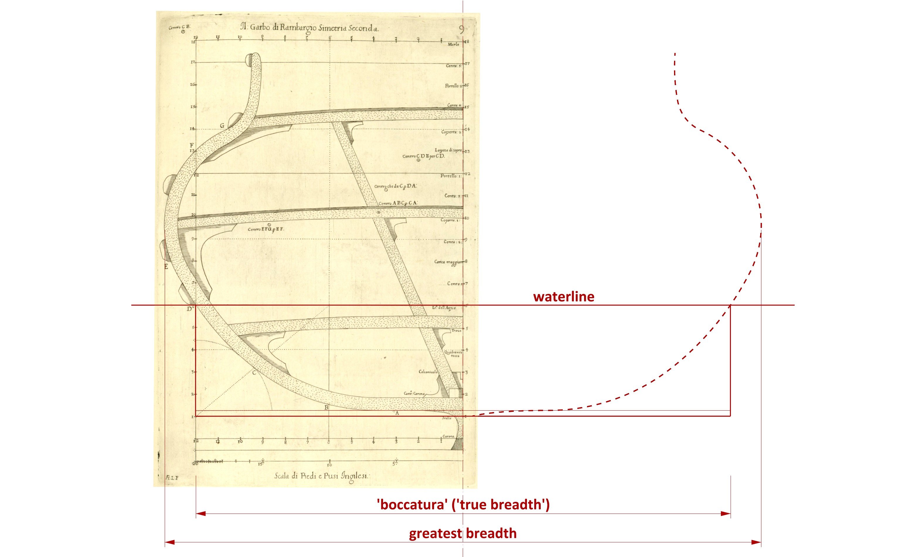

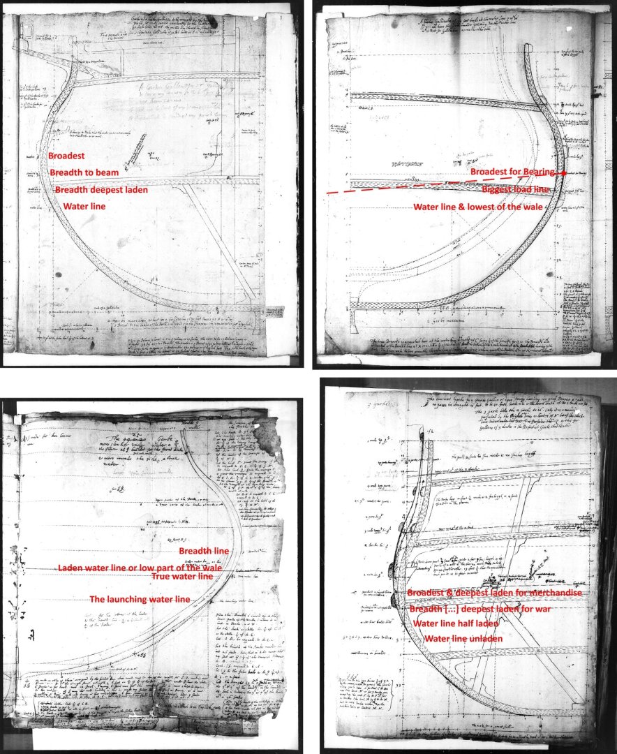

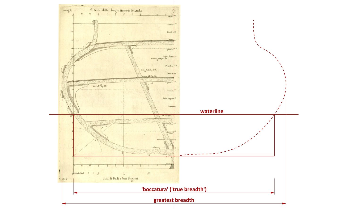

At the outset, it should be emphasised that a particular design method or design system (or, in modern terms, a parametric model) should not be equated with the specific proportions used in a particular design (or, in modern terms, a specific set of parameters entered into such a parametric model), which, unfortunately, is quite common among various authors in this field. In other words, a ship with the same proportions can be designed using different methods, or conversely, ships with different proportions can be designed using the same method, simply by modifying the design parameters. And, at least in a geometric sense, the size of ships, i.e. measured in absolute units of measurement such as feet, cubits or metres, is a completely separate issue.
That said, it should be noted that Dudley's 'inventions' do not consist in the discovery of some new, previously unknown design method, but merely in ‘playing’ with proportions, and in his specific case, primarily in a quite significant increase in the relative length of ships, as it seems, well above the customs accepted at the time.
And so, the essence and main criterion distinguishing his seven ‘inventions’, i.e. proposals for seven different types of vessels, is well reflected in the following unpublished sketch taken from a handwritten batch of material:
Although his designs of different types of ships could have individual, varying breadths (and also generally vary in size), in the above sketch they have all been scaled to a single, common width, making it easy to see the difference in the relative lengths of these vessels. Dudley's shortest design is for a galleon four breadths long, and the longest is for a passavolante 10 breadths long.
The basic unit of measurement used for further calculations of the main proportions of the ship is the breadth of the hull, quite consistently referred to by Dudley as “boccatura” in the publication, and in handwritten notes also as, for example, “true breadth” at the level of “true waterline”, and similarly (in Italian and in English).
Indeed, in accordance with the Mediterranean method or tradition, this breadth is not measured at the widest part of the hull, but at the height of the so-called 'boca' line (at midship), which in Dudley's designs, to simplify now somewhat, generally coincides with the lower edge of the lowest wale and at the same time with the swimming line, and the greatest breadth is hardly mentioned at all in the whole publication. A typical case can be clearly illustrated by one of the published diagrams:
Ah, this is perhaps a bit out of order, however, since the issue has already been raised, at least some graphics with a few unpublished master frame designs by Dudley can now be shown, which demonstrate that the ships were indeed designed by Dudley with more than just one operating draught in mind. For convenience, these levels were synchronised with the height and width of the wales.
As for the proportions of the ships envisaged by Dudley, it is true that some of his designs are, in some respects, rather unusual proposals for their time. But this effect also results from the close, rather complex relationship between the various dimensions of the ship (together with the simultaneous consideration of various design constraints), to enable it to sail or row effectively. We may come back to this later, yet, in essence, it is the design method that is most important here, rather than the proportions of Dudley's designs.

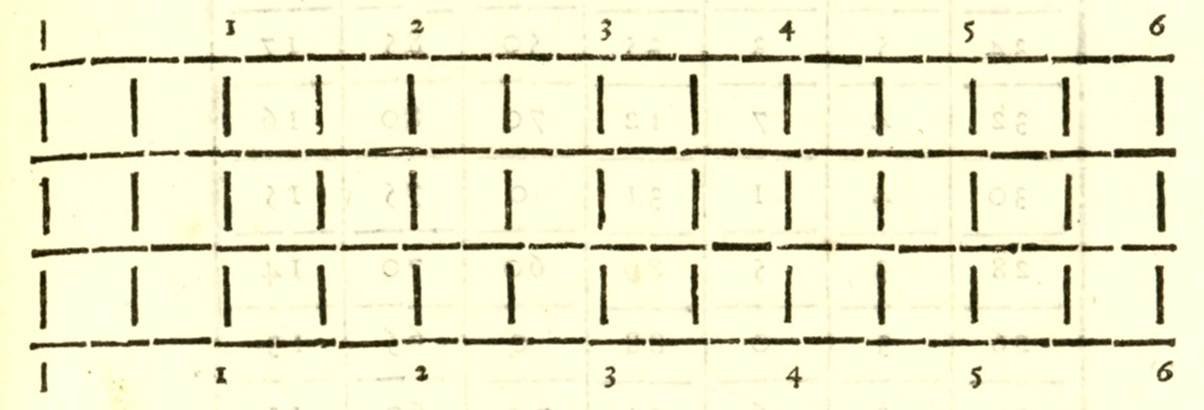

There are three scales, which can be best used in the building of warships mentioned in the previous chapter.
The first scale must be in English feet, because it is best suited to the construction of square-rigged vessels, each foot being divided into 12 inches, and each inch into 8 or 12 parts.
The second scale will be Genoese palms, three of which make two feet, and six English inches, which make one cubit, consisting of three palms, as usual, and applies only to the seventh design of the ‘Passavolanti’, as [presented] in Chapter XIIII (XIV), and to common galleys.
The third scale will be a few palms longer than the second, applied by the Author to the construction of the fifth and sixth designs from Chapters XII and XIII, and three of these palms per cubit make two feet and seven English inches, and each of the Author's palms corresponds to 12 Venetian inches, of which 16 make one of their feet; however, each palm is divided into 12 inches, and each inch into 12 parts: Hence it follows that the two scales of said palms are based on the English foot, as above; and therefore it will suffice here to make the perfect length of an English foot divided into 12 inches; five of which feet make a pace, and a thousand of these paces make a mile, and 60 of these miles make a degree of the great circle, according to the calculations of English sailors.
Therefore, the scale of half an English foot is divided into six English inches, and each inch into eight parts; and this can also serve as an explanation of the following first figure of the English foot.
For the division of the half foot into six inches, the length of three inches gives the fourth part of the same foot; and six inches, the half, and nine inches, three quarters; and four inches, the third part; and eight inches, two thirds of the said English foot, two of which make a Florentine fathom less half an inch, approximately.

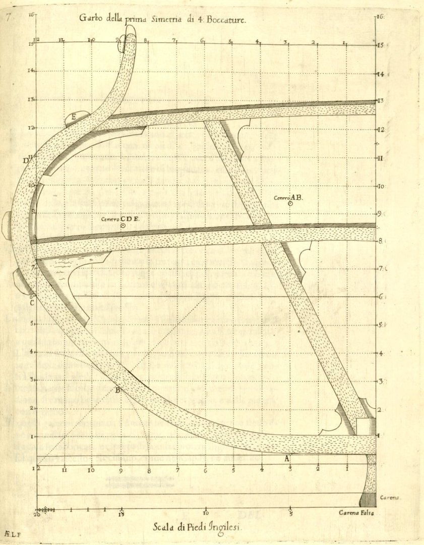

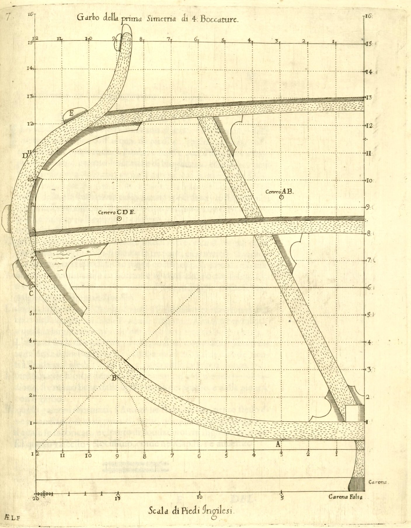

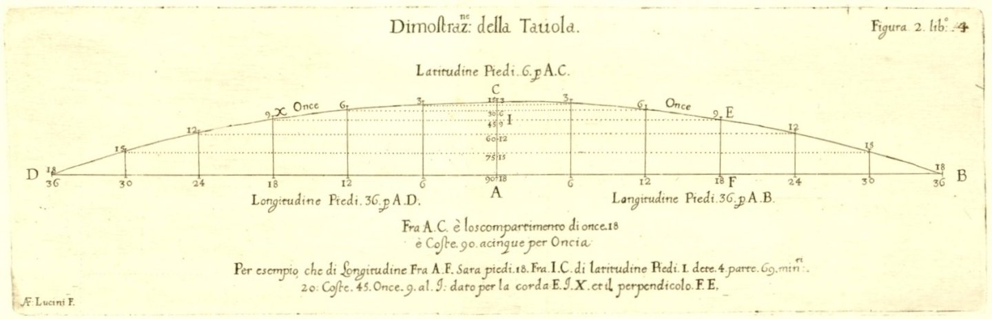

DESCRIPTION AND APPLICATION.
The table contains 36 feet of longitude in the first column and 6 feet of latitude in the second, and can be used for any greater or lesser number of longitude and latitude, using [instrument shown in] Figure 3. In the third column, each foot is divided into only ten parts, to facilitate the calculation of the Table with perfect numbers; and it serves the operation sufficiently, and without considerable difference, as if the foot were divided in the usual way into 12 inches; & each inch in the fourth column is divided into one hundred parts; & each hundredth part of the inch is subdivided into one hundred minutes in the fifth column; the sixth shows the number of ribs of the vessel, up to ninety ribs; and the seventh column presents the bends, which are eighteen, counting five ribs per bend.
The application of the Table follows; for example, given that the longitude is 24 feet in the first column; opposite that number, in the second column, it will give two feet for the latitude, and six inches in the third; and 25 parts of a hundred in the fourth column; and 70 minutes of a hundred in the fifth; if the ribs are 60 as per the sixth; with 12 bends in the seventh column. This example, for the execution thereof, is demonstrated in the following figure, which has its basis in the preceding Table.
DudleyRobert-Arcanodelmare-Fabbricadivascelli-printed1646_Page_07.thumb.jpg.854c5f68d7d86f446b9eb16e903fb2f7.jpg
Figure 2.
DESCRIPTION
The semi-chord AB will be 36 feet in longitude, and the latitude will be 6 feet for AC, and the 18 bends of the ribs as per the seventh column, [and there] will be the right angles between ABF, AC & EC (should be EF instead of EC); and so every perpendicular line between the chord ABDF and the arc BCDE gives the quantity of the division up to one hundred minutes per side.

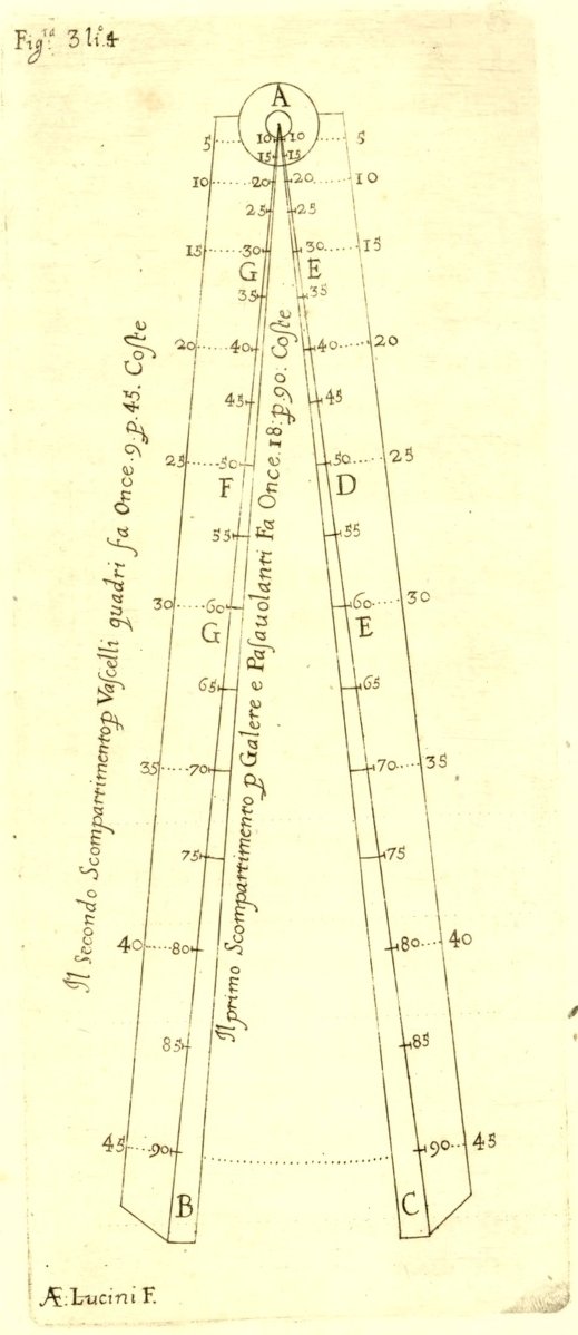

THREE OTHER INSTRUMENTS
by the Author, to be used with the division of the true Circle, with the Table, for building ships.
The first instrument is in the form of compass, to be opened to the number of bends given, and the width and distance limited by the plan and profile of the vessel to be built, in accordance with Chapter VIII and the others up to Chapter XIV, and thus these compasses will give the orderly division of the bends, and ribs, conforming with the previous table, by applying to the ribs of the vessel its width and height, and also the rising [line of the floor].
DudleyRobert-Arcanodelmare-Fabbricadivascelli-printed1646_Page_10.thumb.jpg.360a9239992b9b2ae522b3b470d74983.jpg
Compass, a circular scale in two modes, one of ten bends for square-rigged ships, the other of seventeen or eighteen bends for ‘Galeroni’, or improved galleys, and ‘Passavolanti’. Figure 3.
DESCRIPTION
The two legs BC and AC of the first instrument must be approximately three cubits long; one [side] divided [progressively] into ten bends, for the square-rigged vessels of Chapters VIII, IX, X and XI, and the other [side] into seventeen bends, for the rowing vessels of Chapters XII, XIII and XIV. Thus, the compasses ABC are opened at the required distance to be divided, and [this] at the given number of bends and ribs; and holding the instrument at that setting, the division is made, with the same numbers always opposite, in accordance with the previous table; for example, the number of bend 30 at G corresponds to 30 at E, and bend F corresponds to D, and similarly for the other bends, and they yield the division that must be made.

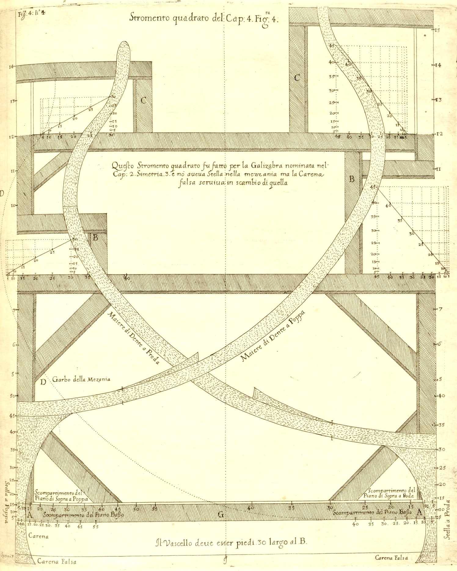

DudleyRobert-Arcanodelmare-Fabbricadivascelli-printed1646_Page_11.thumb.jpg.9a16b2ad75058d29bbab7593ffc2c7f0.jpg
Figure 4.
This instrument is made of wood joined together, & in square shape, for half the greatest breadth of the vessel, and will be divided, by means of the first instrument, in the manner shown in the figure, to give the width & height of the ribs & bends, with the help, however, of the [master frame] mould, applied by means of the figure; and thus every skilled master builder can understand the author's intention well and put it into practice, and it is a very curious and useful invention, not deviating from the design of the plan and profile, which is provided in Chapter VIII to Chapter XIV.
Other requirements concerning the reduction (transformation) of the ribs, and their thickness and reinforcement, by [the help of] the ribbands and battens, are common knowledge and well understood by master builders, and are therefore omitted here, as the author does not wish to deal with ordinary and commonplace matters in this treatise, as has been noted on other occasions.
Indeed, by means of the third, square instrument mentioned above, it is possible to mould the sides of the vessel from stern to bow, and throughout; which thing cannot normally be done, except between the two quarter frames; and therefore the vessel cannot be kept steady, as it should be; and by means of the aforementioned square, it will always be very steady, the mould being well made and applied; and it is a great secret, even though the author deals with it sparingly; albeit it is sufficient for intelligent masters to understand it by means of the figure, it cannot be understood by the ignorant, because they will never fully understand the application of this invention by means of the figure alone.
Of note still that the author has employed the square instrument described above to design ships, he has done so both in the construction of rowing galleys and square-rigged sailing ships and high-sided vessels.

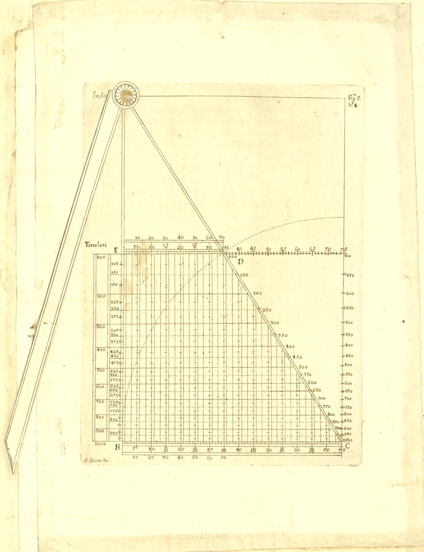

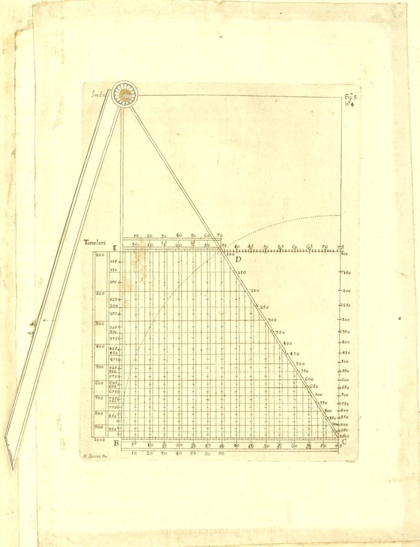

DudleyRobert-Arcanodelmare-Fabbricadivascelli-printed1646_Page_14.thumb.jpg.1dc9ce485d877e9386239013546be16f.jpg
Proportional Instrument, Figure 5.
The letters ABC (the missing letter A should be at the index pivot point) show the rectangular triangle of the proportional instrument; between B [and] E, on side AB, the capacity of warships is marked, from one hundred to one thousand tons, by unequal (degressive) division, from which parallel (horizontal) lines are drawn between DE and BC, as shown in the figure; but the (vertical) lines perpendicular to the base line BC are distributed evenly: It follows that the intersection of the [rotary] index AX with those parallel and perpendicular lines yields proportionally the capacity of warships, in accordance with the given proportion and shape.
For example, it is assumed that the breadth of a 280-ton vessel is 28 feet at the first wale, the length is 112 feet, the hold is nine feet, and one third, which [capacity] is found as the parallel line between DE and BC; and where the perpendicular line of 28 intersects this transverse line, or parallel of 280 tons, the index AX is rotated to that intersection and is fixed there, with the intention of finding the capacity of another vessel of the same design, 35 feet wide; and find where the index intersects the perpendicular line of 35 feet between BC and DE, from which [point] the parallel line gives the capacity of the vessel [on the scale] between B [and] E as approximately 512 tons for war.
TO FIND THE CAPACITY
for the first time of a limited(?) vessel ('vascello limitato').
Take the length of this vessel in feet up to the wing transom, and the breadth, including the depth of the hold; then multiply the depth by the length in English feet, or palms, and multiply the product again by the breadth; subtract one third of that sum, and disregard the last digit of the number; and thus the remaining number gives the capacity of the vessel in Mediterranean salmes, of which five salmes make one English ton of the Ocean sea, and two tons make one last.
For example, it is assumed that the length of the vessel, from the bow to wing transom, is 105 feet, the width is 23 feet, and the depth of the hold is 8 feet. First, multiply 8 by 105 to get 840 feet, then multiply the width of 23 feet by the product of 840 to get 19,320. Subtract one third of this number, leaving 12,872 and a half (should be 12,880); the last figure of 2.5 (should be 0) is cut off and not counted, leaving a remainder of 1287 (should be 1288) salme for the capacity of the proposed vessel, and in tons for merchandise it will be 257 and two thirds approximately, counting five salme per English ton; but for war, a quarter more is added to the calculation; and thus we will have the capacity of the first vessel given, to be applied with the above proportional instrument [to find capacity of vessels of similar proportions].
And to load the vessel in such a way that it sails better, observe this very simple rule, which is that the keel should be level with the horizon, or parallel to the surface of the water, so that the vessel does not draw more at the stern than at the bow; and load it as close to the bow as possible, taking care, however, in the case of warships or privateers, so that they sail perfectly.
And although it is difficult to do so, given that all types of vessels commonly draw more water aft than forward, in any case, by loading the vessel diligently, it is possible to greatly alleviate the deficiency and make it sail better than others of the same type and form.

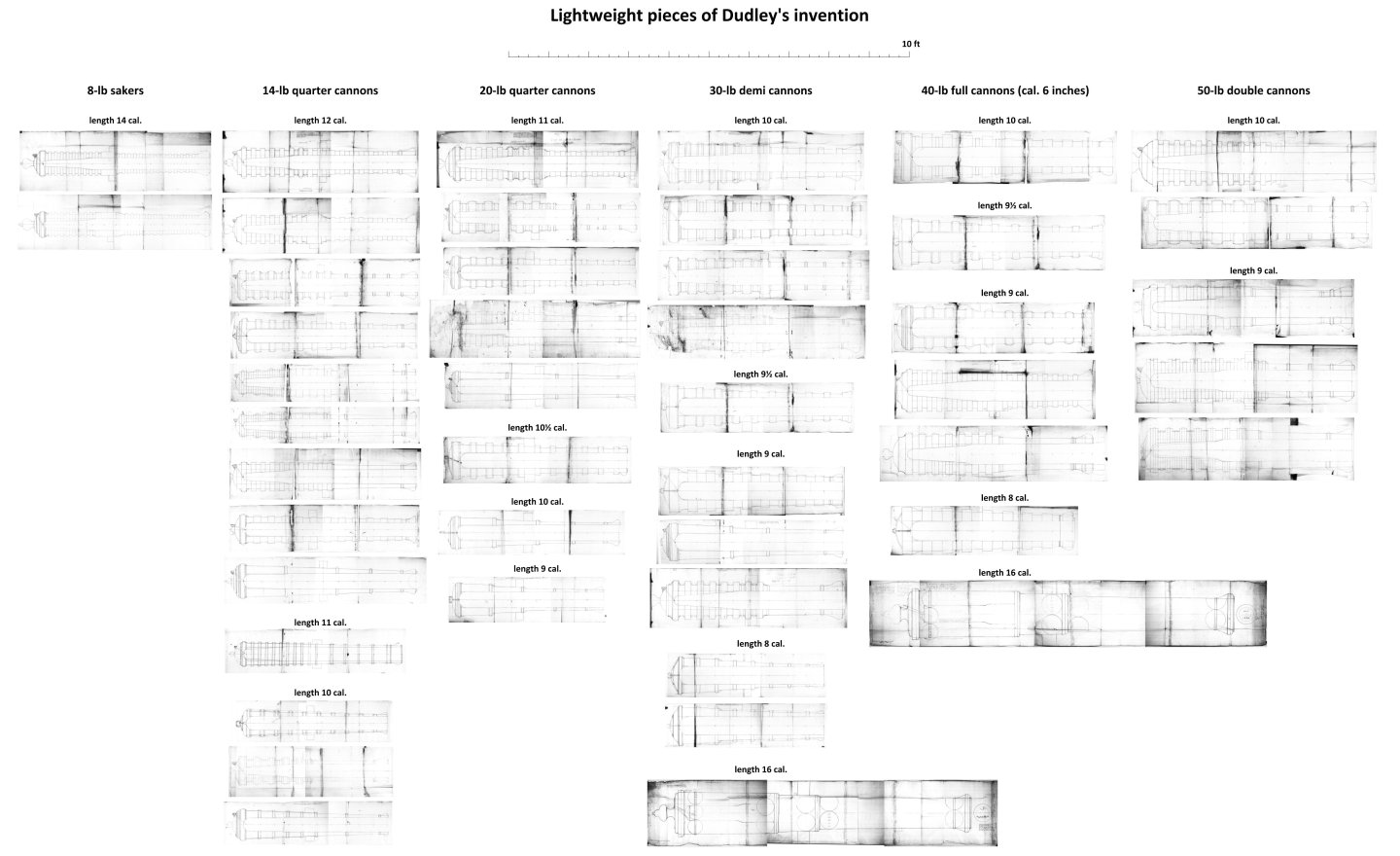

ON LIGHTWEIGHT PIECES BY THE AUTHOR
to arm the proposed vessels, with other more reinforced guns,
and still lighter ones, of his own invention.
Chapter VII.
The light pieces discussed here are of two types: The first type includes chambered quarter-cannons of 14- and 20-pounds; which have been made and proofed by the Inventor on the order of His Serene Highness the Grand Duke, to shoot continuously with powder of half the weight of the iron round shot, and therefore one must not reveal the secret of the design without the express permission of His Highness, as stated in Chapter XIX of the preceding book: The second type will be without a chamber (i.e. true-bored), of a half-cannon of 30- and a [full] cannon of 40-pound to shoot safely with powder of the weight something more than half of the iron round shot; and to fight at sea it is enough, when it is only half, where one does not fire against stone walls, but against the sides of ships, which are made of wood, which could be pierced with a good musket at close range, in the way in which one must fight at sea, as [described] in Chapter V of the Third Book; since the worst gunner at close range is worth more than the best from a distance; in any case, these light pieces will be separated from reinforced guns in the necessary places of the vessel, the latter intended to shoot at a distance, as can be gleaned more clearly from the description of application of the pieces at the end of this chapter; and to shoot with great unity and from windward, which is a great advantage in fighting at sea.
Of the first type of 14- and 20-pound cannons, the first one encircled with integrally cast hoops will weigh no more than 650 pounds of metal; the other only 900 pounds, according to the measurements carried out.
The first above piece, weighing 650 pounds, which is of 14 pound and approximately five English feet in length, will shoot continuously, with seven pounds of ordinary powder, 14 pounds of shot, and 9 pounds and 2 ounces of powder for the first proofing; this proof has already been carried out for His Serene Highness the Grand Duke; and there are two qualities to consider, that it shoots a mile and a quarter at least, and 400 paces levelled (one double pace = 5 feet or 1.5 m); and what matters most, at sea it does not recoil too violently, due to the invention of the rear-facing vent (ignition hole) at the breech, and the trunnions, which are placed half the diameter of the calibre further forward than usual; and these pieces are encircled with hoops two inches wide, and likewise one inch of thickness, and the [barrel] length will not exceed five English feet, and are sufficient at sea, despite them being chambered.
The second light piece is a quarter-cannon of 20 pounds, similar to the previous one, and weighs no more than 900 pounds, as proofed for the Most Serene Grand Duke; and there is one that can be seen, and it will always shoot with ten pounds of ordinary gun powder, and shoots even further than the previous piece; and it has been proofed with about 12 pounds of powder; and it does not recoil with more violence than the other, reinforced guns, due to the invention of the rear-facing vent and trunnions, as was explained for the previous piece; and these are good for use on ‘galeroni’ and improved galleys described in Chapters XII and XIII of the Fourth Book; and its [barrel] length will be five and a half English feet.

Remarks on Chapter VII:
It should be clearly emphasised that the lightweight pieces designed by Dudley must have been the result of experiences gained, among others, during the campaign of 1588, and were therefore suitable for the melee tactics used at the time by individual ships at close range and whole fleets, or for boarding tactics, but would not have been adequate for strictly artillery combat in a formalised line formation, usually at greater distances, which was introduced during the First Anglo-Dutch War.
Due to differences in units of measurement, the calibre of the guns given by Dudley in his work, converted to the English pound measurement would be as follows:
50-lb double cannon – 30 English pounds
40-lb full cannon – 24 ditto
30-lb half cannon – 18 ditto
20-lb quarter cannon – 12 ditto
14-lb quarter cannon – 8 ditto
8-lb saker – 5  ditto
… approximately.
The thickness of metal in gun barrels invented by Dudley, as stated by him in the text (that is 8/8, 7/8 and 4/8 calibre respectively at the breech, at the trunnions and at the muzzle, and taking into account the hoops), is perfectly standard for legitimate cannons of that era. However, in order to obtain the lightest possible cannons, Dudley apart from a dramatic reduction in length of the gun barrels, performed what was probably the worst possible treatment, which was to remove metal from the barrel in such a way that he left the hoops separated by gaps, instead of evenly and smoothly distributing the remaining metal mass along the entire length of the barrel, in accordance with the specifics of internal ballistics. Unknowingly, he further weakened his cannons in this way, because internal stresses resulting during the cooling of castings featuring uneven shapes (cross-sections), contribute to the easier cannons bursting.
For his lightest guns, the 14- and 20-pounders, Dudley ultimately achieved a barrel-to-projectile weight ratio as low as approximately 45:1, so his assurances about the modest recoil of these cannons should be considered mere wishful thinking, and moving the trunnions forward by half a calibre, intentionally redirecting the recoil force slightly more downwards onto the carriage instead of backwards, could not help much here (and besides, it would even faster destroy the carriages themselves). For comparison, the ratio of barrel weight to projectile weight, even in the already technically advanced 18th century field artillery systems (i.e. light artillery par excellence), was no less than about 120:1 for long guns in the very successful Austrian Liechtenstein system and about 150:1 in the equally successful French Gribeauval system.
The relative length of the barrels measured in calibres is not always applied consistently by Dudley in his designs; however, in most cases, it does not include the entire cascabel (that is, the base ring is not included in the length). At the same time, it is also most often the length of the bore without the terminating hemisphere, but there are exceptions here as well. Apart from that, the absolute length of gun barrels in feet seems to be given by him in the text not always in a consistent, professional manner as well, since, at least in some cases, it may also refer to the total length of a gun barrel, taken from muzzle up to the terminating button.
For all the above reasons, it can be assumed that Dudley had no previous design experience in the field of gun design and only could have gain it during the creation of his artillery ‘inventions’.
To conclude this section, it can be said that both Dudley's statements and his artillery ‘inventions’ call into question the modern narrative created by contemporary authors on this subject, which claims that English artillery was more effective and generally technically superior in the 1588 campaign, which was supposed to be based on its greater range compared to the opponent's artillery (while Dudley may not have had any initial experience as an artillery designer, he certainly had it as a user of guns). Perhaps other factors were decisive in the success achieved (for example, logistical issues, in particular the ability of the fleet to replenish ammunition), but certainly not the ‘greater’ range of English cannons, which is assumed today but did not actually exist and was even unnecessary in the specific tactical realities of the time.
Be that as it may, below are Dudley's ordnance designs of various calibres, including those mentioned in other chapters of his work. Many of the drawings bear the exact date of their creation (day, month, year), and the year is always 1635. The drawings were taken from unpublished material (there are 46 cannon designs in total) and all of them have been brought to a common scale for better comparison of their sizes:

ON THE FIRST DESIGN
of improved galleon long four breadths.
Chapter VIII.
This design by the author of improved galleons is very well suited for sailing and for fighting at sea, being four widths, or breadths long at the first wale; so they can be used well for short voyages, and even for long voyages to the East Indies, for warfare, but not for carrying large quantities of ordinary merchandise, as the large carracks of Portugal do; although these galleons by the Author will carry enough valuable goods, provisions for living, and ammunition for the number of people who must be employed on such a long voyage; and they will also withstand the fortunes of the sea very well, carrying many of the gun pieces mentioned in the previous chapter; in such a way that they will be much stronger and much faster than the other galleons and carracks of the Indies; although for short voyages they will be armed with a third more pieces, and carry a greater number of men, proportionally, they will always be faster, more stable, and more manoeuvrable in combat from windward than ordinary galleons.
DudleyRobert-Arcanodelmare-Fabbricadivascelli-printed1646_Page_25.thumb.jpg.d149188b271232fa3c48c435c3874416.jpg
DudleyRobert-Arcanodelmare-Fabbricadivascelli-printed1646_Page_26.thumb.jpg.7869bdae084935319d365eb8ef57ddce.jpg
Design of the improved galleon. Figures 6 and 7.
DESCRIPTION
The vessel will be wide across the midship at the first wale, which touches the waterline in the middle, by 40 English feet; which wale starts at the stempost and ends at the wing transom at the stern, and is four breadths long, that is, 40 feet by design; and the depth in hold will be one third of the breadth, or 13 feet and 4 inches, up to the waterline, which is measured from the lowest part of the keel itself; although with the cargo of provisions, the vessel will not draw less than 14 or 15 feet and a half deep; and the [second] wale, or string, parallel to the first one, marks this limit.
Each section [of the length], long one [ship’s] breadth of 40 feet, is divided into three bends of five ribs per bend, & each rib is divided into three parts, namely floors, futtocks, and toptimbers, and the rising [line of the floor] guides these above the keel; and the said rising is divided (shaped) into portions of a true circle [described] in Chapter IV and starts and terminates at the stem- and sternpost, as can be seen more clearly in the profile projection.
The rake (in the original text: ‘The height’) of the stempost, where the first wale terminates, will be two-thirds of the breadth, and the sternpost will be four-fifths; and there the wing transom will be 20 feet, that is, half the breadth of the hull: The height between the two decks will be six feet and eight inches, being one-sixth of the said breadth: The height of the rising at the fore quarter frame will be 1 foot and a half, and 3 feet at the aft quarter frame at number 20. The other lines, both outside and inside, which are many yet of less importance, can be easily deduced from the drawing itself of the profile projection and from the plan view, with some skill.
Of these improved galleons, the author had one built for himself, of 300 tons, to sail in the Indies, named the Great Bear, which was built in the port of Southampton in England; and this vessel proved to be very fast, as mentioned in Chapter II.
Edited by Waldemar

This invention was applied, with good success, to the galizabra S. Cosimo, & to the galeratina of the same name, of the third and sixth design, & to other vessels of the Author.
The second invention, also tried and tested by the author, is a passageway with two-and-a-half-inch thick caulked fir boards, which can be build around the inside of the ship's hold; and connected from under to the first deck, it will be four feet high and three feet wide at the top, and the passageway will be partitioned into six small rooms on each side, similarly caulked, with a small door for each one, above in the deck, so that during combat, if by chance any enemy cannonballs pass under the water, the hole can be immediately plugged, so that the vessel does not risk sinking due to the enemy's shots; and this invention can be better understood from the figure of the first design, letter G, to be applied to the four designs of the preceding square ships; & it is an invention tried and tested in two ships built for the Most Serene Grand Dukes Ferdinand I and Cosimo II, namely the S. Giovanni Battista, of the second design, and the San Cosimo, of the third.
However, it should be noted that this invention is suitable for warships on short voyages, otherwise on long voyages to India, the said passageway would prevent the ship's hold from carrying sufficient provisions for the voyage.
The third invention can be applied well, according to the test carried out, to the fourth design of frigate with a light deck (i.e. spardeck) above the first, which is gridded halfway across the width and woven in the form of double squares, so that one can walk freely on it; but by turning those squares along the sides of the said light deck, no one can stand on them, by virtue of certain long, sharp steel nails, thus preventing the enemy from boarding the ship when it is in port; since on the high seas there is no such danger against square-rigged vessels; this was done in the galizabra S. Cosimo made by the Author for the Most Serene Grand Duke Cosimo II.
The fourth invention is that the rudder of the vessel should be slightly concave on the side where it touches the water, because this will make it easier for long vessels to steer and navigate well, especially when sailing close-hauled, and down wind, as needed. This was also done on the rudder of the aforementioned galizabra San Cosimo.
The fifth invention can be seen in the figure of the mould of the fourth design of a frigate, with a low passageway in the middle of the deck, to strengthen the length of the vessel and ensure its safety at sea; this also yields other benefits that are very useful in combat; this was done in the galizabra S. Cosimo and in a pinnace made by the author in Livorno.
The sixth invention is that the pumps of the author's square-rigged vessels are fitted with iron chains, in the manner of the royal rowbarges of England, because they are more reliable and, when necessary, expel a much greater quantity of water which has entered the vessel.
The seventh is that the pillars supporting the decks in the preceding designs are sloped, according to the figures in the said designs, and not straight as usual; because these, being straight in the usual manner, are much weaker in supporting artillery and other heavy weights; and it is a very useful invention for warships, because in this way the weight of the artillery will rest on the keel of the ship and strengthen it, so that it will not be weakened so much by the fortunes of the sea; this was done in the galizabra S.Cosimo, of the third design.
The eighth invention is that the bulwarks of the author's ships for combat must be made of canvas sewn with old ropes on the inside, to be musket-proof; because if they were made of wood as usual, they would impede the movement of the ship too much, due to the dead weight, especially in rowing ships; besides, the cannonballs that pass through wooden bulwarks kill many more people by splinters and broken wood than they do with the ball itself; This is remedied by the aforementioned canvas bulwarks, in pieces that can be kept in the hold when not in combat; and therefore this invention is of great importance for combat at sea, especially for galleys and galleasses in the fleet; and so it was also done in the galerata of the sixth design.
The ninth invention is that the galerata must carry a net that does not impede rowing or sailing, and which can be raised like a tent, but not too high, to better defend the vessel in battle, so that it cannot be boarded by the enemy without great disadvantage; this net will be raised when fighting, and then can be stored in the hold.
There are other inventions, tried and tested by the author himself, which are of lesser importance and are omitted for the sake of brevity, especially since the best of them can still be seen in the preceding figures of warships. With this advice, the second volume of The Mysteries comes to an end.

Once again, I am reviewing and analysing Dudley's vast, unpublished material and wondering how best to use, comment on and describe it. There is so much diverse information, some more important than others, that the decision on the best possible course of action is not at all obvious.

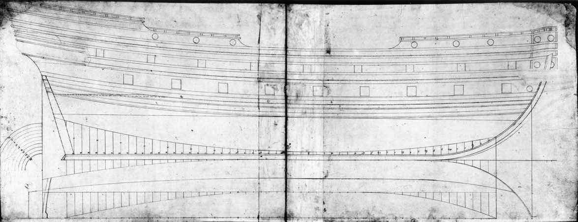

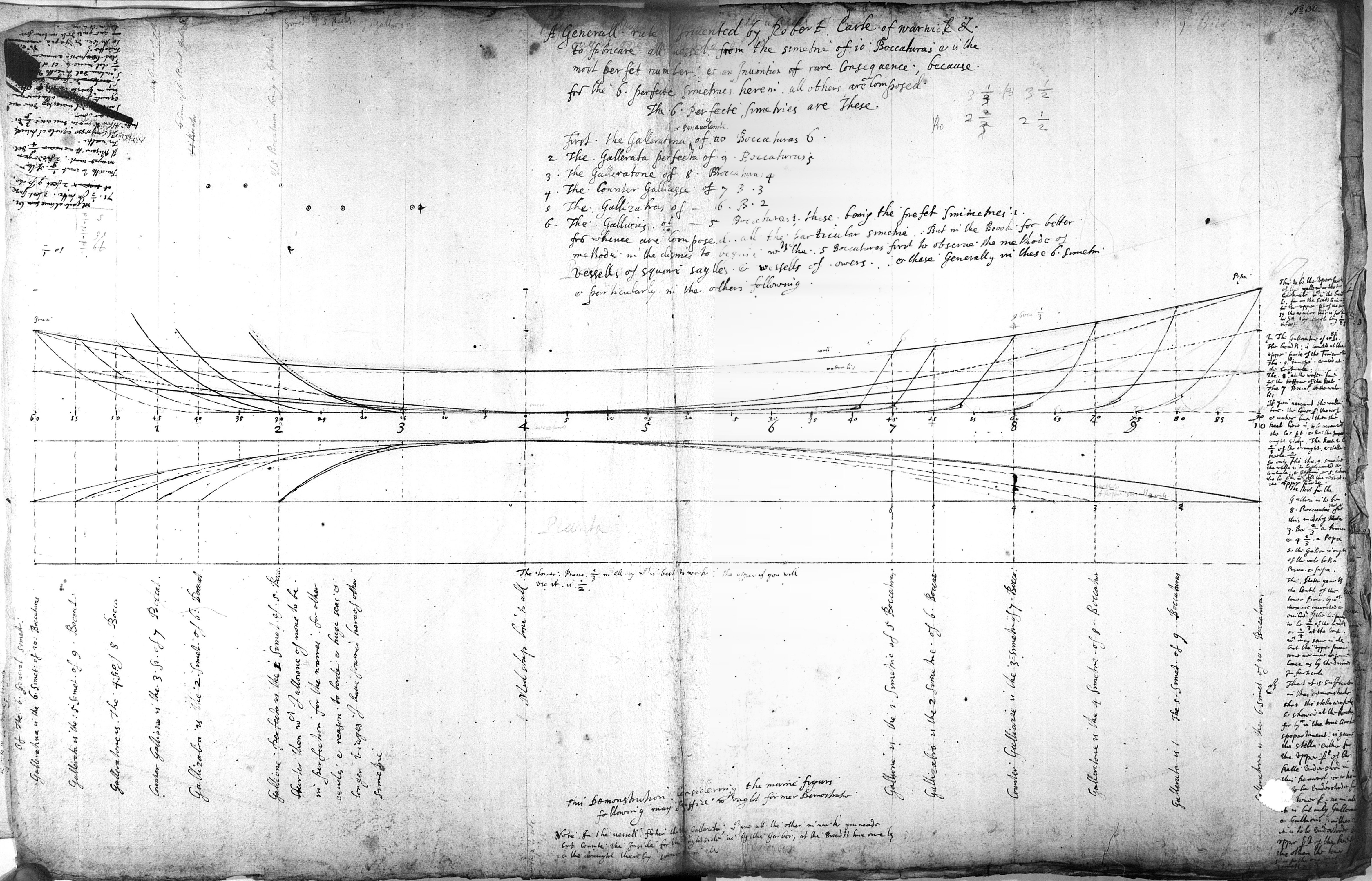

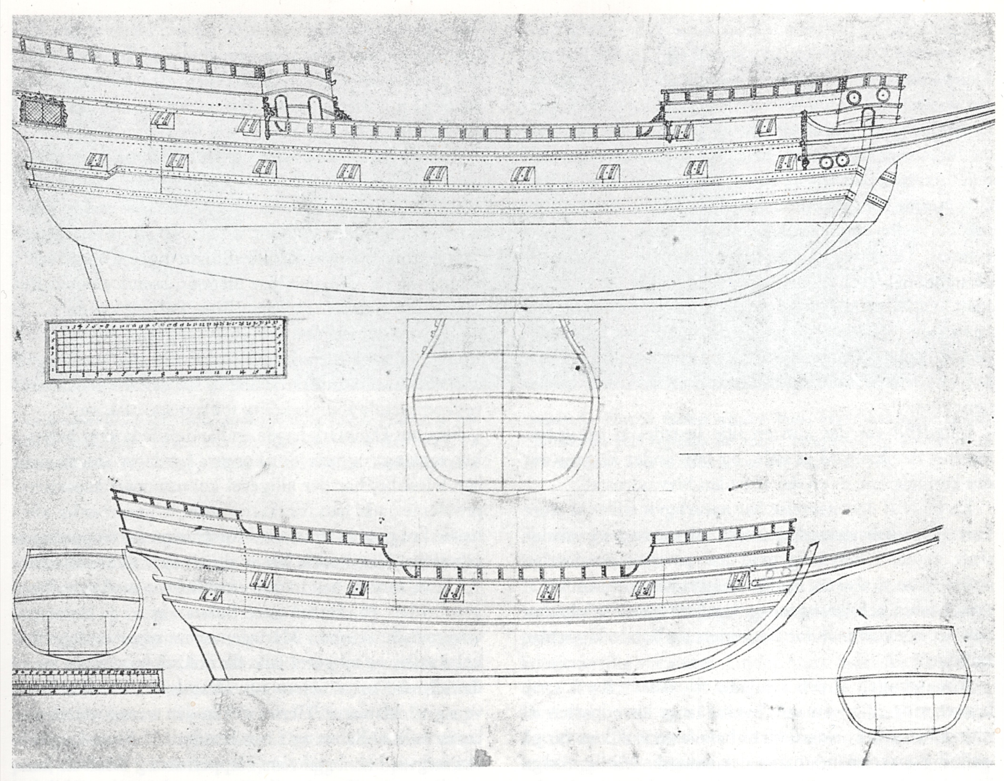

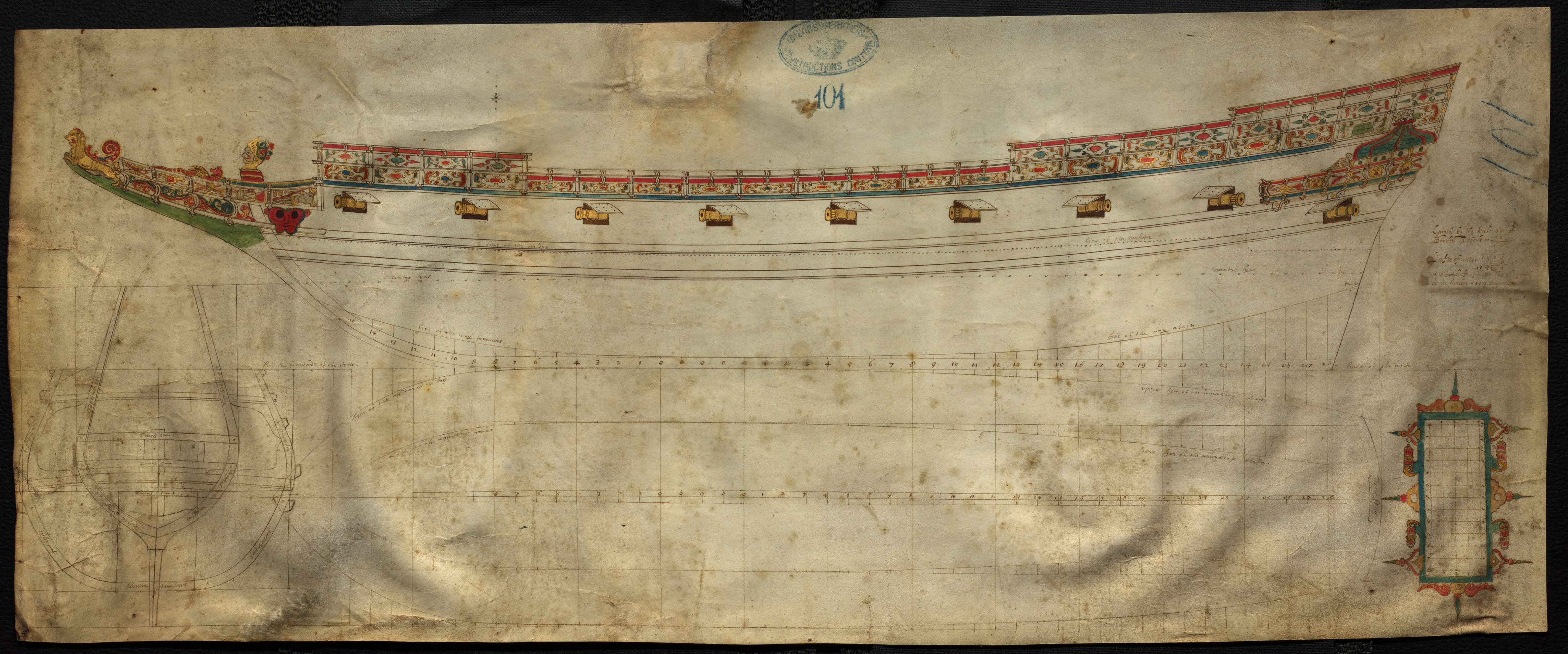

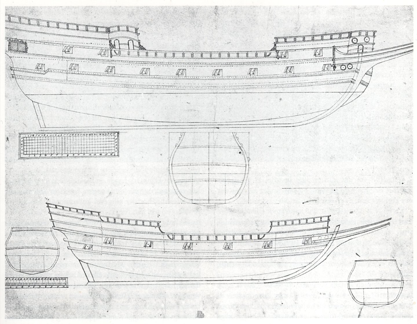

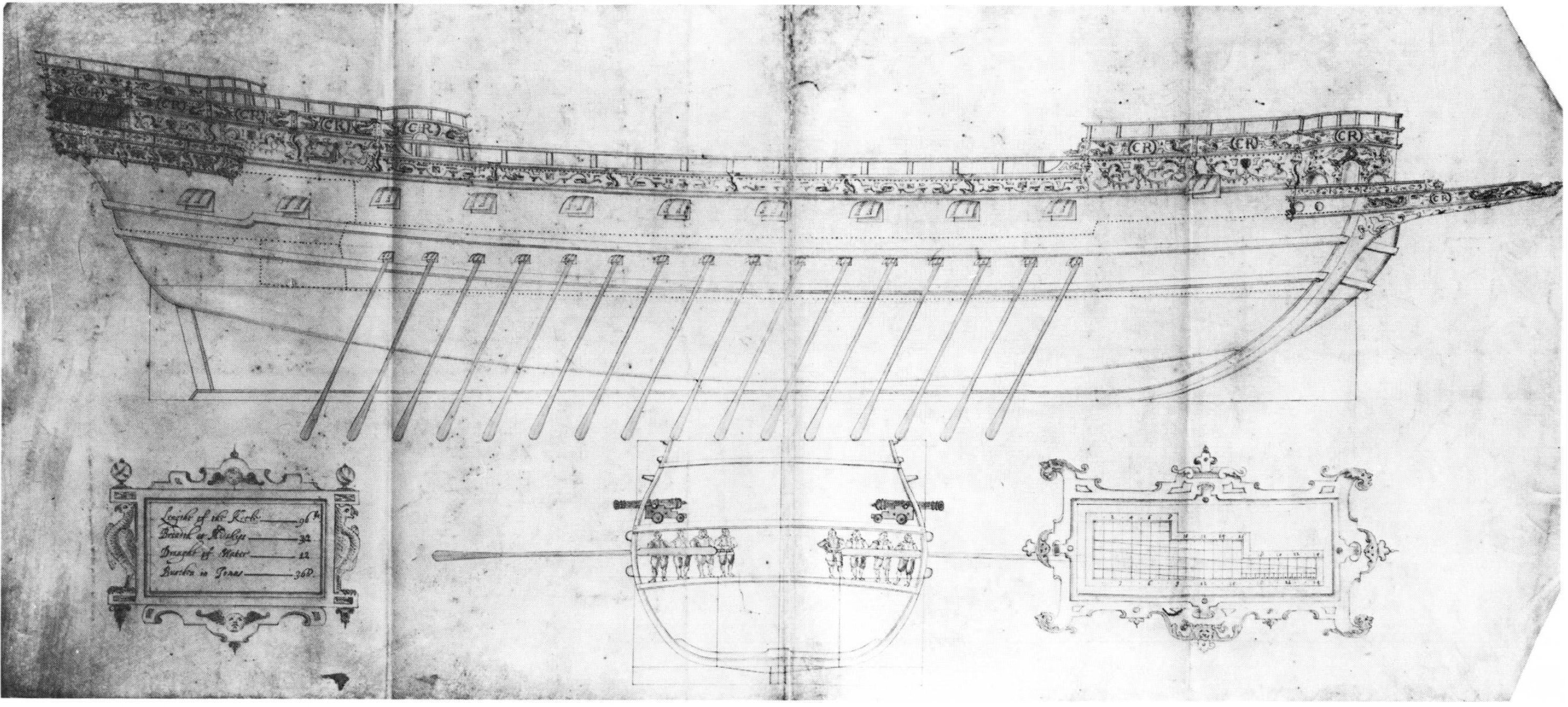

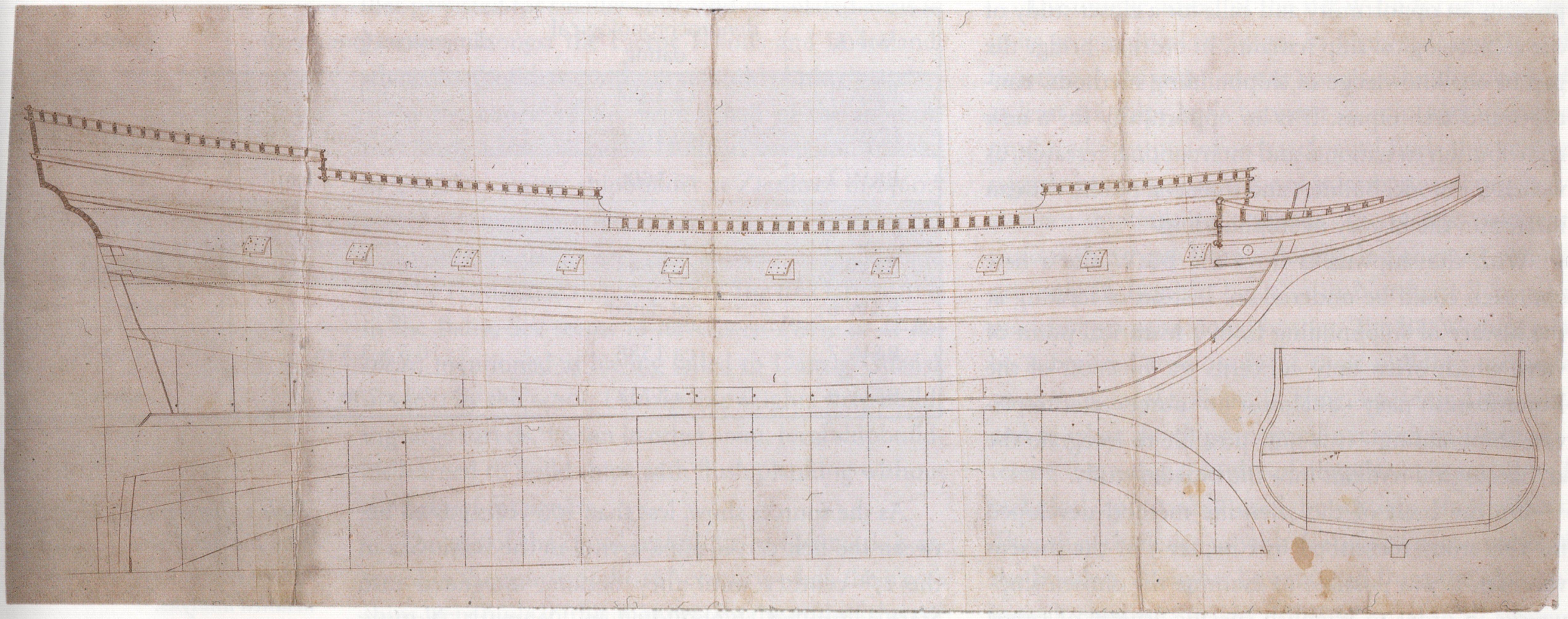

In the meantime, it is worth presenting some extant designs by British (English and Scottish) designers from that period, taken from Danish and British archives, which share the same Mediterranean design paradigm as Dudley's designs — in addition to longitudinal design lines (risings and narrowings; yet no line of the greatest breadth, just ‘boca’ line instead), there is also a master frame mould. No other frames and no auxiliary design lines such as waterlines, buttock lines or diagonals.
Project ca. 1600
Project ca. 1600
Project ca. 1600
Project ca. 1625
Project 1623
