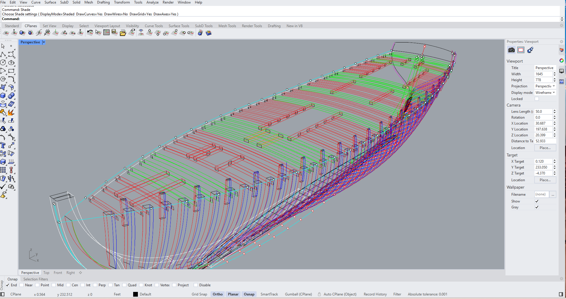

I ve done a lot of work on Tally Ho - shed buckets of digital sweat. The deeper I dig into the boat, the bigger respect I have for Leo and his crew for pulling this off - the complexity of building something like this does not really come out fully from his videos.
So where to start...
First a correction regarding the missing beam at the bow: Leo explains that there was actually a notch at the beam self that was however filled in - so the builders decided not to install this beam, probably to allow more space at the bow for activities.
I also fixed a ripple in the hull midships that is visible at the previous photos - one of the frames was wrong.

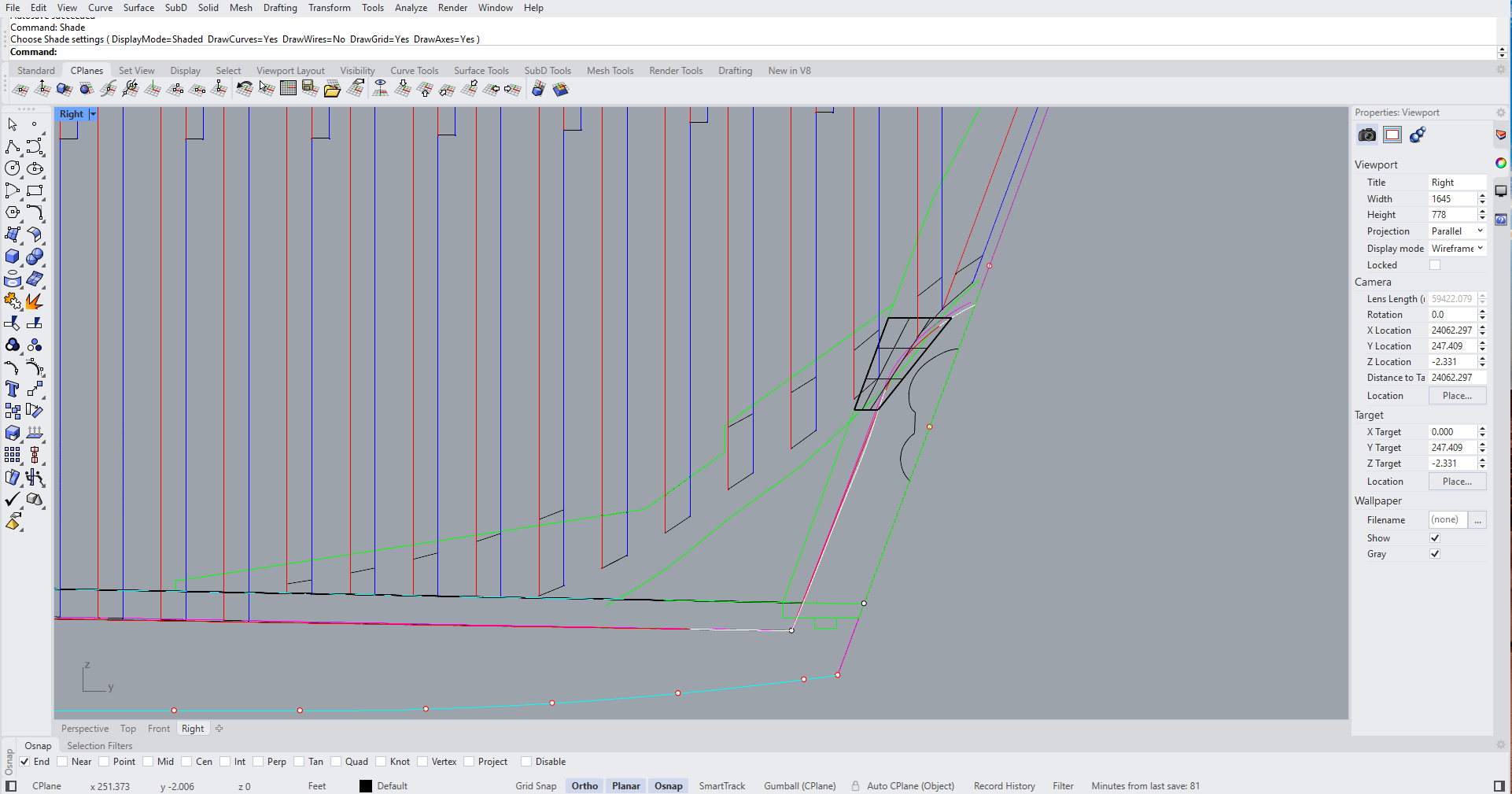

Now, no matter how much I tried I could not make the stem and sternpost as narrow as Leo's without deviating a lot from the plans and table of offsets. However, for the sternpost this is a problem. If I make it too wide, the frames will ride very high and the sternpost knee will be huge. If I make it as narrow as Leos, there is a tiny area at the stern were planking will be unsupported. So either I make the sternpost wide and trim almost all of it away which will be a huge job or add a very small filler piece - the second solution is much better and even a lot of this will be trimmed.
Screenshot(234).thumb.png.c889ece2620885d5a368ab4e89bcaef4.pngScreenshot(235).thumb.png.39b591832685c520de9c2d383a4ac373.png

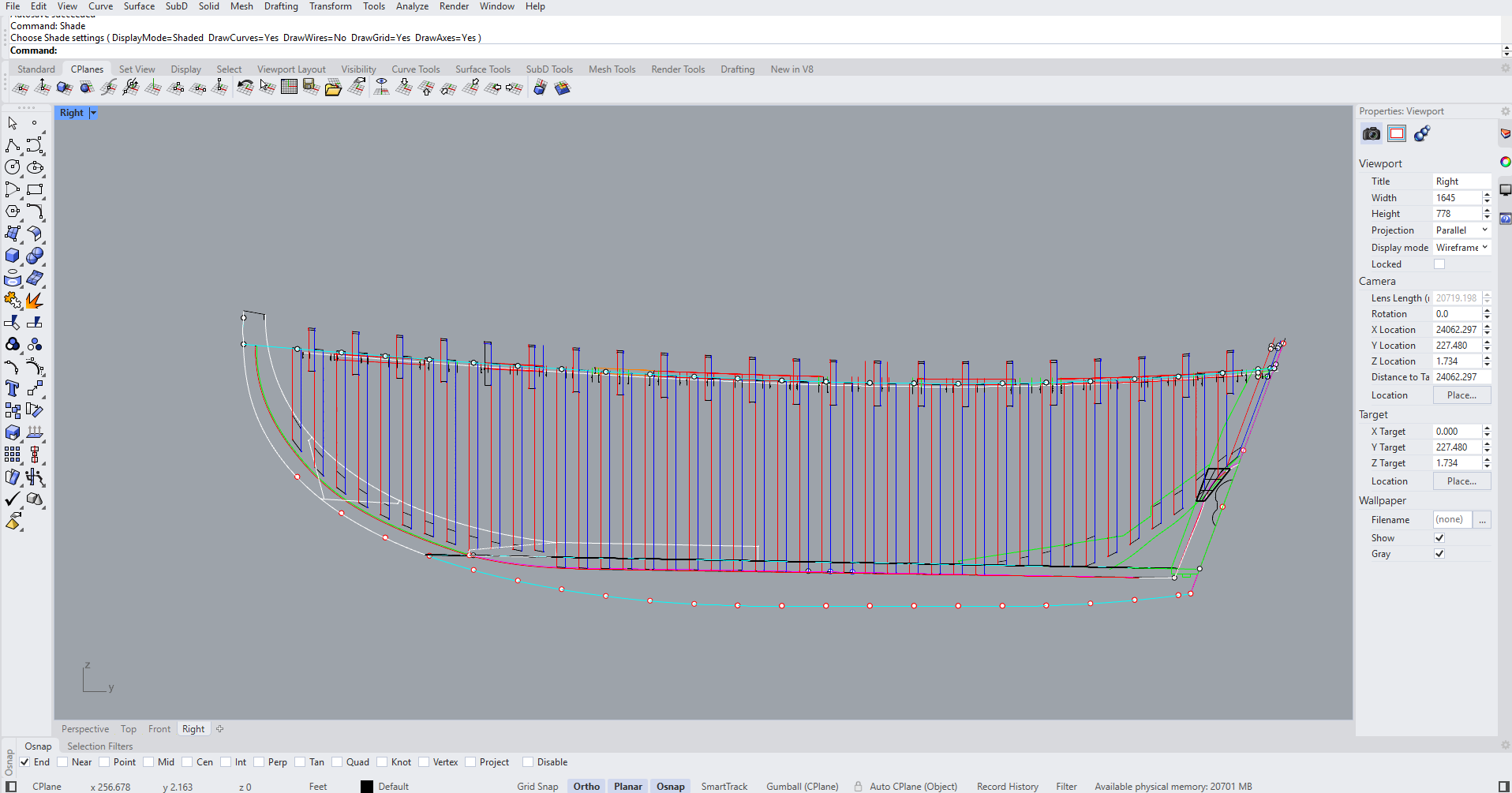

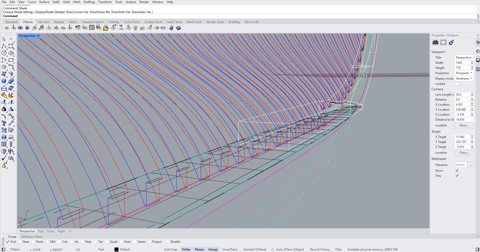

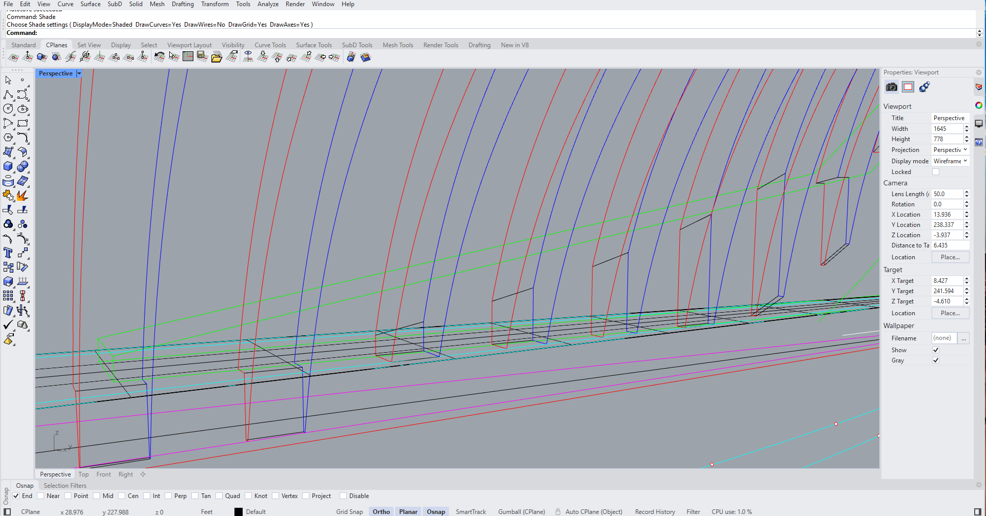

With this sorted I arranged the bow and stern timbers.
I followed Leo closely in his arrangement, almost all frames will be notched into the keel. All keel pockets will be milled before the keel goes in - I hope I will be able to pull this off as the keel will be monumentally huge. And it will have a 1 degree slope - somehow must be made.

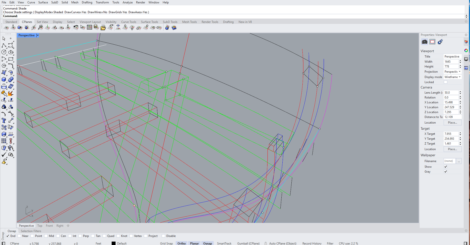

I then made the transom timbers and the transom itself - this took some head scratching. Note the aft most half beams - these will be fun to make...
Then I made all the beams and carlings, including the one that is offset from the midline at the bow. There is a bit more work that needs to be done but they are mostly ready.
I also made all the stanshions, I followed Leos arrangement pretty close but not quite - I arranged them to lie next to beams to help with placement during the build.
I now need to make the beam self and figure out how far from the underside of deck it should be placed.
This was a massive piece of work but I think now we should be ok to move on to the next stage.

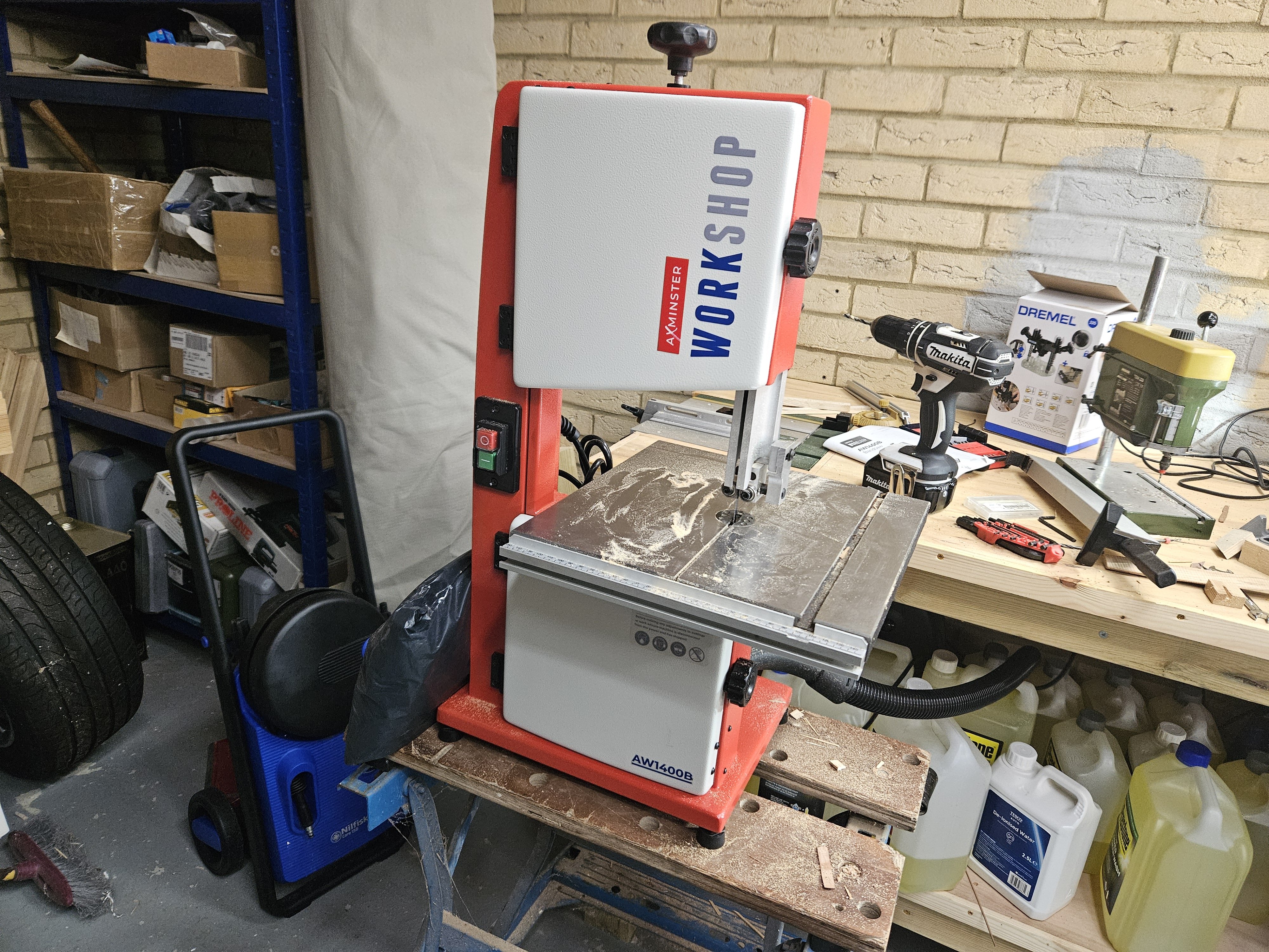

Considering how thick the timber will be, I thought a new toy is needed.
It works great - highly recommended but no doubt I will also need the very expensive Proxon thicknesser - if I can get the Admiral to authorise the investment.
