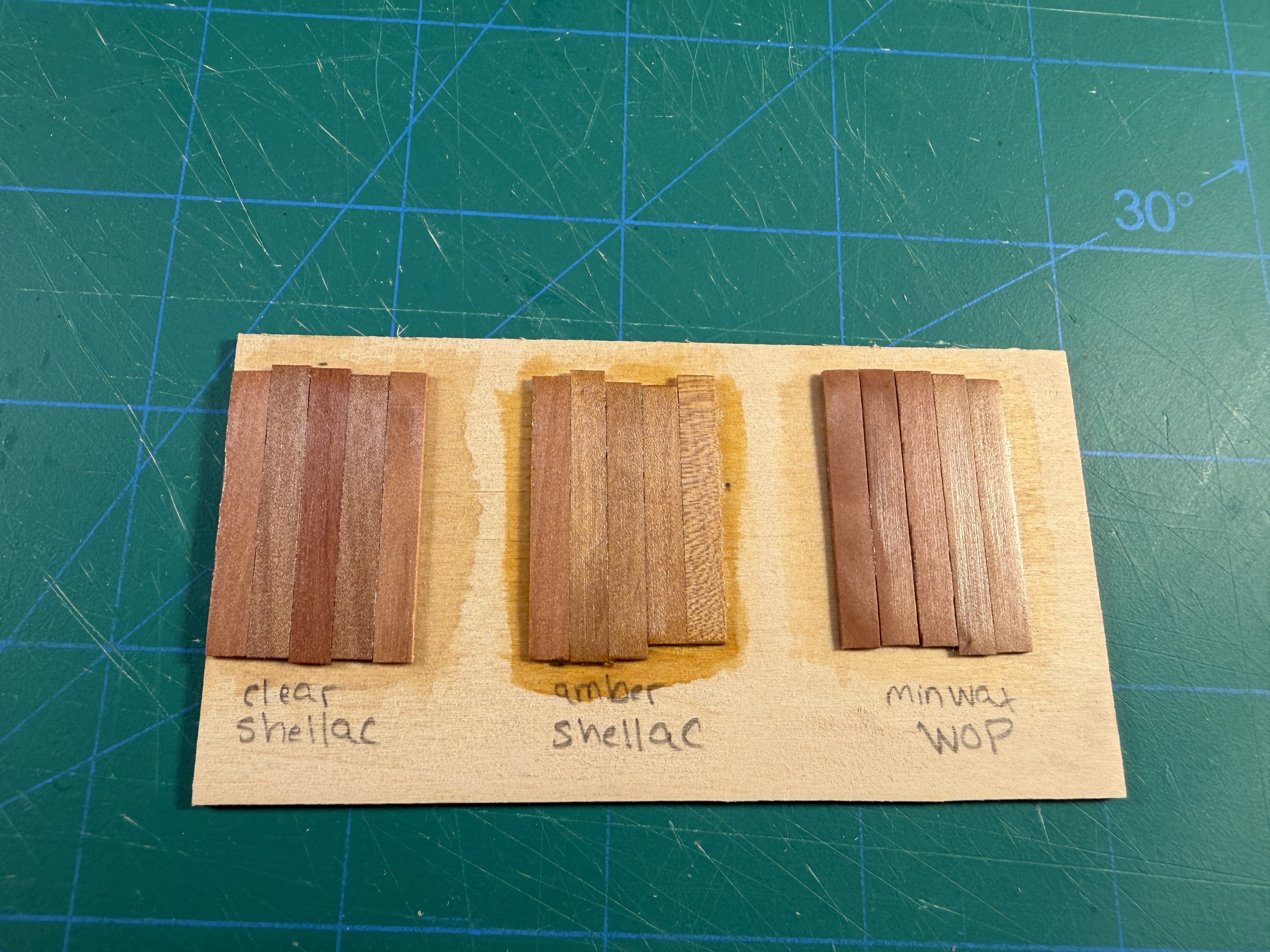

I hoping to leave the upper portion natural wood. I'm leaning toward using WOP by itself. I've seen some recommend shellac instead. Despite reading a whole bunch of posts, I haven't been able to figure out the relative strengths and weaknesses of the two options. I know shellac is dissolvable with alcohol. And I believe you can use PVA glue with shellac, but likely not to WOP. The planking is pear, so I know I don't want to use a stain. I've seen some recommend a tung or danish oil, but some posts have recommended against using those.

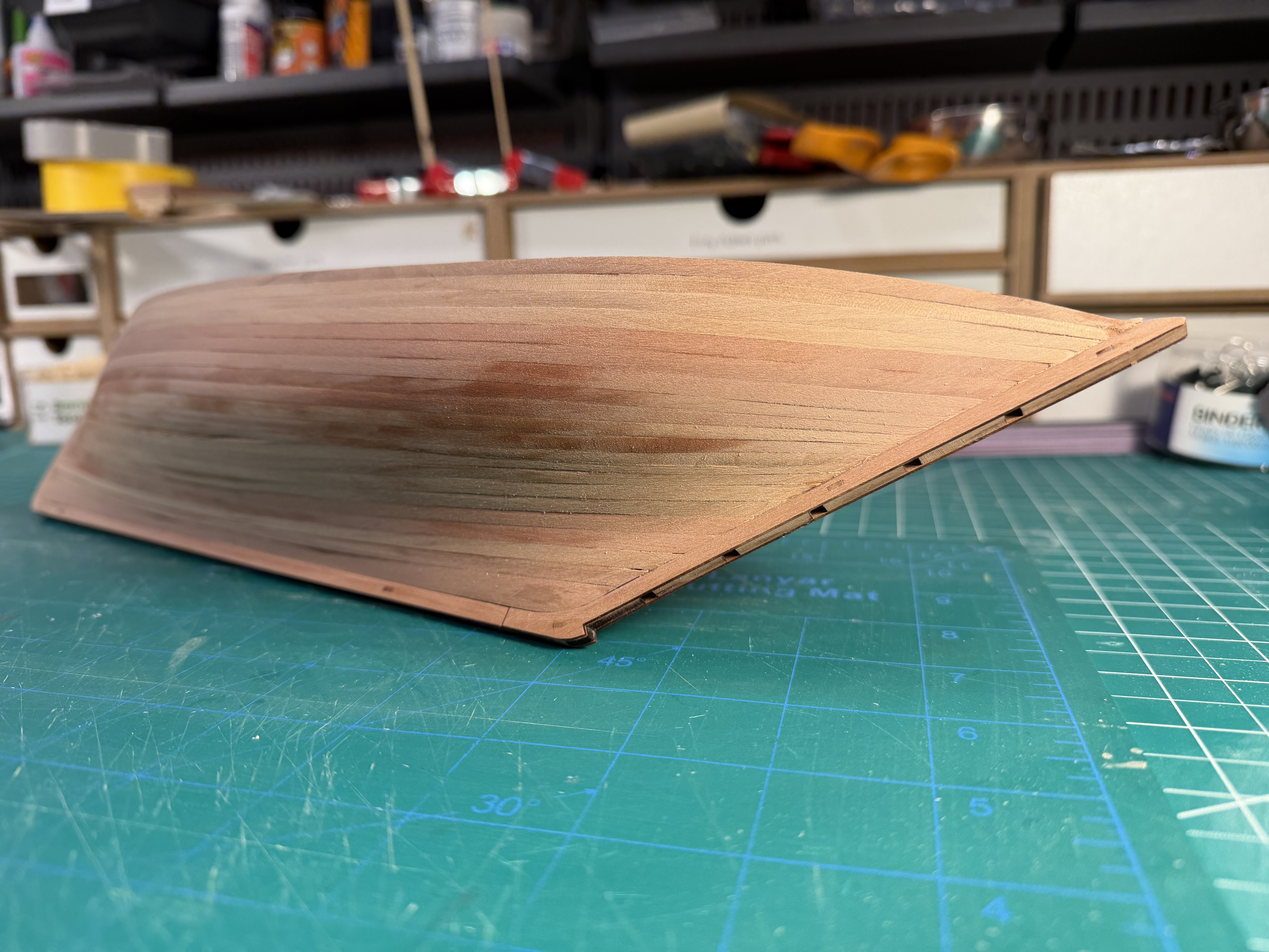

Two coats each of clear shellac, amber shellac, and WOP (on pear wood that’s the 2nd layer of planking). The amber is my least favorite.
I think I like the clear shellac the most - and it has both the advantage and some would say disadvantage of coming off with alcohol). But that could be more the particular strips of wood than shellac vs. WOP.
I have not been able to get a clear sense of whether shellac or WOP is better - and have seen  completely opposite recommendations about doing WOP over shellac, from never do it to do it. Lots of posts with strong opinions here and elsewhere. If anyone has objective thoughts on (1) shellac, (2) WOP, or (3) both, I’d love to hear.

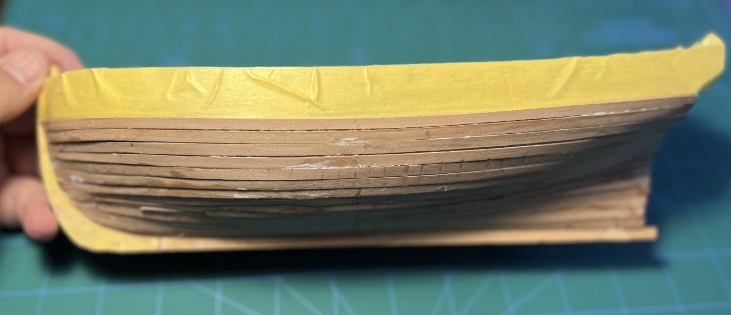

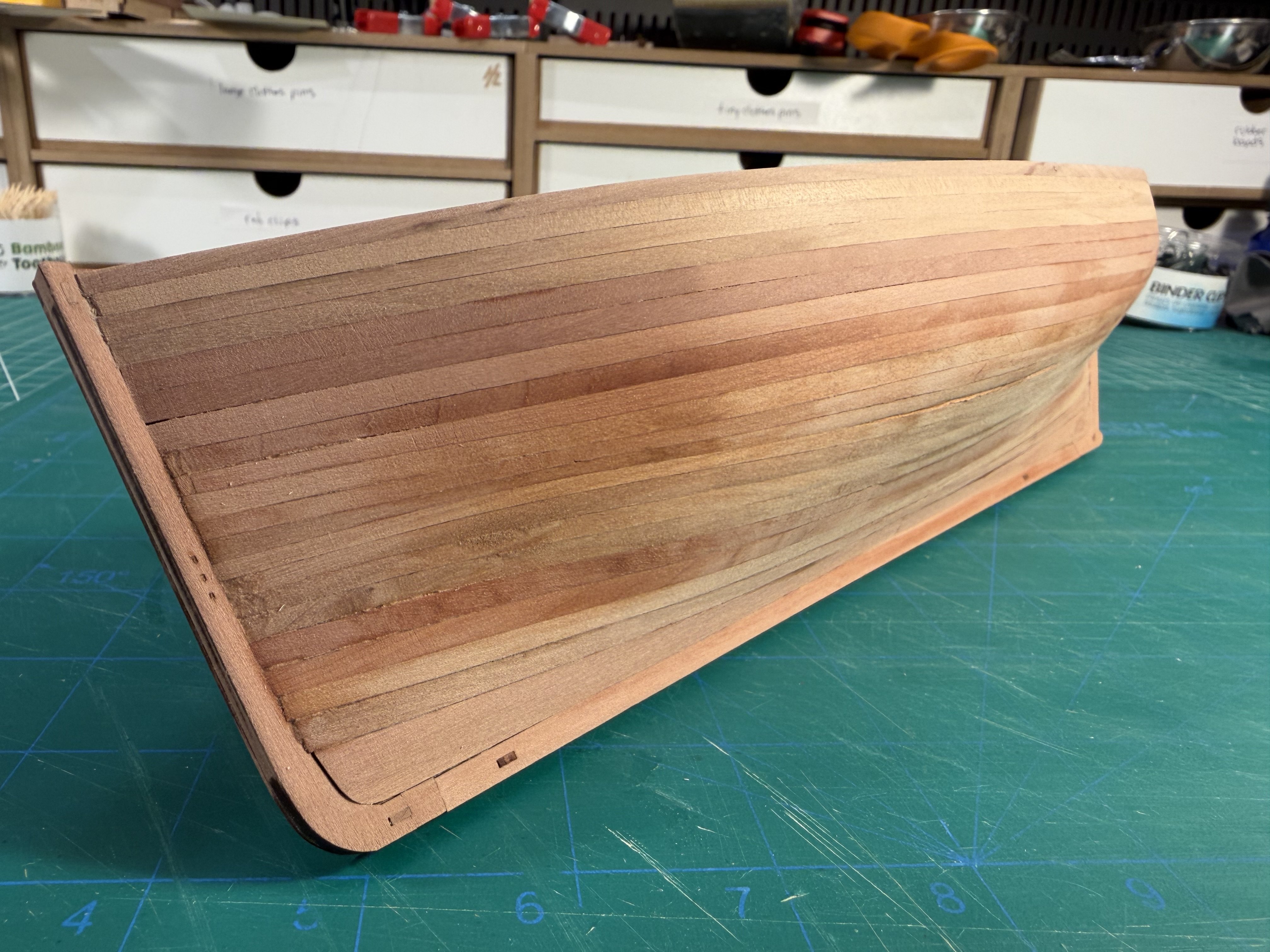

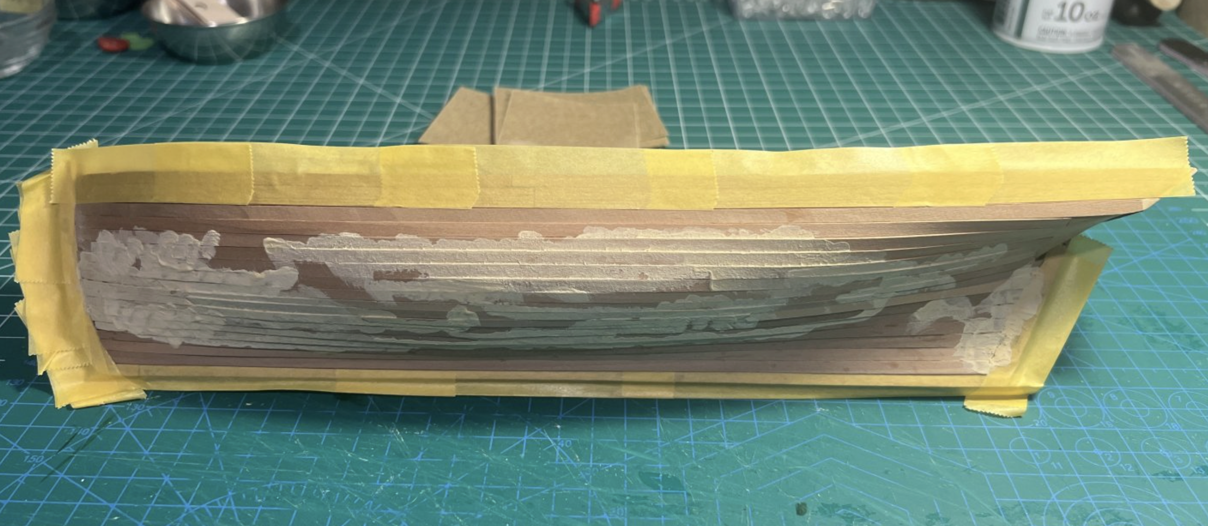

I pulled a screen shot from my first (Sherbourne) and second (Ranger) planking. I realized I didn't have a shot of my Ranger before I used some wood filler. The top photo is my Ranger (with the filler), second photo my Sherbourne (my first model).

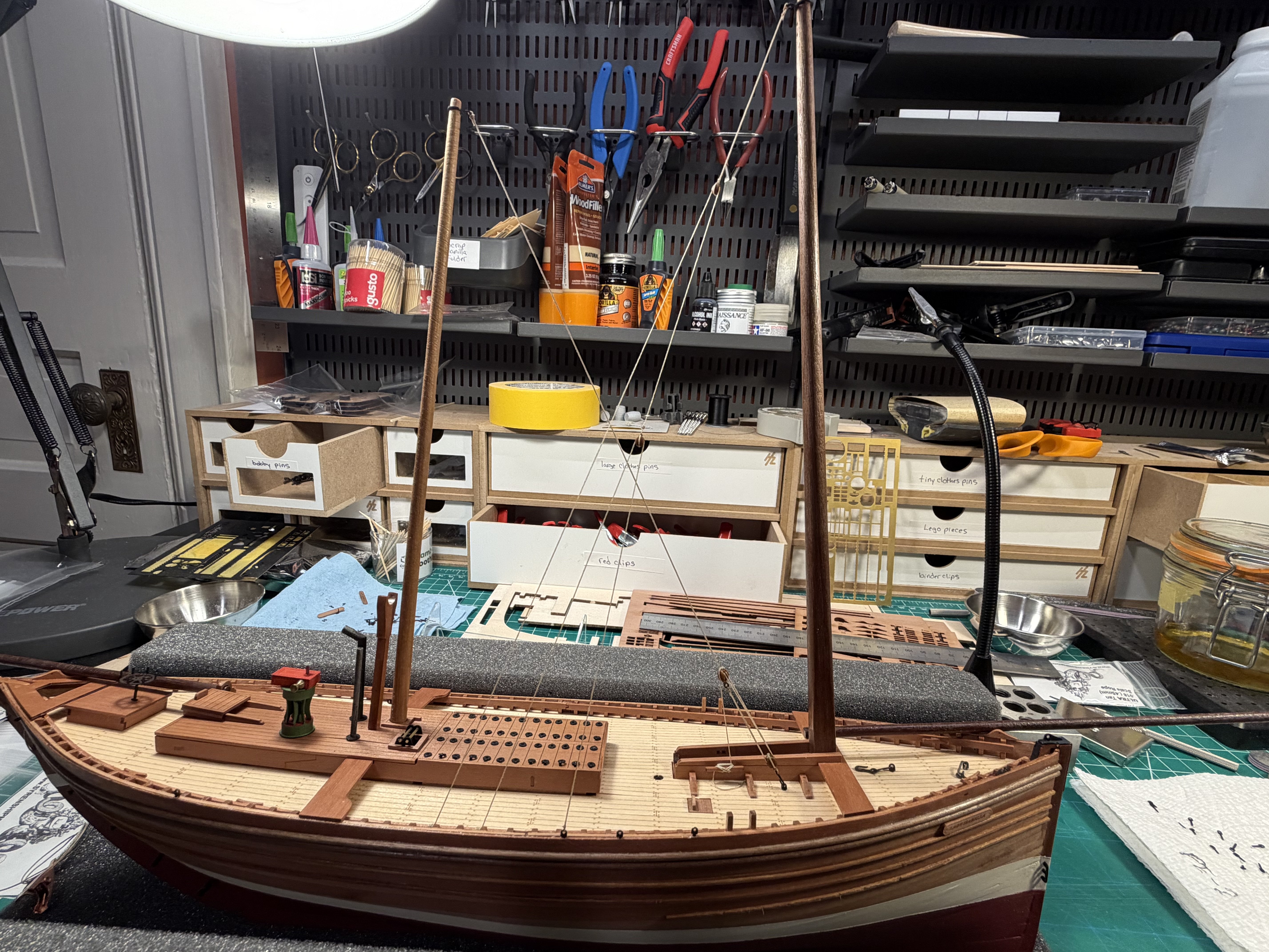

After sanding the hull, I decided to paint the bottom and leave the top unpainted and shellaced. Here I have also added the rub rails and I’ve worked on some pieces that will be added to the deck.
(I used a clear shellac, which nicely darkens the pear just bit.)
