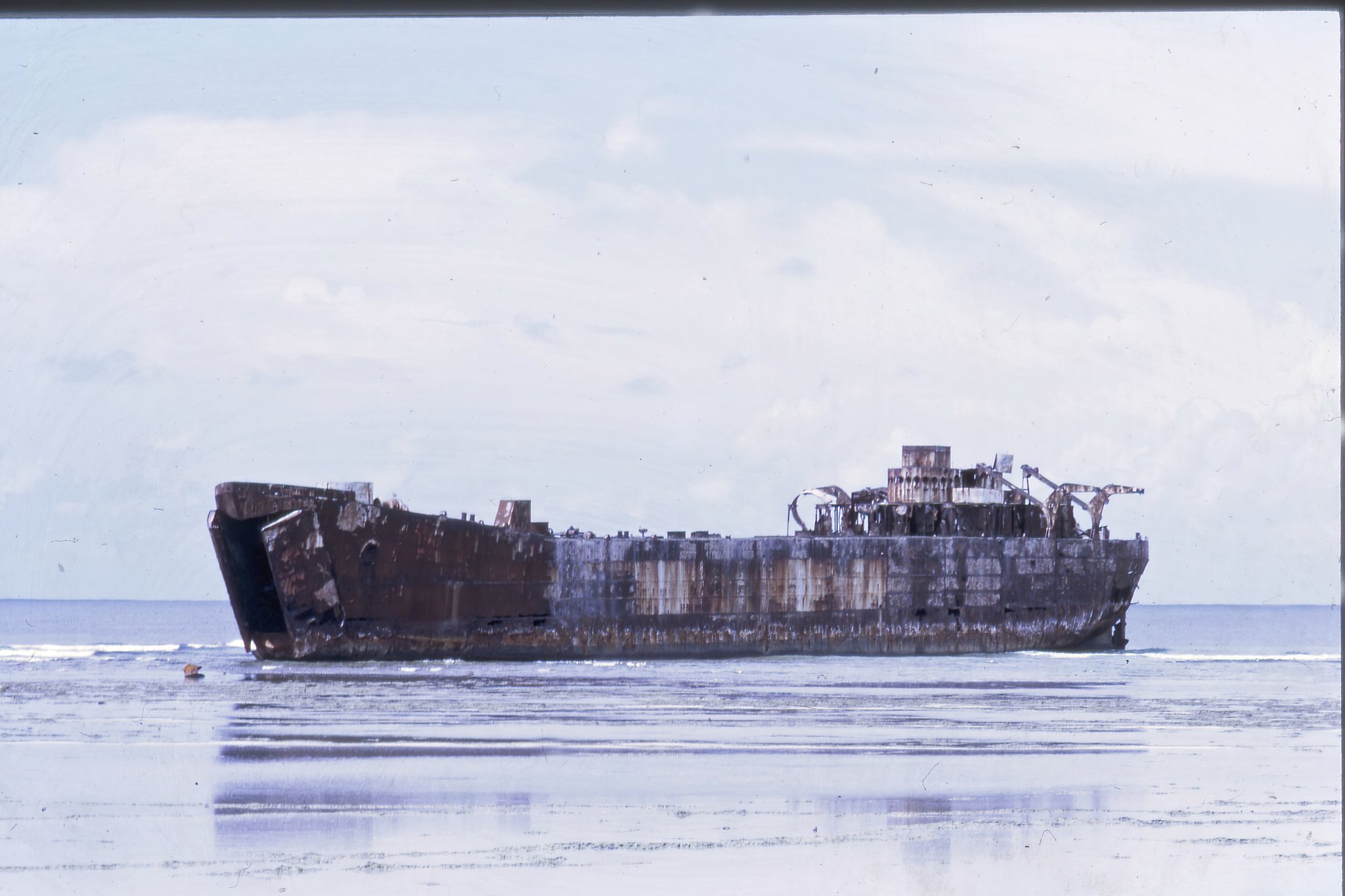

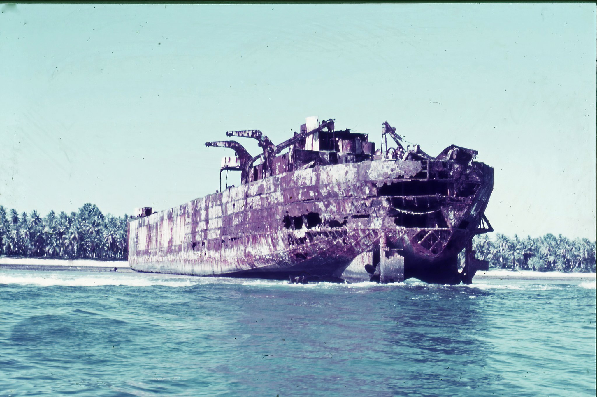

By the way, as you're working on an L.S.T. (I always thought that was an acronym for 'large slow target' 🙂), I thought these images might be of passing interest to you. When the American military occupied Nanumea in early September 1943 they brought their forces in a n L.S.T., which they unfortunately beached just a little too hard on the unforgiving coral reef and, as far as I know, it's there to this day. These images were taken in 1971.
John
