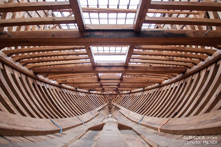

Is this a second replica of this iconic ship, built by the Basques themselves? The video seems to show that the hull of the replica is much too full, especially at the bow, in the gripe area, for a ship of such short relative length. This suggests a very leeward ship that does not hold its course, which, incidentally, is quite typical of today's replicas of ships of this type and from this period. Yet, in this particular case, almost the entire hull of the original has been preserved, which could have been used as a model, and it is unclear why its lines has been so badly deformed to the detriment of the replica's sailing properties.

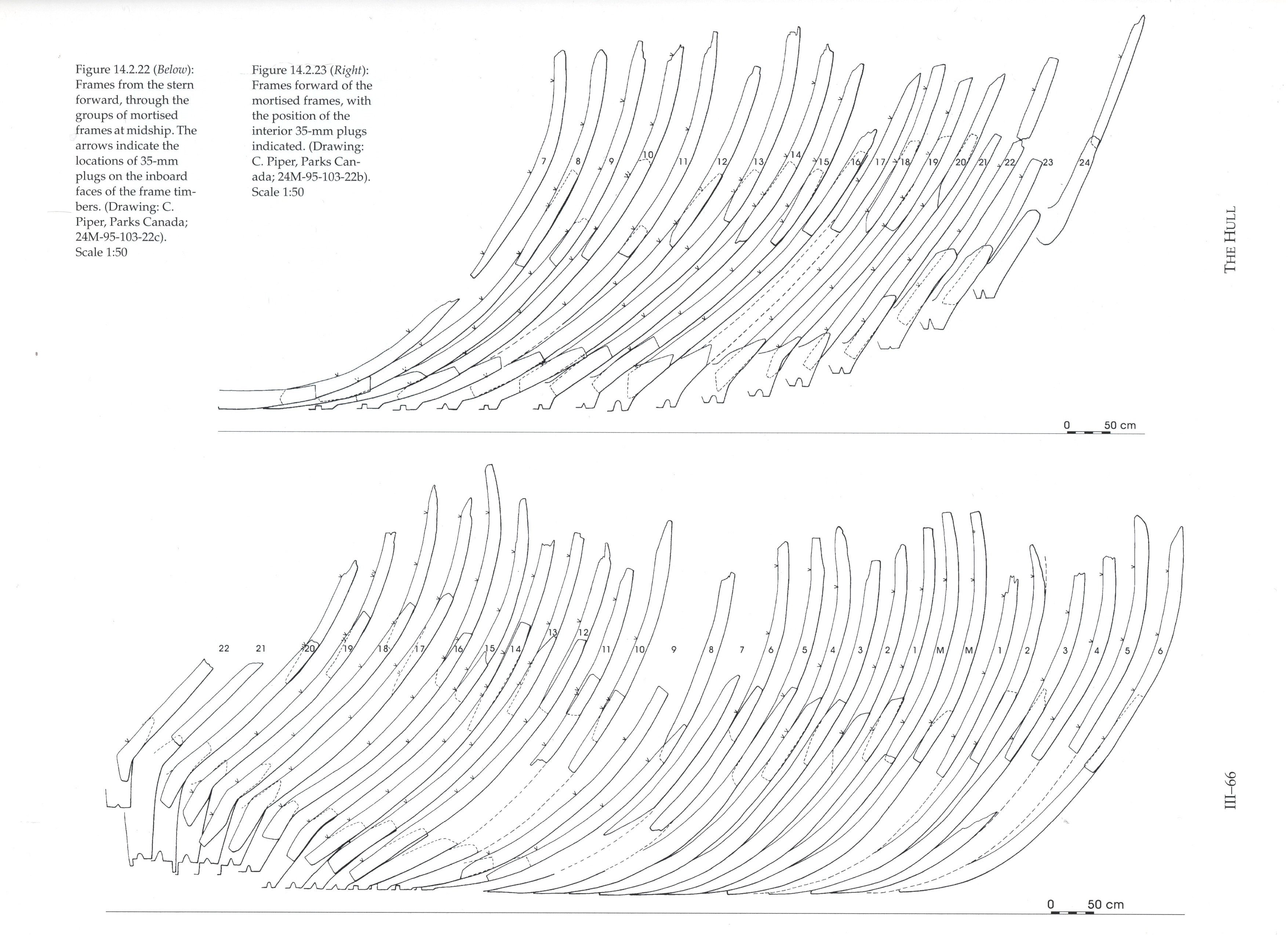

You are right that almost the whole structure of the ship was recovered from the seabed, including the timbers in the area that concerns you -- around the gripe. However, the parts were raised individually (unlike Mary Rose or Vasa) after centuries of distortion of wet wood pressed down by the weight of assorted stuff on top. It's been a long time since I read the report but, taking a quick look now, I think the reconstruction model started with a study of documented design methods. That likely means that the shapes of the timbers were adjusted to match expectations, as much as expectations were adapted to match the timbers as recovered and measured. Still, the forward area of the published lines doesn't look full at all to me.
So either:
1: The shape as seen in the video is misleading, because of camera angles and focal lengths,
2: The builders did not follow the lines as reconstructed by the archaeologists, or
3: The archaeologists, decades ago now, did not interpret the historical sources as reliably as you now can.
Or maybe all three, to some degree?
Trevor
Indeed, I wish it were just an optical illusion caused by the black colour of the bottom, which literally devours light. When it comes to assessing the sharpness of shapes, this can of course be considered quite subjective and relative. Relative, because a sharp bow for relatively long hulls may not be sharp enough for very short ships, such as the San Juan. Either way, I would be interested to see the results of sailing tests of the finished replica in this regard.
Unfortunately, archaeologists have not made a conceptual reconstruction of this important wreck, or at least they have not published these attempts and their results in a multi-volume archaeological monograph by Parcs Canada. The published lines plan is merely the result of smoothing the hull shapes by synchronising cross-sections, waterlines and possibly other lines of this kind (apart from the construction of a 1:10 scale archaeological model, in which the shapes were faired by eye), but this is not how ships were designed at the time and cannot be considered a conceptual reconstruction, but only an attempt to approximate the original shapes using later methods.

At first, I did indeed think that it was the second replica, precisely because of the long time that had passed since construction began. In these circumstances, I referred to photographs from the construction site, where this very aspect looks much better than on the video. And most importantly, it is close to the original. Below are the relevant graphics for comparison. Anyway, I am looking forward to seeing the results of the sailing trials of this replica.
