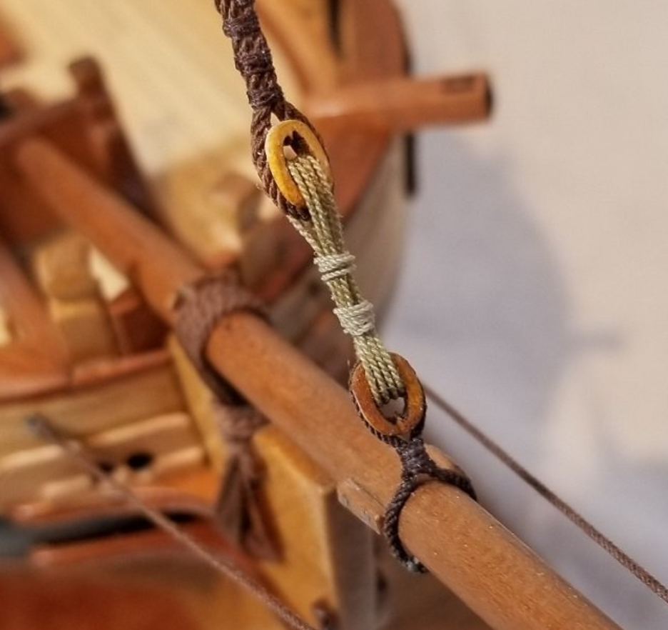

Here is how it looks on my Resolution.  These are 'hearts' but the bulls eyes would be rigged similar as far as the lanyards go.

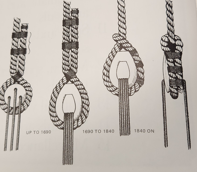

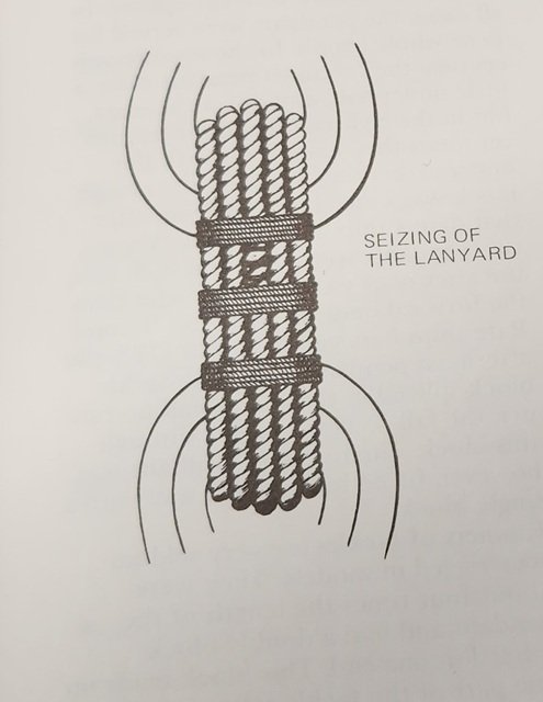

The last two pics are from Lees.  Again, showing hearts.
I can't seem to find specific examples of rigged bulls eyes. Hopefully others will chime in.
The number of loops would be determined by the size of the line.  I would think maybe 2 or 3 max on a bulls eye.
