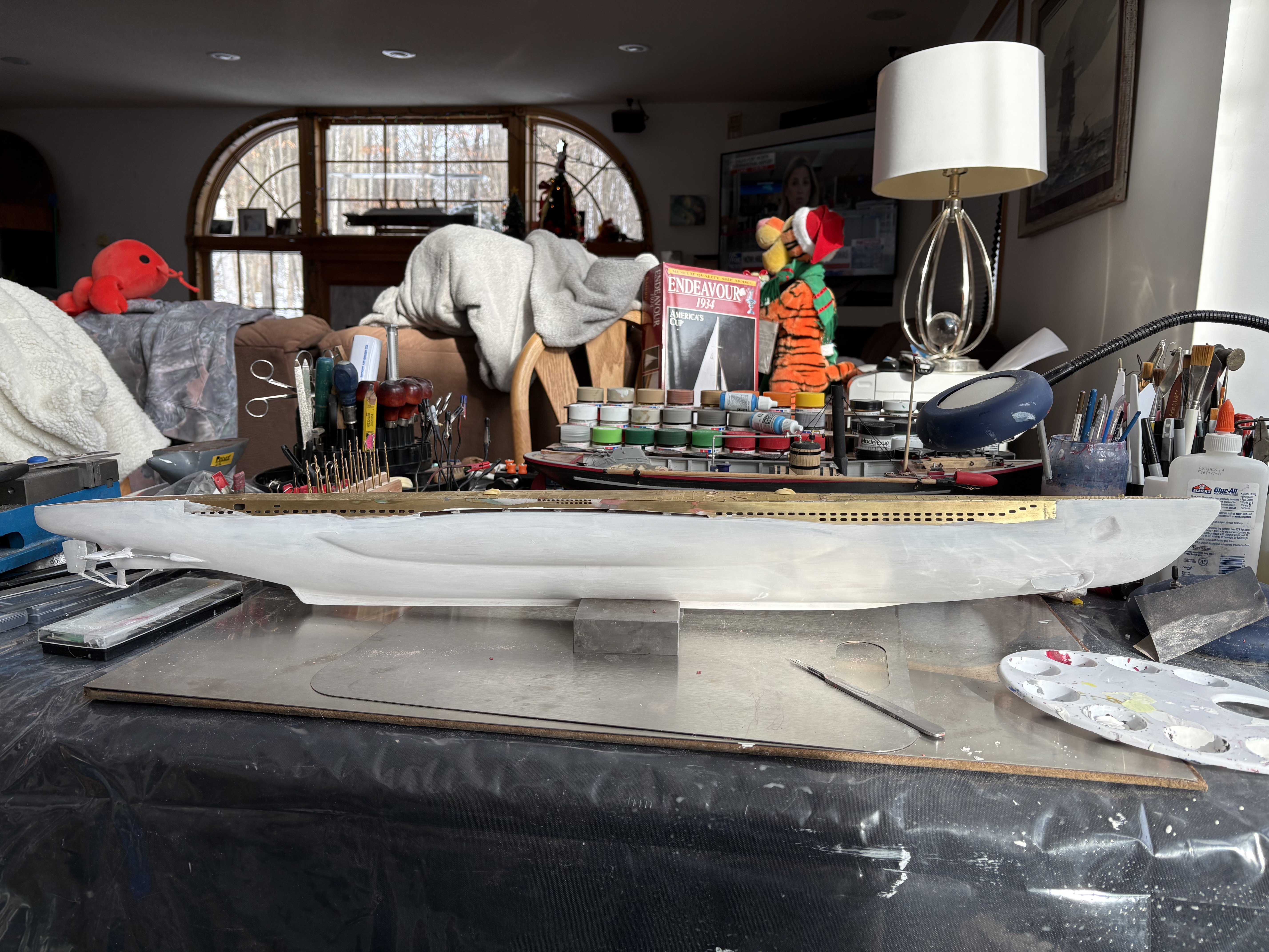

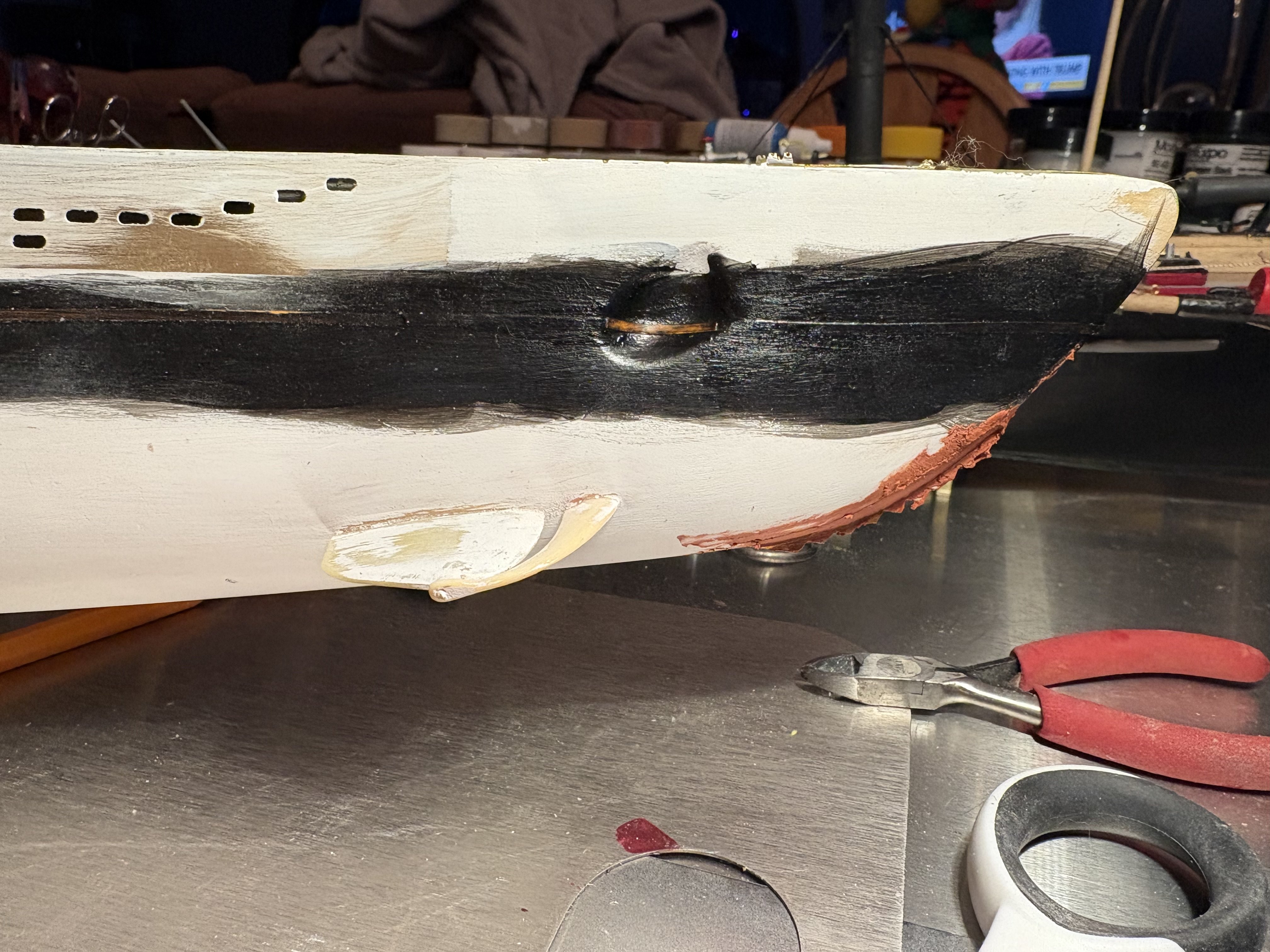

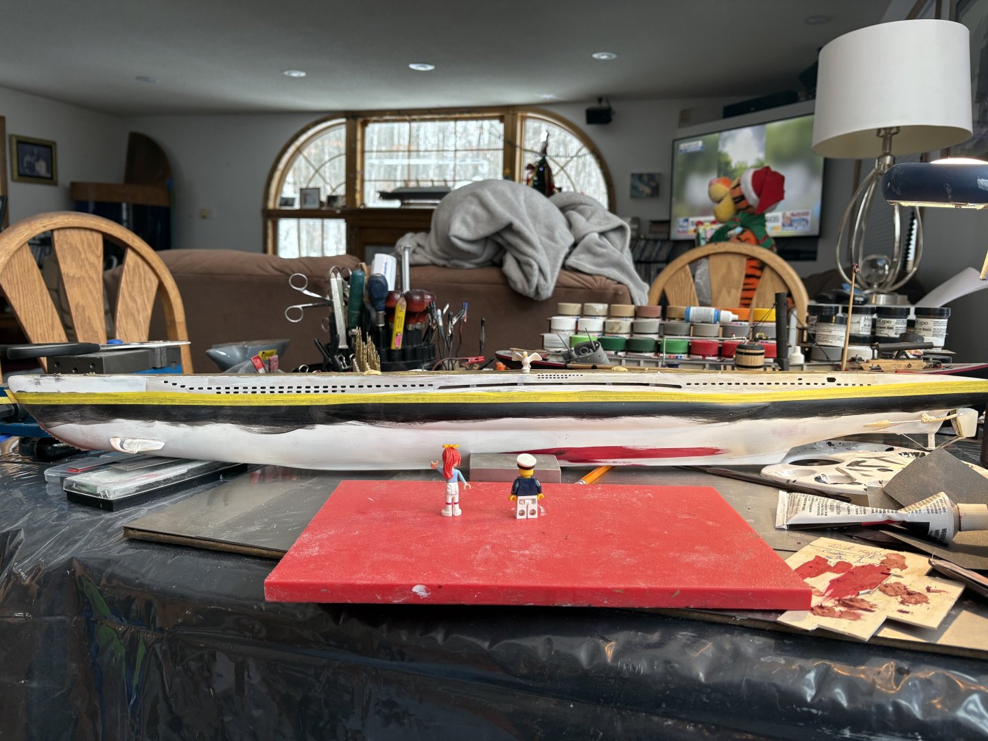

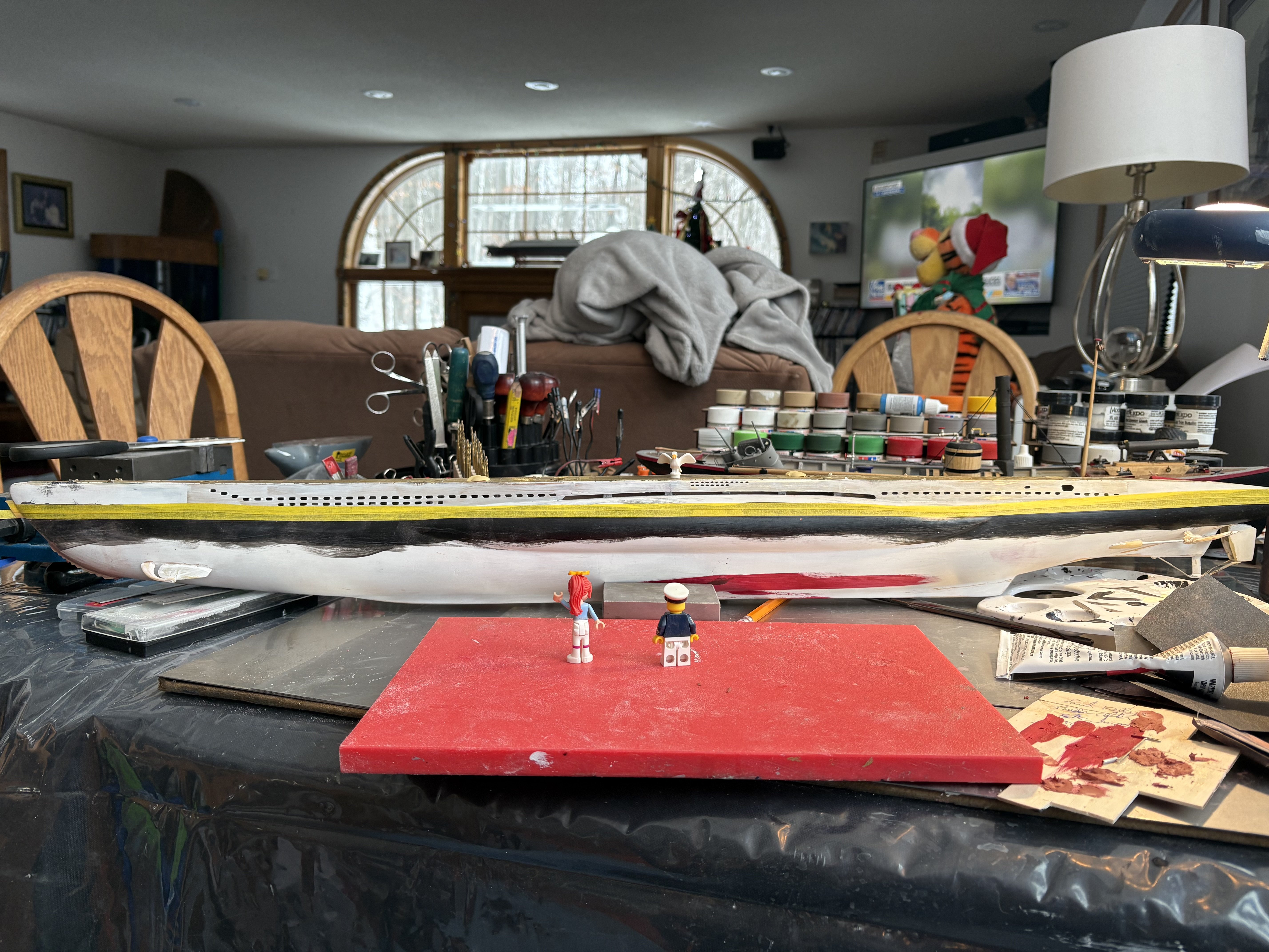

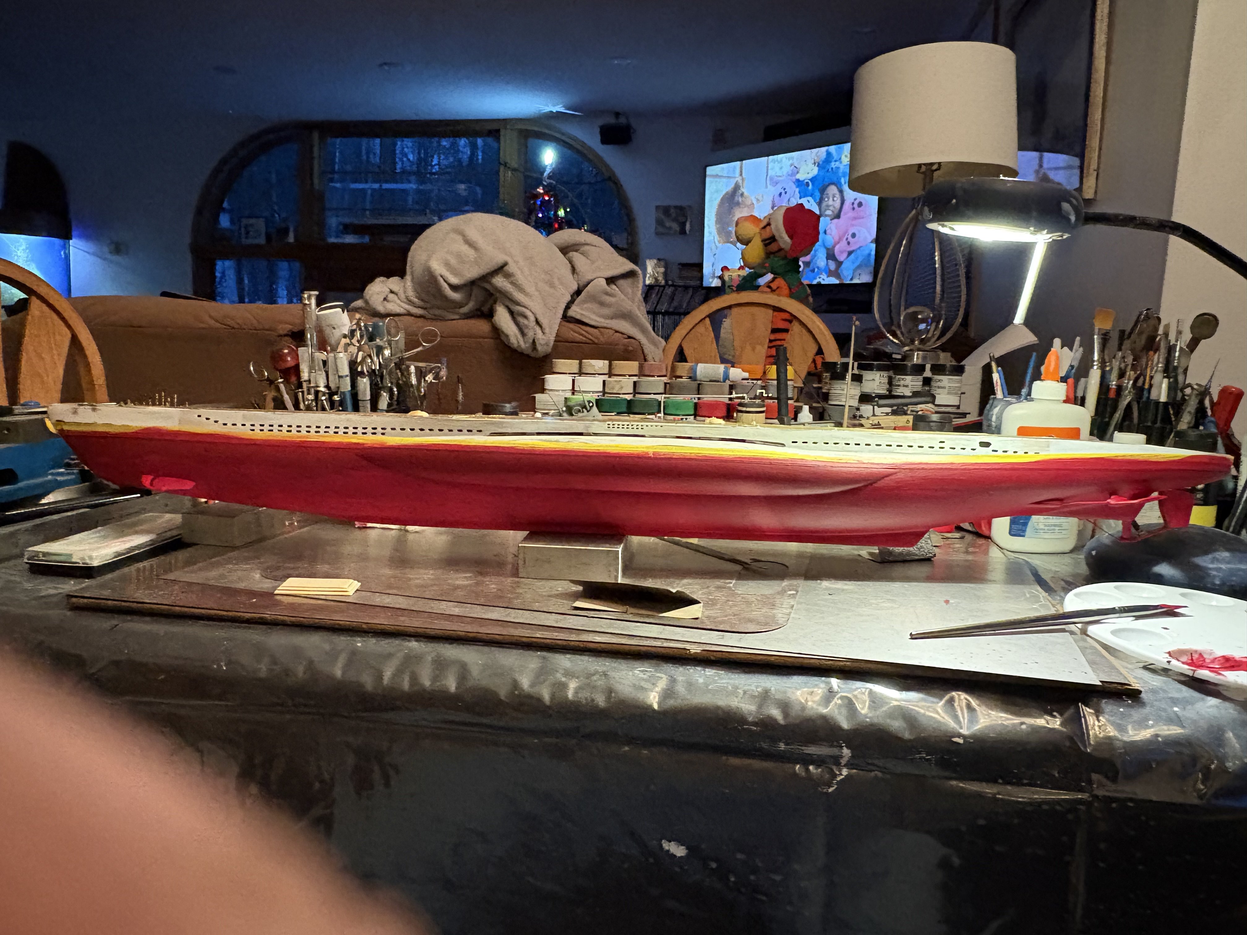

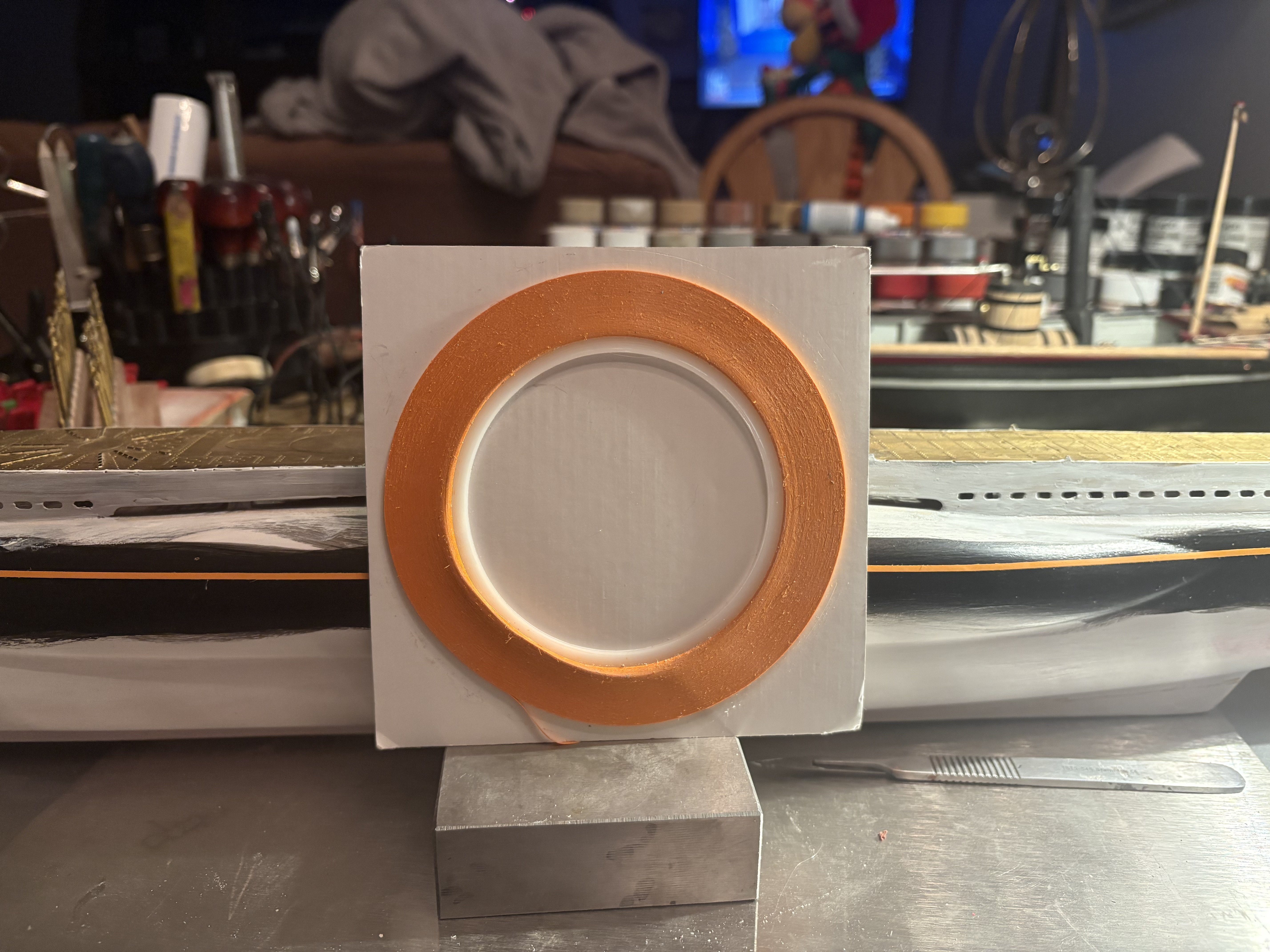

Sun is just coming up with light snow in the sub shipyard. Crew is working on the waterline. 1/16” 3M Vinyl masking tape has been applied over the black painted yesterday. The tape was then painted over with the same black to seal it and set aside to dry. When dry the crew will paint the hull bottom dark red. A brass cutwater was added to the bow and blended with the hull with red spot putty.
Morning update from the AdmiralIMG_4420.jpeg.9d94260a71f309a7b66d99f8049bfa63.jpeg

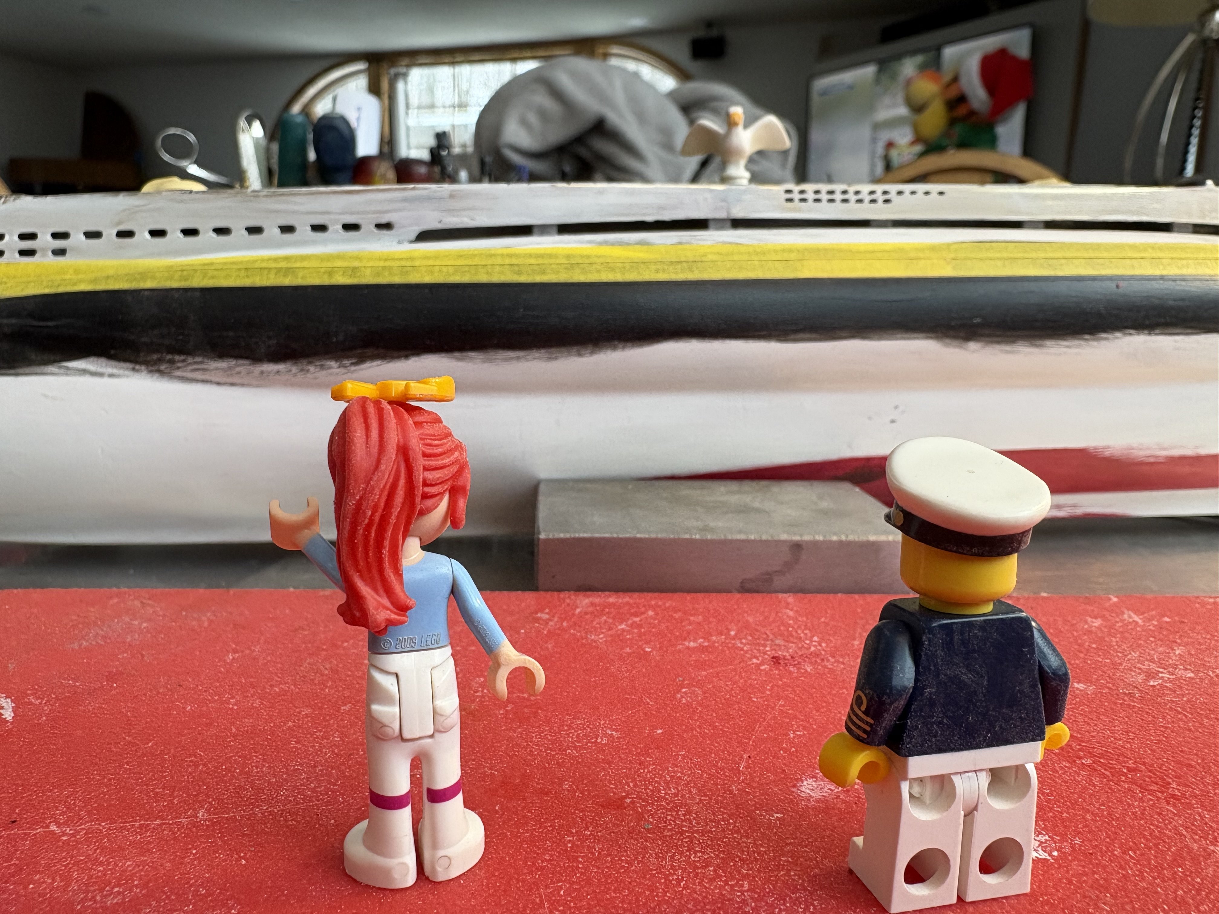

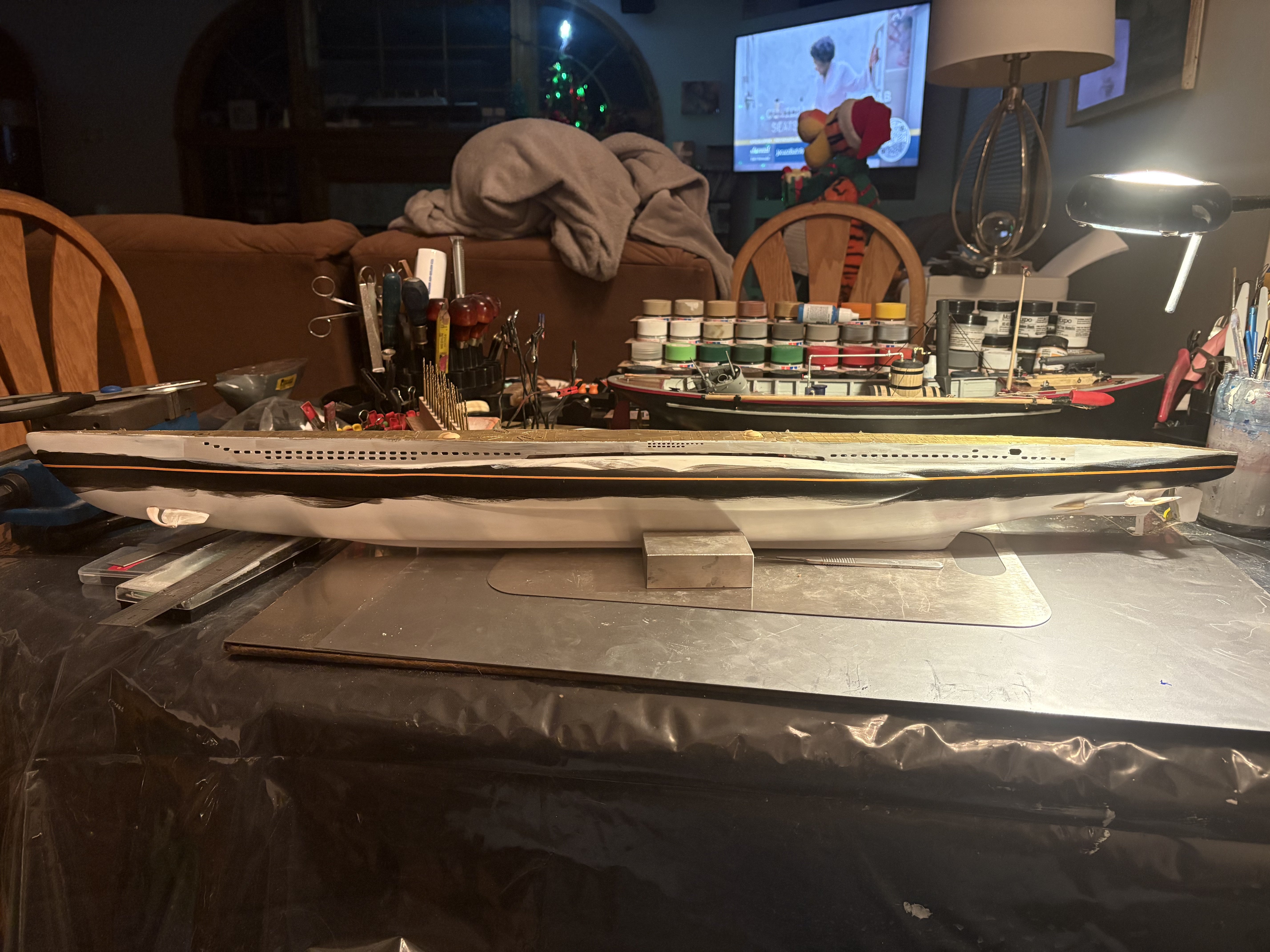

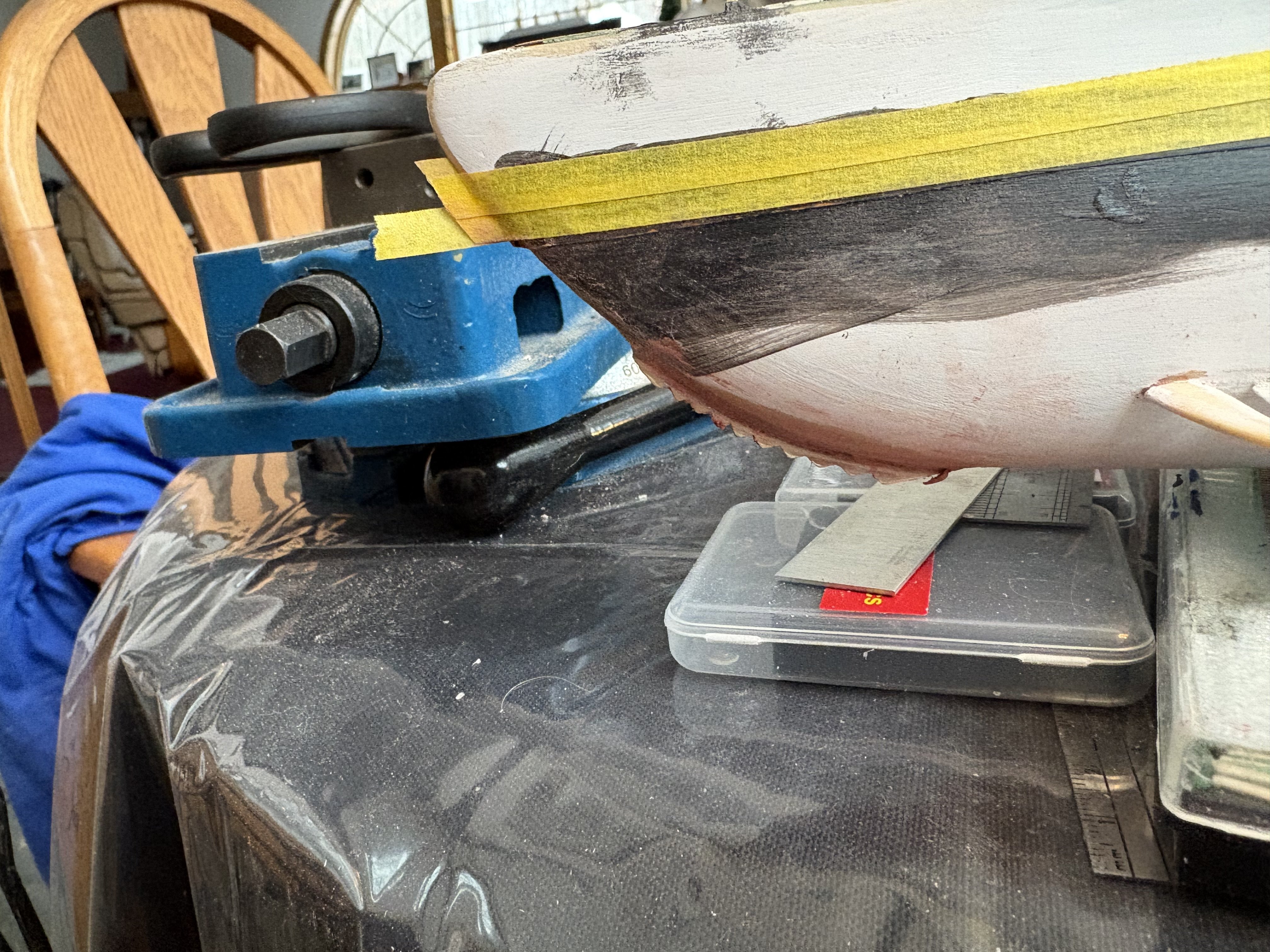

The crew fine sanded the cut water and masked the upper hull prior to painting. I have done  autobody restoration for years and found that materials used in autobody work extremely well if not better than what hobby shops offer for model finishing. The yellow auto masking tape is cheap, stretches on curves and is far superior to regular masking tape and does not leave any film when removed. Anyone who is a very serious modeler should check out auto body supplies.
Next up having the crew paint the lower hull before the sun goes down. Remember the war waits for no one.

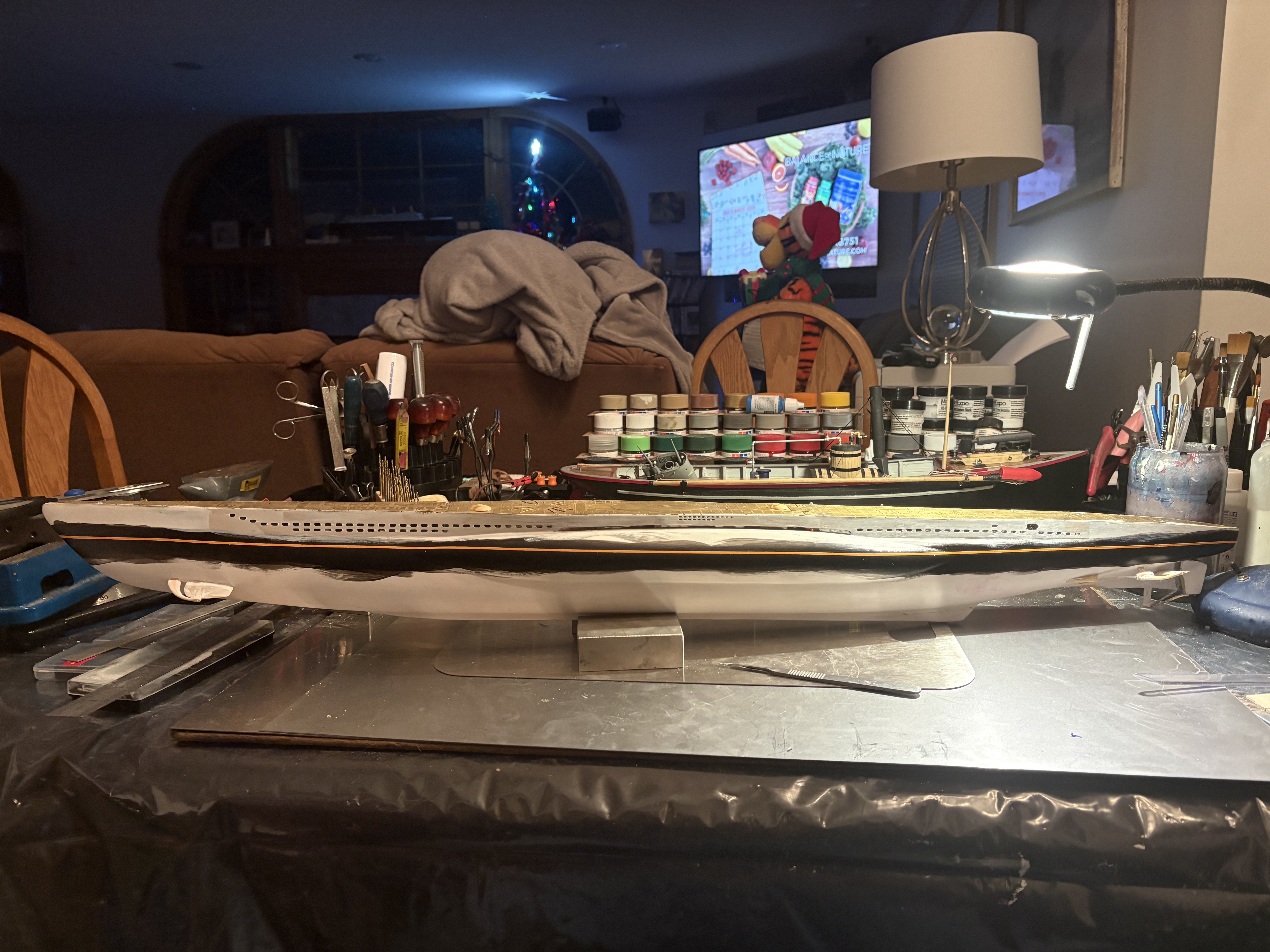

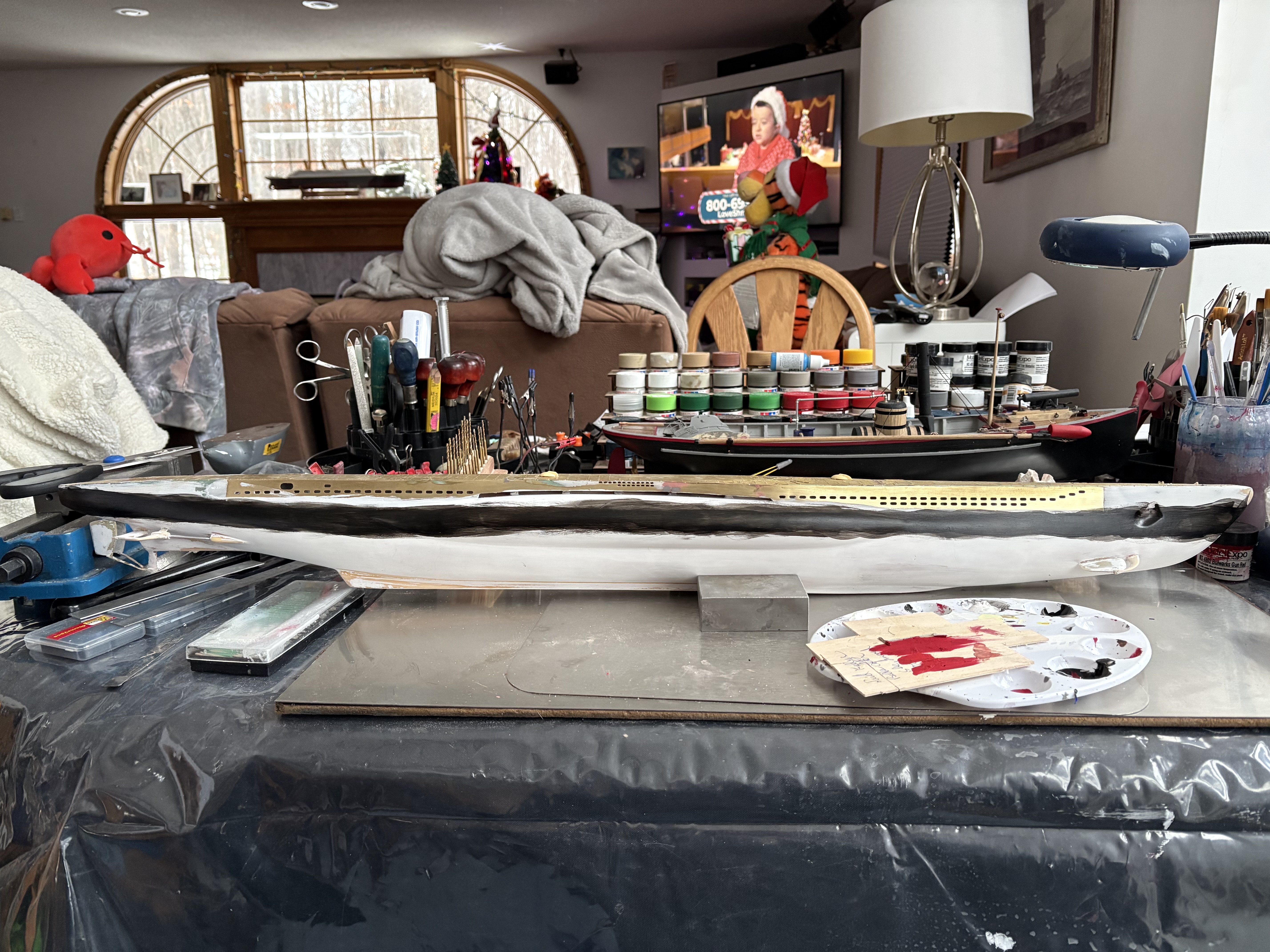

While waiting for paint to dry one crew member my granddaughter started working on the name and a berth for the ship as it waits to join the war. My only problem today is “She has a Screw loose”. The rest of the crew took the afternoon off and headed to the local bar.

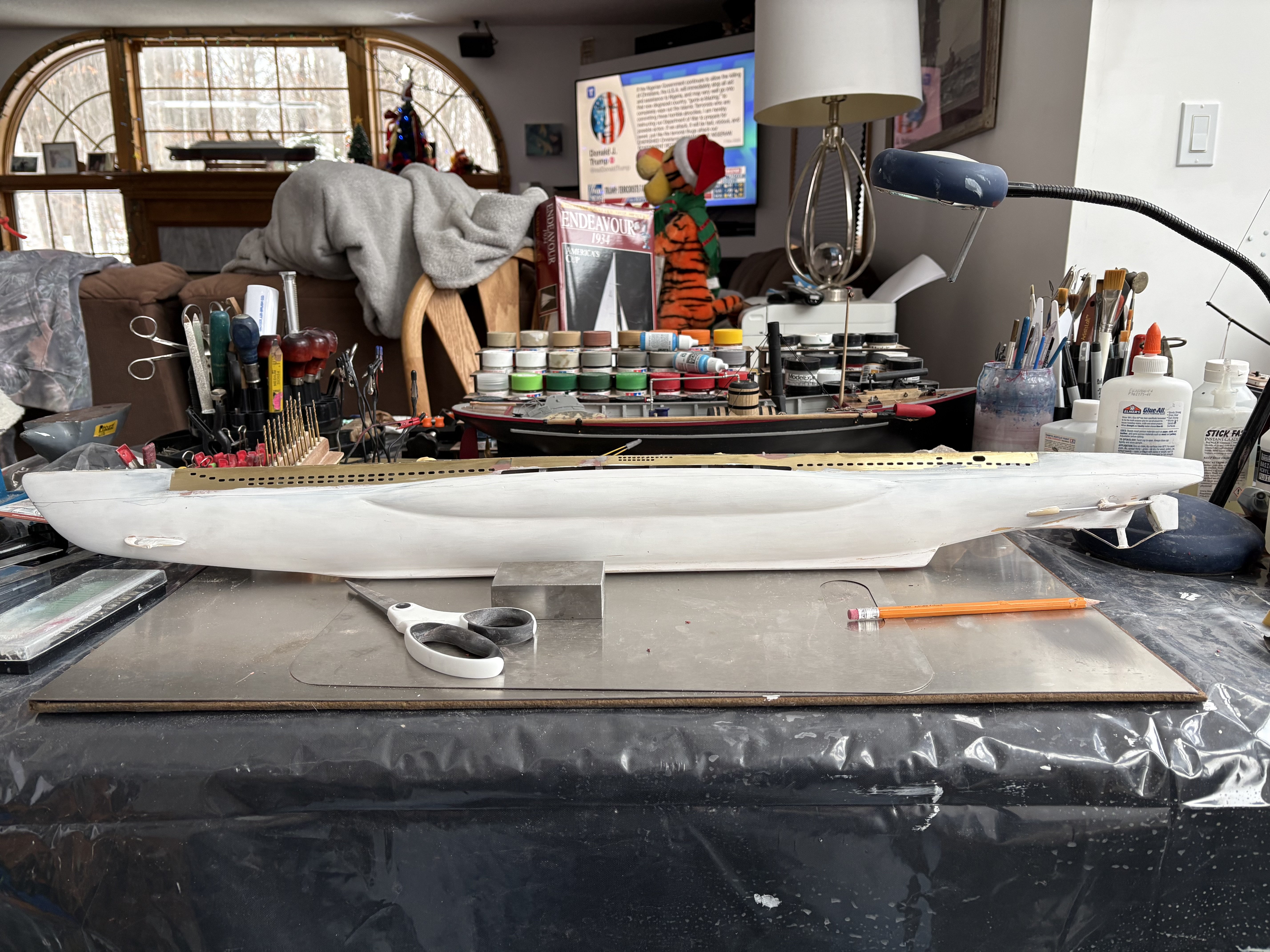

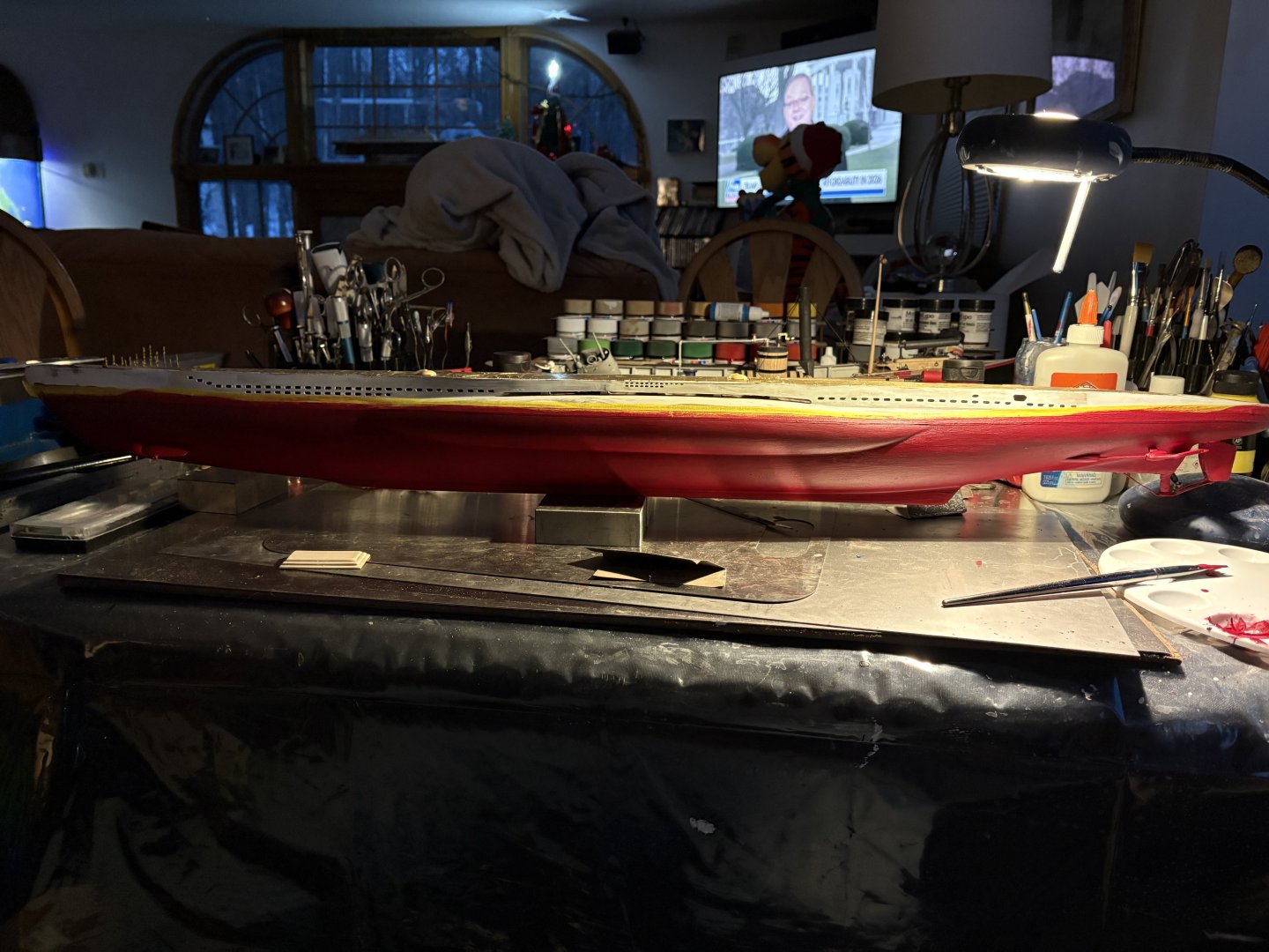

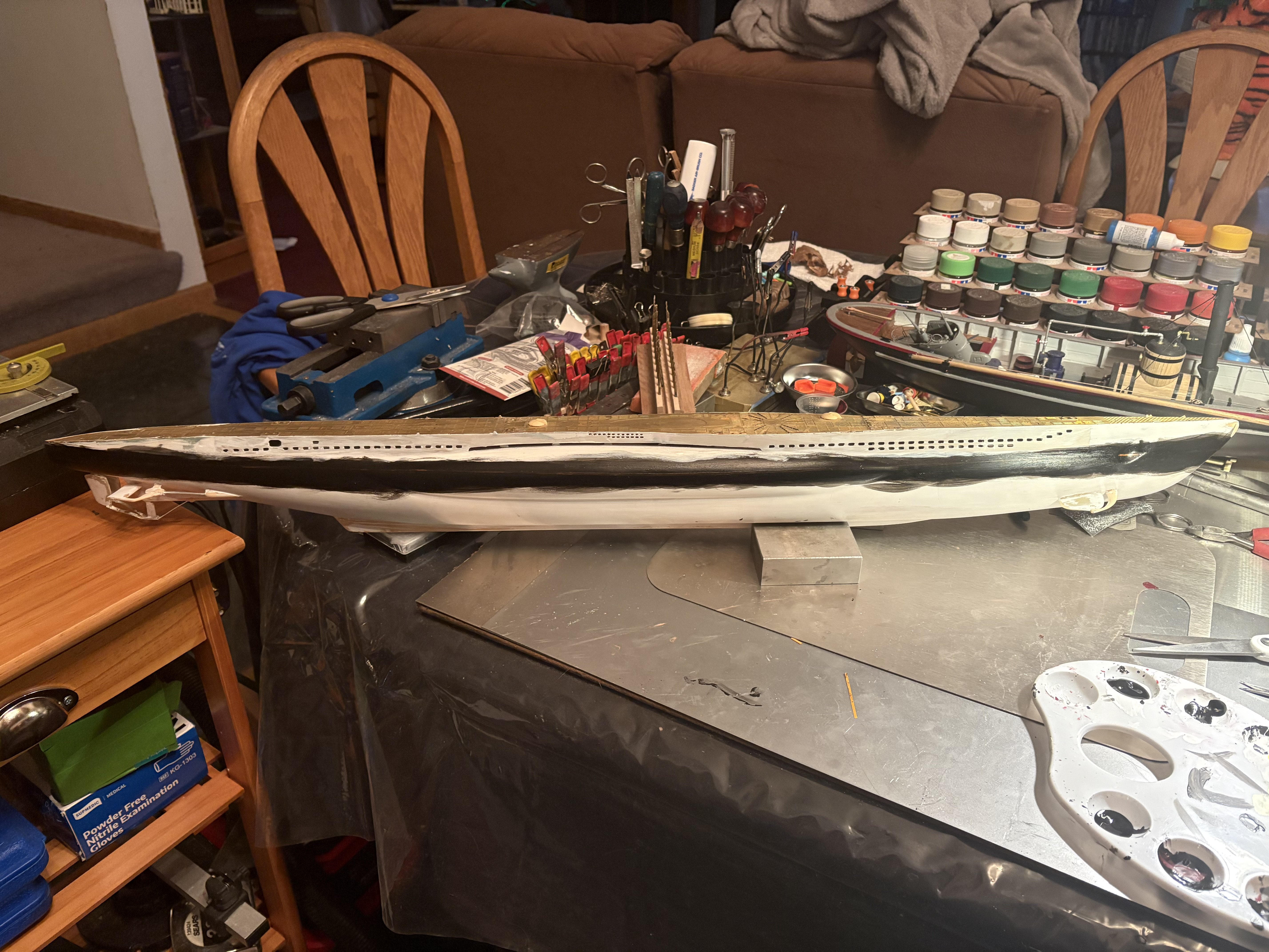

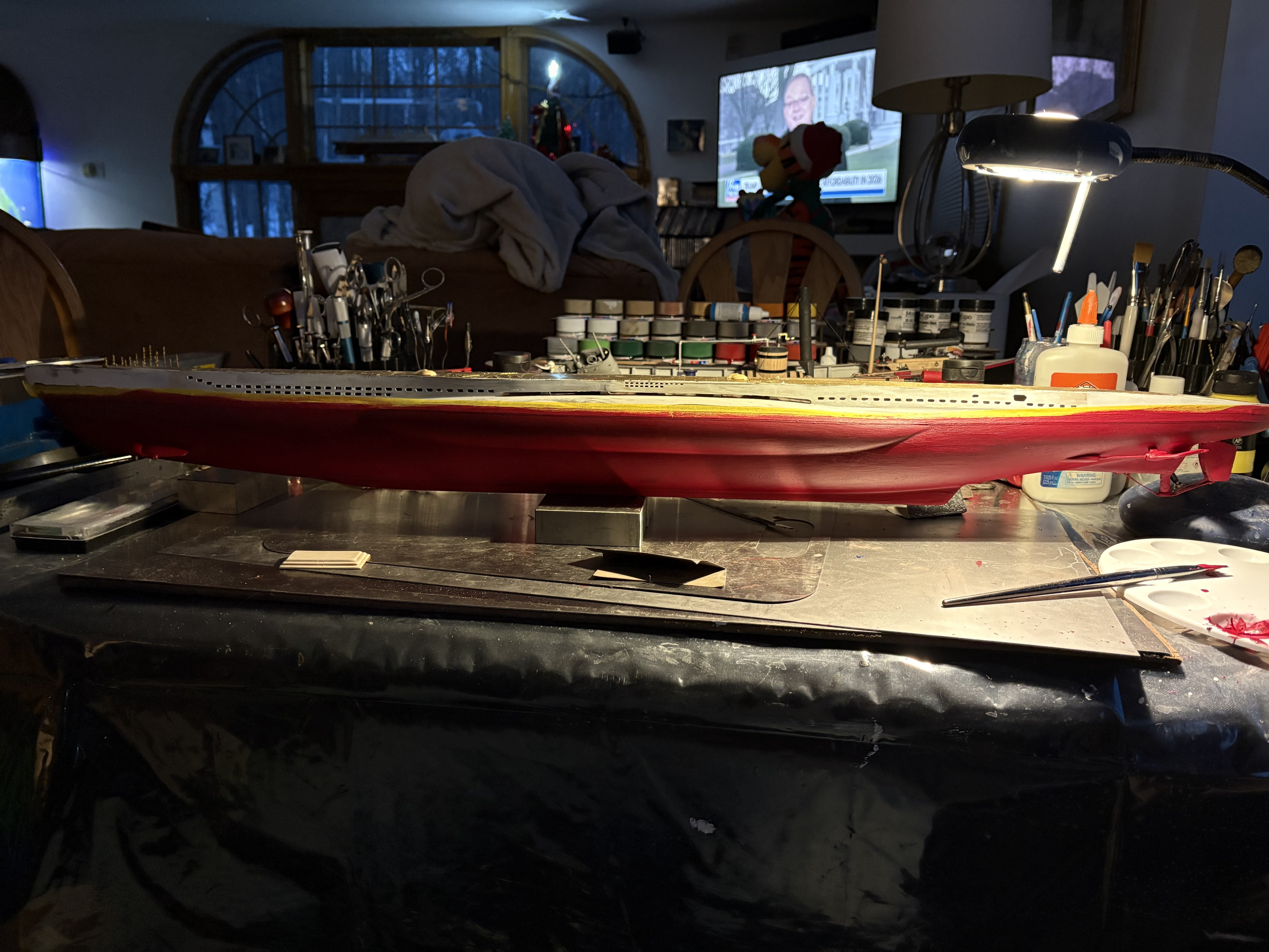

Well the crew finally got the hull painted above the waterline with Liquitex Basic Acrylic Fluid “Neutral Gray”. Joining the war getting closer by the day. Next on preparation for finish is installation of antenna wire needed to receive  necessary info that can only be decoded by our top secret enigma decoder, railings and the on deck bow cutwater needed when submerged. Future necessary painting before finishing and prior to launch are the bow torpedo tube doors. And final weathering of the hull so it appears that we actually have been engaged all the time.

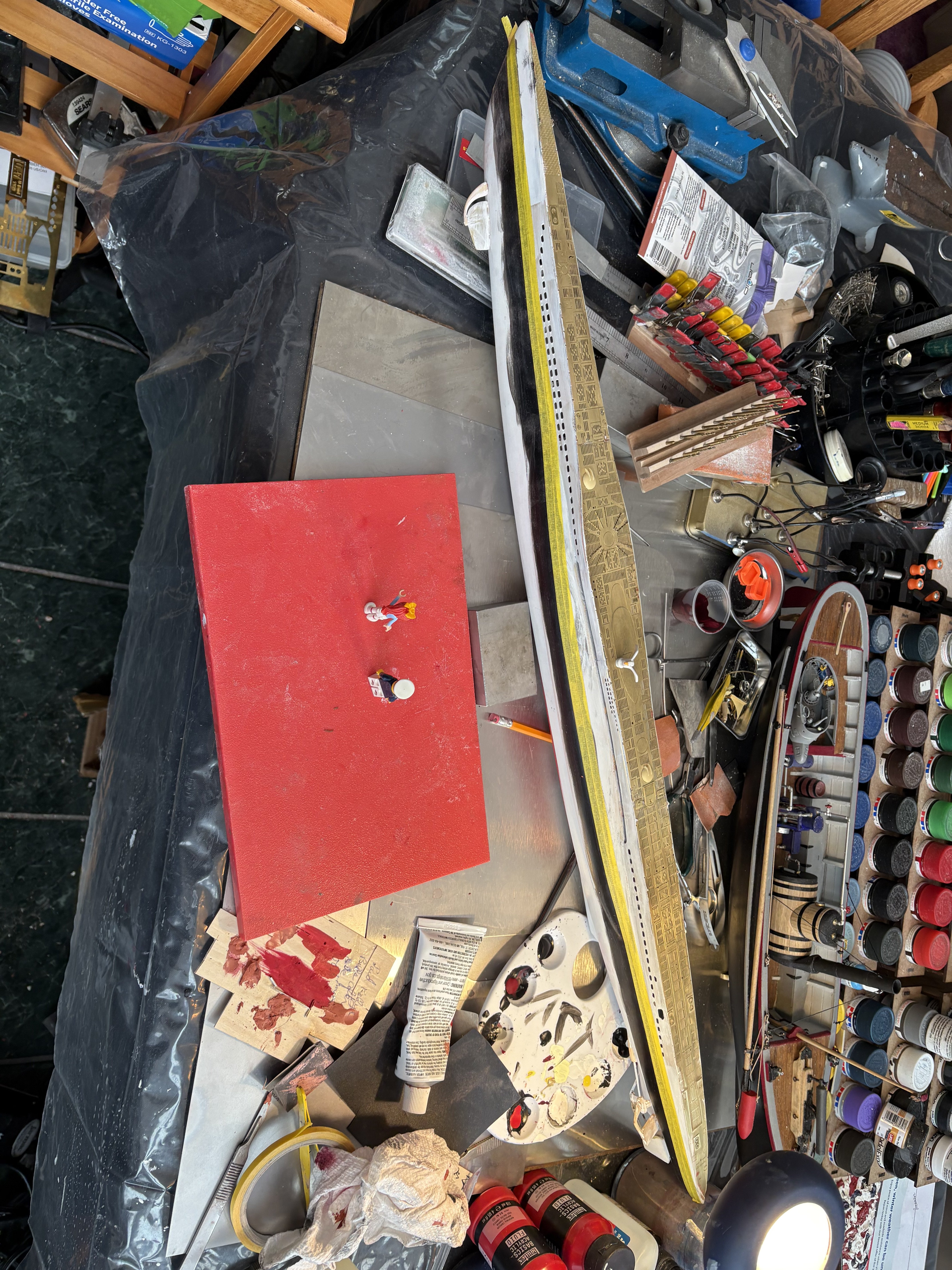

I painted the waterline the way I usually do it but I was worried because it was so thin (1/16”). But it worked out well. I was debating using black auto pinstripe but I chose to paint it.

I know you are right because after I painted the lower hull I looked it up. I wish I had looked it up before I painted it. I went by the picture on the Amati box and they were definitely wrong. There is an extensive discussion of all the colors  the U-47 was painted during its years of service right down to the black tar on the wood deck. After I painted the hull burgundy with the waterline it was too late without extensive work to correct. I have enclosed the website of the hull colors for those interested since the discussion is very interesting. In a few short years every time U-47 sustained war damage and was repaired a different paint color was applied.
