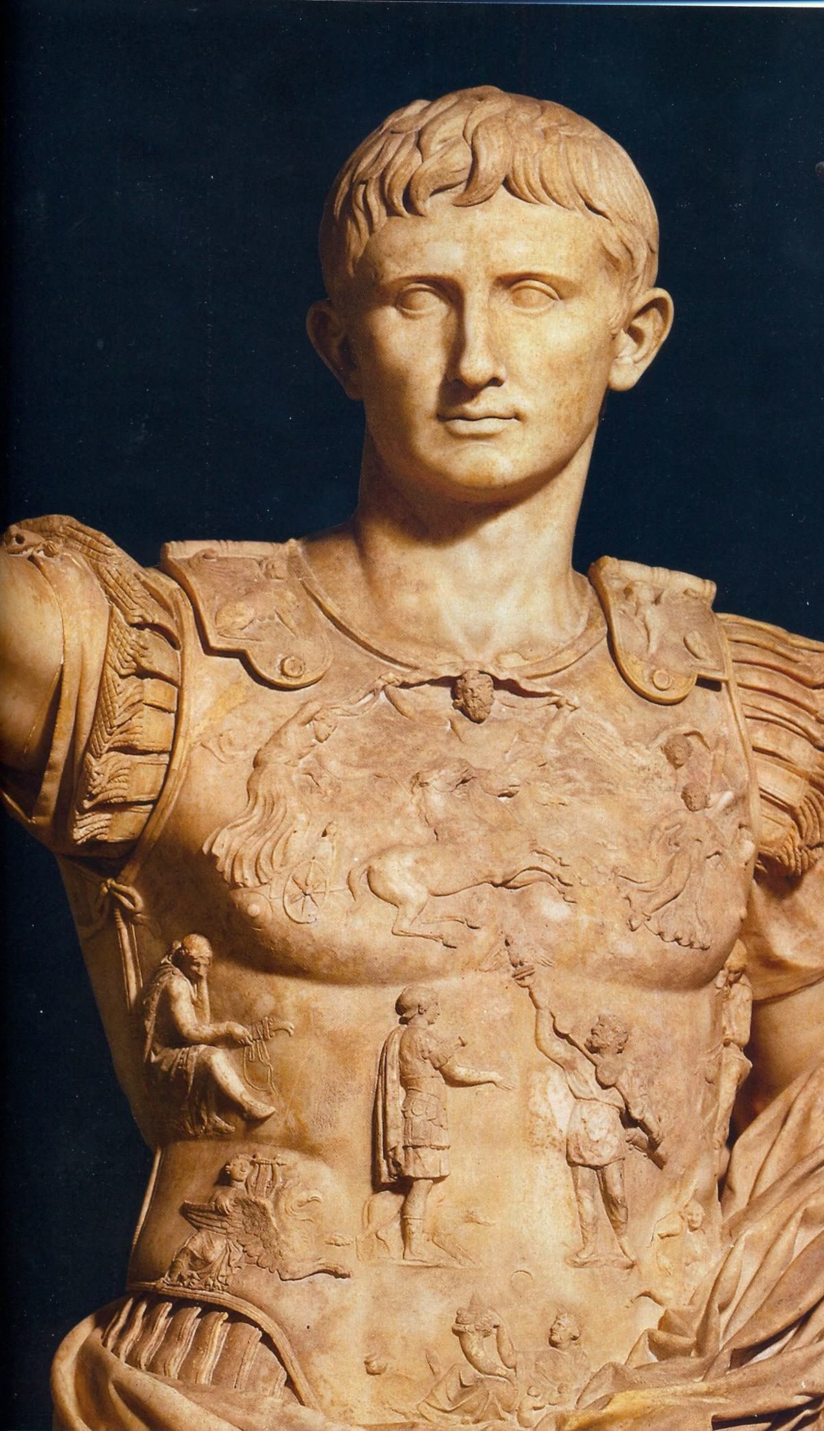

The main theses of the concept were clear to me. It was necessary to depict a warrior and a commander in such a way that there would be clear hints and allegories within him. And in the end, it should be evident that this is not just an ordinary soldier.
Naturally, the first thing I began to study was ancient sculpture. I was especially interested in those works that depict rulers and emperors. How, and by what means, was their status and position conveyed?
And of course, it would have been a serious mistake not to consider another important direction as well. These are rulers too, but not ancient ones—those who lived much later. After all, the fashion of presenting oneself in the image of ancient emperors, heroes, and even gods is far from new. And I was interested in looking at such examples.

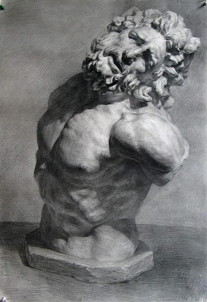

I was also very concerned about the figure itself. How can I explain this clearly? In this case, we are dealing with a classical bust. This is a very common practice: there is a head, there is a torso, but there are no arms.
Instead, there are stumps just below the shoulders. And here my own personal perception comes into play. I have never liked such busts. These kinds of portraits look as if they were tortured in the basement of some horror film about a maniac cannibal.
I remember that during my studies we drew plaster busts, and in one assignment I was drawing a bust of Laocoön. For those who are not familiar, he is a mythological character. In fact, this is a large multi-figure sculpture depicting the agonizing death of Laocoön and his sons.
What we had was only a bust. And it also had truncated arms. And when the plaster face showed a storm of emotions—pain and grief—I always thought that the absence of arms seemed to serve as an explanation for such suffering.
I could not relate calmly to other busts either. That suffering Laocoön evokes sympathy, but when you look at exactly the same armless character who is, at the same time, sweetly smiling, it becomes even more frightening. Man, why are you smiling? Your arms have been torn off—are you aware of that? At that point, he no longer looks like a victim of a maniac, but rather like the maniac himself, someone who does not care whom he inflicts pain upon.
In short, I have always disliked busts without arms. Perhaps this is a reason for me to question my own psyche. Maybe it is I who am unbalanced? After all, I am completely calm when it comes to plaster heads. You sit in front of the easel, draw a plaster head, and everything is fine. You do not think that in front of you there is merely a severed head… All right, now I am frightening myself. Back to the topic.

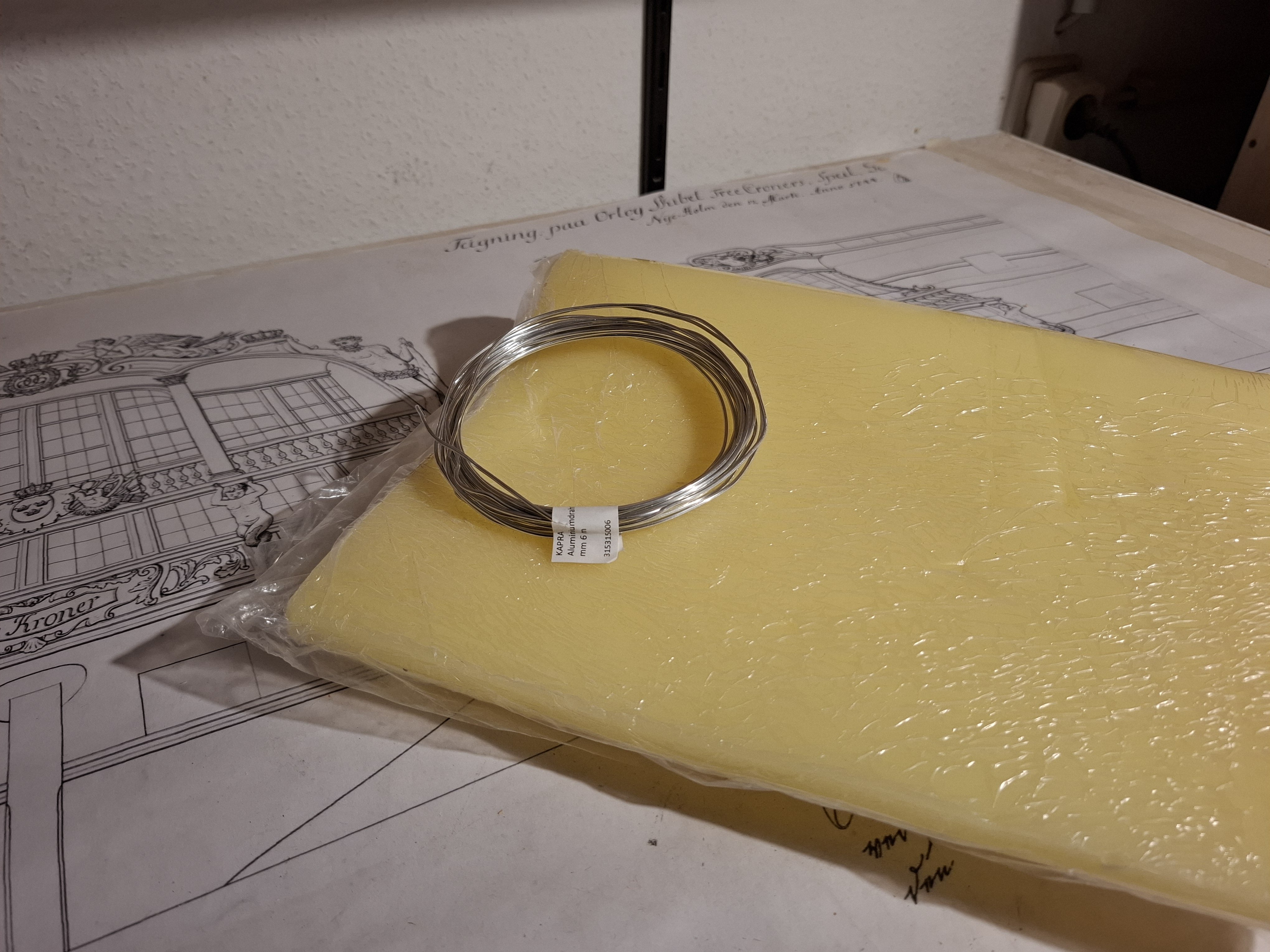

Hi Alexander,
I am talking about easily moldable medium-hard modeling wax. Sculptors use this for the designing process. It is quite stiff, but when you warm it up a bit, or even just warm up your carving tools, you can very essily form it with precise details. You can also make it warm and form it around wire for better  stability of arms or weapons etc.
I bought myself some of it for designing the sculptures of my model, but did not try it out yet.
Matthias

Excellent news. I will be very much looking forward to updates in your thread when you begin this stage of the work. It should be both interesting and useful.
I know ship modelers who create decorative elements using modeling techniques. In this case, epoxy putty is used.
Visually, everything looks fairly simple and straightforward. However, there are always nuances that become apparent only in the course of work and with the acquisition of hands-on experience. I myself have never made modeled decorative details. For me, this is an entirely new and unfamiliar area.
Why did you decide to settle specifically on this material? What are its particular characteristics? Is this an intermediate stage, with the intention that the decoration will later be cast in metal or plastic, or will it remain on the ship model as is? Will it be painted, or perhaps gilded with metal leaf? Is it even possible to apply any kind of finish to this wax?
I have watched several videos showing jewelers working with wax. What I liked is that this wax can be used in different ways: in its hard state, where carving is performed, and in a heated state, where wax can be gradually built up, dripped, and layered to form a rough shape. Later, this form can be refined and brought to a finished state using power tools, heated modeling tools, soldering irons, or knives and chisels.

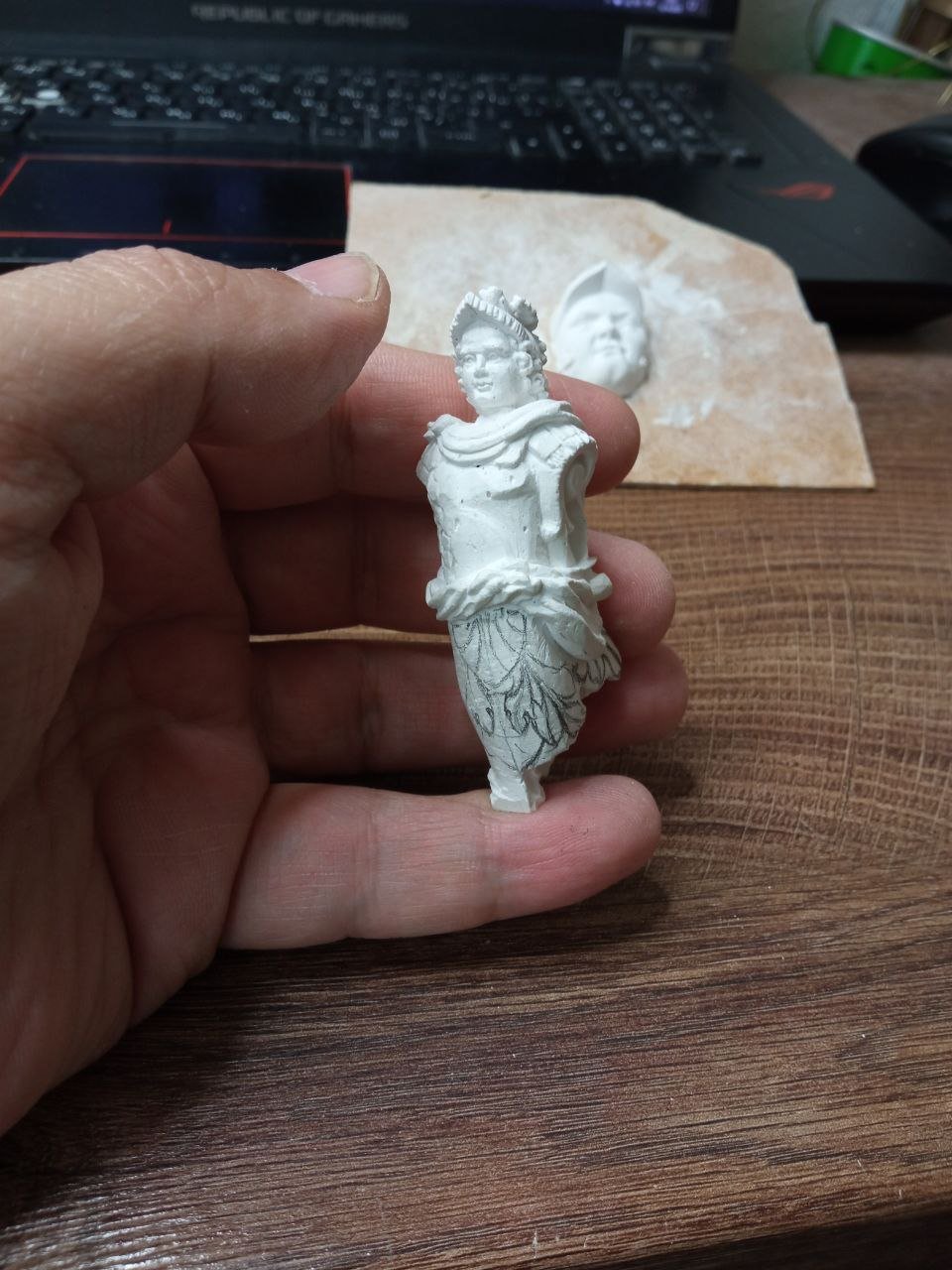

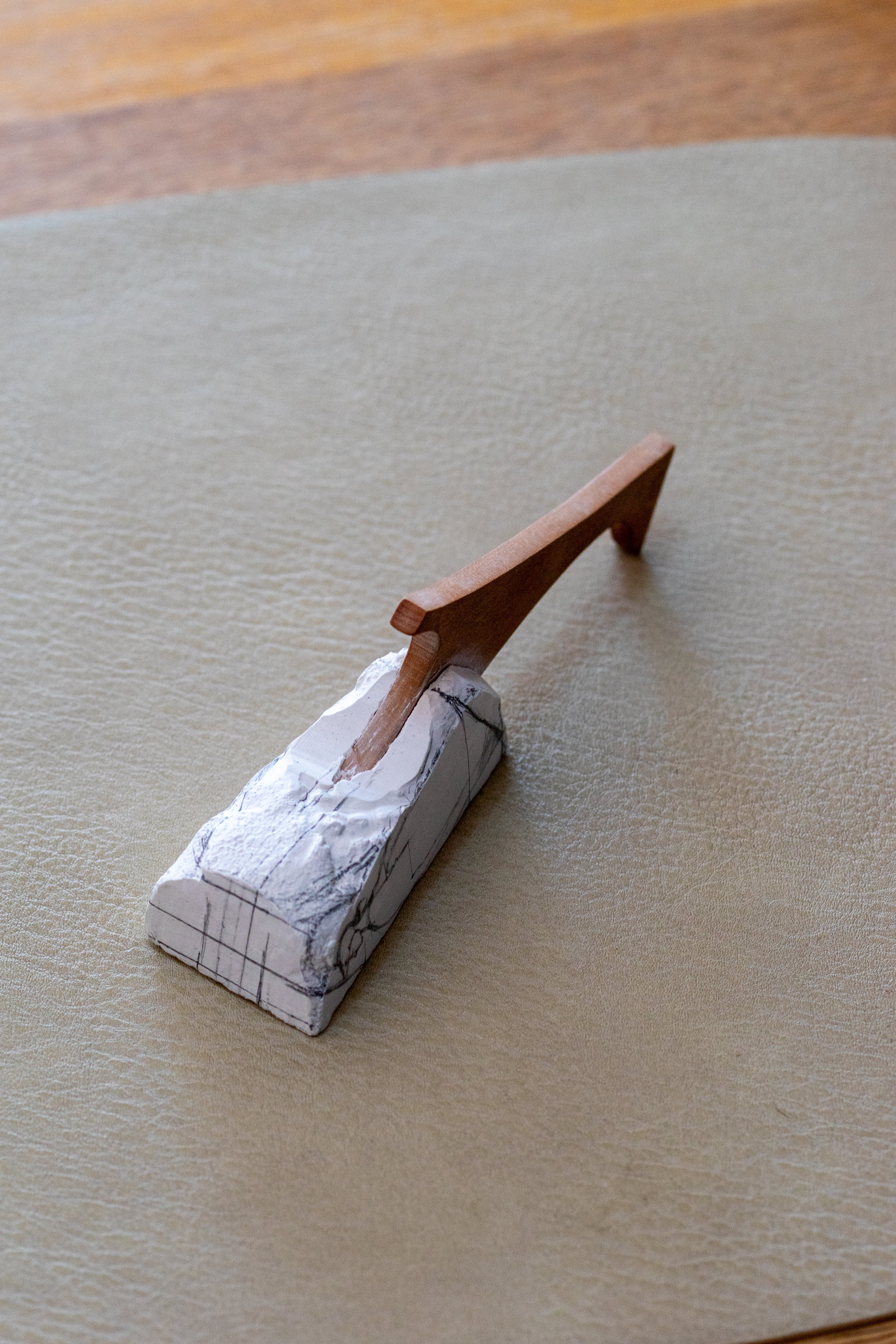

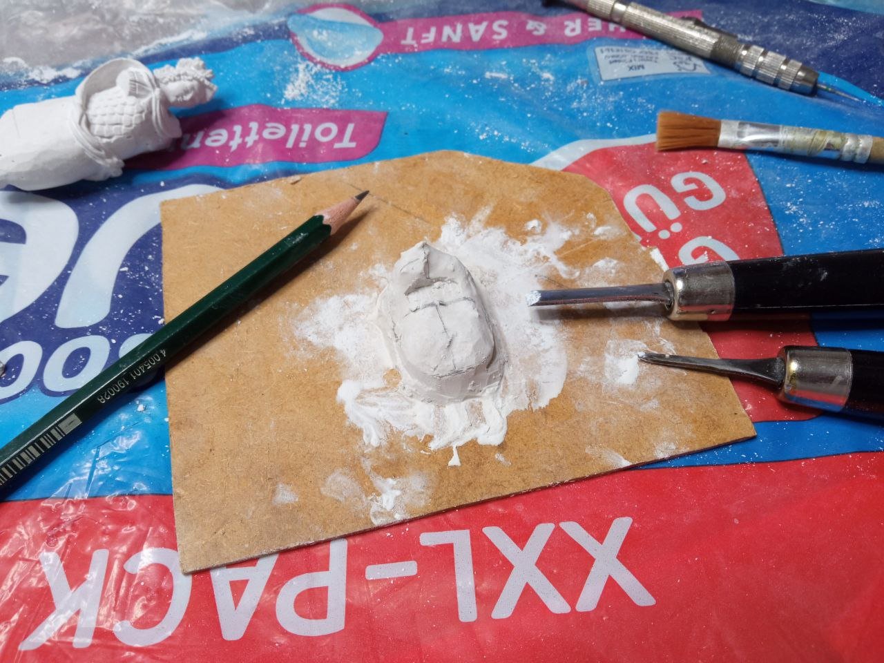

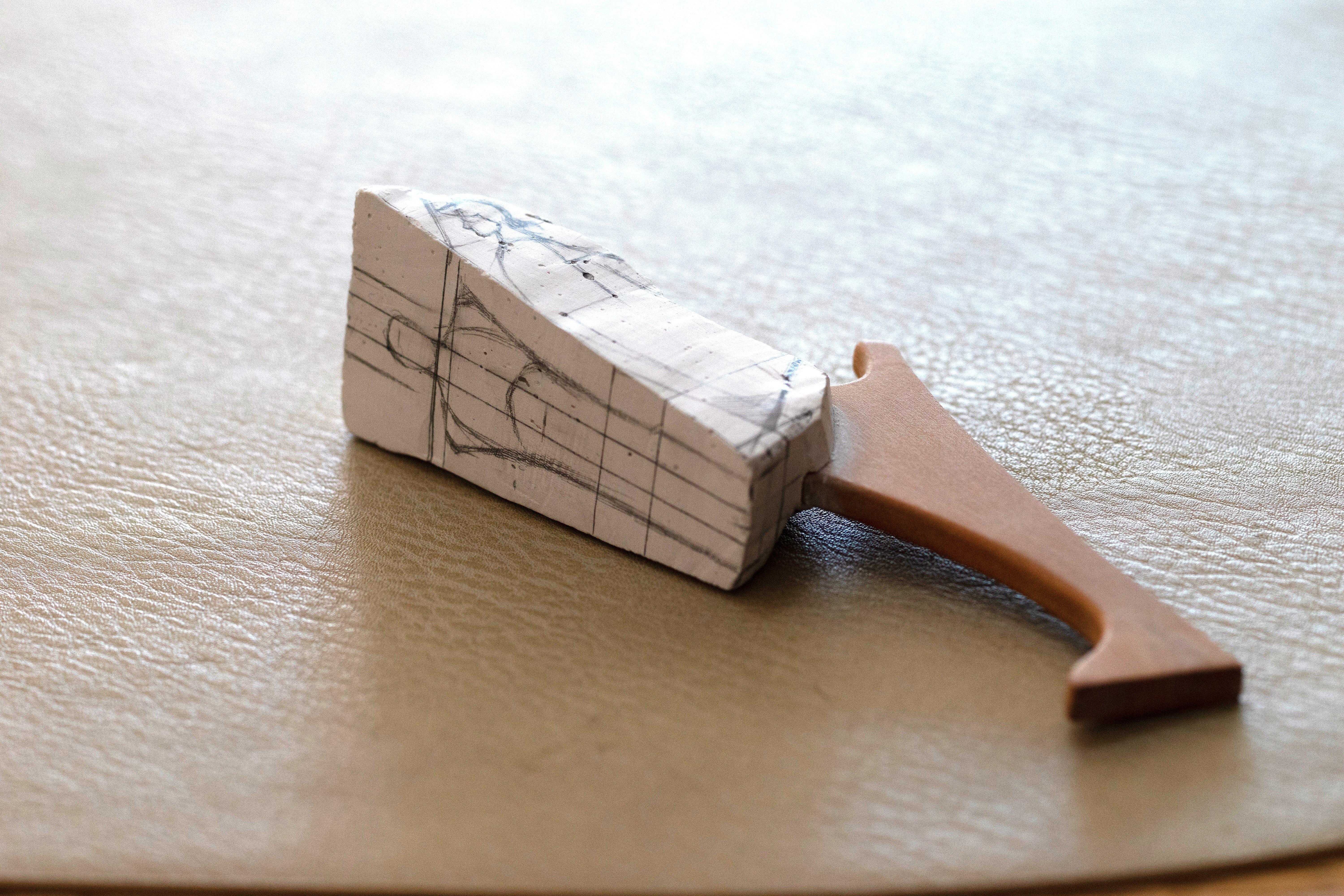

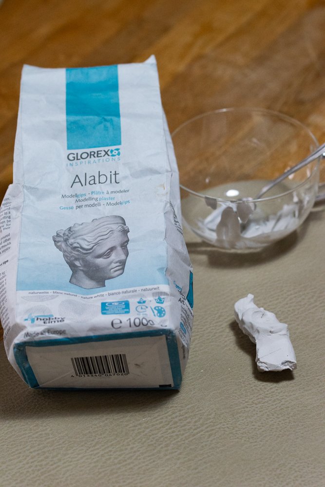

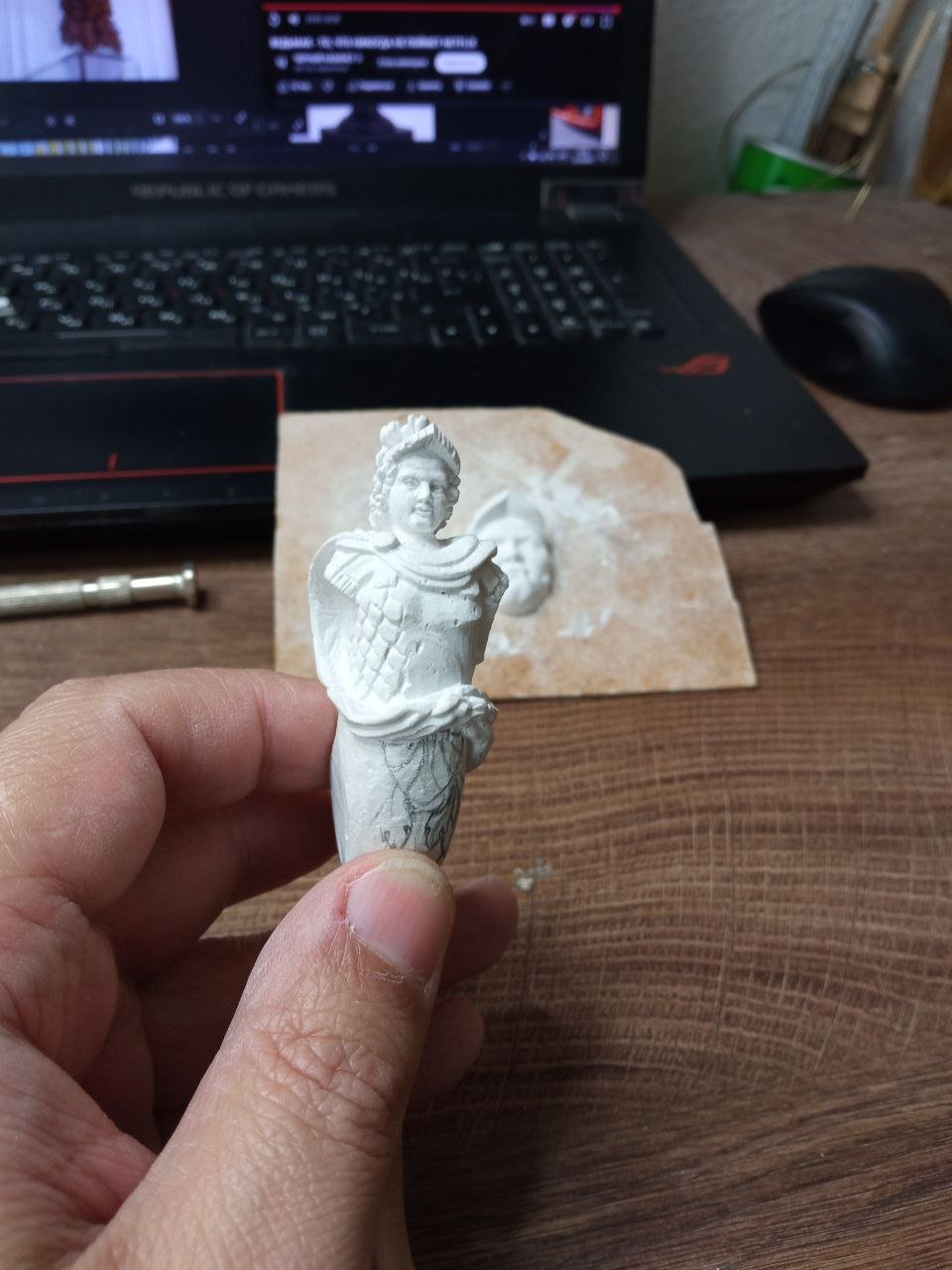

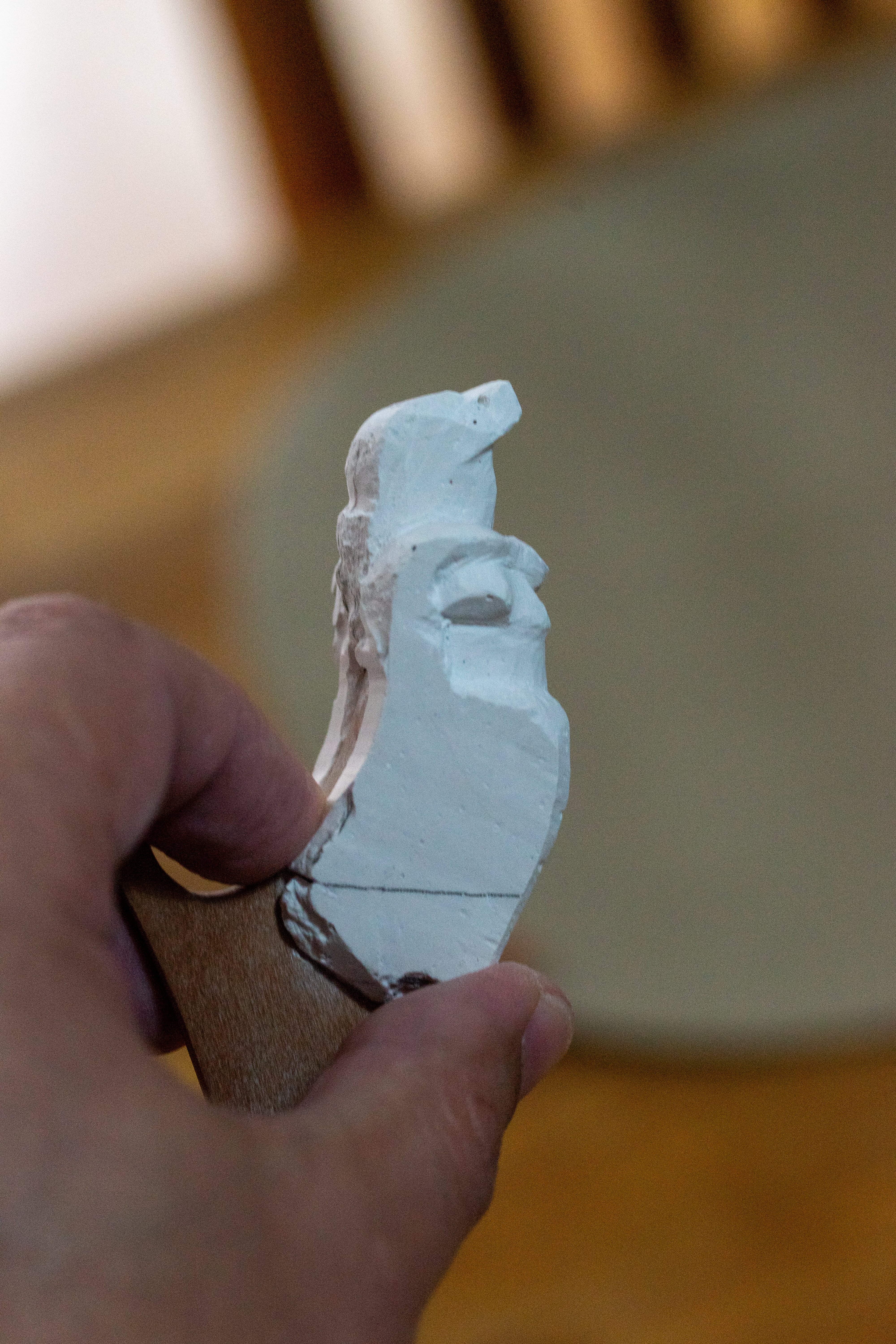

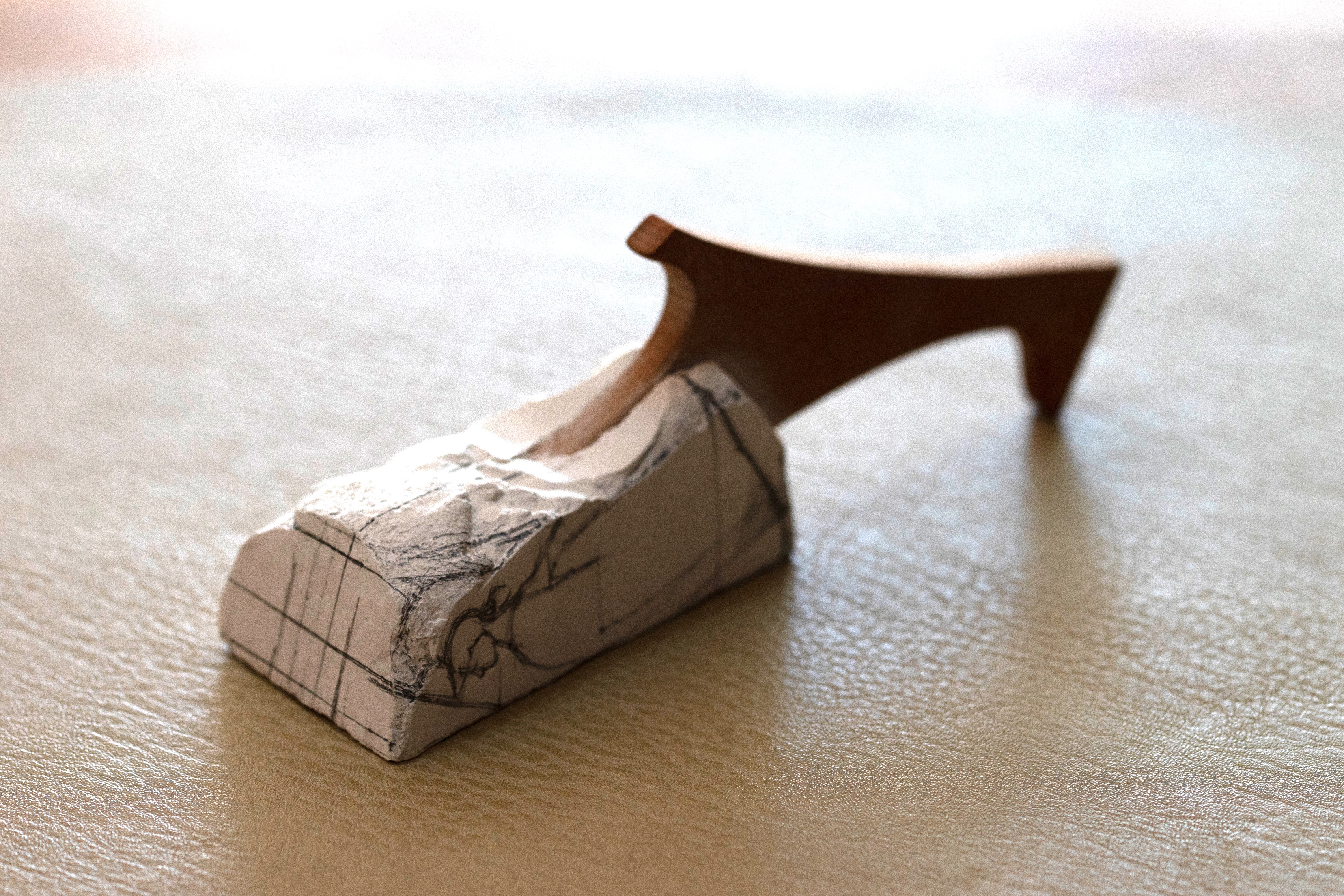

By now, it has become obvious what kind of material this is. And therefore it is clear what exactly I am going to write about. But for those who did not recognize it or have not encountered such material before, I will clarify—it is plaster.
It is a very useful material with great potential. First and foremost, plaster is known as a casting material. The same plaster figures used in art schools clearly demonstrate how detailed forms can be made from it.
I, however, will take a different approach. I will use plaster as a substitute for wood—in order to carve it. Although in this case it might be more appropriate to say not “carving,” but scraping or hewing. But that is not essential.

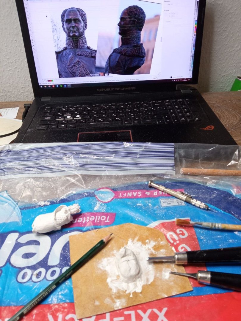

Next, I will show some stages of working with plaster.

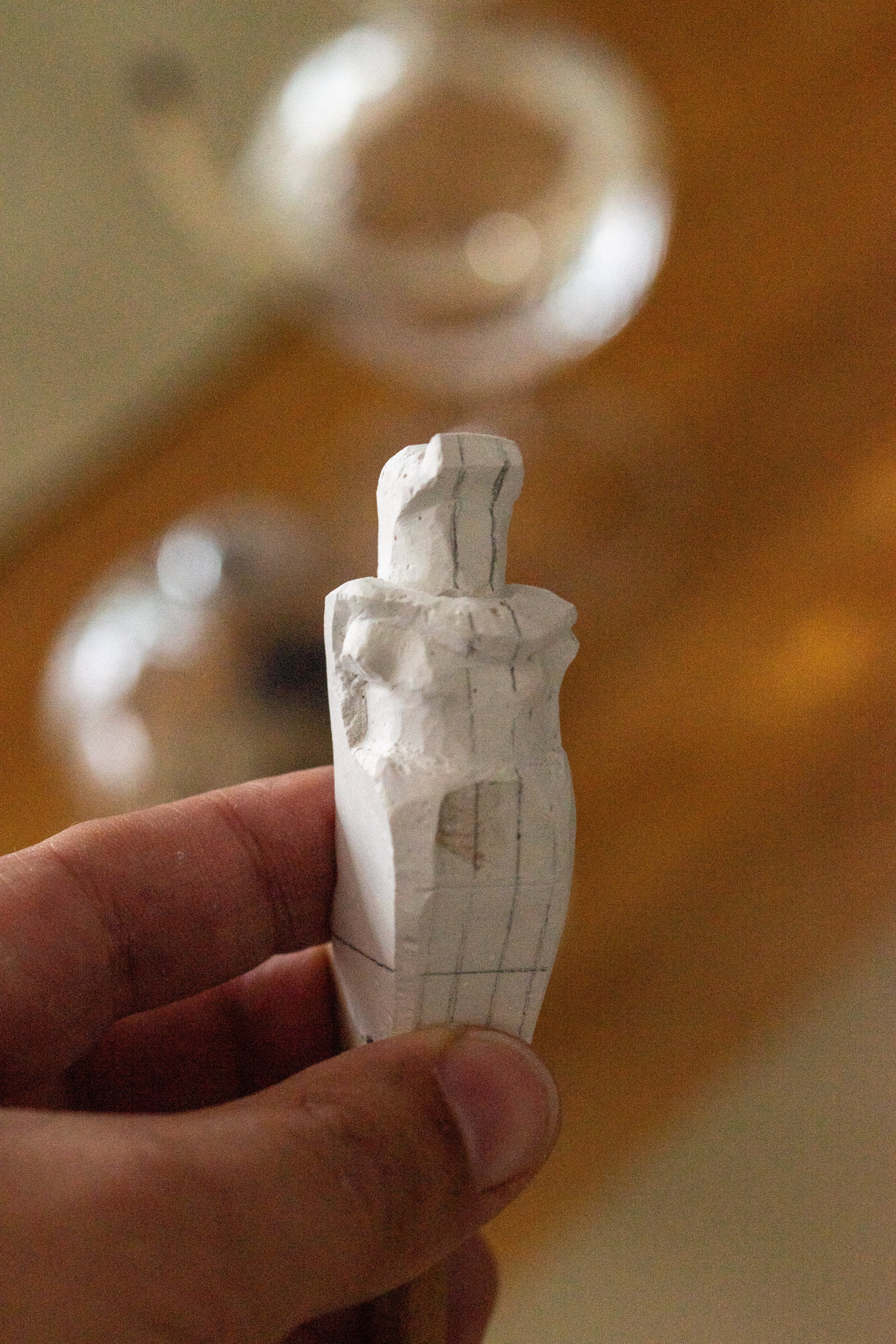

Everything began with casting a blank. This part is very simple. You mix plaster powder with water. The mixture can vary greatly. For casting, it is usually made very liquid. I did not need such a consistency, so I mixed something resembling dough and simply shaped a white lump. The main thing is that it should be large enough to accommodate the planned figure.
There is not much to describe further—everything is clear even without words. First comes working with large masses, and gradually the excess is removed.
Everything is very simple. Plaster comes off very easily.
No force is required—only patience.
You should not try to dig deep right away; it is better to scrape little by little, layer by layer.
It is much more convenient to work by hand. I do not recommend rotary tools or burrs. Although it is possible to use them, there is absolutely no point in doing so—for many reasons.
First, plaster has to be scraped, and what you will be removing is plaster dust. It spreads quite far and soils everything around: hands, clothes, the table. The use of any power tools will create air currents, so plaster will not only end up where I have already mentioned—it will be in the air. Which means it will also be in your hair and on every surface on the other side of the room. In a home environment, this already represents an increased level of risk. Household members will automatically switch into a state of dissatisfaction.
In addition, working with a rotary tool and burrs is inconvenient for another reason. A burr instantly turns the immediate working area into entire snowdrifts of plaster dust—especially when dealing with recesses. One second, and suddenly both the burr and everything around it resemble the scene of walking a small puppy during its first snowfall. He was just there, and a moment later he has vanished into a snowbank.
Within seconds, you will no longer see the tip of the burr and will not know what is happening there—have you already removed the necessary volume of material or not? Perhaps you have long since overdone it and ruined everything. You can only find out once you stop, shake everything off, or at least blow the snowdrifts aside (and do not forget about the household members—they will very soon notice the connection between your puffed cheeks and the new clouds of white haze around).
In short, it is much easier to work with simple hand tools.
Although here, too, a warning is in order. On the one hand, it is good news; on the other, not so much. The good news is that plaster is so easy to remove that it does not require any special tools. Sharpness is not important. You can make a primitive scraping tool out of any nail, and that will be enough. You can make several different shapes and sizes.
The not-so-good news is that if you decide to use your favorite knives, you will most likely have to say goodbye to them. No, they will not break. And they will not be irreversibly ruined—everything is not that dramatic. But if the tool is dear to you, it is better not to let it anywhere near plaster for another reason.
As I mentioned earlier, plaster is removed in the form of dust. This is dust whose particles have adhered to each other to form a solid body. But at the same time, it is not exactly dust. These are small, hard granules or crystals. Does that sound familiar? Practically the same words can be used to describe sharpening stones—only there the bonding of the grains is stronger.
In other words, when working with plaster, essentially the same thing happens as if you decided to carve a figure out of a sharpening stone. Very quickly, nothing would remain of the sharp edges of your knife. And perhaps the knife itself would become half as long. Yes, this is a hyperbolic, exaggerated example—but the principle is exactly the same.
Yes, plaster is softer than even the softest sharpening stone, but you will still dull your tools very quickly.
So what should be done? It is simple. Use tools that you do not particularly value. Replaceable blades are ideal. Even those that have already served their time and are lying in the trash can will be perfectly suitable here. From there on, everything is up to you. If very fine tips are needed, they can be sharpened, brought to the required size, and put to work.
There are no further nuances regarding tools here.
…to be continued…

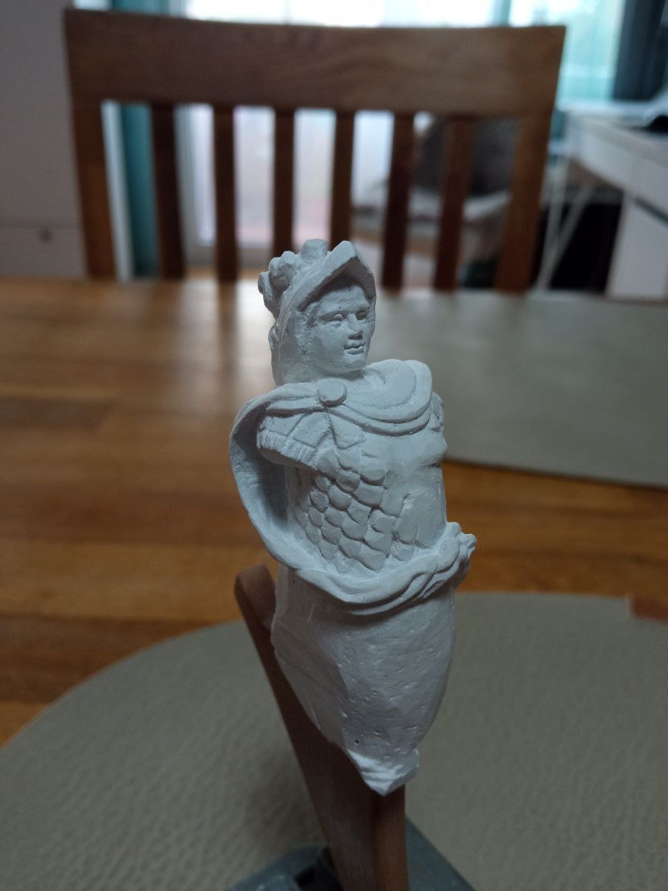

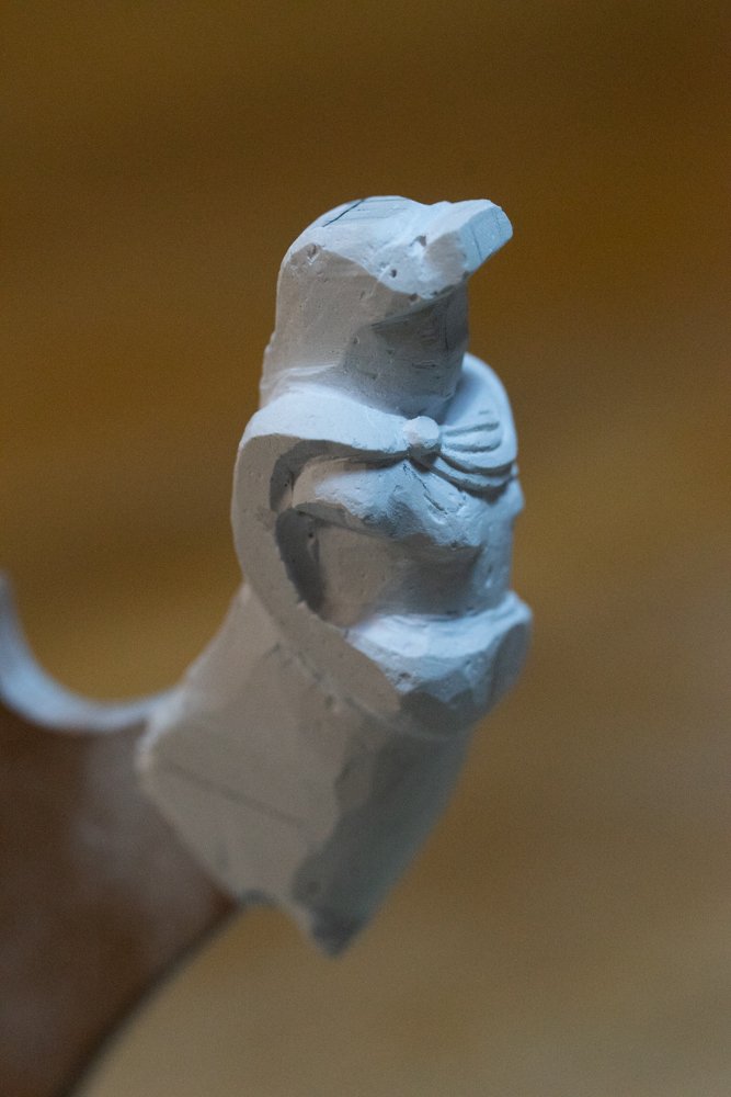

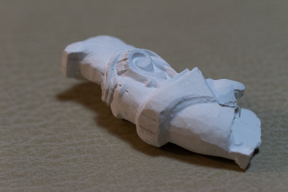

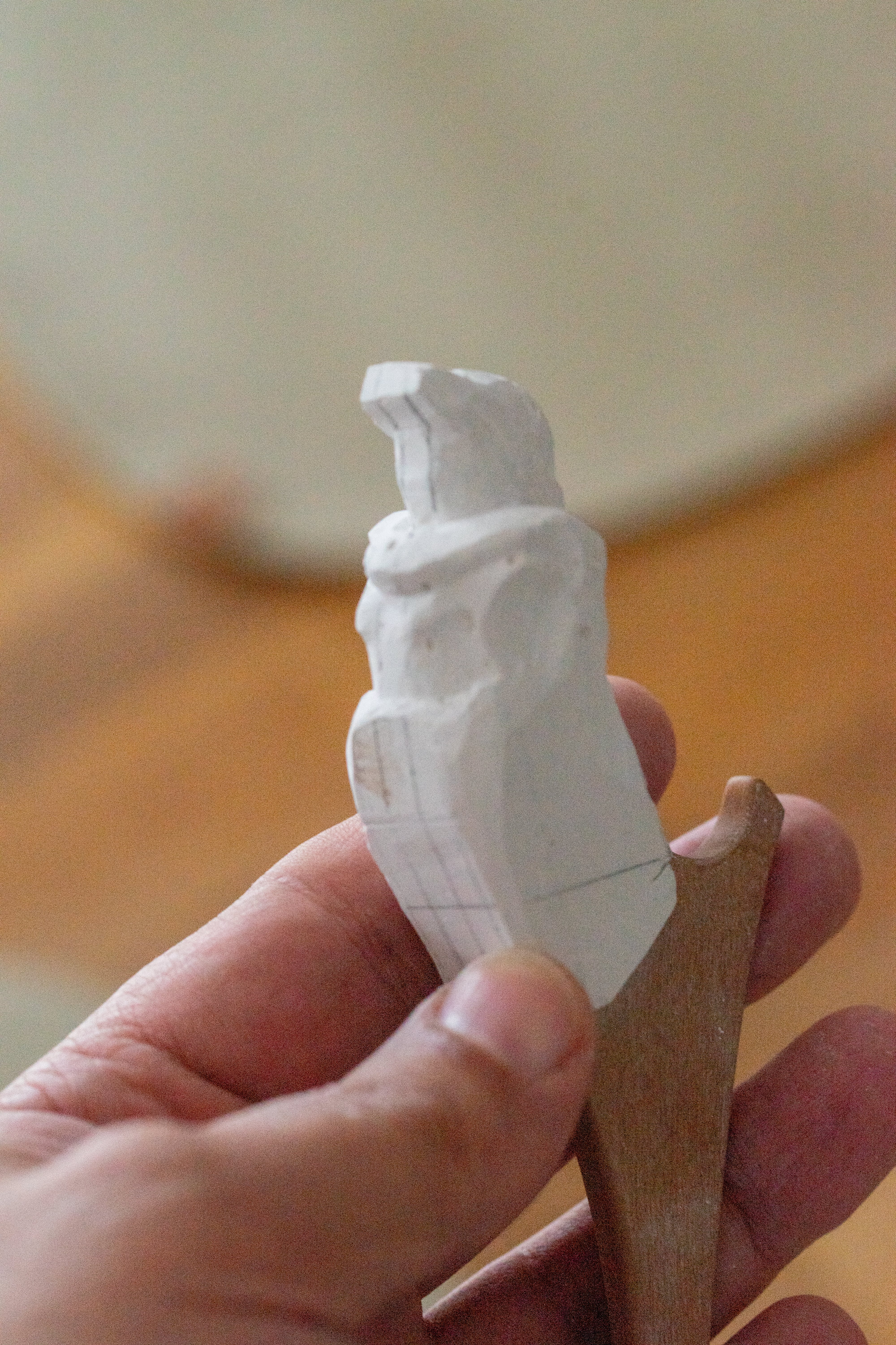

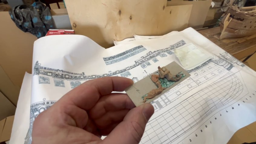

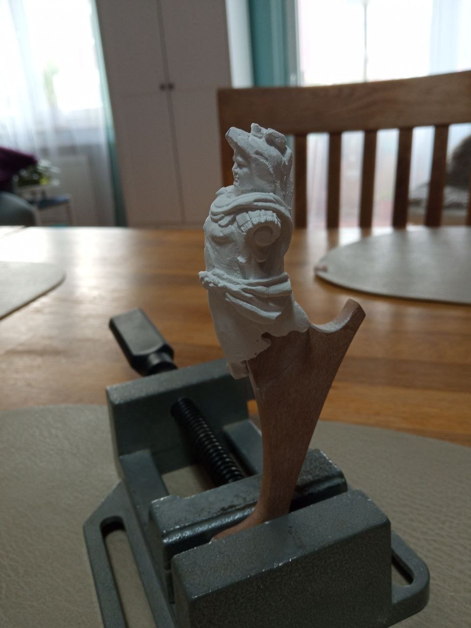

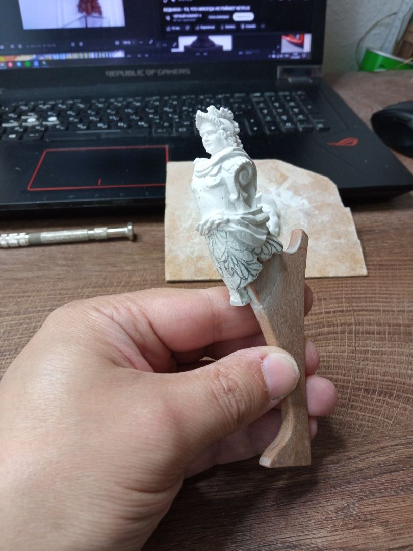

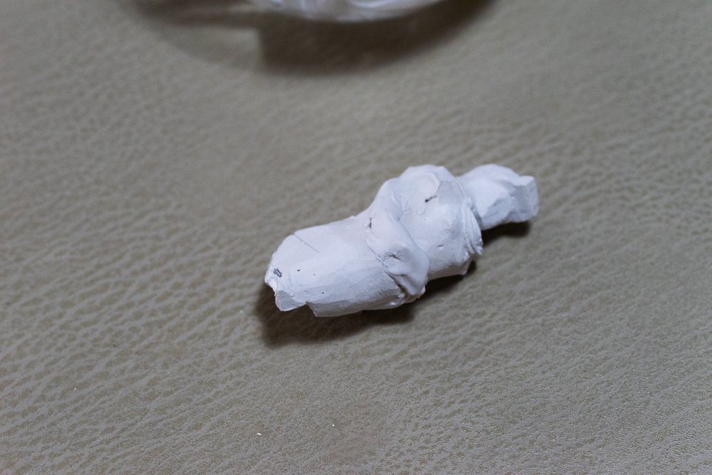

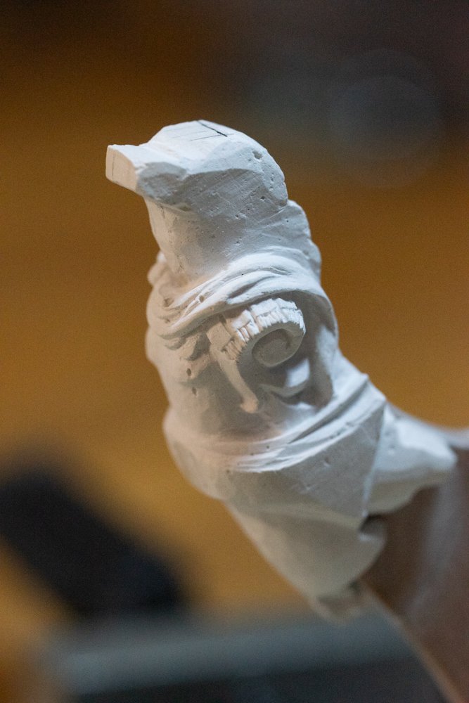

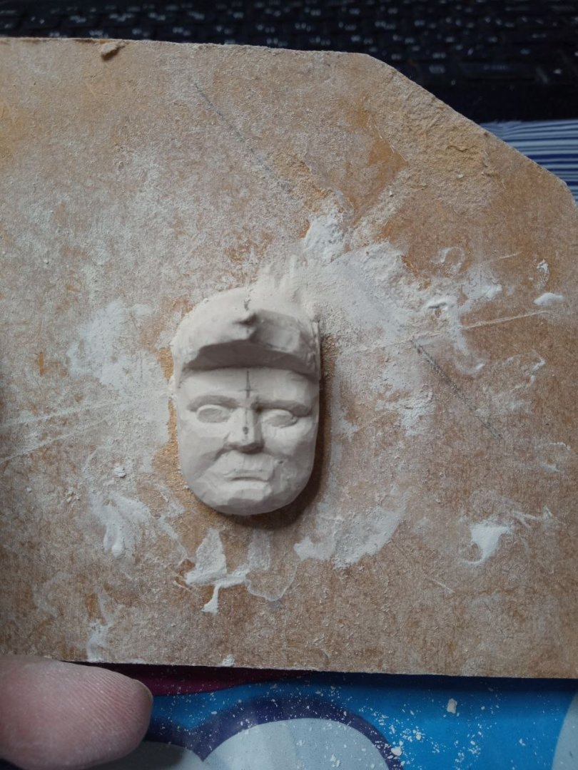

What can I say about the material itself? I liked plaster very much. For me, it was a real discovery. It turned out to be exactly what I needed. Technically, I came as close as possible to carving. Plaster is very easy to work and to cut, yet at the same time it is sufficiently hard and holds even very fine details well.
Initially, I thought that I would simply create a rough figure—establish the elements that were important to me in the material and then stop there. But the working process captivated me. I wanted to continue working even when I had already seen what I needed. I made comparisons and drew conclusions, and still I kept refining more and more details. I wanted to see where the limit was—at what point the plaster would no longer hold and would begin to crumble in fine areas. And I never found that limit. Everything I tried, the plaster accepted willingly and behaved exceptionally well.
It can be easily restored. I slightly moistened the area of the upcoming operation with water to improve adhesion and simply dripped freshly mixed plaster onto the spot. As you can see, at the same time I decided to rework an area that I did not like. This means that one can endlessly introduce corrections and rework the piece in search of the best possible result.
And finally, what did I end up with? You can see that I made the figure different on the two sides. I wanted to compare different options. And I ultimately confirmed my decision not to make the classical truncated arms. I will hide them behind ornamentation. As I said earlier, this solution is very common—perhaps it was invented by an artist just like me, with similar associations.

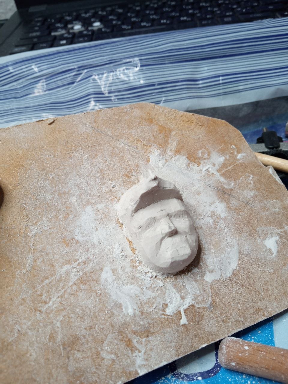

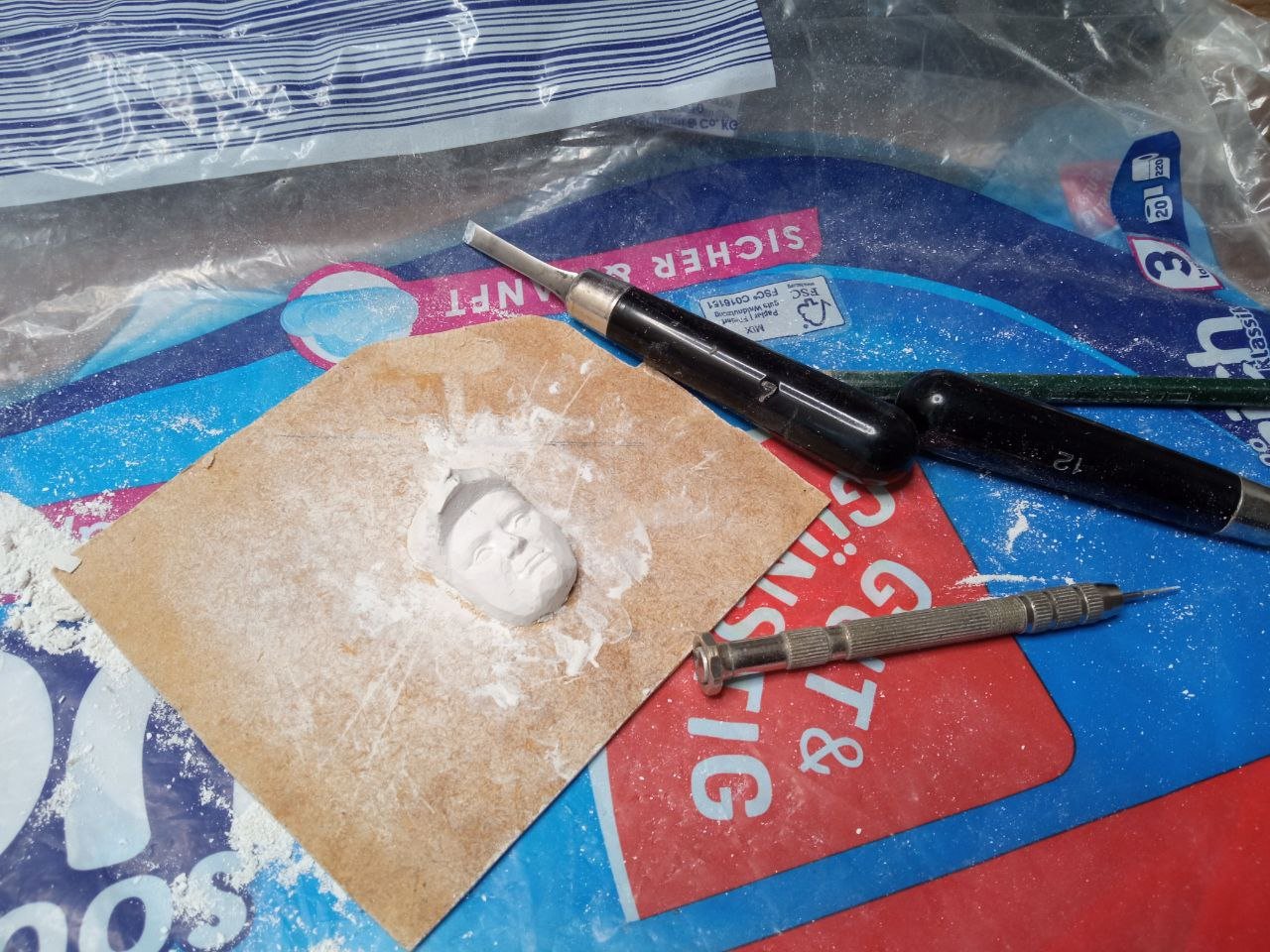

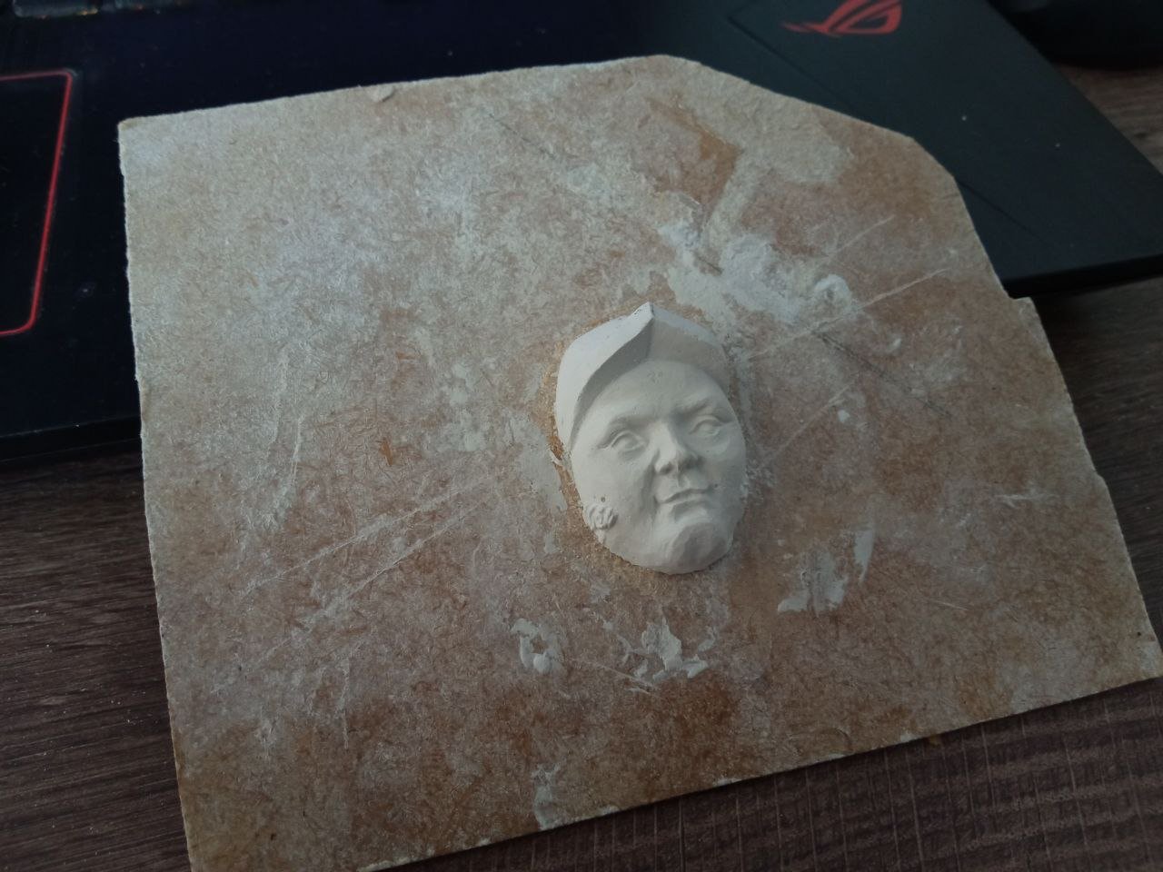

Working with plaster pleased me so much that I decided to separately try working on the face of my Alexander I. The subject of portraiture and individual facial features is very broad. It alone took me a great deal of time, thought, and searching. Later, I will try to speak about this in more detail. For now, let these simply be photographs.
Once again, I will say that I liked plaster very much. It is a wonderful material that suits me perfectly as a medium for preliminary carving, and I will continue to use it in the future. When I showed the result, I received advice to try jeweler’s wax—and that is an excellent idea. I immediately purchased wax so that I would have it on hand and could try this material if needed.
For now, I will not include a discussion of this material in the narrative. The story already branches into many different directions. Someday, when I do try it in practice, I will give a description of it and everything related to this material.
And with that, I can conclude the topic of the plaster stage and move on in my story.

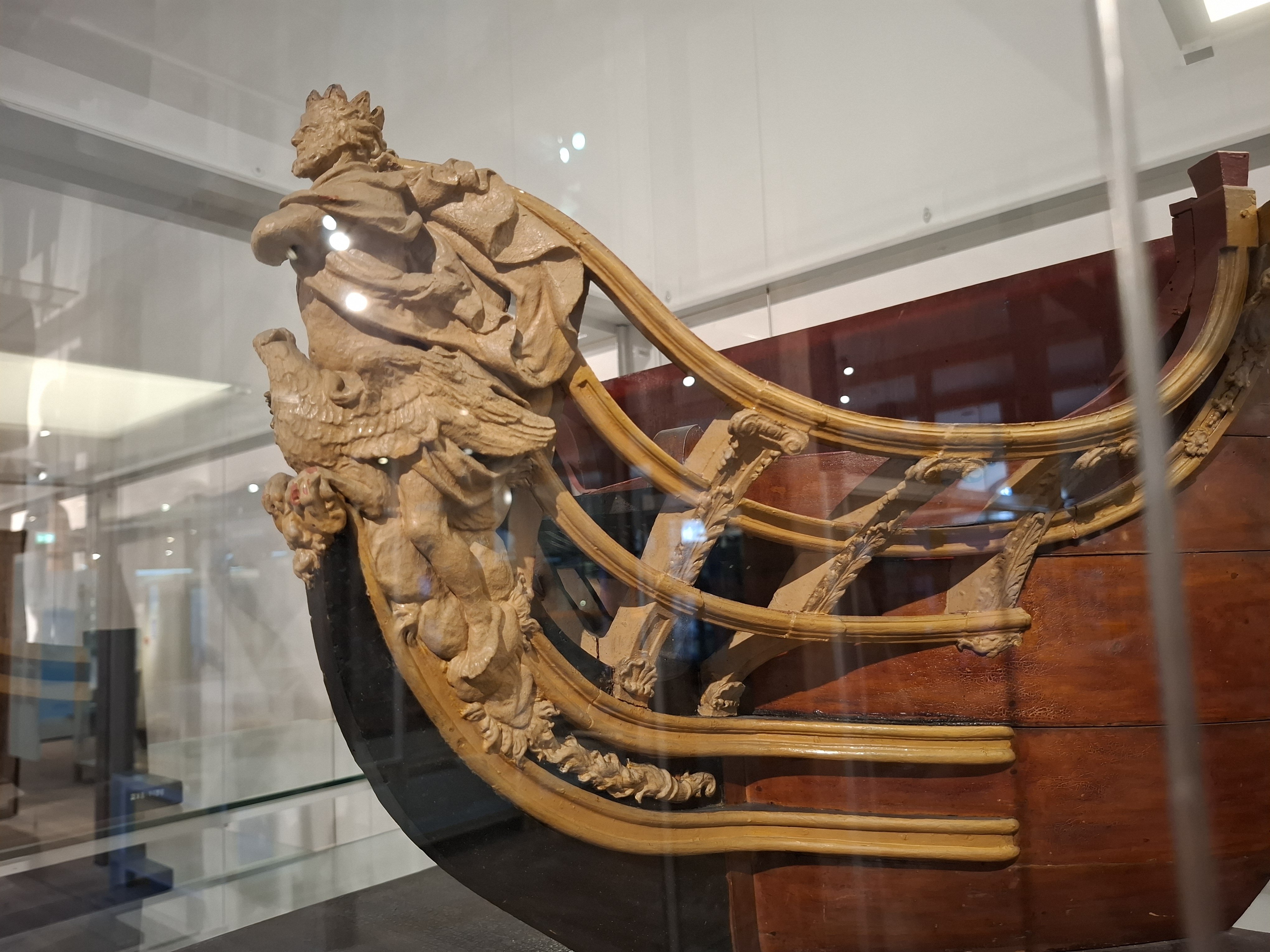

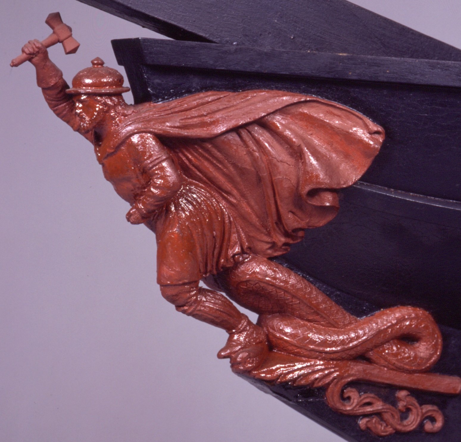

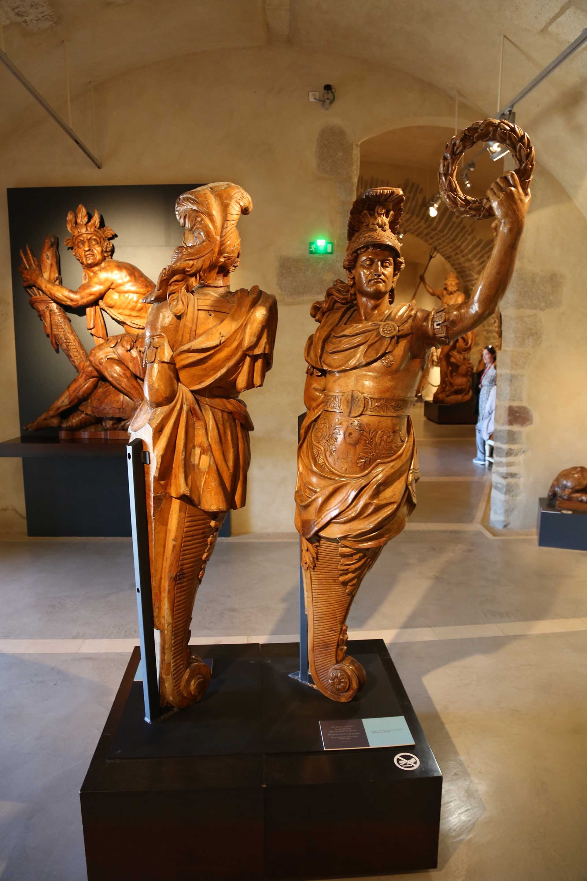

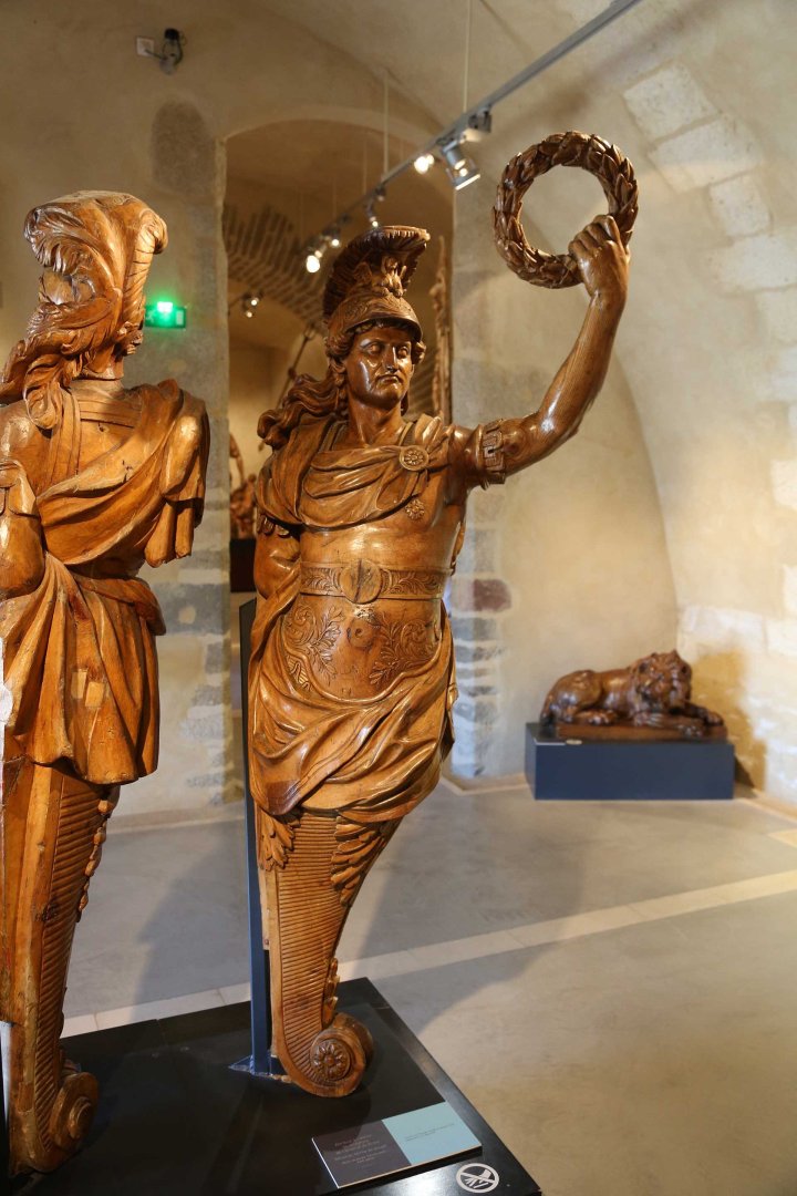

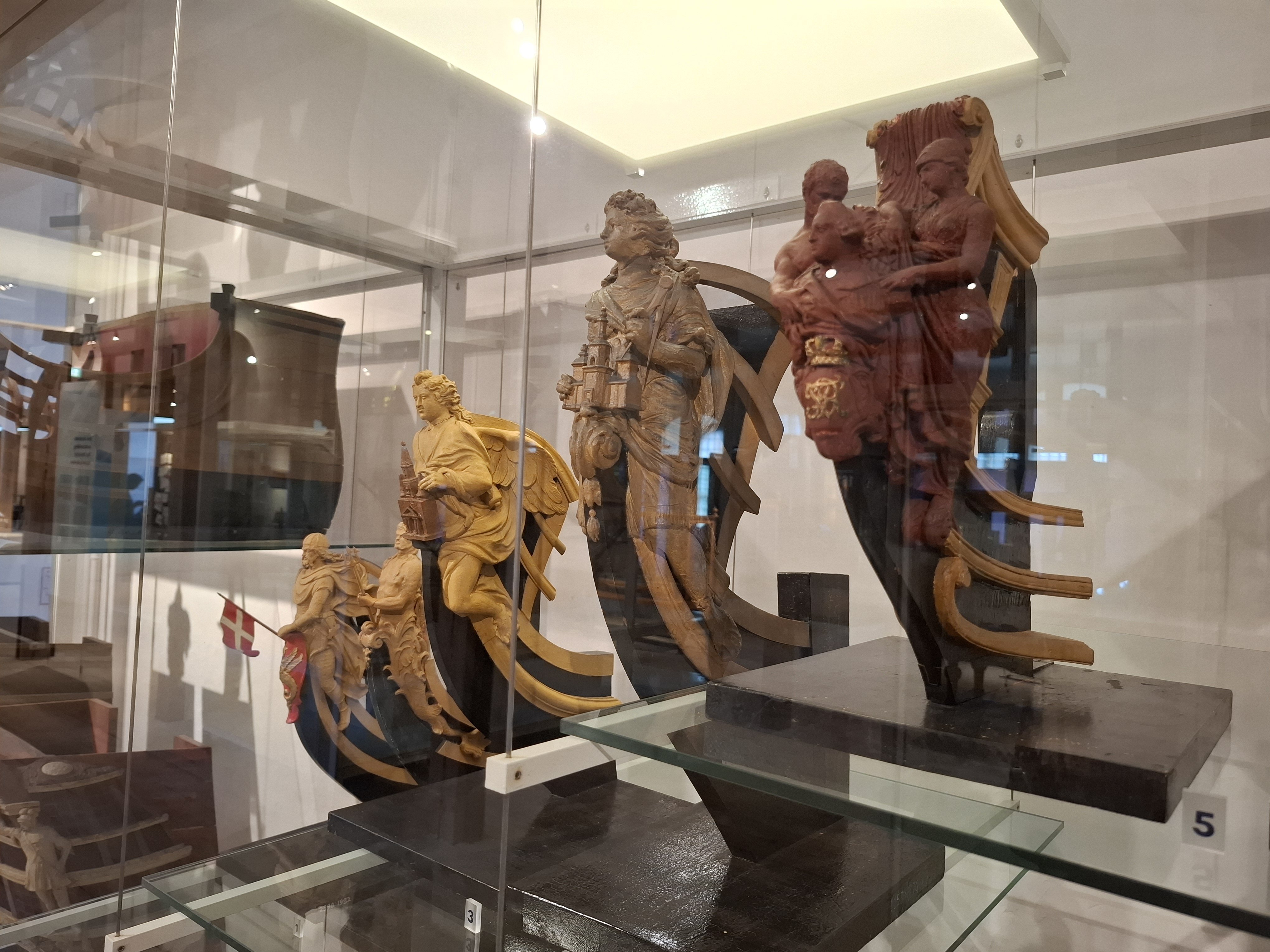

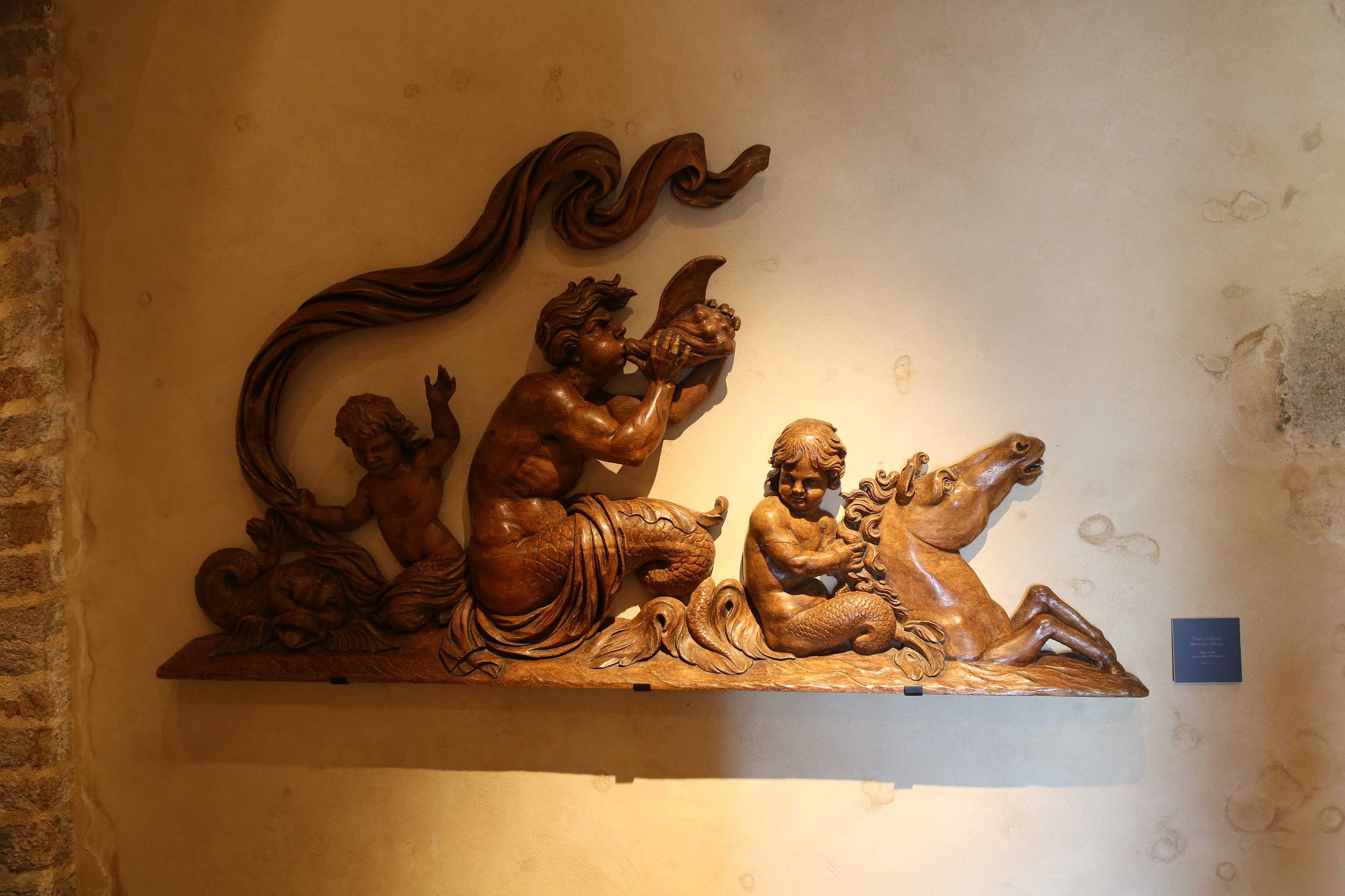

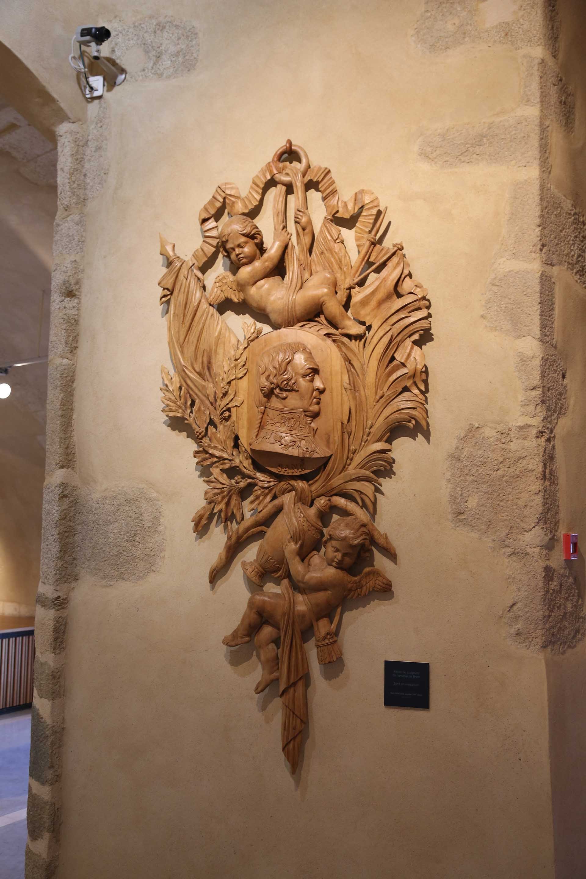

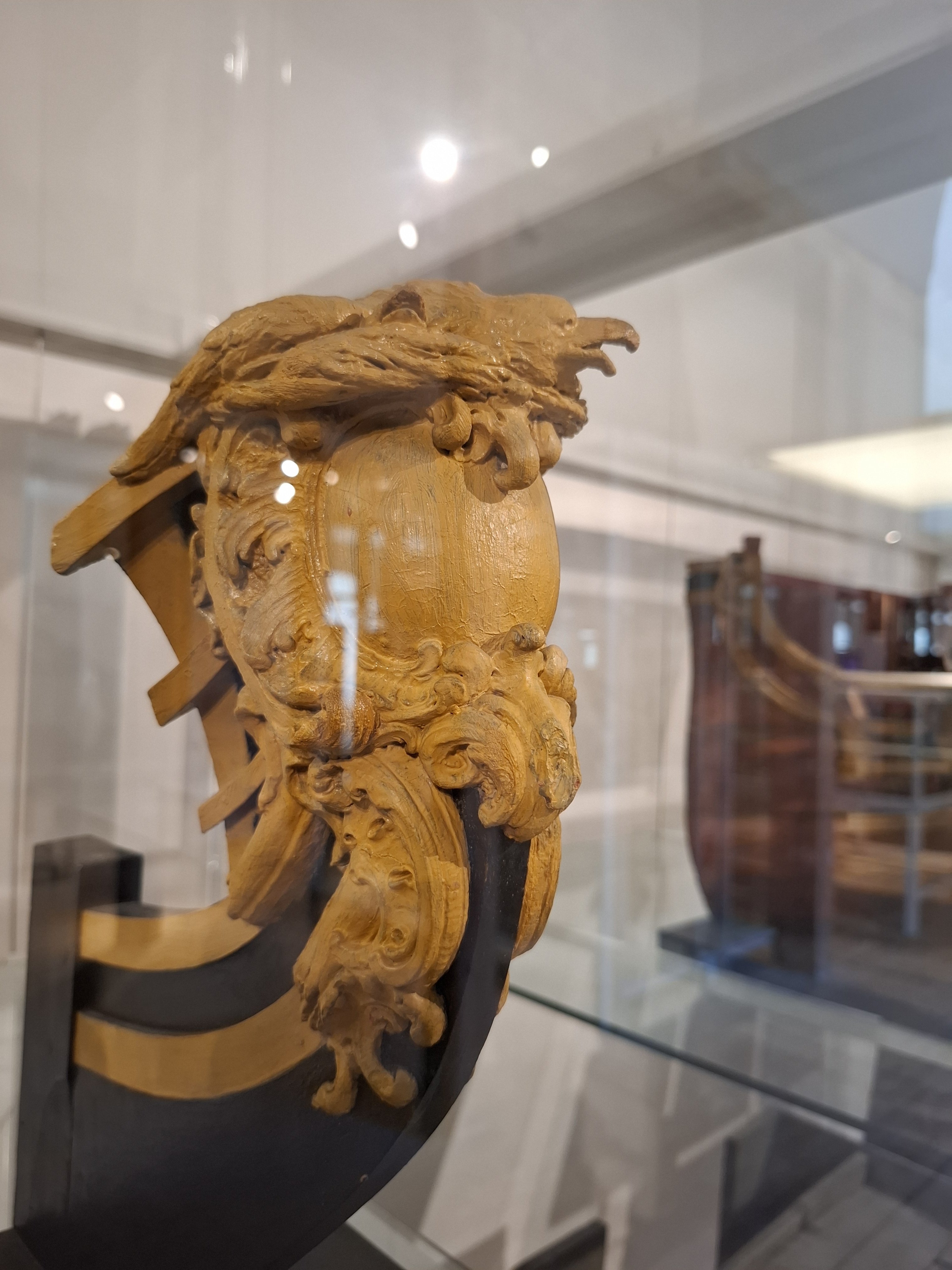

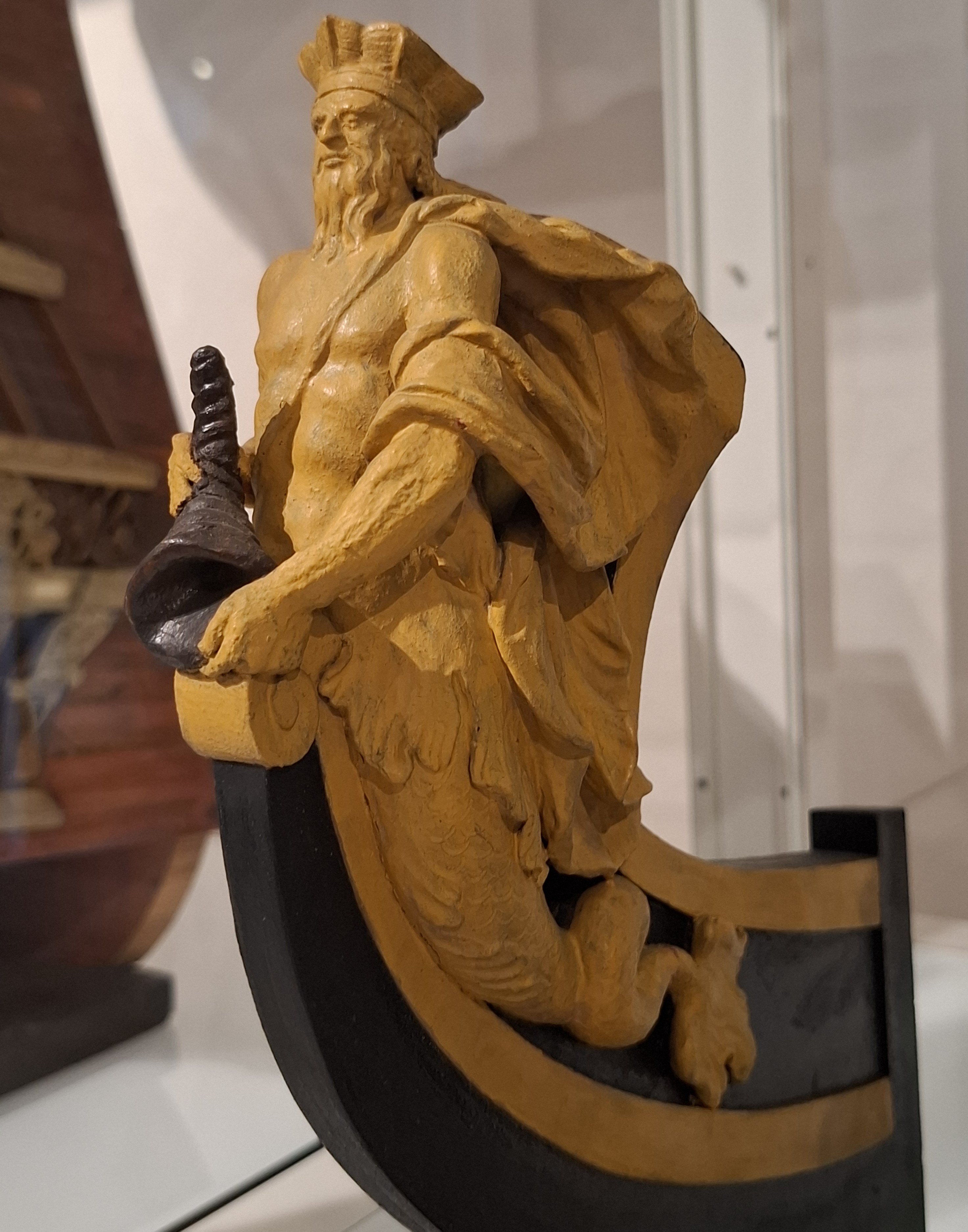

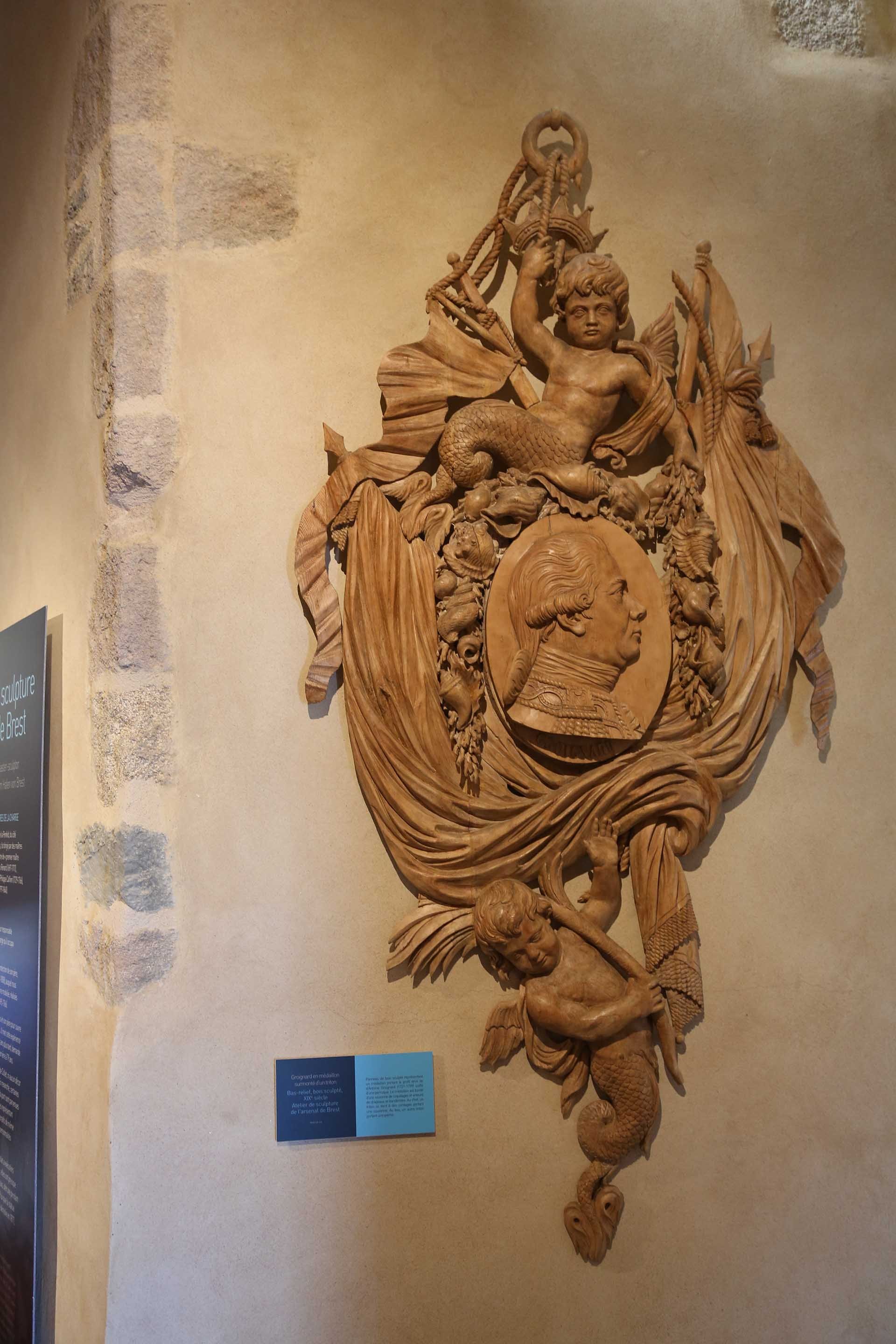

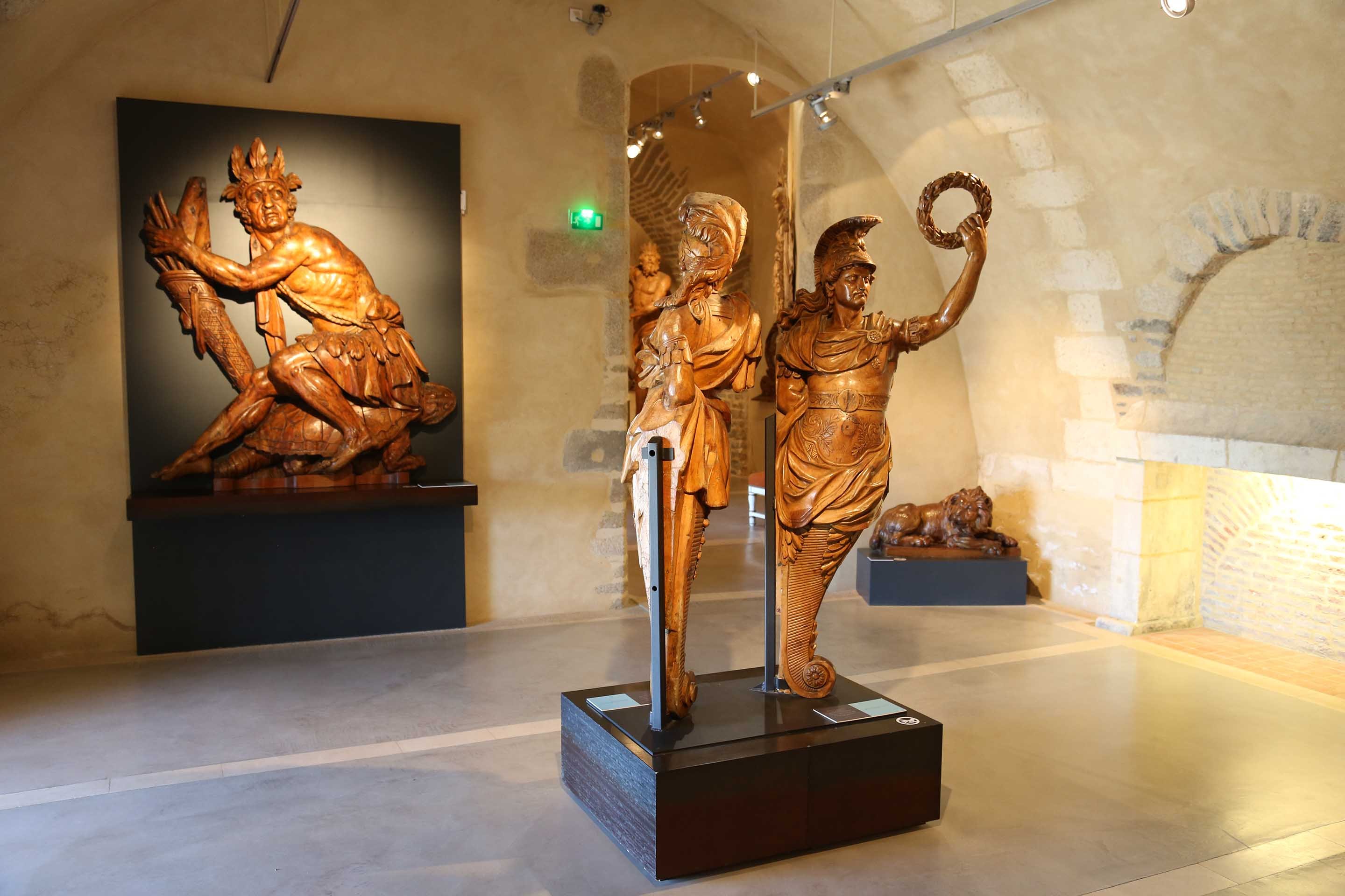

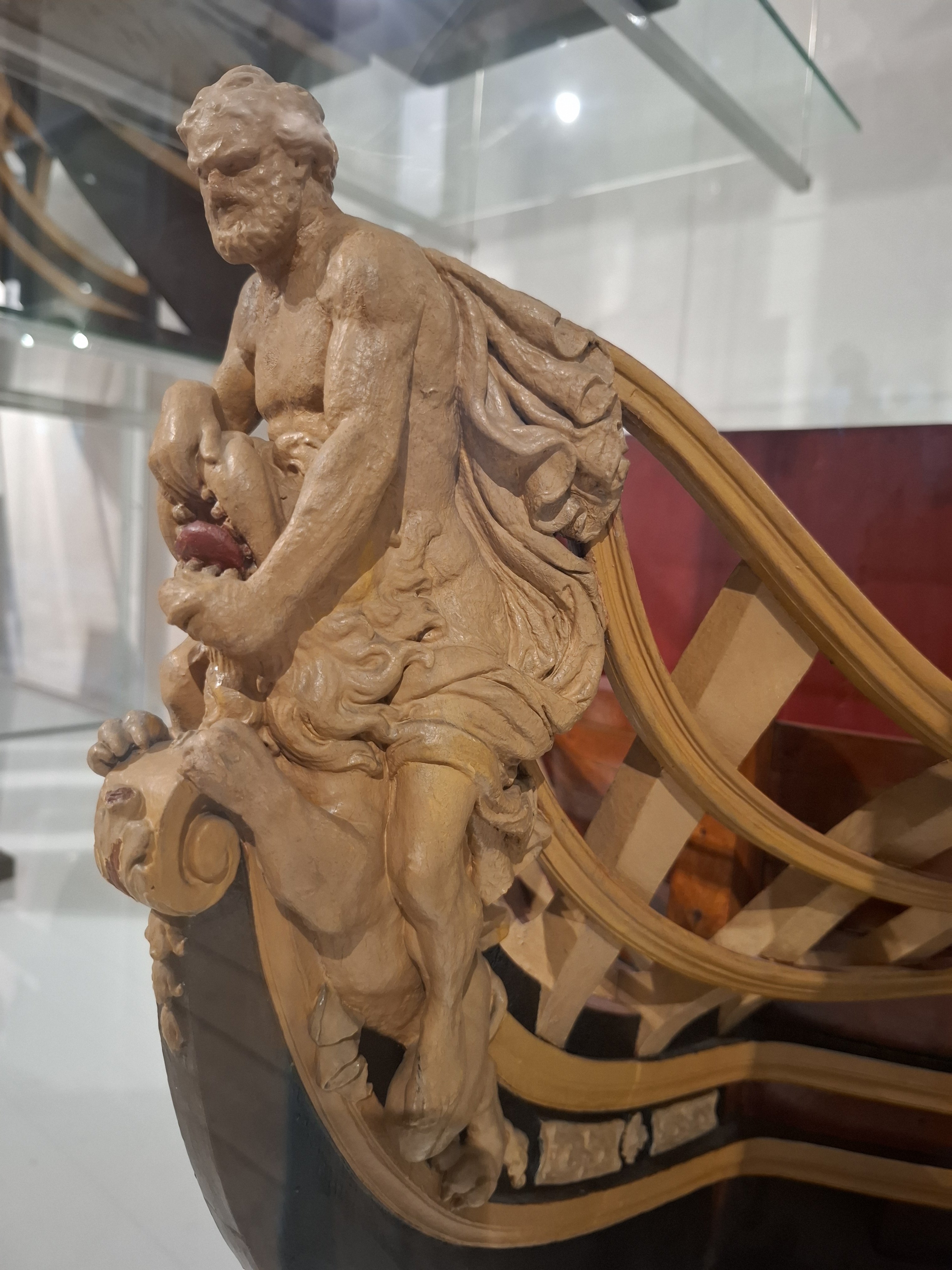

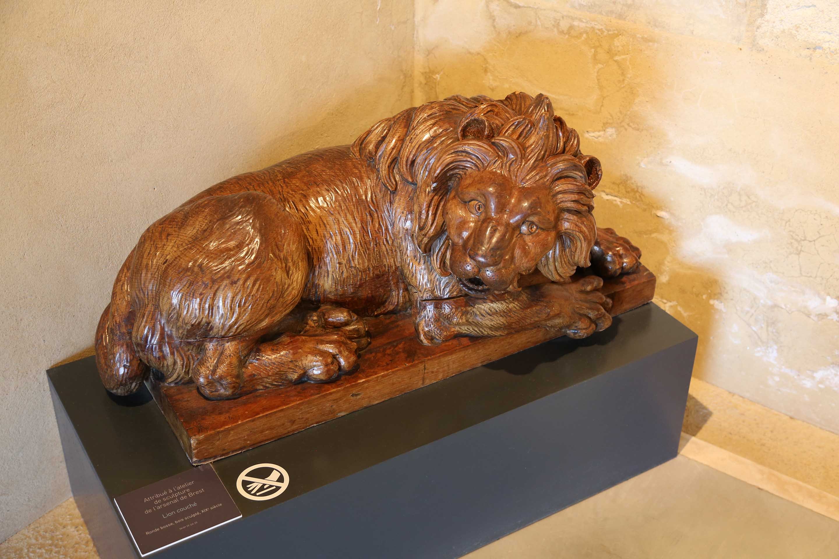

Hi Alexandr,

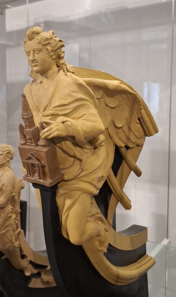

I am going to use the Wax to make carving studies for the sculptures I want to make for my model. The posture of the figures are sometimes very twisted. I am just doing my first carvings, I have not much experimente in finding the proper body posture. I don't want to waste too much wood. The final Version will be boxwood like the other carvings. Here you see, what I mean.
IMG_6918.thumb.jpg.736ee3d5f5ef02d7073e189c7114e3ce.jpg.838332b143b14db0b54e7e15dea0289c.jpg
IMG_6928.thumb.jpg.079d0bc7feafe3bfd0a4ae16066dfeba.jpg.69a03643558aa2a015a7bff16e9d27a8.jpg
This model dates from 1748. The figures are made from wax.

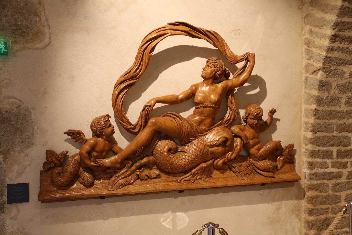

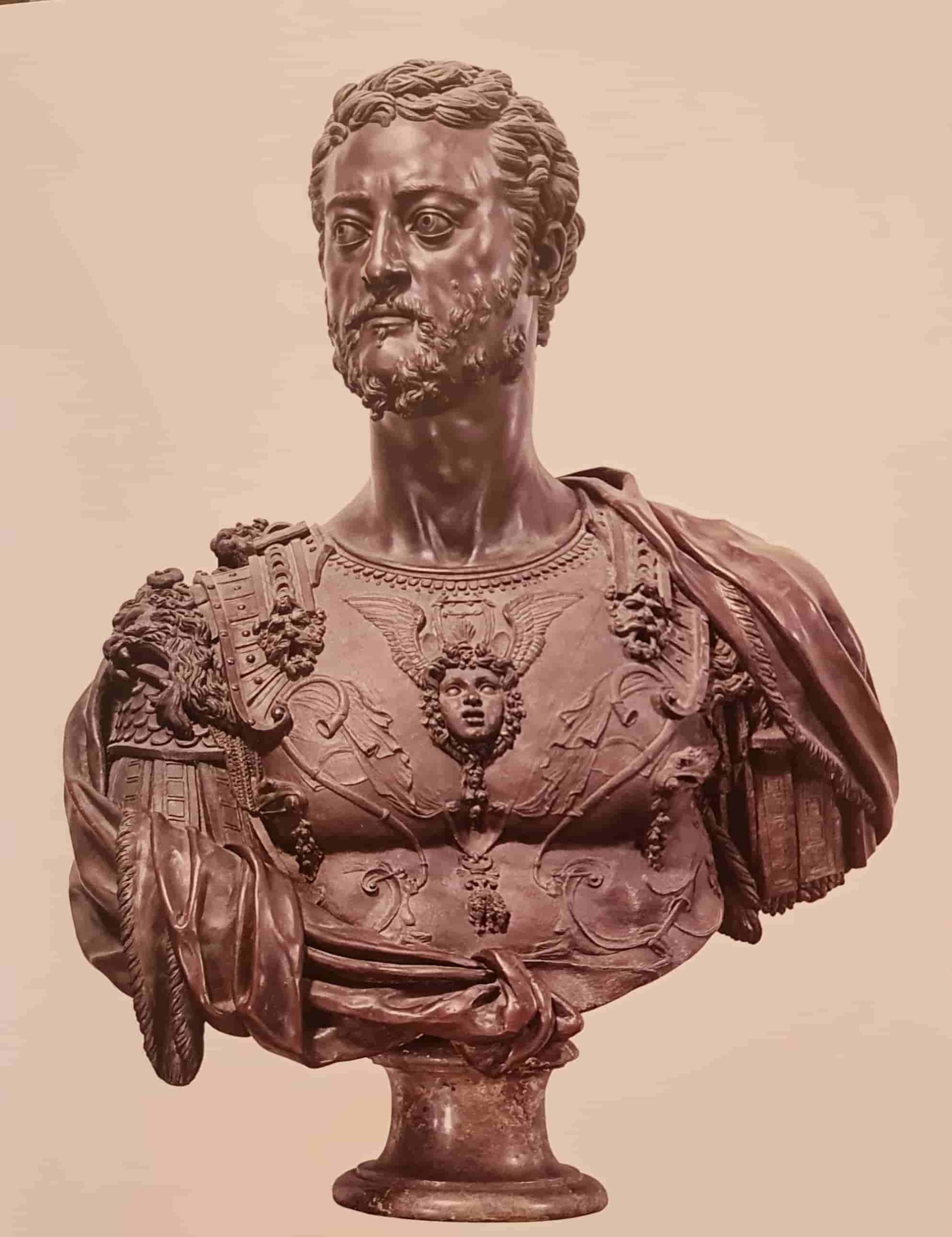

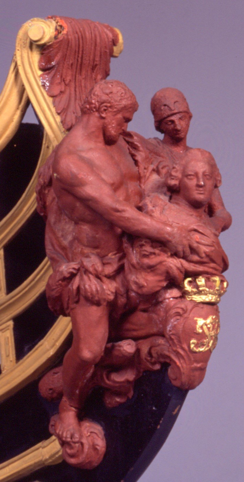

By the way, you were talking about the muscle armour of your figurehead. Here are two nice exampley from the Maritime Museum at Brest.
Matthias
Edited by Beckmann
13 hours ago, Beckmann said:
Hi Alexandr,
Hello, Matthias.
Thank you very much for your reply — now everything is clear to me.
What can I say? Knowing myself and my experience with preparatory stages, wax may indeed be useful to me, but I will definitely need to train my self-discipline and patience. If I imagine myself as a sculptor in this context, then rather as someone who would make modeled figures as the final material. Perhaps these would be epoxy compounds that harden over a certain period of time. Even that, however, is a very big question for me. I would have to learn completely different skills.
Still, useful information should always accumulate in one’s mind. You never know when it might come in handy. Thank you very much for these very helpful suggestions.
Your examples of sculptures, as always, are excellent. You have a real talent for finding the right reference. It does not come so easily to me. I look at a lot of material and read quite a bit as well, but almost everything seems to evaporate. And then, when I suddenly need something for work, I struggle to remember: where did I see this? I am sure I must have saved similar examples in my library — but where did I put them?
Are the sculptures from Copenhagen and Brest yours? I have never come across these particular photographs before. Have you perhaps been to the Erlachhof Museum? I am very interested in that lion sculpture.
I only have photographs from this angle.
From other angles there are only very poor-quality images in which it is impossible to make out any details.

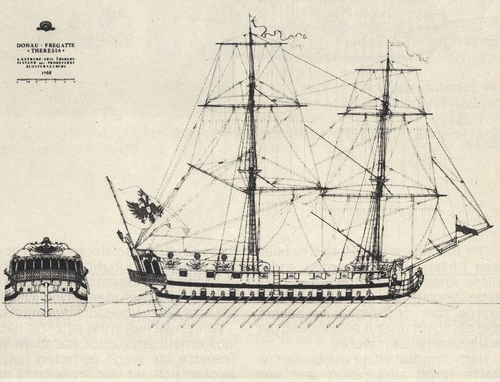

screenshot-beyondarts.at-2024_01.25-22_56_58.jpg.3cdb09bf30c4ac6145192324ac1176ec.jpg
The same can be said about the model of Theresa. Unfortunately, the lion is poorly visible in the photographs I have come across. Perhaps you have any information on this subject? I would very much like to recreate the German lion. Although perhaps it would be more accurate to speak of an Austro-Hungarian lion — I am not entirely sure. But the lion is very interesting. I do not know of any others that could truly fit the definition of a “German lion.”
Sincerely, Aleksandr

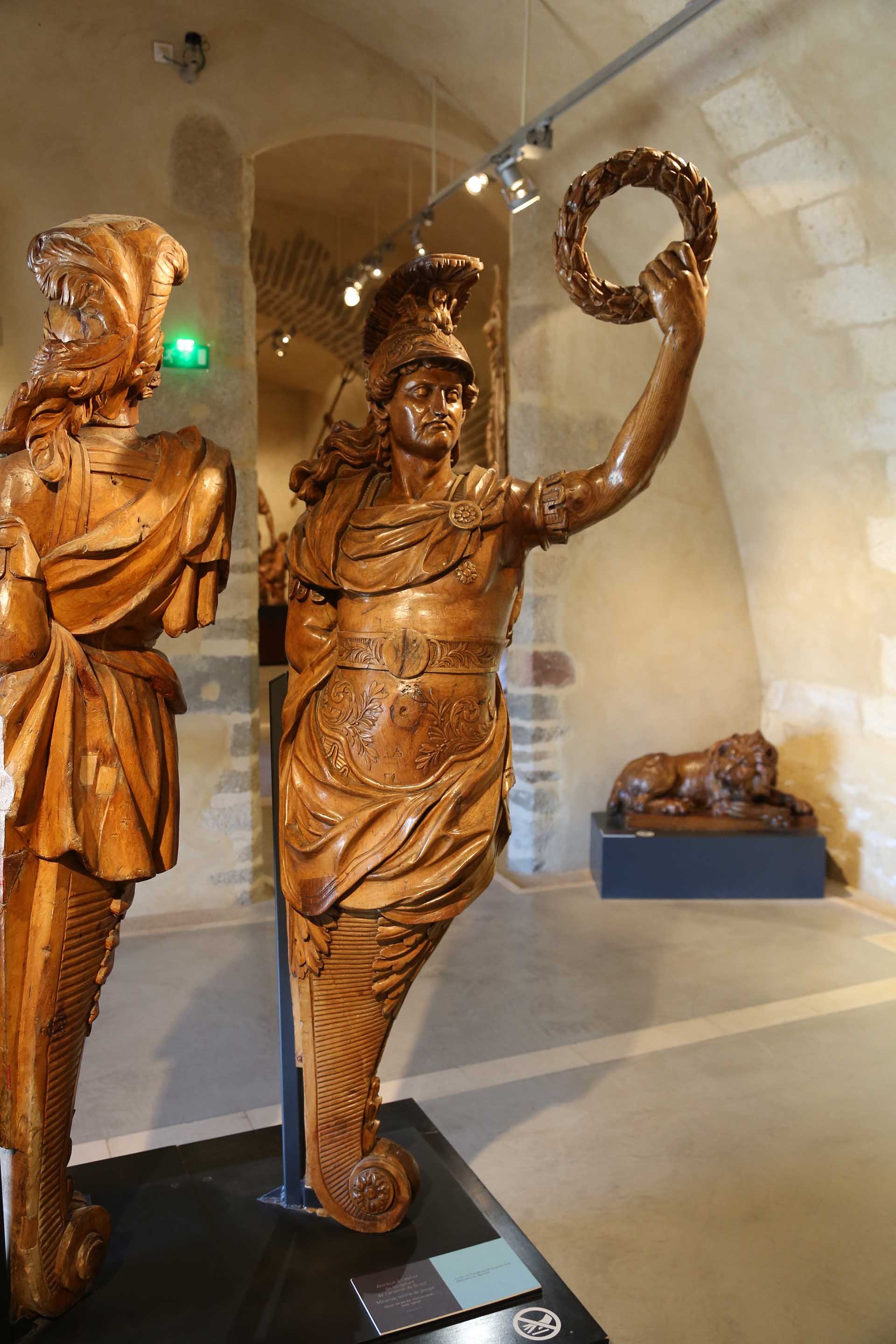

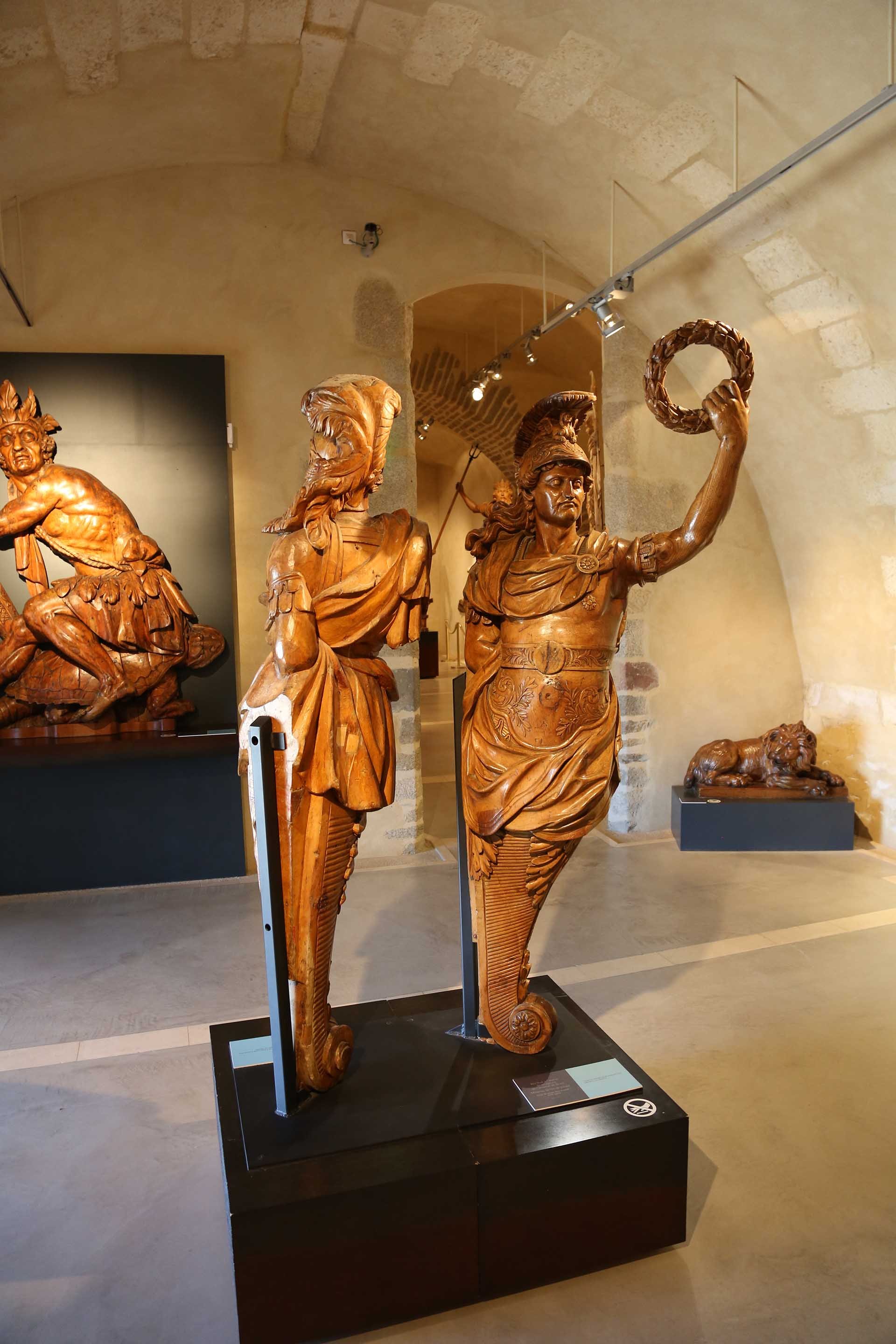

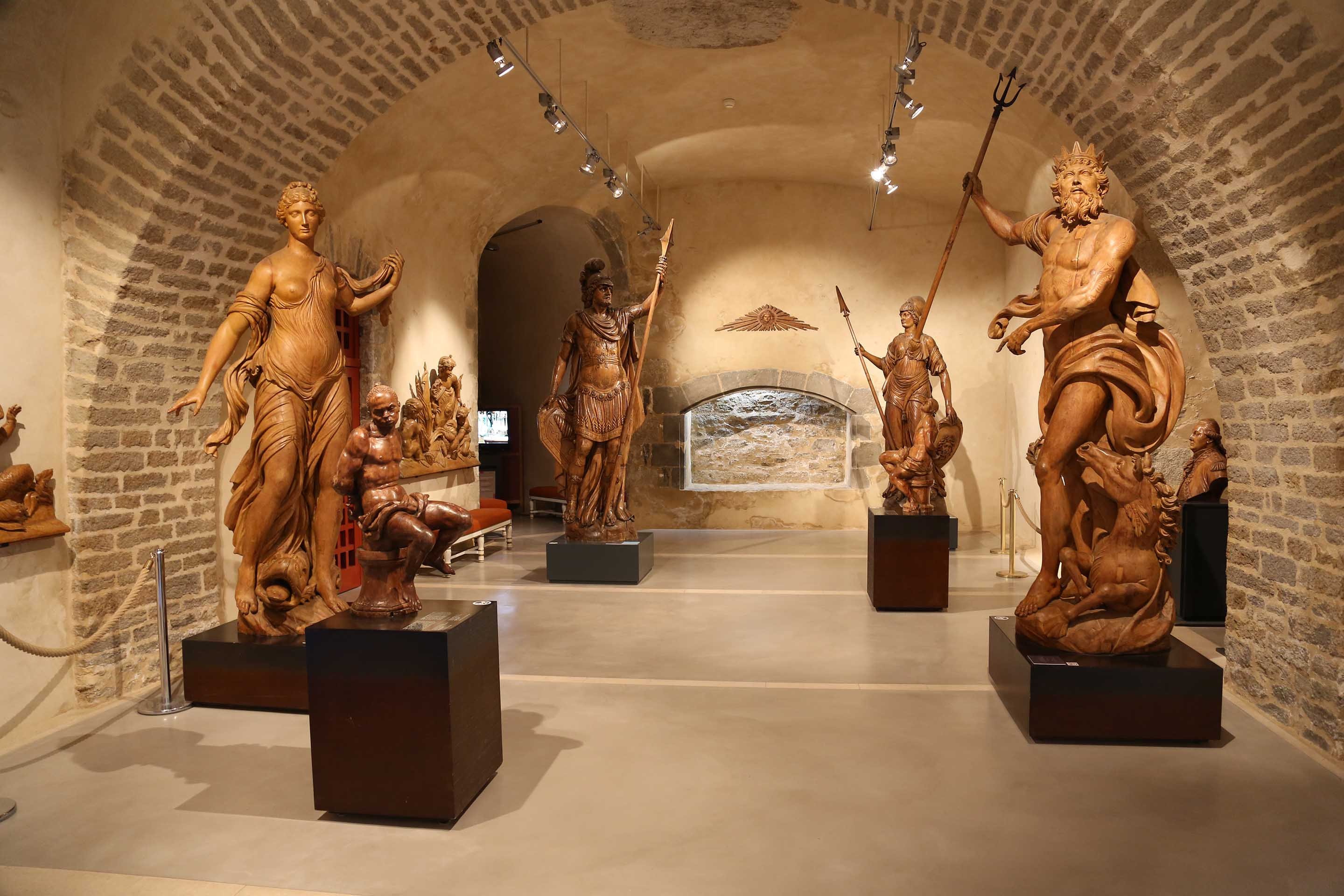

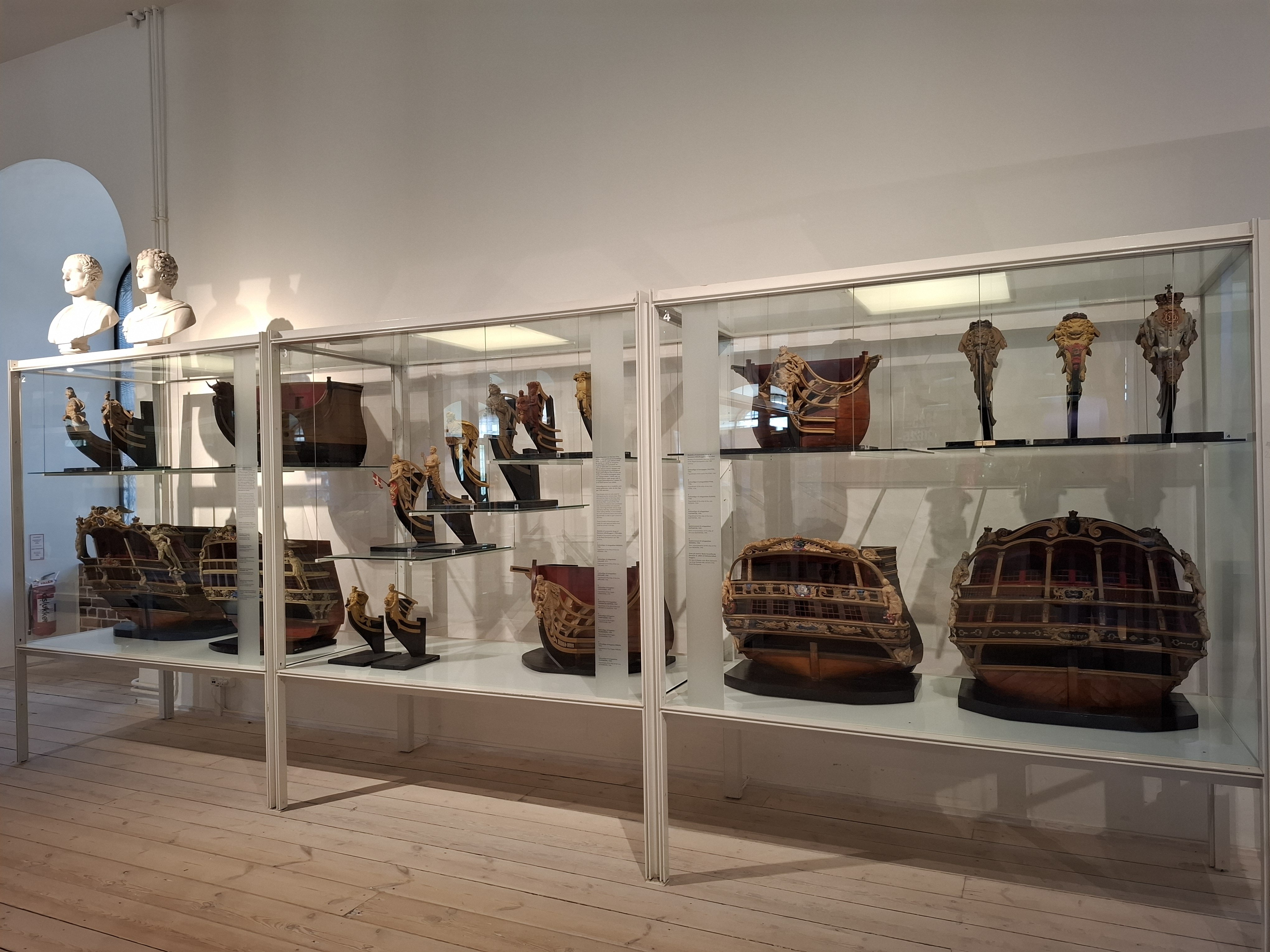

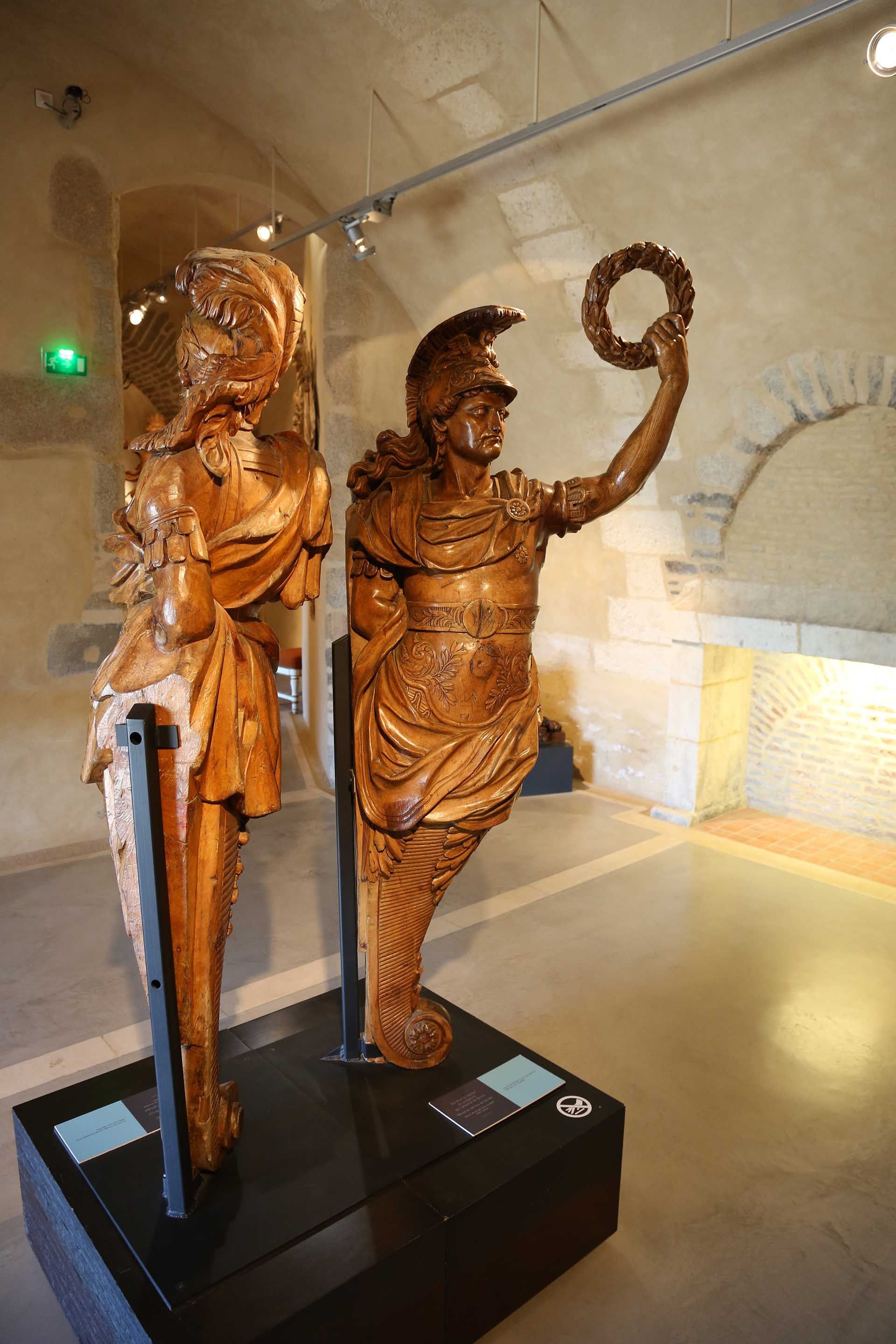

Hi Alexandr,

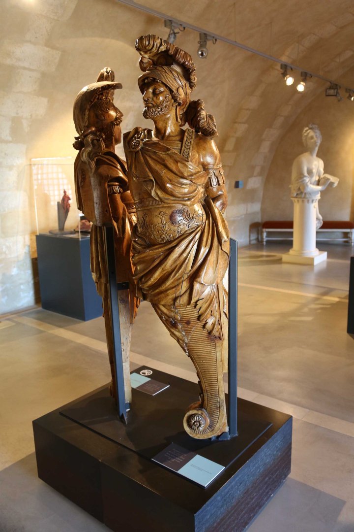

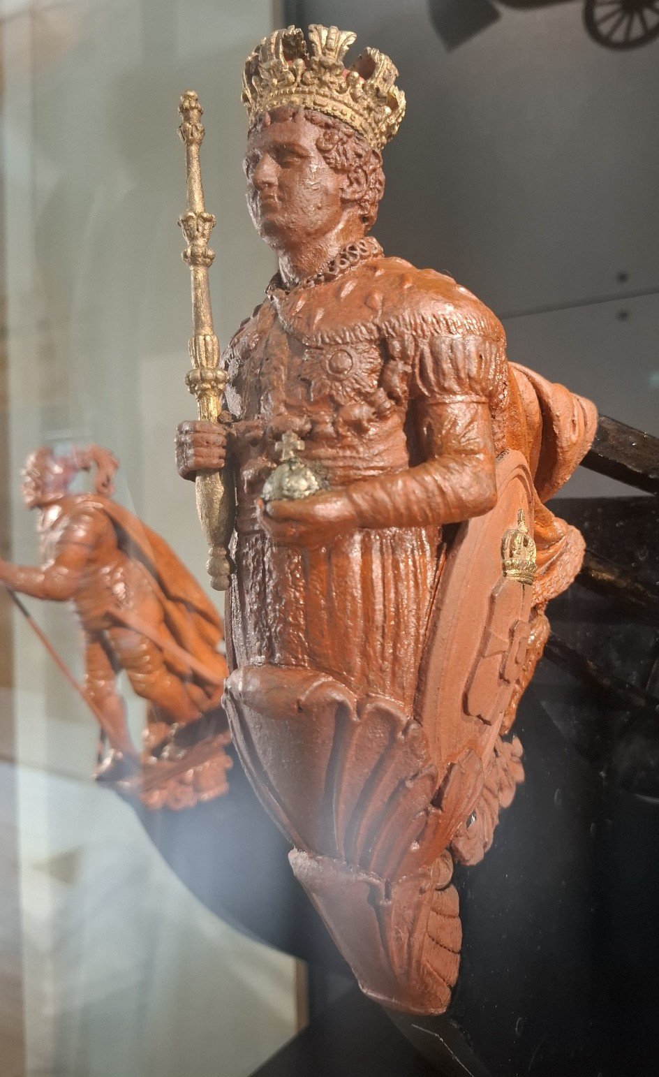

the stern-model you can see at the krigsmuseet Kopenhagen, the wooden sculptures can be seen at the mussee de la marine at Brest in France.
Here are more photos from Brest - wonderful collection by the way.
and the Krigsmuseet at Kopenhagen,
The stern-model I am building is at the very left side on the lower shelf.

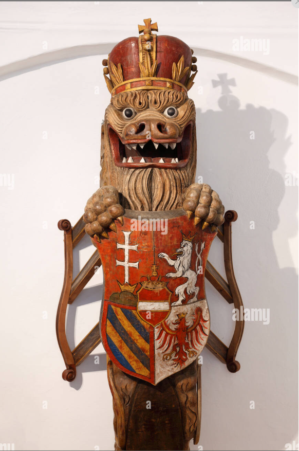

Concerning Erlachhof, I haven't been there. Is that in Austria, or in Germany? I don't know the museum.
Matthias
Edited by Beckmann

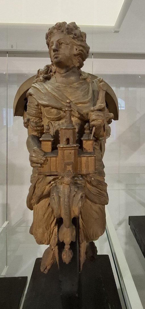

Here is what I know:
It is a small museum located in a castle—or, according to other sources, in the manor of the former Erlahof Abbey. It is in the town of Spitz, in Austria. That is all I know. And it is the only lion I have encountered in the German-speaking region.
Unfortunately, museums offer almost no examples of German shipbuilding. It feels as if the navy in this region appears only starting with ironclads. I know virtually nothing about Germany’s “wooden” naval history.
At present, I have set myself the goal of creating a small collection of sculptures from different countries. I chose one common subject for all of them—the lion—in order to compare different styles. And no matter how much I search, I cannot find a suitable candidate for a German variant. This lion is the closest I have found. Even so, photographs of this sculpture in usable quality exist only from one angle, which is disappointing.
For this project, personal imagination—like with Azov—will not be sufficient. Here it is important for me to reproduce something as close to the original as possible.

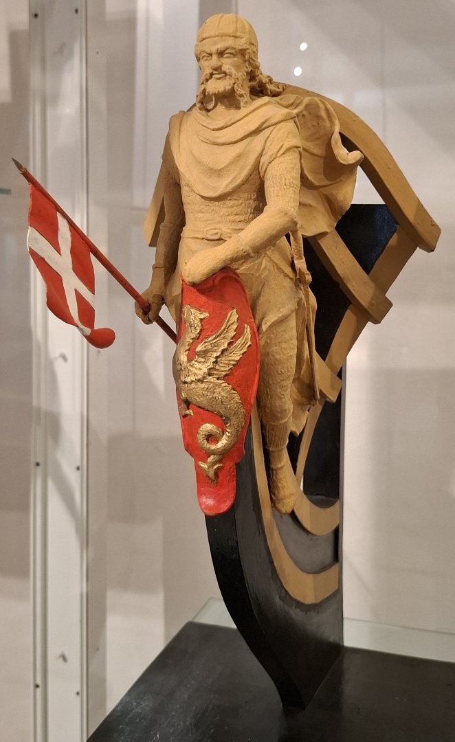

Hi Alexandr,
the reason is, that there was no german navy before the ironclads.
The Hansestädte like Lübeck and Hamburg had a small navy and Prussia and Austria. Later Schleswig-Holstein as well.
But often there was no lokal shipyard-capacity and so, they purchased ships at the Netherlands and in England. There was a wooden german merchant navy, but these ships usually had no lions as figureheads, because that is a royal symbol. The Altona Museum has got a nice collection of figureheads of merchant ships.

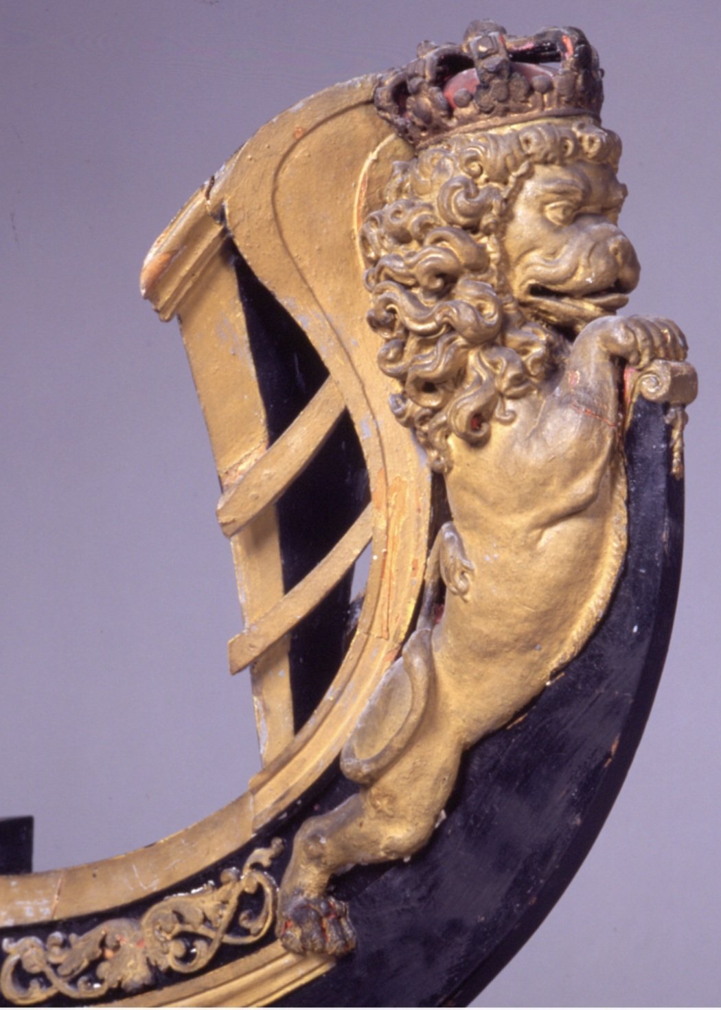

For now I can offer a danish Lion, made  by Just Wiedewelt in the 1740's. He came from Germany,.from the city Schleiz in Saxony, but worked at Kopenhagen for the danish navy.
You might know this example.
Matthias
Edited by Beckmann
4 hours ago, Beckmann said:
Hi Alexandr,
Matthias, thank you very much for your reply. You clarified a lot regarding the history of the German navy, and that is very valuable. I enjoy learning more.
I am familiar with that Danish lion, but you still made a wonderful gift for me, because in my library I have this lion in much poorer quality.
The reason is easy to explain. The overwhelming majority of museum photographs available online are taken by visitors. In that case, they are simply overview shots made on phones. People do not aim to focus on nuances or on proper object photography. One has to rely on modelers, who photograph more meticulously—but such images still have to be found. Or it is better to travel to museums oneself, which is not so easy either.
Your story about Wiedevelt is also a tremendous gift. I will try to look for more information about him. Your remarks about his work in Denmark raise a very interesting question: how can specific sculptures be assigned to a national school? If a German created a work in Denmark, where should that work be placed? Is it German, or Danish? Everything is intertwined.
One can argue for a territorial principle: if it was made in Denmark and later sailed under the Danish flag, then of course it can be called a Danish work. But at the same time, the author may have created it based on experience and an artistic style that he brought from home—or perhaps even from another country.

On ancient sculptures, several zones can be identified for placing decorative elements. At the upper part of the chest, one can very often see a gorgoneion — the head of Medusa Gorgon. This decorative element can be called canonical. And here I had no doubts at all. It goes straight into my set of decorations without hesitation.
I will not go into the allegorical meaning — everything is obvious and immediately understandable. So, the chest is finished and we can move on… Or rather — no, wait. We are not finished. It is worth pausing here a bit longer. There is something else that I considered and thought through, but for various reasons did not include in my final set. I drew attention to this image.
And it interested me. In it, I noticed something that I had not encountered in ancient sculpture. And that is no coincidence, because this is precisely a case where the figure depicted is not an ancient ruler or commander. This is Cosimo I de’ Medici, one of the European rulers of the 16th century. And this bust is exactly an example of a person trying on the image of an ancient character. And in this bust, I was particularly interested in this detail.
Looking closer, I realized that this is not just a decoration — it is the pendant of the Order of the Golden Fleece. That is, an award, a badge of distinction, real regalia of this duke, and not an allegorical element like the head of Medusa Gorgon.
And this is interesting.
These people were quite International. Wiedewelt learnt his art in the Netherlands in 1692 he was for 4  years assistant of dutch carver Thomas Quellinus. Afterwarts 2 years at Antwerpen with Artur Quellinus.(Father of Thomas). From 1698 to 1715 he  worked in Paris. From 1715 on he was in Kopenhagen, were he stayed the rest of his life .Thomas Quelinus had been a carver at Kopenhagen as well,.before he moved to the Netherlands. I think in those times everybody looked at Paris. French stile and art at the court of Louis Quatorze was the ultimate example.
That is him.
800px-Just_Wiedewelt.jpg.98d801014605f69b8701183e719a1af9.jpg The Medaillon was made by his son Johannes Wiedewelt, who was a famous sculptor himself, but not in maritime context.
Matthias
Edited by Beckmann
Now let us move lower, to the area of the abdomen or the abdominal muscles. What should be depicted here? Essentially, this is often the center of the entire decorative composition and of the allegorical description of the owner of the armor. This is where scenes praising virtues and merits are usually placed, or where victories and conquests are depicted. I examined various options. One could depict it this way, or that way. Or something else entirely. All of these were possible. One simply has to decide what exactly to show.
Although there were several options, I decided to settle on placing Jupiter as the main figure at the center. He will be my principal character and the focal point around which everything else will be arranged.
Why Jupiter? There are several reasons for choosing this allegory. Let us start with the simplest explanation. This is a fairly standard and frequently used figure on antique armor.
This god is perfectly suited as an allegory of power, authority, and might. He stands above all others; he is supreme, and there is no one above him. Who could be a better embodiment of imperial power and strength? If one is to demonstrate one’s power, it makes sense to do so by comparing oneself with someone who stands above all others. That is only logical. But this is not all.
I have already said that in my interpretation I want to intertwine several figures at once. I want to show one ruler who places himself on an equal footing with another celebrated ruler. He demonstrates that the coincidence of their names is not accidental, but a sign—an equality in strength, a similarity in greatness, and so on. I hope I have used enough grandiloquent words here. If one is to compare oneself with gods and great rulers of antiquity, there is no reason to be modest with epithets.
So, I thought that Jupiter would serve as an excellent link between one Alexander and the other. After all, Alexander the Great considered himself the son of Zeus. Thus Jupiter (who is Zeus) would signify not only supreme power, but also patronage—like a father supporting his famous earthly son.
In my mind, there was also a third analogy. Jupiter is often associated with the eagle. This bird was almost like his adjutant and personal companion, and Jupiter himself could also be depicted as an eagle. And this bird, once again, connects the ancient god with the eagle that serves as a symbol of the entire state, since the eagle is a figure of the Russian coat of arms. That is, this is no longer merely an allegory of a single individual—Alexander I—but at the same time a statement that the victor and triumphant force is the entire country.
That is quite a turn of thought. So, in the end, Jupiter, according to my idea, should represent the victorious nature of the state, the personal triumph of Alexander I, and at the same time hint at Alexander the Great.
…to be continued…
7.30 - Wake up
9.00 - Dispersal of clouds
10.00 -19.00 - Feat
On both sides of Jupiter, I decided to place the principal victories of Alexander I. During his reign, Russia took part in a series of different wars. But there is no particular sense in accounting for all of the triumphs. One could even mention only a single victory allegorically. Since the subject is the Russo-Turkish War, it would be logical for it to be reflected on the armor. Everything seems consistent. However, I decided that two victories should be shown. This is neither too much, nor just one.
And since these references must be composed together with the figure of Jupiter, it is logical that they should be placed on both sides of him.
I have already mentioned the Ottoman Empire, and paired with it there must be the victory over Napoleon. What symbols could speak for these countries?
Napoleonic France identified itself with the eagle, so let it appear on the cuirass. Depicting a defeated and subdued French eagle is a well-established motif. For example, here, on a commemorative medal, the victory of Great Britain over France is shown.
With the Ottoman Empire, however, things are somewhat more complicated. It was not possible to find an animal or bird associated with it that would allow for an ensemble of “beast-countries.” Neither the Ottoman Empire itself, nor anyone else, associated this state with anything of that kind.
In all cases where allegories of victory over the Turks were shown in engravings or paintings, they were depicted either as people with large turbans or voluminous trousers, or as banners bearing the crescent.
“Well, let it be so,” I decided. However, I soon realized that I would most likely have to depict only France. On one side, the place intended for a relief with the defeated enemy will be covered by the cloak. So be it—it actually makes things a bit easier for me.
I also decided that it would be appropriate to show not only the strength and military superiority of the victor. Triumphant figures often try to present themselves as merciful as well, ready to forgive their opponents. This is also a common motif in such allegories. It would be fitting to show that Alexander did not seek to destroy either France or the Ottoman Empire. With the Turks, everything ended when Greece gained its freedom from the Ottoman Empire; with France, it ended with the expulsion of the French from Russia.
Allegorically, this can be shown in different ways—for example, by not depicting the eagle as dead, sprawled, or placed under the feet of Jupiter the victor. It is sufficient that it lowers its head before the winner. There are other symbols that indicate that wrath has been restrained. But I decided that at my scale such details would not be visible at all, so there is no point in planning them.
As a surrounding element, I decided to add trophy flags behind Jupiter, and to place griffins above the entire composition.
At this point, I finished working through the details of the emperor’s cuirass.

With the helmet, things will be simpler. There is not such an abundance of decorative elements here, so there is less to write about. I found the main answer to how I wanted the helmet to look back when I was comparing different variants and existing drawings of Azov and her sister ships. I immediately decided that I would keep the helmet roughly as it appeared in the drawings. I mean the lavish plumes above the helmet.
This is a very characteristic feature, and any changes here would be far more noticeable than liberties taken in ornamentation or even in the detailing of the cuirass. I see no reason to radically alter anything about the helmet. This conviction only strengthened when I made the plaster study. I liked the Renaissance-style version—the long visor of the helmet and the rich plumes on top. I assume these are ostrich feathers.
There are plenty of sculptural analogues:
One could even say that it was precisely the helmet that gave me the impulse for my artistic liberties. Such a helmet sets a Renaissance mood, with its free and lavish interpretations of costume and expression. If the helmet had been truly antique, then everything else would also have had to be done in that style, adhering to more restrained interpretations. But the helmet in the sketch suggested that I had greater freedom of action. The overall appearance could be lush, elaborate, baroque, or more restrained. This gave me room to be bolder.
I am not a great expert in military equipment, but it seems that such helmets are called burgonets. More precisely, this is likely a ceremonial or even a fantasy variant. Combat burgonets were simpler and more practical.
When I was making the plaster figure, I did not set myself the task of executing the helmet in its final form. I had other goals—I only gave the helmet its basic features and tried to suggest the luxuriant mass of feathers. In the final sculpture, however, I planned to add more detail.
First, a laurel wreath had to appear there. The meaning of this element is obvious: it shows that before us is not merely a warrior, but a triumphant one. It also indicates imperial status. Another important element of the helmet was to be a lion’s mask above the visor. The significance of this detail should also be clear.
Alexander the Great is depicted either wearing a helmet with a ram’s head or with a lion’s head. I considered ram’s horns inappropriate here, but the lion variant seemed entirely suitable.
Thus, my version was meant to lie somewhere at the intersection of these variants. This would establish logical parallels between the two Alexanders and place the Russian emperor alongside his Greek namesake.
At this point, I have fully described all my preliminary research. It was very interesting for me to think through and choose between the options. I hope that reading about it was not too tedious. Now, however, it is time to move on to carving the final sculpture.
Hi Alexandr,
the bavarian and the french army used to have such helmets, here are some examples from the middle of the 19th. century.
Hello, Matthias.
As always, you respond to my story with great attentiveness and continue to help with examples and advice. Thank you very much for that.

While I am preparing the text for the next parts, I will briefly step aside in the narrative with a request for help. For this same project, I am looking for more sculptures, and I need to add a British work with certain characteristics. Ideally, this composition would be perfect:
…but it is Danish. Do the English have anything similar? Something with several figures. However, options with horses and riders are not suitable, so no Royal Williams, no Princes, no Georges or Sovereigns. Victory is not acceptable either. And I will not even mention lions—there will be a whole pride of them nearby, so they are not an option as well.
I have been scrolling through dozens of images for four days now and still cannot find anything I can choose. Somehow the English seem to struggle with romance and imagination. There are no mythological characters. The French or the Danes have plenty of them—very different ones. But as soon as I need something similar from the English, it suddenly becomes a problem to find anything suitable.
Could you suggest what I might look for—something closer to this Dane?

Well, do you know the figurehead of 90 gun ship of the line St Georg from the year 1701?
It shows St Georg fighting a dragon.
Ther are a couple of models, often before 1703 with mythological figurehead-arrangements . If you want, I can send you some more photos.
Edited by Beckmann
Well, do you know the figurehead of 90 gun ship of the line St Georg?
I am honestly shocked and a bit overwhelmed. How do you manage to find a suitable example so quickly? I have been sitting for four days in a row, from morning until evening, going through the list ship by ship and trying to find at least something that fits. And you found a similar сюжет in just a few minutes. How is that even possible?
I have never come across this ship before, and I do not have it in my notes. Right now I am trying to find photographs. I have even found a few, but the quality is not very good, and the sculpture is visible only from one side. Are there any archives or libraries where the detailing can be examined more closely? Is there anything in the Greenwich collections? There I found only an engraving and a painting of the ship’s loss, but there seems to be no ship model available for viewing.
7.30 - Wake up
10.00 -19.00 - Feat
Hi Alexandr,
That was really just a coincidence. I just opened my book Volume 1 Rogers Collection in Annapolis and there it was. Here are two better pictures.
Also interesting:
Rogers Collection Volume 2 page 34:
Figureheads depicting Minerva and Neptun. (watch the helmet :))
and from the book Navy board ship models:
Second Rate from 1675: SLR 0003
Allegorie of a crowned figure being carried over the water in a chariot, drawn by eagles.
Same figurehead see SLR 0002 St Michael:
And SLR 0386 First Rate from 1702 a figurehead depicting the abduction of Europe by Zeus.
Matthias
