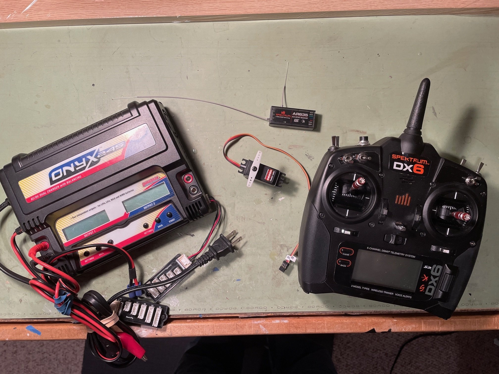

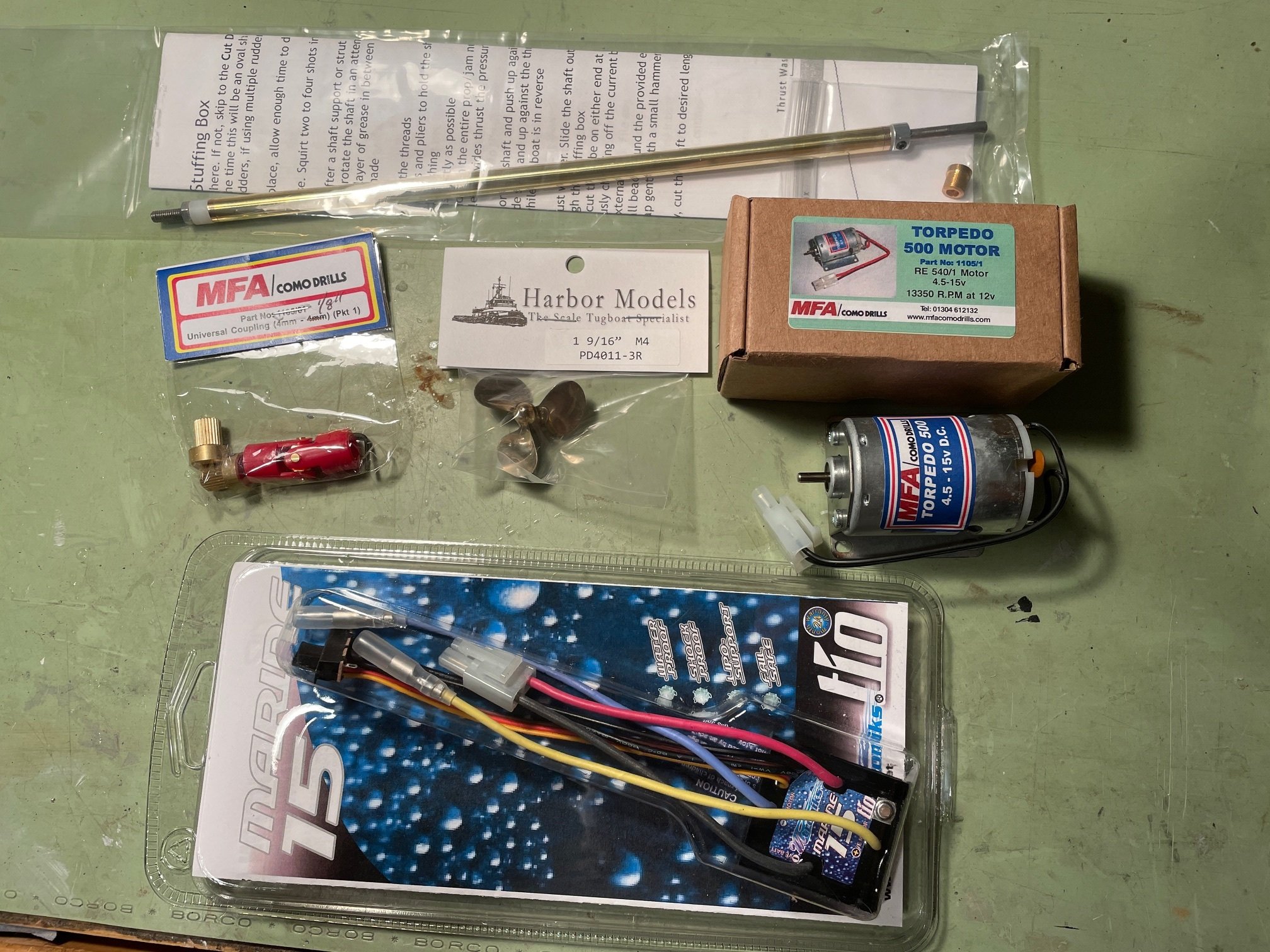

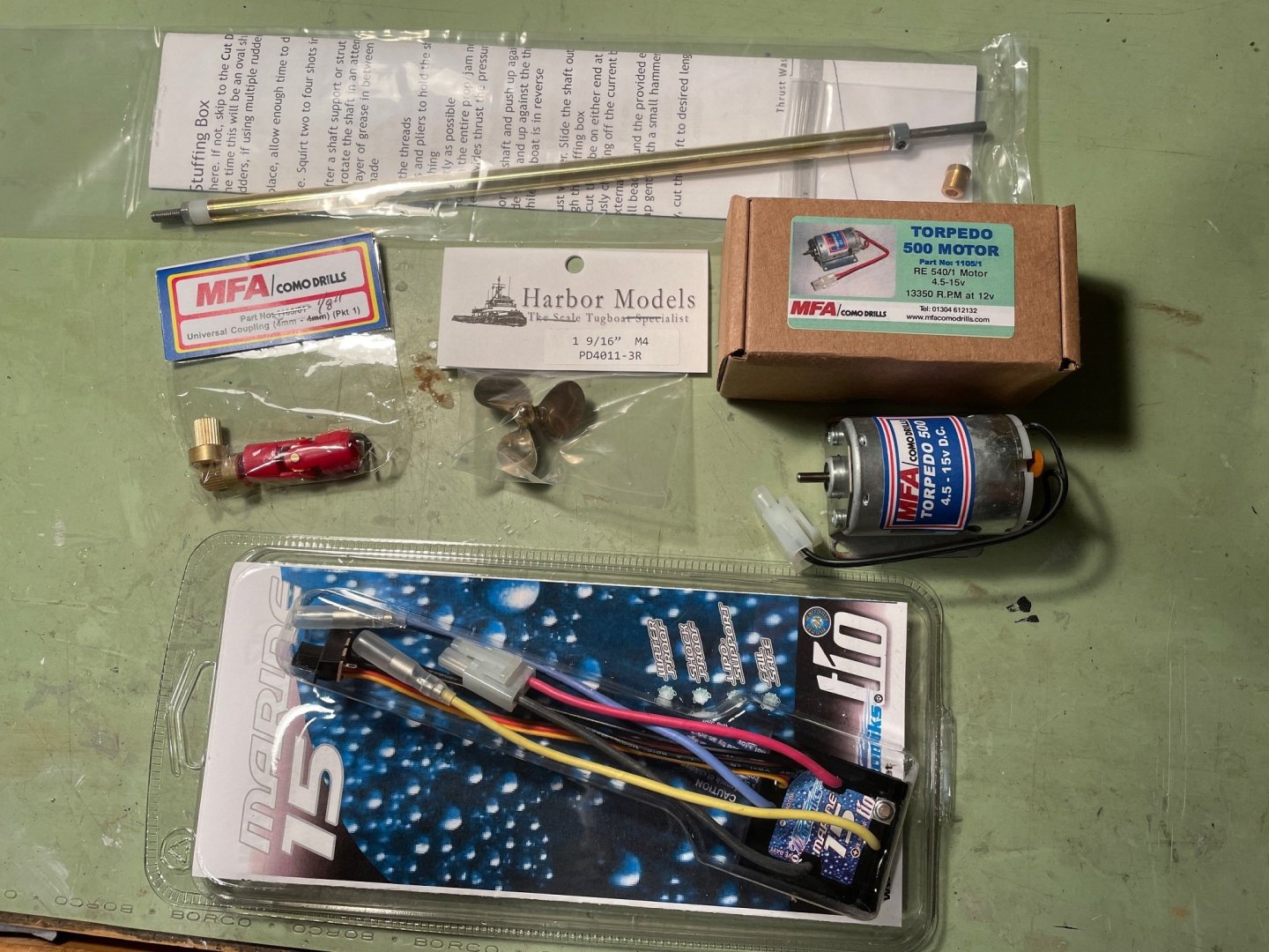

Not exactly a sea trial, but I’m taking baby steps. I used a friend’s pool to get a better feel for the controls and how the ship maneuvers. In a way, I’m glad I tested her in the pool first because it helped me work out a few kinks. I also wanted to try out the new transmitters I purchased—the Dumborc-6X. The first issue was a simple one: making sure the battery was fully charged. I put her in the water, made one lap around the pool, and the battery died. (Color me embarrassed.) 🫢 The next challenge was controlling the rudder movement and propeller speed. There was too much throw in the rudder servo, so I had to be careful not to turn the steering wheel too far to the left or right. The same issue showed up with the throttle—the forward speed was difficult to keep slow and steady. Later, after watching a YouTube video on the transmitter, I learned that you can limit both servo travel and maximum motor speed by adjusting the two knobs on top of the transmitter. These knobs control the percentage of maximum servo movement and motor output. (It takes me a while, but I eventually catch on.) I do have a video of this, but posting it here is above my pay grade.

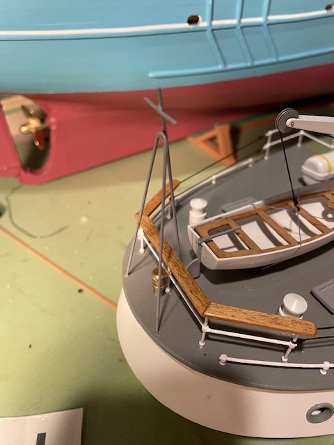

Based on @Kenchington's suggestion, I decided to create a new day shape for when the ship is underway. Using a wooden dowel, I sanded down the end to form two cone-shaped pieces. These pieces were glued together, and eyelets were added to each end to make it easier to connect the halyard. The entire shape was then painted black. I tied two small hooks to the ends of the halyard, allowing for quick and simple shape swaps. I kept the original round day shape and made a few modifications so it could be easily reattached to the halyard when the ship is sitting on the shelf. I'm always impressed as to how much knowledge is shared on this forum. As more of a modeler than a sailor, I'm always grateful when people take the time to share their expertise with those of us who aren’t as well-versed in seamanship as others. Thank you all for all the likes and have a Happy New Year.

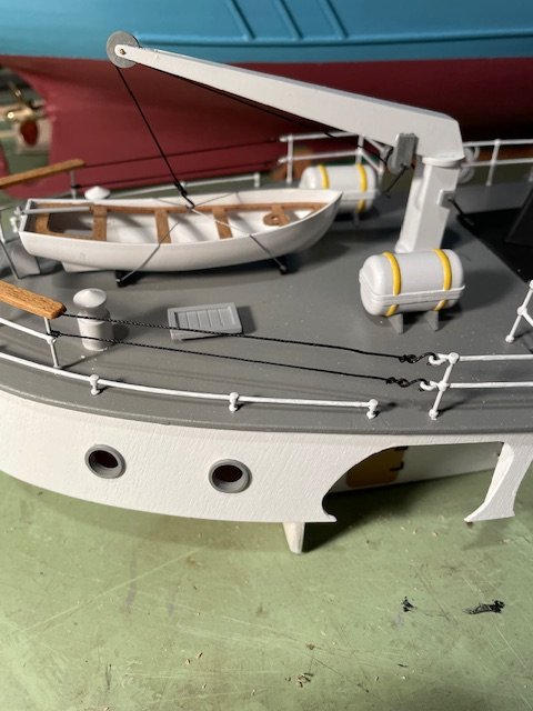

Getting close to the end The cables running from the deck cranes to the windlass were run along the deck and through the deck pulleys. Next I installed what might be a forestay running from the masthead down to a gusset plate at the bow. From this stay, a halyard was rigged down to a handrail post located on the bow deck. On this halyard I installed a wooden ball that was shown on the plans, though initially I had no idea what it’s called or its purpose. After showing a photo of it to my brother-in-law— an experienced sailor—I learned it’s an anchor signal ball. Further research confirmed that an anchor ball (or "day shape") is a black spherical marker used by vessels to indicate they are at anchor during daylight hours. Learned something new! Next, what I assume are antenna wires were installed running from the masthead aft to the wire support tower at the stern. These wires need to be easily removable so the cabin could be lifted off the model. To achieve this, I incorporated small hooks at the ends of the lines that attach to the wire support tower at the stern, allowing for simple detachment and reattachment. I also attached small hooks to the wires that run from the antenna wires down to the cabin roof deck for easy removal and reattachment. The ship’s number decals were added, The plastic fish were painted and placed into the fish storage bins. (they don't look to fresh 🫢) I also added several rope coils Nameplate installed Overall to date. Thanks for looking in and for the likes

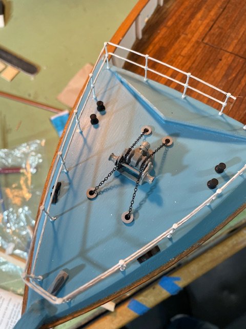

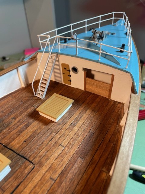

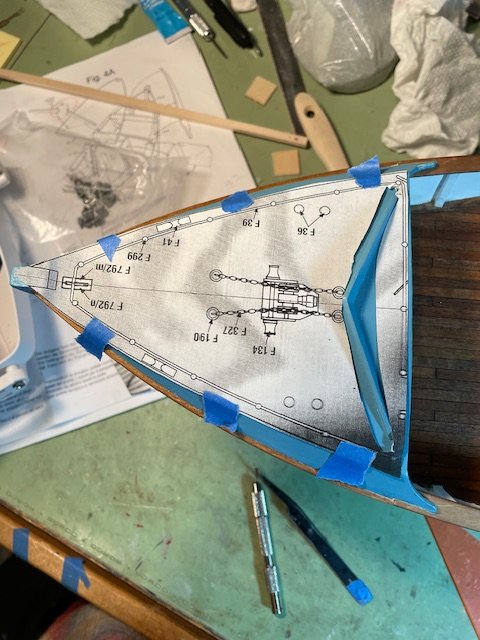

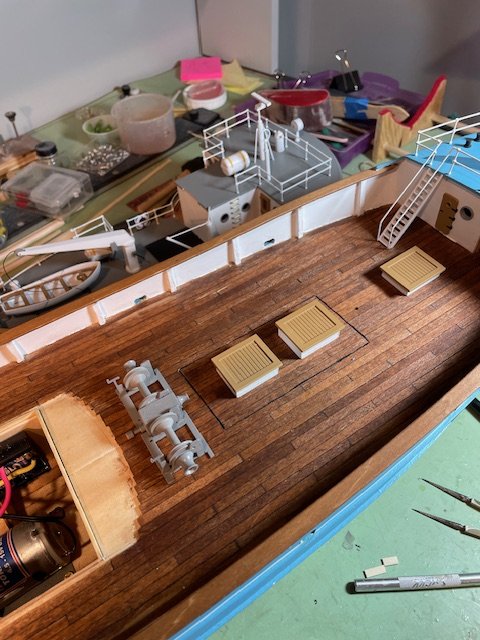

I was a little slow posting this update because I’m just getting over my first case of COVID. It took five years to finally catch it, and when I did, it did a pretty good job on me—but I’m all better now. I started at the bow, installing the handrail and windlass. To accurately locate the handrail posts, I made a photocopy of the bow section from the plans and taped it in place as a guide. I used a compass point to mark all the locations. I also marked the bollard locations on the deck. Next, I installed the ladder, deck hatches, and the larger windlass on the main deck. The two higher hatches are mounted on the removable deck portion to access the battery. After that, I jumped over to the hull pin striping. I had some 1/16” white pinstripe tape left over from another project, and it worked out very nicely. Then it was back to the superstructure. I installed the rear antenna support and the cable handrail, finished painting the stack and the anchors, and added pins to the anchors to help secure them to the hull. Thanks for looking in and for the likes.
