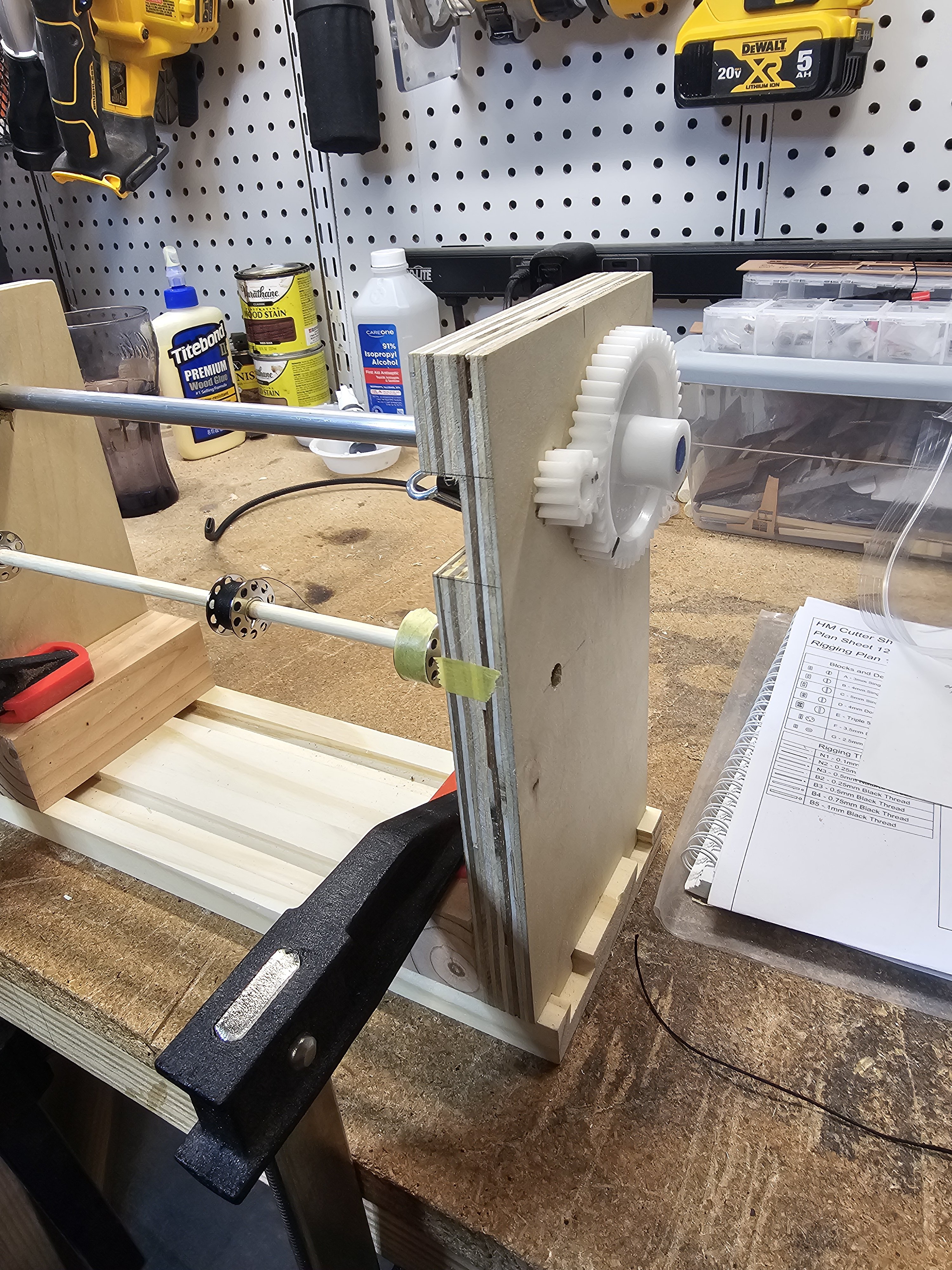

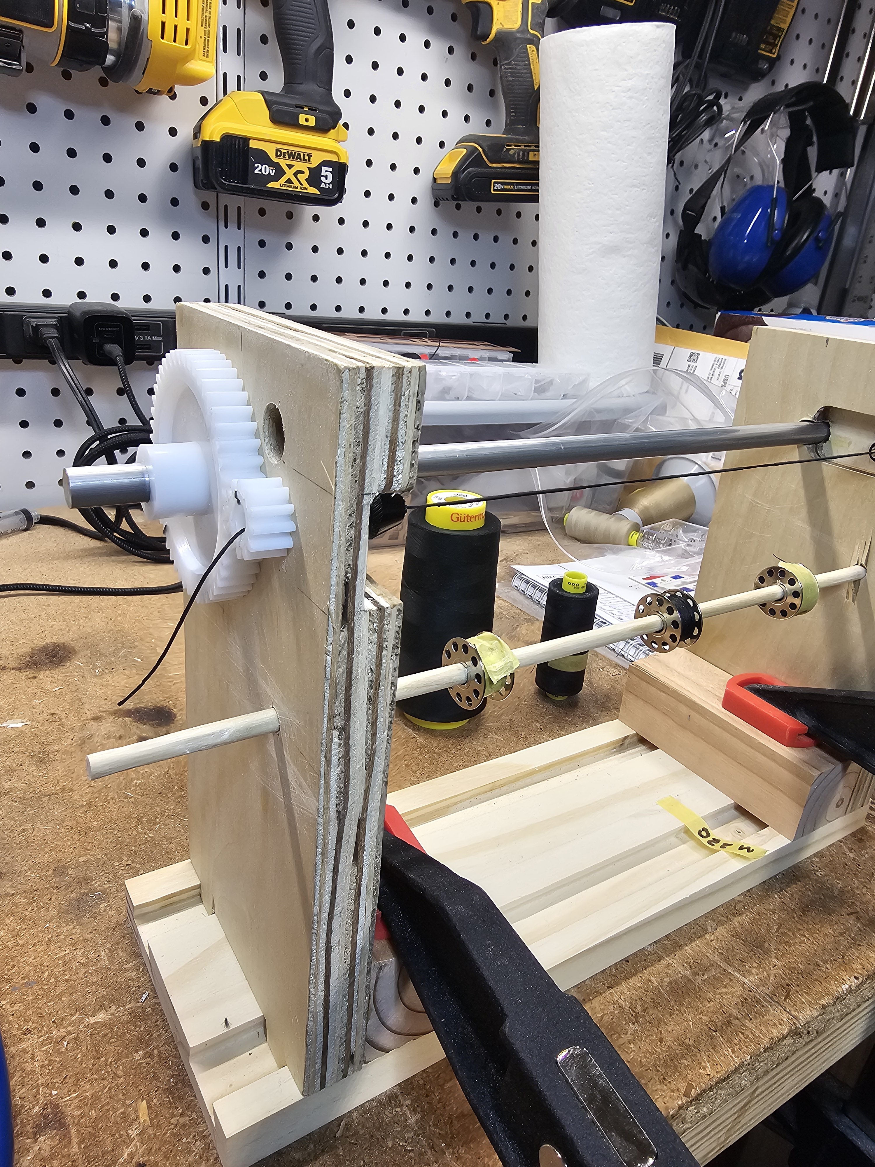

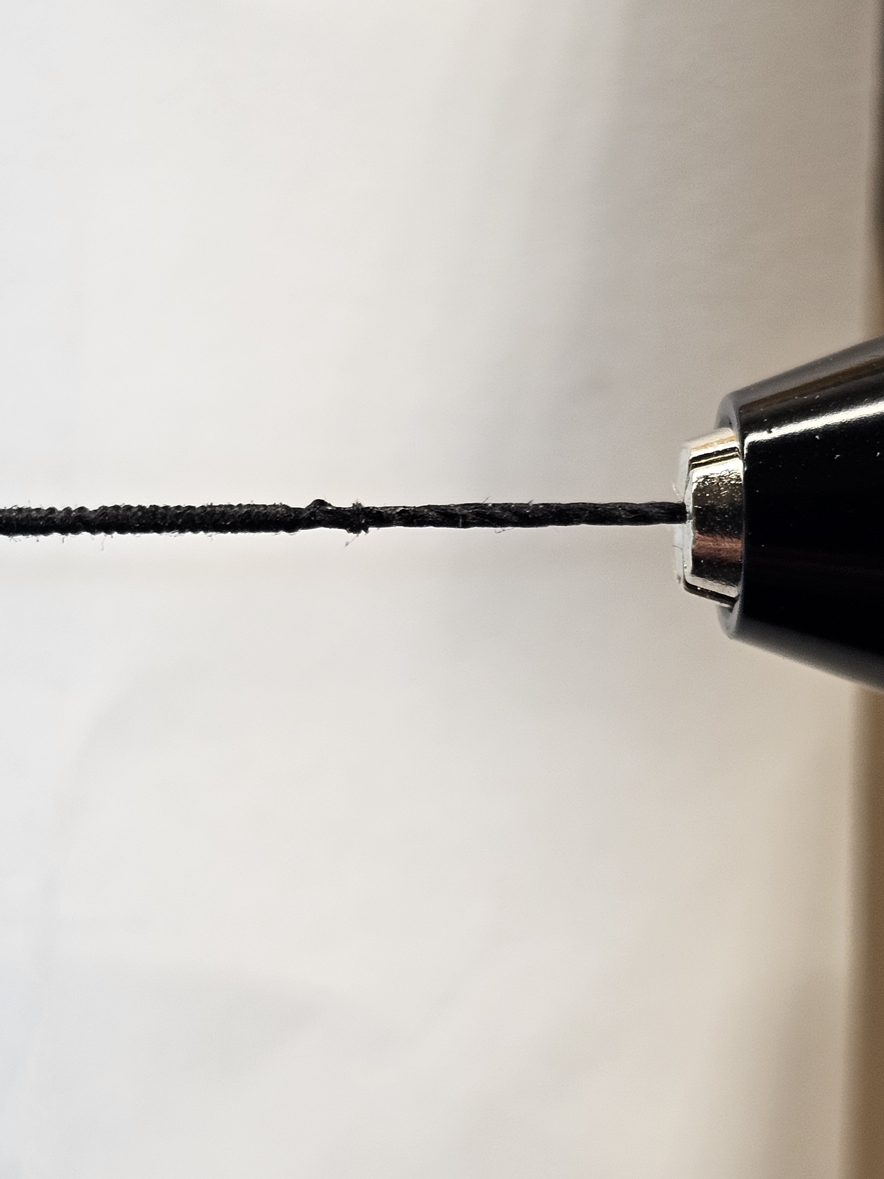

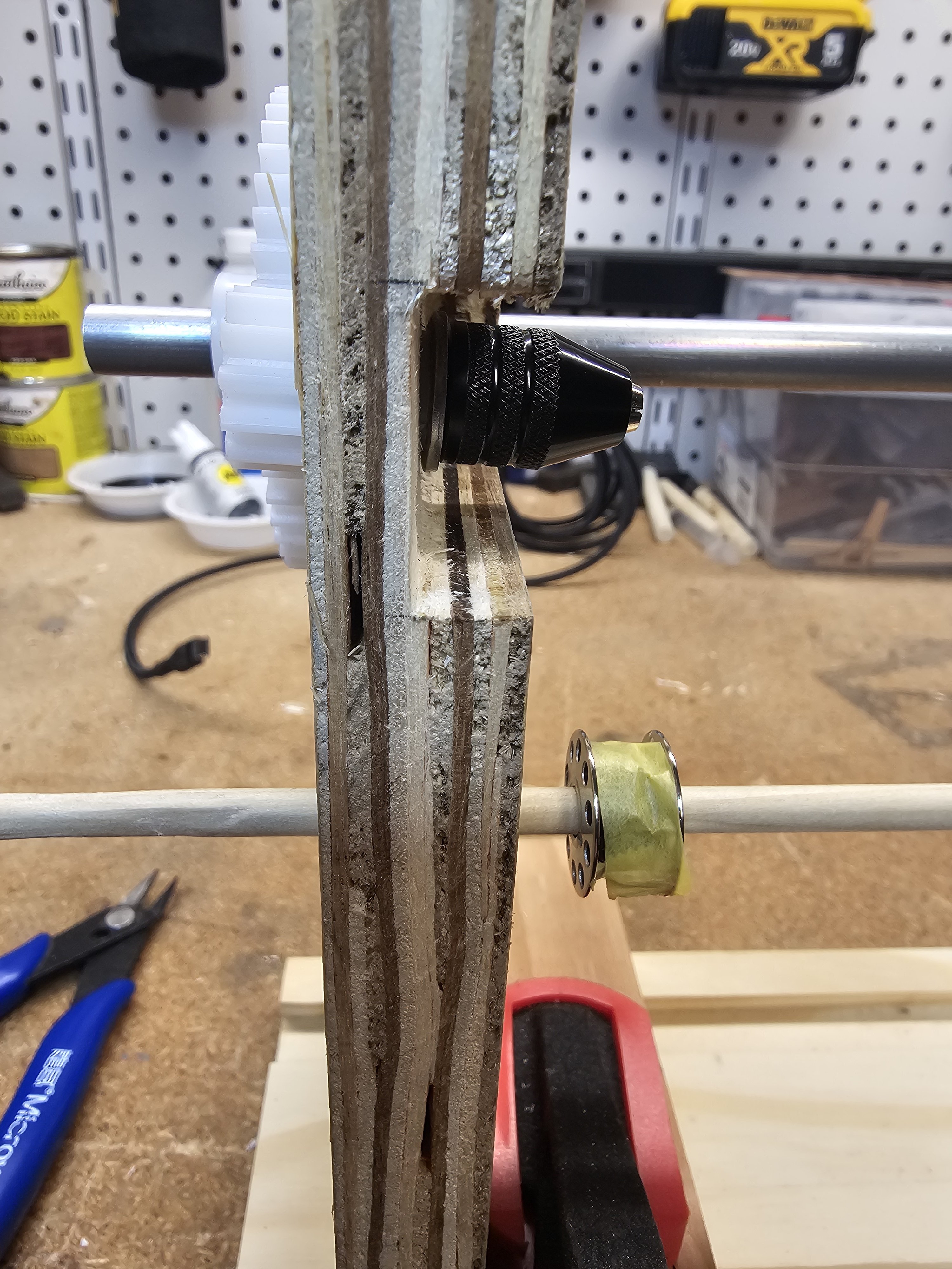

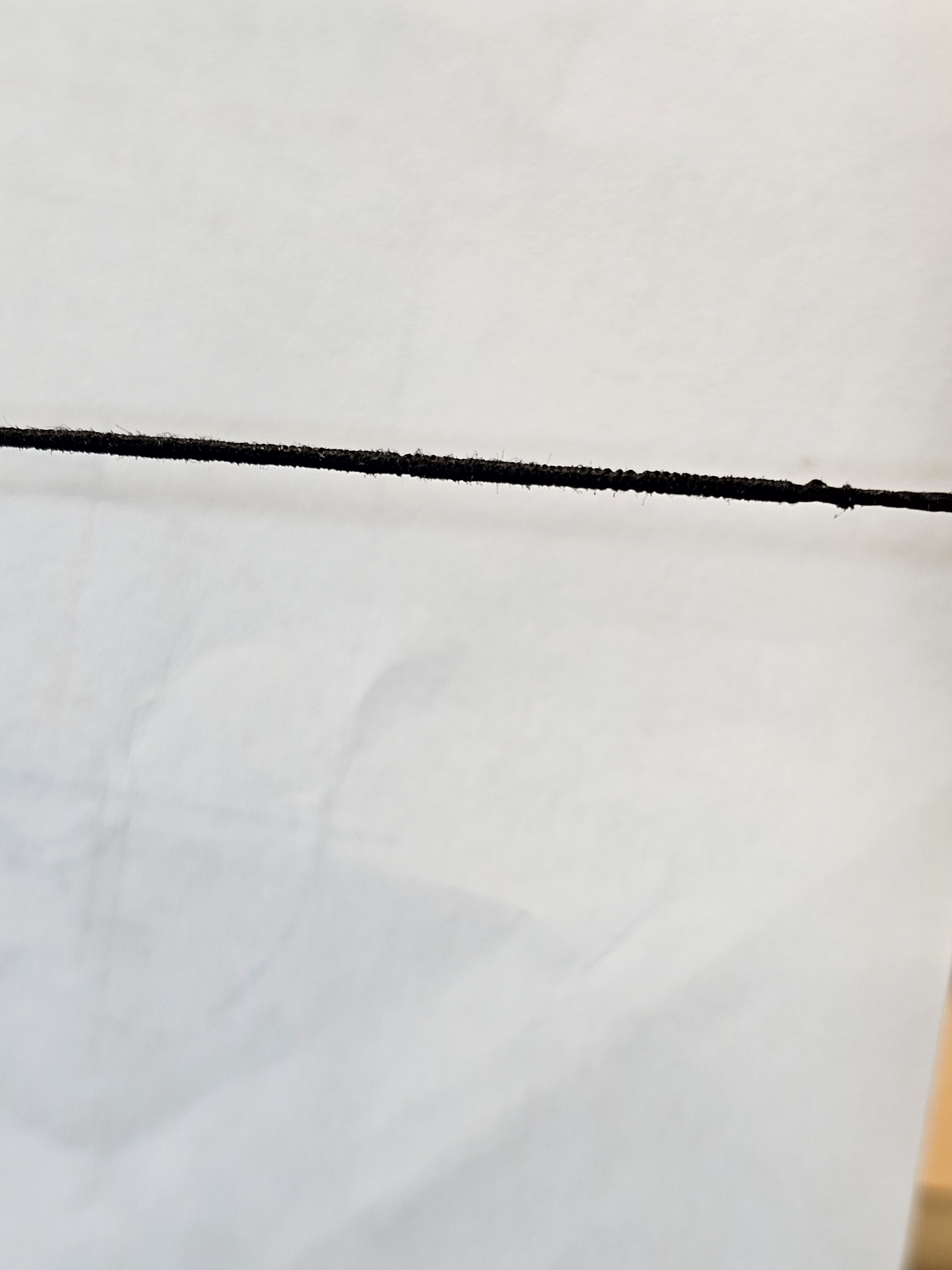

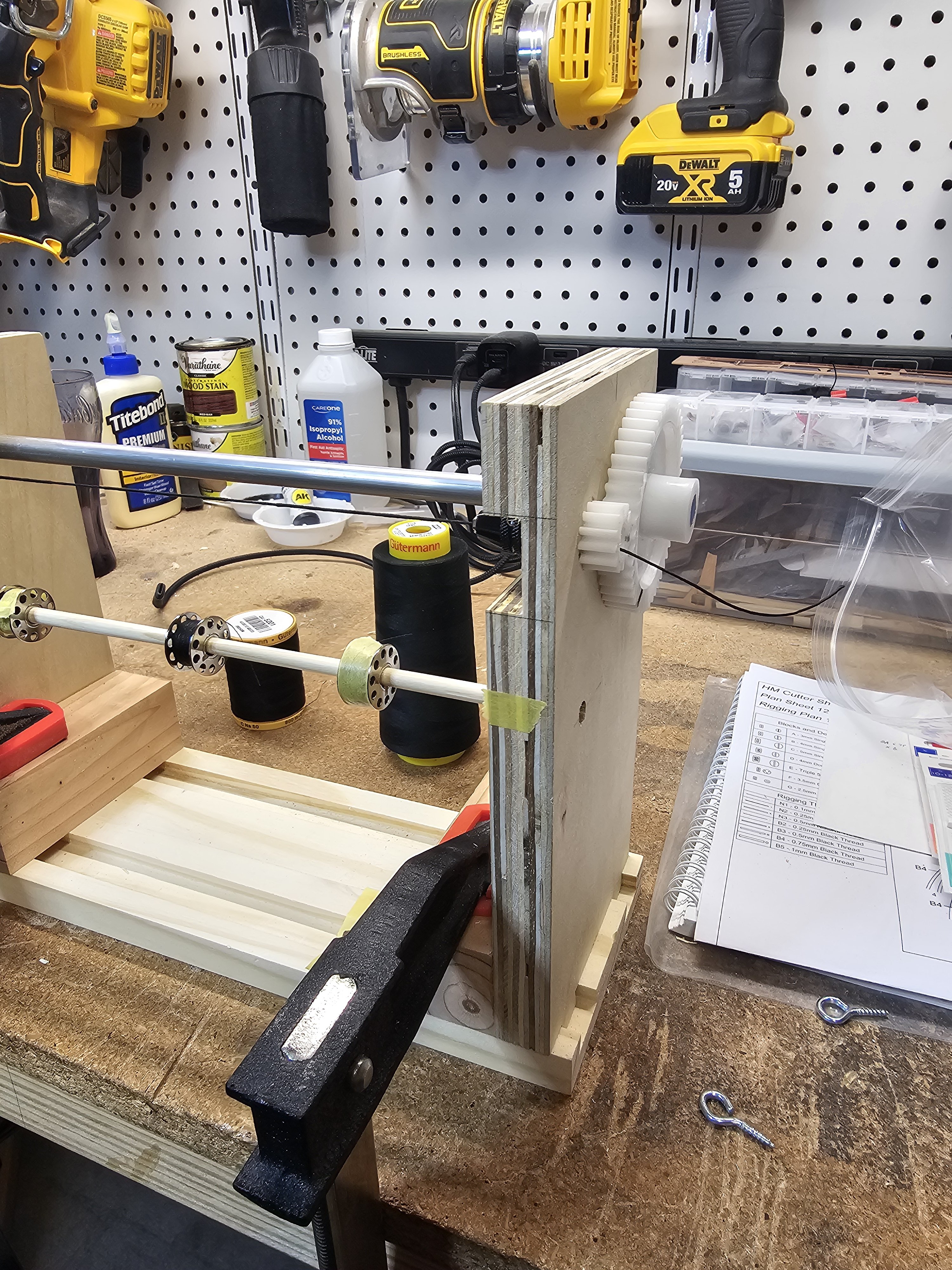

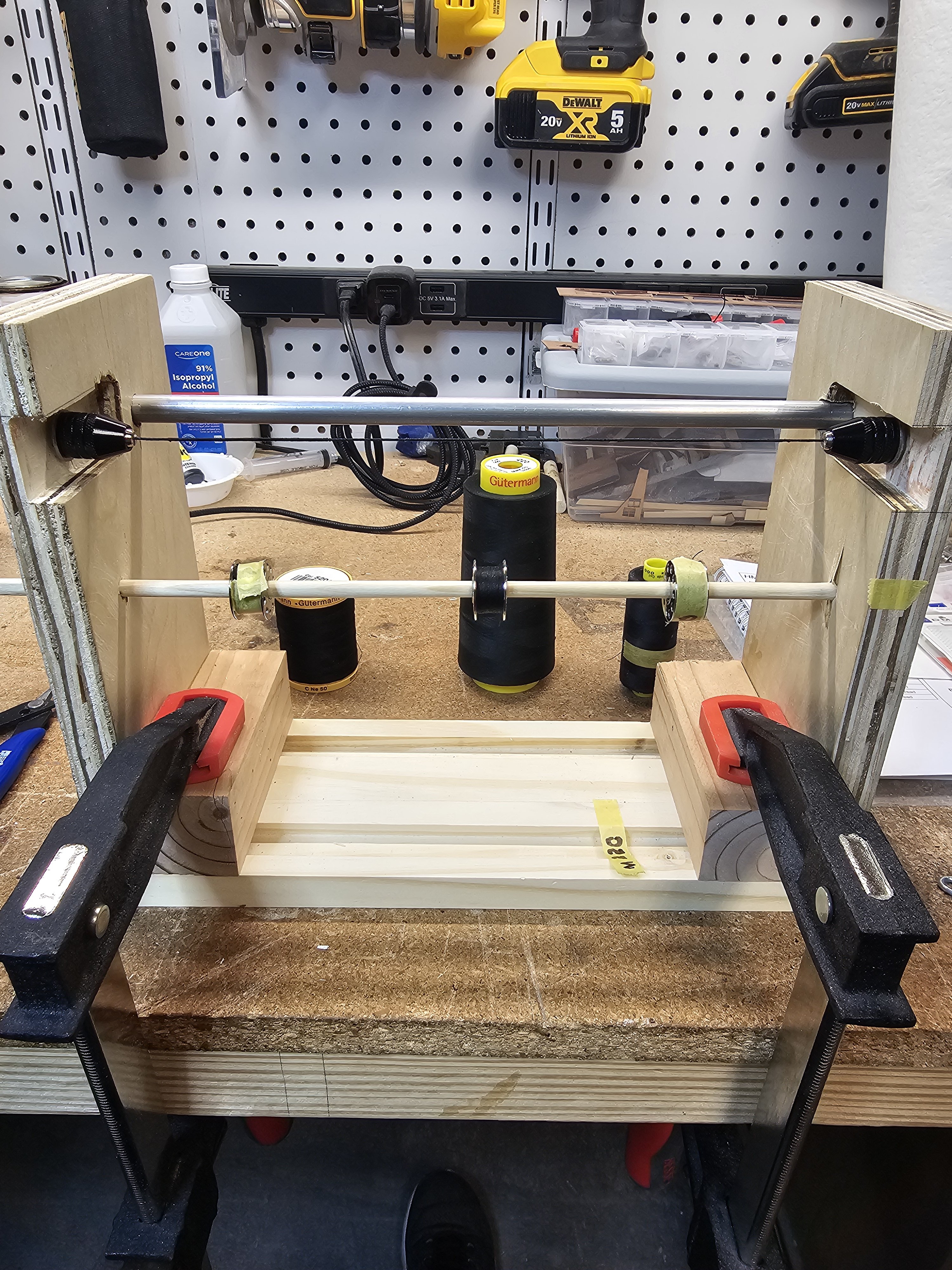

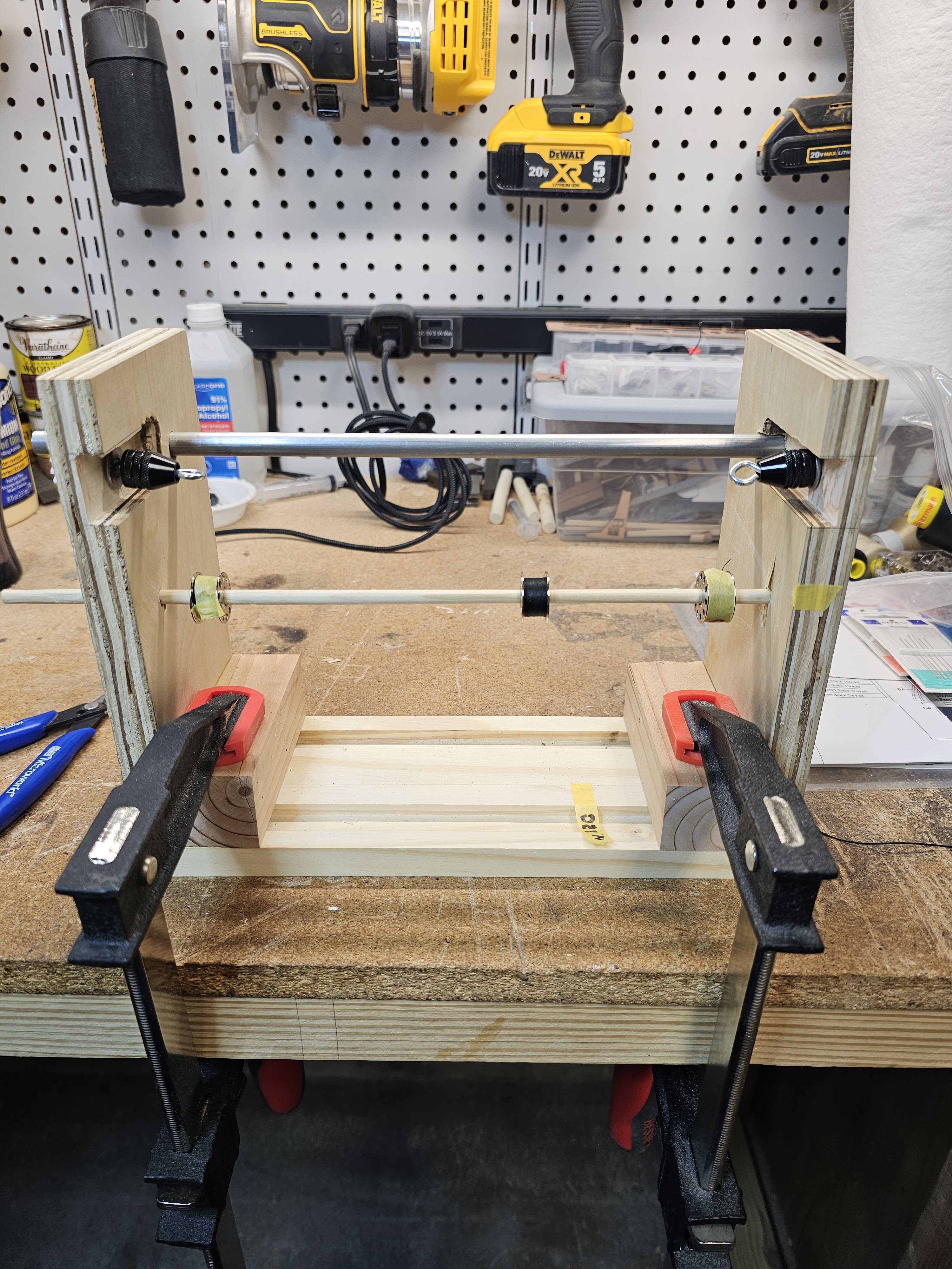

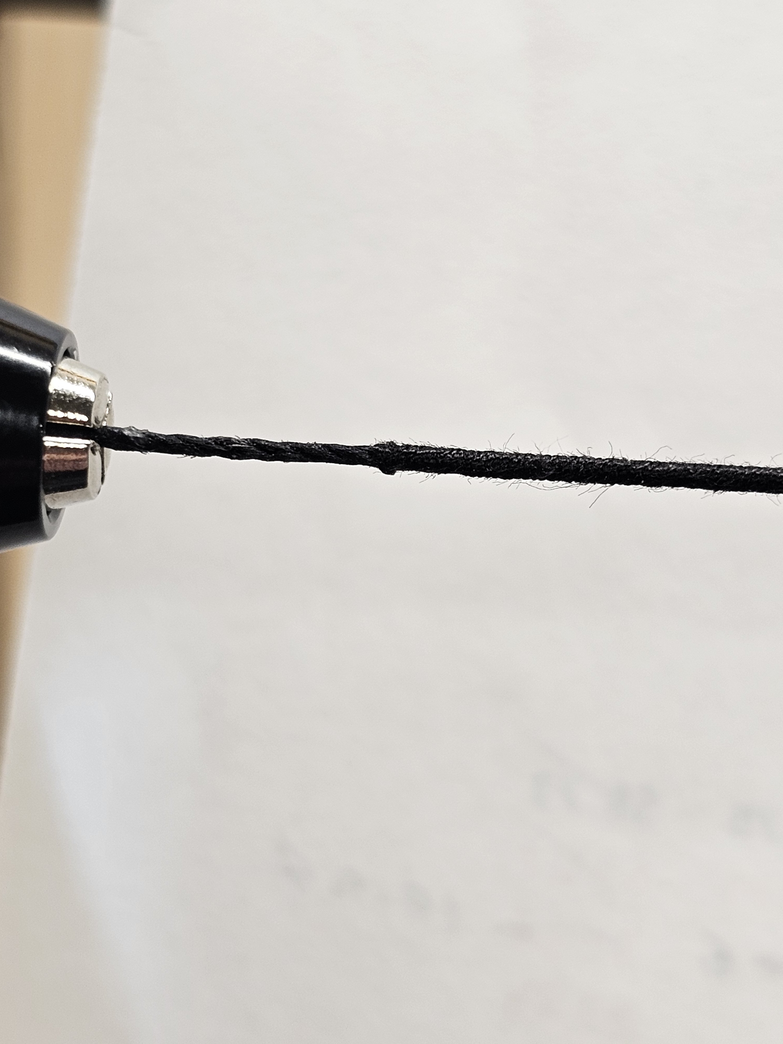

  1. Did some more work on my serving machine... Sliding dovetail joint in base so I can adjust lengths to be served (each chuck at the ends is drilled thru in order to run continuous-lengths of rope to be served- just need to hang spools at each end). Gears are 4:1 ratio, so I get 4 turns of serving per turn of the big drive gears (probably add a handle later). Could be motorized, but I'm not going to get that involved with this. Using the thick line for the shrouds as a test piece, I did some samples of Gutermann brand thread for the servings. Left side: 50wt all-purpose, Tex-20, 876yds Middle: Mara 220, Tex-13, 5468yds Right: Mara 150, Tex-20, 1093yds *Tex # is some standards thread size/diameter... lower tex #, thinner the thread For this model, I'm liking the Mara 220, mostly due to minimal fuzz and it's finished texture (just needs some wax or post-treatment to cut fuzzy down a little). All the threads I tried are very similar in size, especially at this scale. I also purchased some spools in beige/tan so I can do my own hawsers and breech lines, etc.

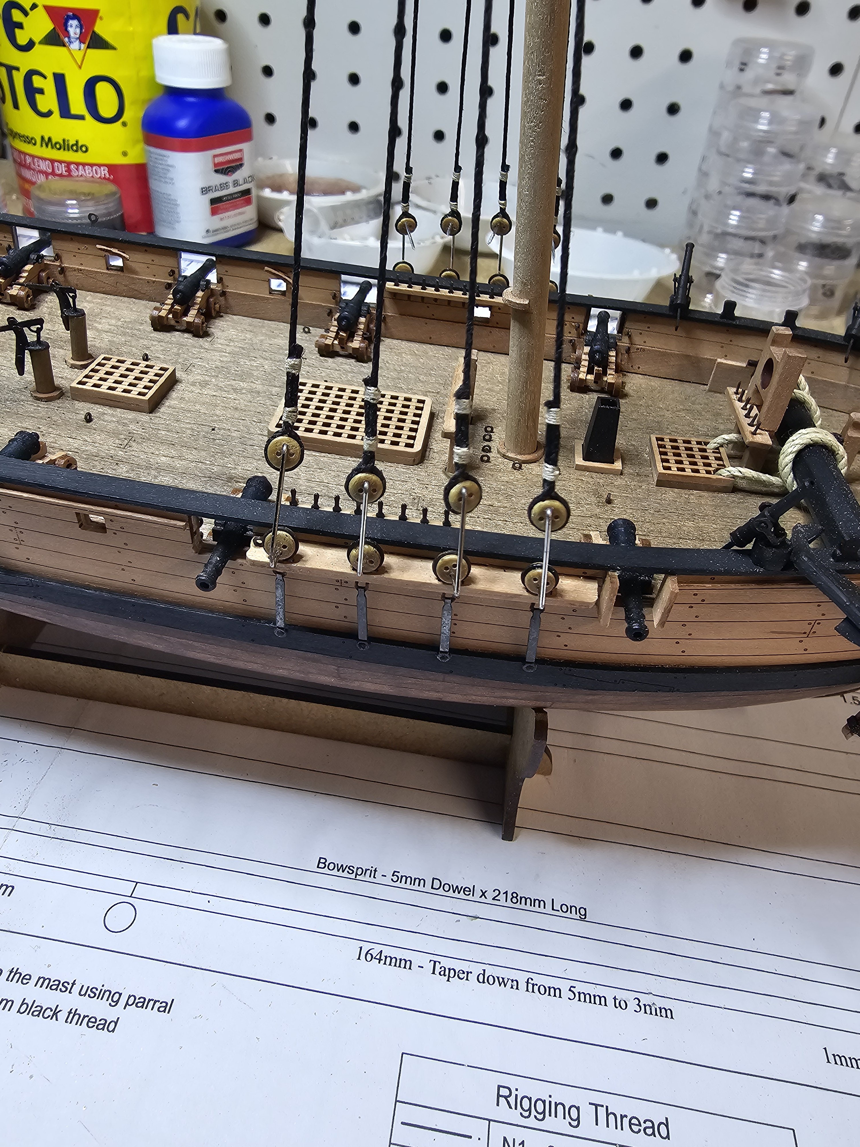

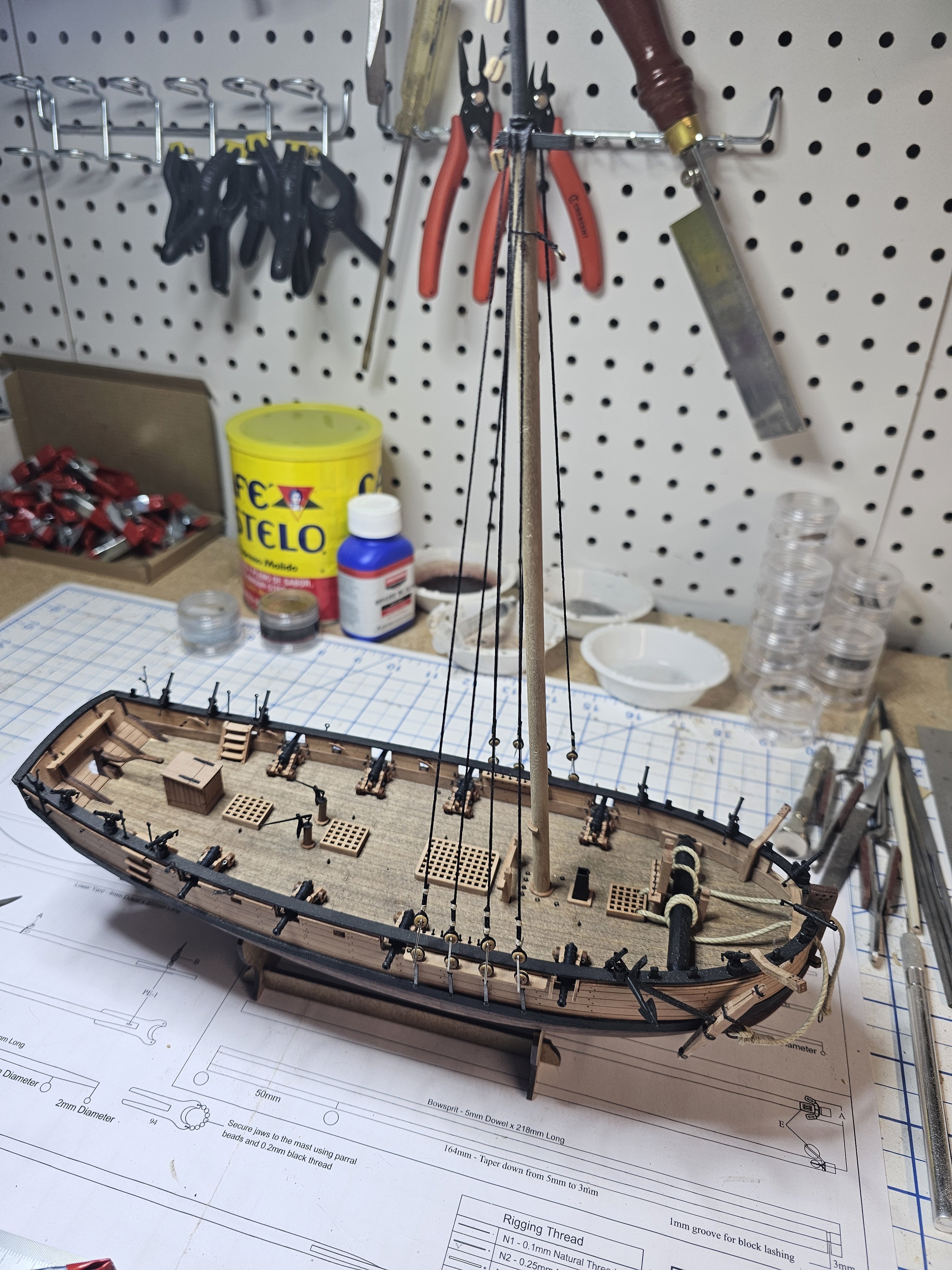

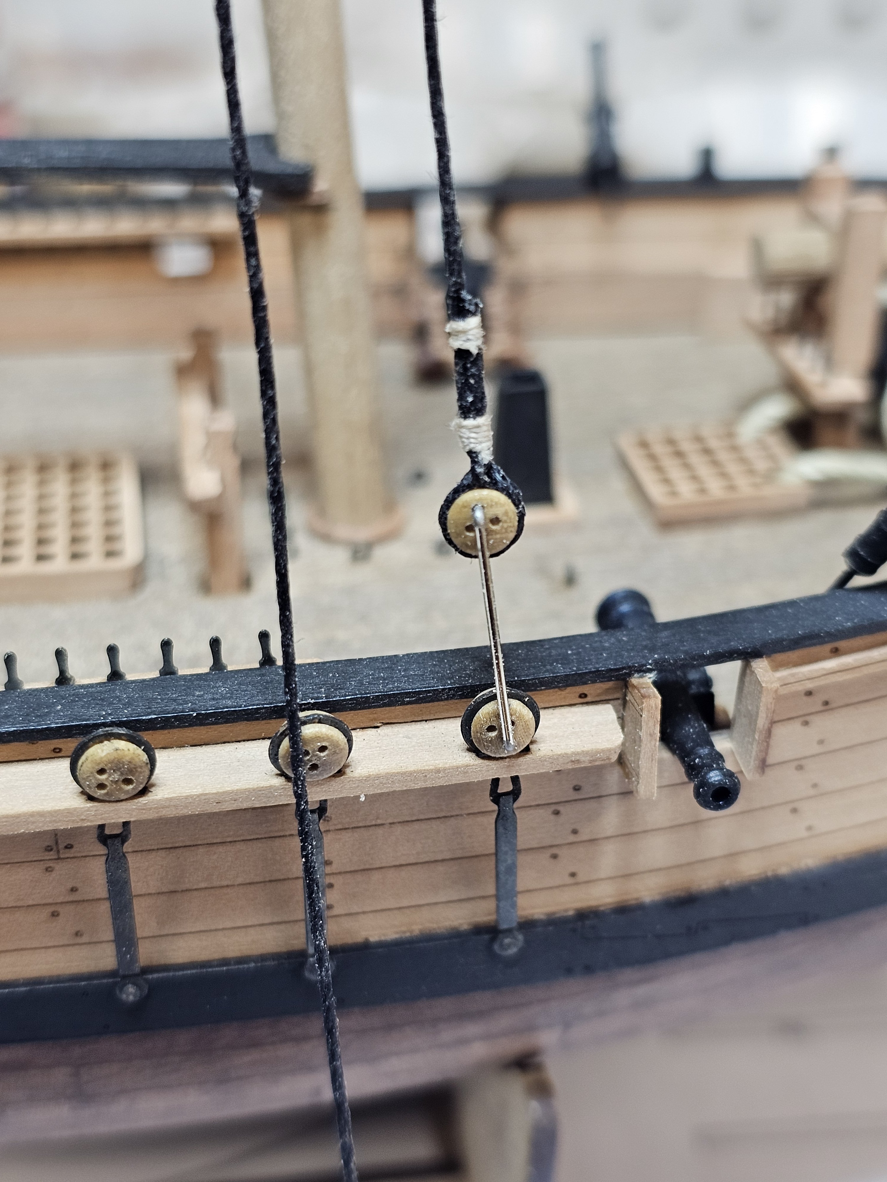

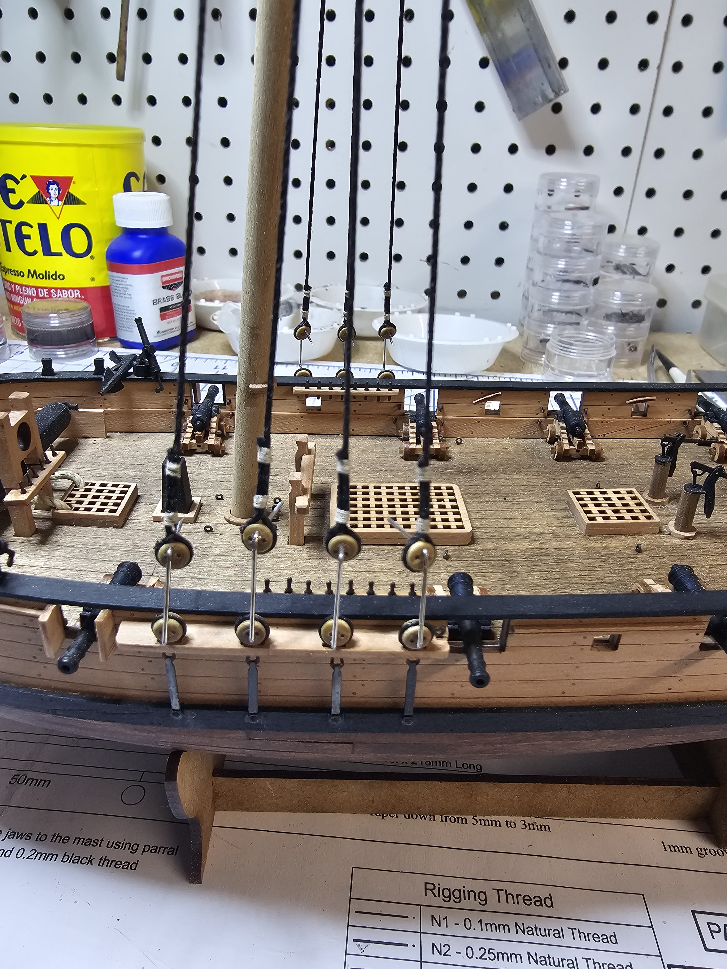

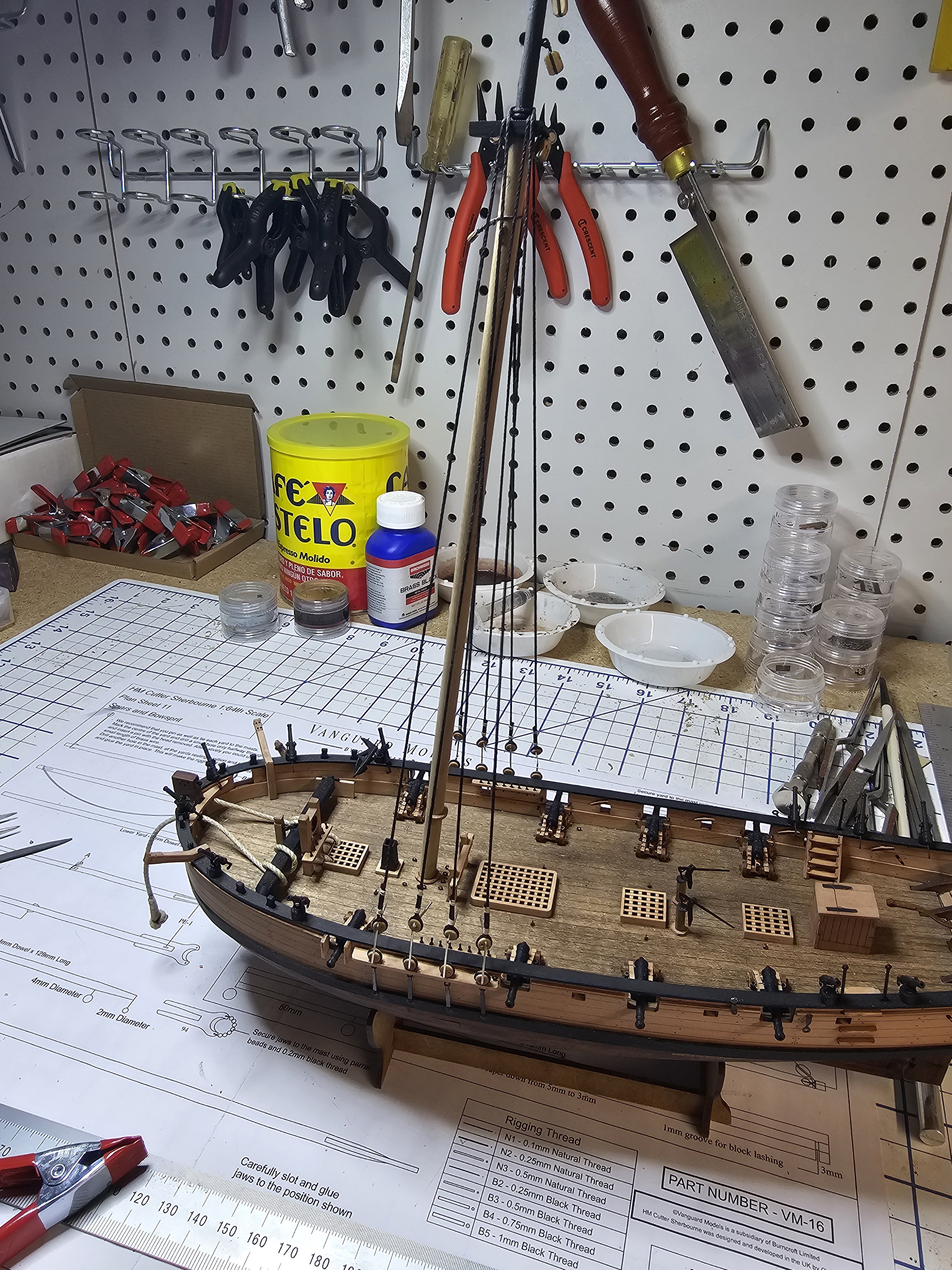

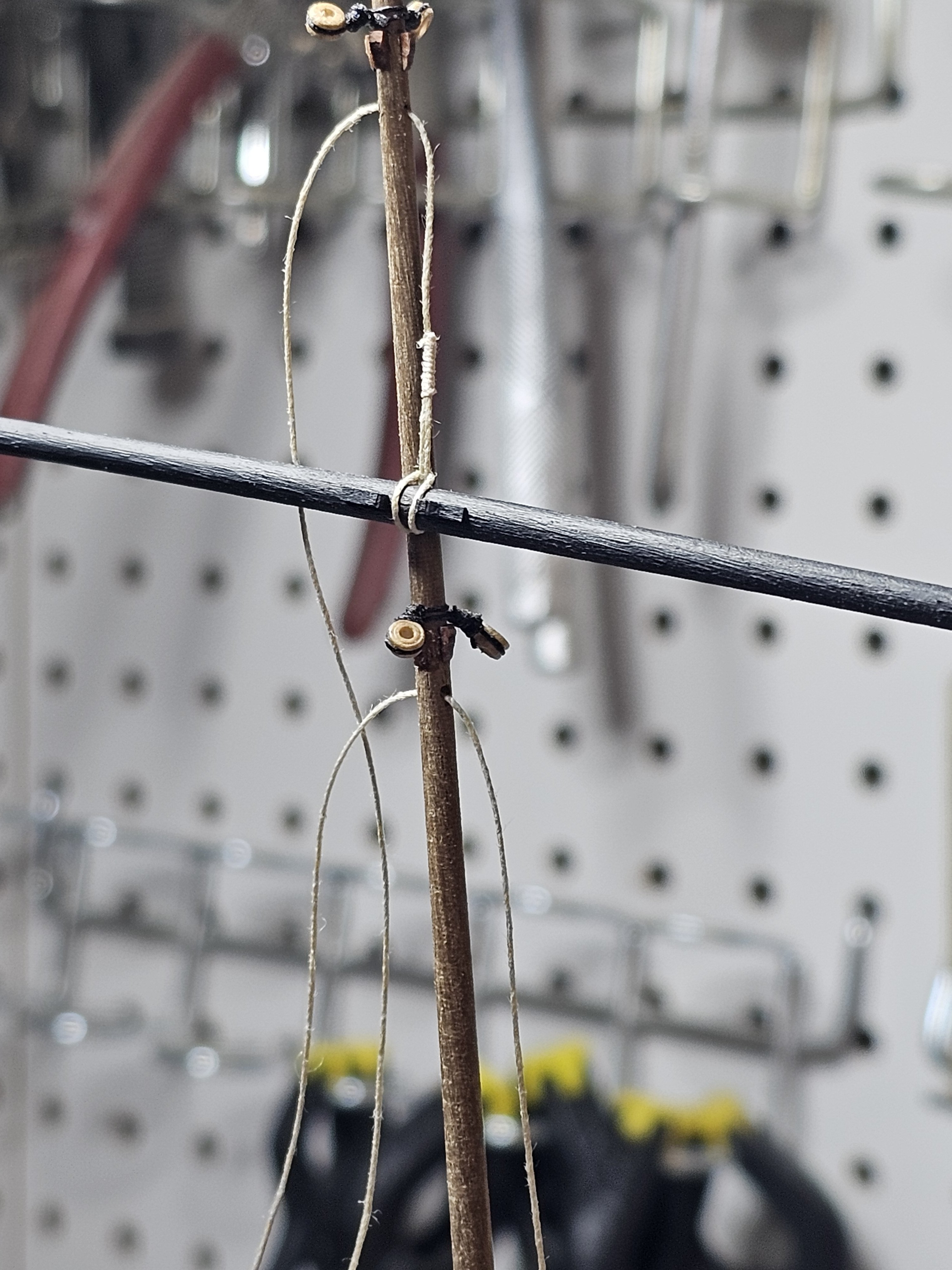

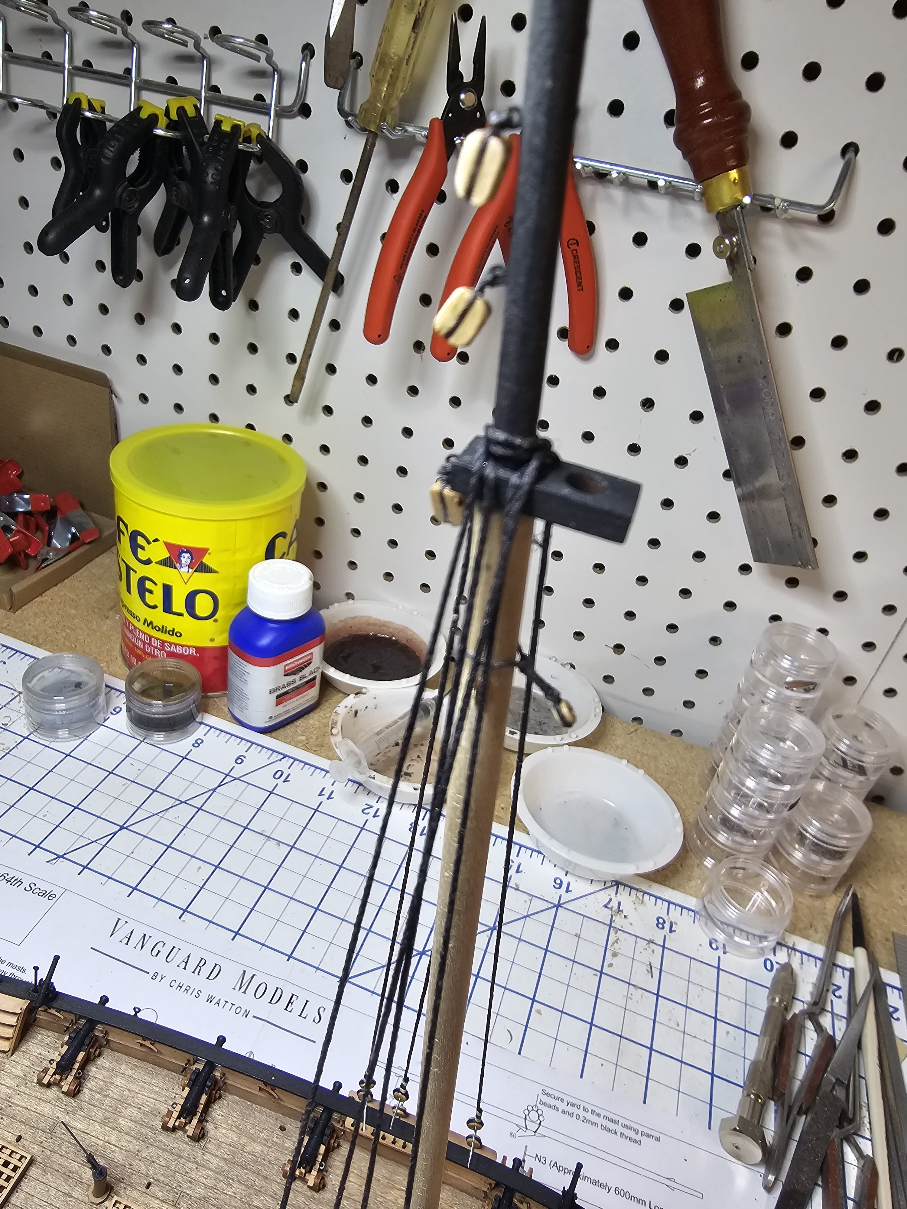

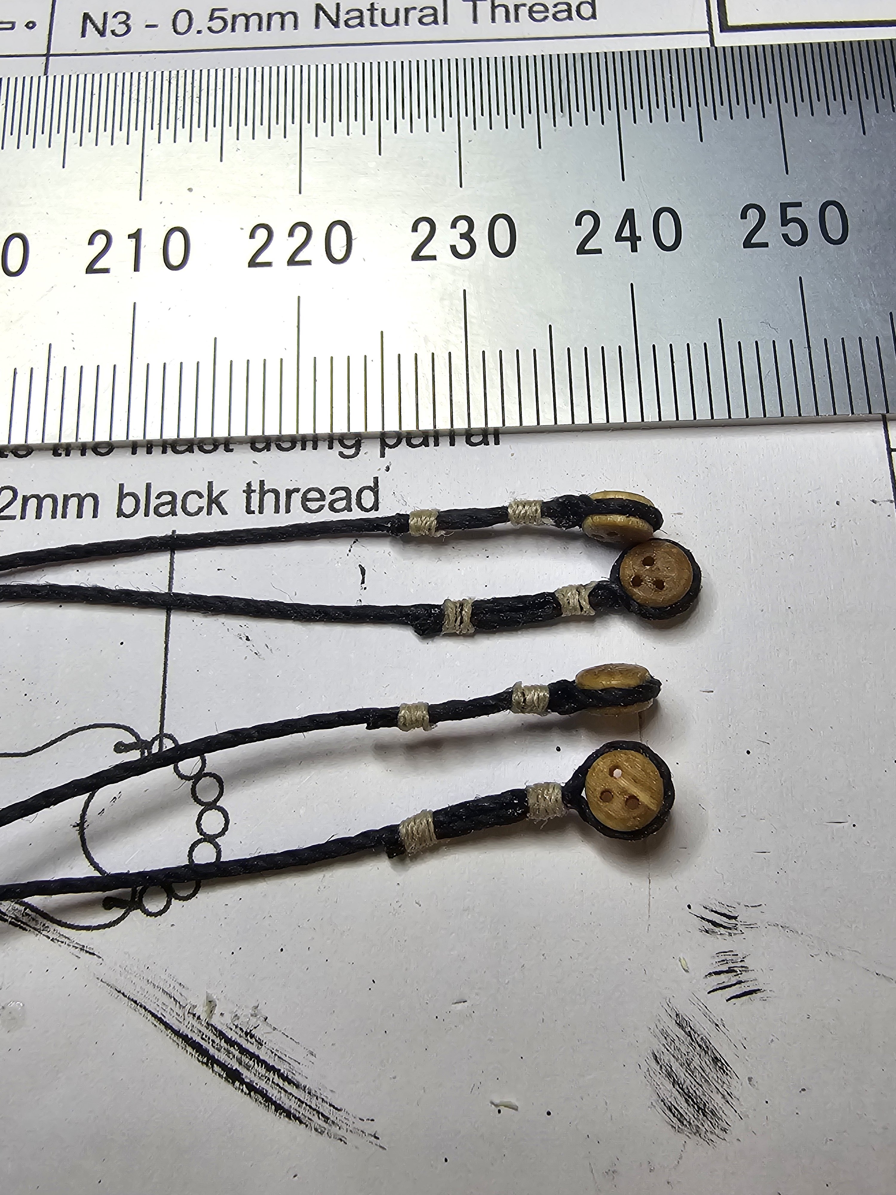

  2. Deadeyes and shrouds ready to go. Pins are judt to hold shrouds in position so I could check the lengths and lanyard distance- trying to be as even as possible (close, but good enough for now). So far this is the farthest I've gotten with a wooden kit (my Niagara only has the hull, no spars or rigging yet). This kit design definitely helps with building some confidence while making things relatively simple- I definitely need that before I tackle more involved builds! And it's rewarding to see things move along a bit faster too- fully rewarding throught the whole build thus far 😊

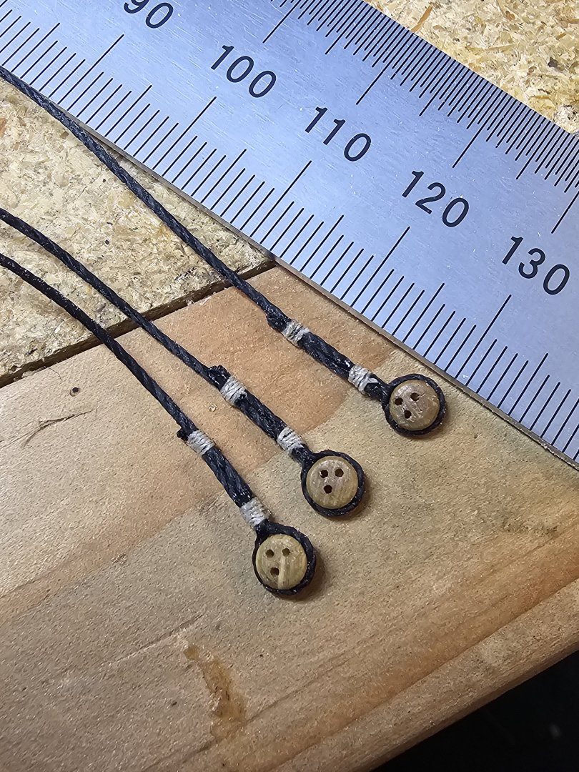

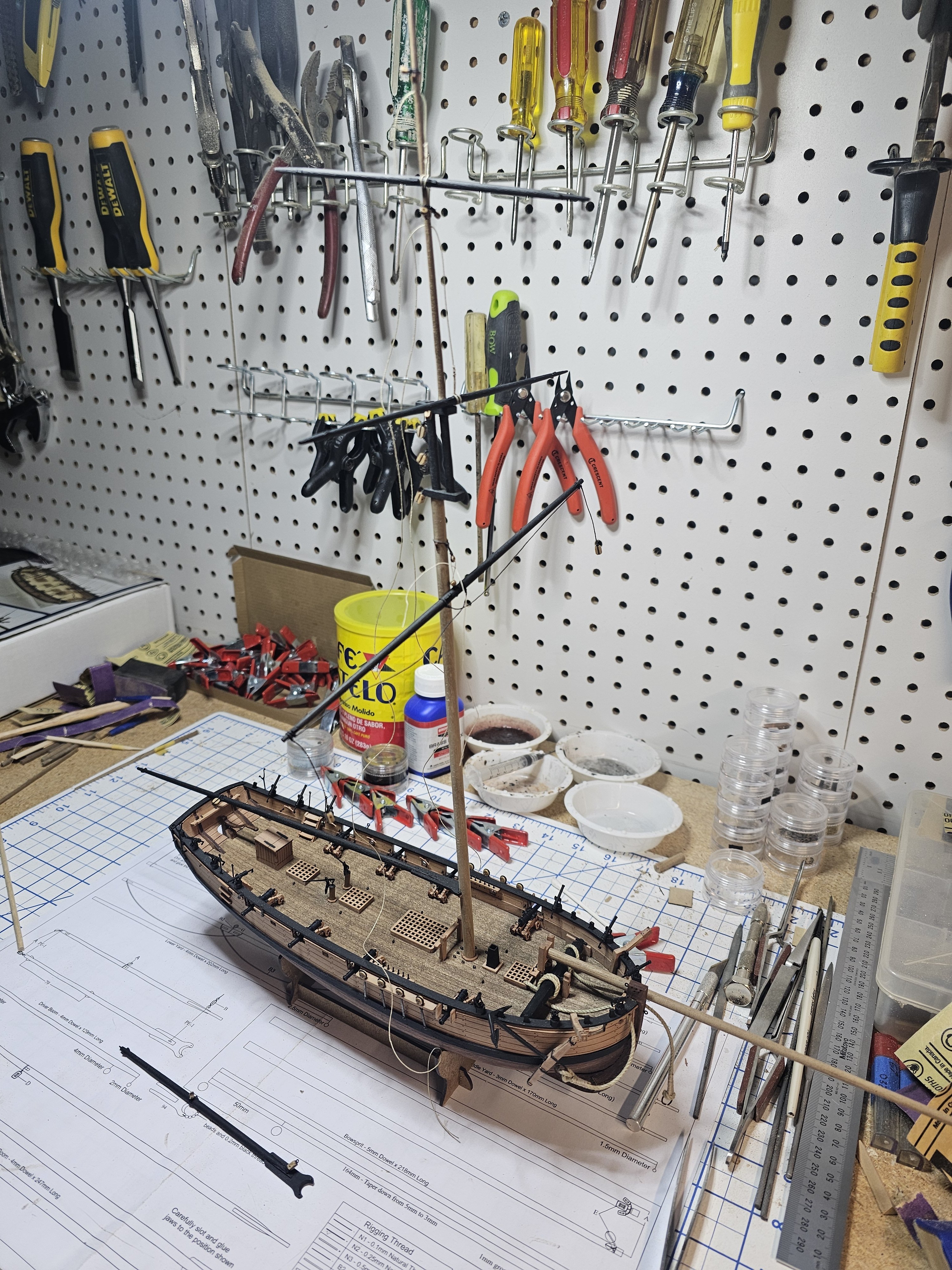

  3. Started prepping shrouds- going to get as much rigging done off the ship before packing up and moving across country (job hunting in order to leave the state of Md). Using a straight pin to set the lanyard distance before installing the deadeye on the other end. Also ordered some parts to make a serving machine (more details/pics on that hopefully later this week once parts arrive). Going to try some Semperfli fly-tying line to serve the shrouds, etc.

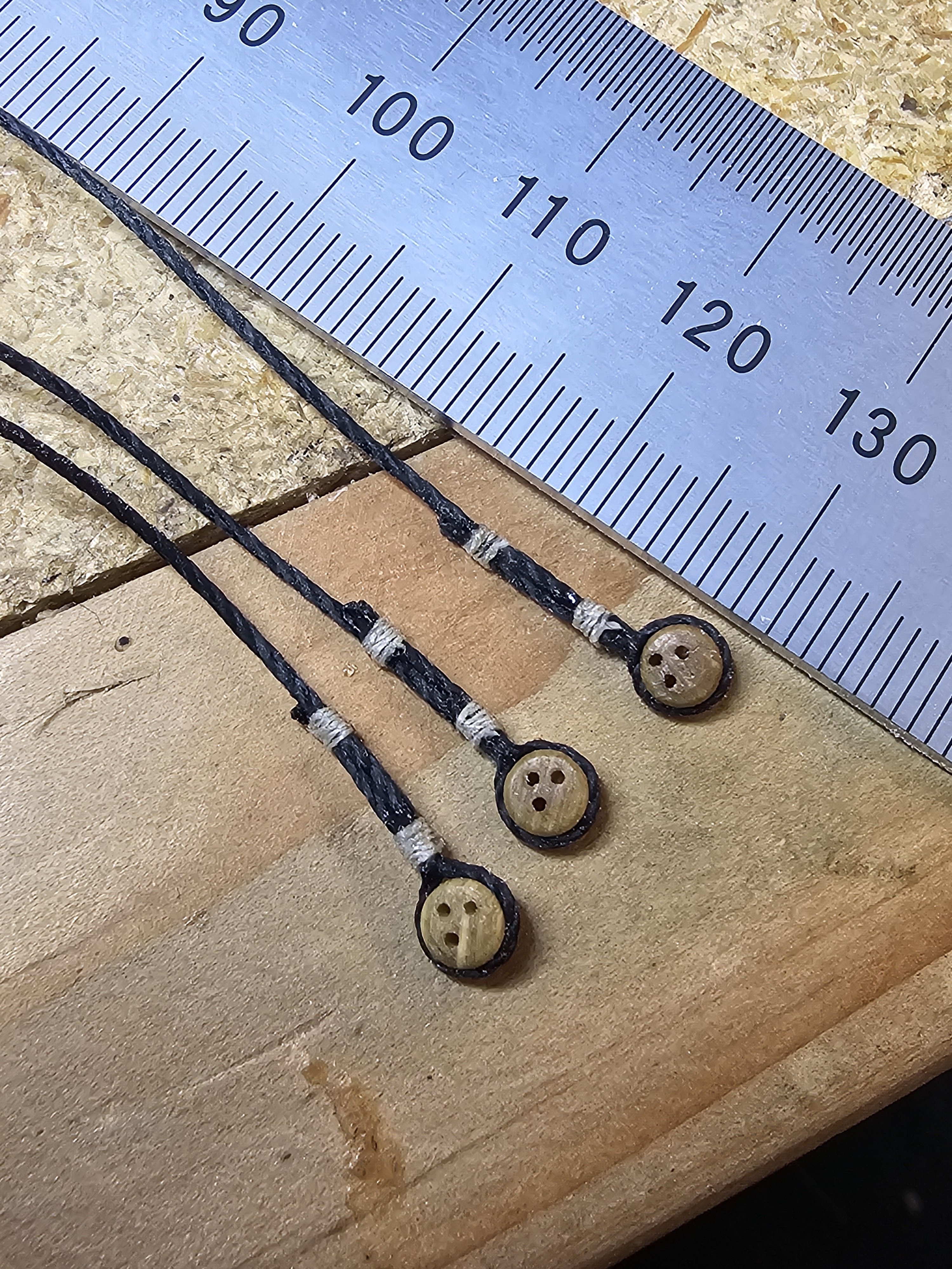

  5. Been a really crappy and sad week- Monday I had to put my dog Dharma to sleep. She was 18, she's been my family/daughter for 16 years (rescued her a year or two prior to starting my Niagara build). Rather cruel how time flies! So, spent the whole weekend with her and extra Love and snuggles... As a break from my sobbing and the unsettling stillness and quiet in the house, tonight I finished all the spars and getting ready to install the mast and begin rigging. I also prepped the shroud pairs (1 deadeye at each end). Nothing is pinned/attached just yet- getting a feel for how she looks and making sure things 'work' together.

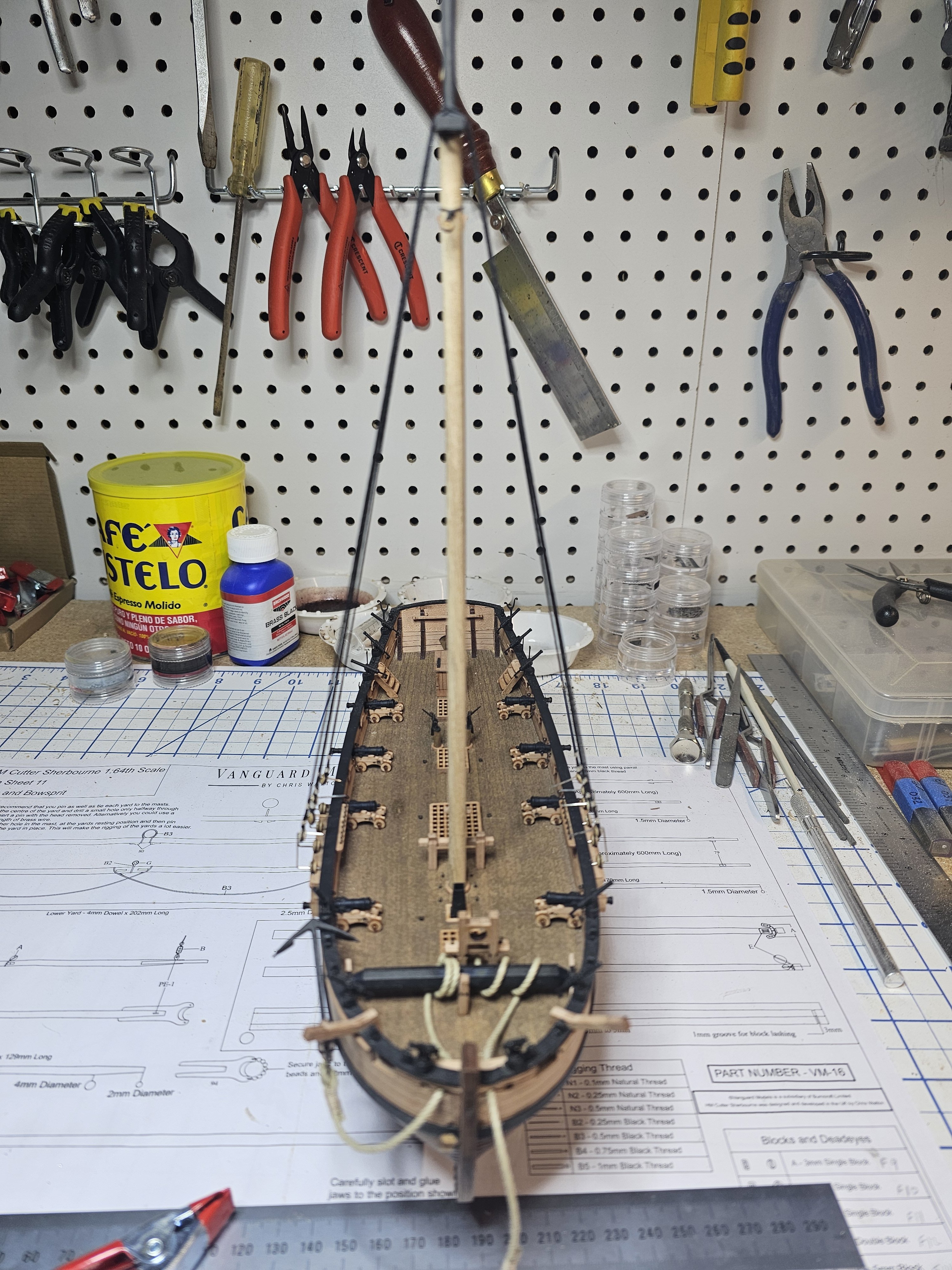

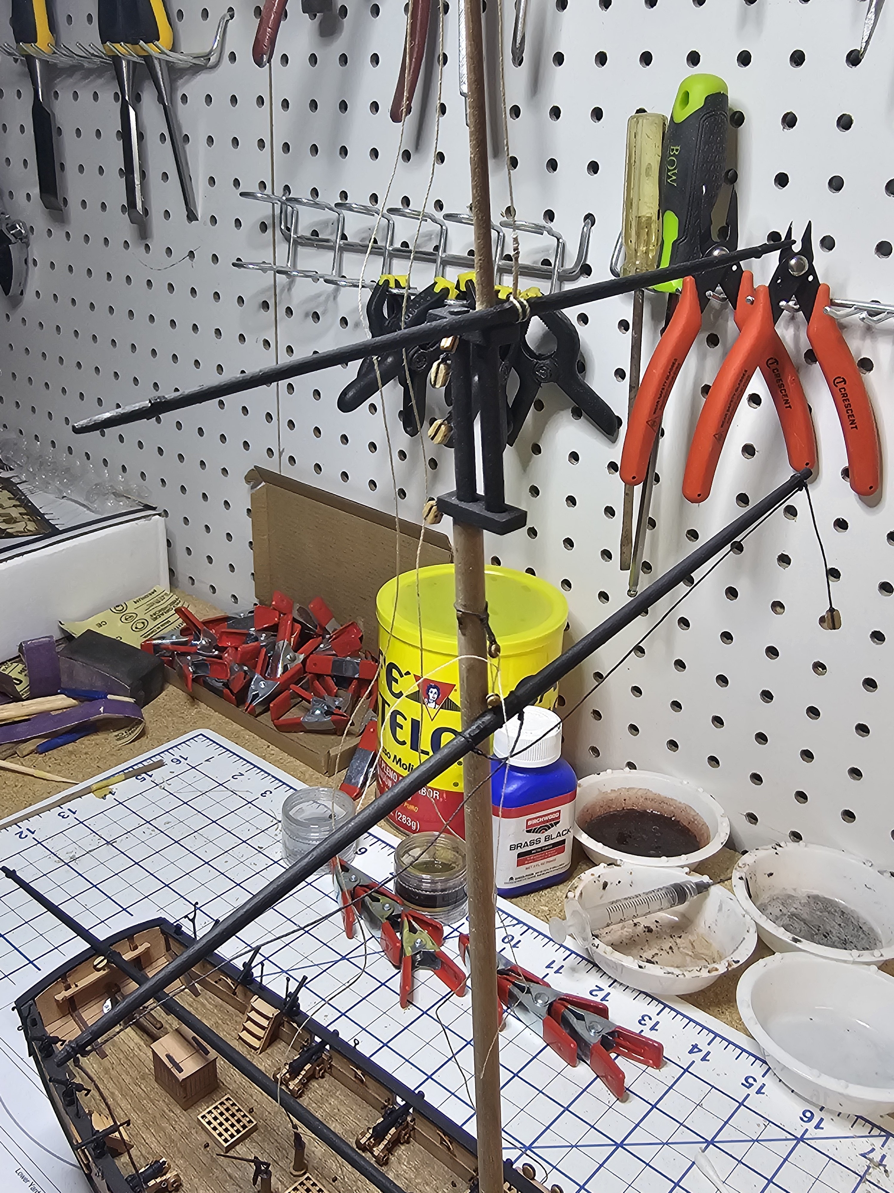

  6. Finished the mast (minus the mast cap). Blocks attached too. Main and topmast are not glued together (will do that once I get the shrouds going). Next up is shaping and assembling the bowsprit.

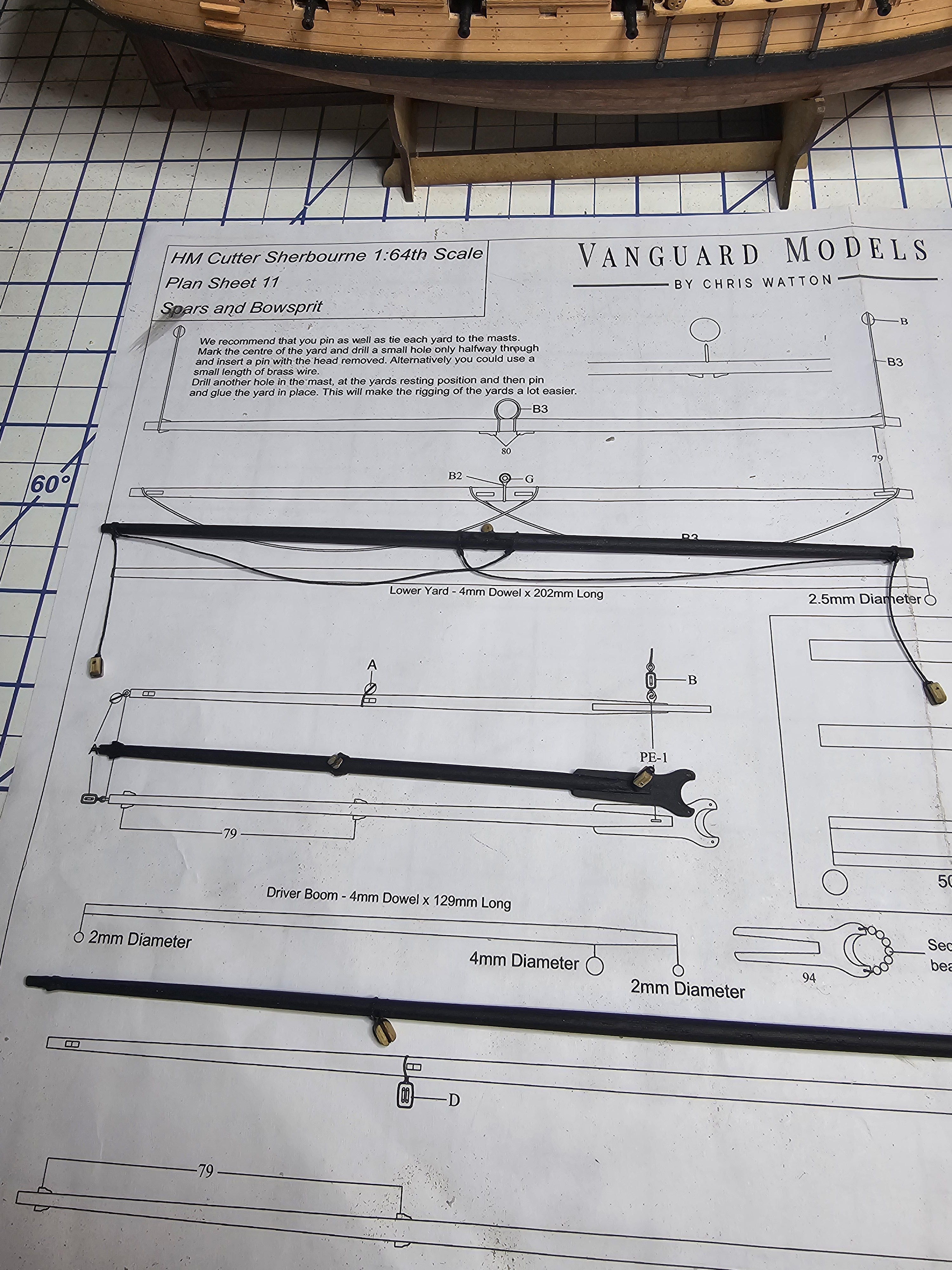

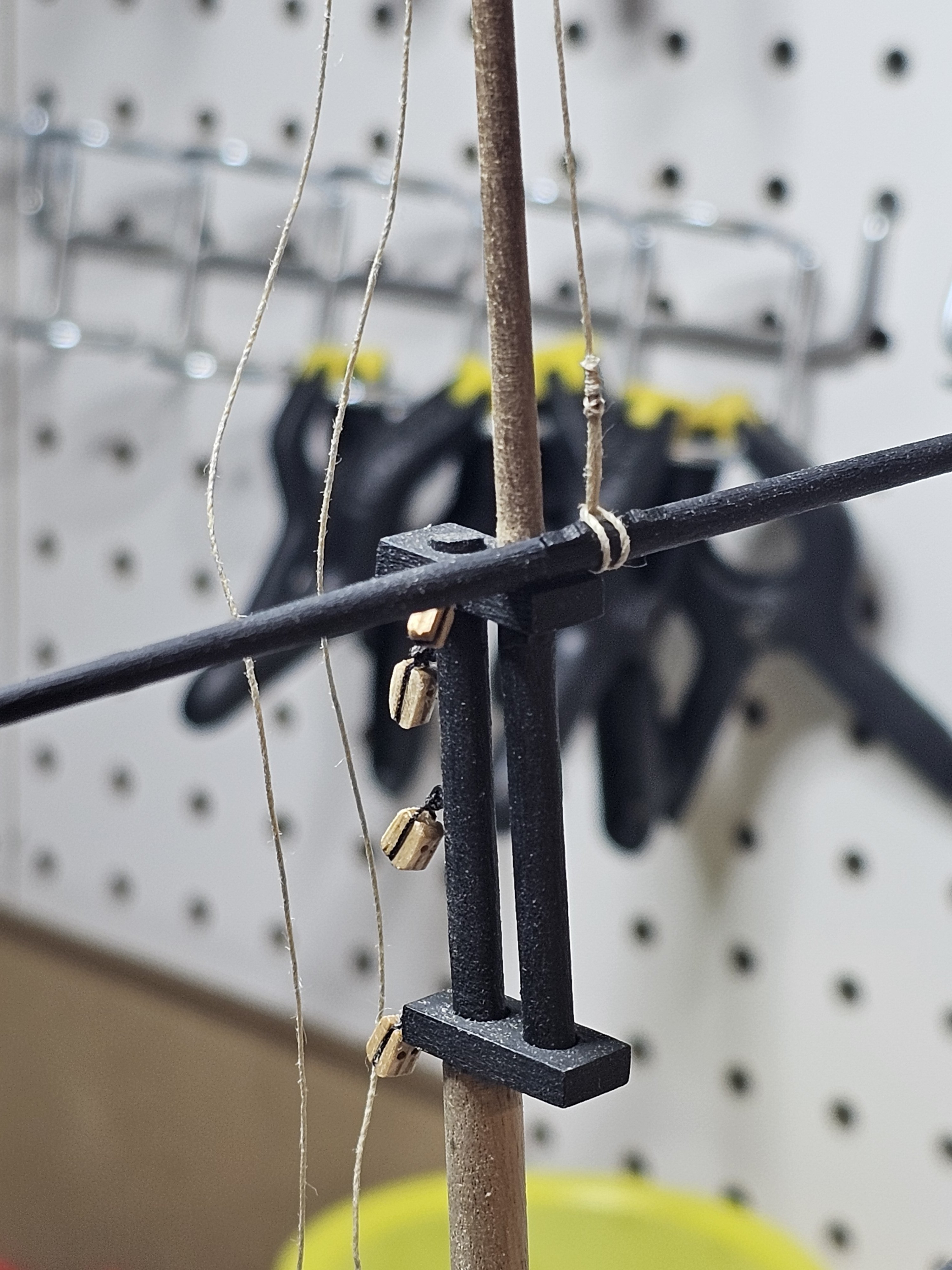

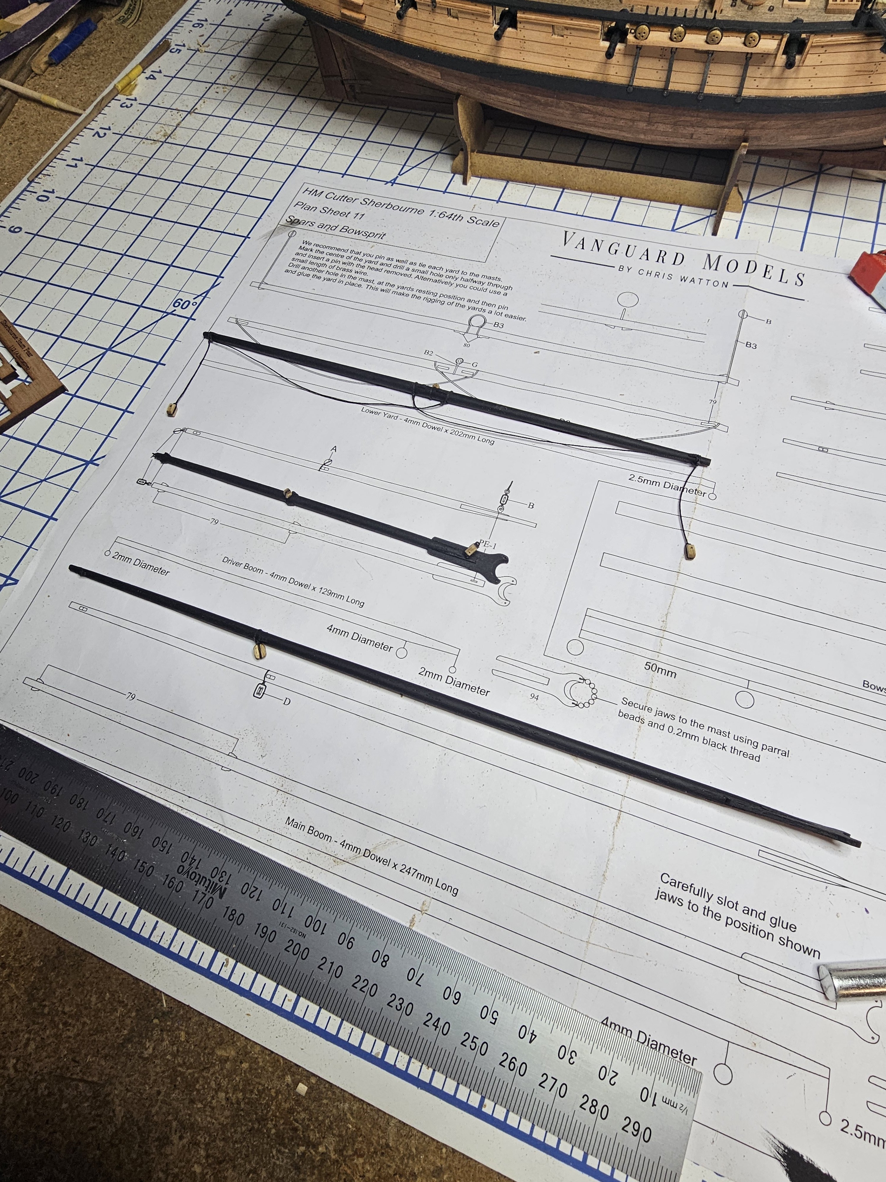

  7. Worked on the main mast and topmast today. Cleats were tricky because of their super small size, but so far so good. First time tapering a mast: taped off one end of the topmast, chucked it in the hand drill, then ran a sanding block along the length... not sure if this the best way, but turned out ok. Drilled the holes, attached the eyebolts, and the lower pendant (square knot around thimble and mast, then seized). Few spots to even/level, but workable. Won't assemble the whole mast until after doing lower shrouds, etc.

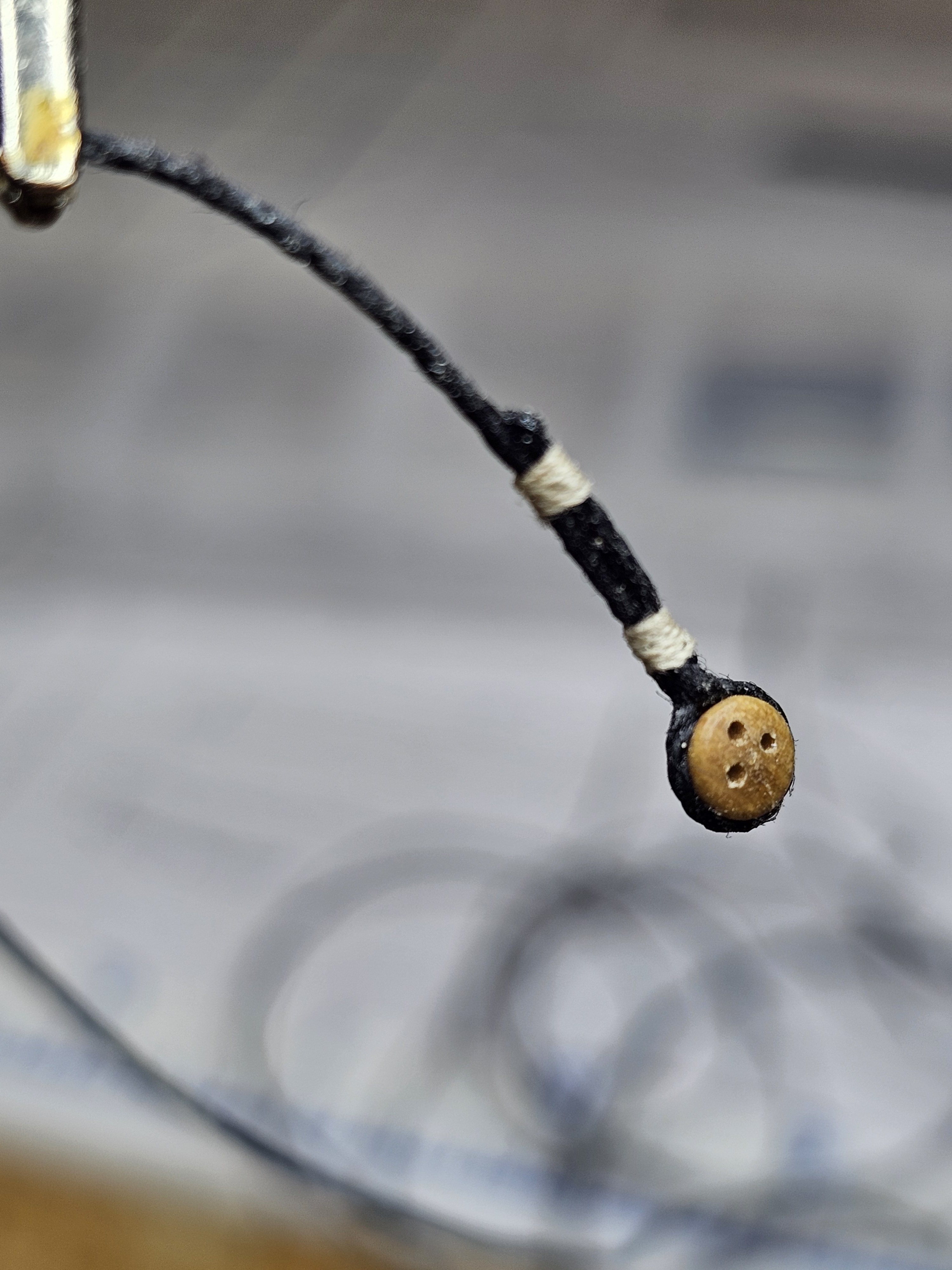

  8. Not sure exactly... lol... just looked at some pics of how it's done and tried to replicate that. After my 'knot' I used a small but of CA to glue the free end, then whipped the end. Anchors will be attached/rigged as the very last thing so they don't get in the way of actual rigging.

  11. Now that hull and deck are mostly finished, onto the mast and spars... Also semi-thinking of adding sails (furled on the yards/boom, etc)... haven't decided yet... if I do go with sails, have to do them before adding the standing rigging I think...

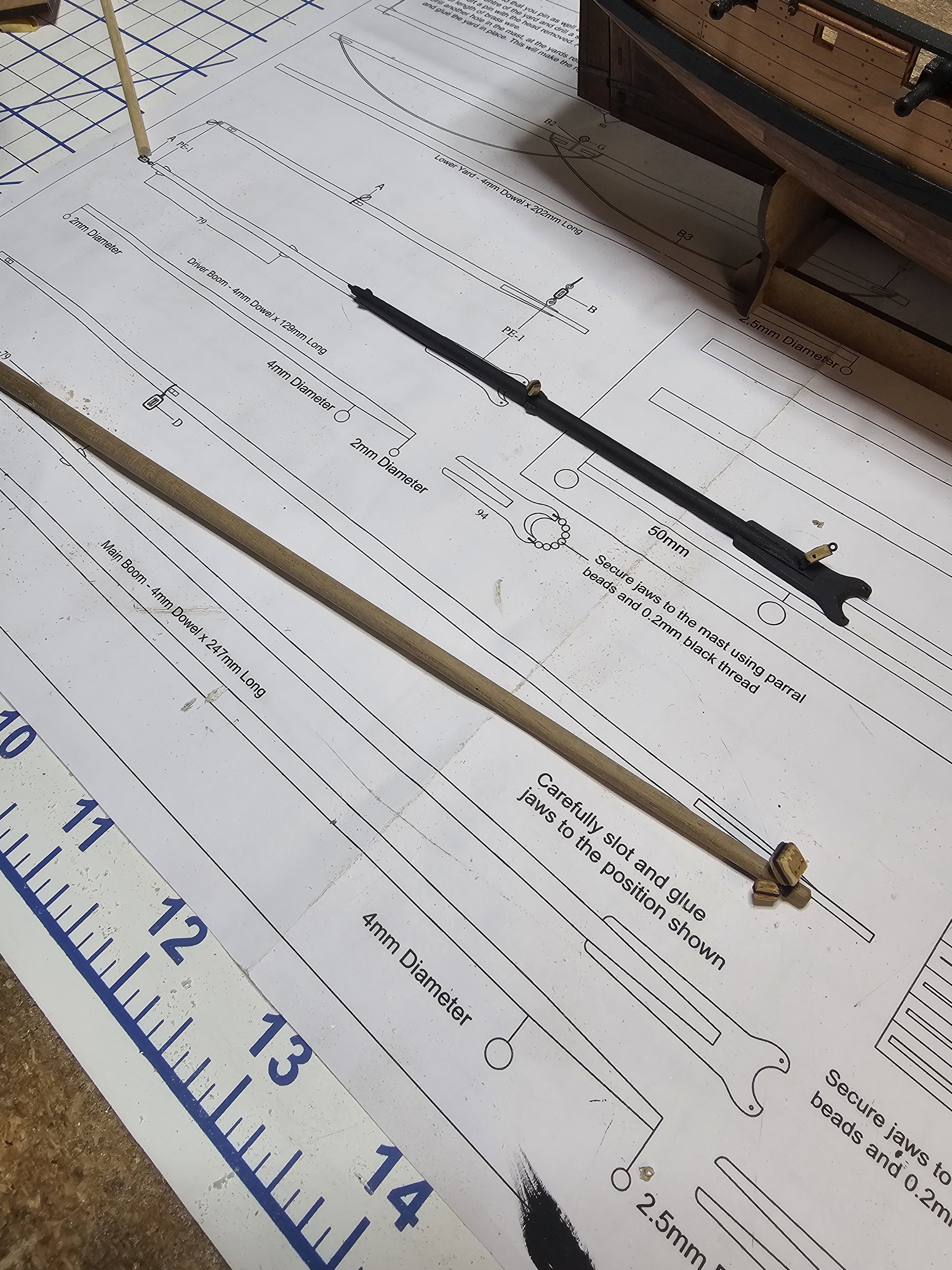

  14. Hull stain was English chestnut (minwax) Deck was weathered oak first followed by red oak stain (by minwax). LOTS of wipe/rub to get the look and coloring I wanted. For blackening the brass I used Birchwood-Casey (several dips in the solution, then wiped/rinsed). Solid black would be too dark, so I like the rusty steel/gunmetal look the parts took on.

  16. Hey- back from my sailing lessons/vacation!! And I passed both certifications!!!! Had THE time of my life- was pure heaven!!!!!!! Plus, we were sailing around what I believe was the Sultana- got lots of pics on my phone that I need to upload so y'all can drool over!! lol~~ Anyway, build is obviously on the back burner for now (getting re-set up since our stuff from TX came a few weeks ago and I gotta get the shop rearranged). Plus, I'm looking at boat rentals for a day so I can keep building my experience! All is well- miss you guys!!!
