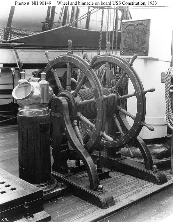

I believe the modern binnacle was there for the practical reason the ship was on the ocean on tour under full sail part of the time and others being towed. She went through the Panama Canal all the way up the coast to San Francisco and back to Boston .
Jon
Quote
Ha! Sorry, no. I was referring to the extra layer of decking on the spar deck, at the mizzen mast, on top of which the wheel resides, at least according the the MS plans and the Bob Hunt Practicum. I took my lead from XKen, and opted to omit this "feature".
Thanks for the clarification. I went through my collection of images and found one, just one photo of the platform. It was taken during the 1931-34 National Cruise in 1933. Since the MS kit is largely based on the 1927 restoration, I'm not surprised it's part of the kit's plans. Therefore, I won't be adding it to my model either.

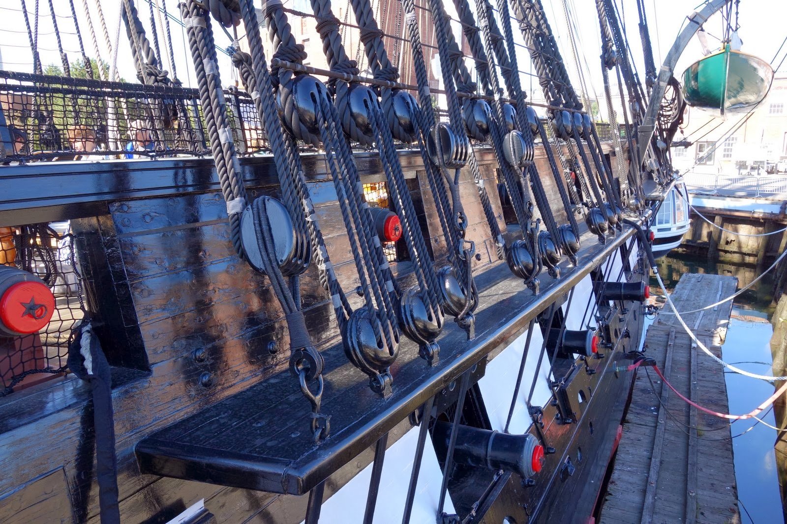

Up to now, I have not looked too deeply into the deadeyes yet as I have not gotten that far in my build. (In case you haven't noticed, I'm very slow). So, I took a look at the real ship's hardware and discovered that for the lower deadeyes, the wire is not twisted, but doubled. It's a loop that goes around the deadeye and is bolted to the chainplate from both sides of the loop. At your 1:96 scale, a single larger gauge wire, twisted just at the meeting point at the bottom of the deadeye might be easier to do and would look more real than the twisted wire going around the deadeye.

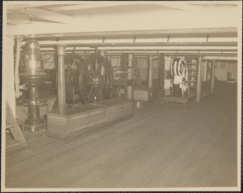

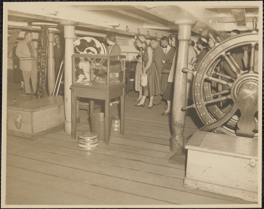

Here are a couple of more photos of the ship's wheel taken between 1940 - 1950. It looks like the wheel in the 1933 picture was removed and shown as a museum piece on the gun deck, Sorry, these images are not the greatest.
Jon
