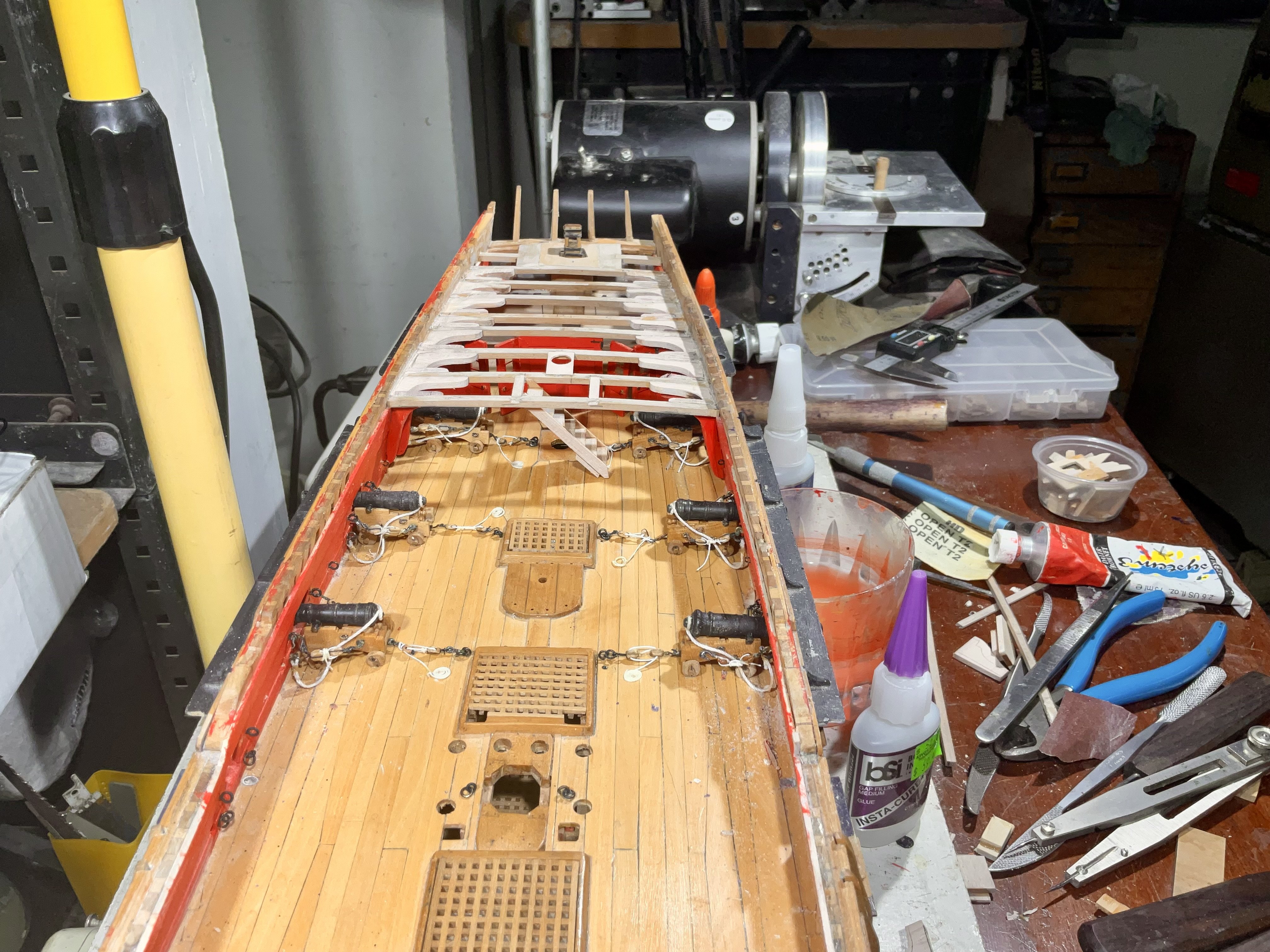

  3. Here is the natural colour of the plywood. I think i prefer the red.
  4. I was unhappy with the colour difference between the plywood and the mahogany so thought I would go back to the safe colour choice. Still not happy with the fit.
  5. Hi Alan the recoil from the cannon would push it all the way back to the end of the breeching line. After which the gun would be reloaded and i feel will need both port or gun tackles to get it back to its firing position. Also pulling on one side of the gun tackle may cause the gun to move to one side. So my guess is that they pulled both sides together. The train tackle was probably only needed when starting the firing sequence. i also found how the port tackle was flayed. Photograph attached. So they did not coil the side tackles but instead tied it on itself as i did with my guns. These storage solutions for the various tackles would only be used when the cannon was not in use. When in use rope would be all over the place just like it is in a modern racing boat. The tackles would also be tight when the cannon is not in use to prevent ut moving around. i also found a short video which may be useful to those who never knew how the cannons were used in battle.
  6. This is the first attempt . I am sure that i will make these removable doors and windows a few times before i get it correct.
