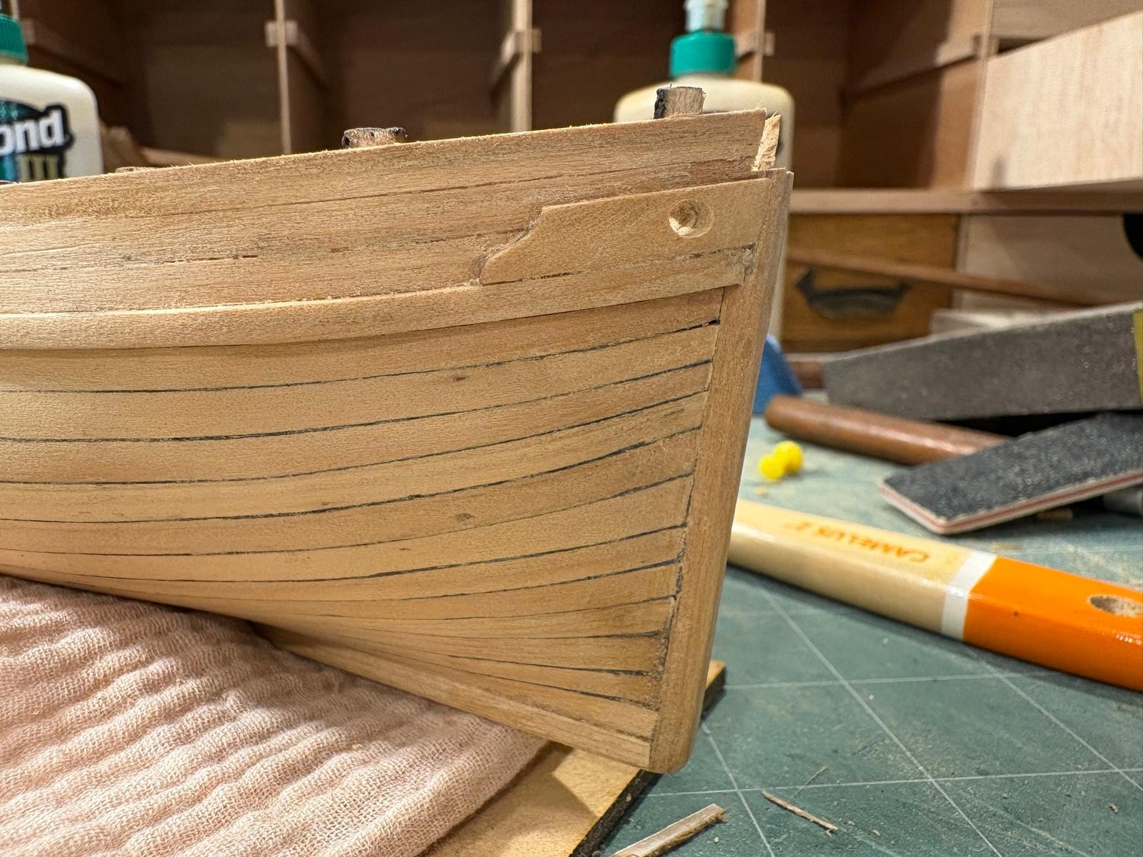

Ciao shipmates! First of all, thank you for all the likes and comments. They are very important to me. Thank you @Rik Thistle, i didn´t know about the book. I confirm to you that the book is about Luis Piedrabuena, the constructor of Luisito, i´m sure it must talk about in the book, it must be some more information about it, surely. So, with these photos, i complete the chapter. I opened the hawseholes, and gave to the hull some polishing. Brazilian pine is a rather soft wood, but hard enough to stand a good polishing and dye, unlike other types of pine wich aren´t suitable for that. Anyway some scratches were too deep to correct. So, pics: See you in next chapter. Black colored, and hull fittings. Thank you for your interest. Greetings. Giorgio

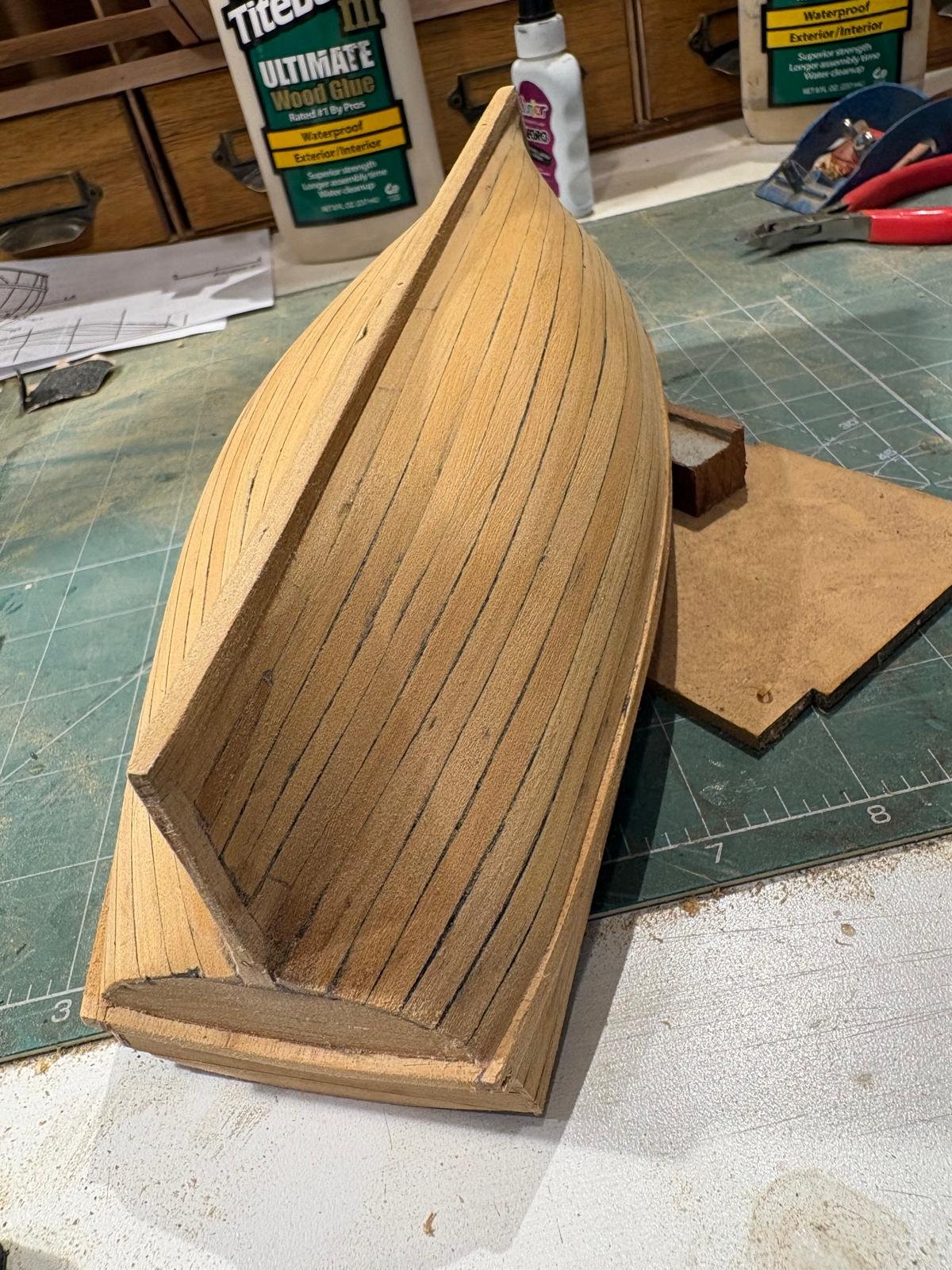

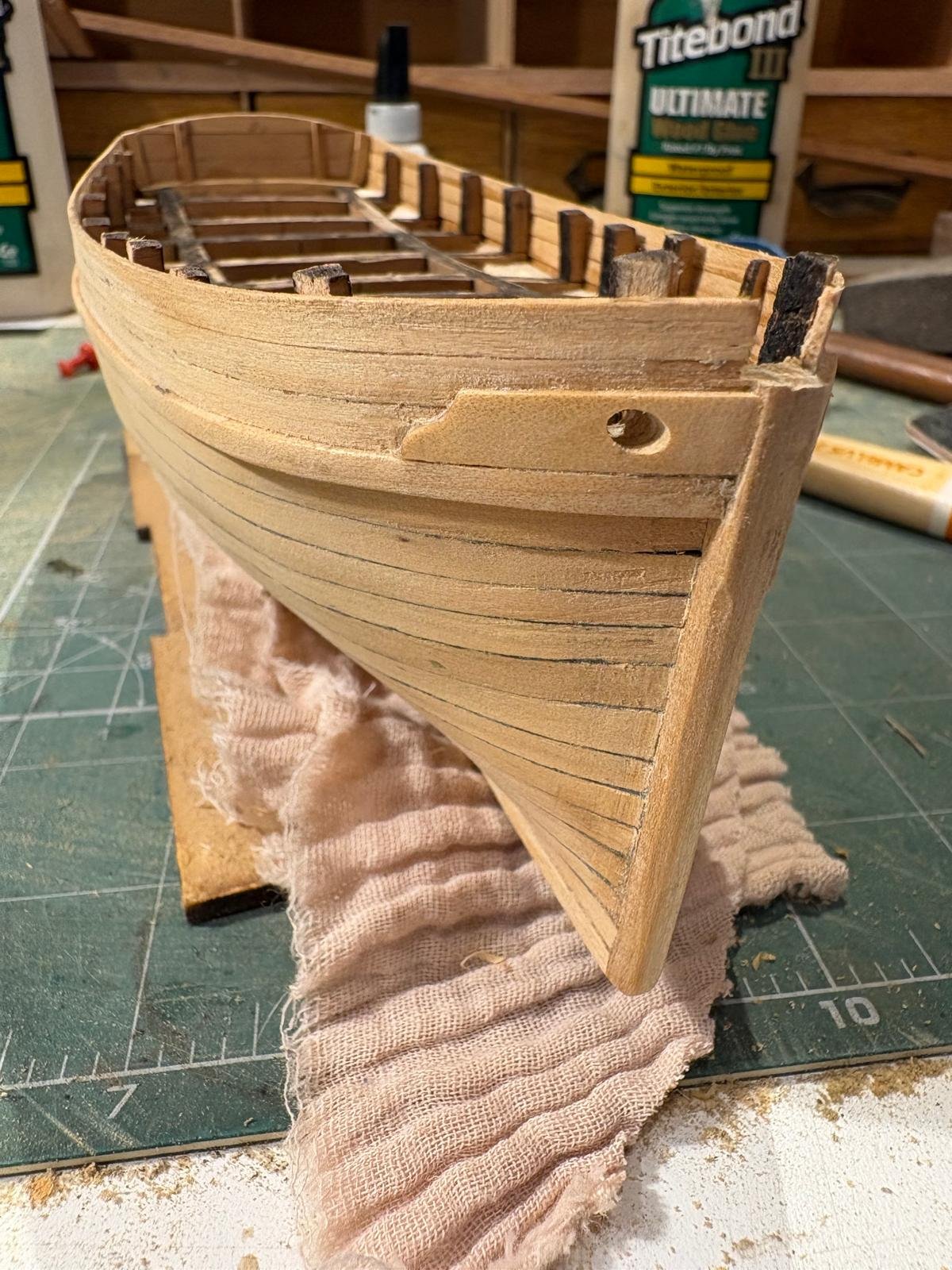

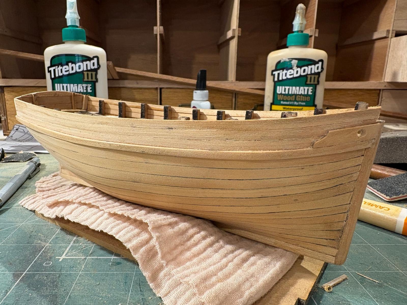

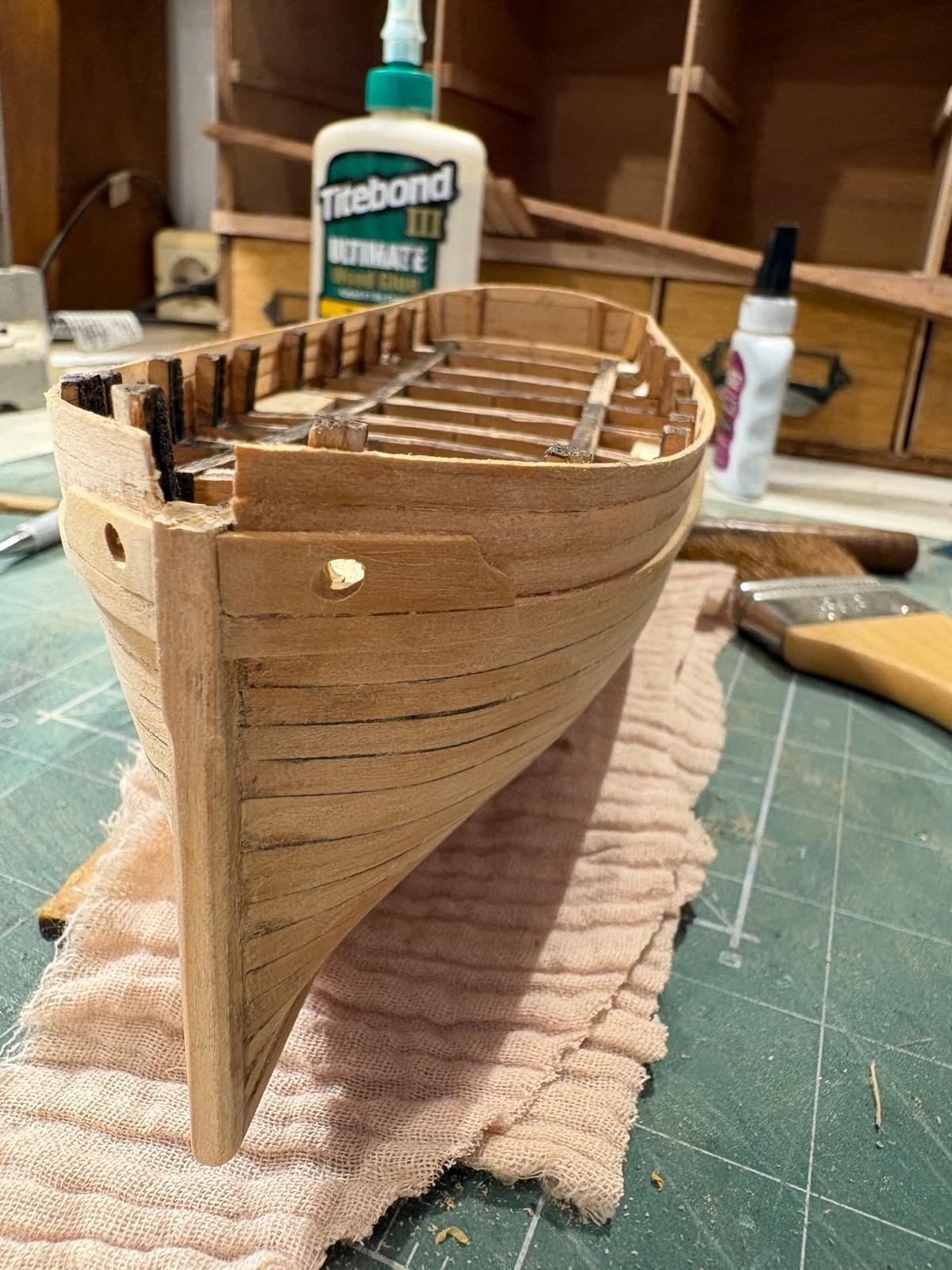

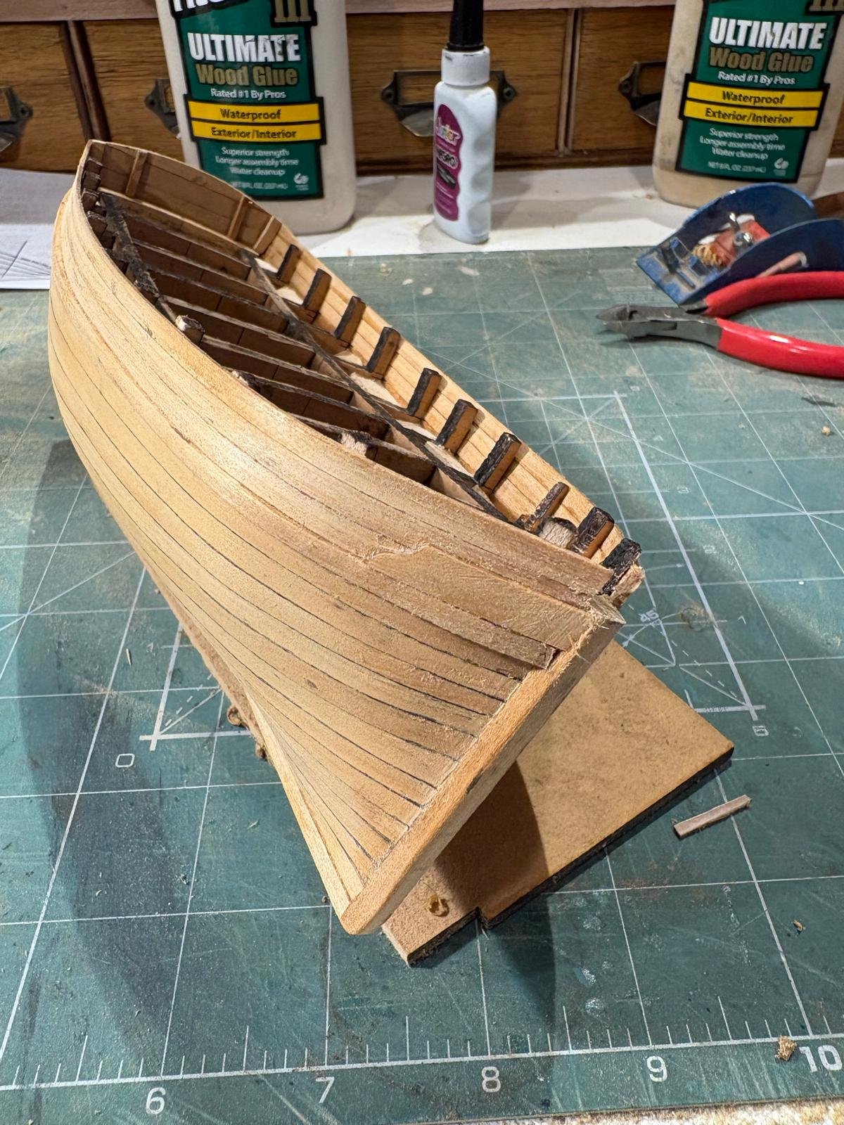

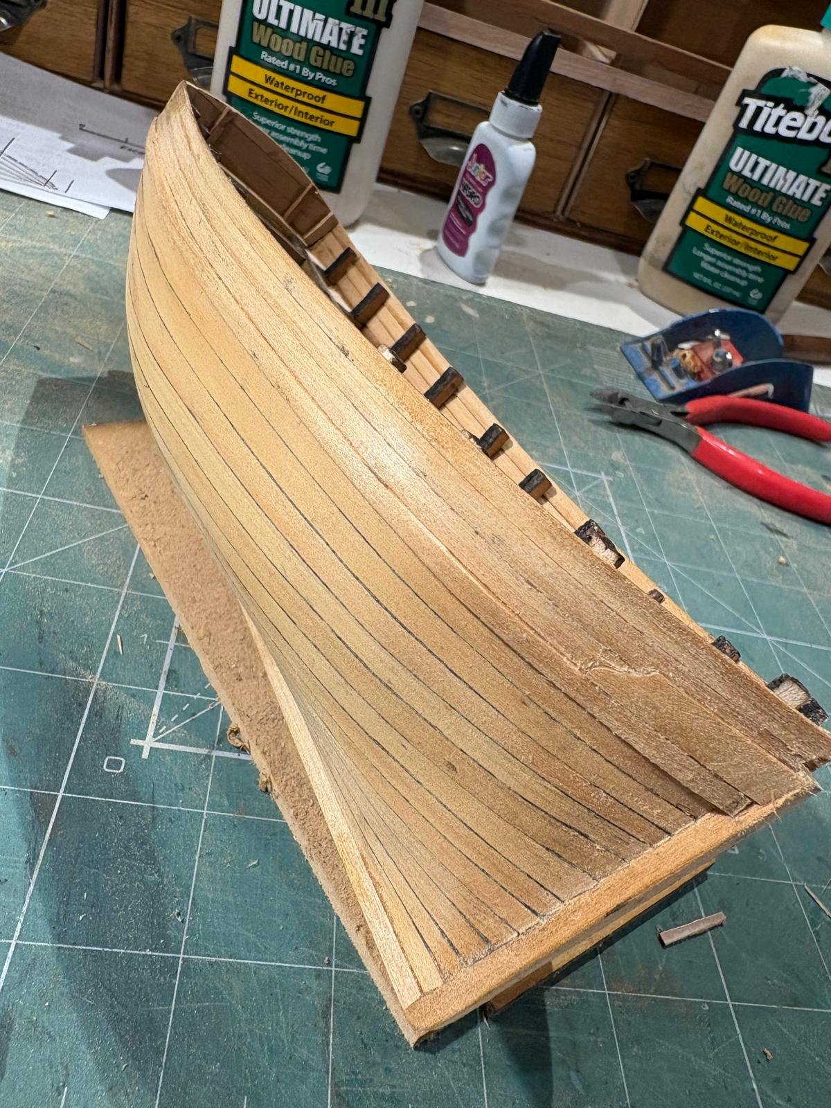

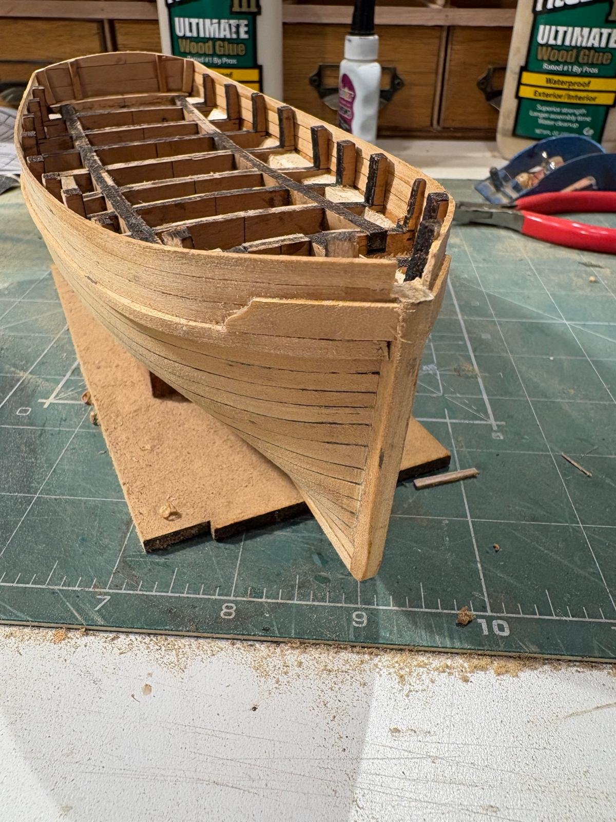

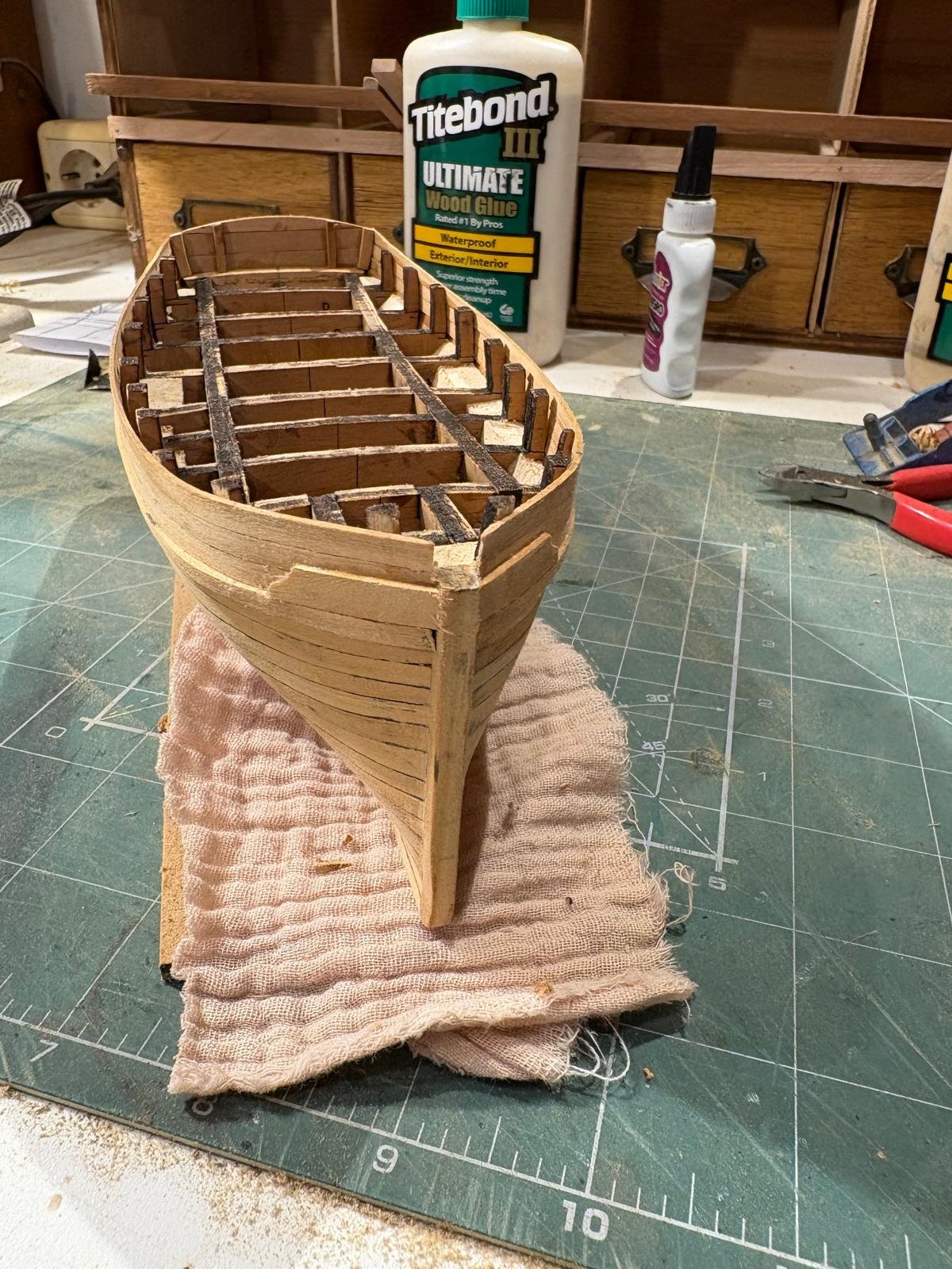

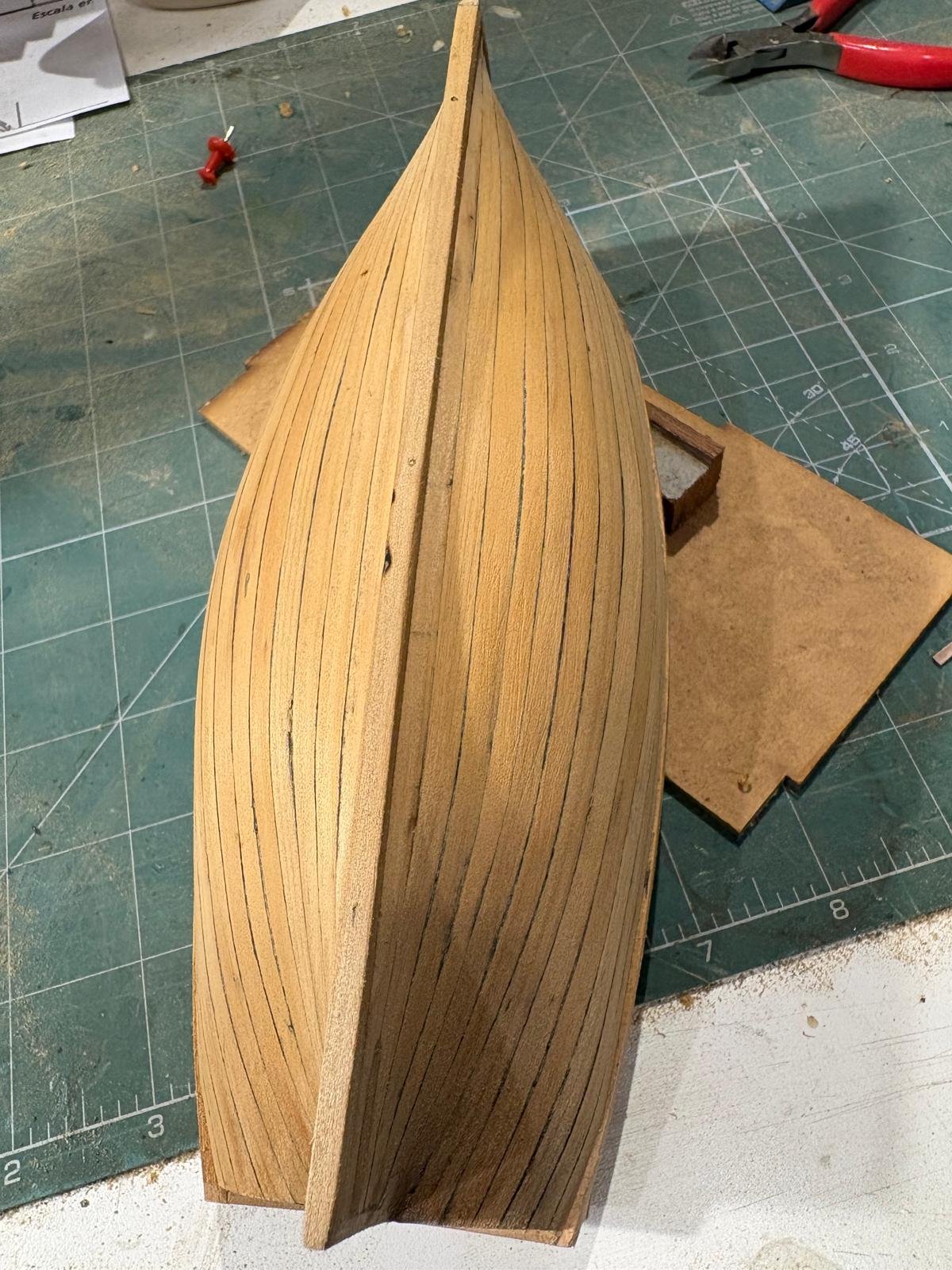

Ciao Shipmates! So, i finally finished the planking. It´s still raw, still have to do some sanding, polishing, etc., but you can see the idea how it goes. I decided to do not nail it, since the hull it´s going to be dyed in black, and anything of it would be visible. I will let that to the deck planking. I´m not very happy with the result, there are some mistakes wich i wish they weren´t there, but they are! Some of them i just found them with the macro of the camera. They are barely visible for the naked eye. So, a lot to do better next time. I hope you like it and thank you for your comments of course. Also, i made the rudder and modified the head of the stempost, in order to make the space for the bowsprit. Photos: As i said, a lot to be sanded, polsihed and corrected! I will post some picutres or the finished plank after this operations are done, and then.... Chapter 4! Thank you for your interest. Greetings Giorgio

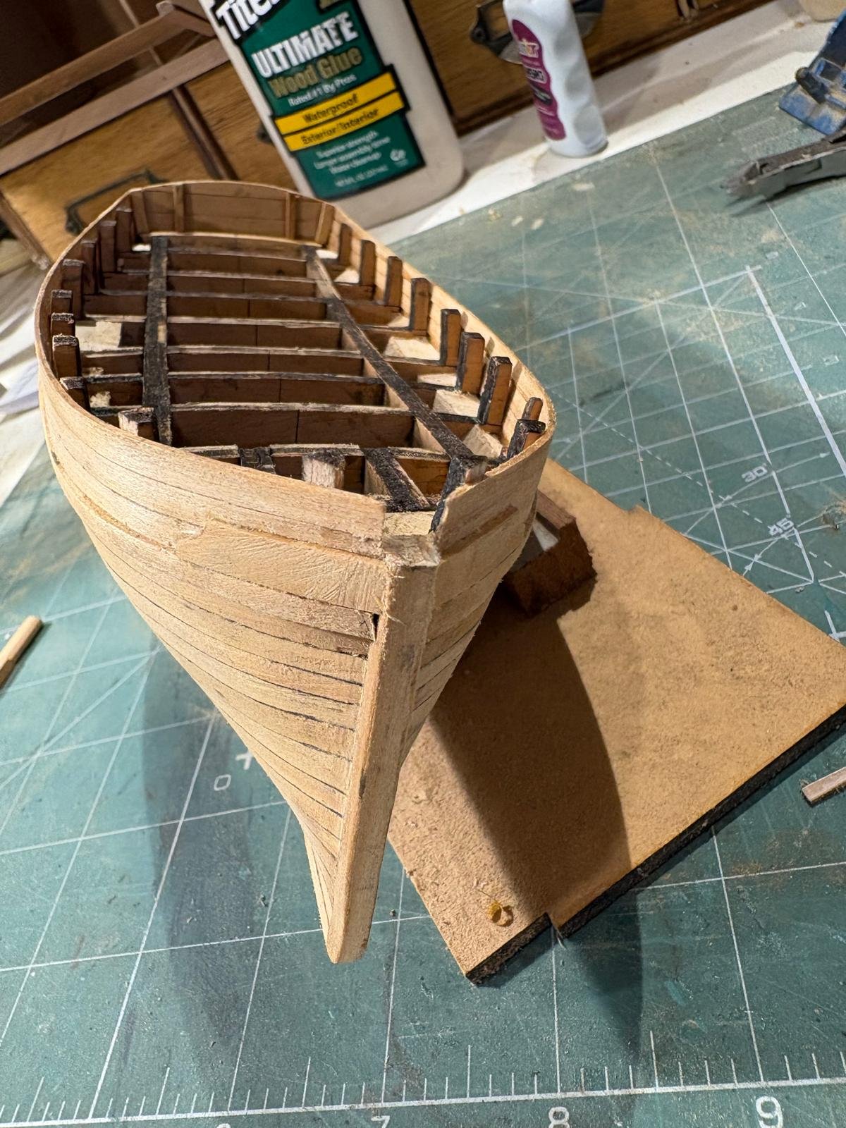

Hi shipmates! I started the planking. First i marked 4 rows, then divided them in to 3, in order to achieve the best number of planks. This done following, not precisley, the David Antscherl practicum. As for the plans of the Luisito, i know that the plans we are using (i say we for all the modelers that are building it), are from of course a survey done, i mean a ¨as built¨ set of plans. Of course Piedrabuena didn´t have any drawings available with him. He later said that he managed to remember the lines from his studies. This set of plans is signed by an architect who happens to be a shipmodeler too, maybe he maneged to draw this set after that survey. You can search in the web Arq. Carlos Rando Ferrer. He is an argentinian architect, teacher and shipmodeler. The bullwarks are planked too, using 3 rows of planks in each side. This wood i´m using is very easy to bend, so no big difficulties so far. For caulking i´m using black glue (school grade), once sanded down it leaves a fine line between planks. So, lets go to the pictures. Chapter 3 - Planking, calulking and nailing. Thank you all for all the likes, the comments, and the views. See you next time!! Greetings. Giorgio
