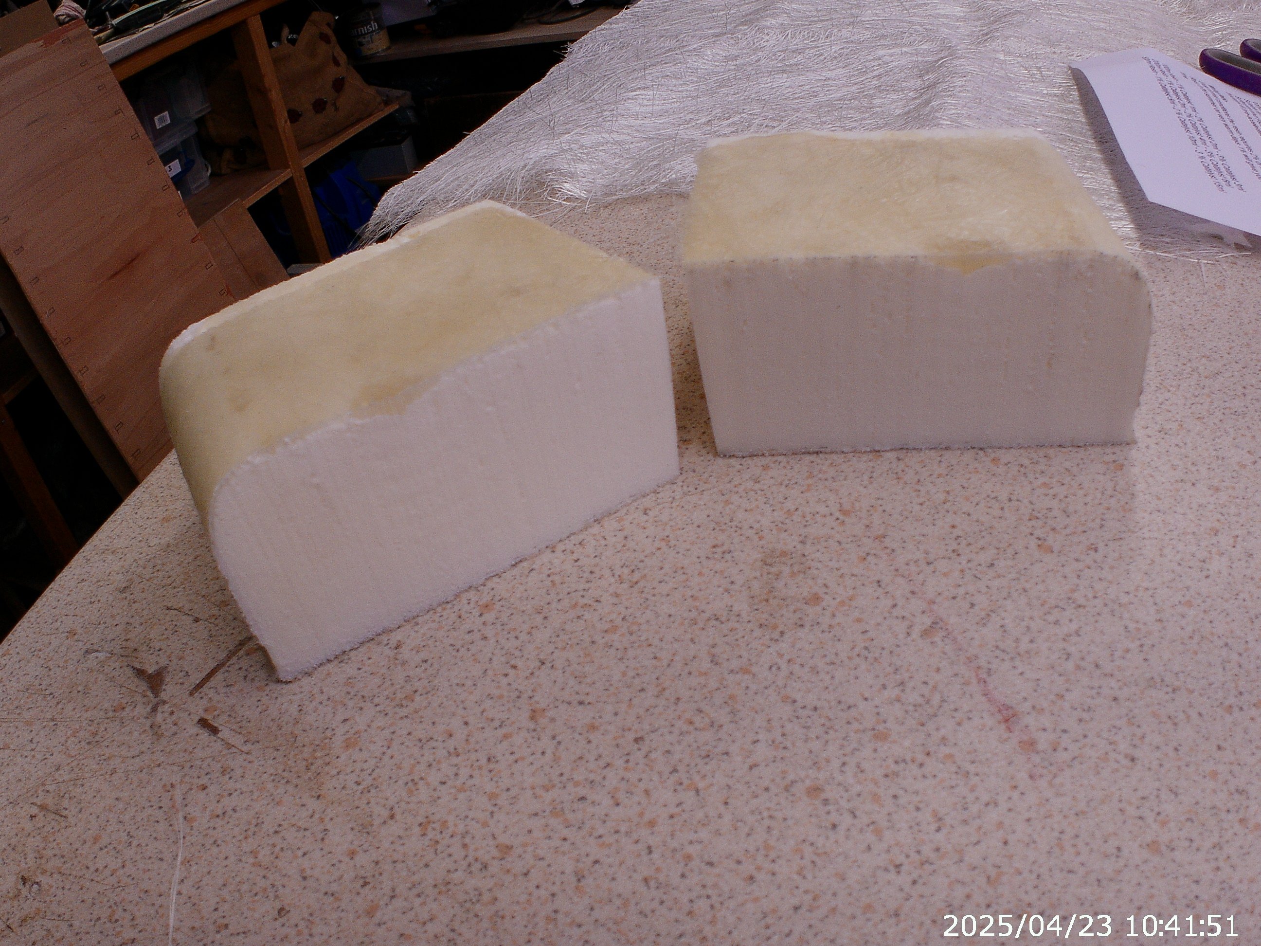

  10. Hello again. A change of plans. After testing polyester resin on the Polyisocyanurate foam it showed no signs of melting the foam. I just wet the foam with the resin then added 300g chopped strand mat and wetted it through. Left it 24 hours and sliced it through with a bandsaw. So I will Not be using the plaster of paris to give the hull a firm surface for finishing. Looks good to me So I will apply 2 layers of 300g matting and sand to a good fare curve mabe adding more matt and resin or filler if needed. then I will spray a grey gel coat onto the sanded surface and fine sand to a finish. then a white gel coat and fine sand and polish. I am hoping that I can cut the planking seams in with a diamond edge and fare curve plank. Will test this on some scrape before attempting to do it on the hull. This fibre glassing is all new to me. Any advice ?? . Thanks for looking in. AntonyUK.
