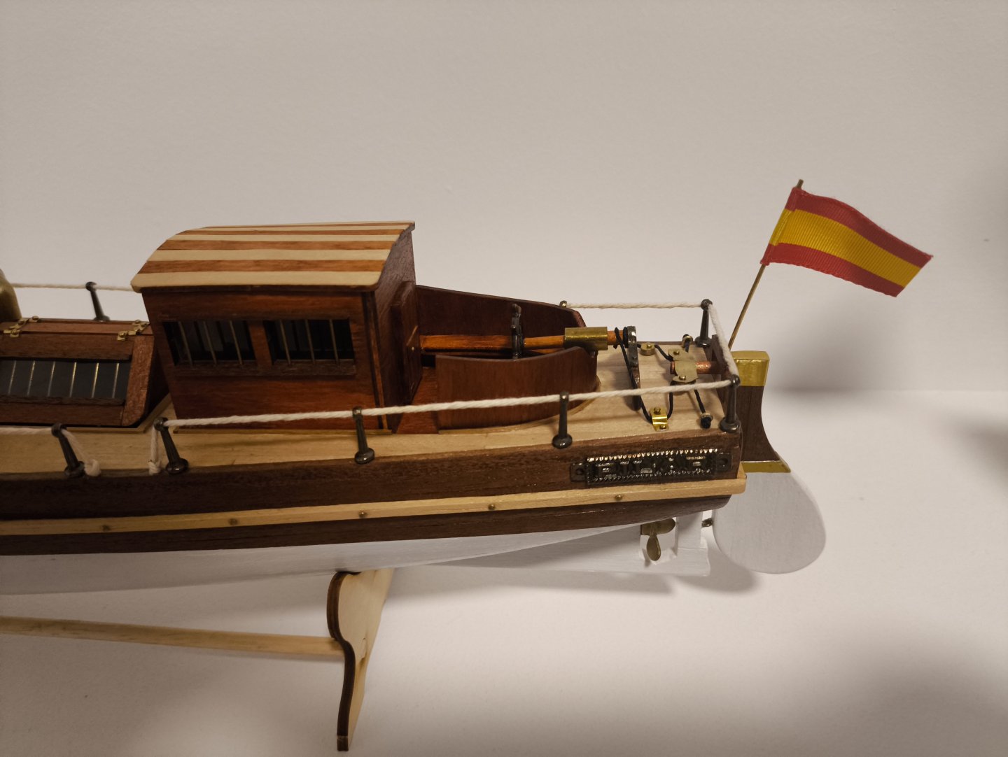

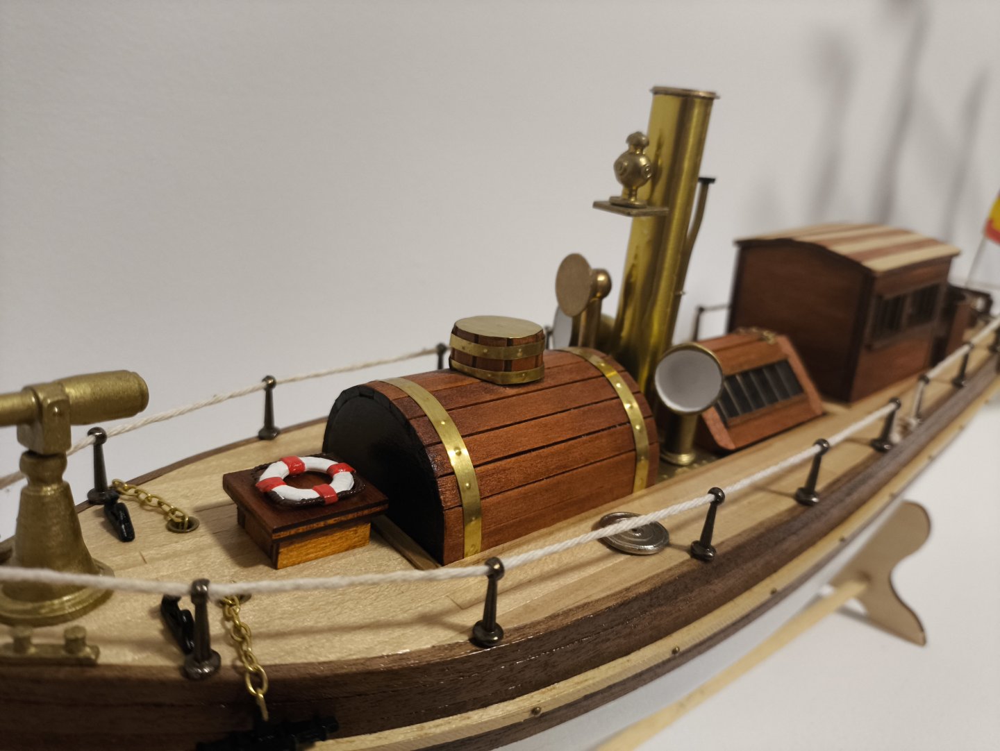

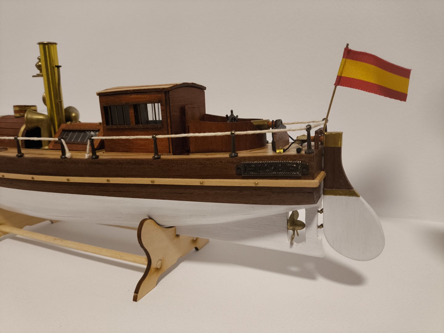

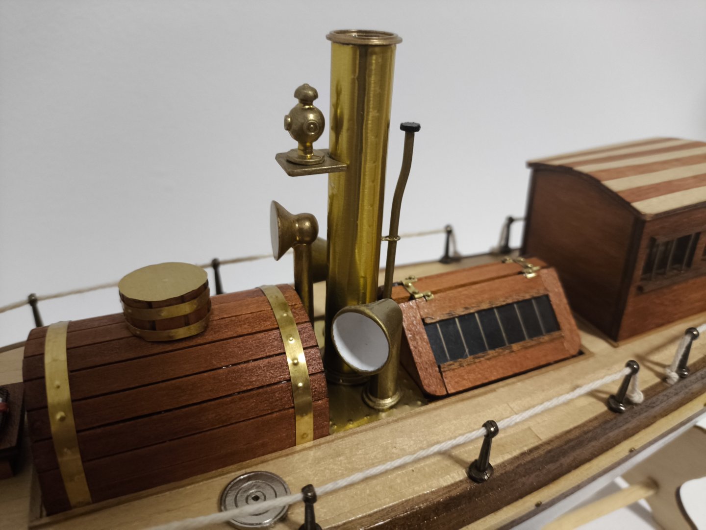

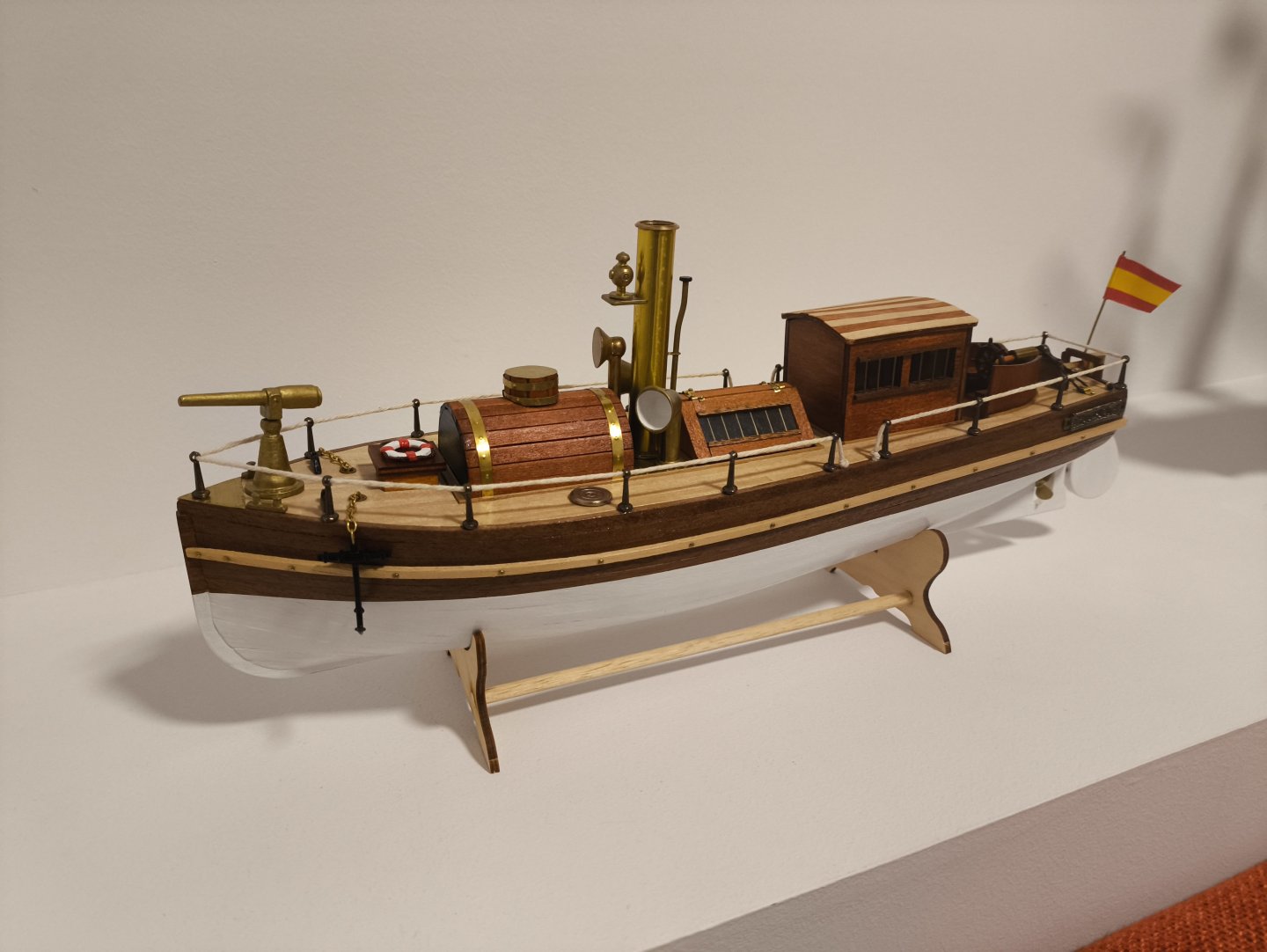

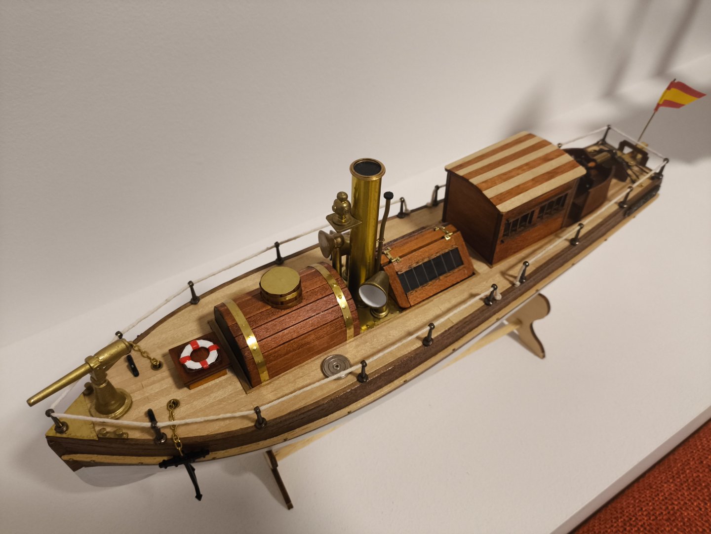

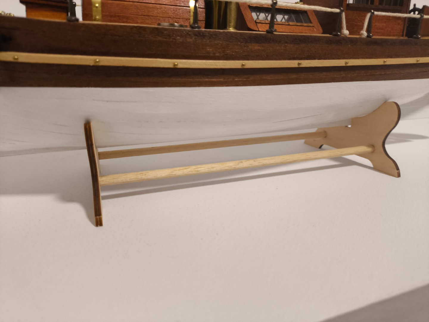

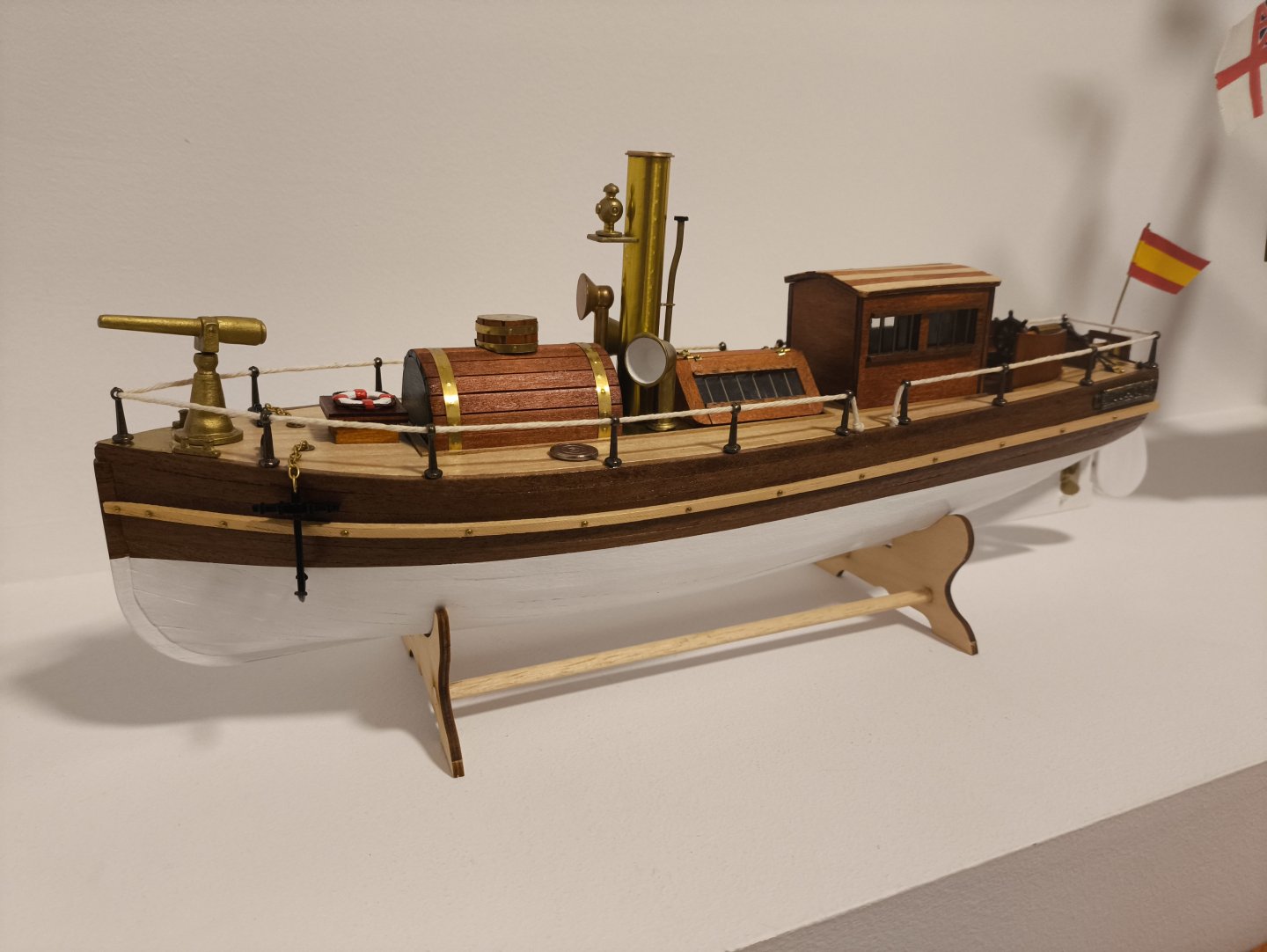

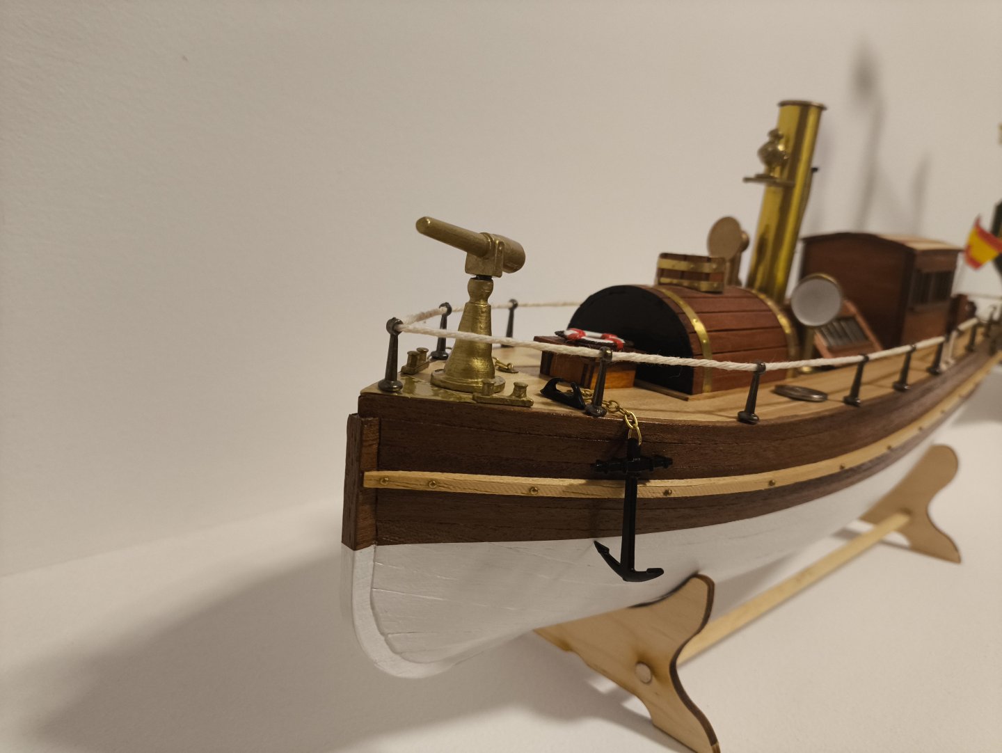

  1. Hello everyone! I have just finished my Escampavia Pilar 1865 from the lesser-known Carthagonova company. It has taken me about a year of intermittent work. Still, I must say that the instructions and how the kit is prepared require the modeller to plan in advance. Sometimes, more than one might like, to look for alternatives out of the box, both rhetorically and physically, as the bits and wood supplied and those listed differ quite a bit. I want to think that it was just my case, but let it be a heads up. Anyway, apart from showing it to all of you, I need a bit of help to build a suitable and adequate base for this model, as the one supplied by the kit is way too simple, even if painted or dyed. After some time reading threads and watching models, I have seen many bases made from scratch, so I would love to get some ideas to try to build the best one for this kit. I hope you like it. And here you can see the basic supplied base.

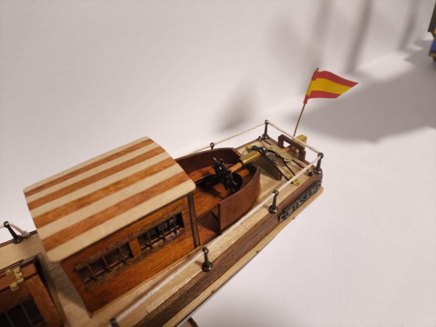

  2. Now let's move to the auxiliary boat. At first, I just decided to paint it brown and white, but I am not really good at painting and making effects so finally I decided to line this steel boat with sapelli strips and make it look like a wooden boat. At first, I thought about keeping it simple but as I was covering it up with wooden strips I wanted to add more and more details so it could look nicer. I don't have photos of all these details I added on the go but you can see the result here. As you can see I added two oars and an anchor. Finally, I stopped adding details and this is how it looks like: That's all the progress for now. As I said I have more time than before and I am going to keep working on my wonderful flore. I won't be a fas progress but a steady one. I hope you liked the photos. Thank you.
  3. Then, I primed the transom stern, quarter galleries, and the auxiliary boat which is made of steel too but later I thought it would not look nice painted and I changed my mind.... I think it looks pretty nice After this, I also glued the walnut stem stringer Then the head rails
