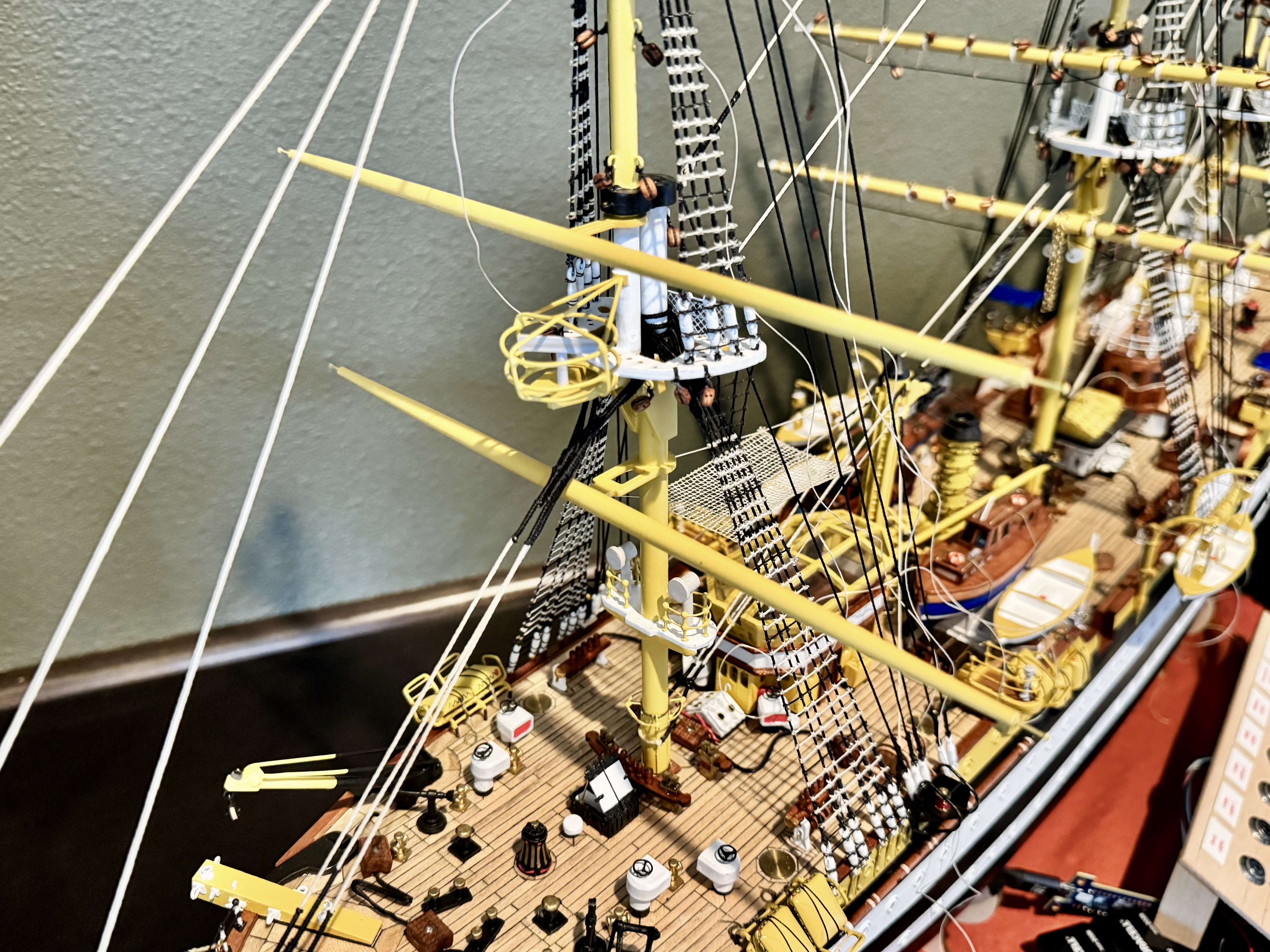

  14. Good evening mates, today I met a milestone with my AV! I finally have all the yards completed with all the hardware (15 of them). Next up is to add the blocks to the standing rigging, then the furled sails…once I figure that out.

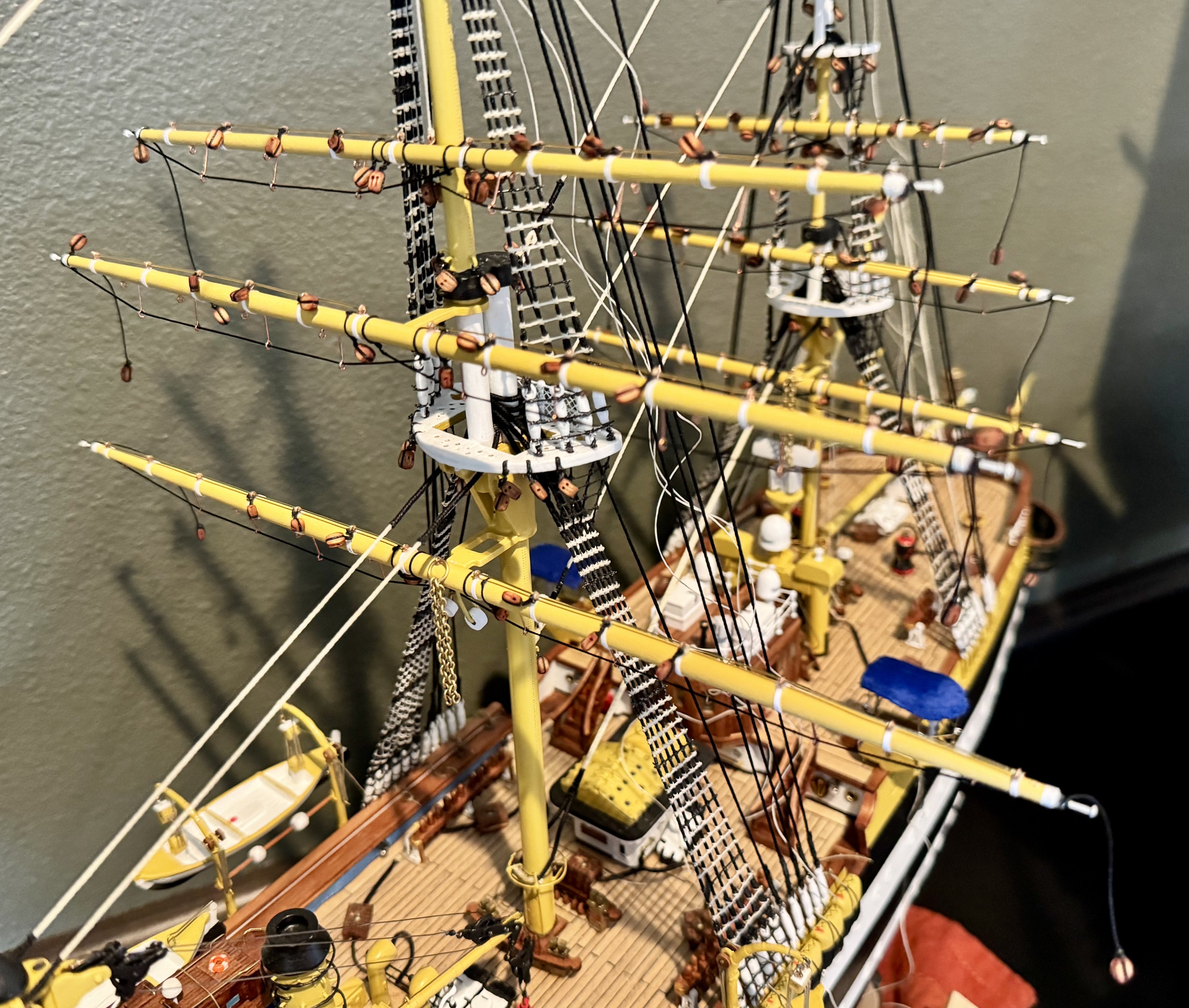

  20. Good afternoon mates, it’s been awhile since my last post, but progress has been steady. I’ve been working on the yards, a total of 15 on the Amerigo Vespucci. Below is a comparison from an unfinished yard to a finished one.

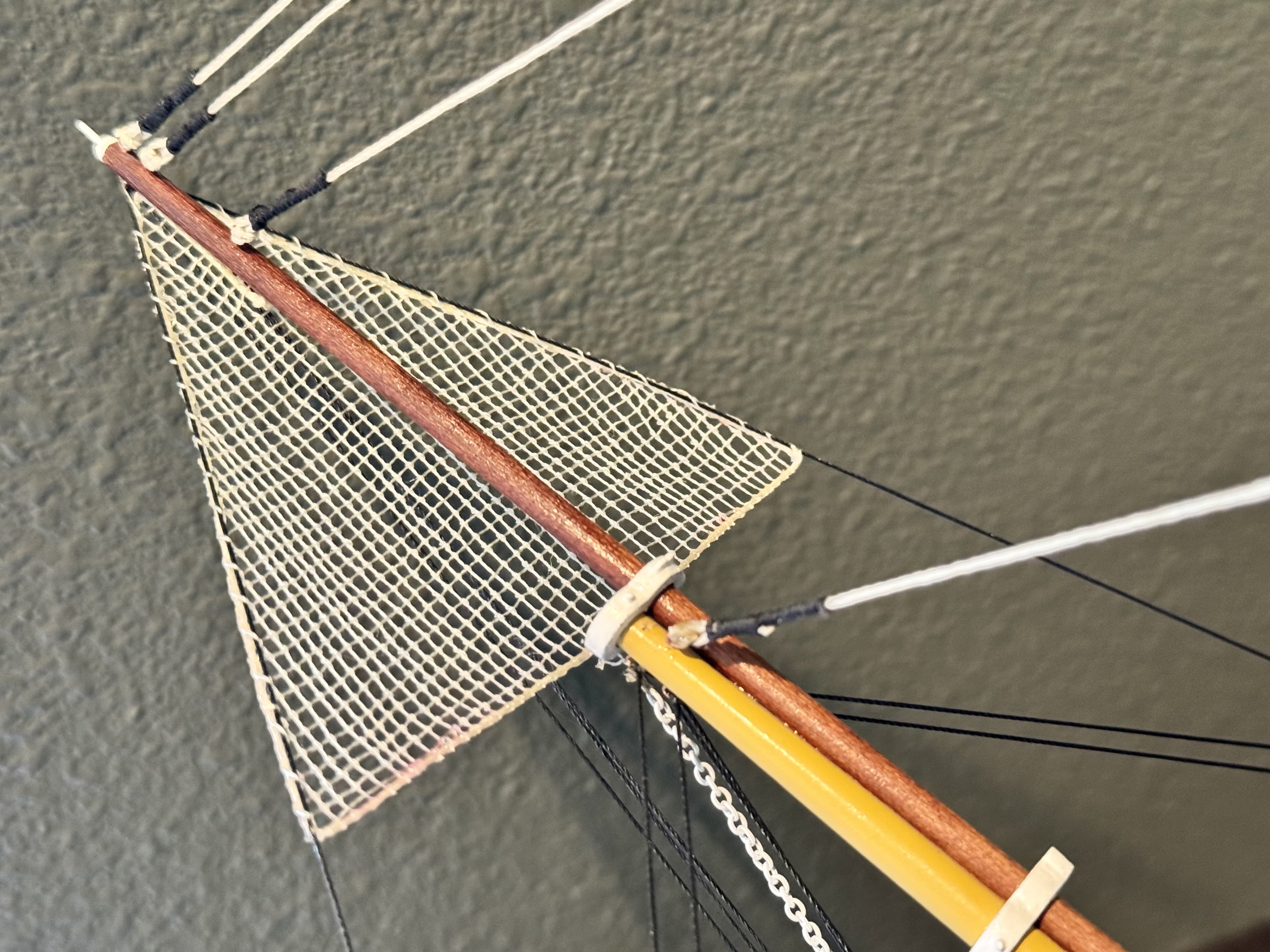

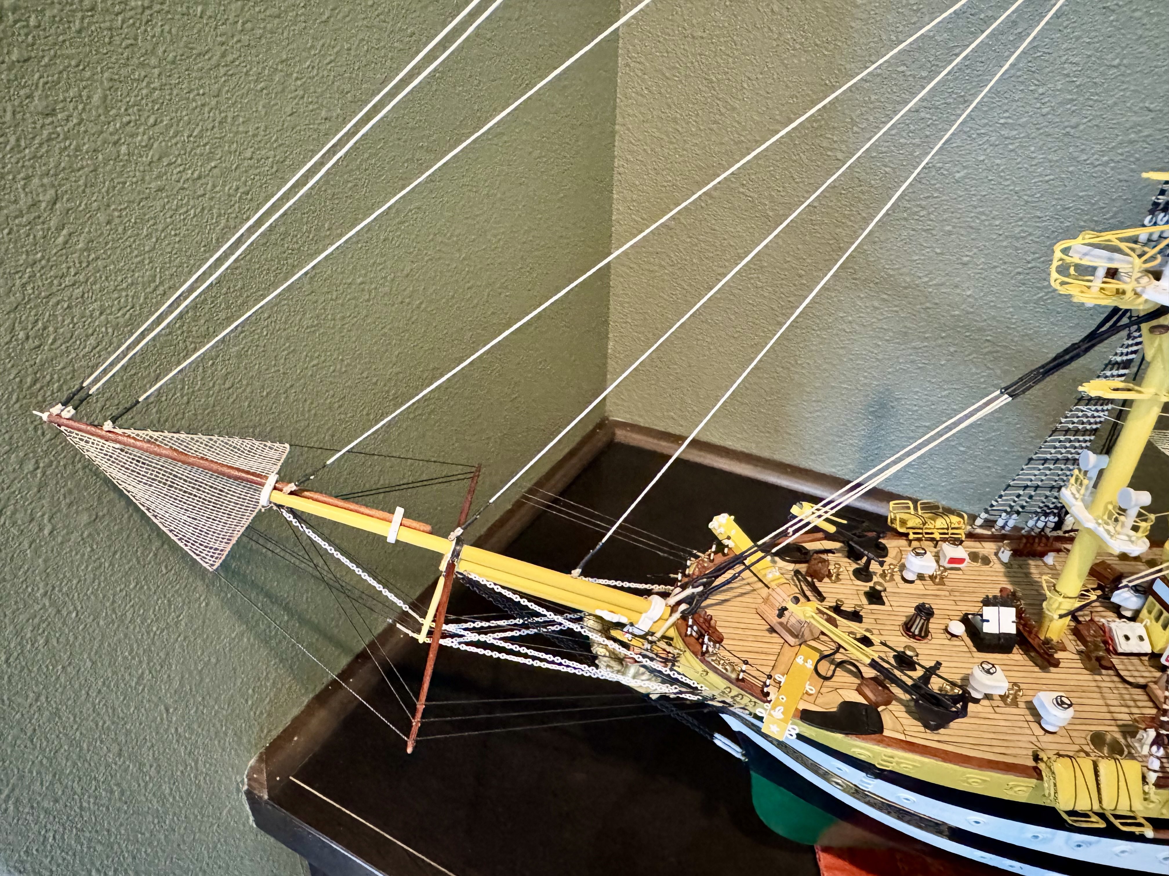

  23. Good evening mates, I’m finally finished with the custom hand made netting for my Amerigo Vespucci. I have about 80 hours in these three nets.
  24. Bill, sorry it’s been so long. As far as the home made netting, I map out the shape and size of the net I need, run a larger sized rope around the outside of the shape like in the image below. Then I add the vertical thread at one or two mm apart. Once all those are strung, I add the horizontal thread using a clove hitch at each intersection. The last step is to run a light bead of CA glue along the outside rope sealing all of the outside knots in place. The key for a good hand made net is to be as precise as possible when adding the thread, knowing that it will never be perfect. It’s those minor mis-aligned threads or knots that make the net appear hand made. After many hours, you end up with a finished product. I have about 80 hours in the three nets in the following post.
  25. Good morning mates, just finished another hand made safety net for my Amerigo Vespucci. Will mount permanently later today. One more net to manufacture.
