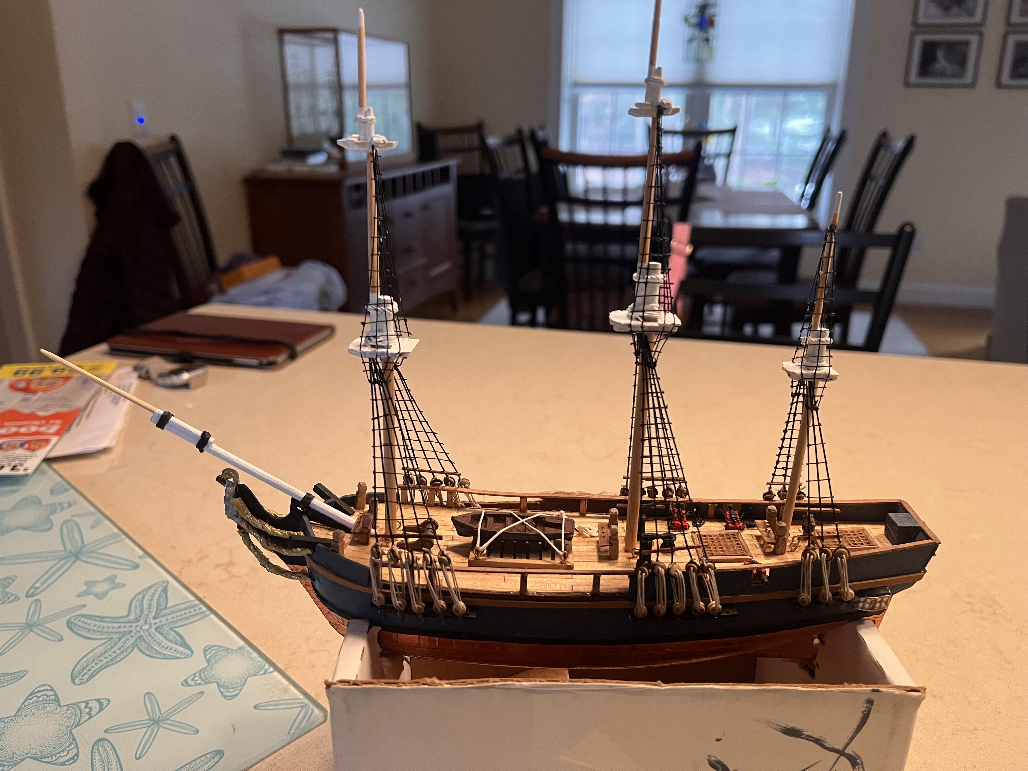

I built and erected the fore, main and mizzen masts along with their respective tops. I then completed the shrouds, deadeyes and ratlines on the starboard side of the model. Port side next after time off for the Thanksgiving holiday. Happy Thanksgiving to all! Jerry

Having built many ship models as well as scratch builds over several decades, I am running out of room to display them.. i decided to build a mini model of the HMS Bounty. It is rated as a beginners model but I decided to “detail” it and make it more authentic. I researched the ship and found the true Royal Navy color pattern as well as the fact that it was copper bottomed. Here are a few initial pictures of my journey.
