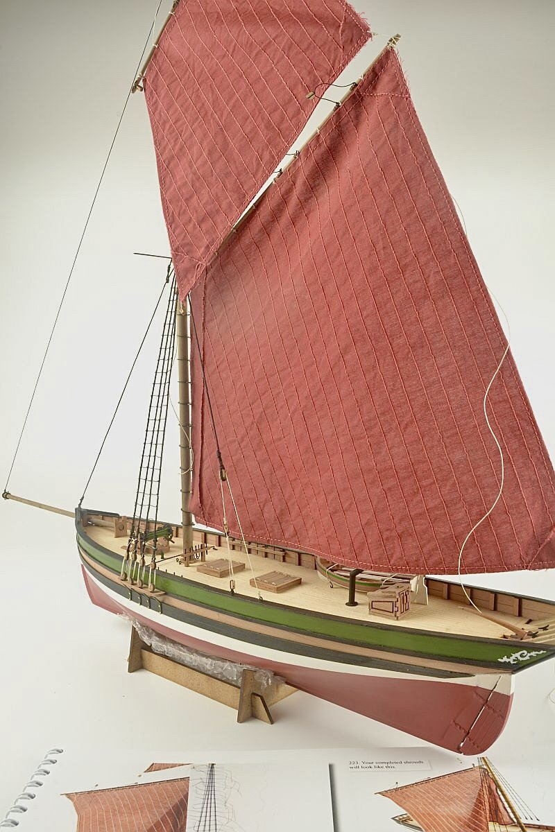

  1. Hello - Ranger now completed. Sails all rigged, rope coils etc, barrels and now sitting on the Perspex stand. The name plates on the stand were difficult to fix on - very tight. One plate slightly split - not very noticeable fortunately. Thank you all for looking and the ‘Likes’ Regards Doug

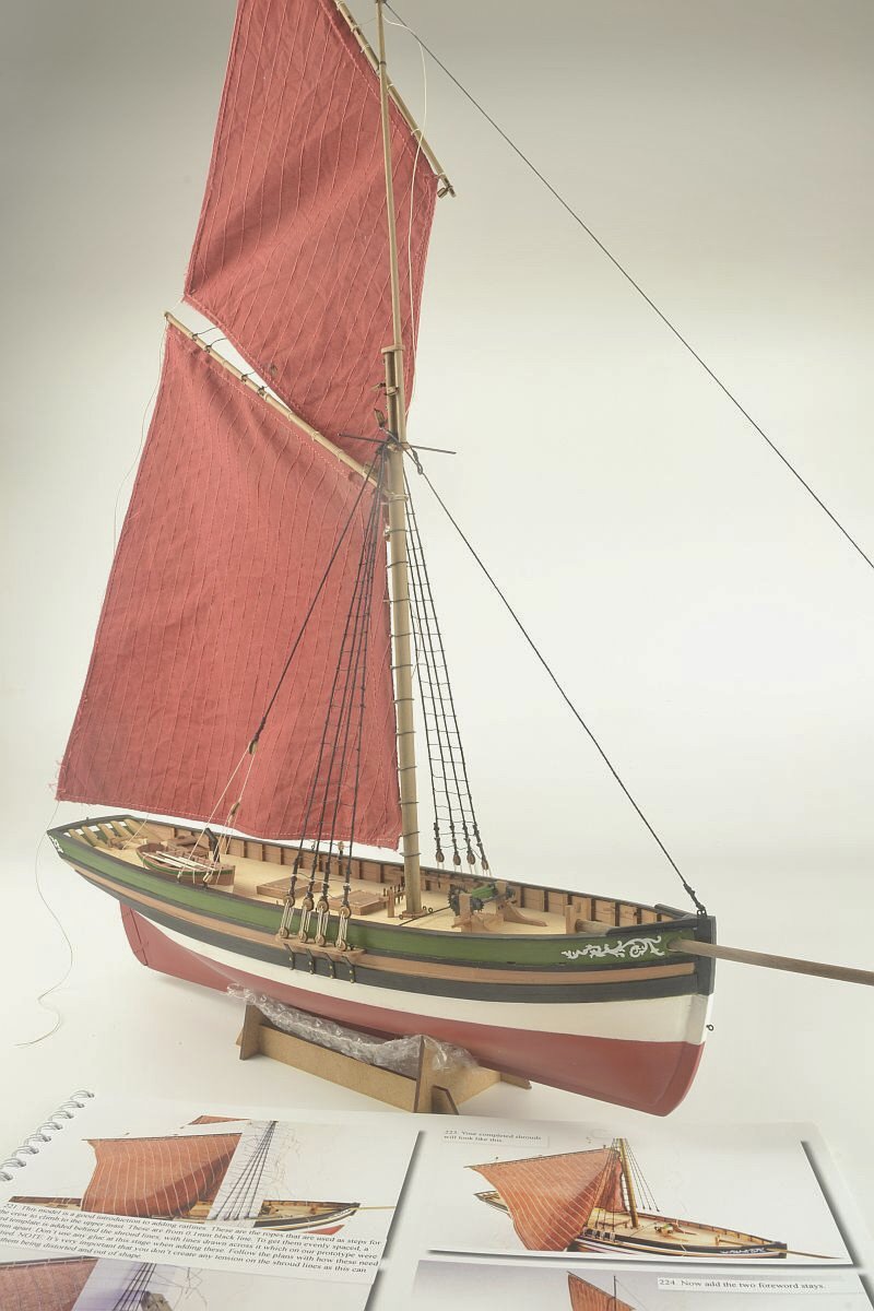

  2. Hello - getting there. Shrouds / Ratlines / Stays etc done. The Yard / Gaff / Boom have been shorten a tiny bit due to sails shrinking from the dyeing process. Thank you for looking and the ‘Likes’ Regards Doug

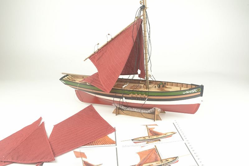

  3. Hello - a small update. Sails all dyed using Rit cocoa brown and scarlet (equal mix of each). Wanted a deep red to match the bottom of boat. The Main Sail secured to Yard, rings added and fitted to Mast. Doing the Shrouds before fitting the Top Sail unlike the instructions. Thank you Doug
