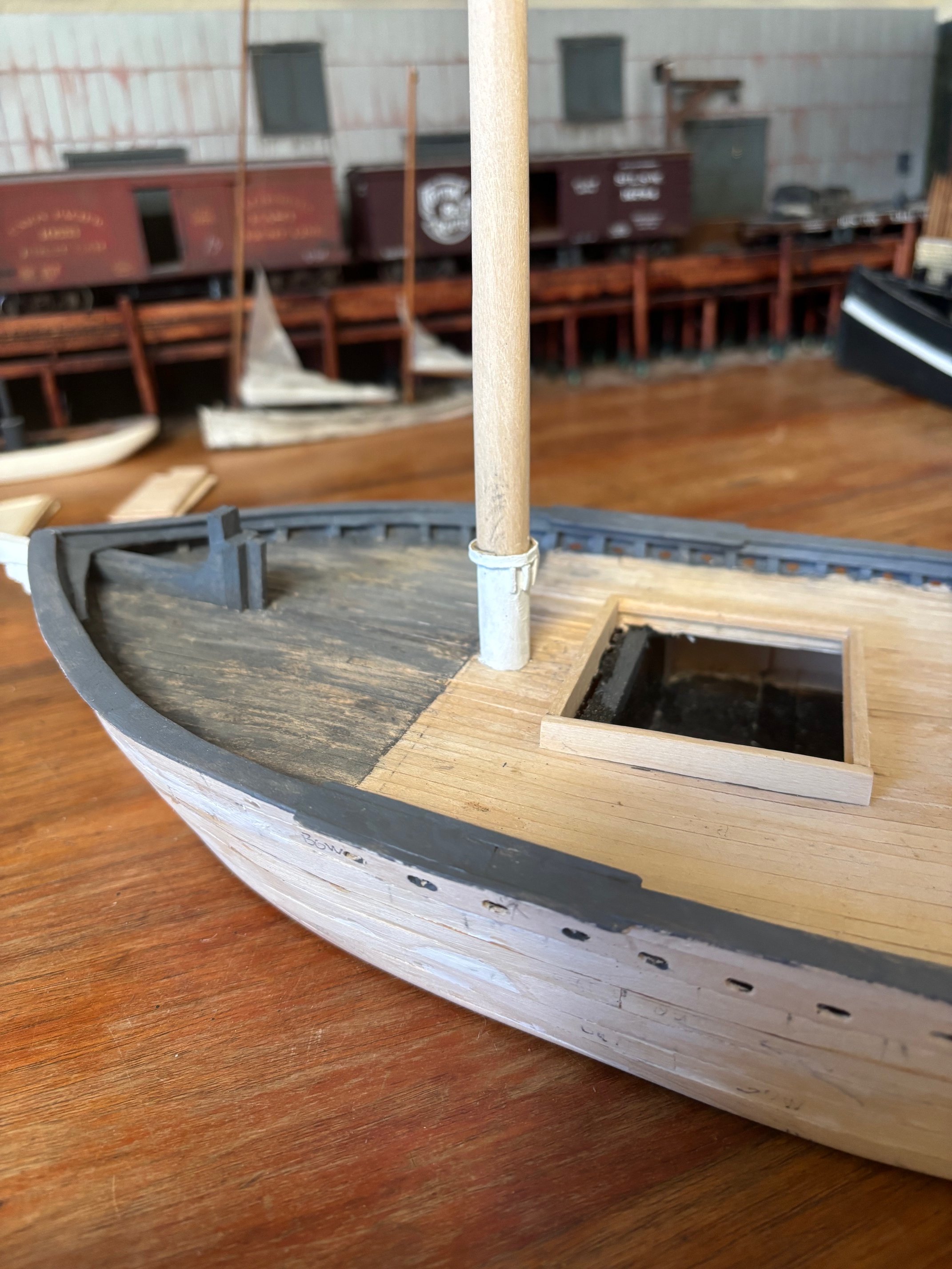

I have decided to build a waterline model of the granite sloop Albert Baldwin ca. 1890.  It will fit in my harbor scene of the same period.  The other craft and the wharf and railroad transfer bridge in the diorama are built to 1 inch equals 48 inch scale. I have the plans which are conveniently 1/4 inch to the foot scale.  These are from 1930 by Howard Chapelle.
I am planning on challenging myself and build it plank on bulkhead.

I traced the stem shape onto some vellum.  I used white carpenter's glue to glue it to a 1/4 thick piece of Basswood.   Coping saw, sandpaper and knife were used to carve it out.
After looking at the tutorials I decided I had better fill in the fore and aft sets of bulkheads to create good surfaces for bonding the more radically curved hull planks.  It was kind of labor intensive as it required a lot of fitting and sanding.

I am finally back to the build of the Albert Baldwin.  After a cross country move and discouraging false starts on planking.  I have been following the tutorials and think I am making progress.  I steamed the bow end of the first plank and it seems to fit well.

I finished adding the taff rail.  and am beginning to put in the covering boards.  I can't seem to be able to add an image.  I get "error 200"
