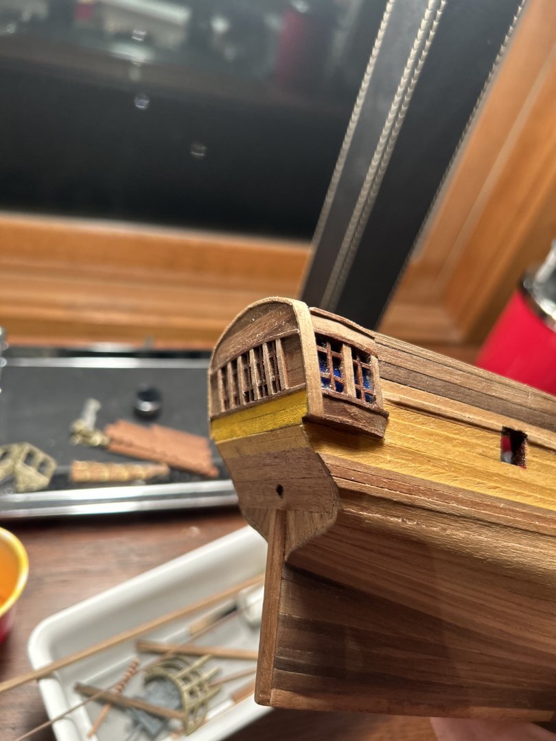

This next step took forever because it involved my nemesis: oil paint. And even worse, yellow oil paint.
To get the next two planks to approximately the right shade, I had to blast them with several layers of thinned oil paint. Of course, each layer took a day to dry.
Of course, after the painting, they went on fairly easily.

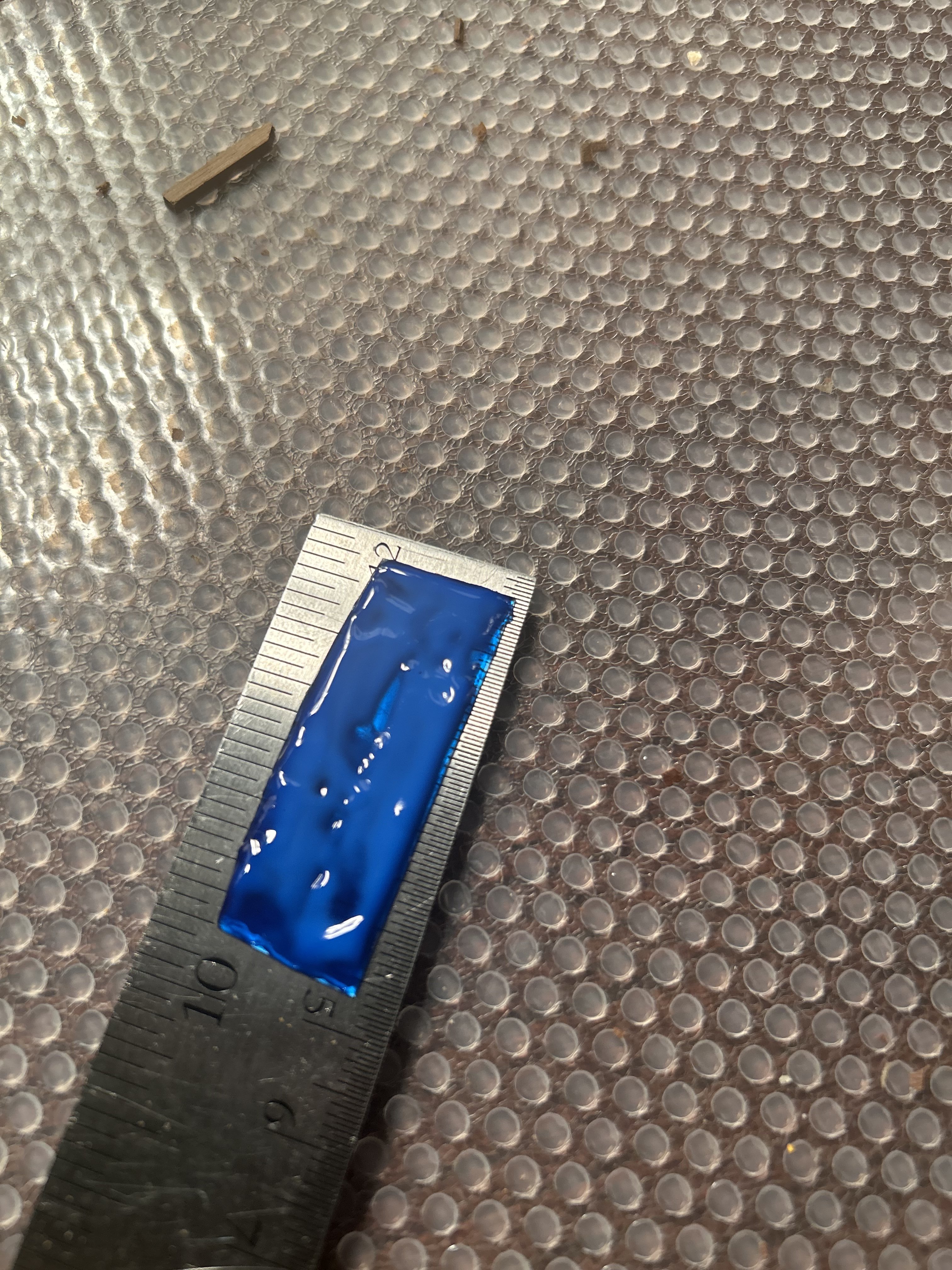

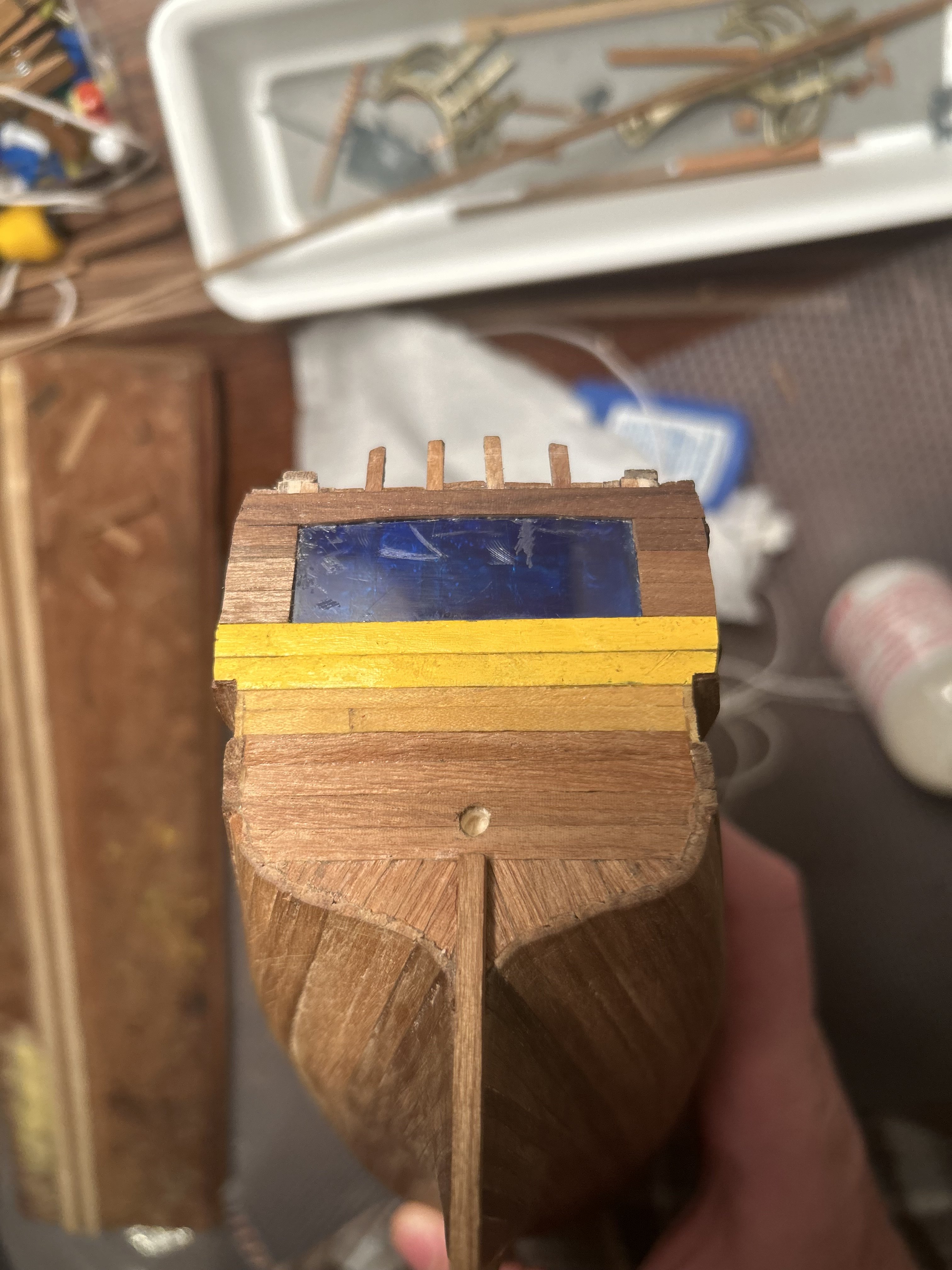

And in the meantime, I realized that my glass for the transom window wasn't quite blue enough, so I've put on another layer of staining goo.77614093806__258B4587-0A0D-4247-8A74-0D36890CEAE8.thumb.jpeg.072b55e471350a421ed0431184c3e4de.jpeg
Hopefully, the next step won't involve loads of drying for stuff under my control.

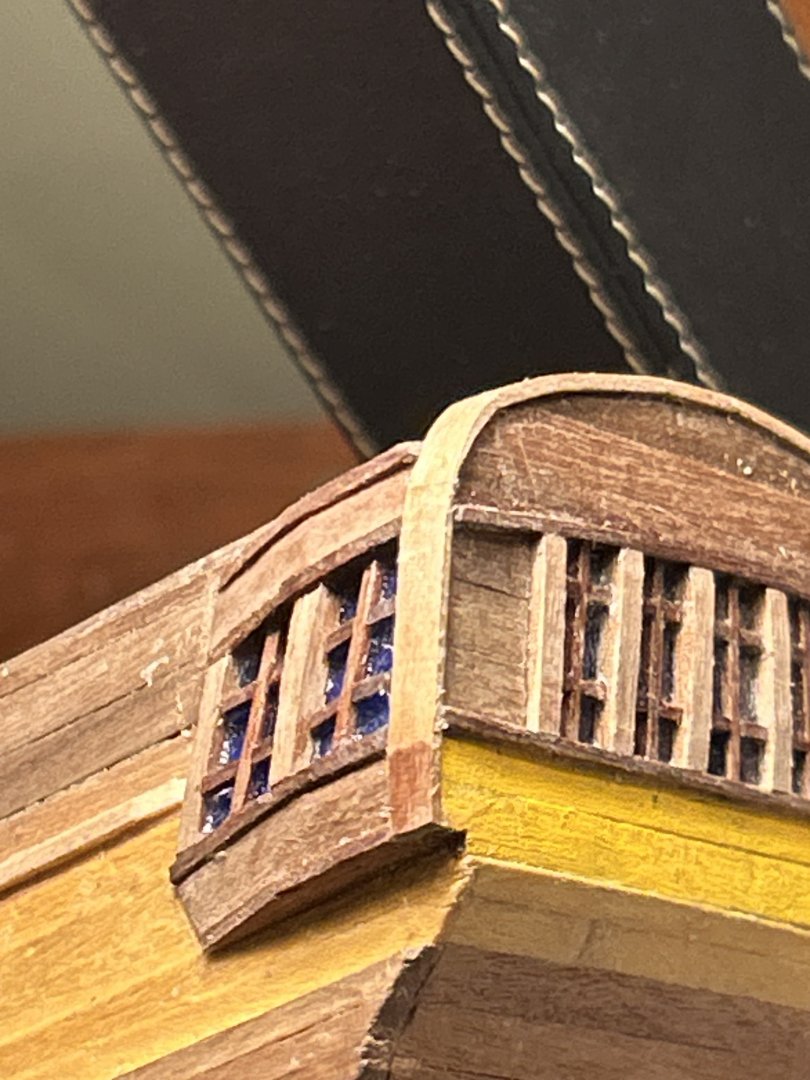

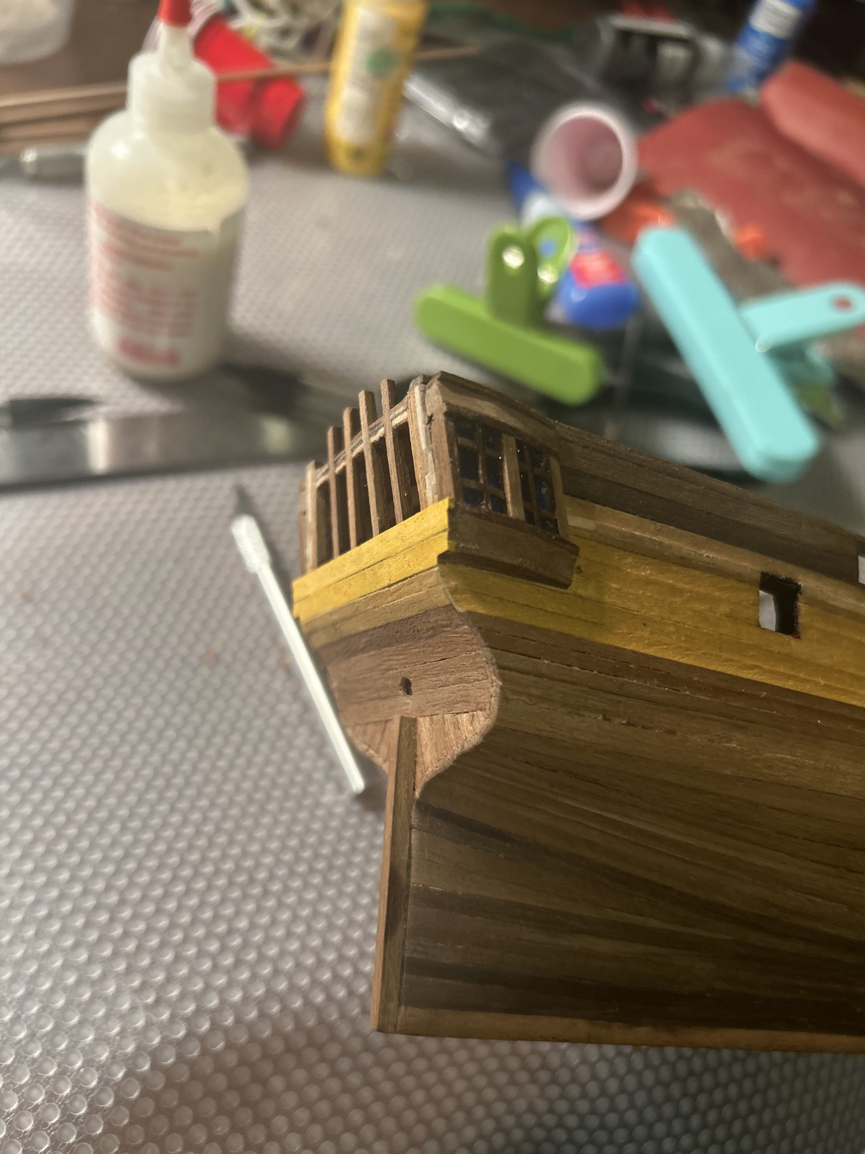

The side gallery windows have tiny wooden window bars. In an ideal world, they would connect percectly with the pillars that frame the windows. But the back pillar is too low to connect perfectly against its bars.
Rather than leave the bars bumping up, I sublty cut the bars into a wedge shape so it looks like they are flush with the pillar.

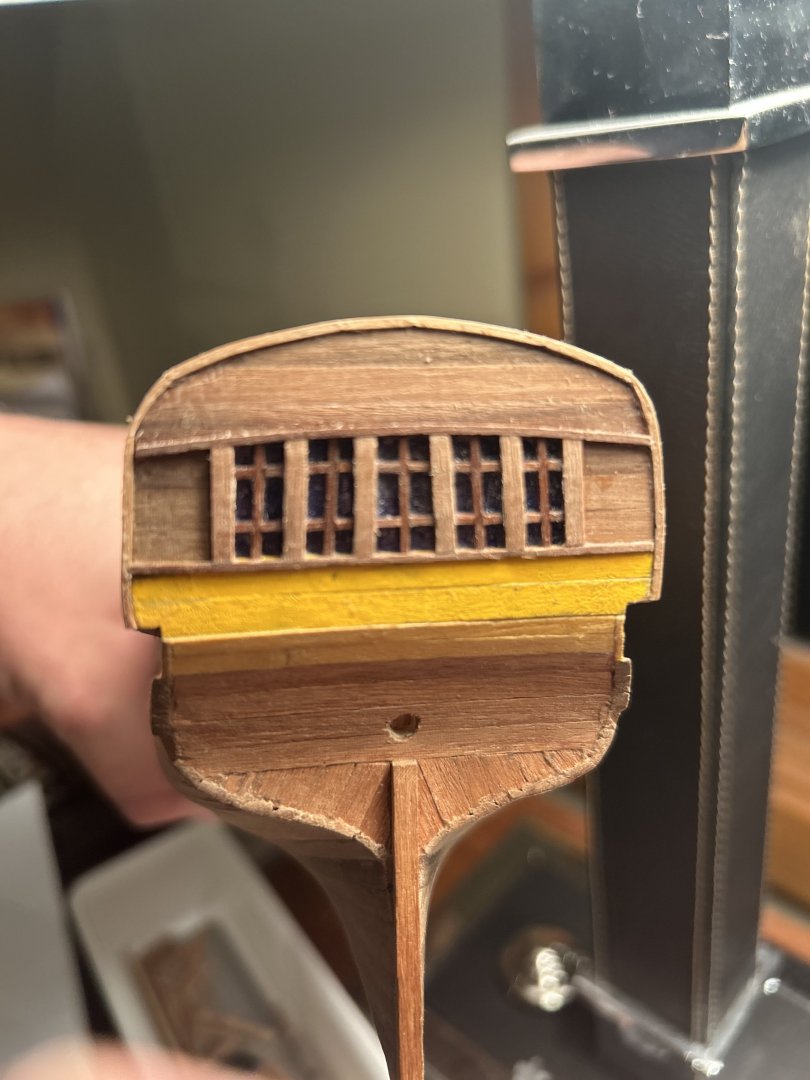

On the stern, one piece of yellow-dyed wood is too short. To make it fit, I cut and glued two other pieces so they looked like a single solid piece. The result is hardly noticeable.
There's another similar piece of woodworking on the bow where I did the same thing.

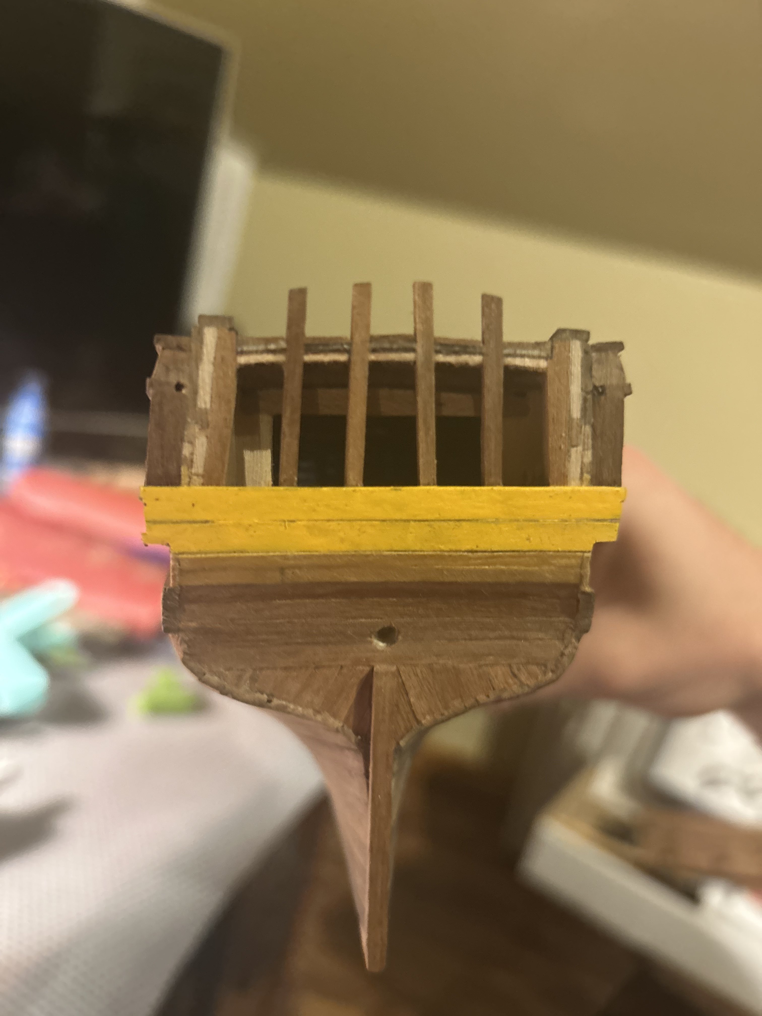

Tonight I put everything onto the transom planking except the last two planks. The only difficult part was the plank directly above the transom window. I had to cut a divot in the middle so the window could fit smoothly. It all has gone very well though, apart from some remedial sanding where surfaces haven't been perfectly flat or straight.
77631474425__0994417D-E16A-4C22-8D9F-C5551A954B2D.thumb.jpeg.34ead7d0406874bfe58e2db44f6b1936.jpeg
The last two planks will have to wait until I finish the transom window supports, as the pieces underneath them show where everything fits together.

After these steps, I put on the last two pieces of transom wood. Gluing them on was simple. I sanded them until they looked like a relatively smooth arch. IMG_1609.thumb.jpeg.d66c4717d12d7fc112c6ef1ca454ace1.jpeg
I'll bend a cap piece over them after I finish the last few details.

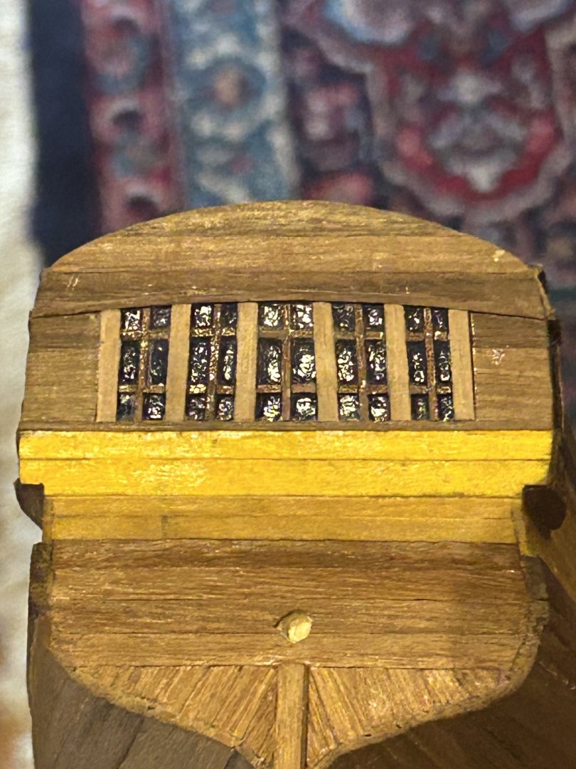

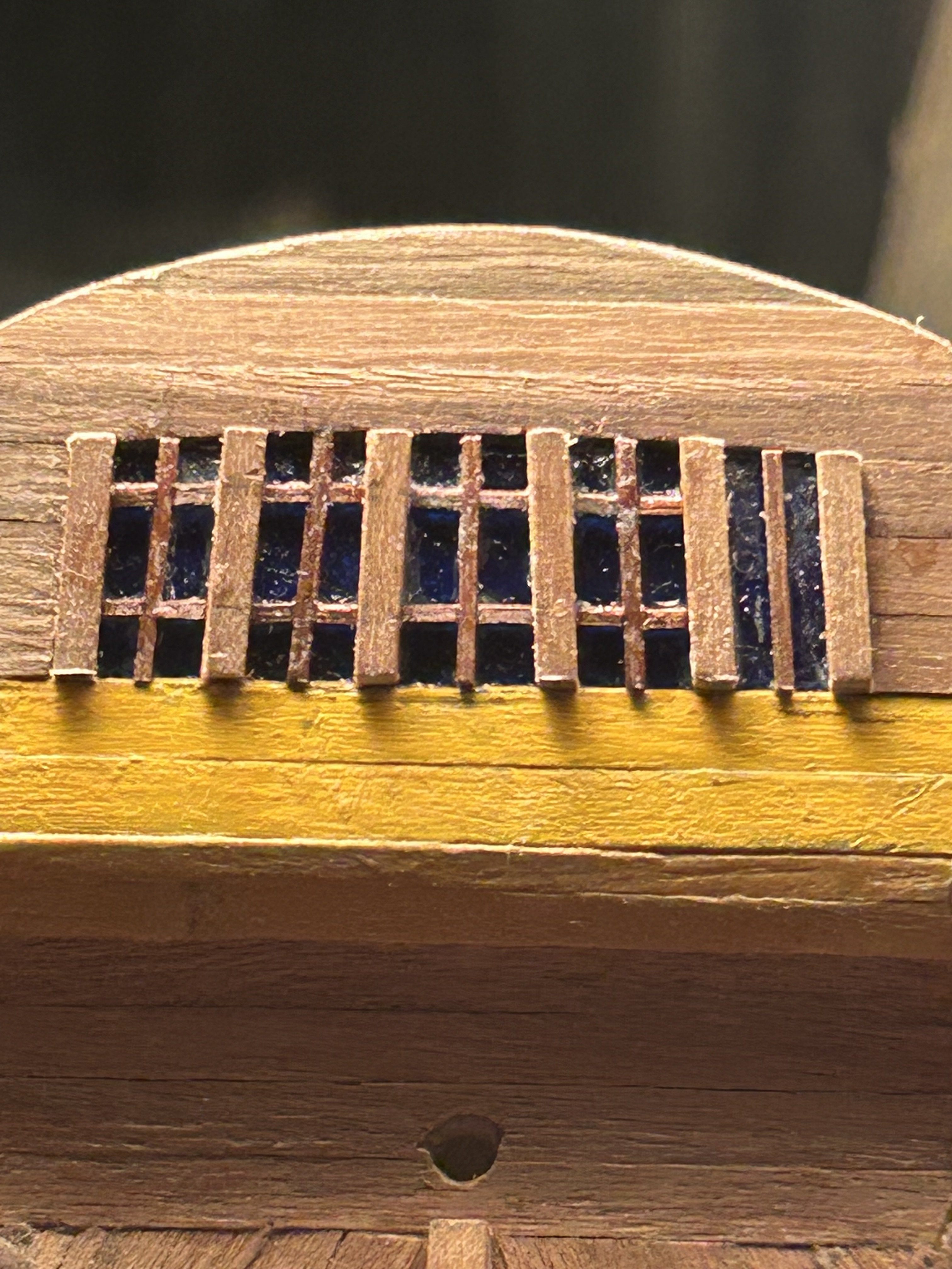

Cutting 20 miniscule window bars to shape has been stressful and somewhat tedious. But I think the results justify themselves.
The transom windows are now complete.
Given that the 3d printing is just too big, I've settled for a simple framing design reminescent of the HMS Surprise.
I'm not sure if I want to paint the window pillars or the wood pieces above or below the windows.

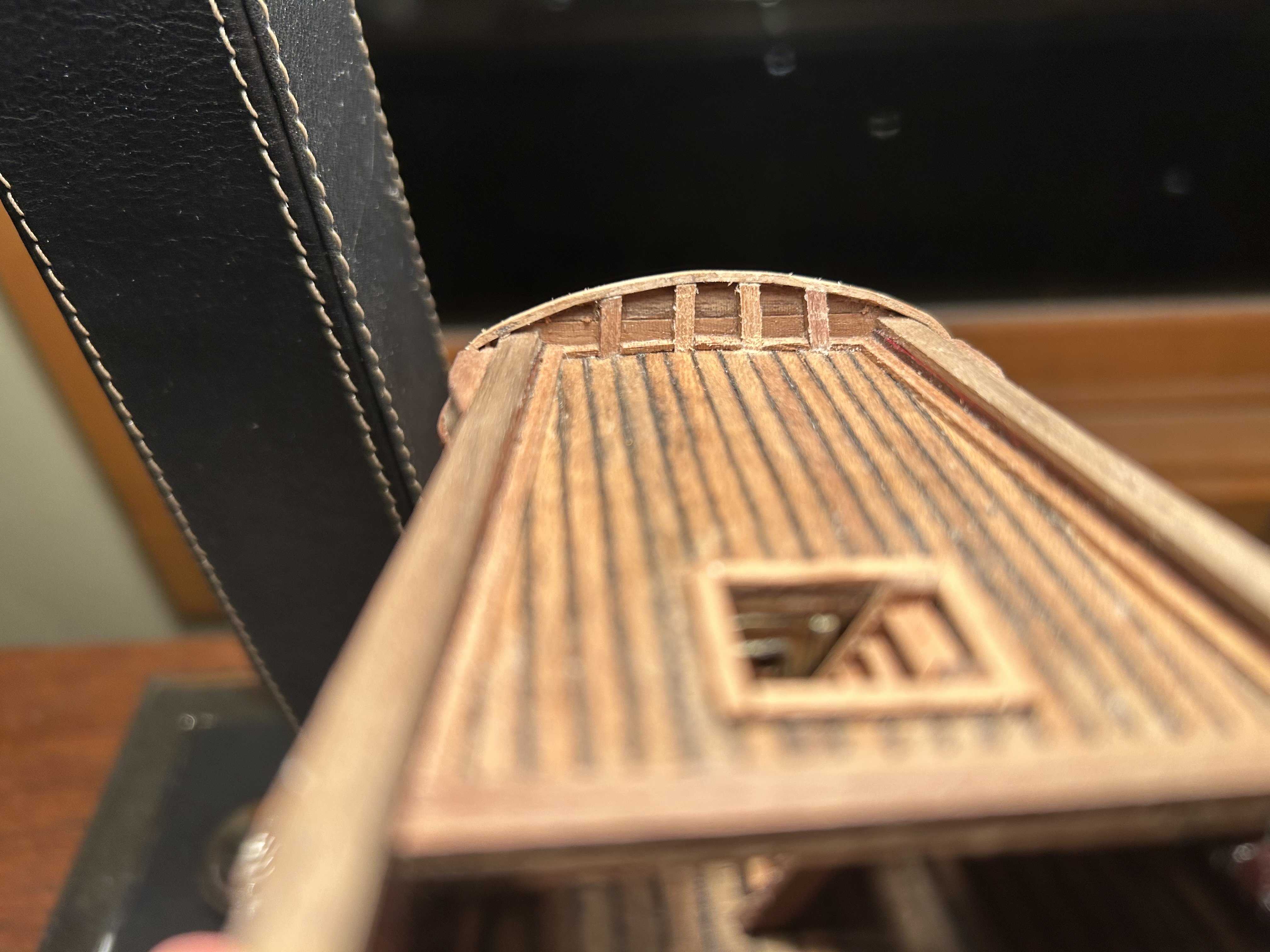

I used the trusty boil and bend technique to put the cap piece in place. 2 hours in a thermos of boiling water, 24 hours being bent to shape between nails, and then 15 minutes or so of pressure to glue to the hull.IMG_1695.thumb.jpeg.91a0bbb93e0ab875c4a4767a2c73b8cd.jpeg
Unfortunately, the 1x3mm cap piece was too short by a tiny bit, so I had to patch it over on the side. It's hardly noticeable though.
My final verdict is that it looks far better than the original metal kit part. Far more natural, and definitely a better fit.

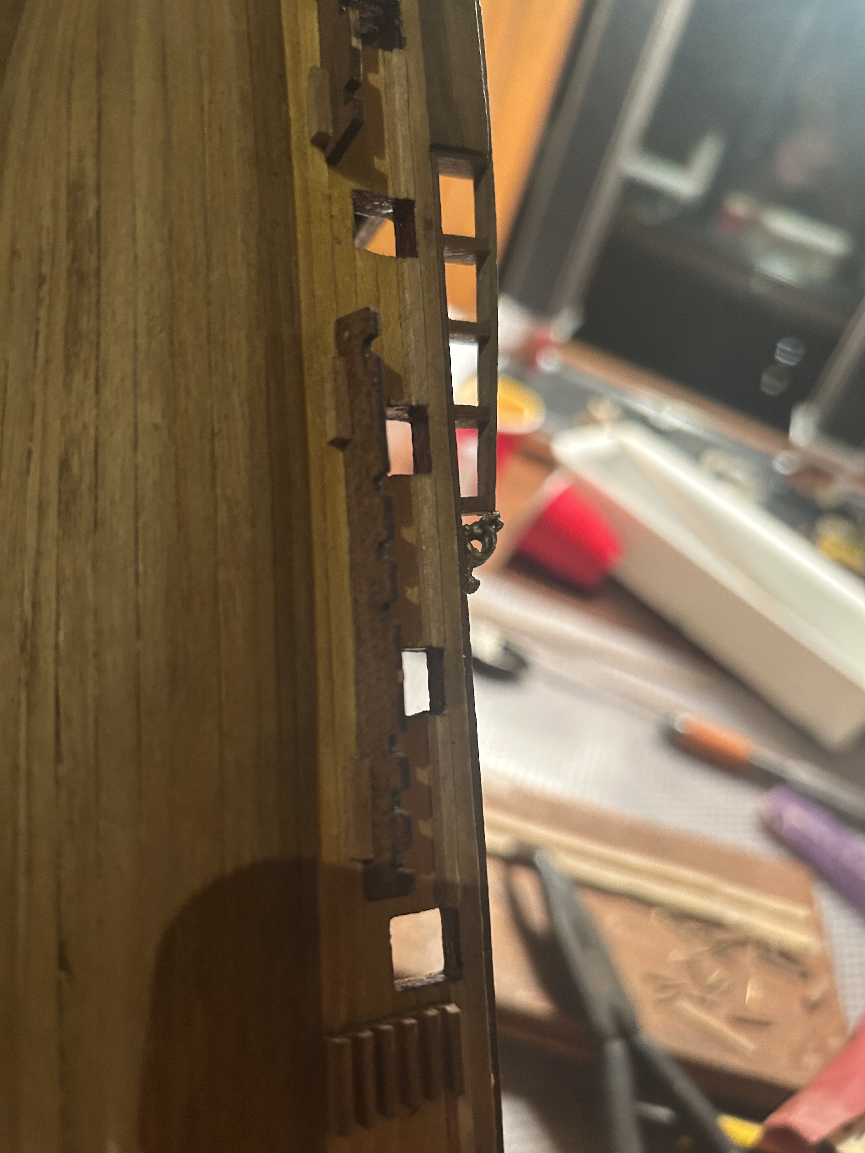

I just finished putting on the chain-wales. I supported them underneath with two small pieces of 2x2mm wood each.
It was difficult to sand them to fit the curve of the hull, but the end product works well enough.
I drilled holes in them where the pictures of the Greyhound show they need them. The instruction booklet should mention this part and advise builders to do it before putting them on the hull.

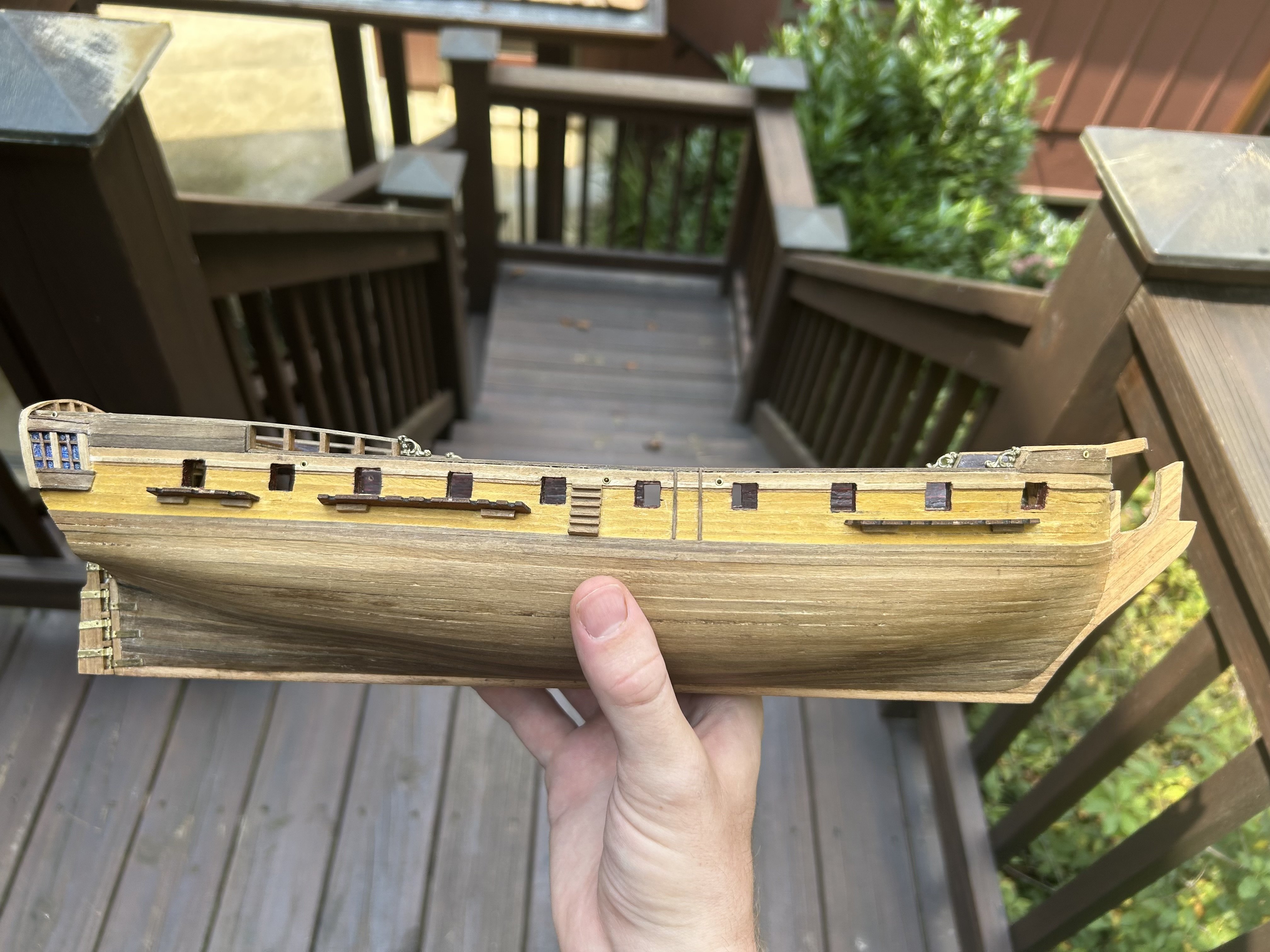

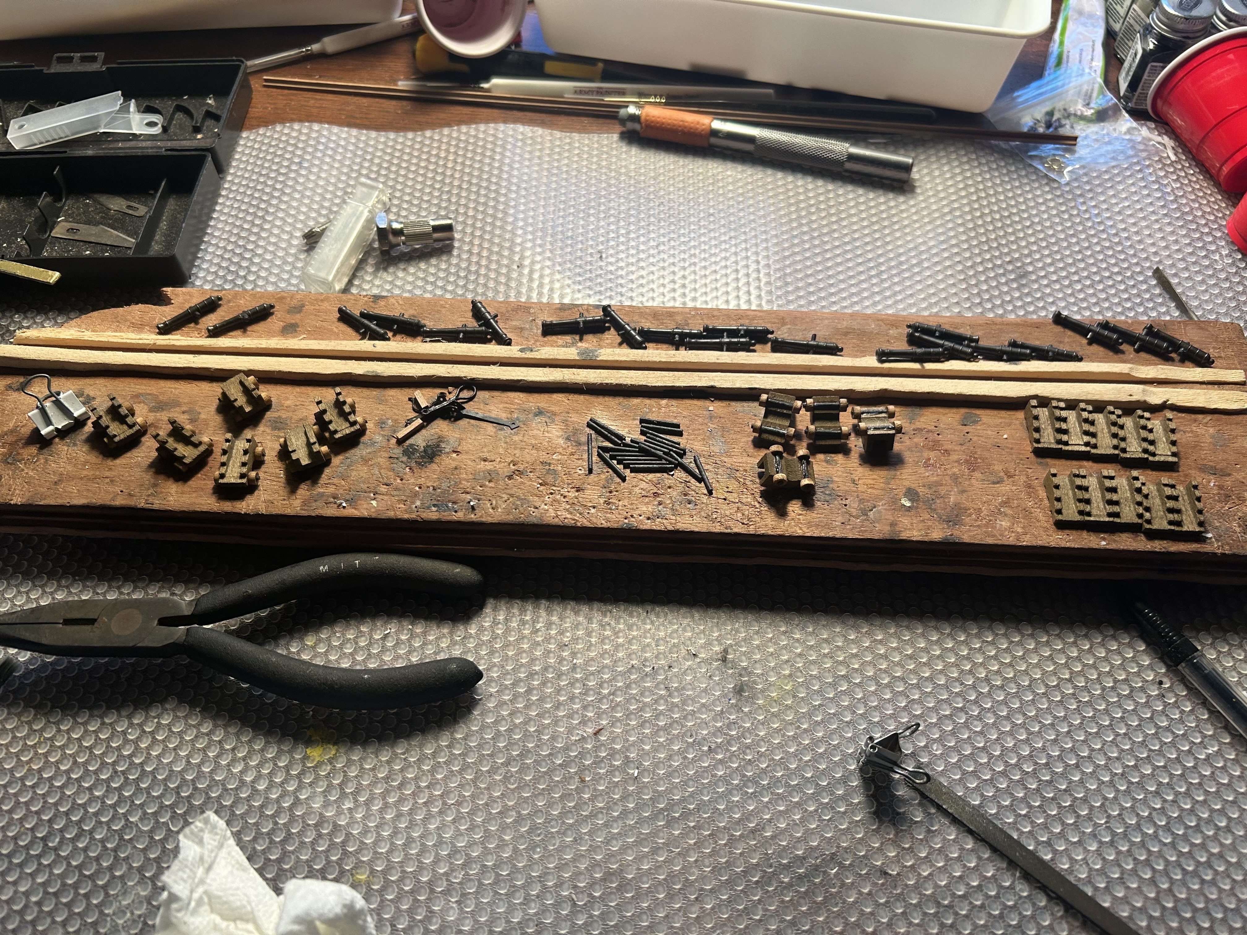

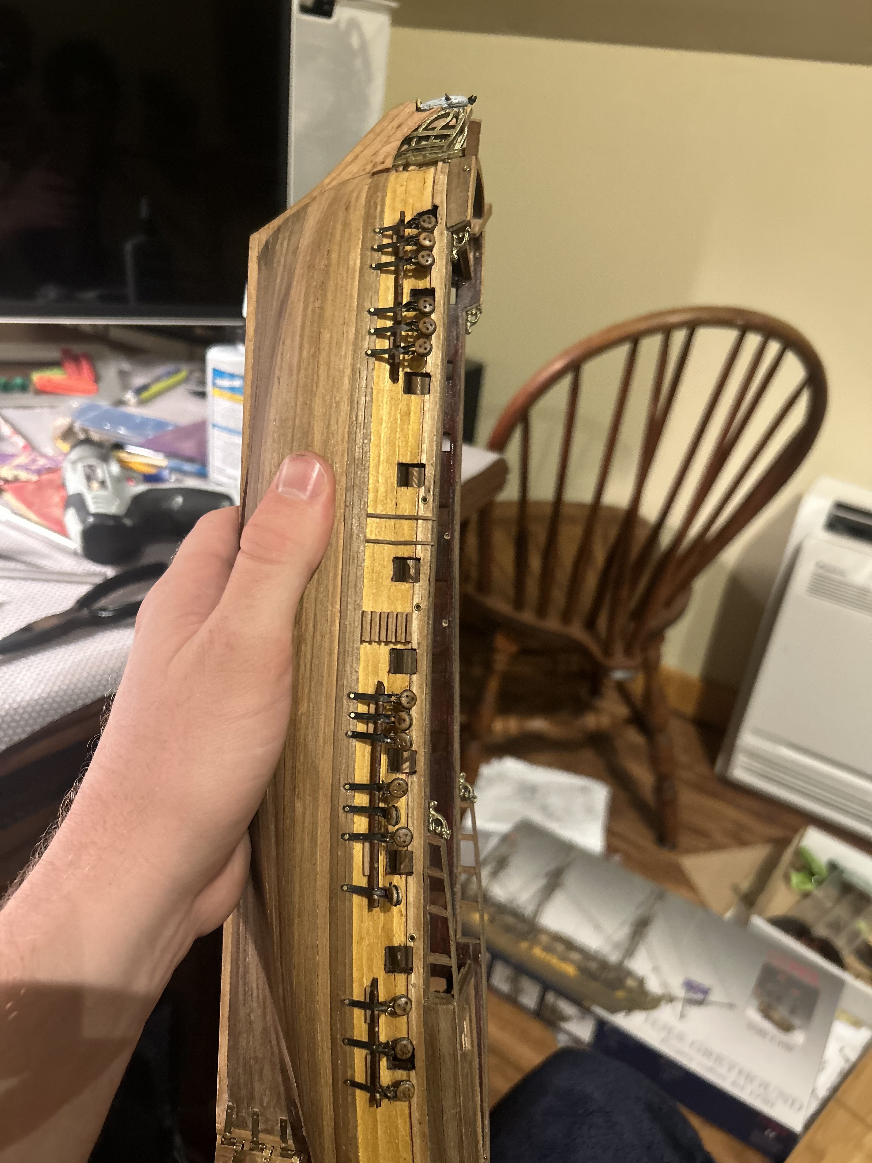

Hey y'all, I've returned at last. I didn't like the brightness of the brass on many of the ship's pieces, so I blackened them all with Birchwood Casey Brass Black. It generated a cleaner result than painting them.
The process was arduous. I cleaned them off with steel wool and denatured alcohol, soaked them briefly in brass black, let them dry, then coated them all with Birchwood Casey gun stock wax.
The resulting color is impressively solid, and it's not worth going back to fix the few small problems.
If someone else chooses to use this method, they should blacken the brass in small batches. I think that gives a better result.

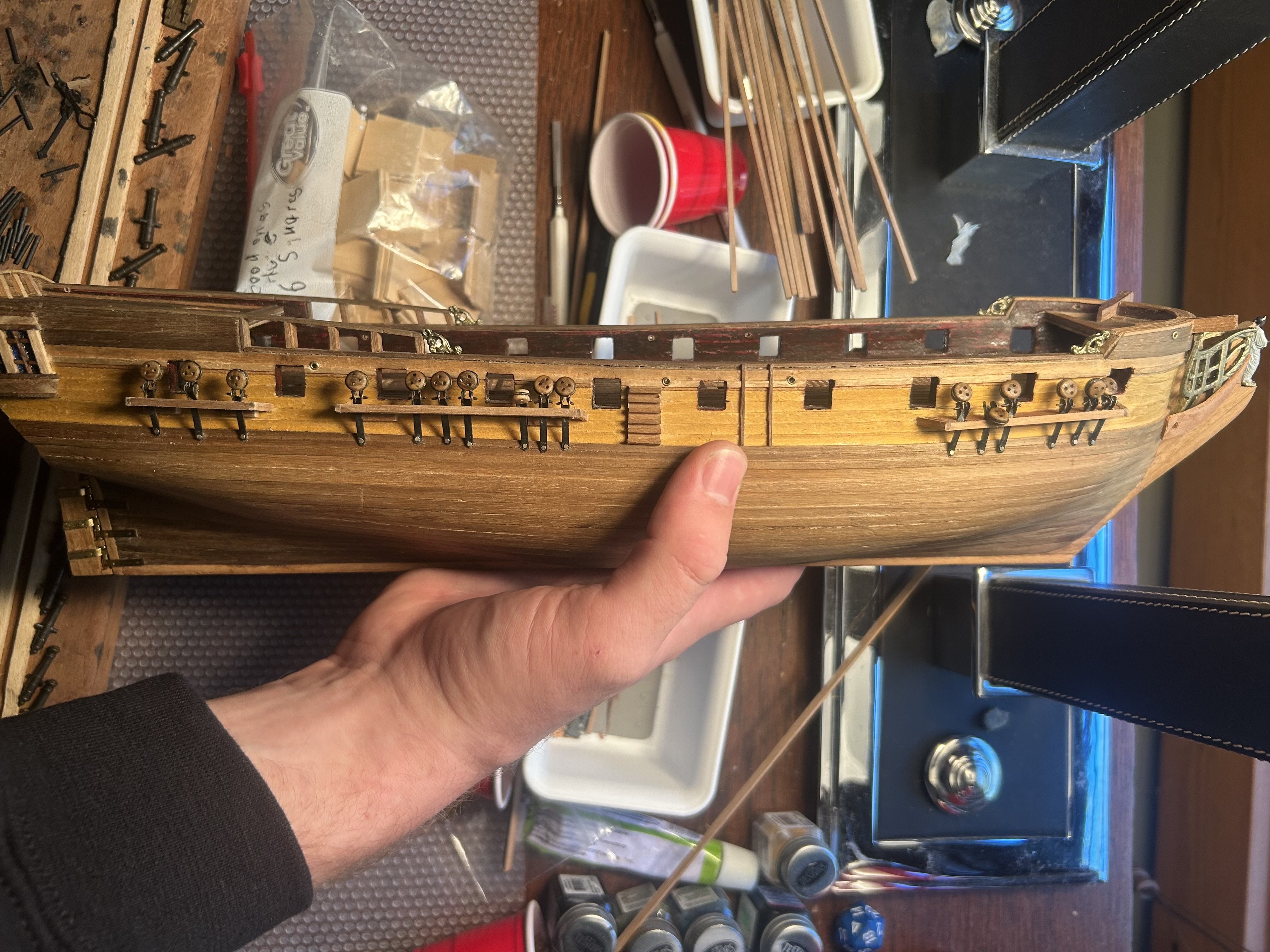

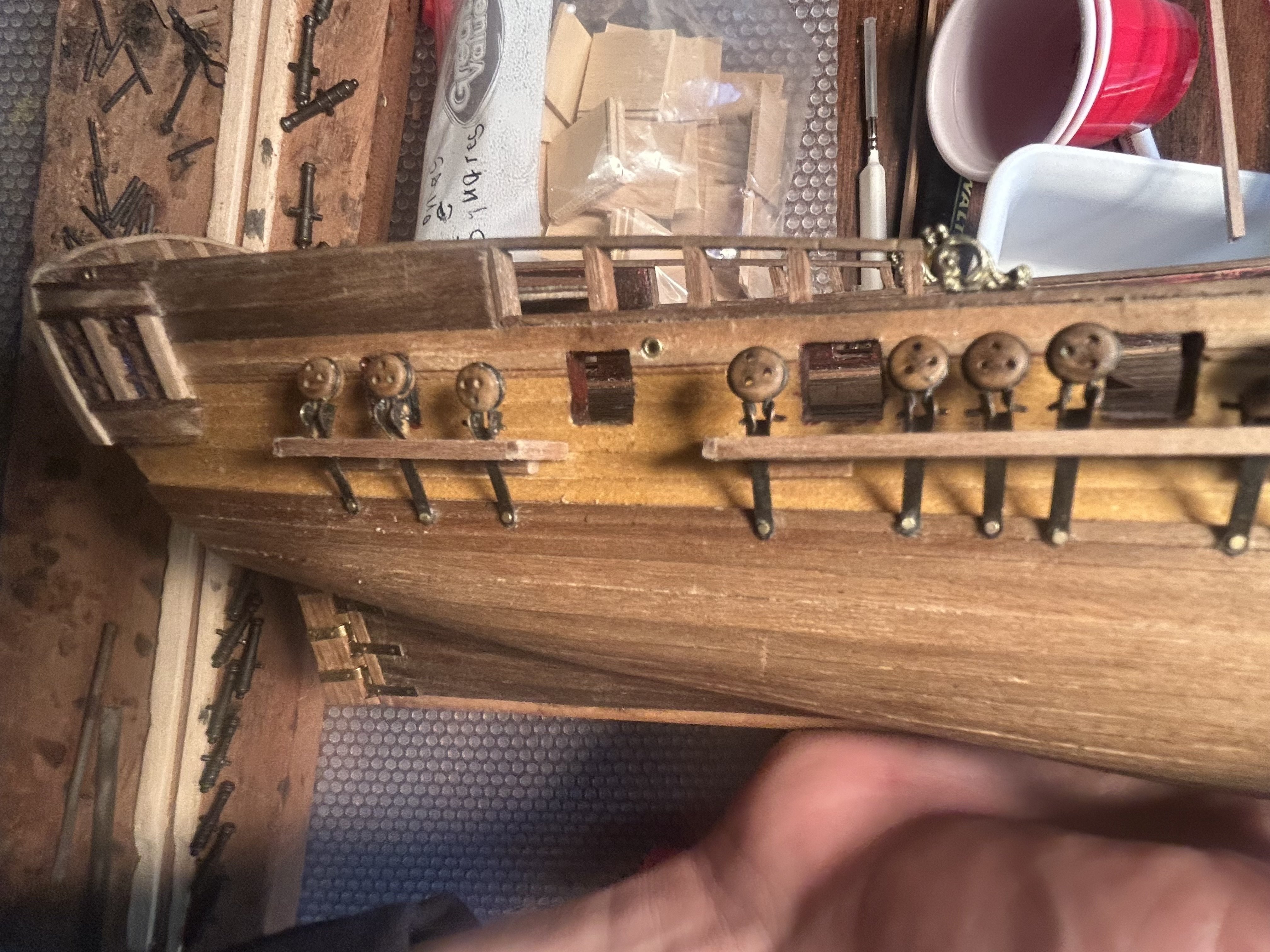

I've successfully attached the chainwales and deadeyes to the ship. After coating them in some protective metal wax, they look almost exactly as I hoped.
To avoid splitting the gunwale wood, I drilled tiny holes for the nails to enter.
Right now, I still need to put on the wood that holds them in place. I think they're going to be the last wood I need to glue onto the outside hull.

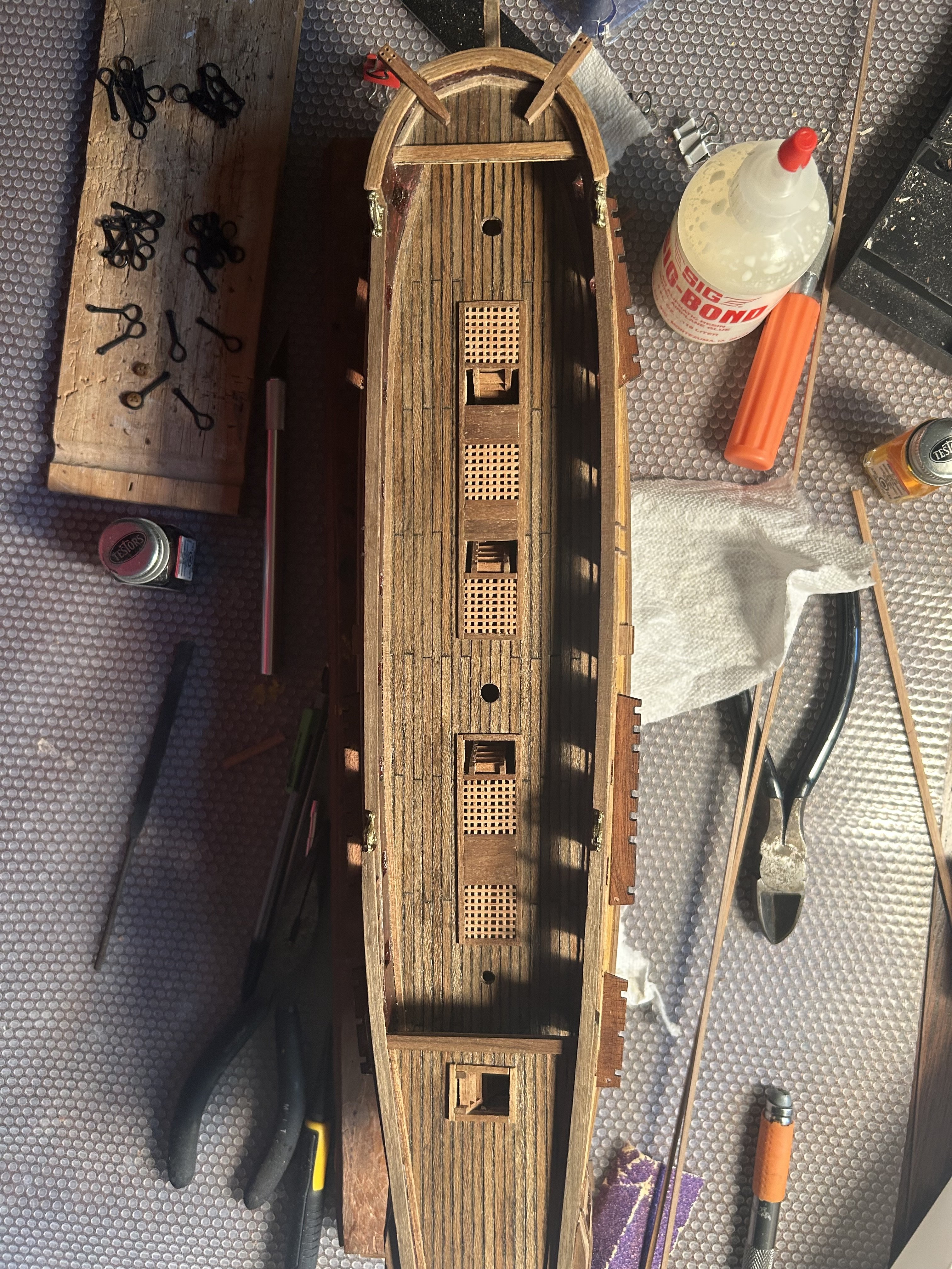

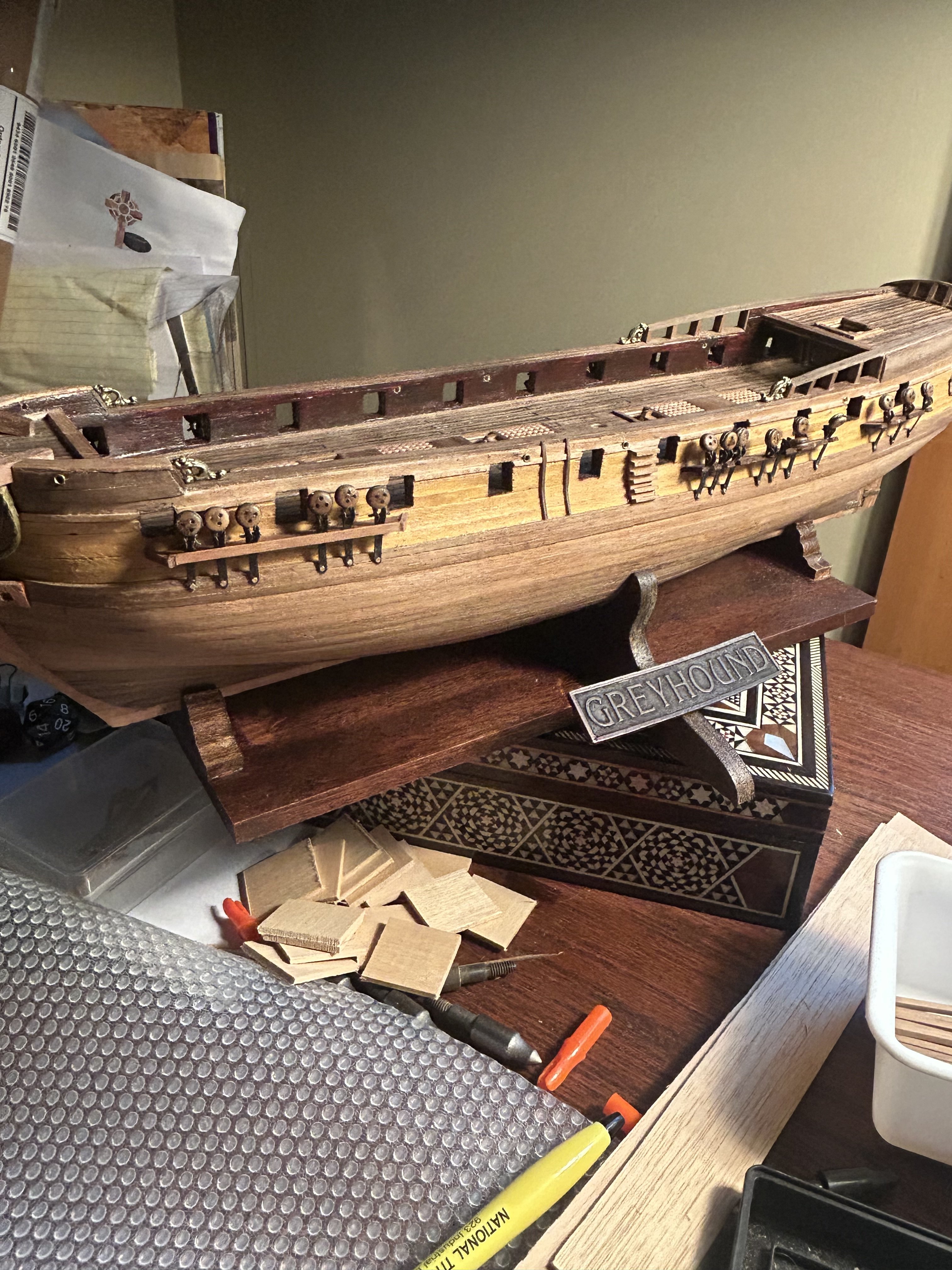

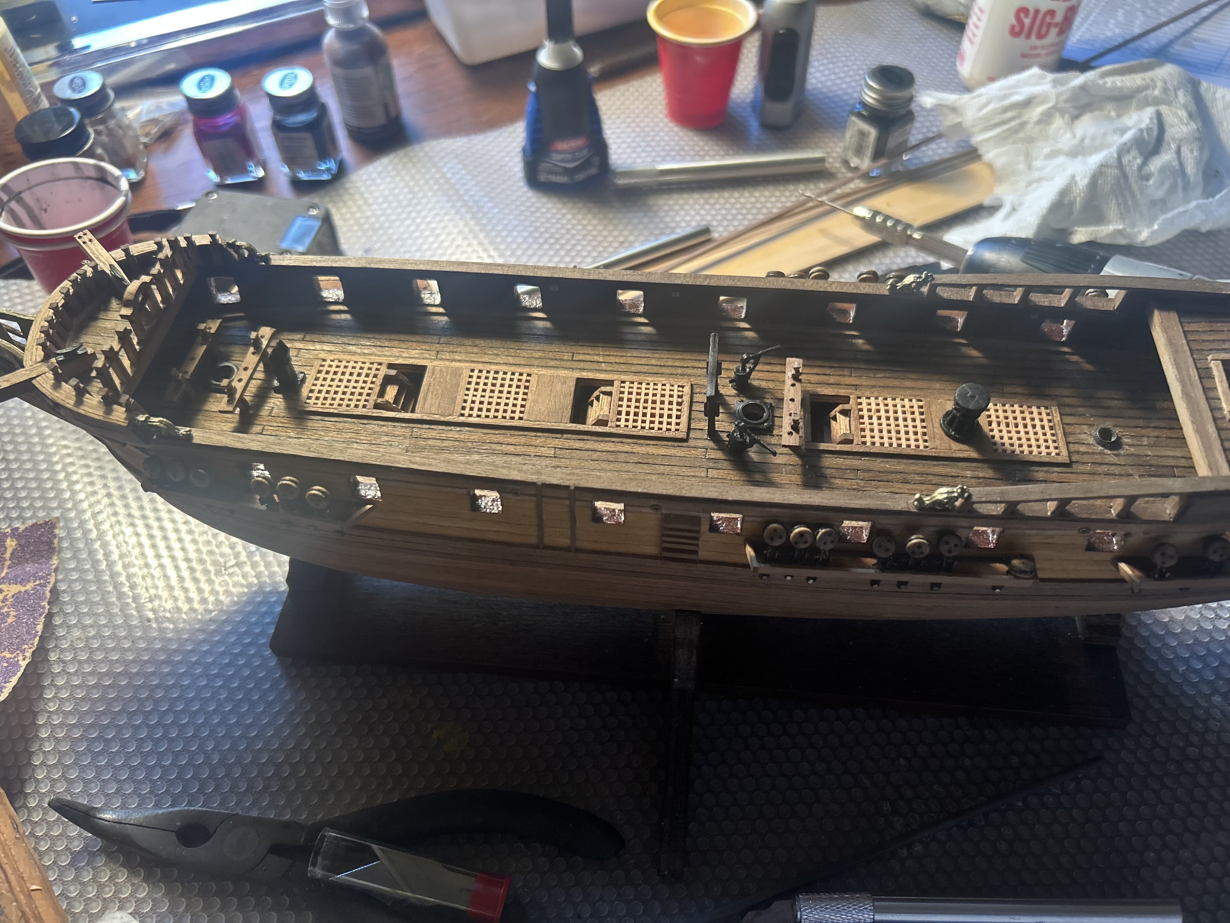

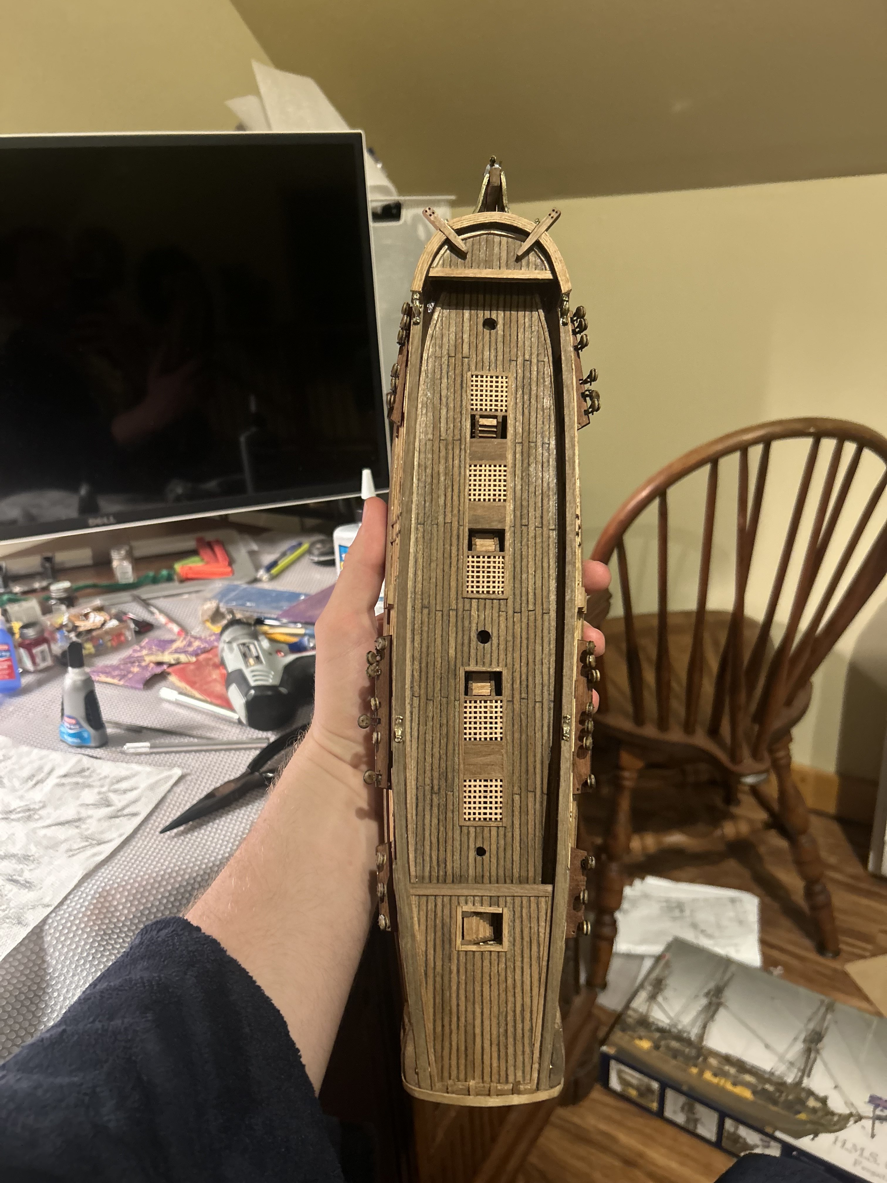

I've passed a milestone. Every piece of wood that remains to be glued onto the ship is either a deck furnishing or part of the masts.
I have realized that for the deck furnishings, I'm better off carving my own knight heads from 2mm by 2mm than using the kit's metal ones. It will be just as much trouble to cut metal to shape as to cut wood to shape.
Before I begin that arduous task, I'm gluing the gun carriages together. So far, they're looking great. Blackened brass was the way to go.IMG_2312.thumb.jpeg.fc5b9dcb38c188ae54db9666e4784853.jpeg
I settled on carving the knightheads myself. Now, 22 tiny carved knightheads later, I'm done with all the ones that attach to the rail. Of course, the metal front railing doesn't fit, so I'm carving that too. And I'm probably going to carve the 8 additional knightheads that go near the masts.
They're simple to do. All you need is a sharp X-Acto knife and a lot of persistence. I also put a thin veneer over the false deck at the bow and the stern. It looks much better.
Hopefully this phase will go much more quickly after I'm done with the ridiculous amounts of tiny carvings. At least I've preemptively assembled the gun carriages.
Also, if anyone can provide photos of where all the cleat hitches attach, I would be very grateful. I don't trust the kit drawings at this point.
When the metal bannister provided by the kit didn't fit, I built my own. It may be the best bit of carving I've done yet on this insane project.
It looks far more natural than the original.
Now, I just have the other railing and all the wood knighthead things in the center. We'll see just how they go.
Why work from a kit when you can take four times as long doing it yourself?
78430447427__94DB288B-423C-4906-83B1-7CE75E4E1231.thumb.jpeg.d872fbfc6878cda11f43f348aba11fed.jpeg

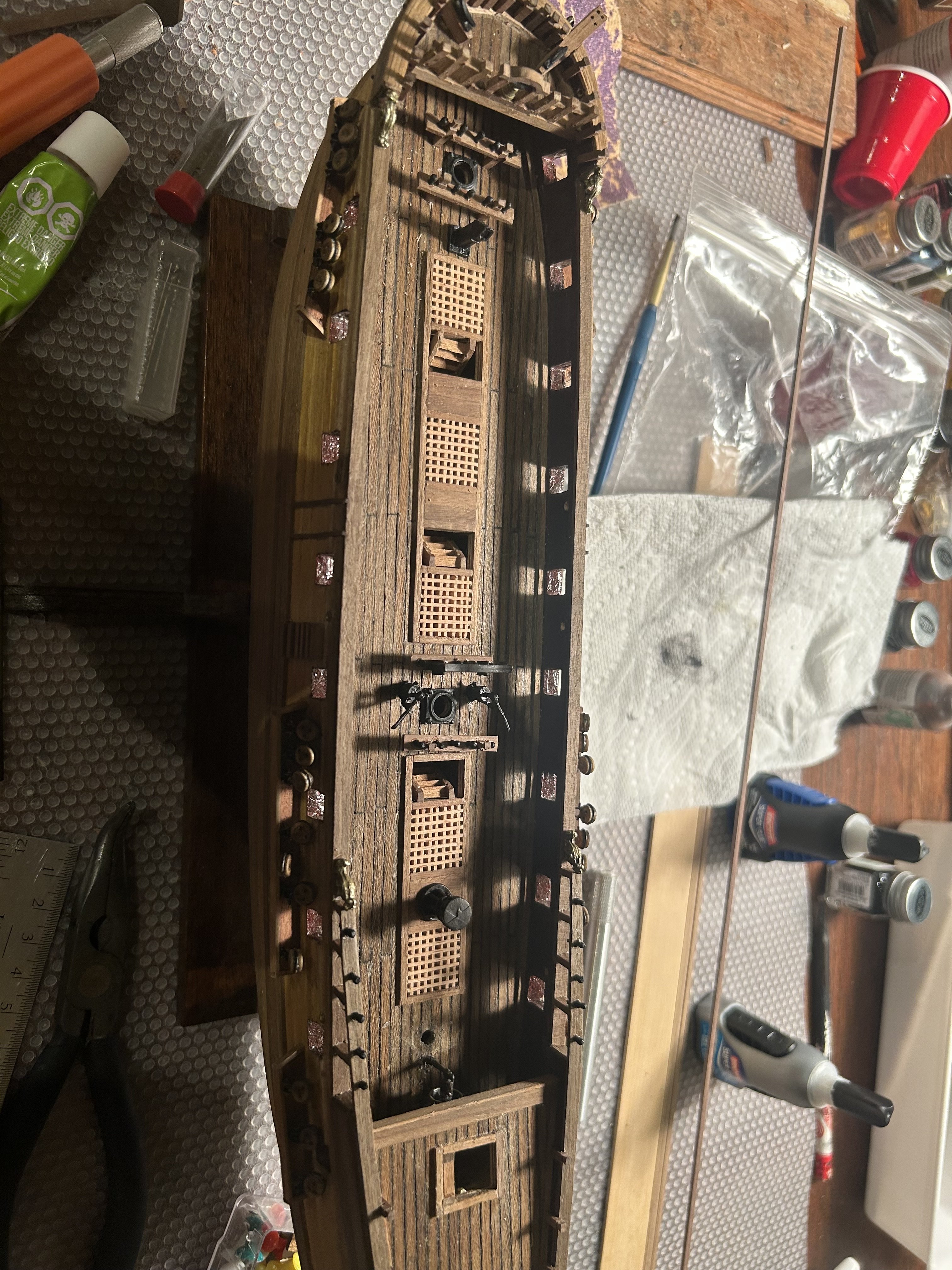

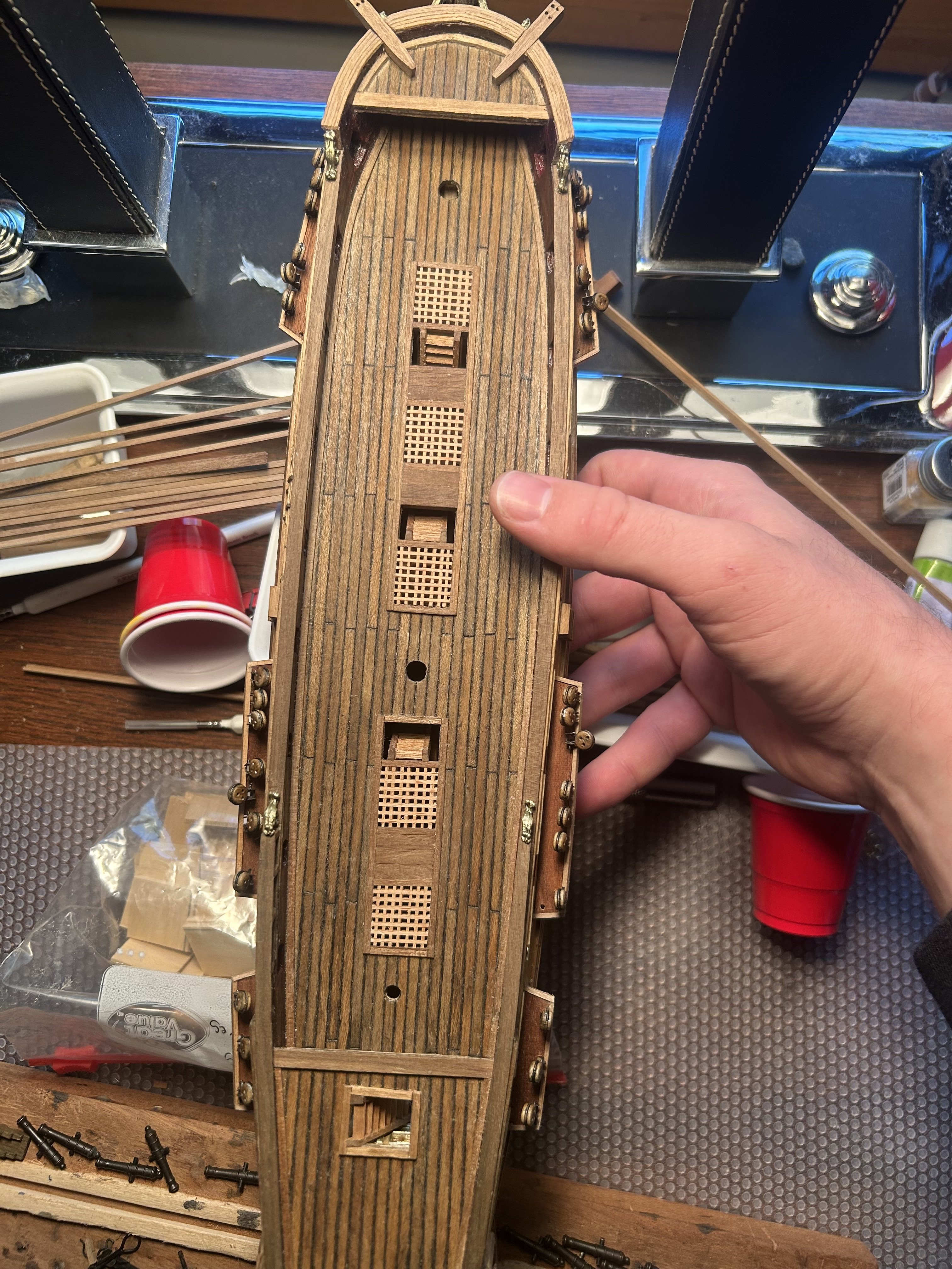

Slowly, carefully, I have carved wooden deck pieces for every parrt I've felt capable of carving. It's worked great. They look way better.
Putting into the deck was frightening. I drilled hoes in the deck where they attached, then carved the ends of the square pegs into circular shapes. They went into the holes fairly easily. It was much better than trying to carve square holes to put them into.
Now, I have just the back rail and the little railings for the stairs.

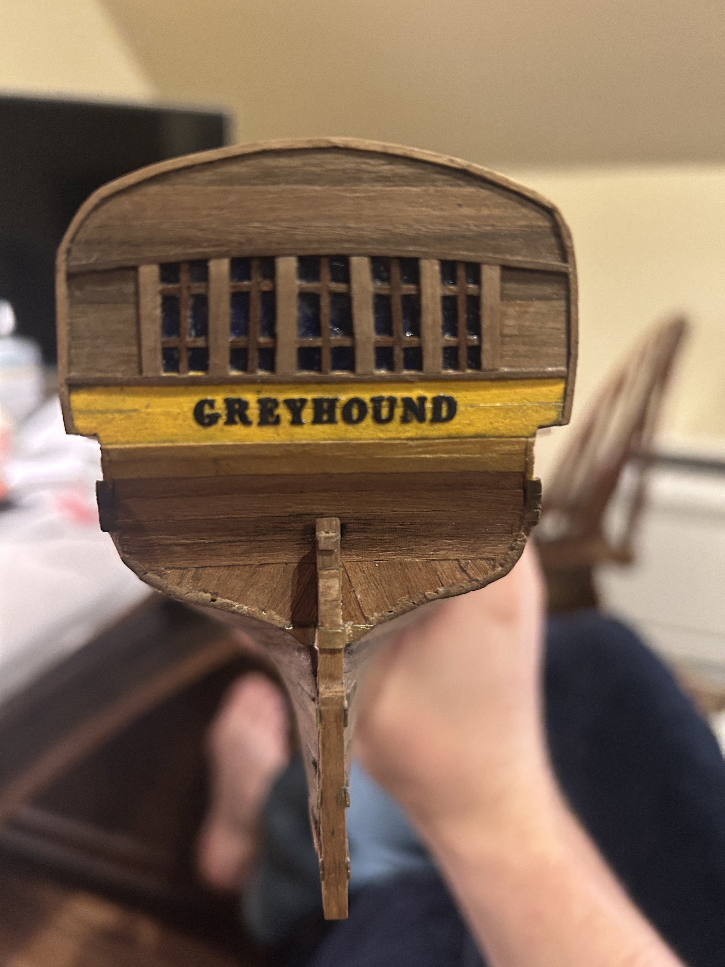

I bought some 3 mm high letters from Walmart to put the name on the stern. After some cleaning, sanding and painting, they were ready to place on.
They give the stern that last little spark of color it needs to work.

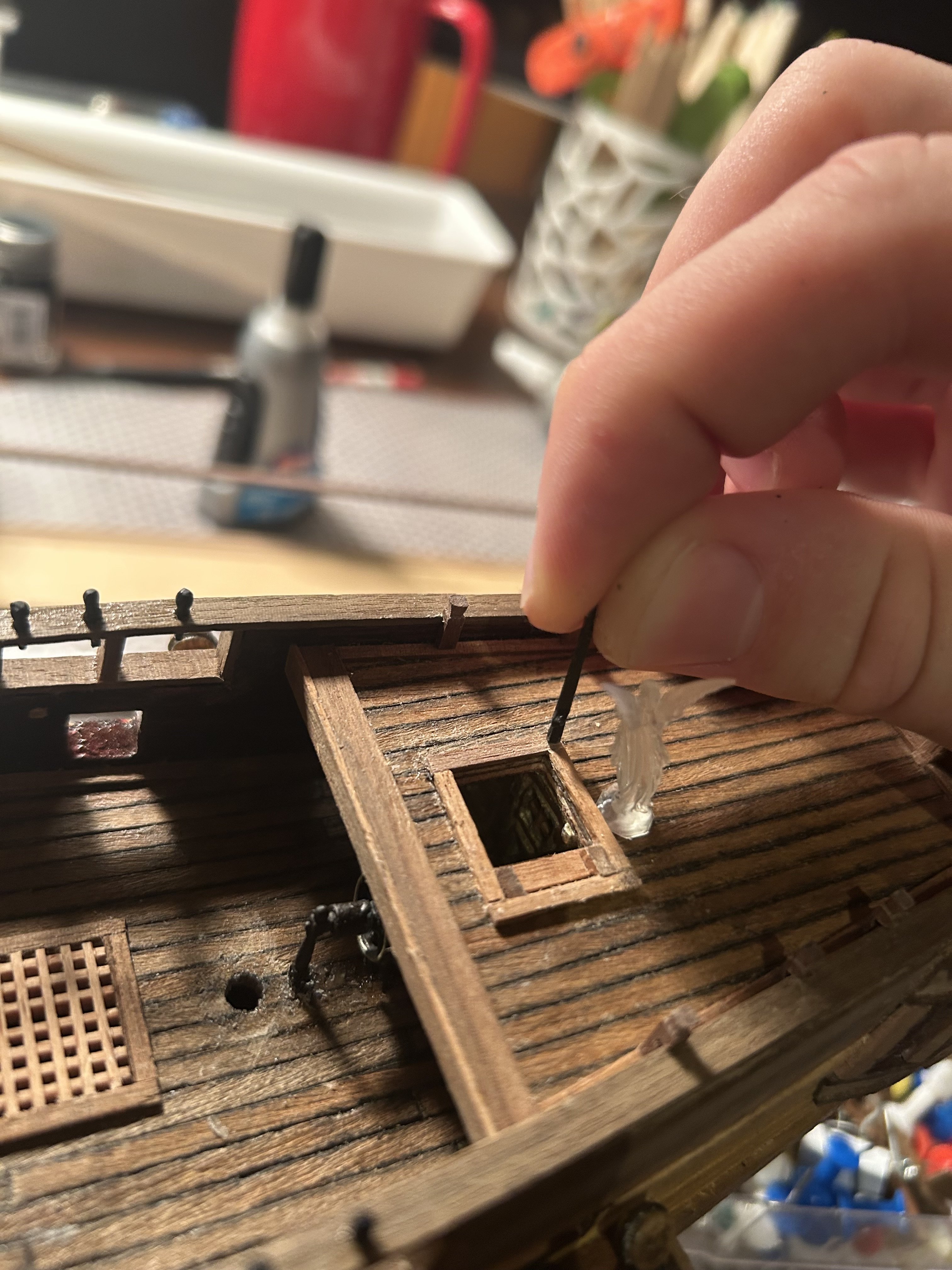

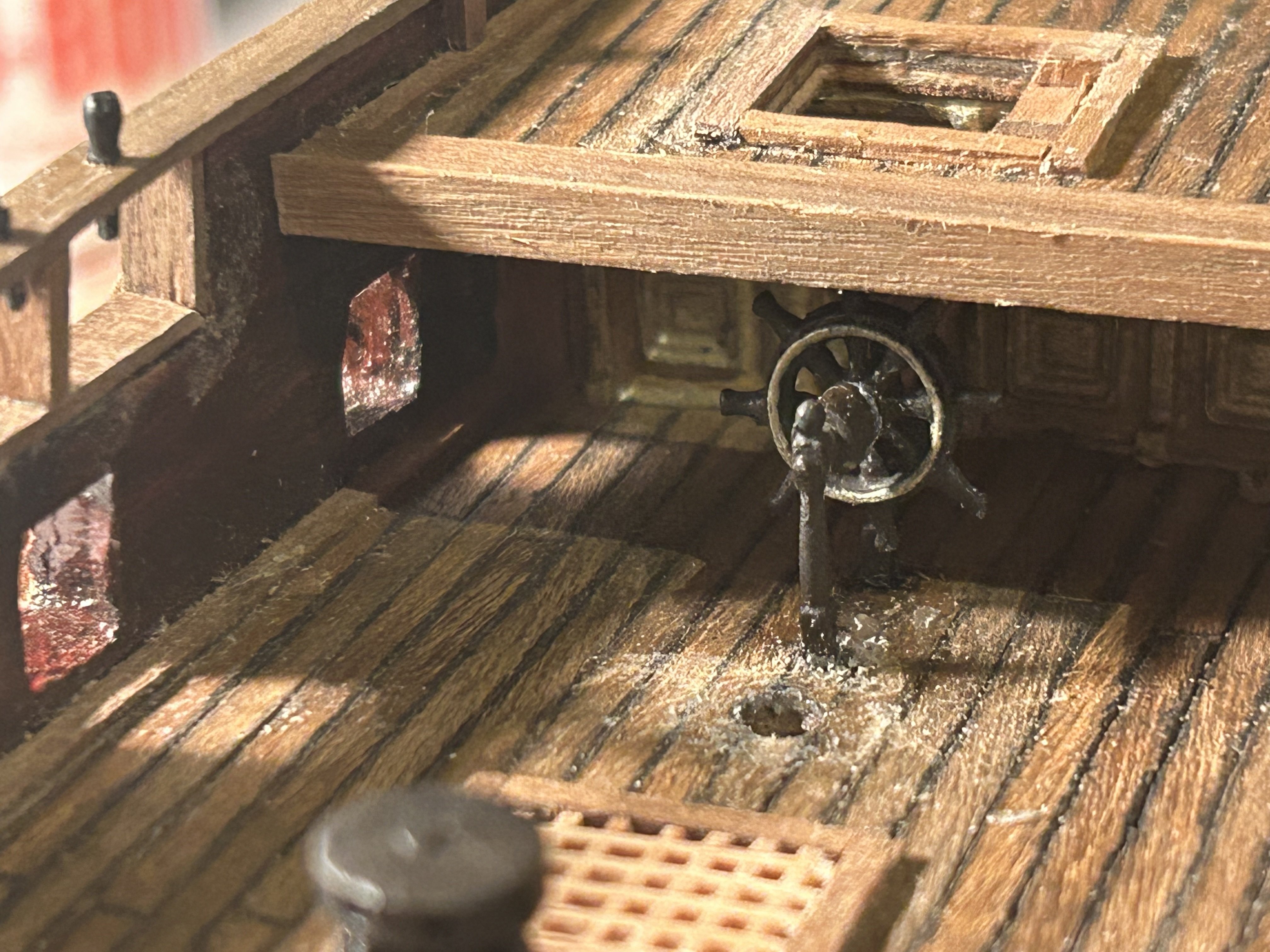

I ran into a bit of trouble.
The good news is I was able to put the wheel on and add in all the belaying pins. I accidentally broke off the mast base near the wheel, and it's such a bother than I plan to put it onwhile it's around the mast.
I'd recommend doing this step (or at least drilling the holes for it) before putting the quarter deck on. I had to use a thumb tack to press holes in the hull where a drill couldn't reach.
The bad news is that I kinda damaged my work on the top deck trying to put in railings. And then I discovered that there's no way they are comfortably at 1/100 scale. I've calculated that they would be nearly 5 feet high. Rope railings at neck level are uncomfortable at best. At worst, they're a way to combine strangulation with falling down the stairs.
Given that I doubt my ability to drill holes to contain them and that they are too big, I'm just going to eschew railings. Safety regulations were probably not high on the priority list in 1720 anyway.
