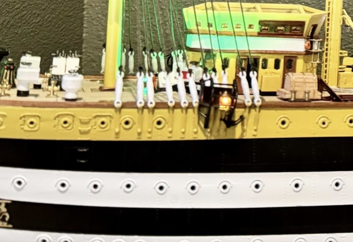

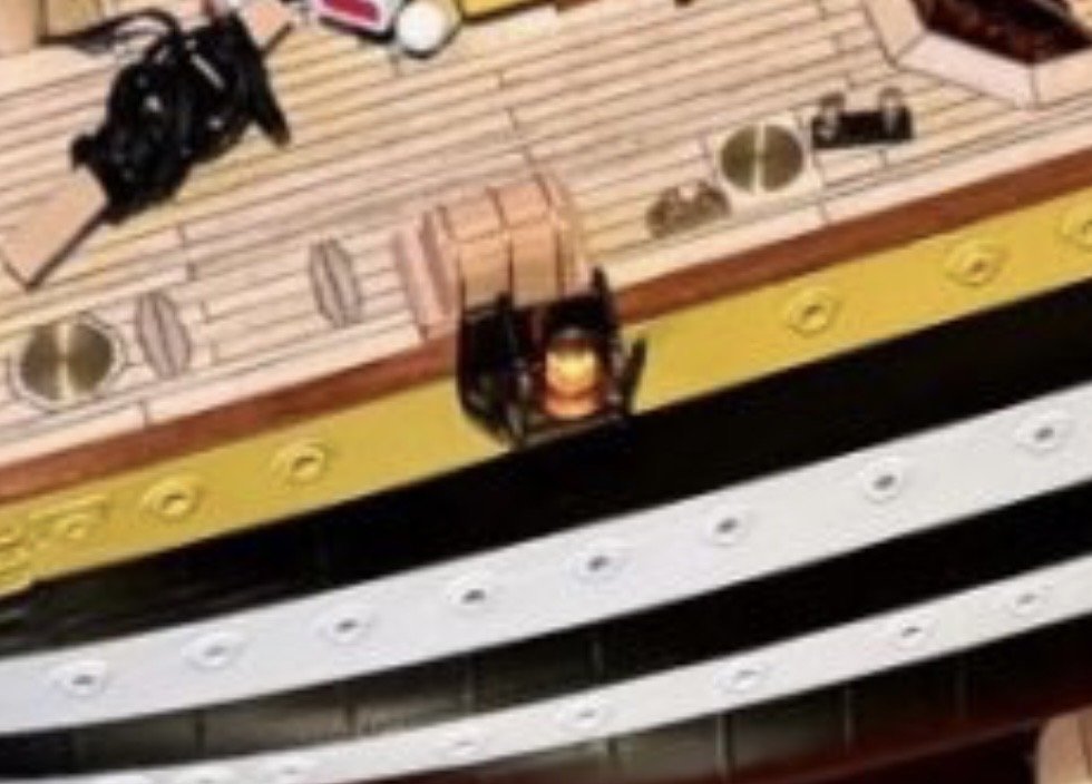

Daniel another logistical question on your build. I am crafting the holders/brackets for the side red and green navigation lights. I have a shape/design that I am pleased with. Very similar to your’s which is no doubt since I used photos of your’s to design mine. I am very curious about your installation. In the first photo you show them mounted in the side of the ship. In the second picture the brackets from the lower shrouds pass behind the navigation light fixture. Would you care to share what you did here?
Hi Bill, if I did it again I would do it differently. I soldered about 1” of flat 3mm bar in two places on the back side of the bracket, and then cut two slots into the side of the hull. This more or less made the entire device removable, so I could work behind it, then reinstall. Worked great, except cutting the flat slots into the hull was difficult. Instead, I’d I were you, I would use brass rod, maybe 1mm diameter, and affix to the back of the bracket. Then all you have to do is drill matching holes into the hull and slide in place. Still removable, but much easier construction.
Great idea Daniel. I believe that is the route I will take. Then also change the protective cage to stop at the bottom of the bracket instead of going on down to connect to the supports which would no longer be there?
