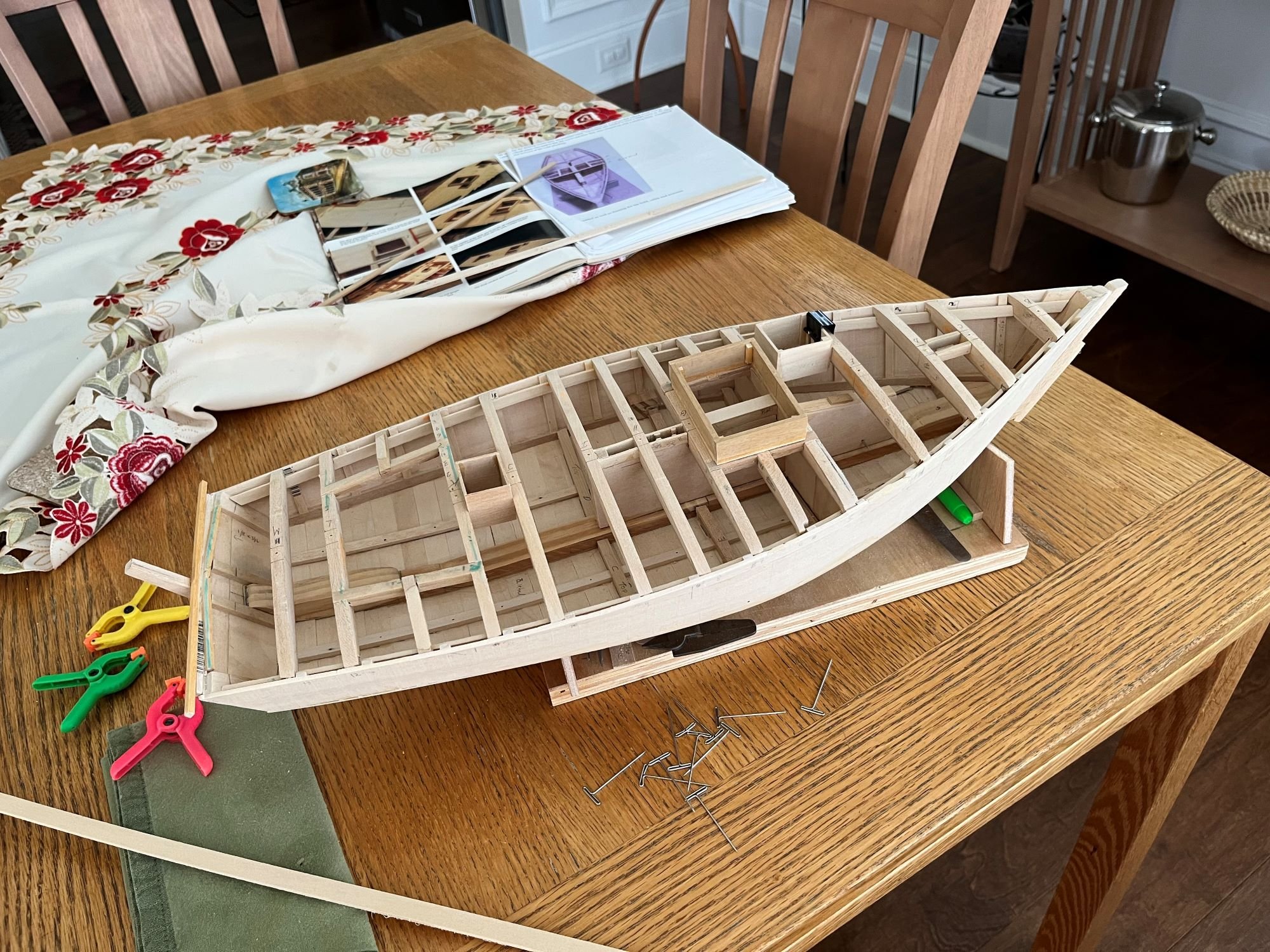

In my last post, I was installing the side planks and frames.  Once these were installed, I began installing the bottom planks, 33 on each side f the keelson.  No major issues, just tedious.  This is where I am at this point.  The left picture is looking from the bottom of the boat, showing the untrimmed starboard and trimmed, but not completely sanded port side.  Also, the chunks at the bow are not yet shaped.  The right picture is looking down at the bottom of the boat from the inside.  After rough trimming, I will move onto the stem, forward worm shoe, stern post, center-board battens, keel and rudder assemblies.   I probably missed something in my list.   Hopefully I will catch everything in their proper order.

Thanks for the pictures.  You are much further along on the skipjack than me.  Since the earlier pictures, I cut a slot in the keel for an operating center board.
There were some other pictures, which I mistakenly deleted, taken in January 2024.  In the meantime, boards were cut  and faired to the bottom of the hull, deck beams were installed with a reasonable camber, beams all faired for eventual deck planks and hatch coamings built but not permanently installed.   Beginning to install the deck planks, hopefully completed in a more timely manner than this post.    As we are all aware, we need a lot of patience and some ability to deal with frustration.  So, we measure 10 times, check after each measurement, remeasure and eventually cut and install.  Not a hobby where one can expect fast results.  My excuse is it takes forever for glue to dry!  Be well!
