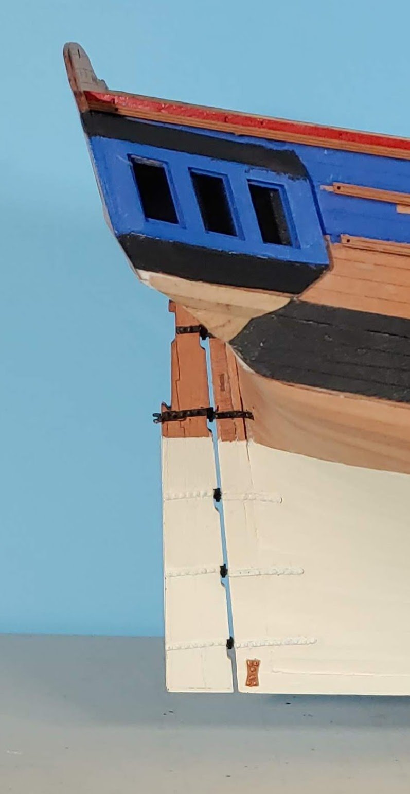

Quarter gallery filled then painted:

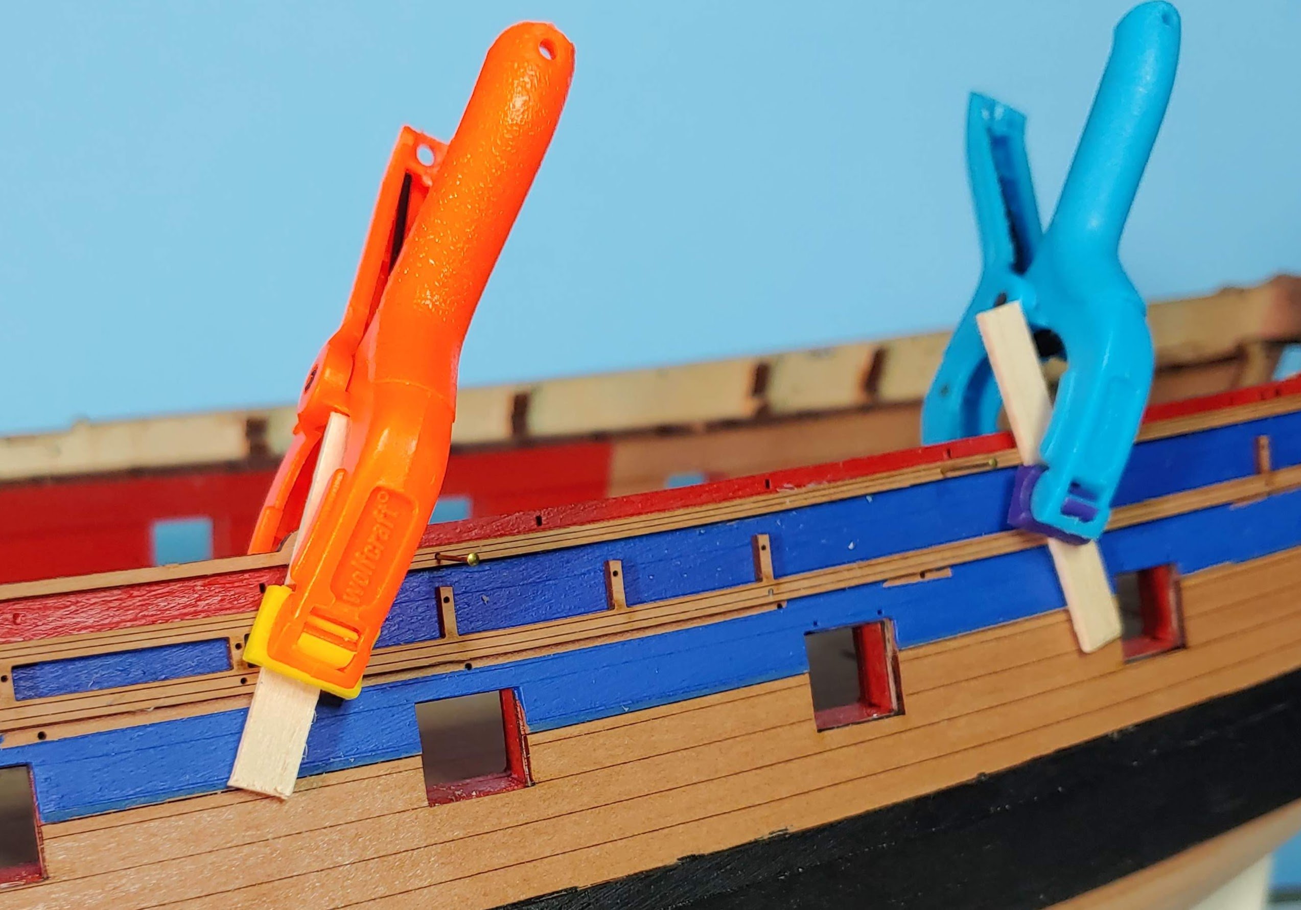

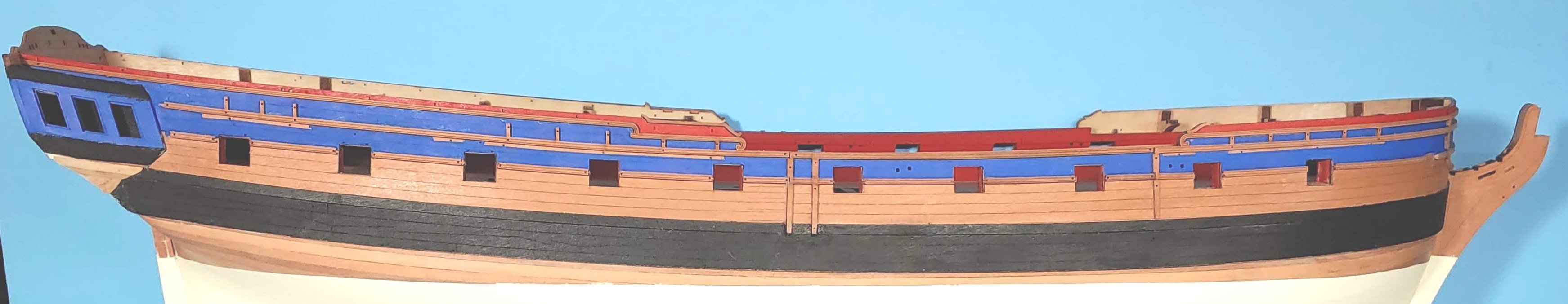

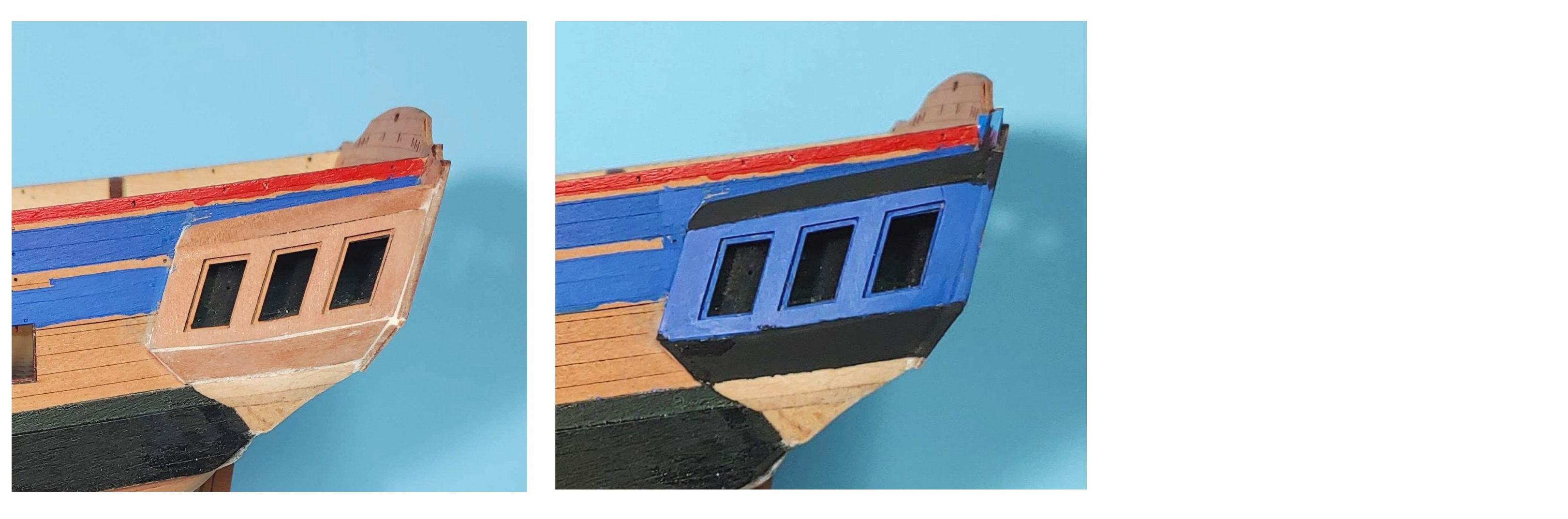

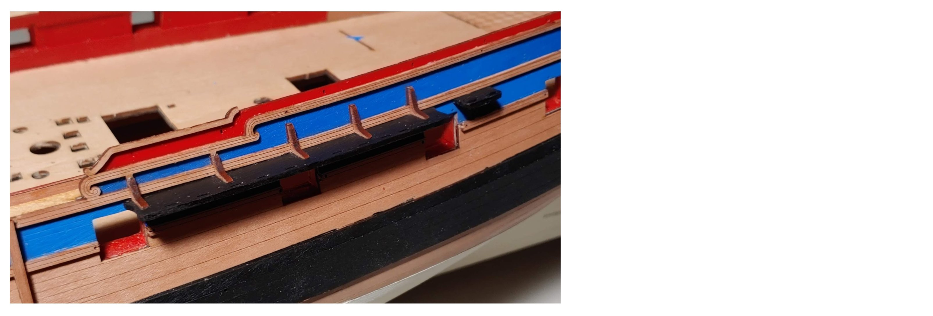

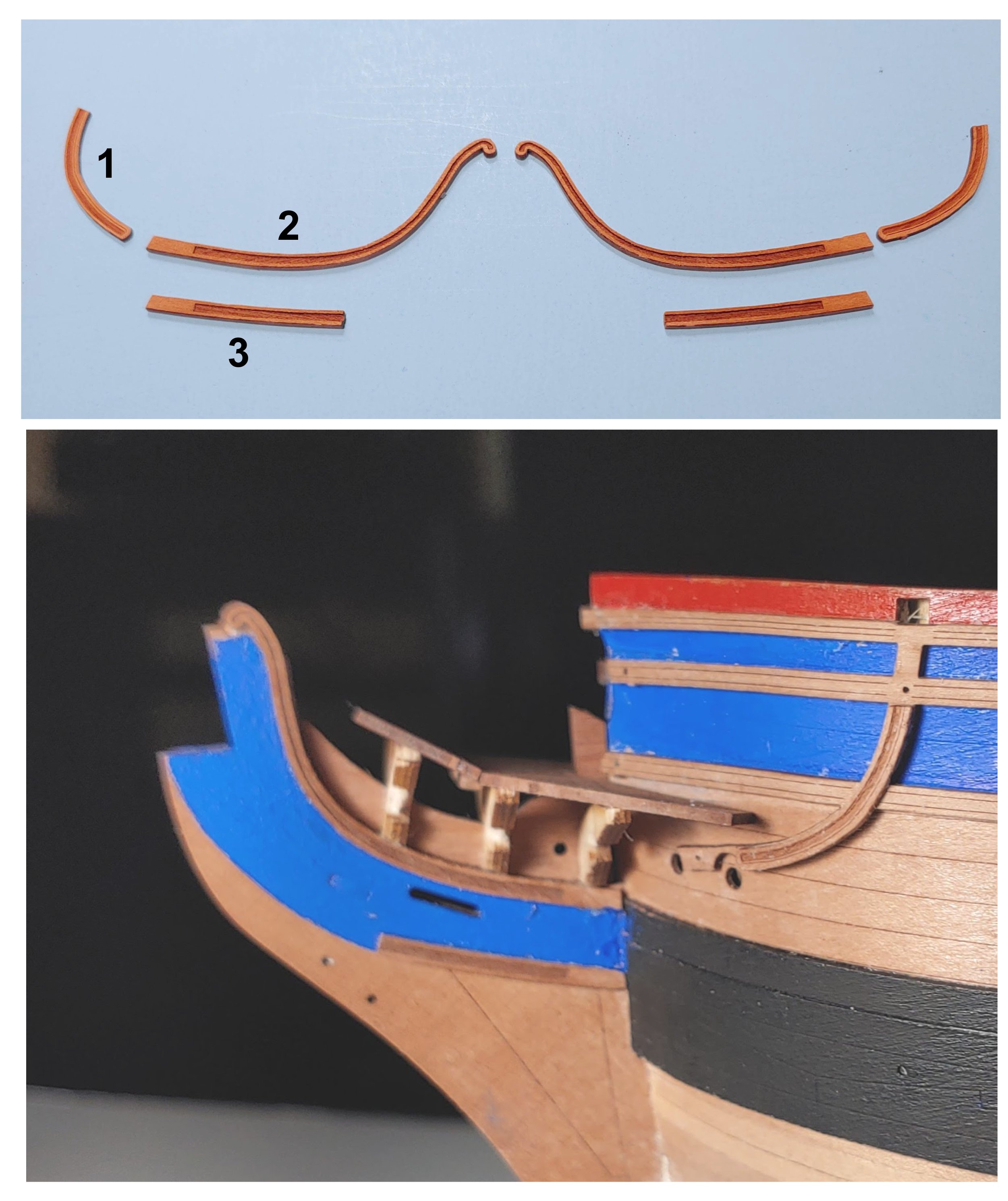

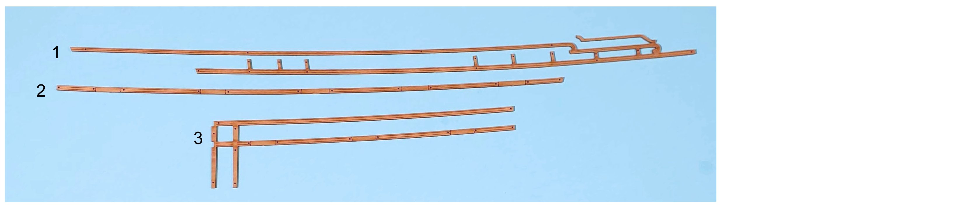

Rail patterns:
1. Sheer rail pattern
2. Waist rail pattern
3. Sheer and waist rail pattern
The pin holes provided in the rails and in the hull were critical in being able to place the rails in place quickly and accurately before the glue set.
Rail patterns installed:

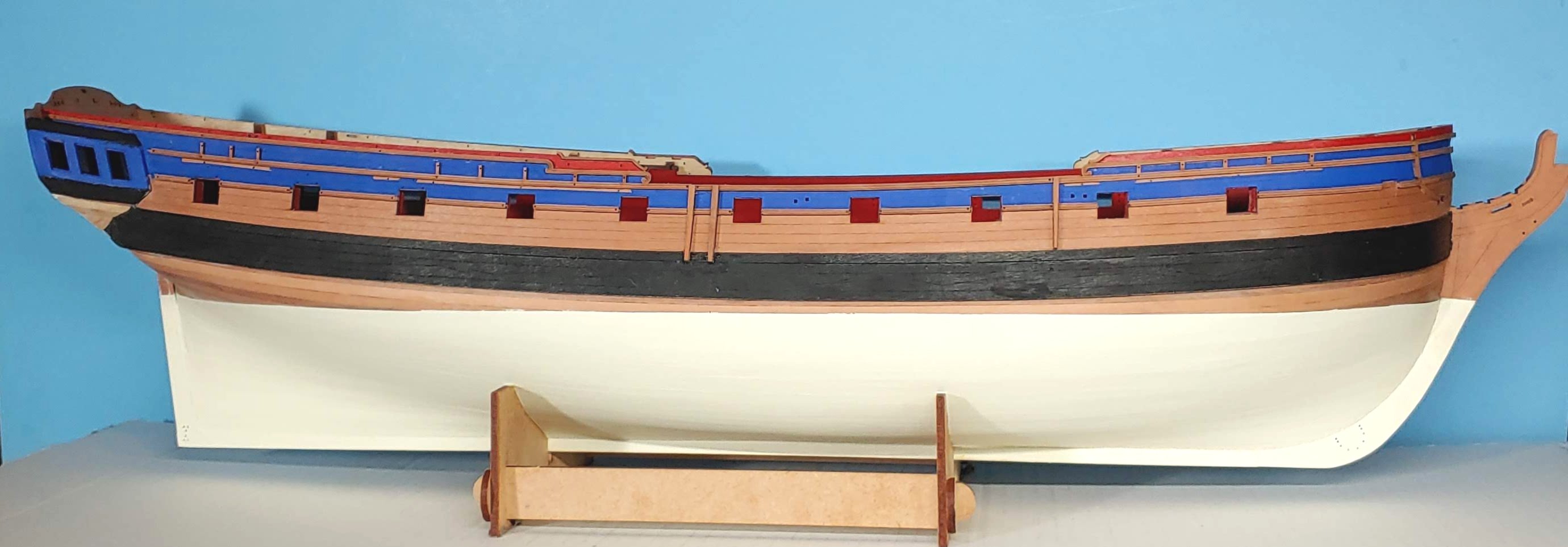

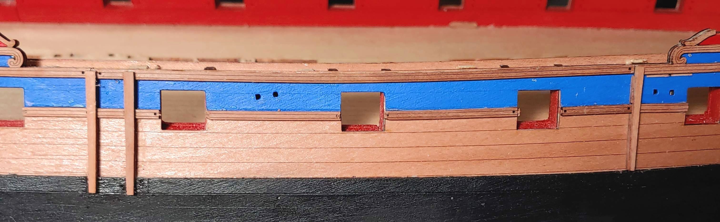

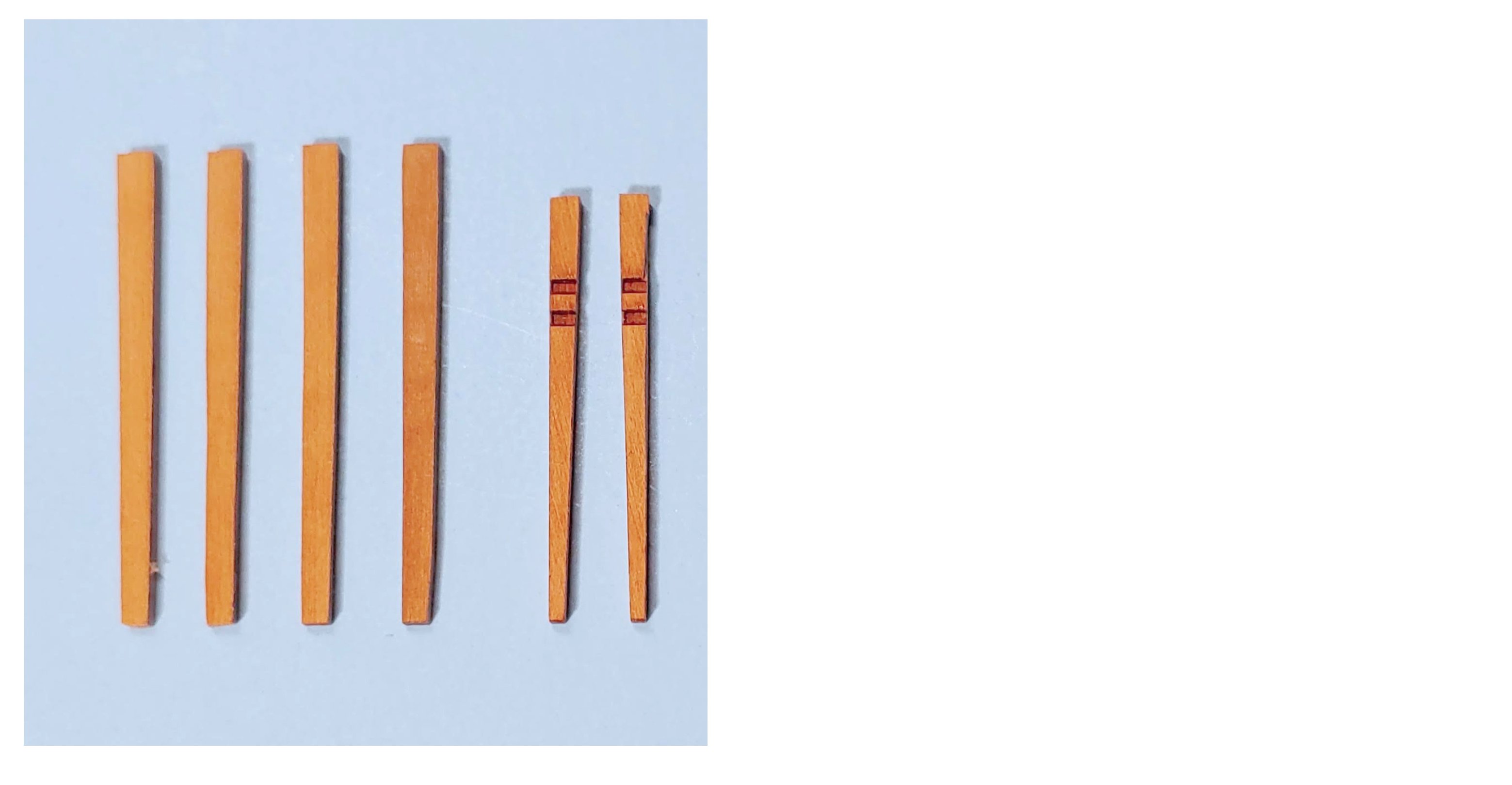

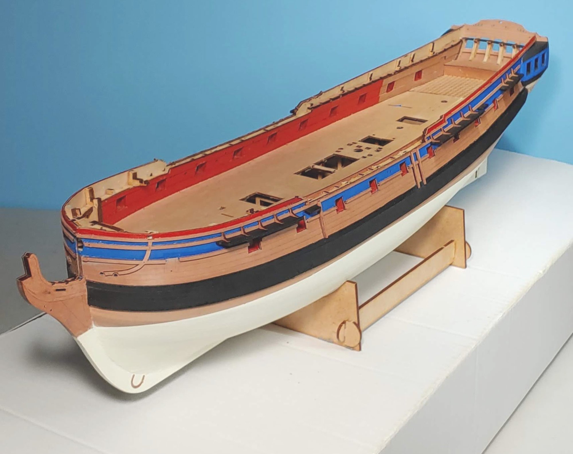

Side fender patterns (left), and chess tree patterns (right)
Fender and chess tree patterns installed:
Current state of play:
It is time for me to step away from this build in order to do my yearly video job.  I expect to resume work late in July.

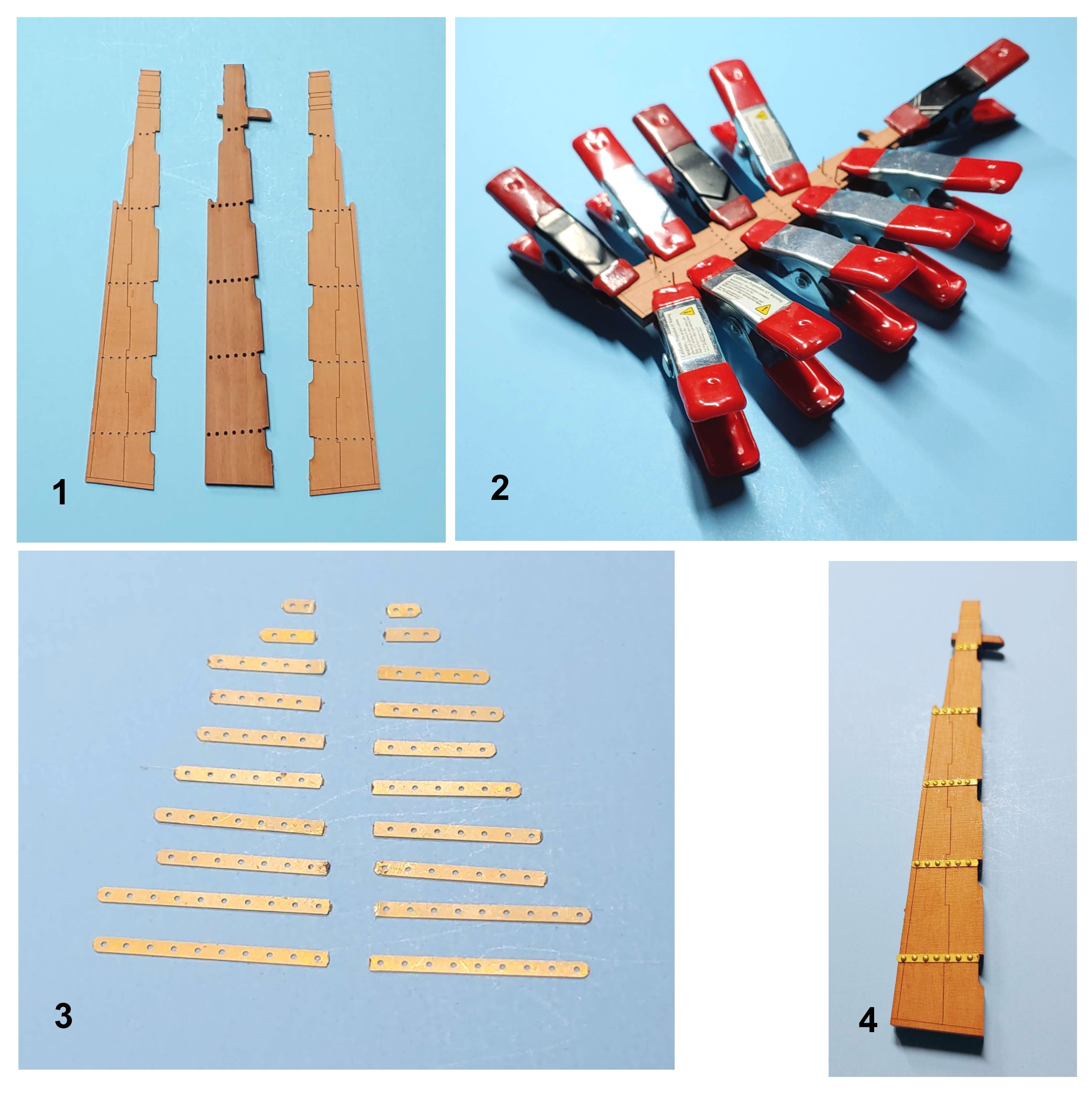

1. Rudder and the two outer patterns.  This will make the usual sandwich arrangement  providing detail which I would not be able to as neatly achieve on my own.
2. Sandwich glued and clamped.
3. PE brass gudgeon and pintle straps.
4, PE straps installed on the rudder using brass pins thoughtfully provided in the kit.  These are cut short so that pins can be inserted from both sides.  Steady hand needed to insert these.
    Loctite CA gel control used here.  I like this glue as it can penetrate well, yet is easy to control.

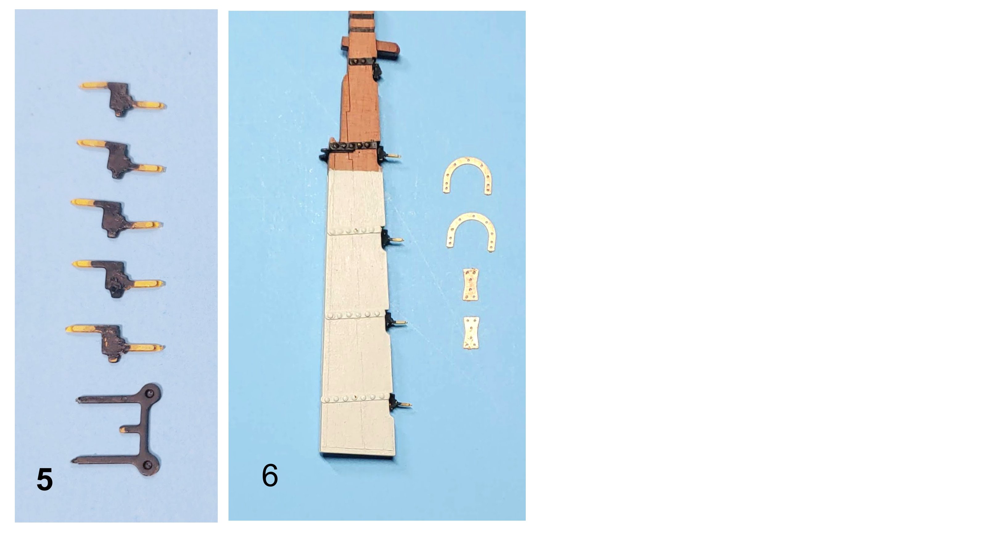

5. PE brass gudgeon/pintle hinge patterns and PE spectacle plate.  These hinge patterns are two dimensional, but enable precise alignment when installing the rudder; a fair tradeoff I would say.
    I was not planning on being able to turn the rudder anyway.
6. Hinge patterns and spectacle plate installed on the rudder.  I dry fitted the rudder on the model after each pattern was glued in before the glue set to insure proper alignment of the pins.

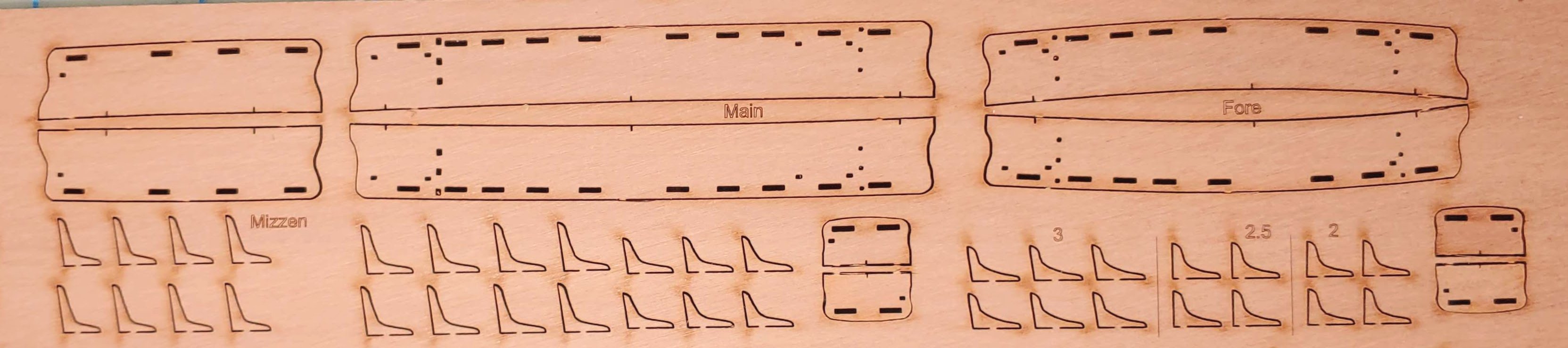

These are the  channels and their knees as they appear in the sheet:

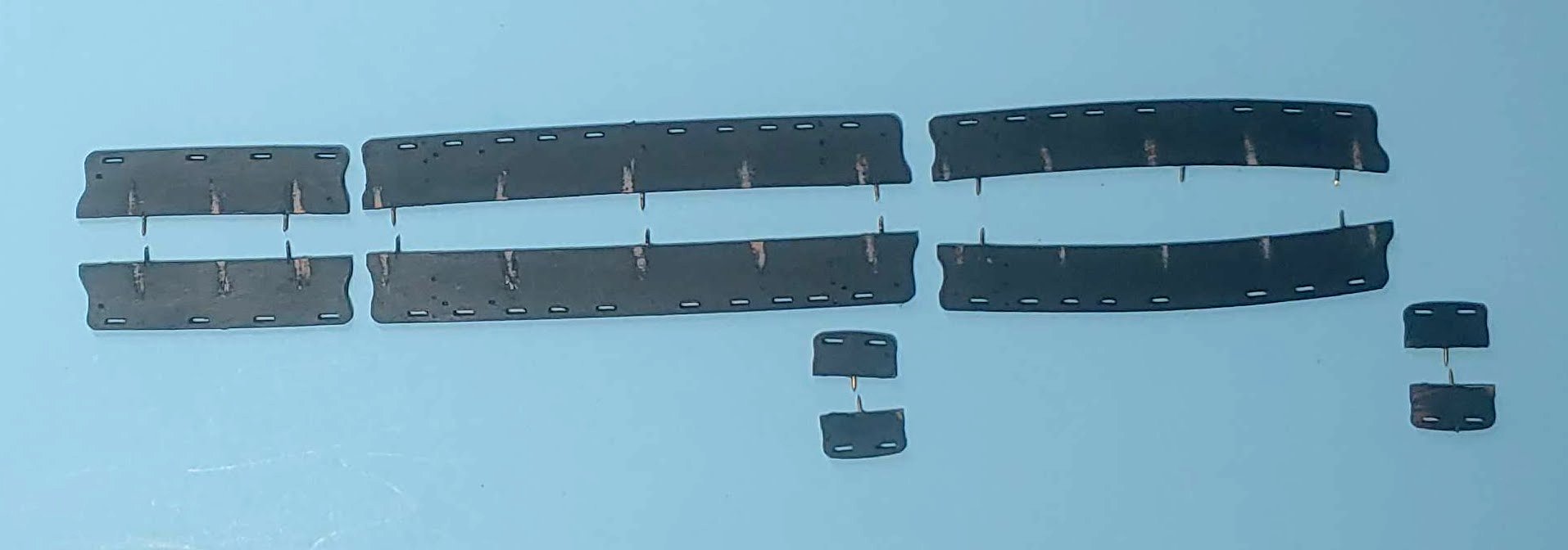

Here are the channels after having  been painted, paint removed at the places where the knees will be located, and the pins installed:
Holes are drilled into the channel at the laser cut notches.  If you do this by hand as I did, be careful that your bit does not emerge from the upper or lower surface of the channel.  The ends of the pins which have been cut off during the installation of the pintle and gudgeon straps are then inserted and glued in so that the points face outward.  These in turn go into the holes provided in the planking pattern.  It all lines up well insuring precise location of the channels.
Here is a view of the port main channel with its knees installed:

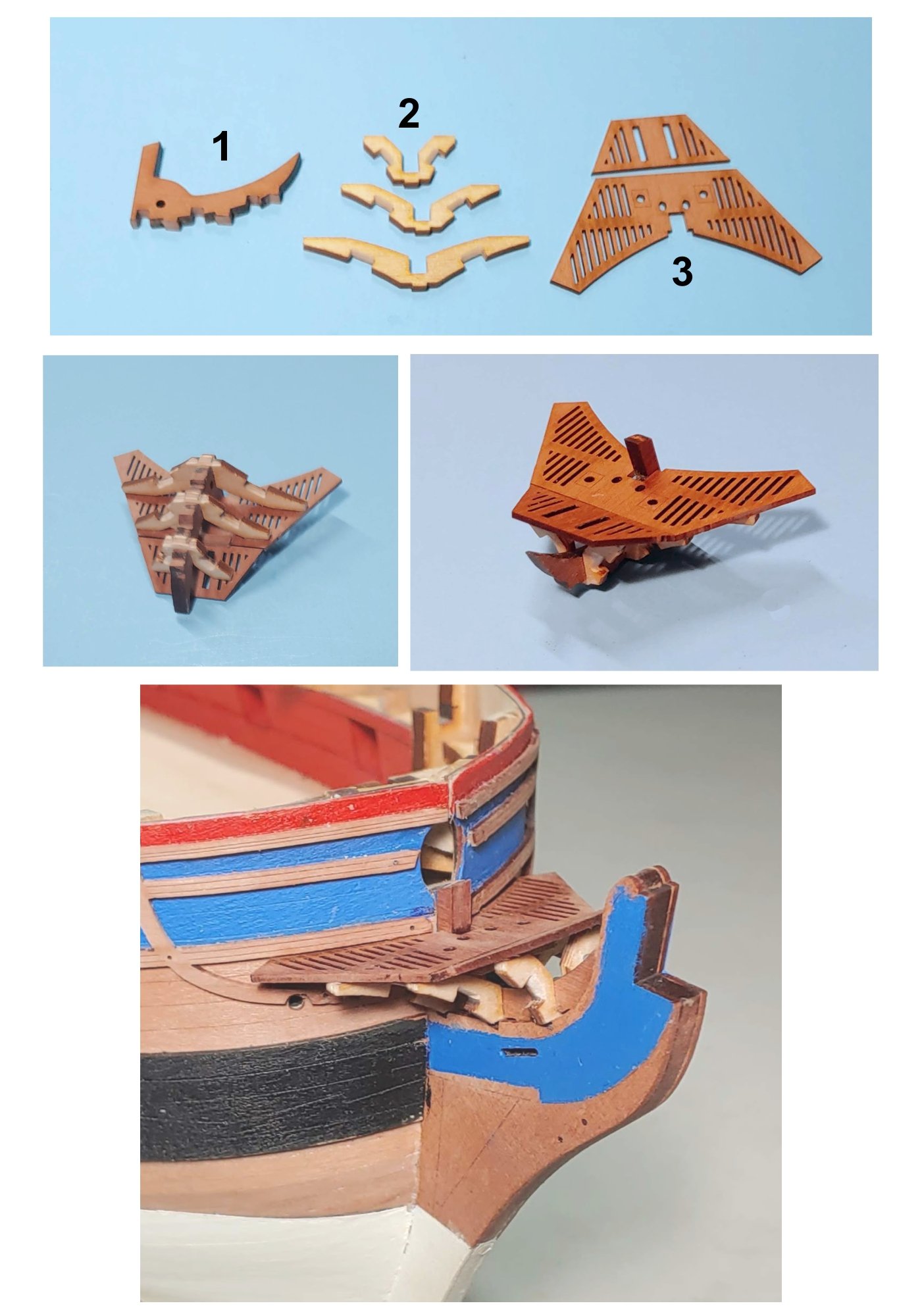

Now for the bowheads.
1. Gammoning knee
2. V brackets (AKA bowhead timbers)  It did not occur to me to paint these black.  Once I got everything together they stood out like the proverbial sore thumb from all the pear components.
    I noticed that in step 300 on p. 52, they are black.  I saw the same in James H's build.  I managed to blacken the forward surfaces of these with a fine felt tip pen as you will see.
3. Bowhead grating.
Photos of their assembly are self explanatory.  They fit together very well.
Next up:

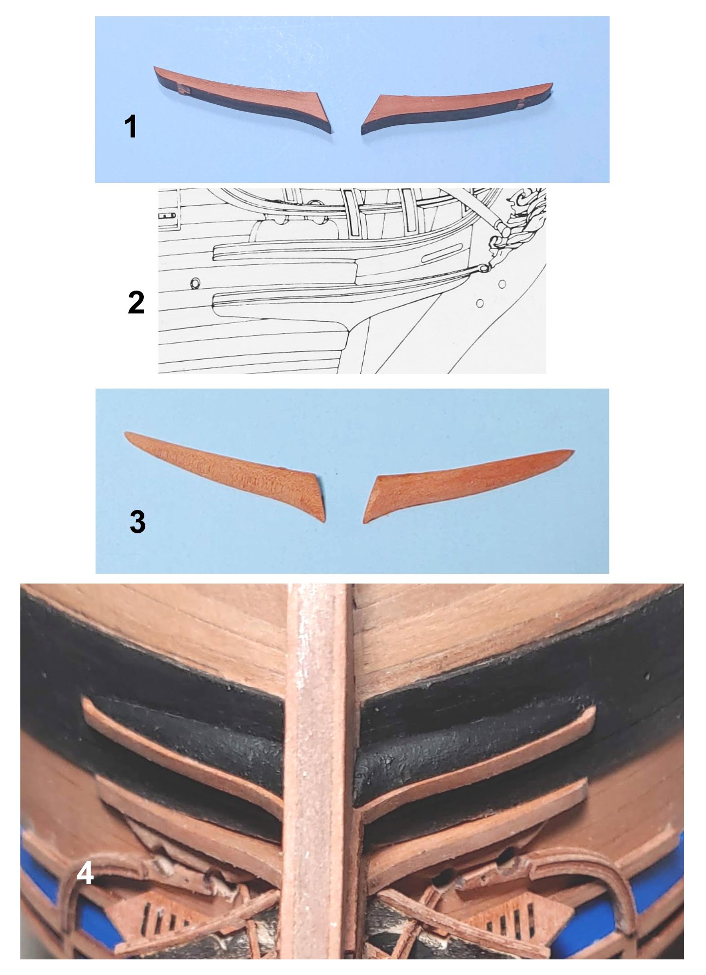

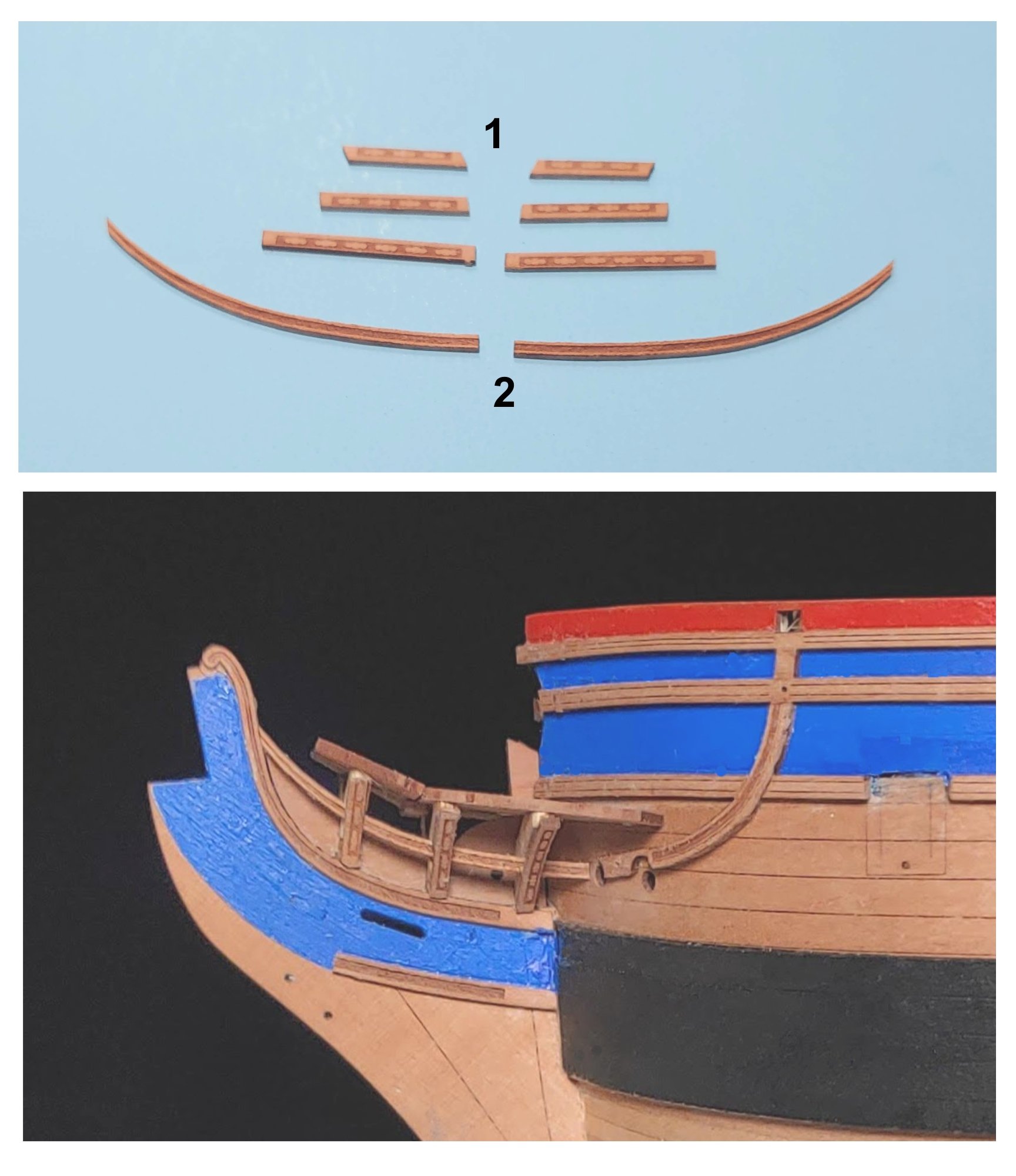

1. Ekeing moulding patterns.  There was some temporary confusion as these parts do not match what is shown in the photo (p51, #288), but looking at other builds cleared things up for me.
2. Bow hair brackets:
3. Bow lower rail
Next I installed the second rail (2) and the head timber patterns (1).  This is not in the prescribed order, and I do not have an explanation of why I did it at that time.  I do not necessarily recommend it.  On the
other hand it did not cause any problems for me either.

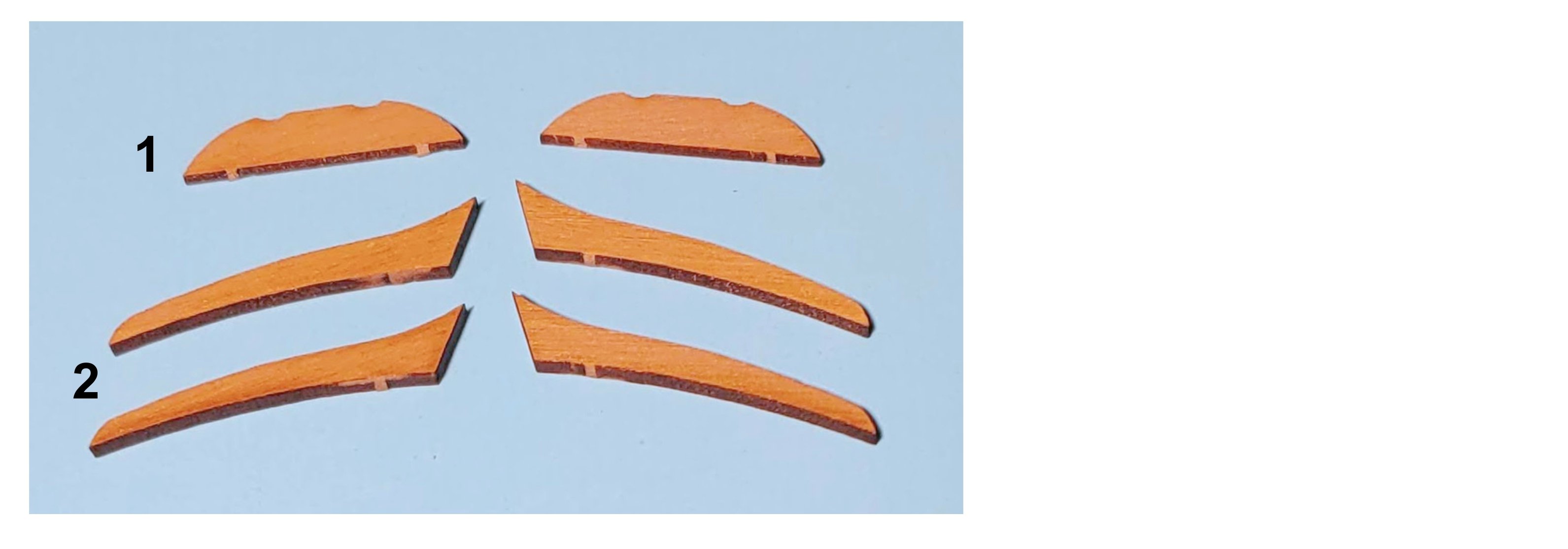

1. Facia for the outboard edges of the V brackets.  I needed to soak and pre-bend these as they were not flexible
2. Second rail

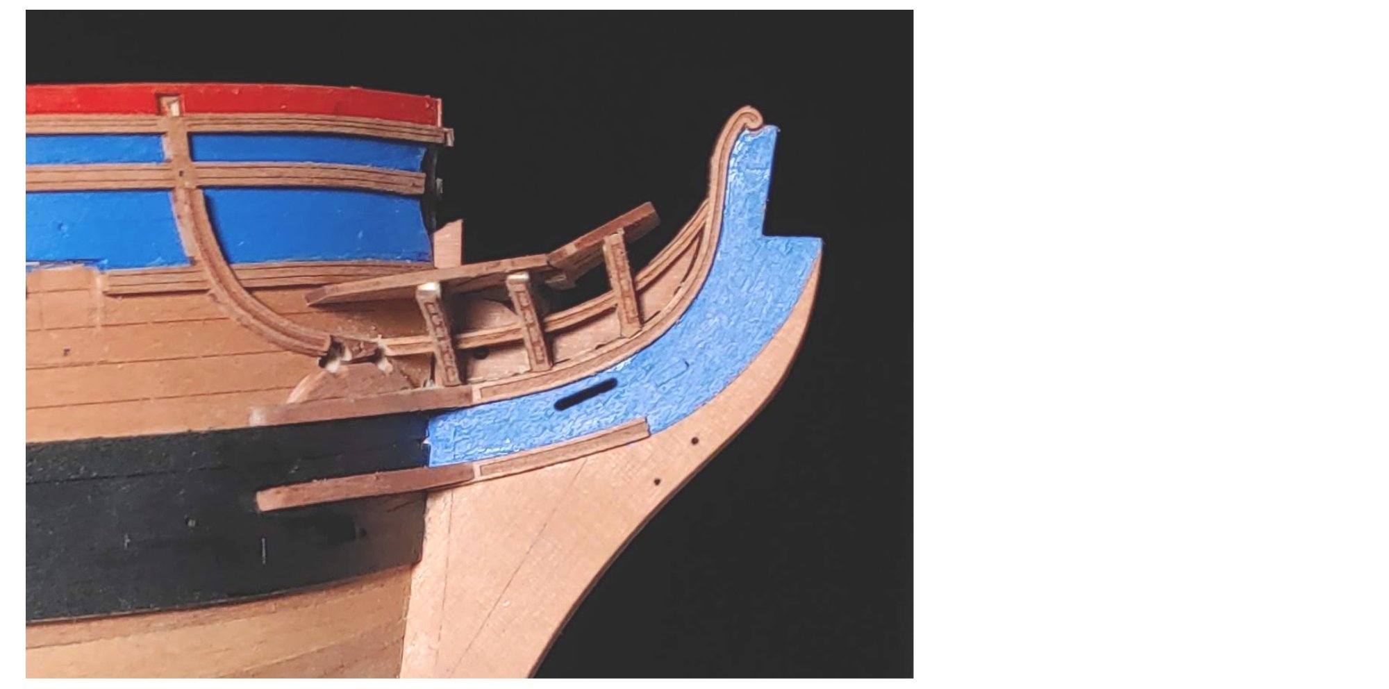

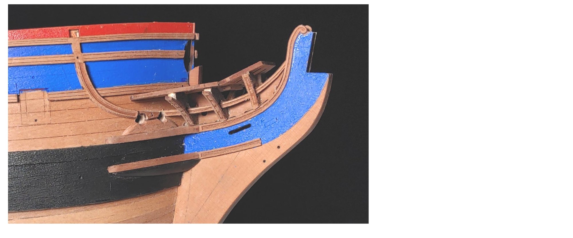

Next step, the bow cheeks (2) and hawse bolsters (1):

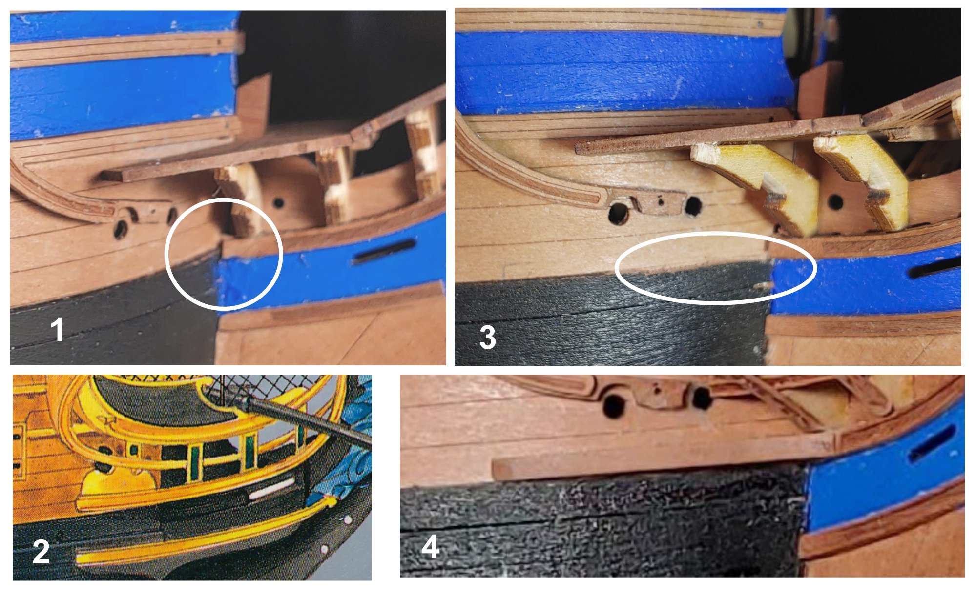

The next set of photos illustrates a problem I ran into and how I got round it:
1. It seems that I installed the wales 1.5 mm too low resulting in the mismatch identified by the circle.  The upper edge of the cheeks should coincide with the upper edge of the black strake which then
    lines up with the bow hair bracket.
2. I looked at the bowhead illustrated in the Pandora AOTS and saw that the upper cheek sits atop the wale black strake.
3. I trimmed down the wale a bit.
4.  I then installed the upper cheek.  Now it lines up with the bow hair bracket.  The Pandora was a sister ship to Sphinx and nearly identical to her in most respects, so I do not think I am completely off base here.
Lastly, the wash cants:
1.  The wash cants as provided.
2.  Again, I looked at the Pandora AOTS and liked the shape I saw...
3. ...and replicated it as closely as I could.  This took some time as you can imagine.
4 They fit nicely under the lower cheeks.
This completes the bowheads except for the main rails, seats of ease, and figure head which will be added much later in the build.

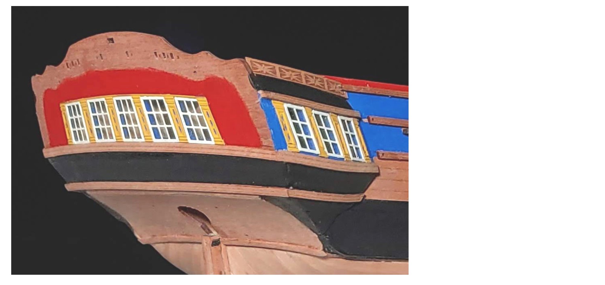

Work is proceeding on the stern.  I have not quite finished the transom yet, but I did finish the quarter galleries, so I thought I would post that work now.
Here is a shot of some of the PE items which have been primed and painted:
As you can see, I elected to paint the decorations yellow ochre rather than gold.  I started with Vallejo Yellow Ochre.  I thought it was too dark, so I added two drops of Vallejo Ivory, then a squirt of Vallejo Light Yellow which
gave me the tone I wanted.  I looks very dark here, but the following photos give a better idea of the actual color:

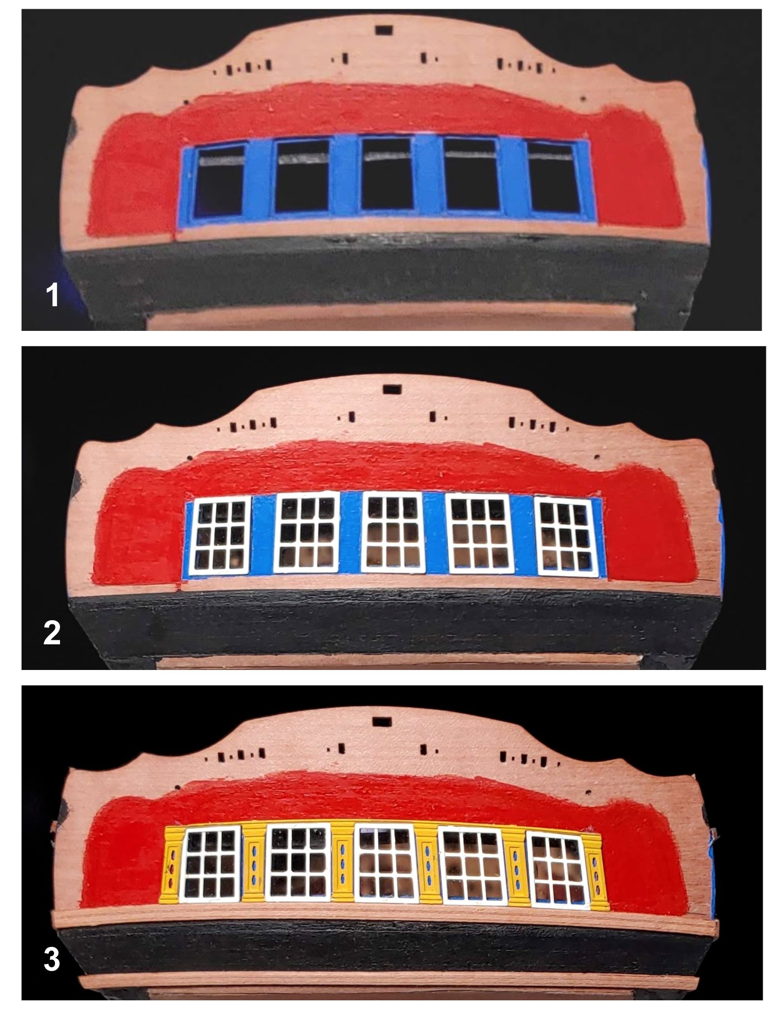

1. I painted the window insert spaces blue.  Big mistake!!  It caused me no end of problems when the time came to insert the acetate window panes.
2. Acetate windows and their frames glued in place.  I used Vallejo matt varnish for this.
3. Rails PE pilasters, and upper fret work installed.  I notice that in other builds, there is quite a variety of color schemes used in the fret work and in the bow head rails and bowhead timber fasciae.  I thought about doing that,
    but ended up deciding to leave well enough alone, discretion being the better part of valor.
4. PE decorations added to the quarter gallery berthing patterns and lower finishing stool.  I applied a coat of varnish, installed the decoration, then put another coat of varnish over that.  The instructions suggest doing
    that with floor polish, but I found that this method also works.  It turned out that there was not enough room for both PE parts on the lower stool, but I am happy with how it looks with just the lower one.
5. Shingles added.  One of the PE shingle patterns slipped out of my hand and into the space between spaces, so there are three rows here instead of the four that the instructions call for.  I see that several other fine builds also have three rows, so I do not see this as a disaster.  There are four rows of shingles on the port side, but as one can only see one gallery at a time, and as I never had any thought of entering my work in a show,    I can live with it.
You might have noticed that the rudder is absent in these photos.  I found it difficult to handle the model while applying decorations without having the rudder come loose, so I removed it. Once all the outer hull details
have been completed, I will re-attach it, this time using maximum strength epoxy.
I will post my work on the transom when I have finished it.

Thank you Ron.  The paint impeded the reaming out of those openings to accommodate the acetate window panes which were larger than I anticipated.  After having made a mess of the forward opening on the port side,  I ended up filing down the acetate panes to fit.  As I could not do the same with the frames which were the same size as the panes, I installed the panes flush with the gallery pattern and then added the frames on top, leaving them proud of the surface of the gallery.  This defect became a lot less noticeable once the plasters were installed fortunately.
Work is proceeding on the stern:
1.  Background painting done.
2. Acetate window panes and frames installed.  The same issues I described in my reply to @Ronald-V question are the same here.
3. PE pilasters glued in place using CA.  Rails installed.
My rendition of the stern is not without its flaws, but at least I managed to have the quarter gallery rails and the transom rails meet neatly at the corners.

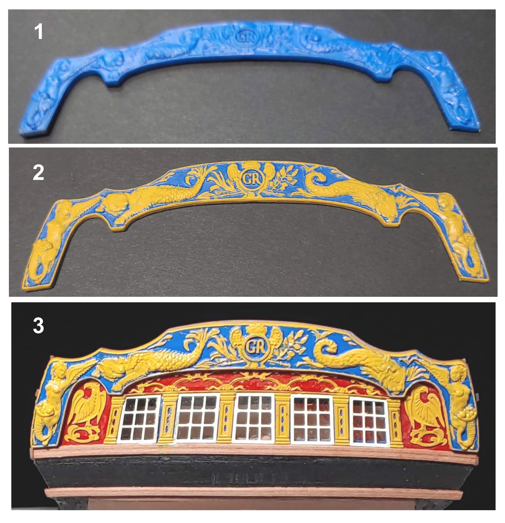

Next:
1.  The superb cast resin taffrail, primed and painted Vallejo Royal Blue.
2.  My best effort to paint the detail thereon with yellow ochre.  Touchup was done on the pilasters after the photo was taken.  Why not before? Well, that's a long story.

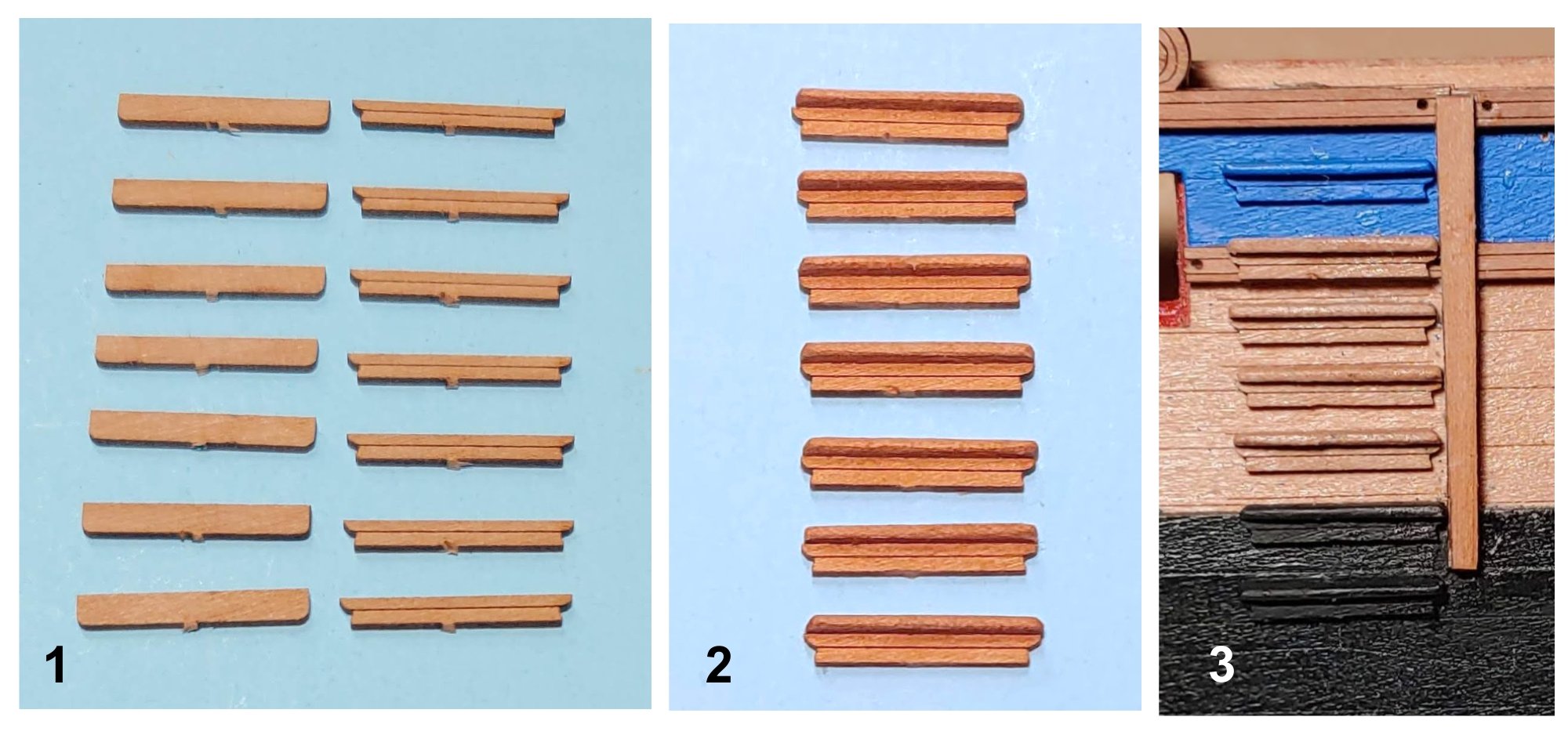

Meanwhile, the next step is the assembly and installation of the gangway steps:
1.  These parts sure beat having to make them from scratch
2.  Having looked at photos of the gangway steps of HMS Victory, I decided to round the steps.
3. After having exposed the bare wood where the steps will go with the point of a file, I glued the steps in position using PVA.  The laser inscribed lines were a big help, especially in view of the fact the steps do not line up with the planks, but with the water line.

Time to glue on the PE decorations to form the frieze.
Here is a sampling of the PE filigree:
The numbers you see on the sprue correspond with those on the detailed 1/64 scale drawings provided, assuring accurate placement of these elements on the hull.
And here they are all glued into place using Vallejo acrylic matte varnish with occasional touches of CA:
