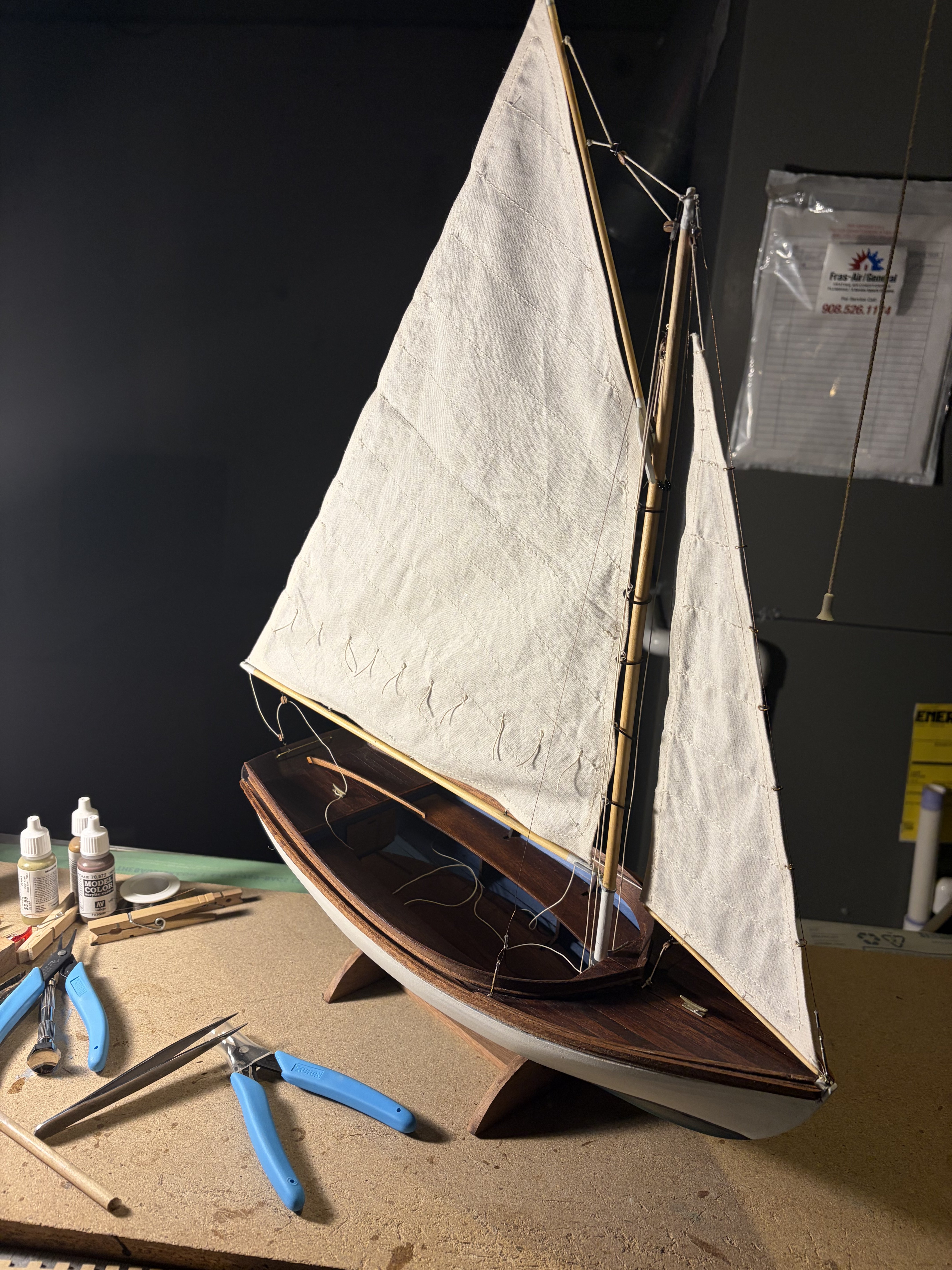

11/14/2025 update( back to it- golf season in the Northeast is over)
Construction notes:
1. Entire hull was painted with Rustoleum 2x Painters Touch Flat white
2. Exposed interior planking was spray painted Rustoleum 2x Painters Touch Wildflower Blue satin( I would choose a different color in retrospect )
3. I used delicate surface Frog Tape to mask the water line. Hunter Green Americas Finest ( Rustoleum) below the water line.
I sprayed the frog tape with matte clear b4 painting with green to prevent color bleed
4. SIGSCS642 1/8” Super Stripe black for the water line
5. I attempted (unsuccessfully) to make wooden mast hoops as outlined in the instructions. I purchased 13/32” hoops ( part no. F-1504) from Blue Jacket
6. Model Shipways makes a wood single sheeve 5mm block MSBB1050- similar in size to the cast components provided with the kit.
7. I am fortunate to have some viable Flo Quil model paint. I used this to paint the ends of the mast, boom and gaff.
8.  Much appreciated shout out to Sue A. who I met at the Blue Jacket rigging class a few years ago. We’ve stayed in touch since, and she provides great advice and ideas as I progress. She stitched the mainsail and jib- great job- and we opted not to install the bolt rope.
9. I had painted the interior mahogany transom blue, and realized that didn’t look right. I used citric acid to effectively strip the paint.
Edited by Steve116
Update
Closing in. The cub and some running rigging remain. It’s been fun. I realize that patience, creativity, imagination, a steady hand( calm, I’m practicing my yoga breathing 😉) visualization are skills that helped me in modeling. Having Nic and Sue as resources have been huge. Thank you
