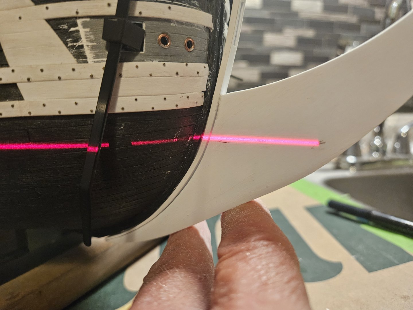

Finally, this is a head on view. Believe it or not, the width at the top (i.e. above the waterline) is 6.25mm, and it gradually tapers down to 4.25mm at the base. Too me, there seems to be very little visible taper at this point, even though it is there. Again, my assumption that only "A" and "B" pieces will be tapered might be wrong, but I can't believe that all of the individual pieces that make up the knee of the head would all be tapered in unison, starting at the stem and marching forward to the cutwater, at least below the waterline. It is not razor blade sharp as in the clipper photo that I posted just abve this, but it does seem to be more in line with the Zeven Provincean photo that Marc also posted just above.

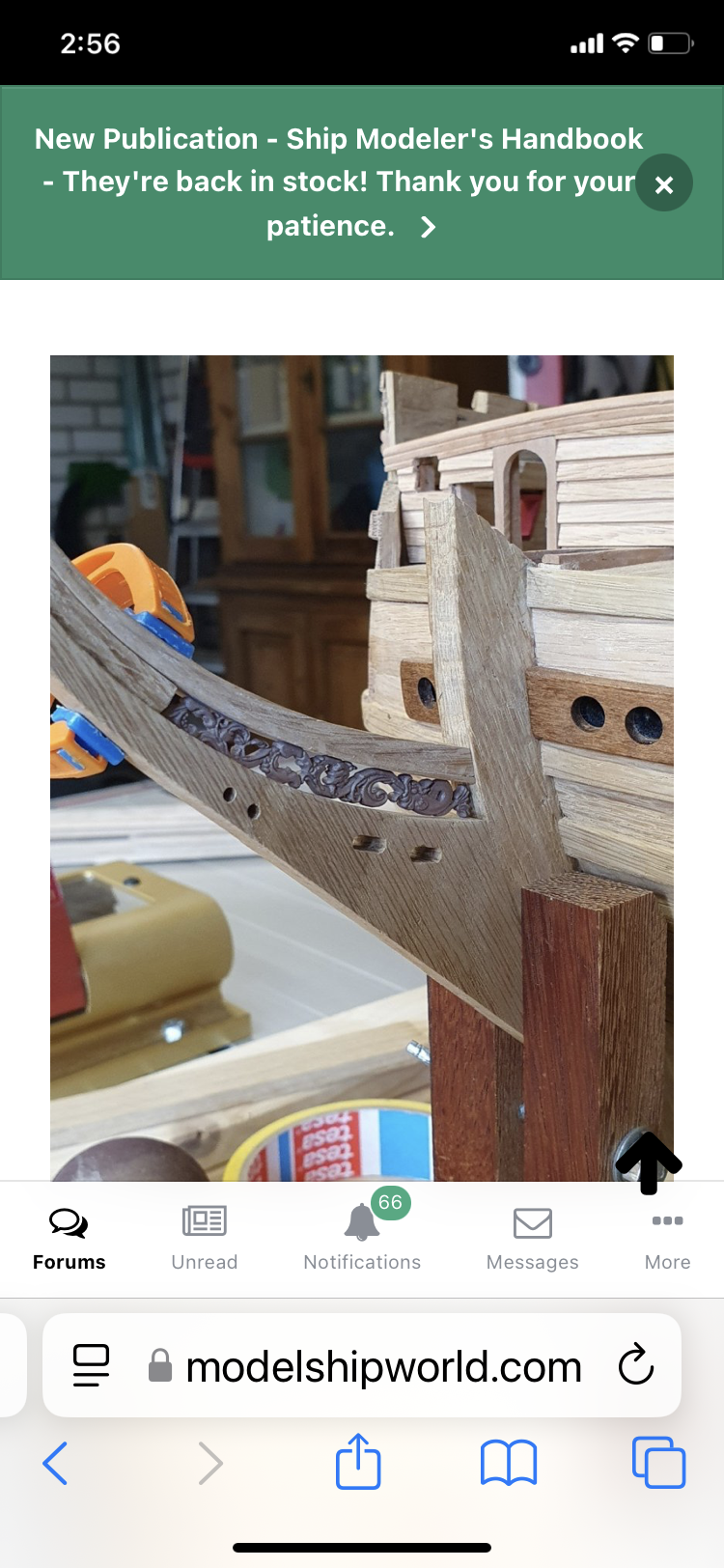

Generally, shipwrights avoid cutting timbers into long tapering points because those sharp timber ends become much more prone to rotting quickly.  This is why deck planking is “joggled” into the margin plank, for example:
As it relates to the stem, it is also quite beneficial for the structure of the thing to be inter-locking with the use of hooks and scarfs.  I’ve taken the liberty to draw an approximate sketch of your cutwater:
Ideally, you don’t want the gammoning holes to cross between timber joins.
As for the tapering of the cutwater, Lemineur shows it as a long gradual taper across the full depth of the cutwater:
However, he also shows the foot of the cutwater as being full width, while the head of the cutwater (behind the head of the Figurehead) is tapered to half-width:
The way to understand this, I think, is that the foot of the cutwater is very shallow in depth, as opposed to the head of the cutwater, which extends some 30’ further, ahead of the stem.
From a practical standpoint, you want that taper to be most pronounced at the foot of the cutwater, as it improves water-flow.  This is what you have done.  I do think, though, that the full depth of the cutwater should have a gradual tapering, back to full width where it meets the stem.  What this means is that your cutwater foot will have a much more pronounced looking taper, because you are reducing by anywhere from a 1/3 to a 1/2 width, over a relatively short span:
I hope that makes sense.
Marc's taper explanation above really helped... in simple terms for my mind, it means that even though the curve of the cutwater viewed from the side may be a curve 6" long, the ocean sees the frontal view, and the curve now appears to be a simple straight piece only 4" top to bottom, but the taper must appear even as Marc drew. I also tried to evenly plane down the thickness from leading edge back to the stem...

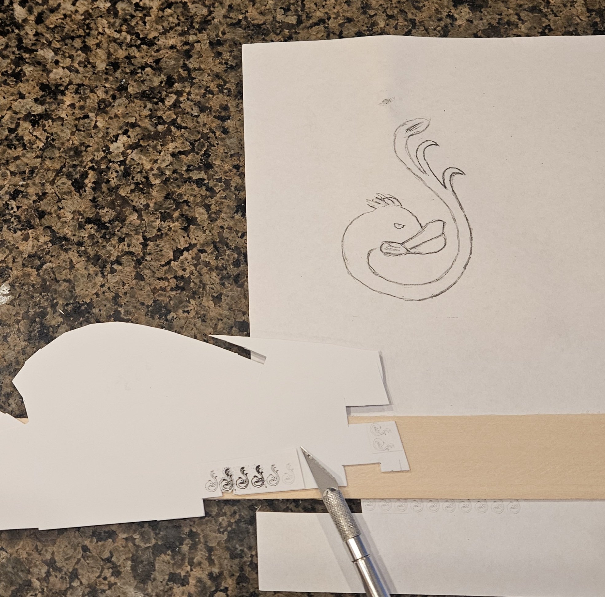

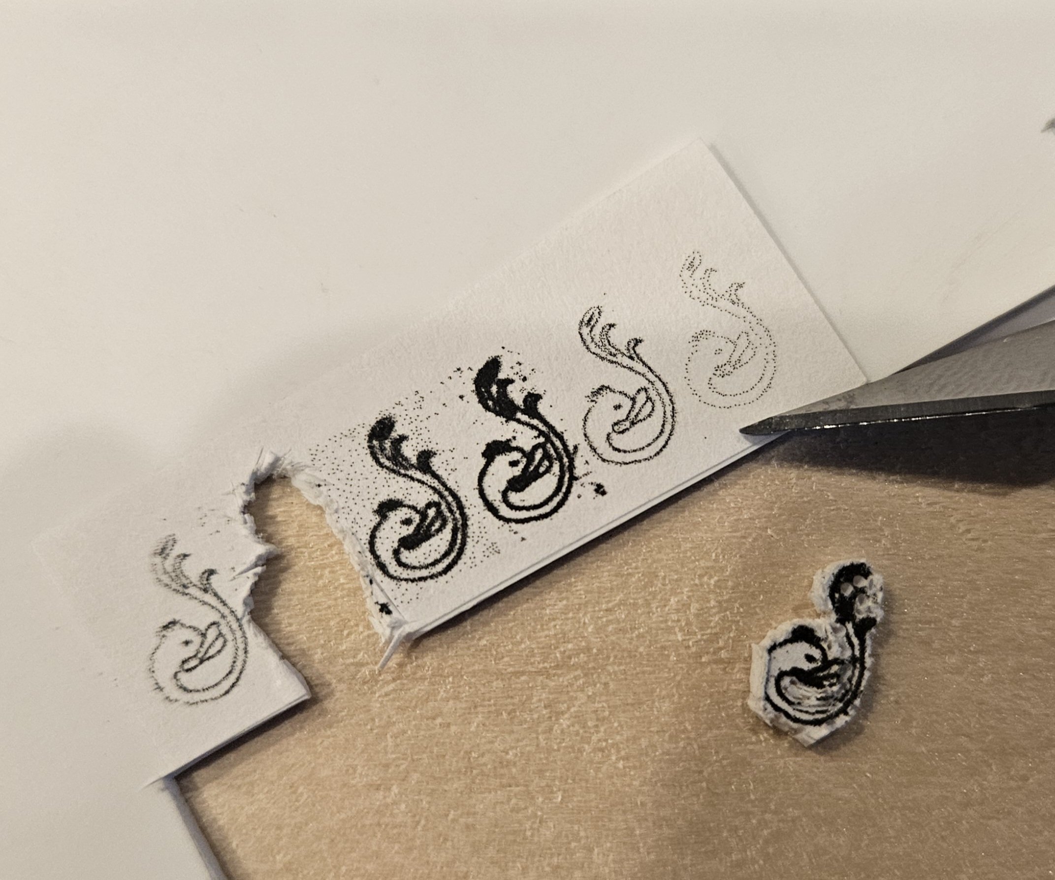

I decided to try a dolphin first; I will need a mirror image pair to make resin molds of. I drew a dolphin on vellum after finding lots of "dolphins on French furniture" pictures. I wanted a large head and a slender body, and I liked the wood carving with oversized lips (duck lips?!). I took the drawing and scanned it, then was able to make tiny little prints that measured 8mm tall... the vertical height of the upper deck gun ports.

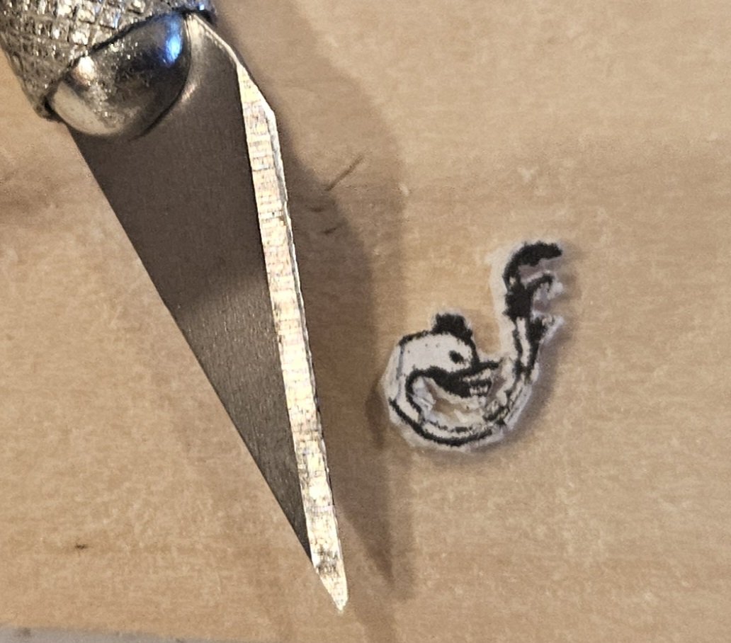

I decided to try 0.5mm thick sheet fr the first go around, and glued the little prints to the Evergreen sheet stock.
So far, maybe so good. Very fragile but nothing has broken so far...
After about 90 minutes of very gentle cutting, filing, and scraping...
I am satisfied with my first attempt; I know that Marc and others have said in their logs that the trick is to create some texture that catches the light. I know that my second carving will be better than the first, and the third better than the second, and so on....

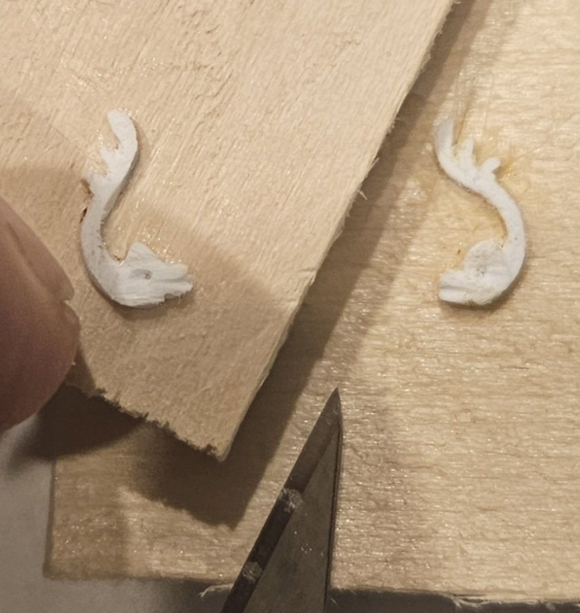

Hi Eric - you might have an easier time of it, if you drill perforation holes all around your carvings, first.  After extracting the carving blank, I find needle files indispensable for cleaning up the outline shapes of even small parts like this.  Once you like the outline, you can mount the carving permanently to a wooden block and do the detail carving.  Finally, you’ll be left with a master for making rubber moulds.  It’s all very fiddly, but you’d be surprised what you can train your fingers to do.

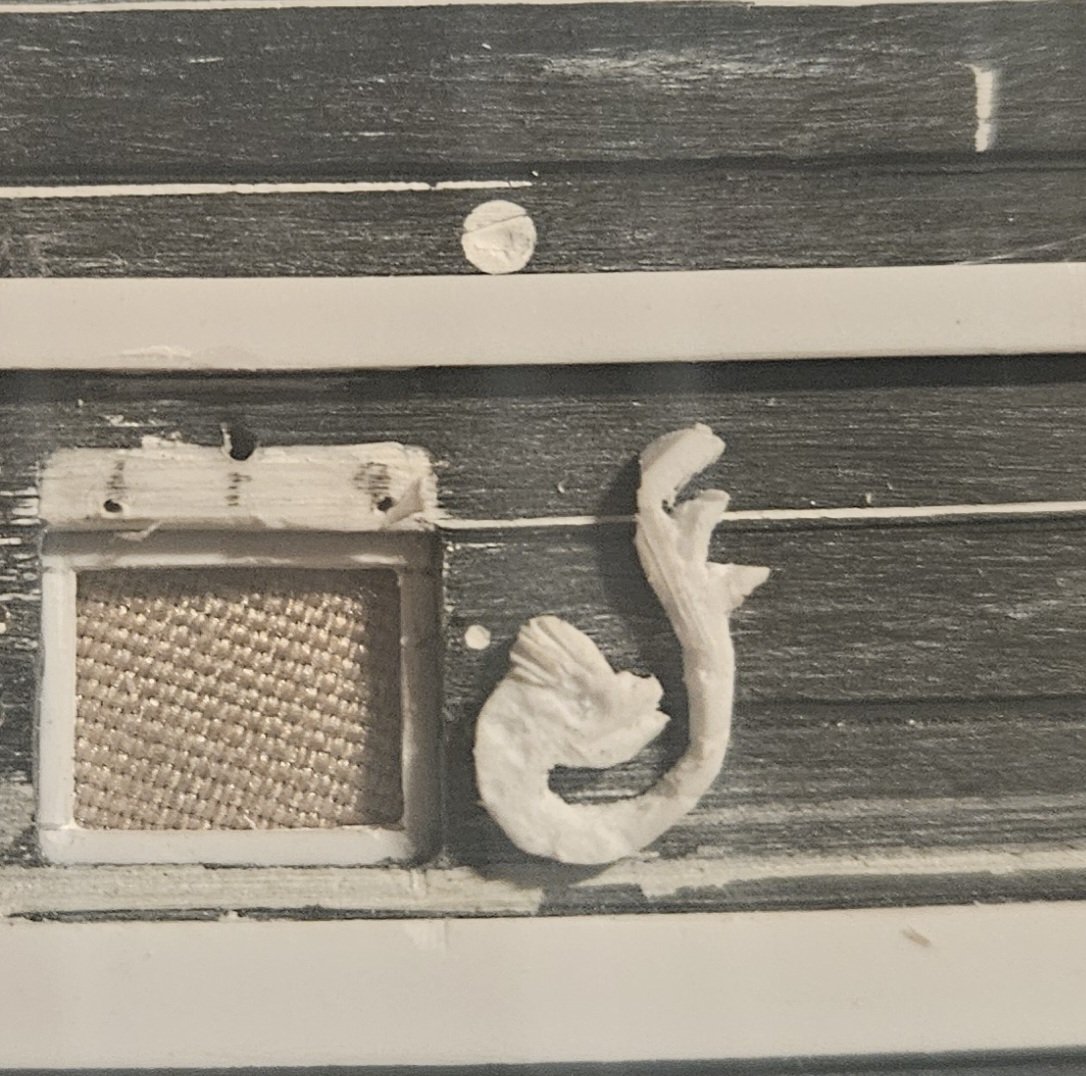

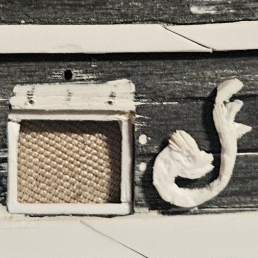

I like the dolphins.  Will the tails abut the port openings?
Marc, I did drill perforation holes around the first one (the one in the picture below). I just tried a second one without perforation, and it didn't do well.

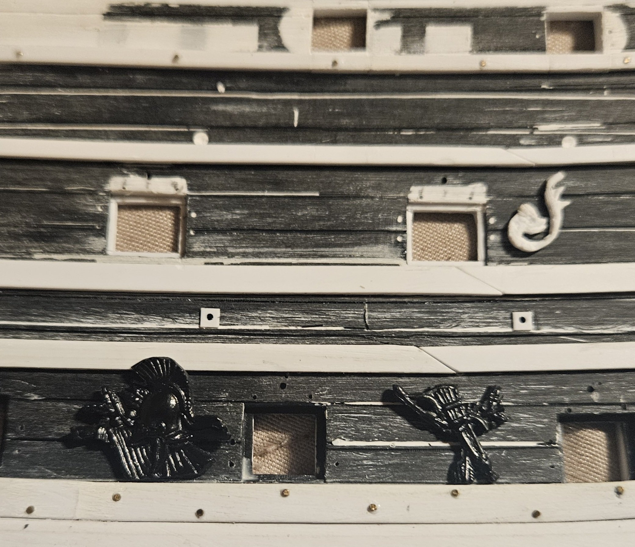

By "abut", do you mean the tail should be a little more to the left? This is as close as I can get the dolphin without butting up against the (future) gun port tackles
What I mean is that the dolphins make more visual sense as a framing for the port if their orientation is the opposite of what you are showing - whereby the tails contact the top corners of the port and the heads fan away from the port.  Given the shape of your dolphins, you should still have clearance for the carriage tackle bolts.

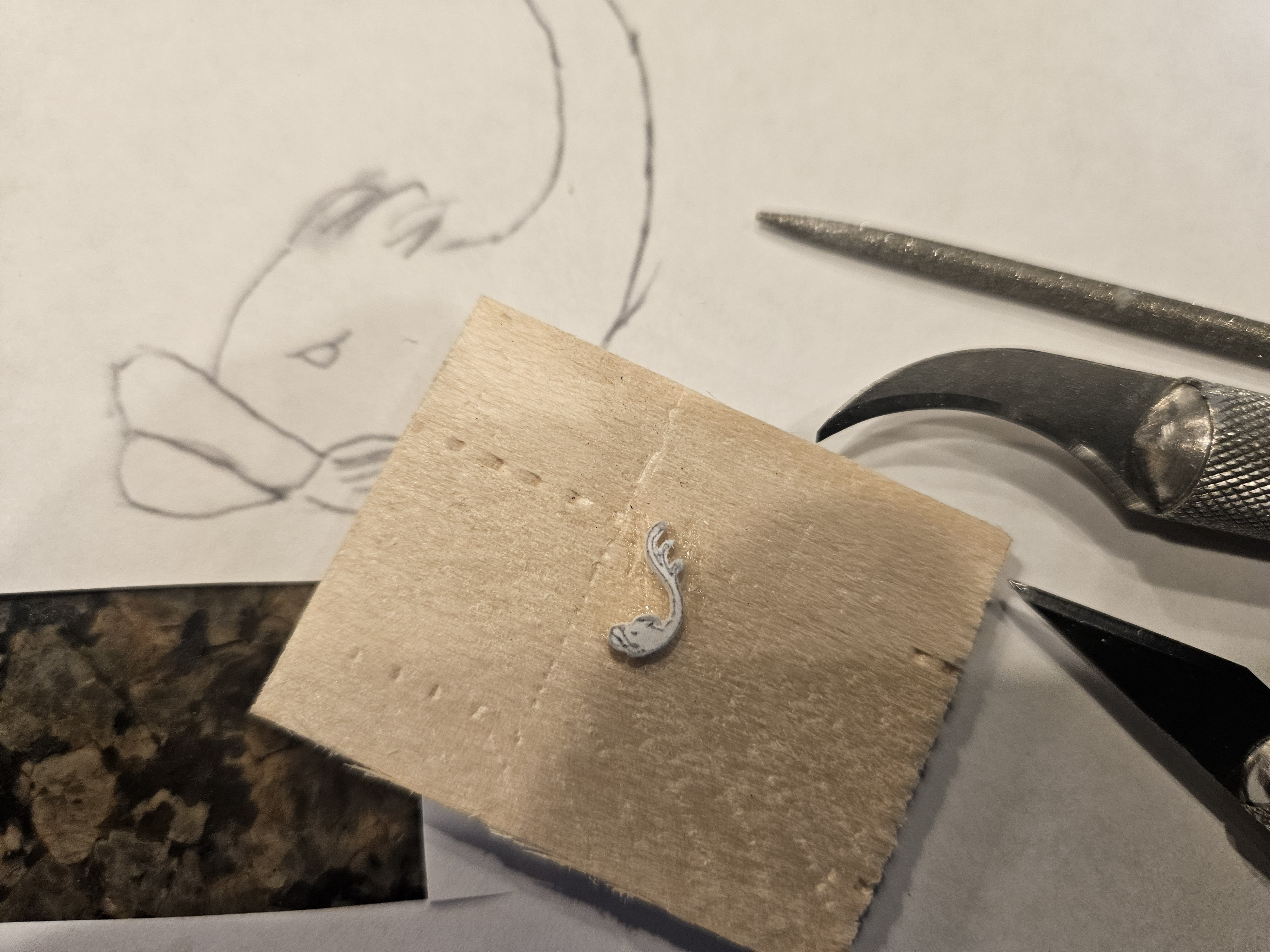

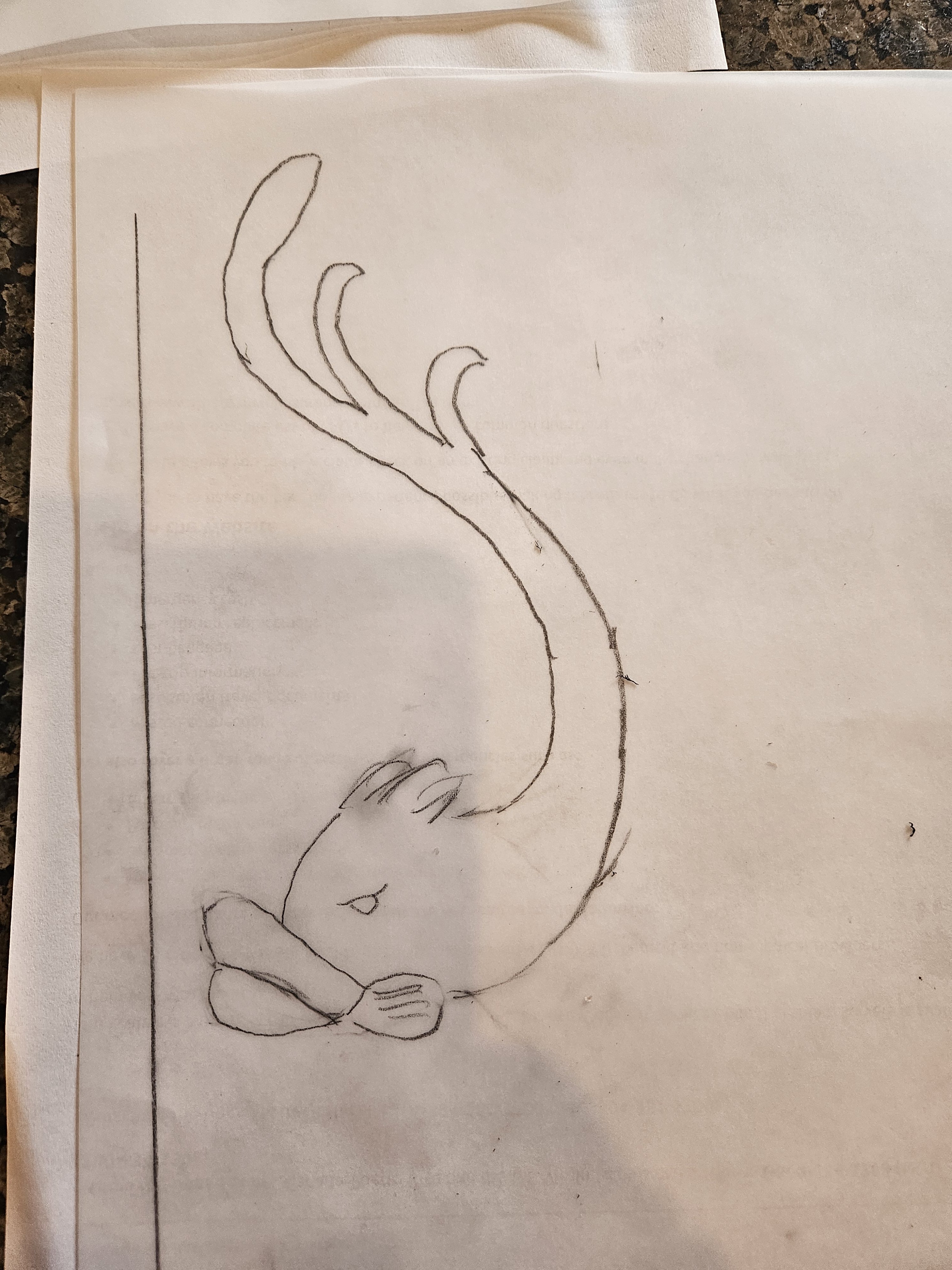

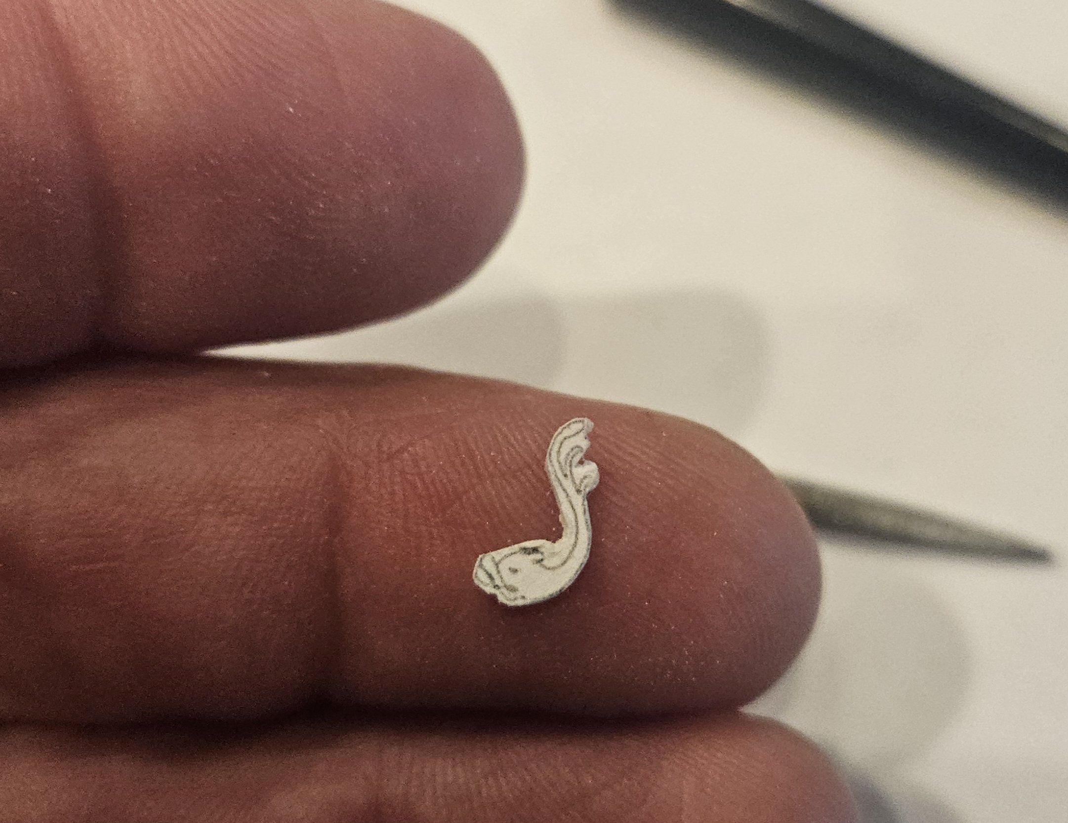

Taking Marc's suggestion to heart (dolphin head should face the gun port, tail flaring away), I went back to the vellum paper for sketching and ended up with this...
After scanning the drawing into my computer, I just went into Word and shrank the drawing to a square 8mm x 8mm, then printed out some tiny dolphins that I glued to 1mm thick Evergreen sheet.I then perforated around the tiny dolphin with a very small drill bit, and with a bit of filing, got this for my right side of gun port dolphin (this is my second attempt at a right hand dolphin)...

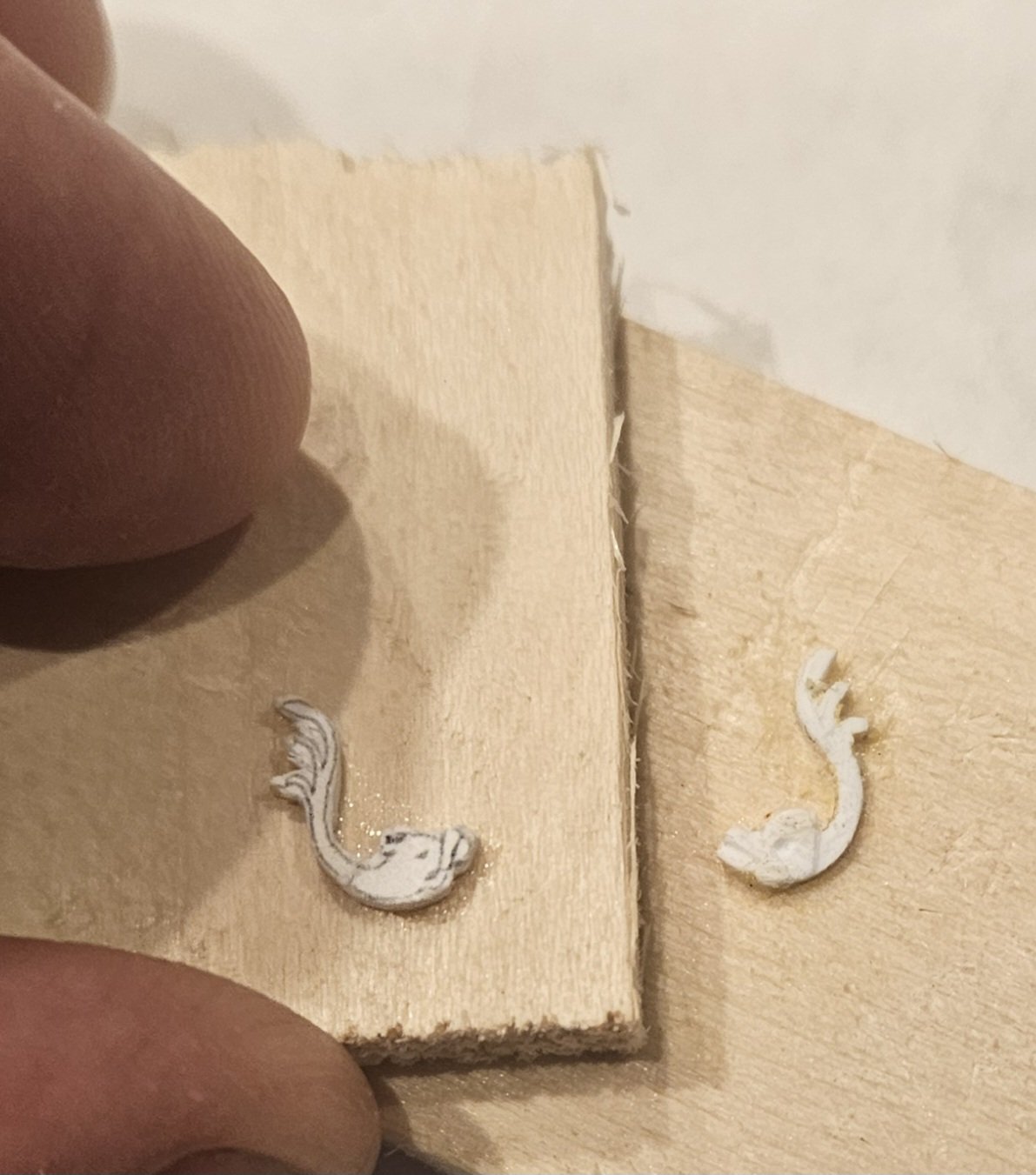

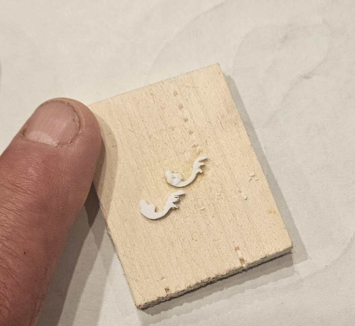

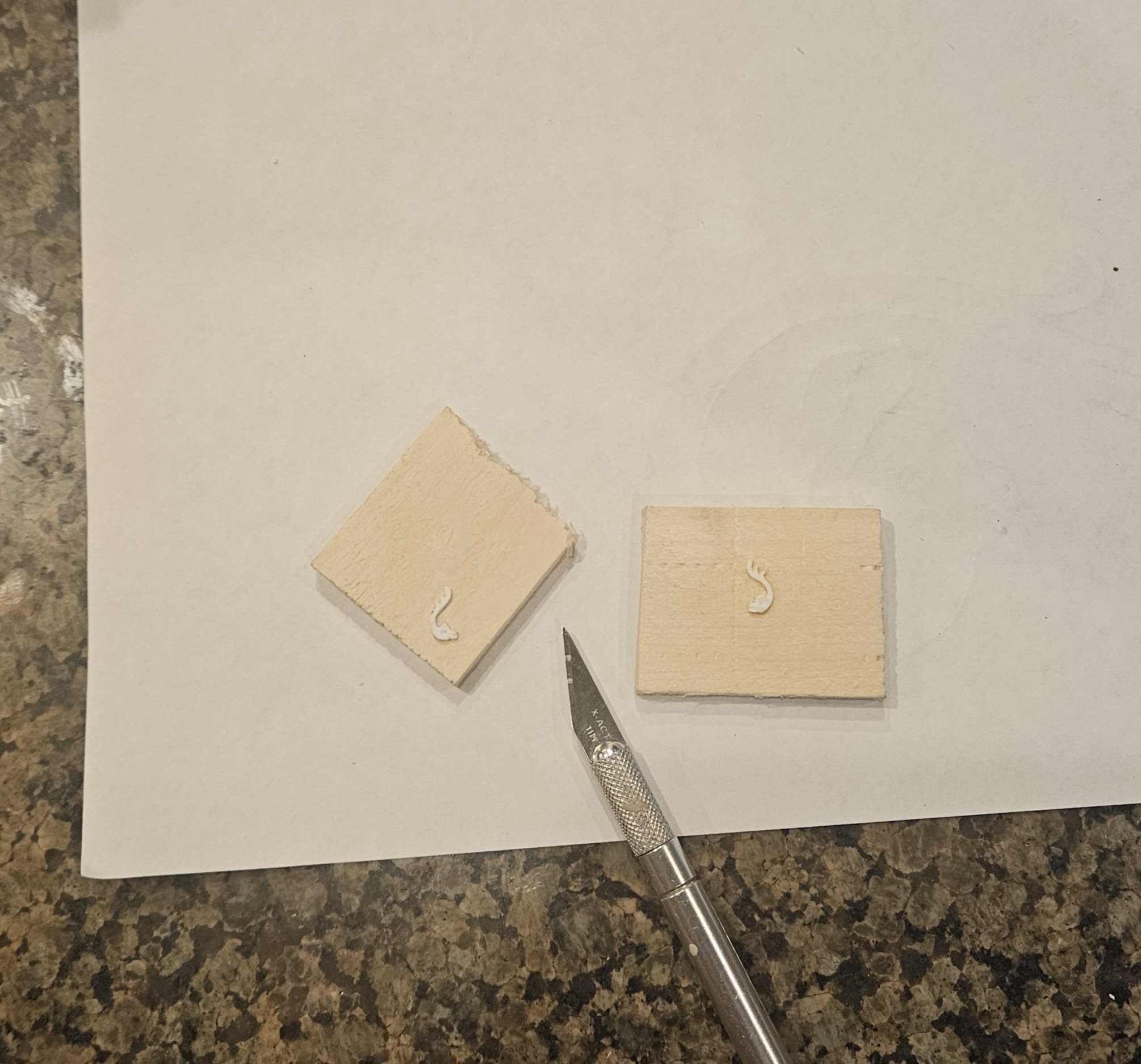

 I also cut some blanks out for a left side dolphin, but I finished the right side first..
It took me 4-5 tries on the left side dolphin, as I just couldn't get a result that looked close to a mirror image... until I flipped the left side over and worked on it while it was laying next to the completed right side dolphin.. it was much easier for my brain to "see".
Finally, I ended up with this pair that I am mostly satisfied with...
I could continue to tweak and try again, but I reassured myelf that this is the view that people will see if they get their eyes within six inxhes of the ship (however, I may add the tiniest piece of clay behind the head of the left hand dolphin if I am not satisfied with the resin copies). It is interestng how just changing the position of the camera angle very slightly can make them look a lot different!

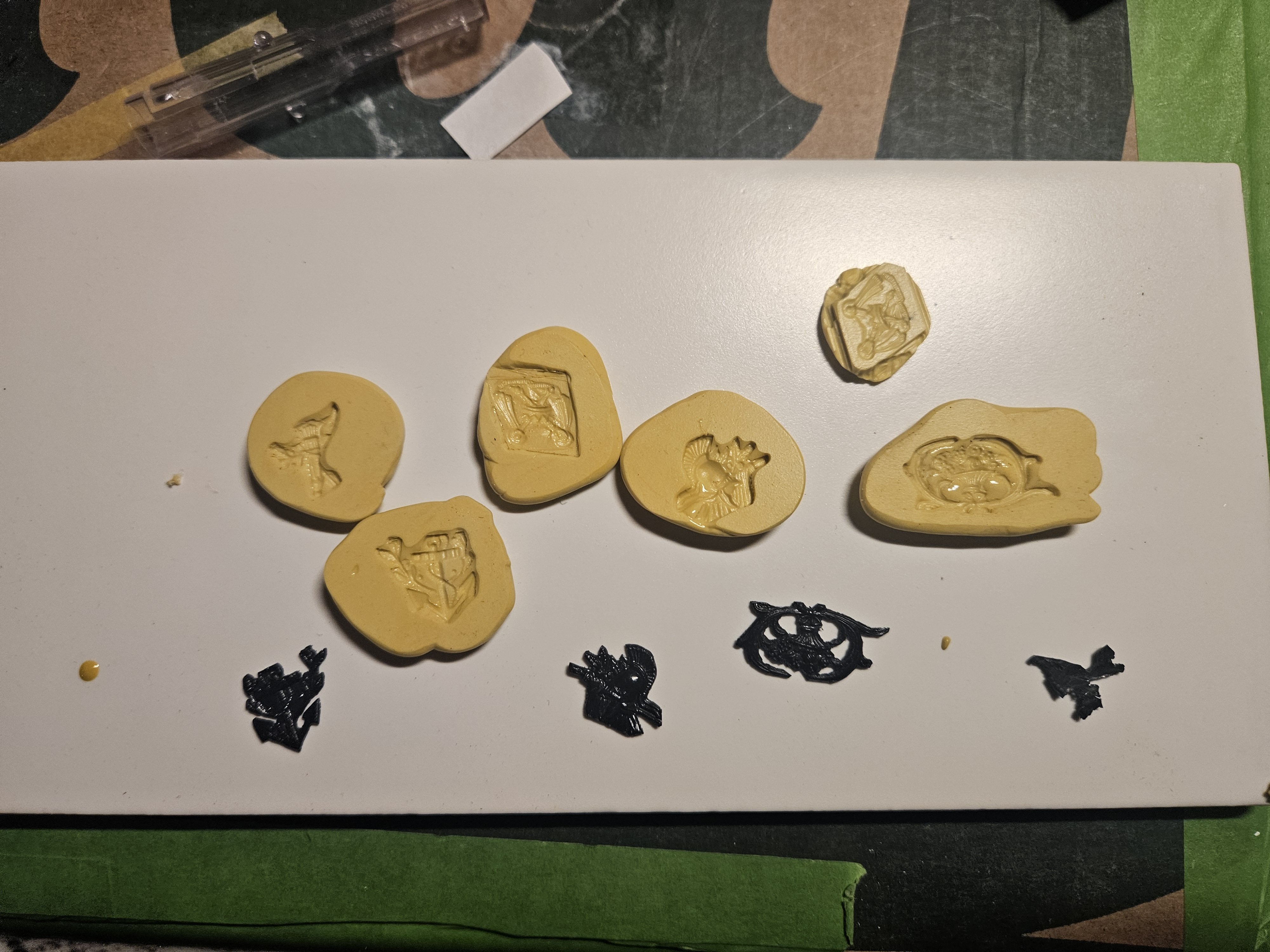

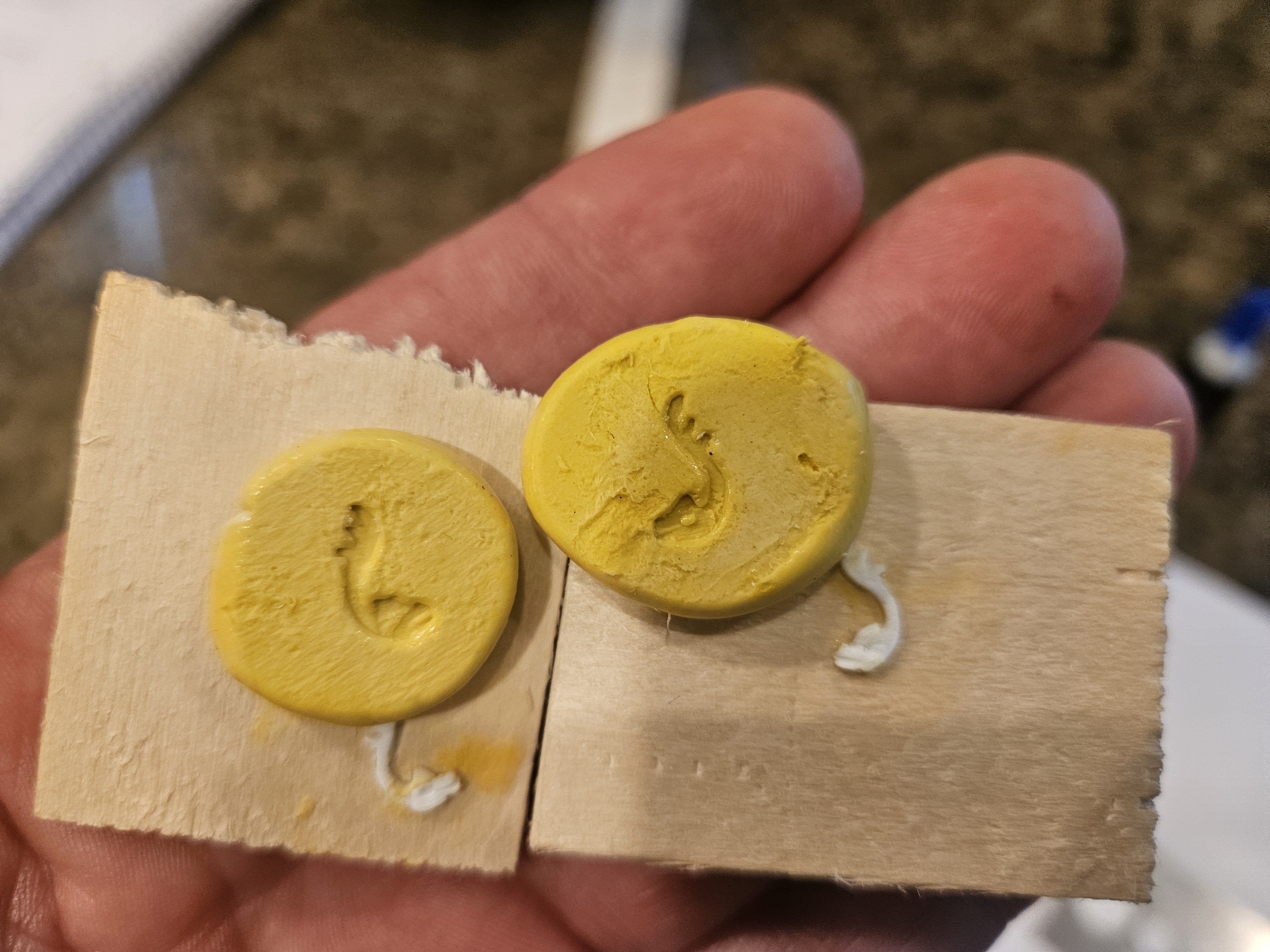

And now the great reveal of the moulds.... ugg. Not happy. I will try making resin copies from these just to see, but I think I made a mistake glueing the pieces to a rough piece of wood (a cheap shim!). Notice the mould body doesnt want to release cleanly. Hmmm... maybe I can sand around the pieces to smooth the wood a bit, and then coat the wood surface with a very thin cyano acrylate to seal the surface? Suggestions welcome, as I think if I try and pry off the pieces, I will ruin them...
These dolphins are much more proportional, and I think the placement works much better.

Definitely, you are going to want to glue the masters to a flat smooth surface, and after you do that you want to scrape away the glue “halo” (squeeze out), so that you get a sharp delineation between the carving and the ground.
As for removing the carvings from the existing ground, acetone is the most effective release agent, but that will obviously melt your part.
You could waste the wood away from behind with a Dremel sanding drum attachment.  Or, you may have to chalk that up to experience and make new masters.
